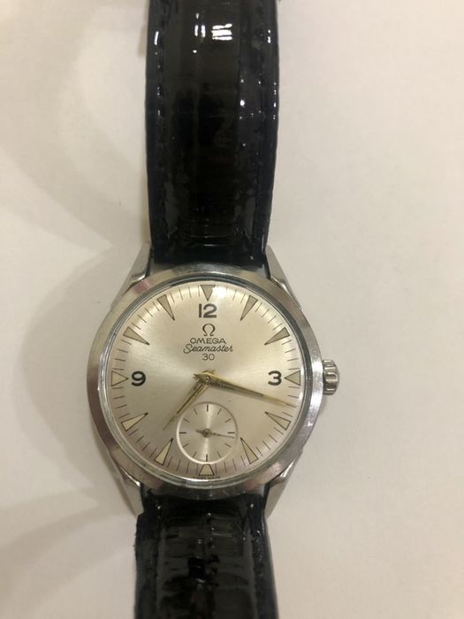

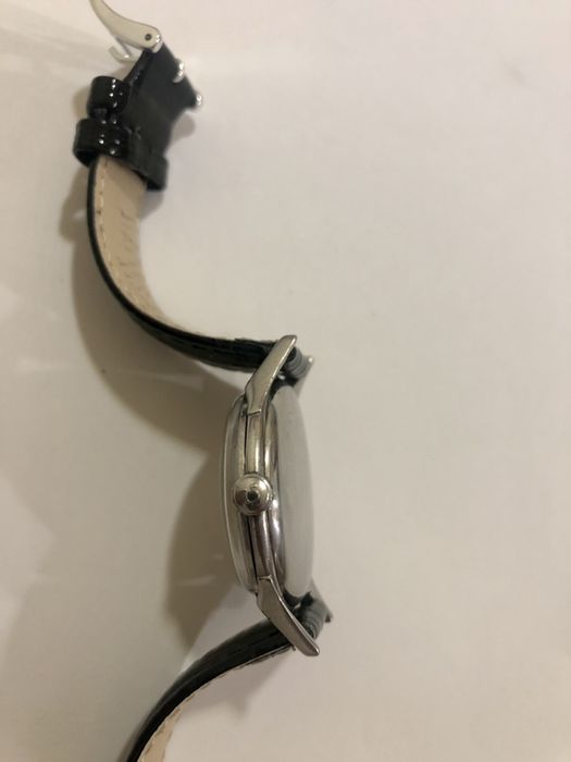

Posts 354 Likes 3,268 GeorgeT11 ·Dec 2, 2020 Hi fellow watch addicts, Found this Omega for sale but I can't find anywhere this dial configuration. Is it just one of those fantasy dials some people come up with? Thanks for looking and sorry for the bad photos.

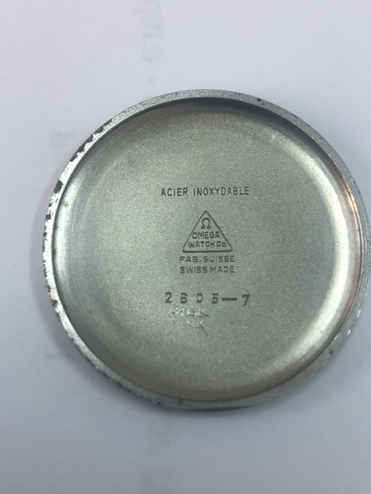

Posts 13,492 Likes 31,811 X350 XJR ·Dec 2, 2020·Vintage Omega Aficionado Not to mention ref 2605 never was a Seamaster.

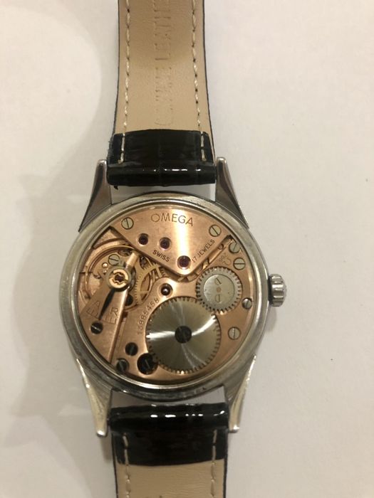

Posts 99 Likes 239 Romega ·Dec 2, 2020 The dial is wrong, but the 2605 was launched in 1950 and is correct with caliber 266. Serialnumber 13 mill dates the watch to about 1952. Hands seems OK as well https://www.omegawatches.com/watch-omega-other-omega-ck-2605
Posts 5,026 Likes 18,608 Shabbaz ·Dec 2, 2020 X350 XJR Not to mention ref 2605 never was a Seamaster. Haha. Did'nt even look at that! One look at the case and I've could have seen it. Terrible judgement. Never listen to me again
