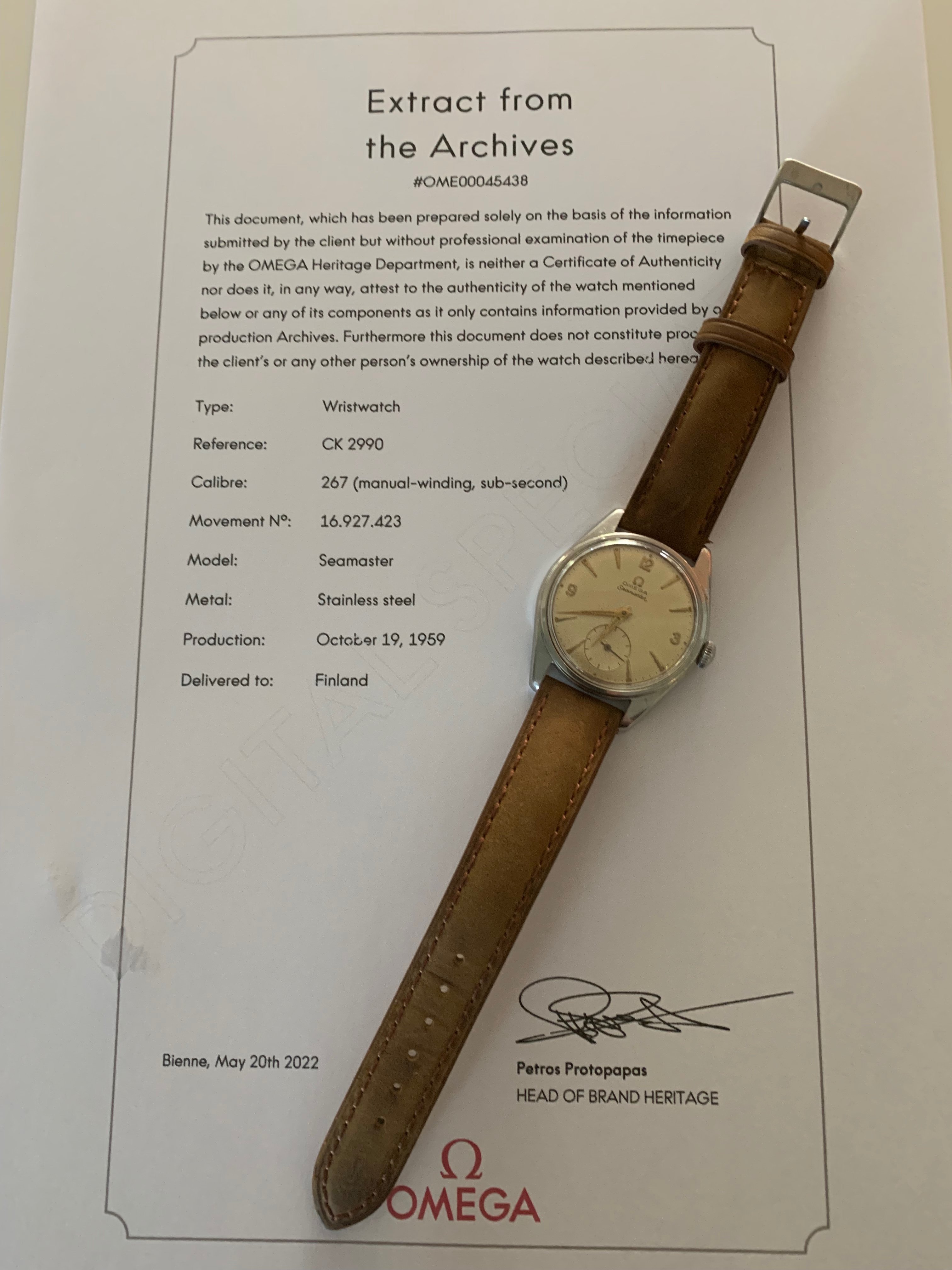

Returning to the matter which initiated this thread - having read and re-read all the opinions, is it worth going back to Omega and querying whether the archive did indeed show that movement number being produced as a Ranchero - and therefore - despite the current Seamaster dial - the model which should be recorded as Ranchero on the Extract? Interestingly, the production date is only a few days apart from @tdn-dk 's extract and delivery is also to Finland...
This isn't about value in any way - it's simply that I purchased what was offered as a 'Seachero' from interest in the circumstances back then that led to these existing - and now looks like it cannot be proven this was born a Ranchero. Therefore - at best - it "maybe" a 'Seachero' or whatever label is used...

That aside, the final chapter in this particular story is yet to be written - I did contact Omega asking their Archive team to take another look to ensure the watch with this case and movement didn't leave the factory as a Ranchero (and correct the EoA if needed). Just received the following reply (my highlights)....
OUR ANSWER
Dear Mr. Sheffield,
We thank you for your request and are happy to learn that you own a Vintage OMEGA watch. First, we take this opportunity to thank you for the confidence in our brand.
We have consulted our Heritage Team and are sorry that the model name was not correctly reflected. Our experts will release an updated version of the Extract from the Archives shortly.
We hope that we were able to address your concerns and send you our best regards from Switzerland.
Best Regards,
Your OMEGA Team
So - I hope to return to this thread in a few weeks with an EoA stating that the watch was produced as a Ranchero - and therefore to me truly reflects a 'Seachero' (or transformed Ranchero...😀)

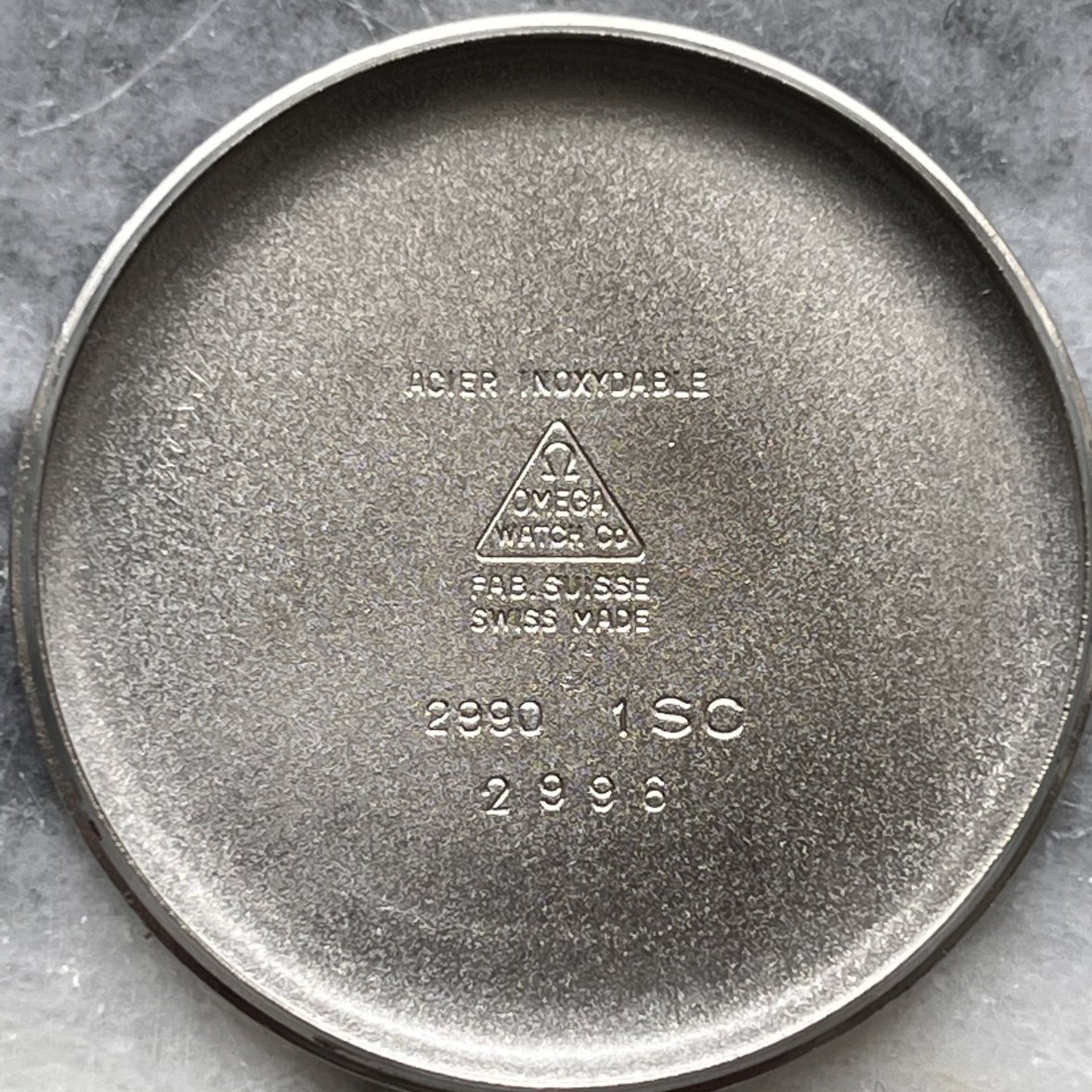

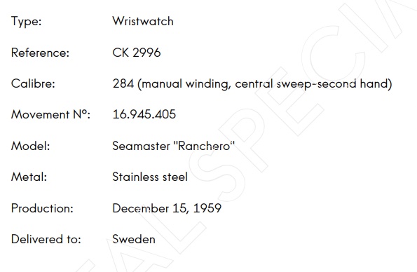

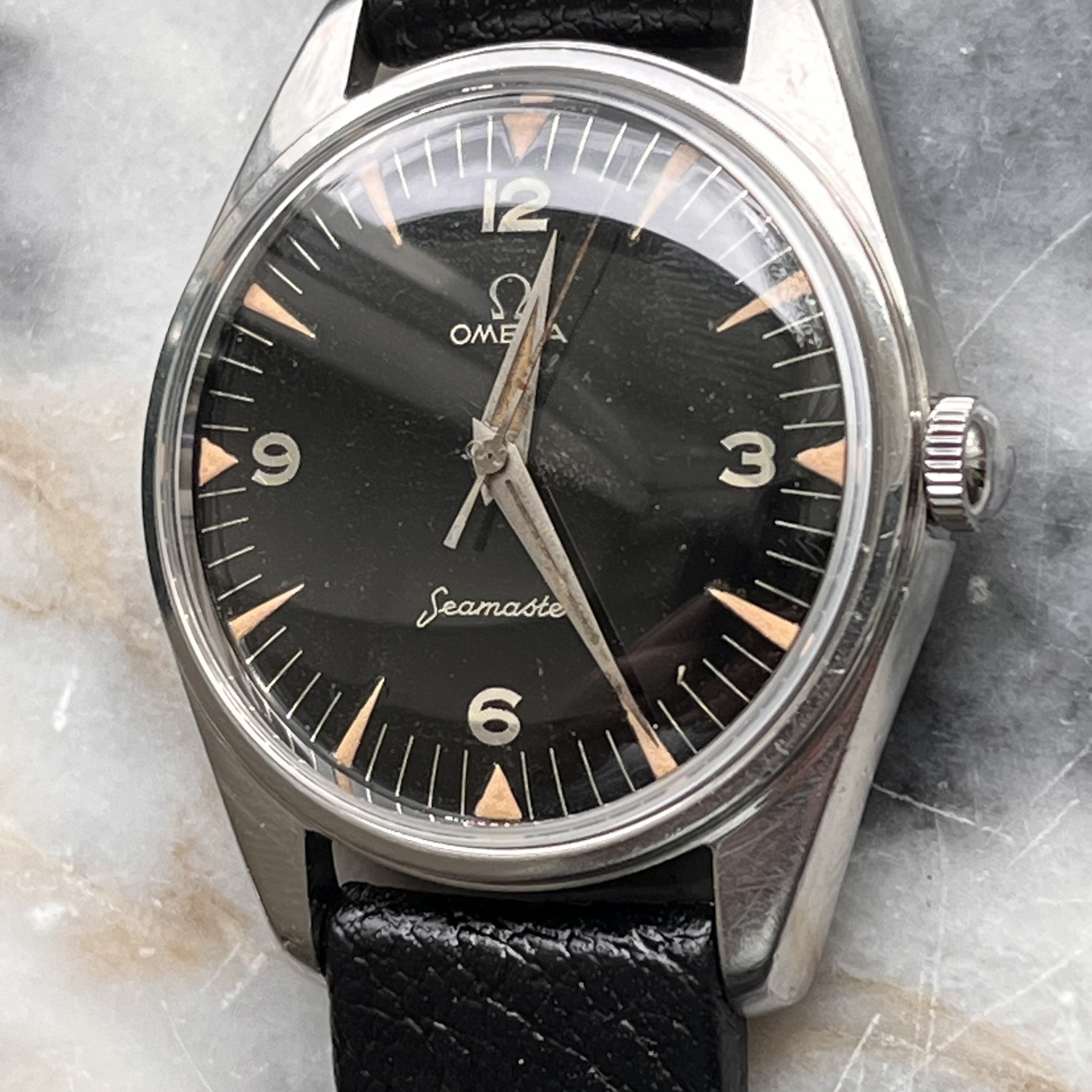

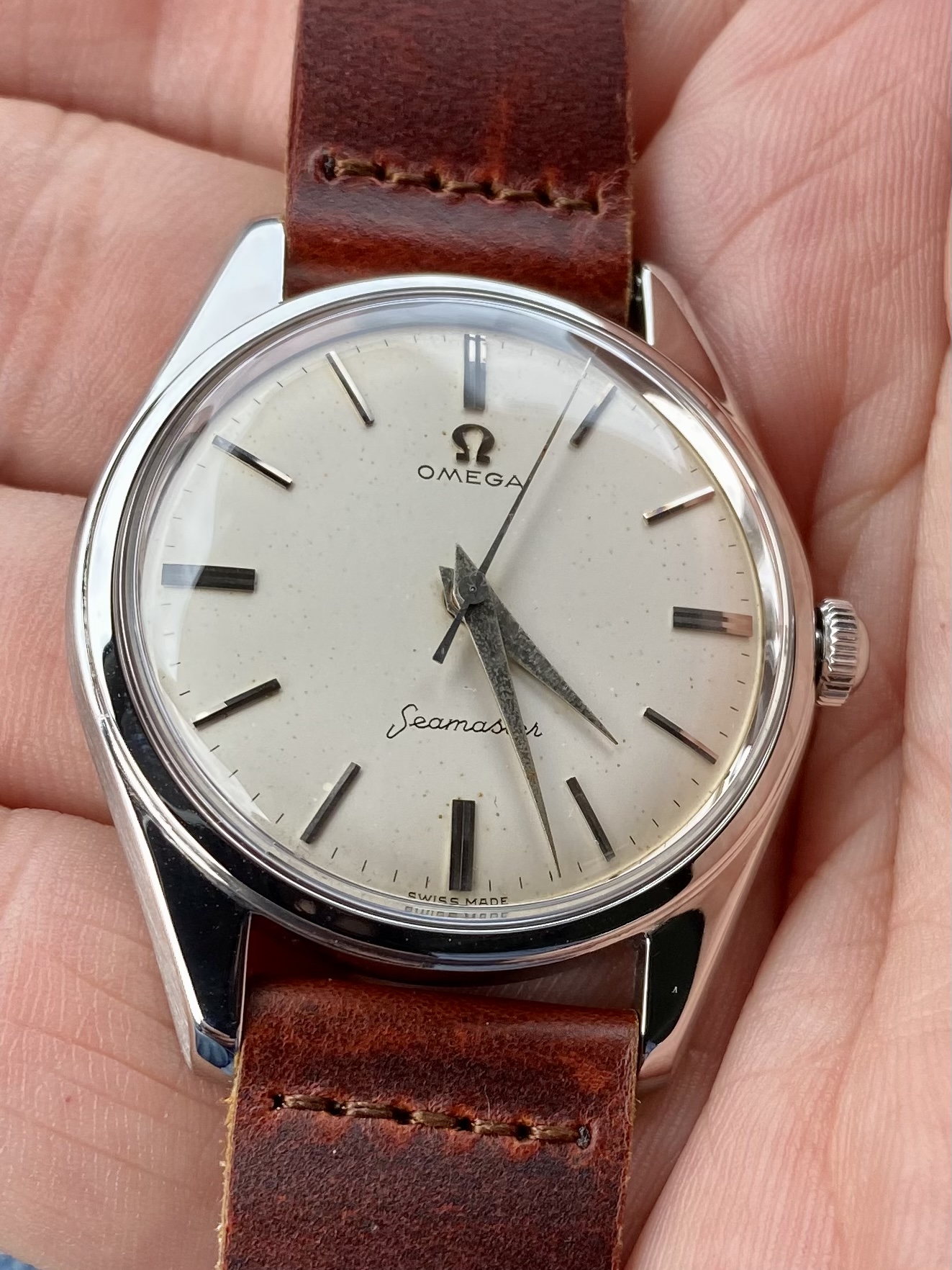

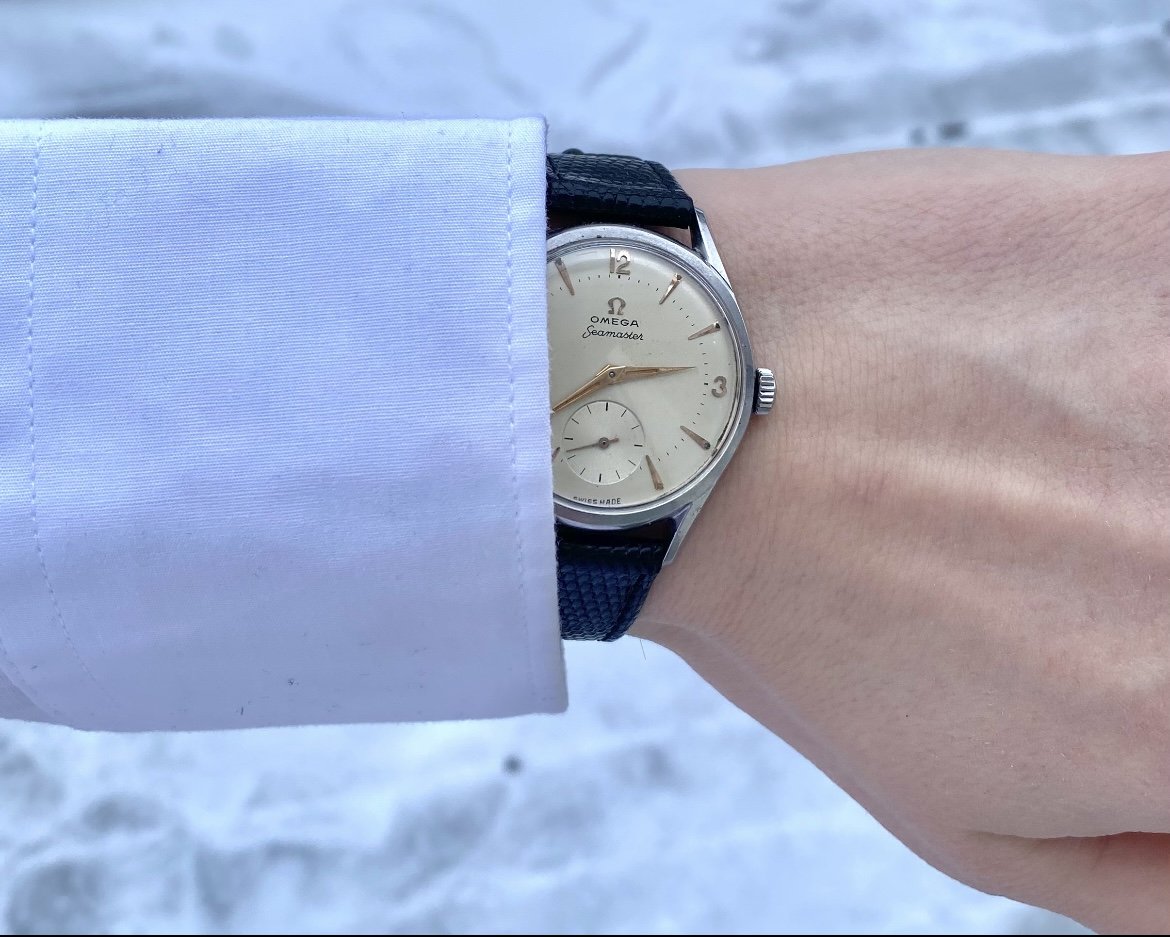

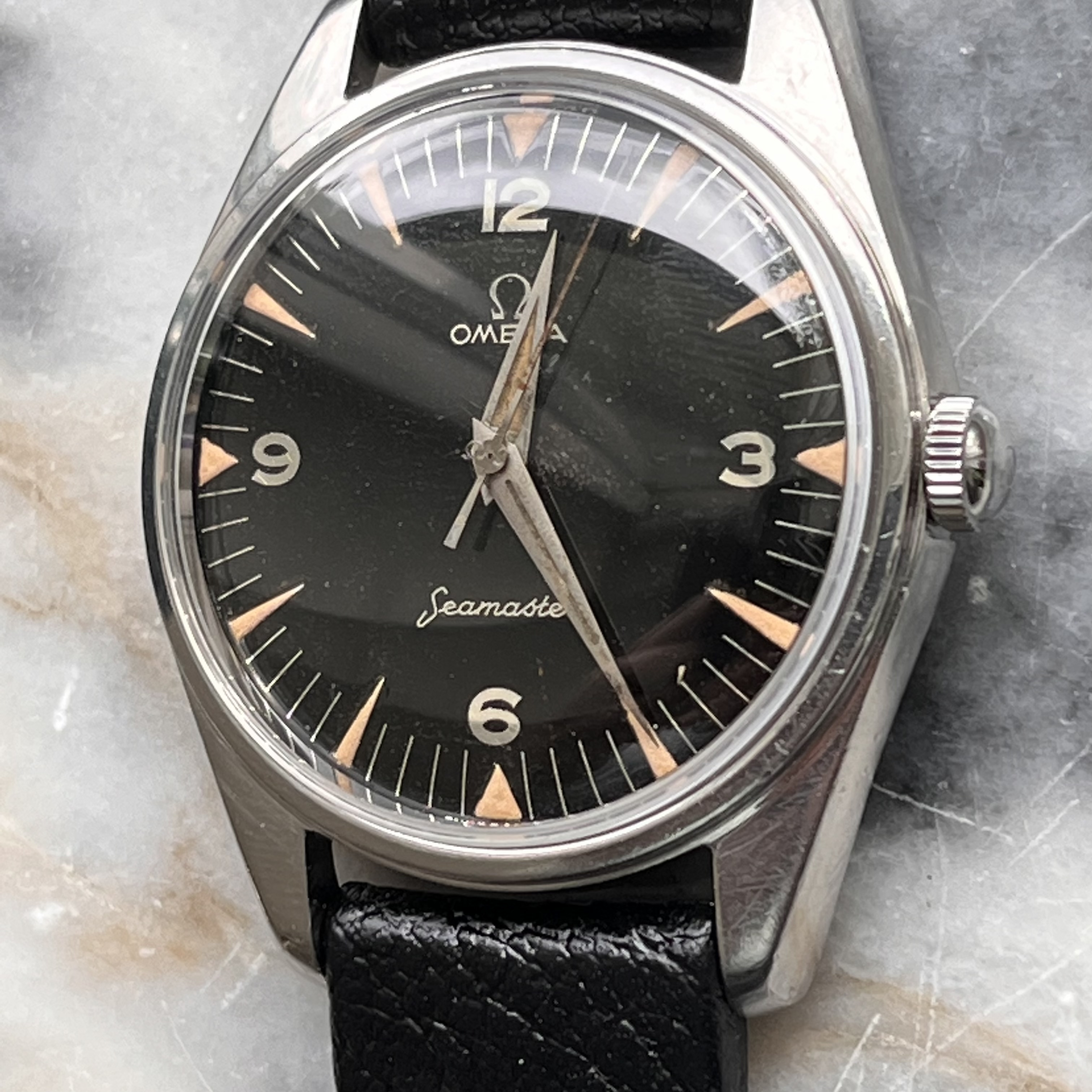

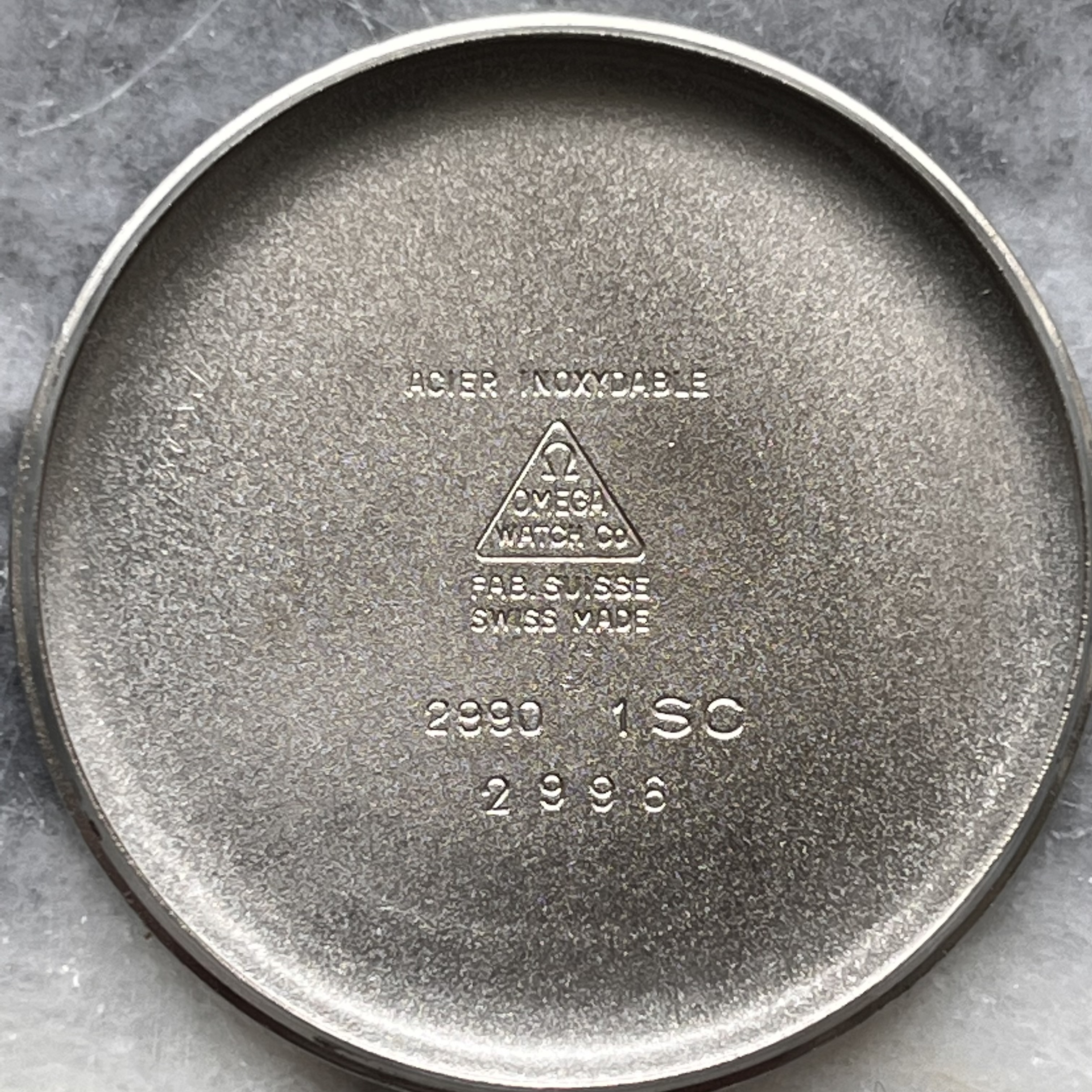

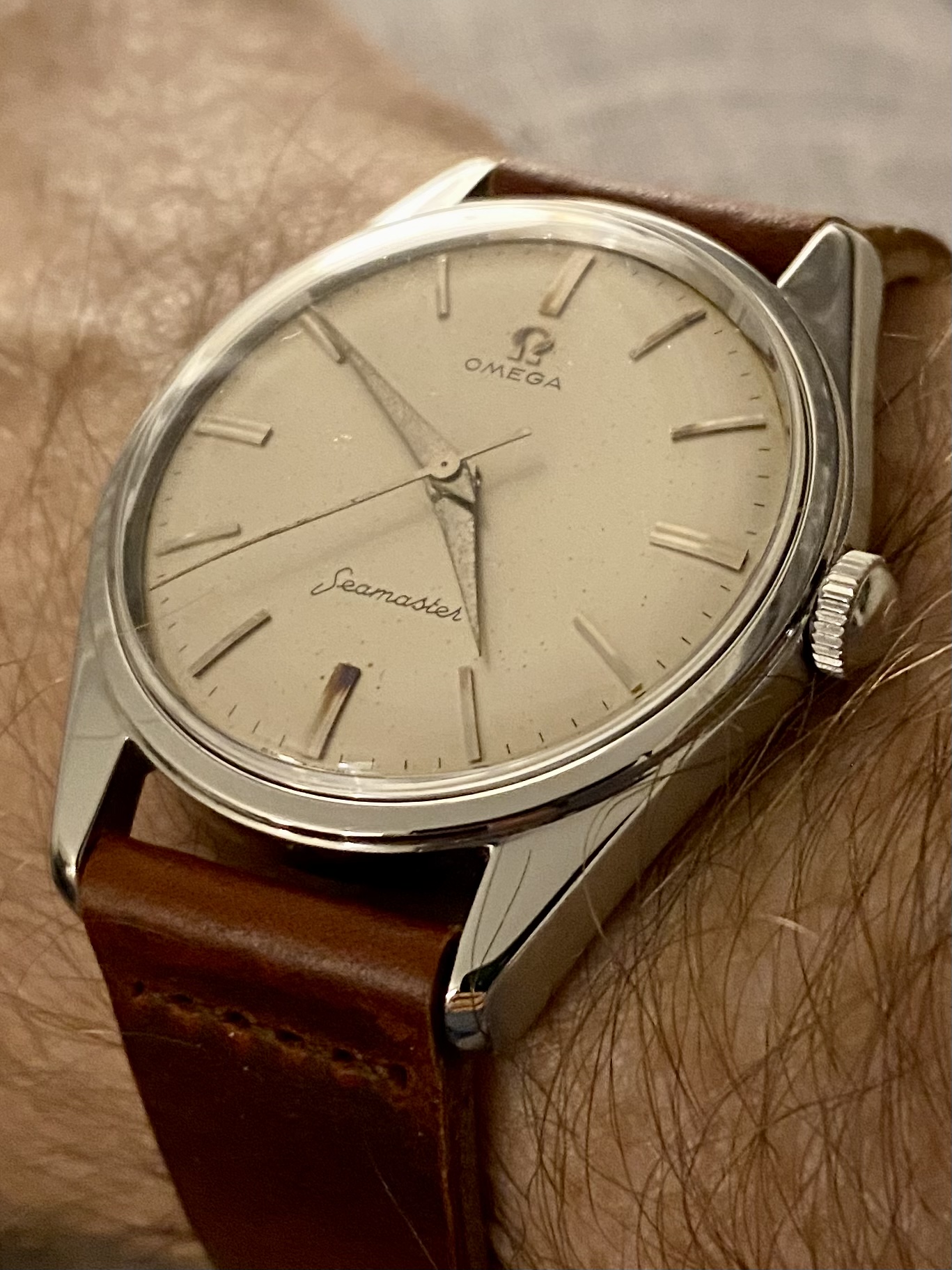

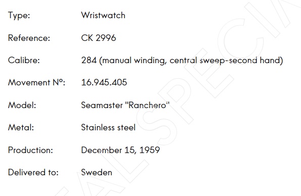

Wonderful thread! Here’s my double reference 2990-1SC / 2996 with a dial looking very much like a real Ranchero (or Railmaster), but with Seamaster on the dial. Actually closest visual matches are the few Pakistani Airforce (PAF labeled on both back and movemen) I have seen. These left Omega as Seamasters, but mine actually says Seamaster “Ranchero” on the extract that indicates production in 1959 and delivery to Sweden. I don’t think you can get much closer to an official Seachero;-)
10,129
57,973
Very handsome watch. Then there are the VERY few examples that have BOTH Ranchero and Seamaster on the dial. There is one up for sale on Chrono24 right now - for $13,000 or so - that looks authentic to me. I've only seen a couple of these, but apparently they are the real deal.

Thank you very much! Yes, those are very rare! If I have understood the lore, these were modified for the German market. I agree, with you that the one on CH24 looks like the real deal, but I would have liked an extract from the archive as well. At that price point, I think the SELLER should provide that!

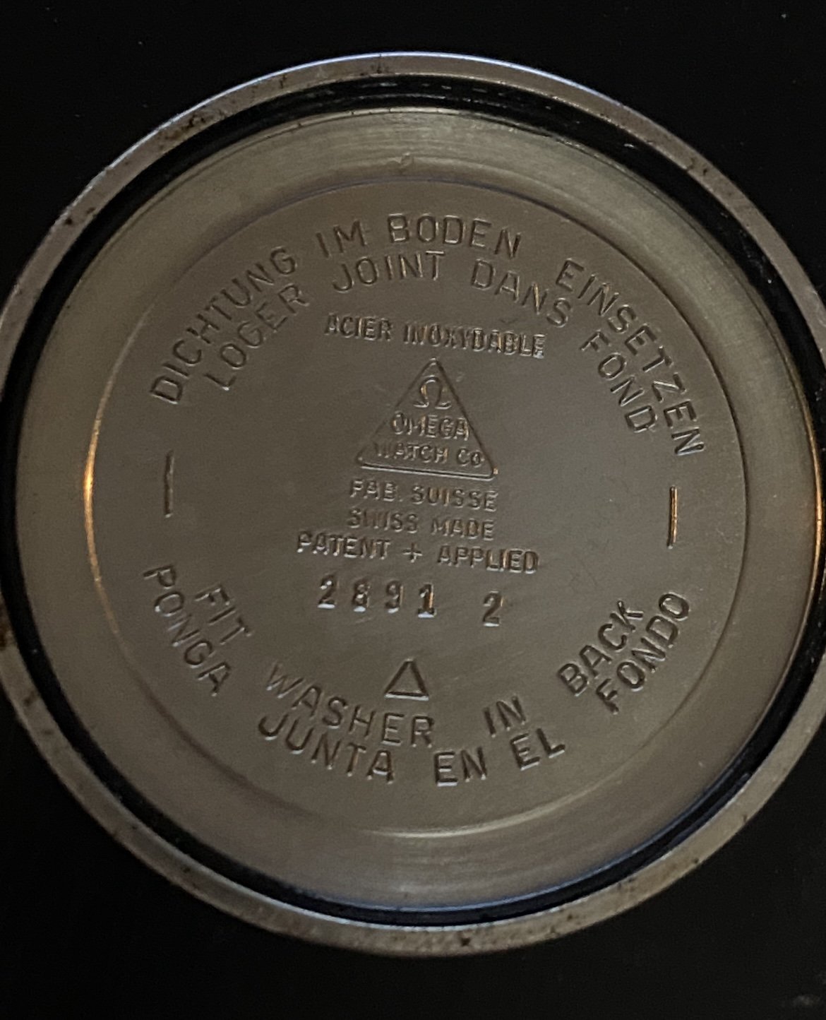

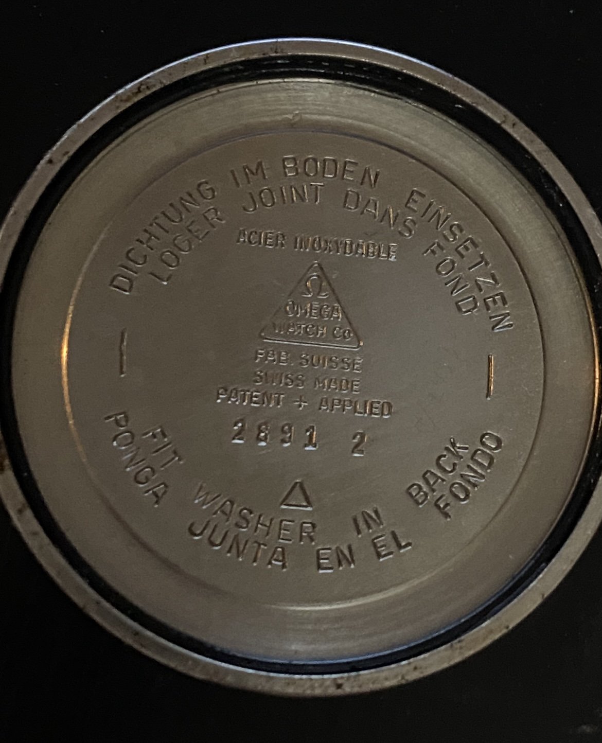

What about the 2891-1 and 2891-2 models? Are they Searcheros or what? Need help
Not to my knowledge. The only case reference other than the 2990/2996 that I've sometimes seen referred to as a Seachero is the 2937 and I personally have some doubts that it is properly classified as a Seachero.

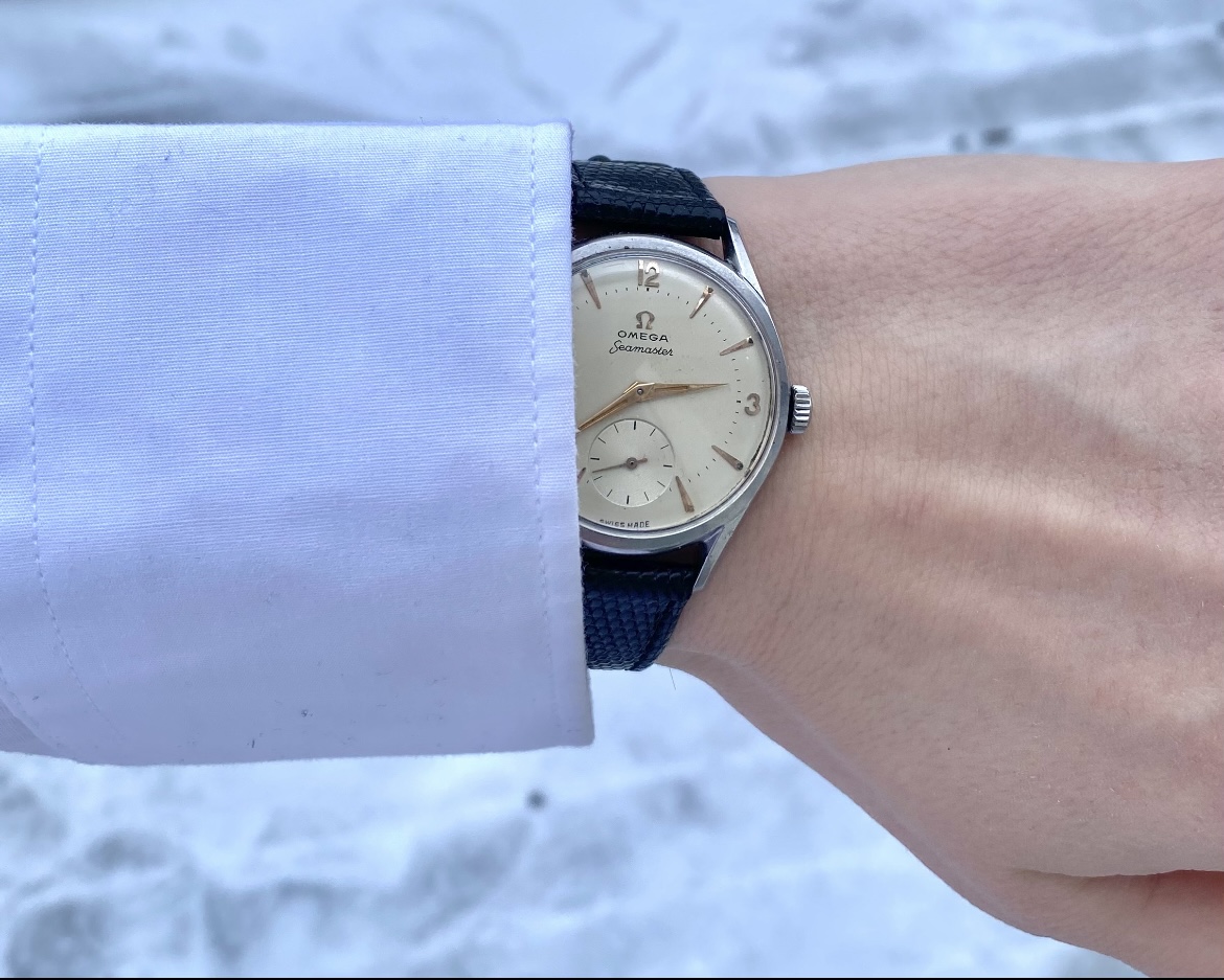

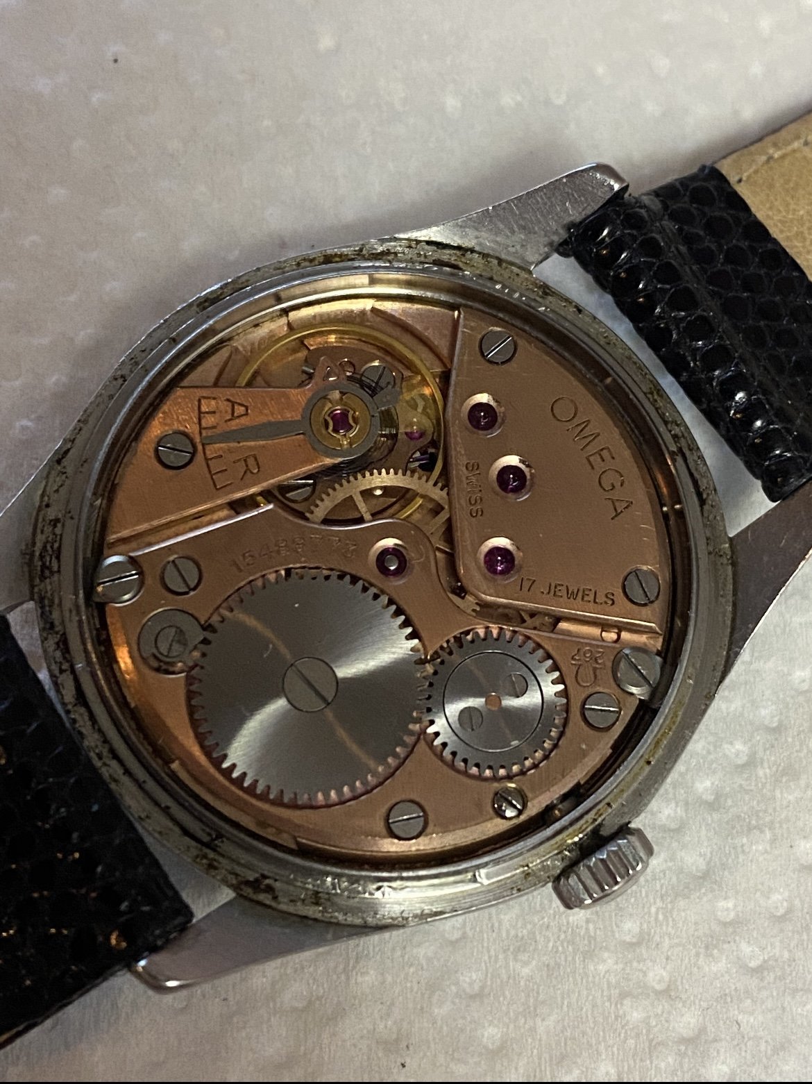

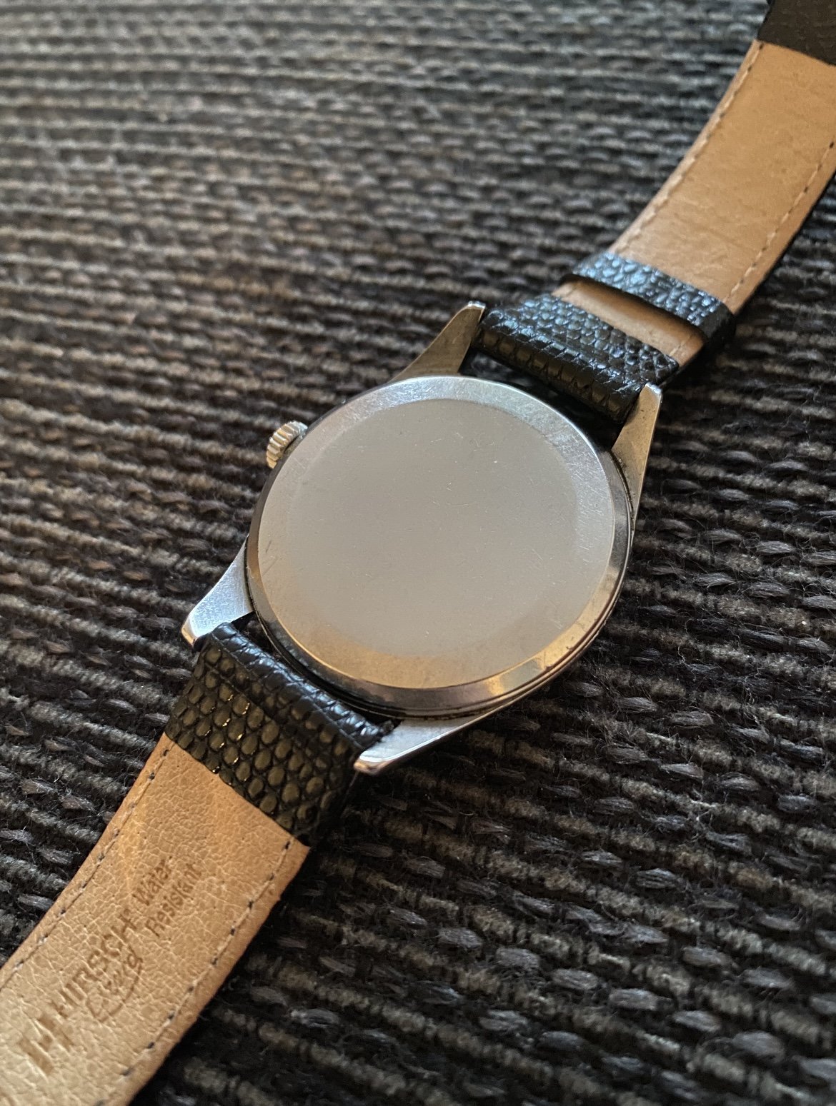

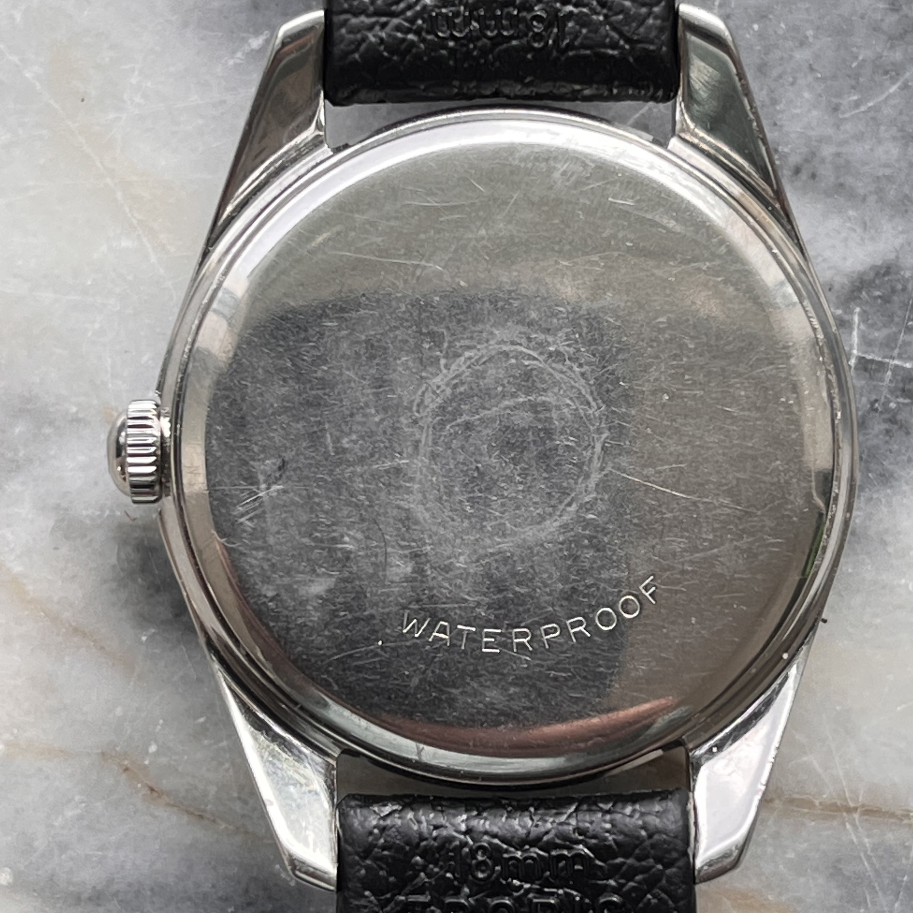

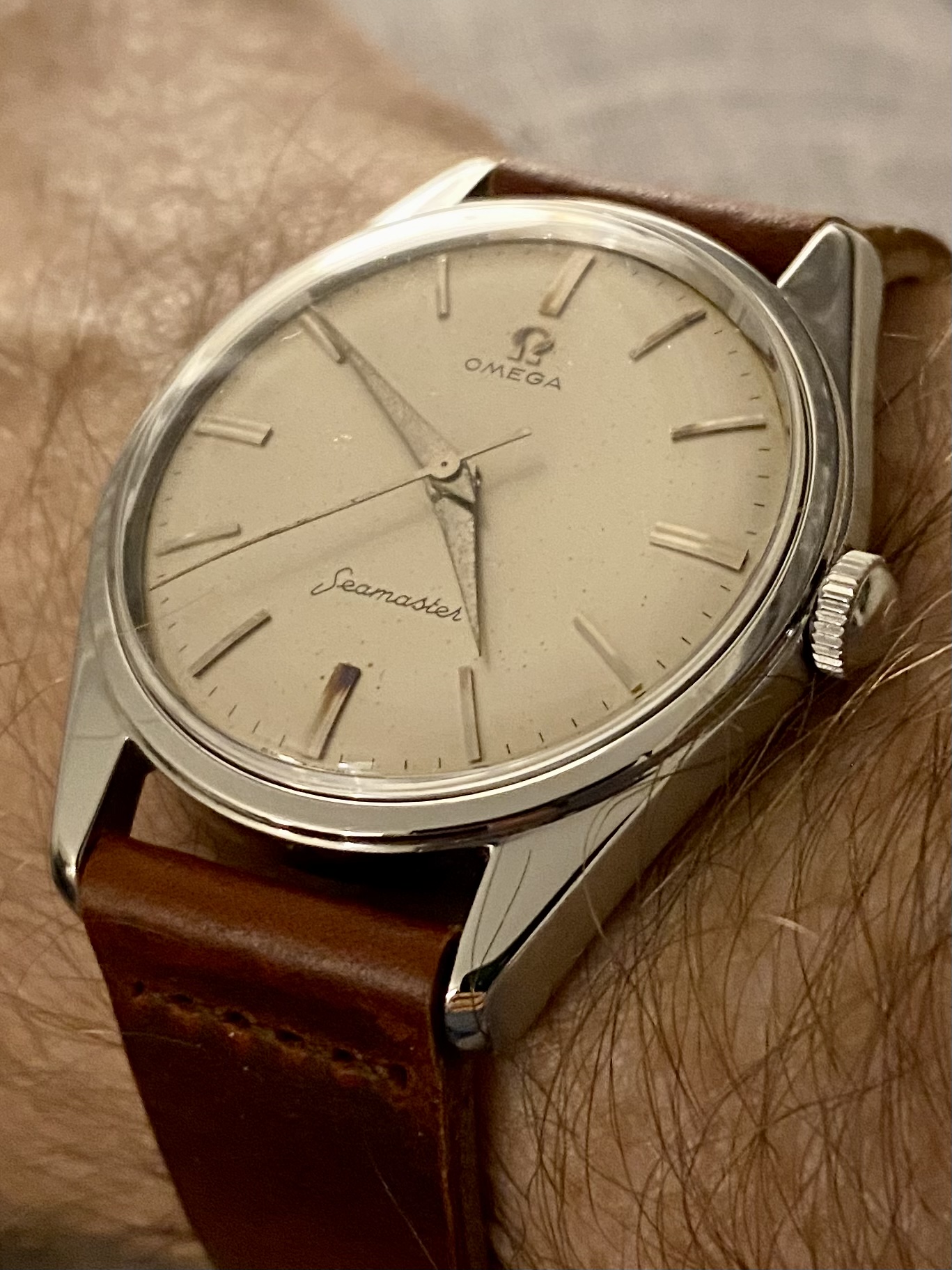

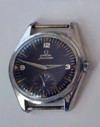

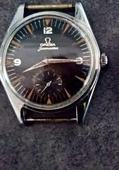

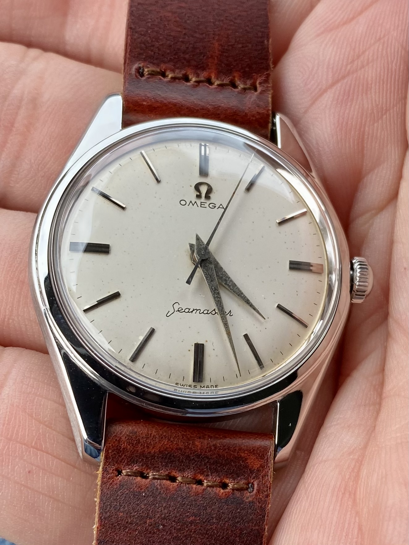

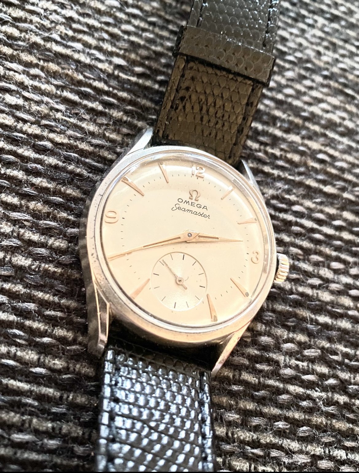

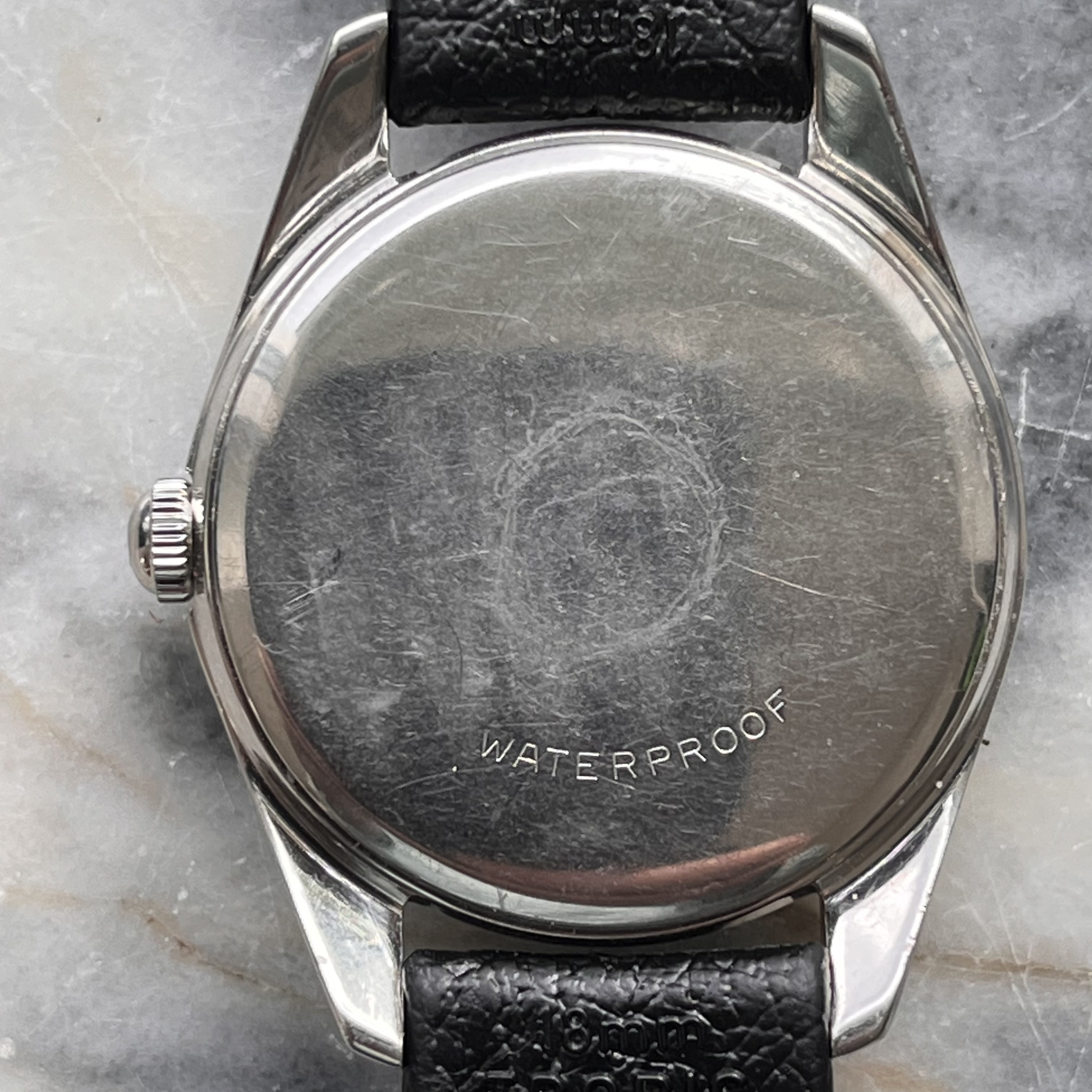

I pulled the trigger on this one. It’s the only two pictures I have so far, but on the back case it also have the ”Waterproof” text. Pretty confident it’s a 2990-1. Differing opinions? Oh, and location is Finland, of course.
22
57
Definitely 2990! Very nice!
10,129
57,973
Agreed that it’s a 2990 case. I would have to see much better photos to be sure, but I think that the dial may be refinished.
