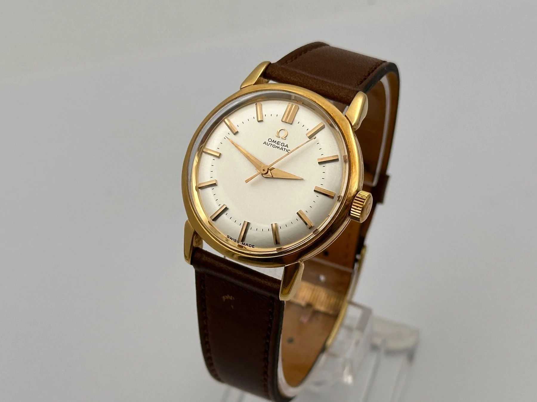

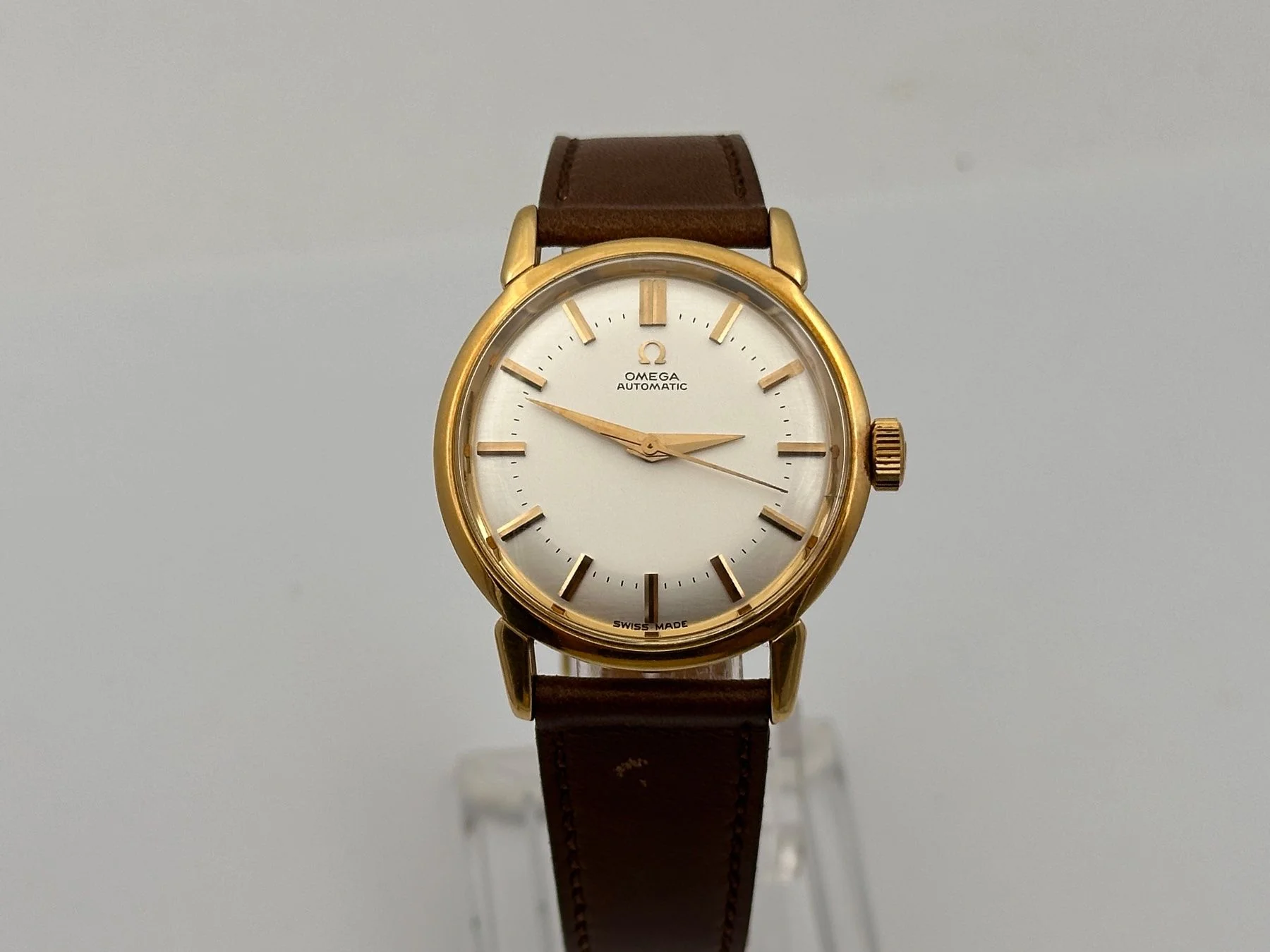

I have a doubt on this Seamaster 2866 from the 60s. What bugs me:
  • There is the Seamaster logo on the case back, but it's not written on the dial.
  • Absolutely no patina, no dots, it looks brand new...
  • There is something odd about the markers. They seem almost fake and when comparing with others 2866s, it was impossible to find markers similar to these.
I don't know if I'm oversuspicious or if it's an obvious redial, I have really no clue haha.

Best way to start judging vintage watches IMO is to compare a certain example with original condition ones.
It's not easy to find a 2866 in original condition as a reference, you even find 2866 case backs with and without Seamaster logo
A 16 million serial number dates the watch roughly to 1958
IMO it's pretty obvious that the dial was redone, the markers also look off but you often have different dial variations for one reference

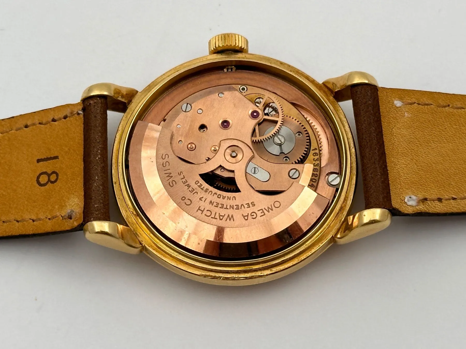

Two things about the movement: 501 (usually this number is visiable) should have 19/20 juwels, on the rotor there is a 17
The part where the number is engraved has a very different color than the rest of the movement so maybe it was put together from different parts

The word 'automatic' looks weird to me.

The 500 is basically an identical movement, except with 17 jewels, and there is a ton of parts availability between 490, 491, and 500->505. Of those, 490 (sub-second version), 500, and 502(plus date version) are 17 jewels. SO I wouldn't be surprised at all if a watchmaker figured it didn't matter and took parts from a 490, 500, or 502.
