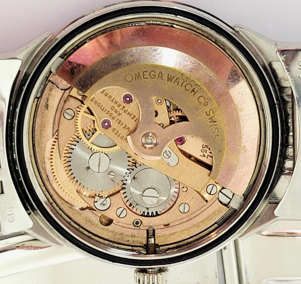

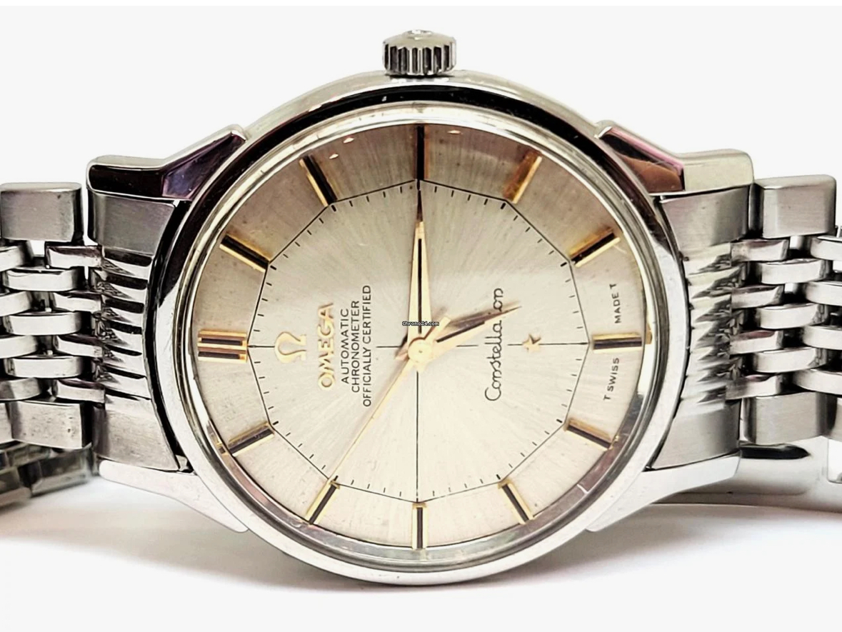

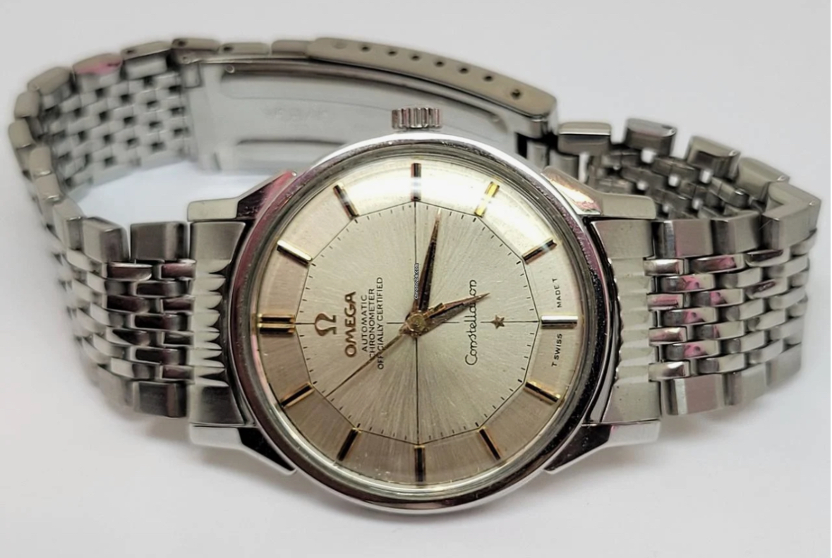

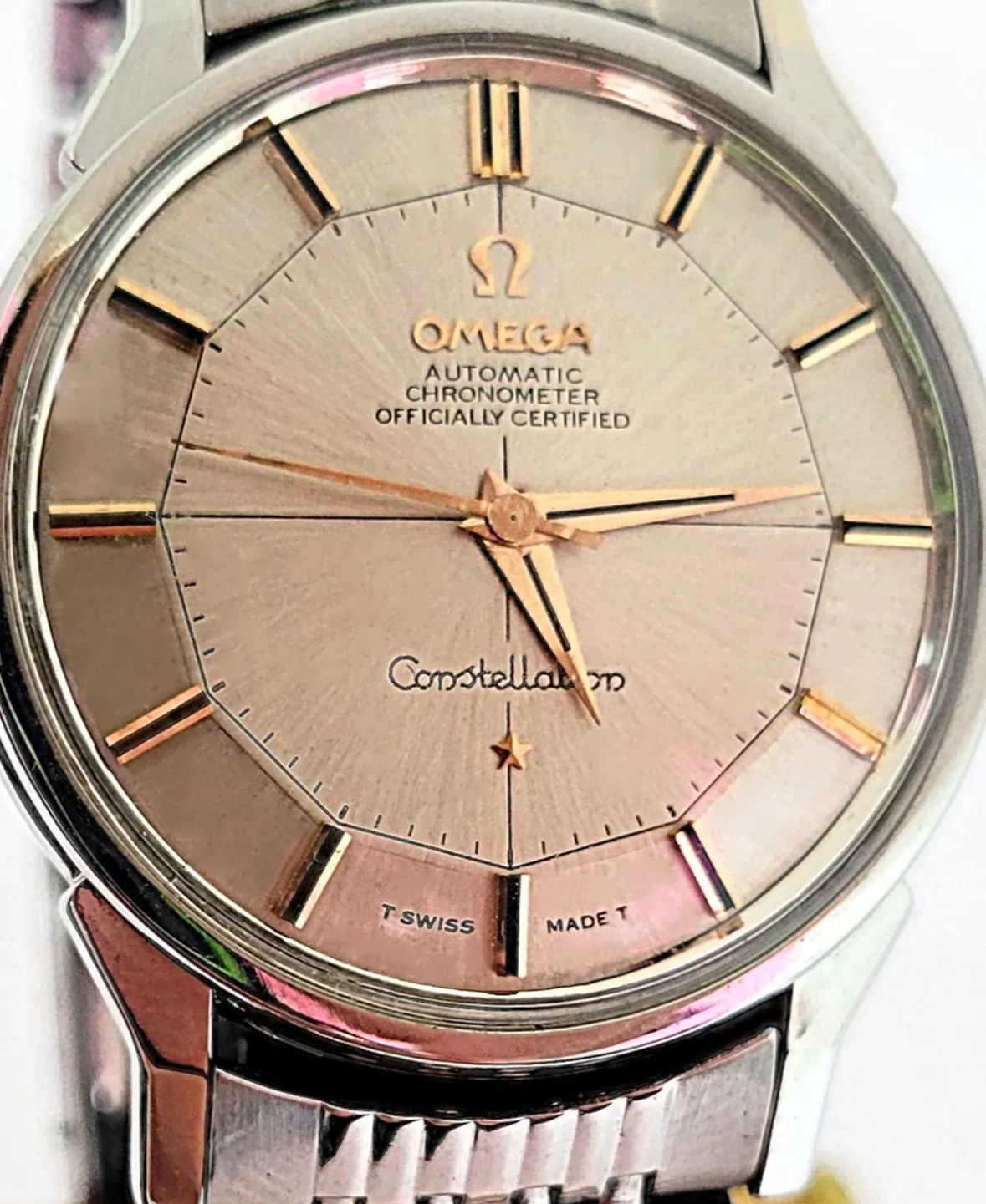

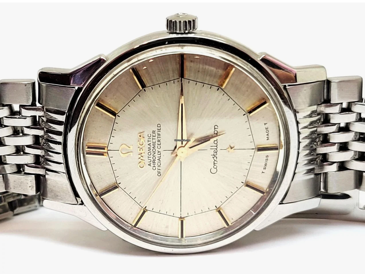

Hi everyone, I have been reading about pie-pan constellations for a while and would benefit from your insights.
Do you think the one below is a redial or not?
MOY checks out.
I have also read unmatched ‘M’s (Automatic and chronometer) is OK, but I have only seen this with ‘chronometre’ - not ‘chronometer’.
Swiss made has double Ts.
Crosshairs is the one thing I have never seen this way (the vertical one doesn’t cross through the omega logo and other words there), and also the black perimeter line that goes from hour marker to hour marker.
Thanks for the insights!
13,738
53,611
Yikes ! Walk away.
