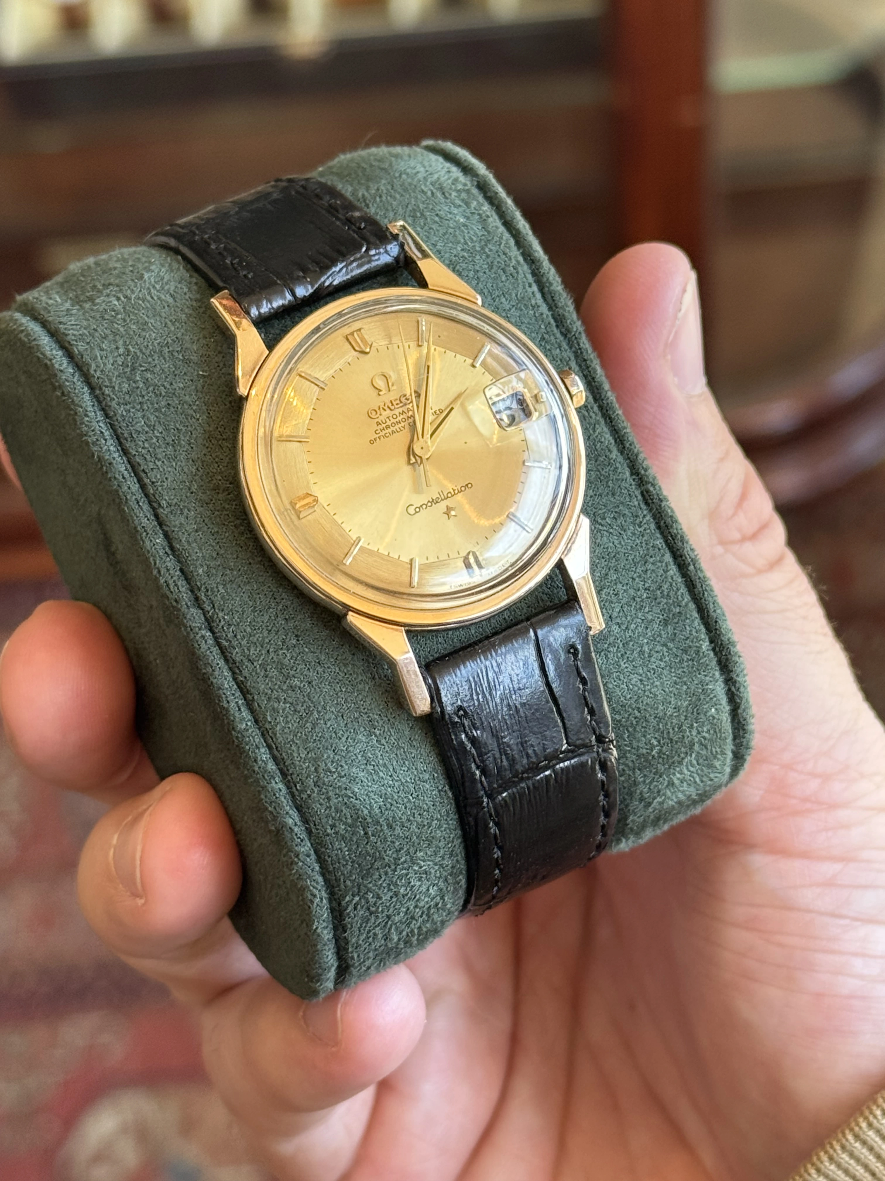

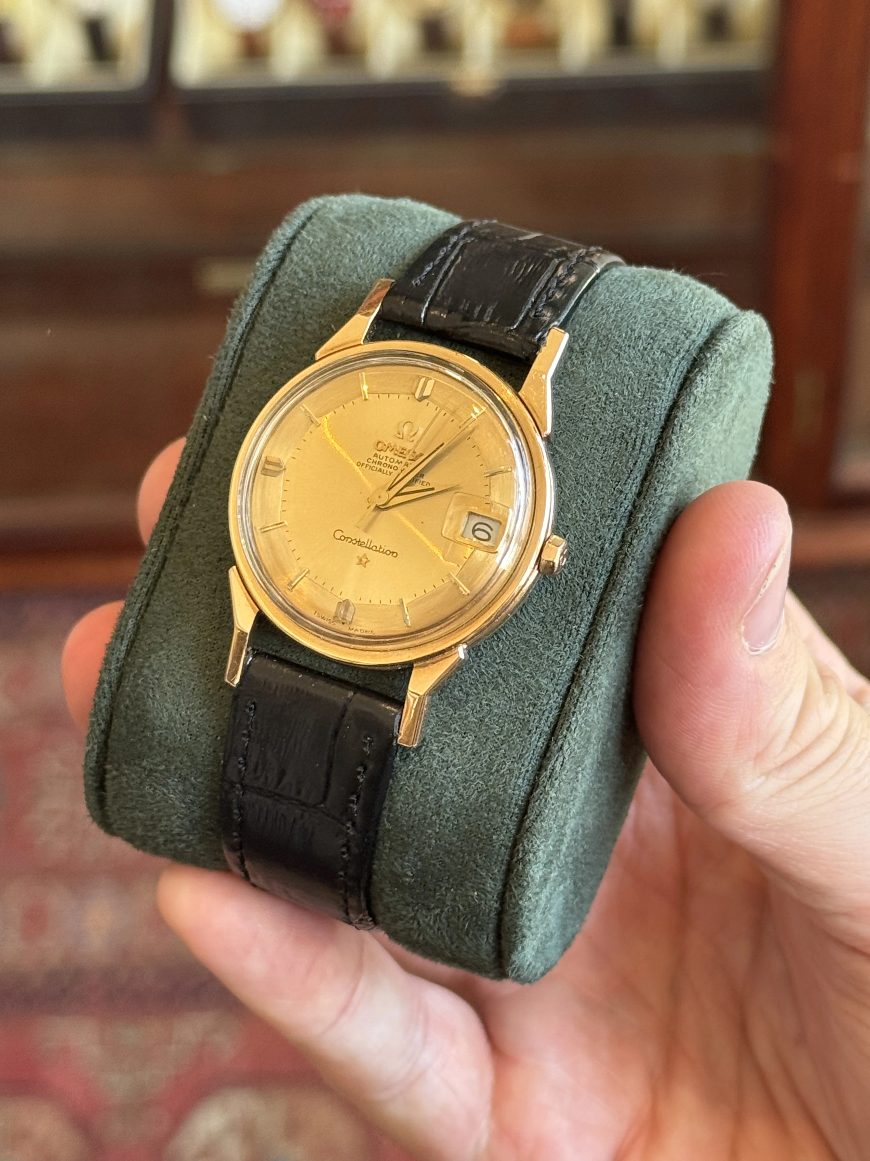

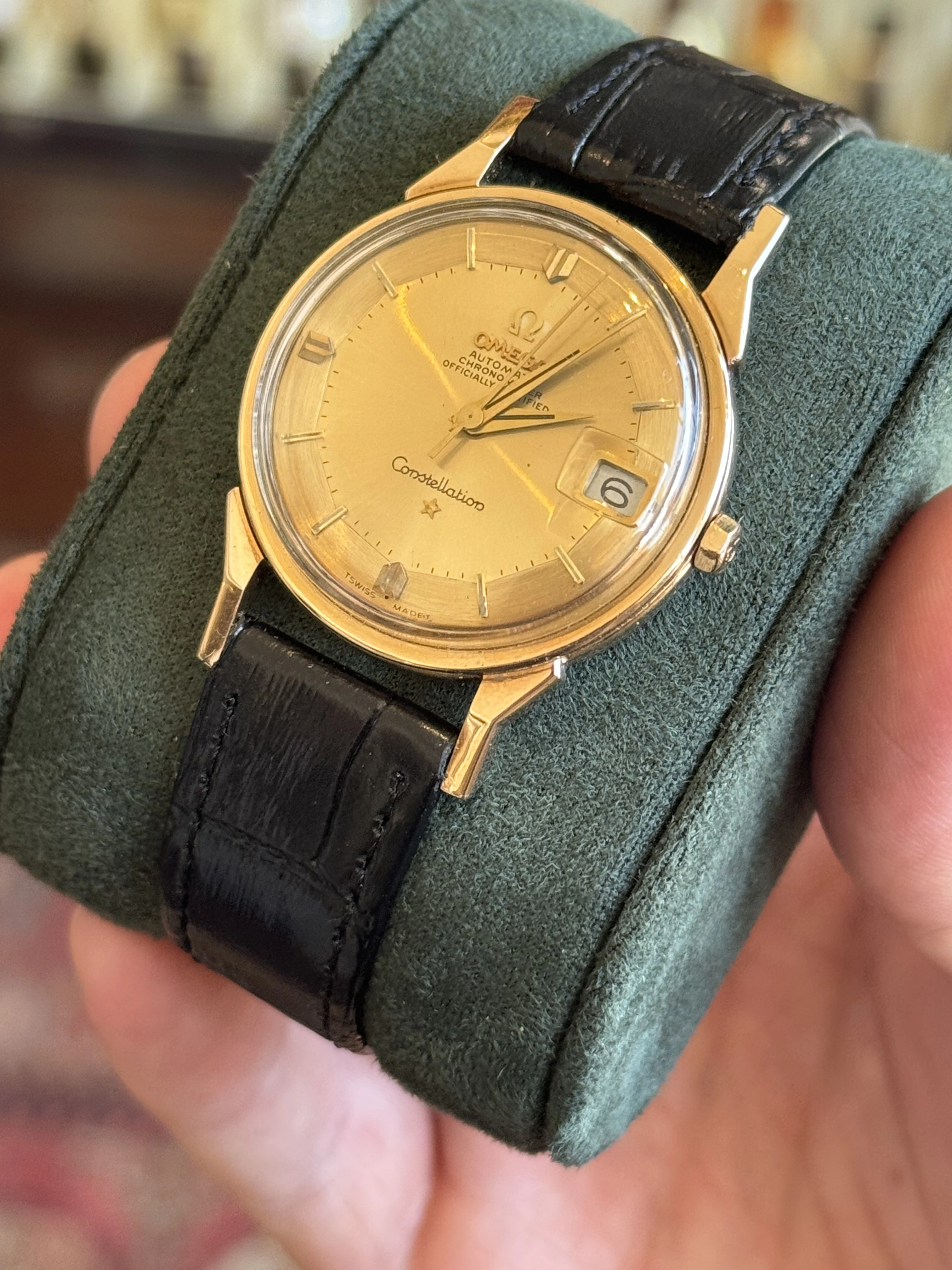

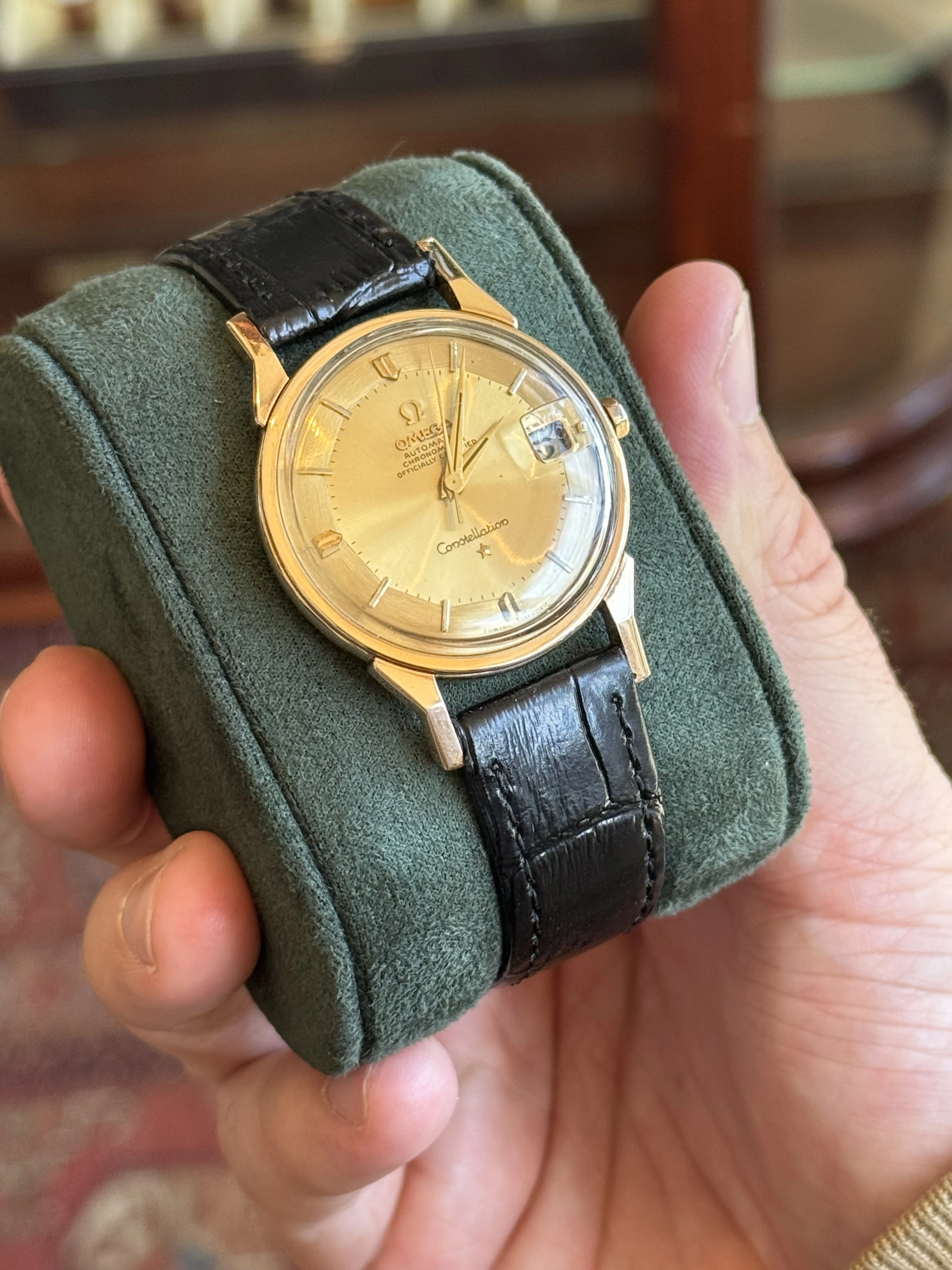

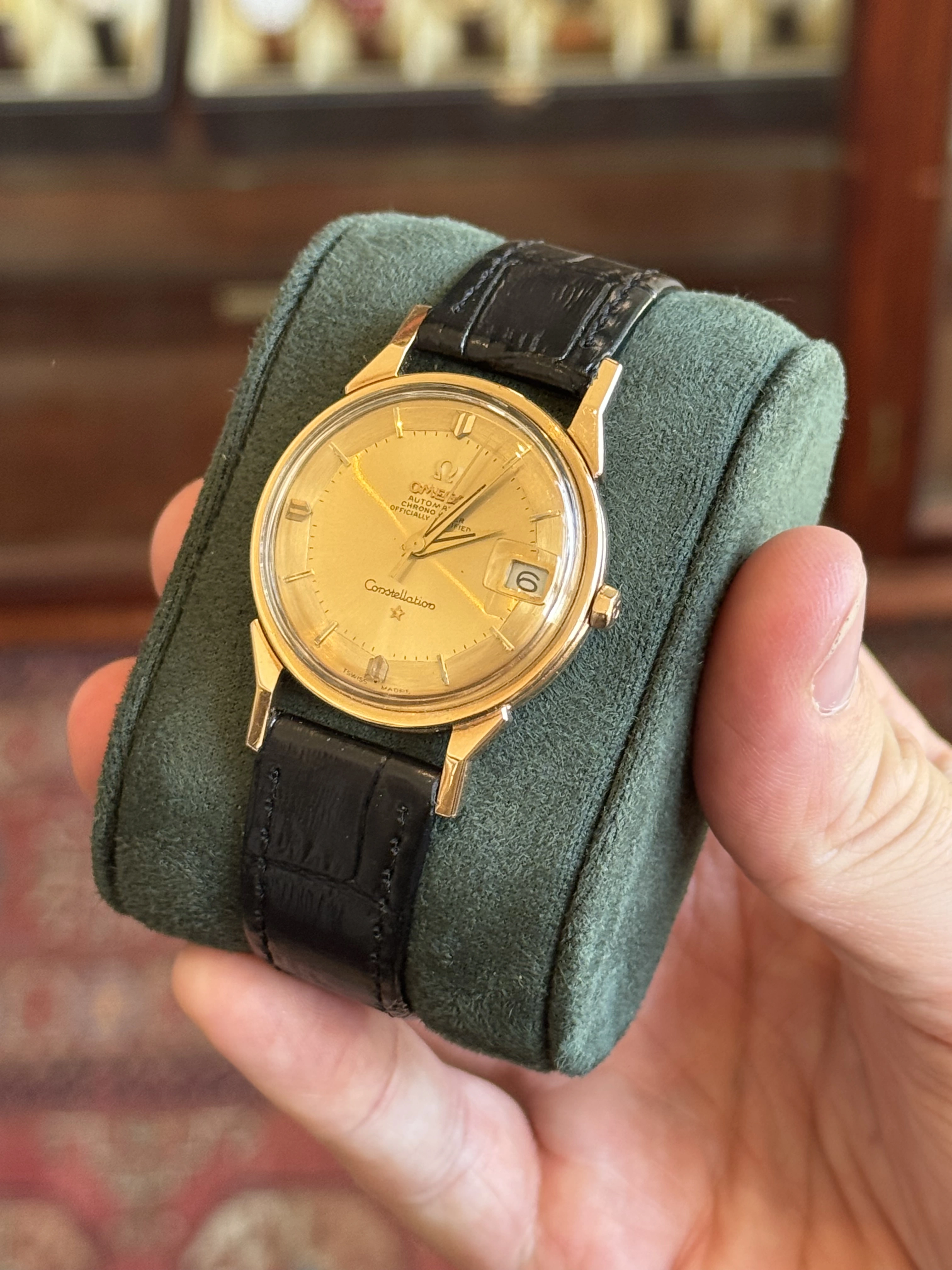

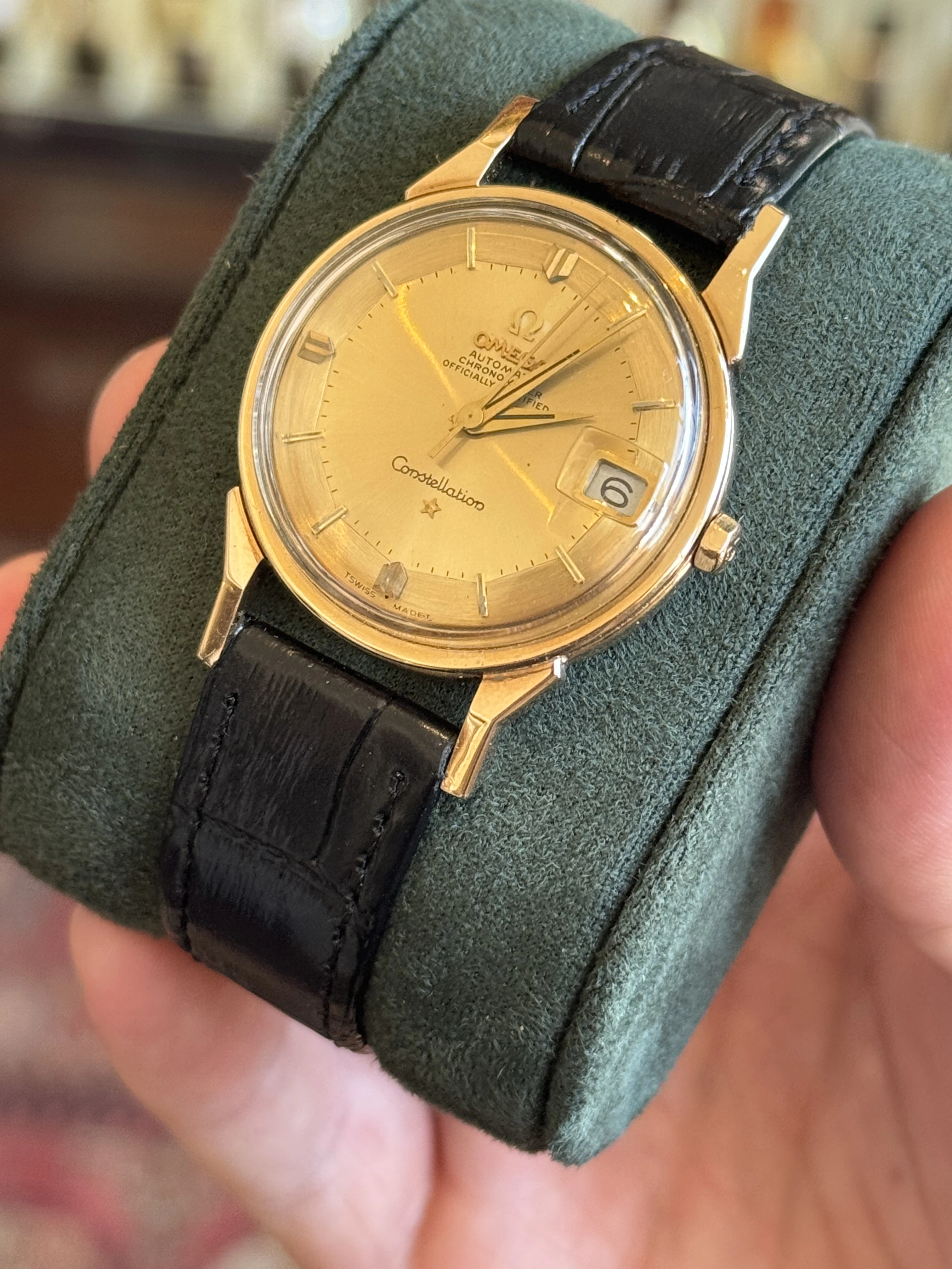

Hi All,
Got a friend asking me about this one, it’s being sold by a supposed reputable dealer. Rose gold pie pan. Told it’s early 70s very last of the pie pan models apparently.
To me it looks like a complete and pretty poor redial. Never seen a model with a dial like this. Says it’s a lume dial but I can’t see any lume plots etc.
Your opinions would be appreciated however.
Thanks! 😀
3,166
6,908

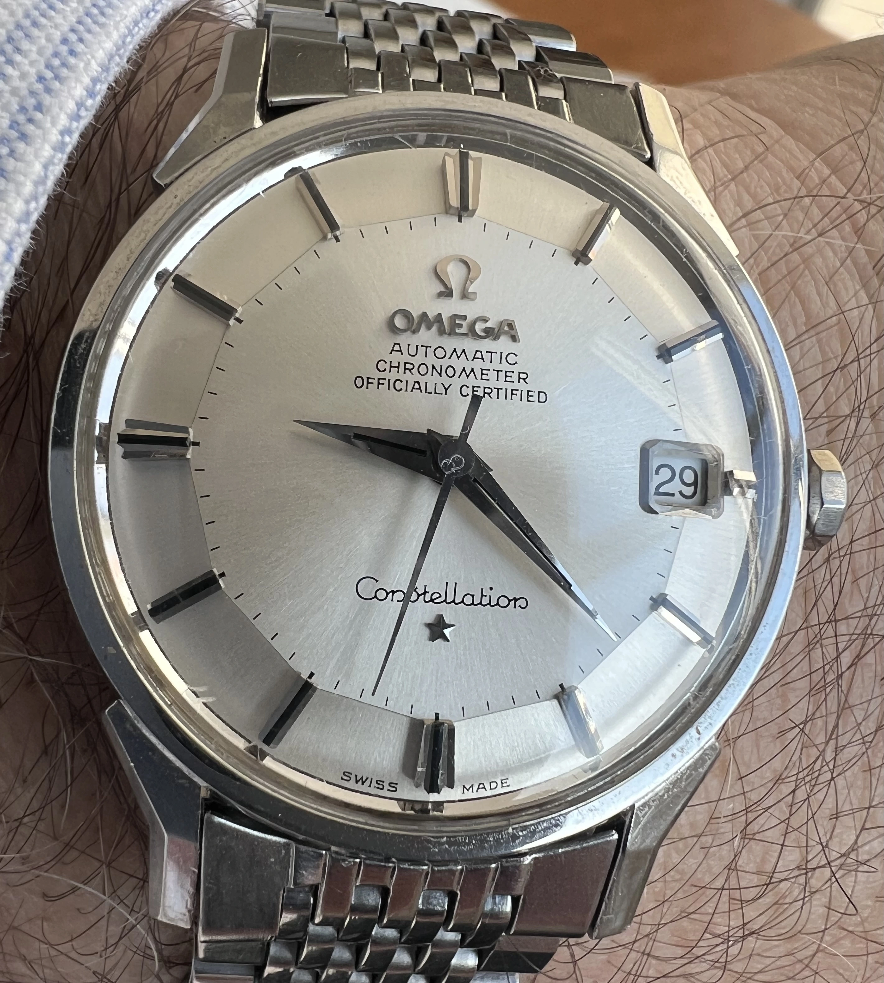

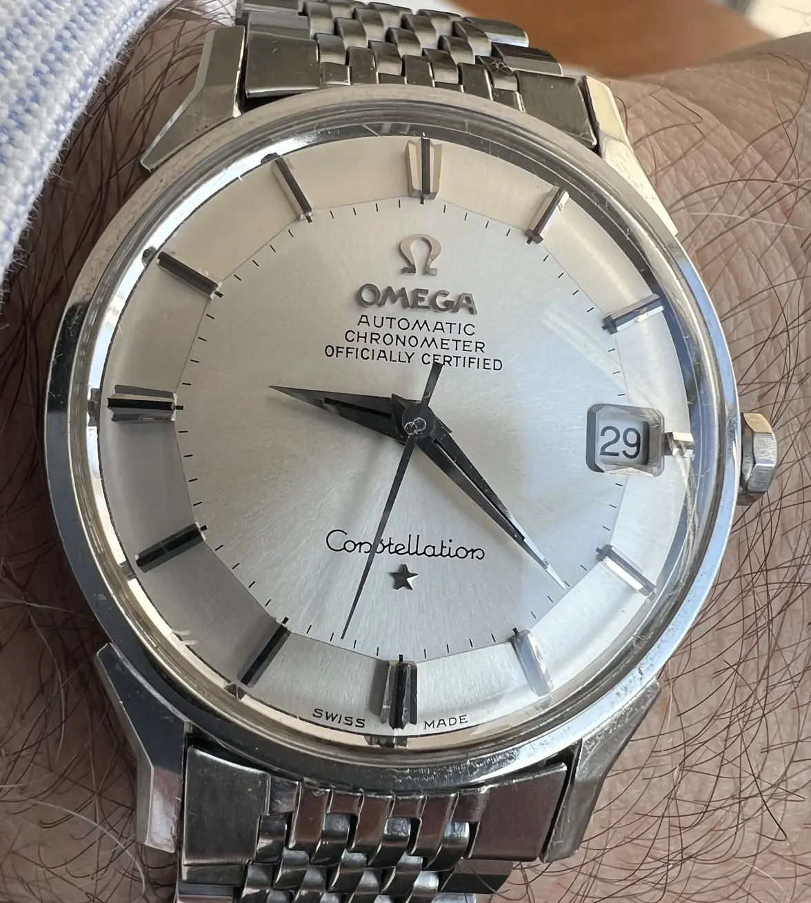

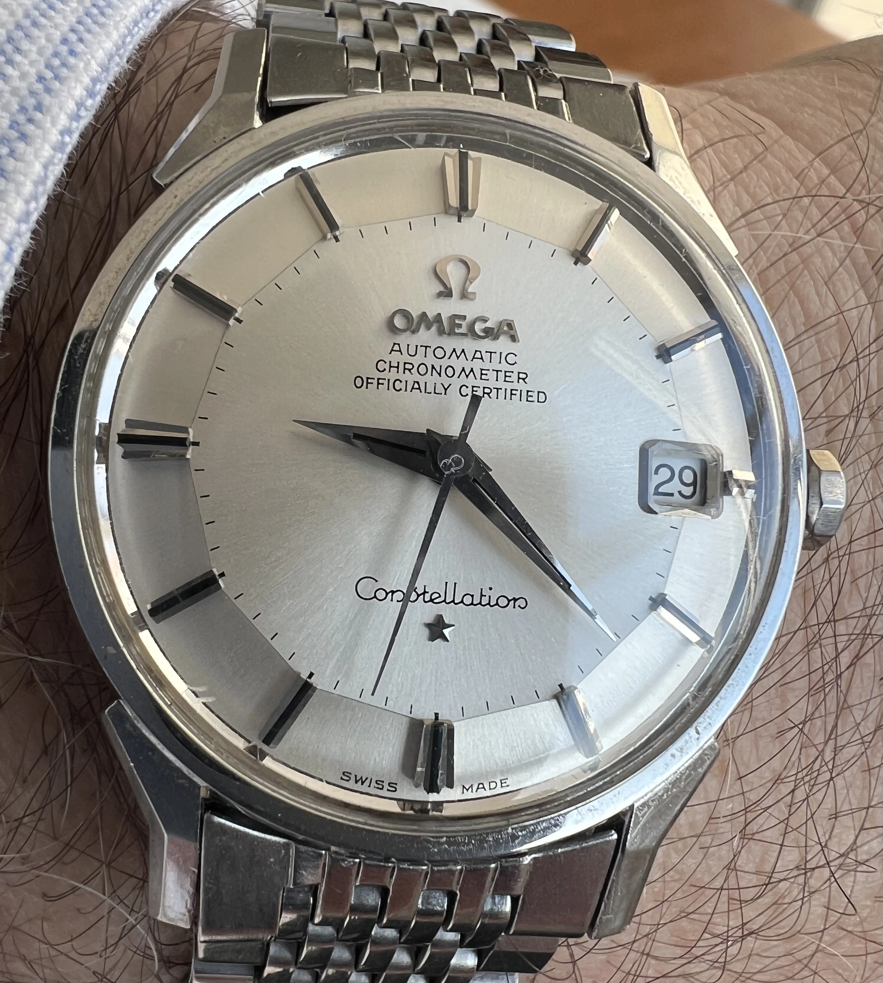

The hour markers should not protrude beyond the line between outer and inner dial
So this is redial for this and other reasons (font)
See how should look below
