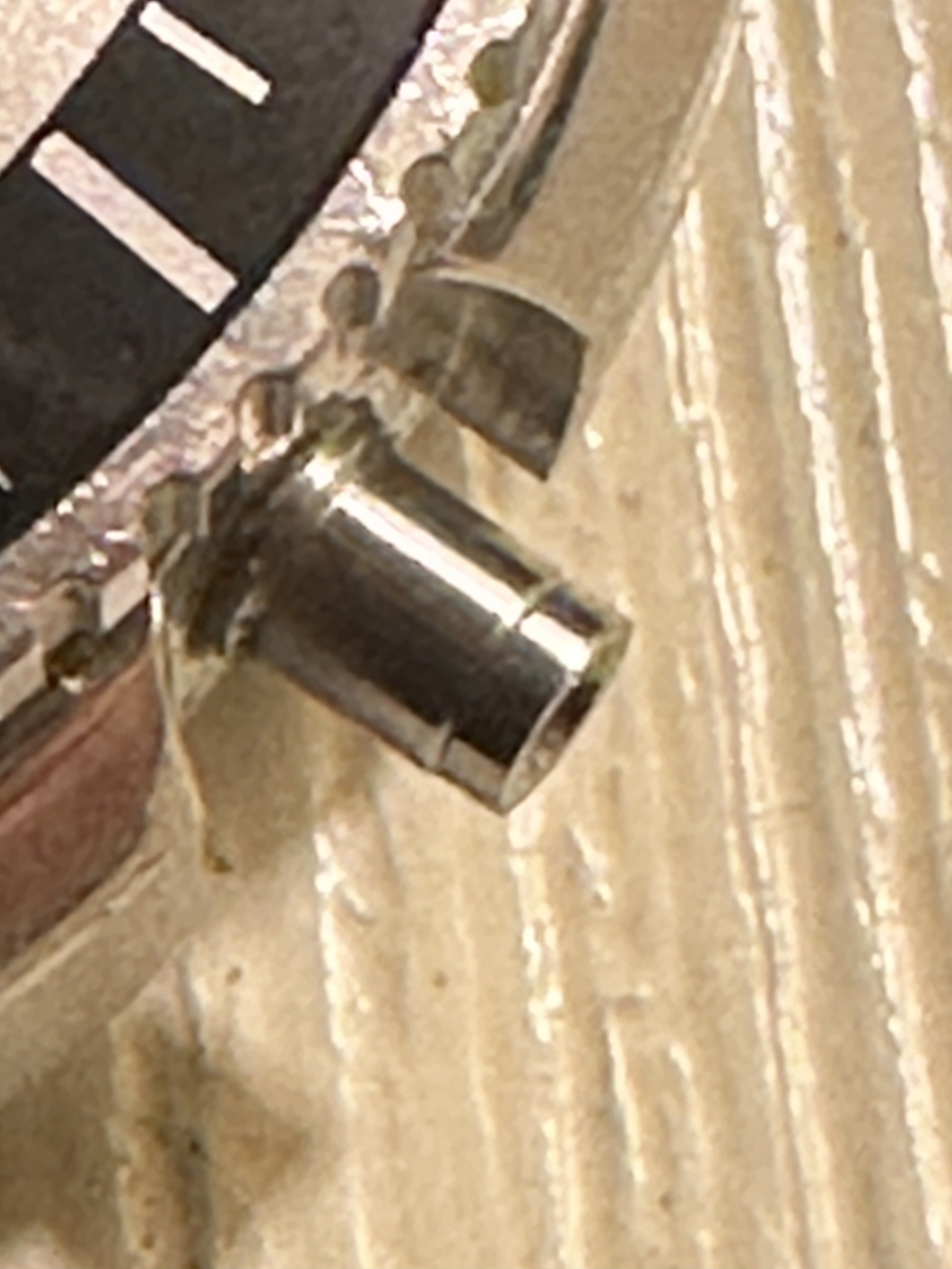

Also, can anyone explain what the piece is here connect to the tube, there is a separation there and it looks to be possibly the screw down part of the crown that fell off.
Archer who is an Omega authorised watchmaker already explained that above. You’d do worse than send it to him, but he’s not quite in your part of North America it must be said. Nesbitts are closer it’s true.

Good eye, I purchased a new crown and stem from SLE. I honestly want to make the repair myself, the movement and time keeping was great I don’t feel it needs a full service and I would save money and time away from my watch but I’m not sure yet what I’m going to do. Applying the crown to the stem with loctite doesn’t look very difficult and the stem is already cut the fit the case.
I don’t have anything to lose if the parts won’t be used anyways I might as well make my own attempt and then send it in if all else fails.
You will need to be careful unscrewing what remains of the crown from the case tube - if you damage the tube, it will need replacing, and that is not a DIY job for someone with little experience.
The stem is already cut to fit the case and crown - as I've already mentioned in my previous post, often the depth of the threads in the crown will vary enough that the existing stem may be too short, so it's a good idea to have a spare on hand, just in case.

Update***
I went to a local repair shop, guy was super knowledgeable with Omegas and told me the original stem was still in good condition, just the crown fell off. He used the original stem and told me to keep the spare uncut stem in case it’s needed later. He salvaged the part for me and did the repair for next to nothing. Timegrapher was great too. Told me I would have wasted money and time sending it to Omega.

Update***
A good outcome all round! Just be careful about water resistance. It may have none.
