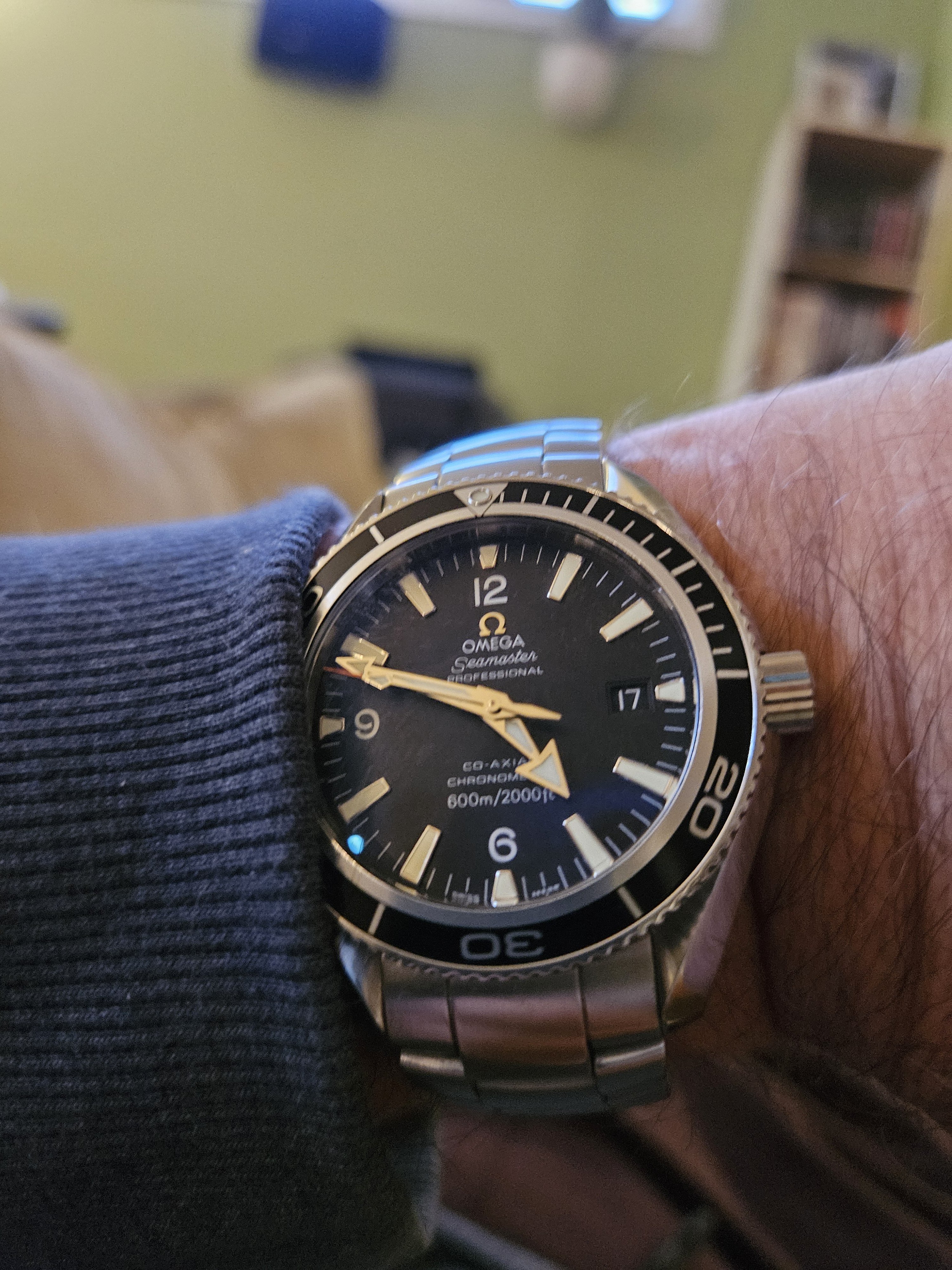

My crown fell off and I’m not sure where or how, but it’s gone. I ordered a OEM replacement from Swiss Limited Editions website in the UK. I believe I have the capability to make the repair myself, using LocTite. It doesn’t appear the stem or tube are damaged, the only issue is the crown was screwed tight when the crown came loose, so I’m not sure how I’m going to unscrew the stem properly before removing it and reapplying the new crown. Does anyone have any advice? I want to avoid the OB if I can.

Crown is locked with locktite on the stem. Apply some heat to the stem Spiritus burner, candle. Do not use a lighter or the kitchen stove, this will heat the stem to much and take away the hardness of the stem. 150 degrees celsius should do it.
Use locktite again when securing the new crown on the stem.
Last word of caution: the stem has to be removed from the movement in the winding position.

The crown has failed. The inner portion of the crown has been separated from the cap. It will need a new crown to ensure this doesn’t happen again. Having a new stem on hand is a good idea, as the threading in the crowns can vary enough that a stem may end up too short to use again.
