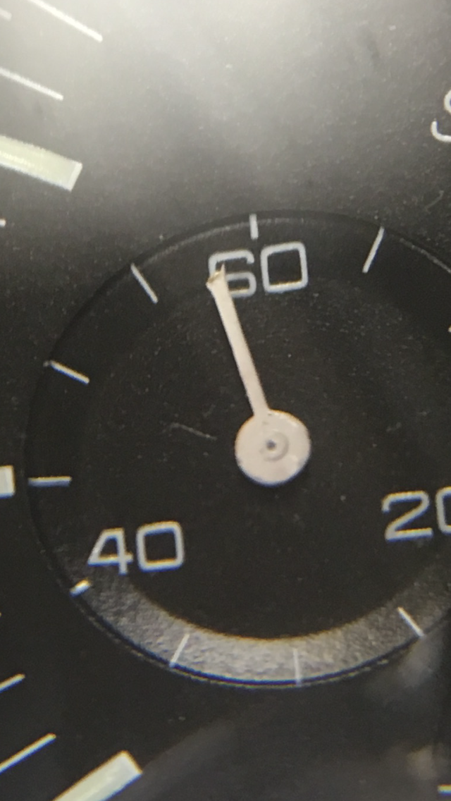

Al: Are there any US based folks who are less expensive? Just to give you an idea what I've been through, I took the watch to a local guy who said he could "match' the part. Take a look at what he did to my watch; not sure where he got that POS hand. There are also large bits of dust on the face now, too.

So he found a generic sub-dial hand and snipped the end off to fit - top notch watchmaking! 🙄

Perhaps he meant 066TP3922 and not 066PP3922? I believe the same hand but for case 145.012? No idea what the difference would be from the one that Al has already checked for what you want.
Yeah, that number works. But if the idea is to match the other hands, it doesn't make any sense to recommend that one.

I went ahead an ordered the part from the UK guy. He's super nice and does have quite an inventory. I really do want to find someone who ages lume; I've seen Speedys done up that way and I really like it. I think it will go well with my c.1965 JB Champion band. If anyone had this this aging done (and are happy with the results), do tell.

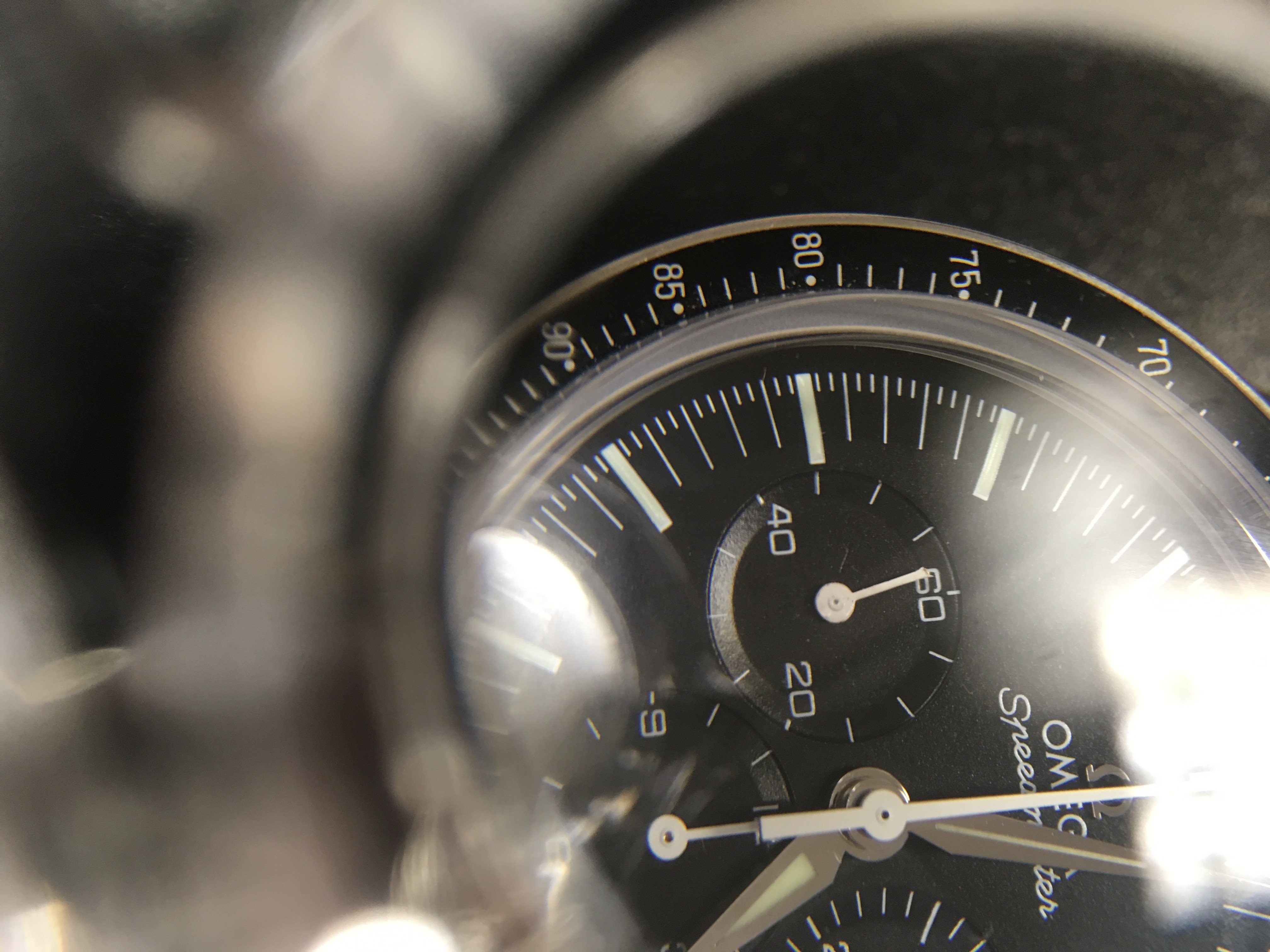

Well, as I mentioned earlier, I ordered the hand Archer described and took the watch to The Watchmaker in Stoneham, MA. Just picked it up today and am very happy. The previous butcher put two small scratches on the back cover and one on the face ( hairline on the seconds subdial), but they're hard to see with the naked eye.

Indeed, the sapphire bothers the living heather out of me. I am waiting for a swap to be a reasonable possibility someday; be assured I'll get in that line. There are differences from the CK2998 I can live with, but the seconds hand and the crystal aren't two of them....
