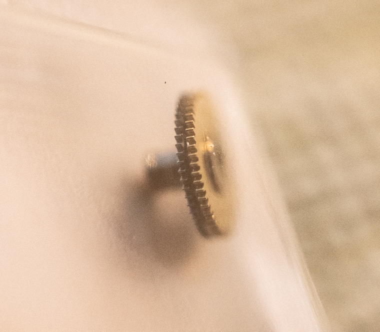

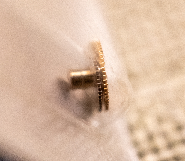

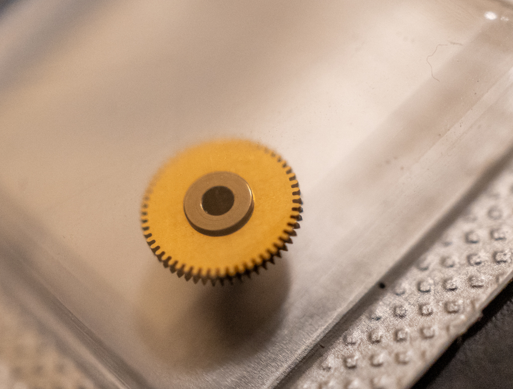

Yes, it is a double wheel, the spring in between! Here some photos, I have a new sealed hour wheel! He was able to take apart the two wheels....but I don`t exactly know how. I forgot to tell him to make some pictures...

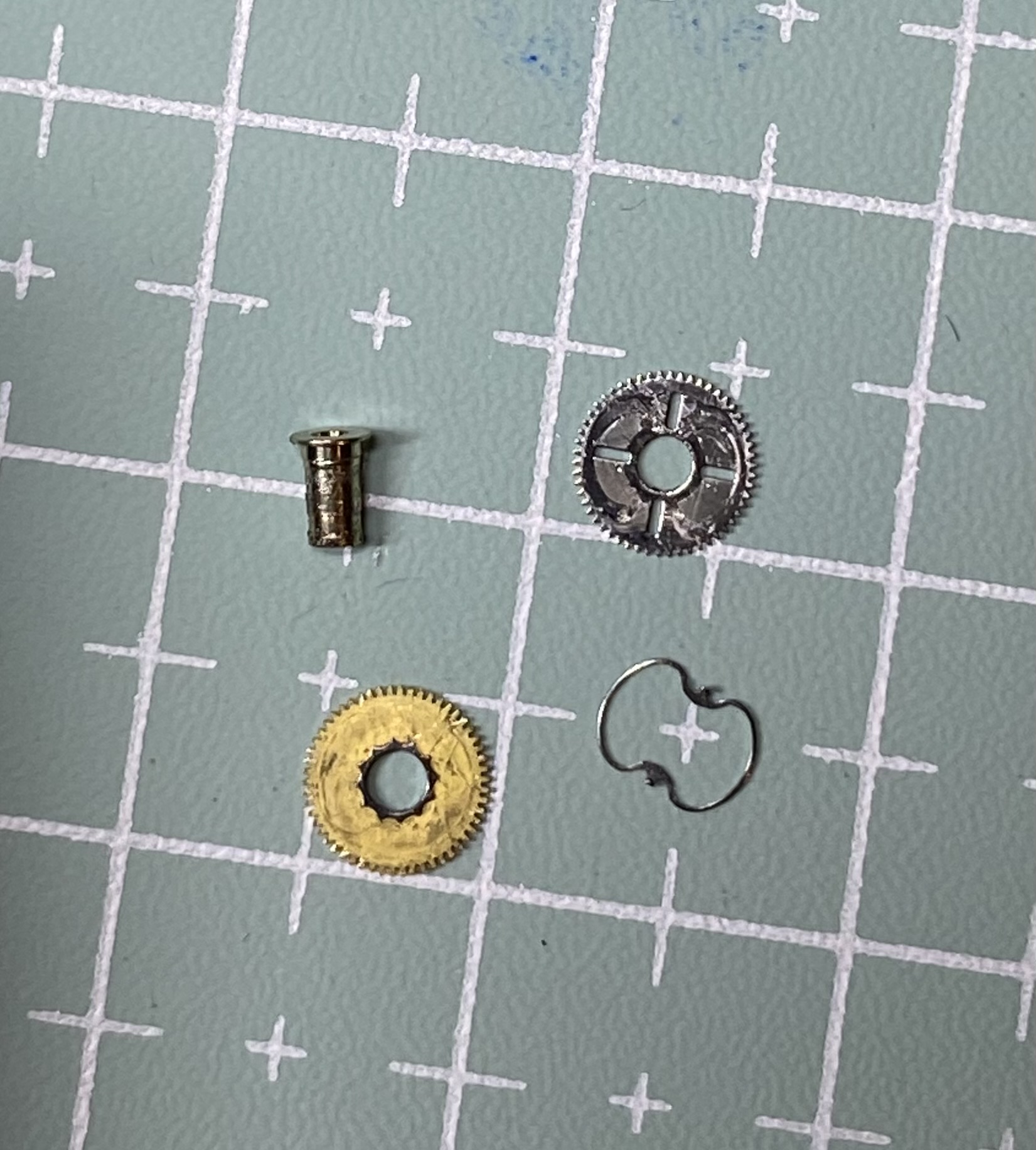

To anyone who might be stalled on this 1128 31046 hour wheel. Note for my 2005 Deville GMT the hour wheel is 3mm high, for info. If you can get the click spring then the double wheels can be separated relatively easily by applying gentle pressure on the bottom wheel towards the top of the centre pipe, like a canon pinion extraction really. Both wheels will slide along the pipe and fall off with the click between. I have attached an image of the 4 pieces involved in this hour wheel for the avoidance of any doubts. Hope this is useful to someone. I will be sourcing a couple of new click springs (just in case) and remaking my watch.!
