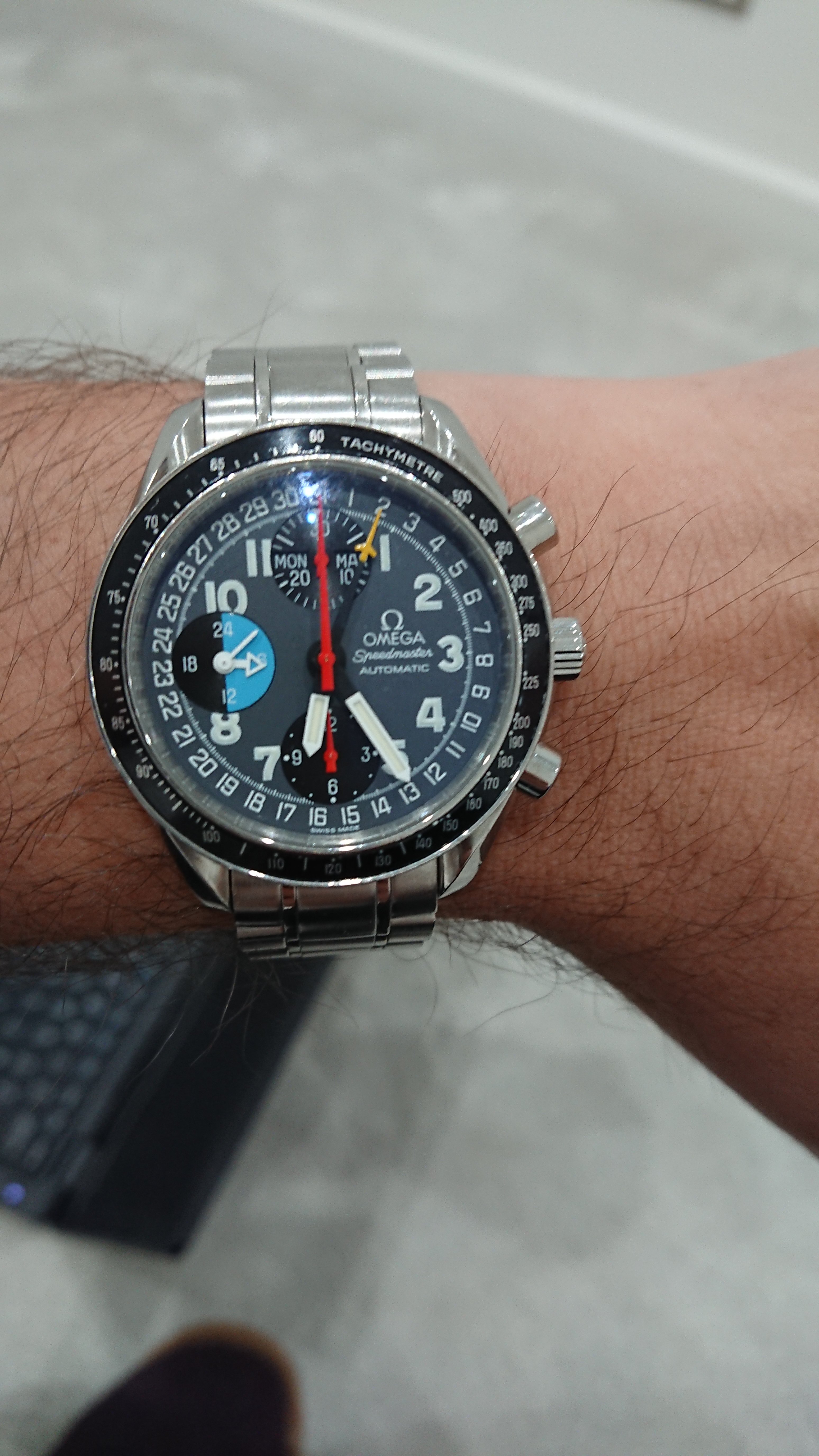

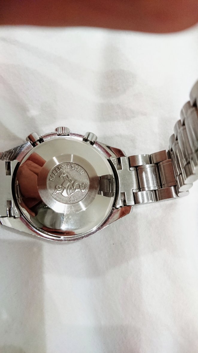

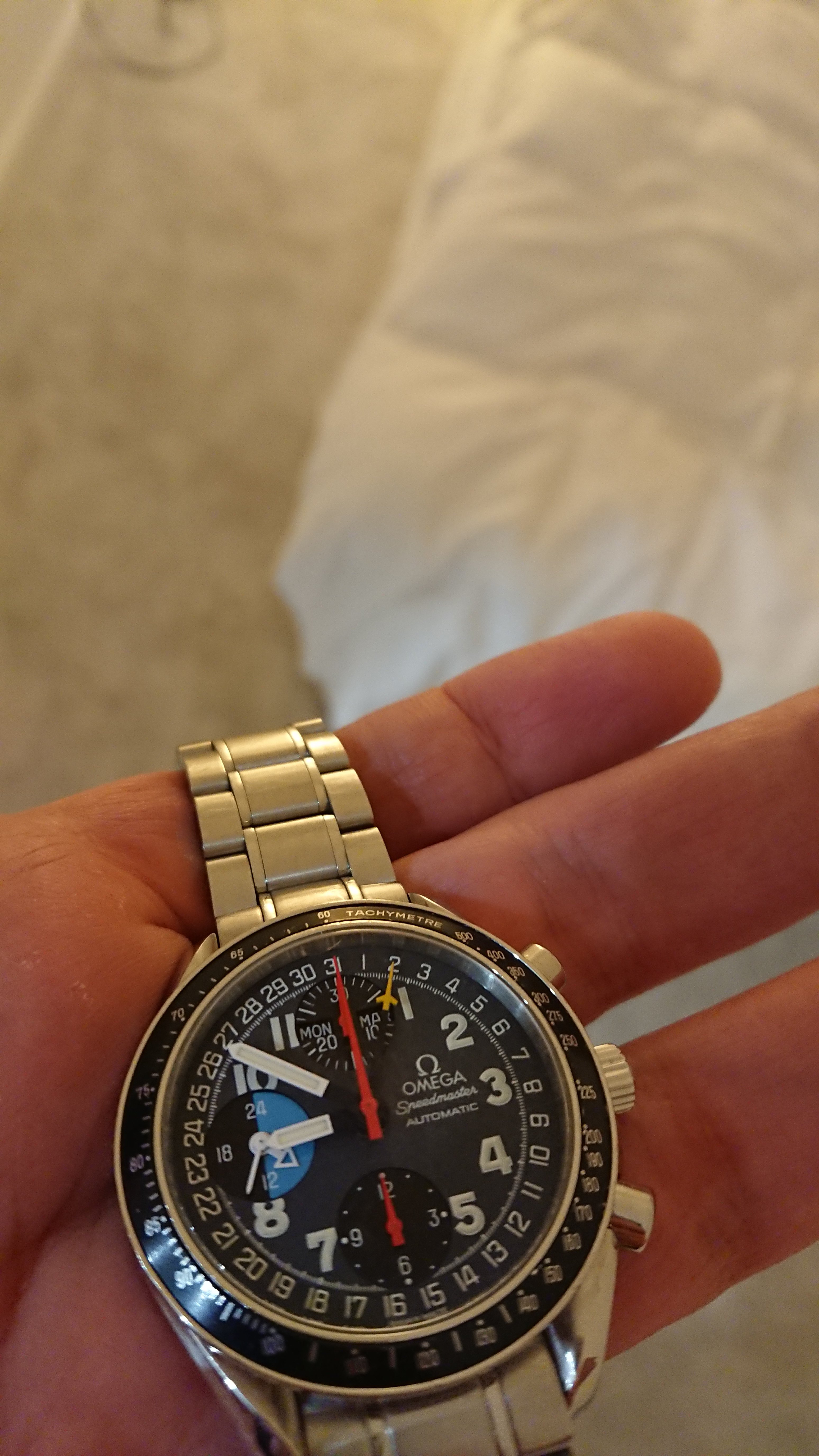

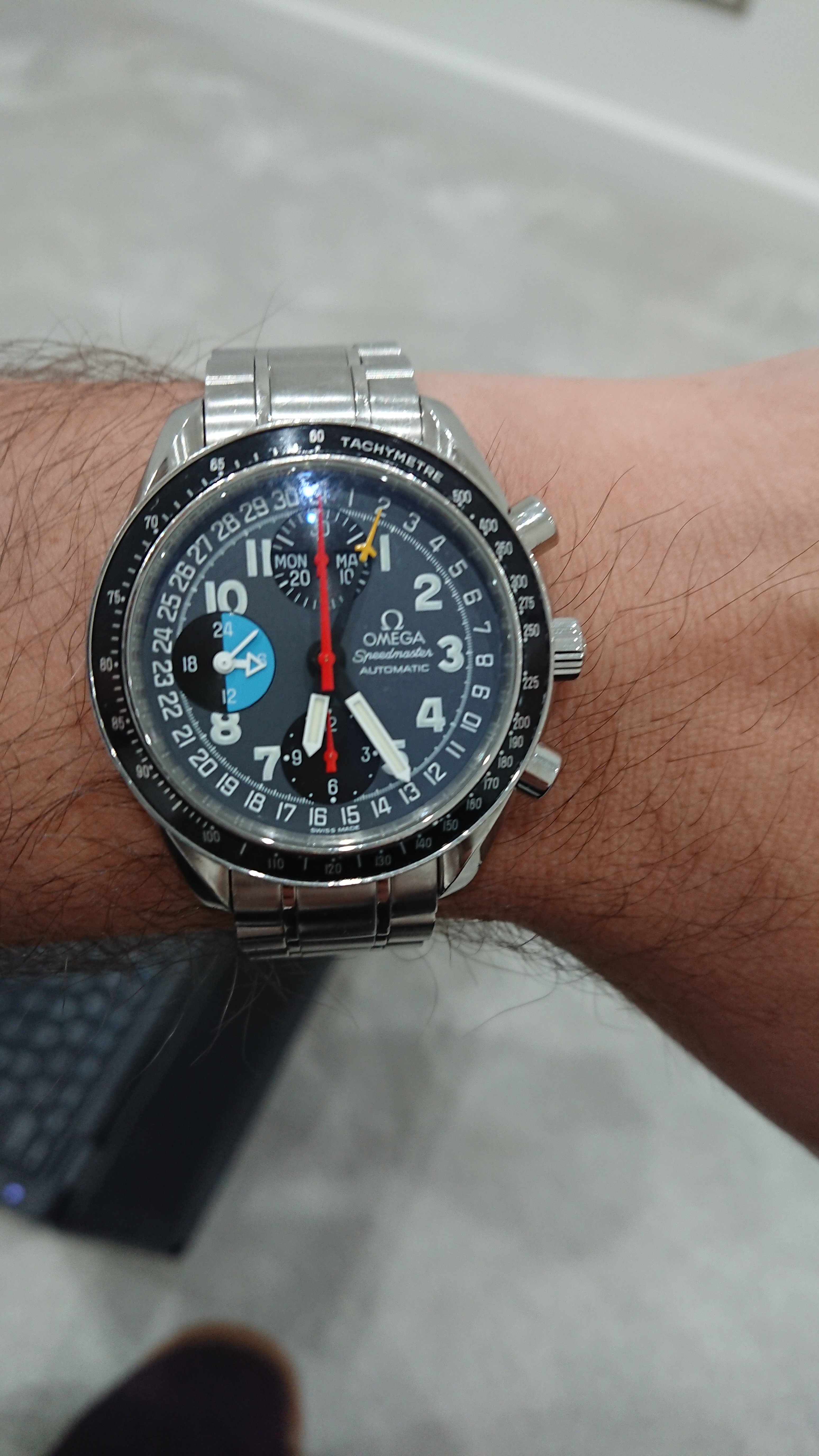

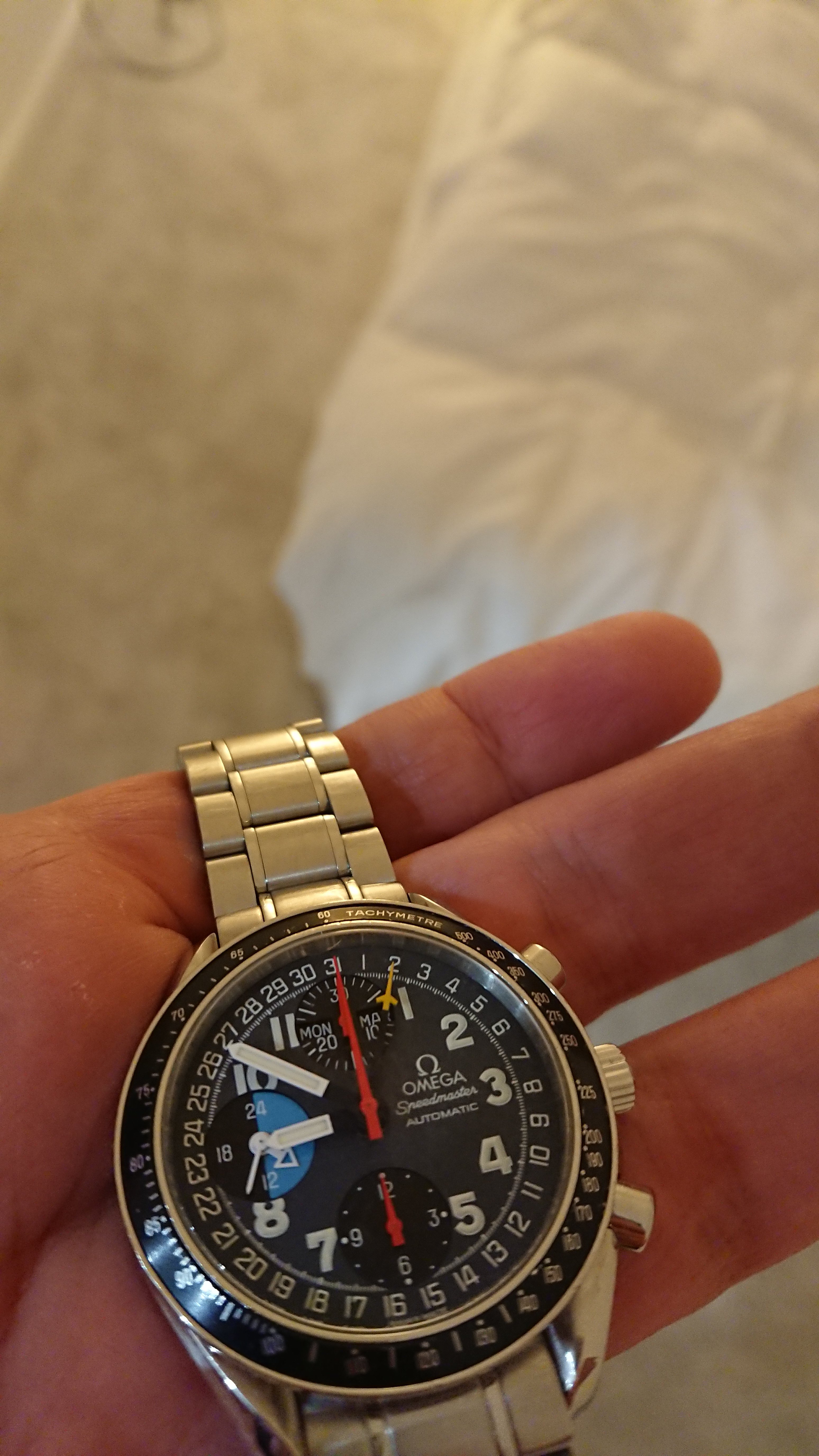

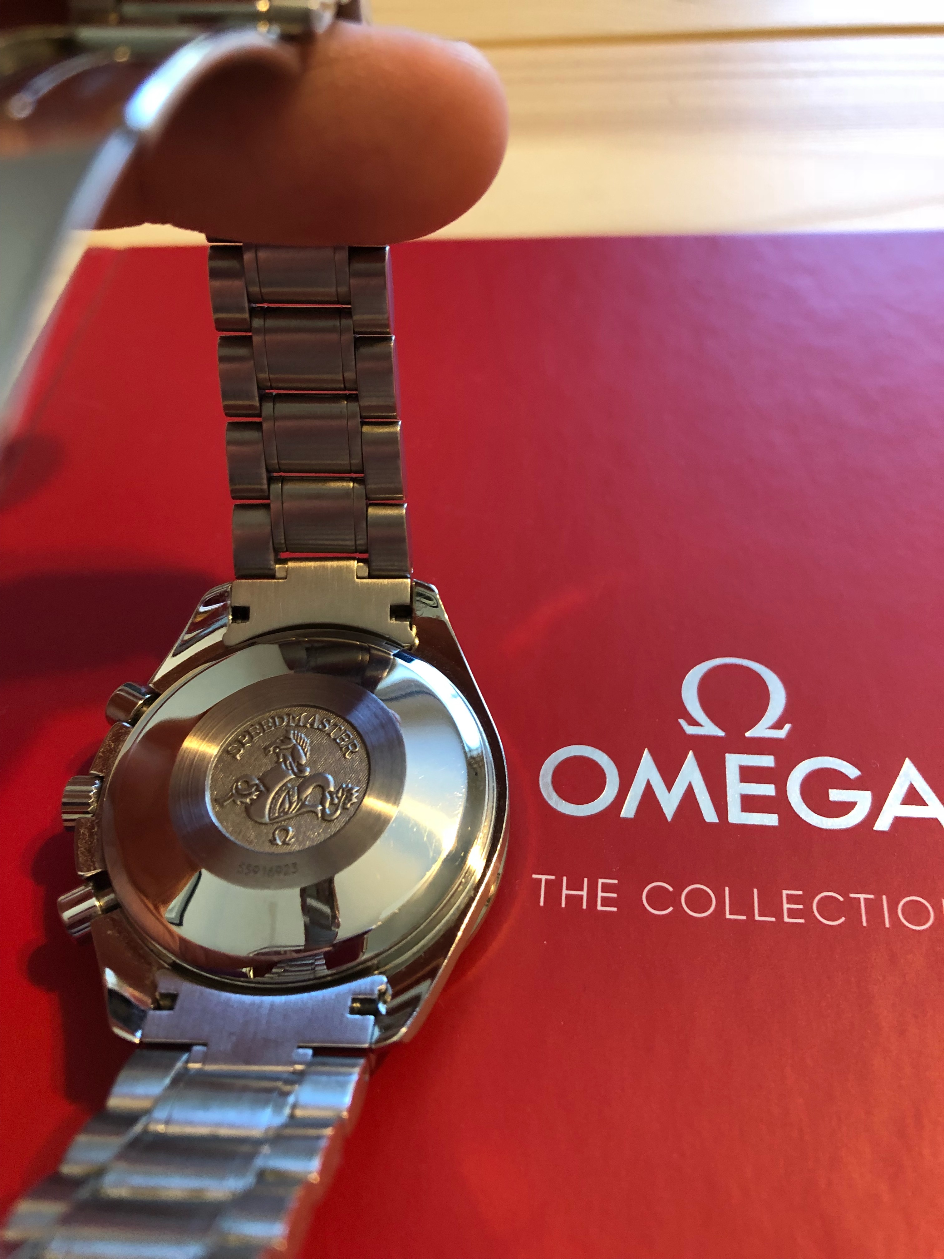

Wish I was starting my first post with a different topic, however it is what it is. This week I purchased my second wristwatch before my 30th birthday an Omega MK40 Schumacher. I was careful to choose a reputable dealer from Chrono 24 with over 700 reviews, however when I received the watch was shocked to see it has no serial number on the case back.
This seem to be the later issue model without tritium dial. The watch itself keeps very good time +2s/day and it was straightforward to set the time. The dealer said the serial is present on the movement, however looking at other examples online they all seem to have the serial engraved on the back.
I really love this watch, it's character and keeps the time great. Was there an issue of this model with no serial number on the caseback?

My guess is it was polished off. The caseback on my MK40 has a kind of machined look around the center.

Stupidity or a stolen Watch. Both are hurting the value of the Watch badly if you ever need to sell it.

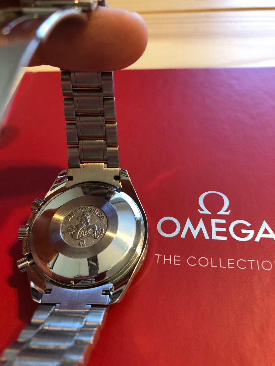

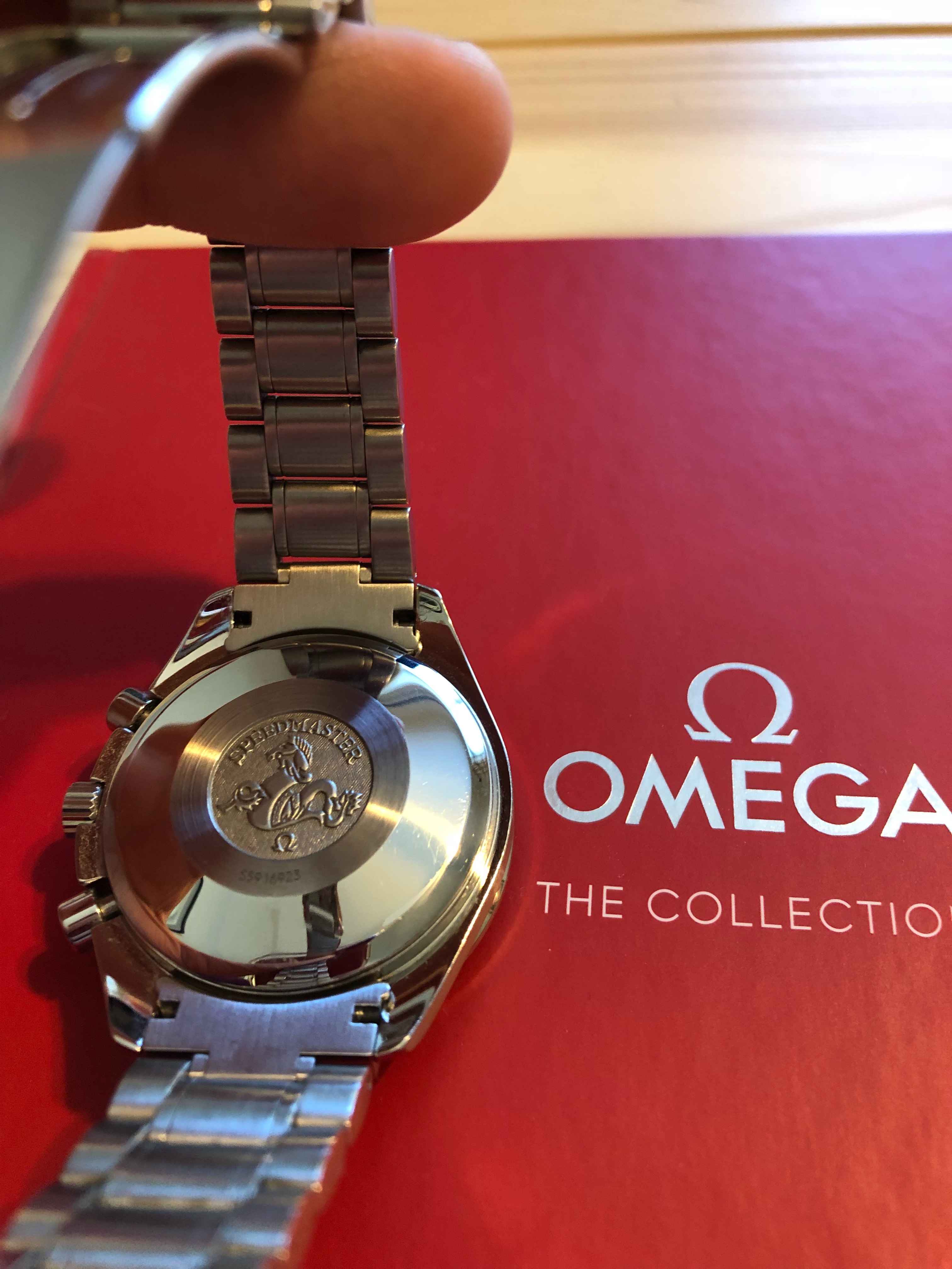

Just saying it looks polished because here is the back of my MK40. Regardless it should be on the inside like others have mentioned.

No - in this time period only COSC versions of Omega's 7750 based calibers received serial number on the movements, so this one will not have a serial number for the movement.
I just went back through the photos of the last 20 or so of these 7750 based Speedmasters that I've serviced, and none of them have the serial number printed inside the case back. I don't service the reduced models (modular chronograph models) so I don't have a lot of experience with them, but I don't believe your theory applies with the various Speedmaster Date models.
Do we have a consensus that it should be returned?
It's up to you, but with the serial number removed, and none present on the movement, Omega may refuse to service this watch in the future. Personally, for that sort of money I would send it back.

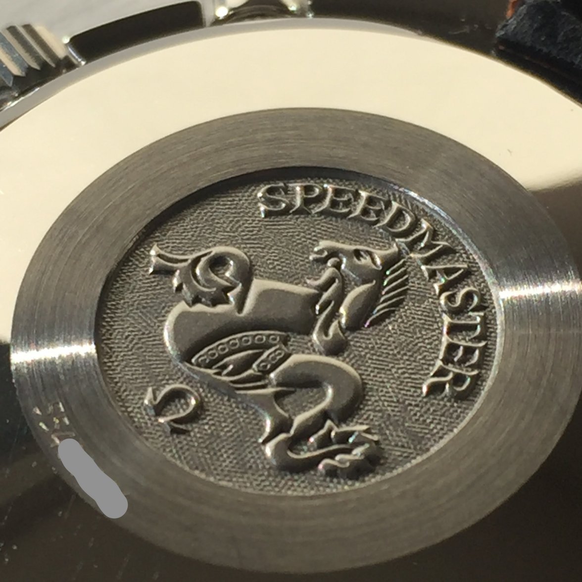

My MK40 has the serial number engraved on the outside of the case back, and as mentioned previously, it appears that the serial number may have been polished off the OP's example. Below is a magnified image of my never polished and sparingly worn example:
My question, @Archer or one of the more knowledgeable folks, is there a service replacement case back for this model that would not have included the engraved serial? Good luck OP!

Yes, but it's more likely that it has been removed during refinishing. First, case backs are not often replaced, and if they are it would be pretty unusual for a watchmaker that was in any way a professional, to change this part in a way that would eliminate the serial number from the watch entirely.
