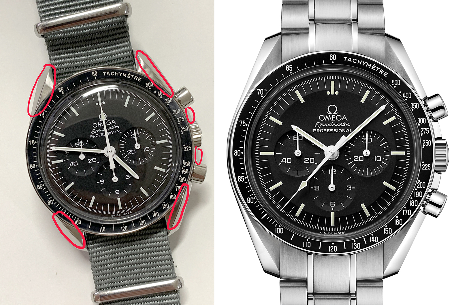

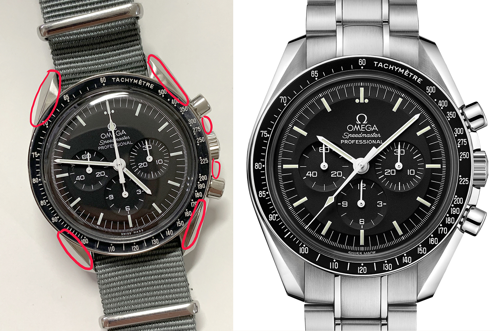

Omega have done something weird to my Speedy.

Looking at the before and after shots, they seem to have really gone to town with the polishing between the pushers. I would be pretty angry about that also.

A little update on this as of a few minutes ago.
I've been speaking to with the head of customer services at Omega UK. They told me that the damage to the bezel was caused by a mistaken new employee using the ultrasonic tank to clean. They are replacing this free of charge.
The polishing to the case which many of you have picked up on is another story. My asking the AD to leave the case as is and just to replace the hesalite seems to not have been relayed to Omega, who took it upon themselves to carry out a FULL service on my watch. Something that they are very keen to stress is above and beyond normal customer service and something I should be thankful for. Which, if it wasn't for the rounding of the corners on my case I would be.
It's all ongoing, they are now speaking with the AD. Just thought worthy of an update.

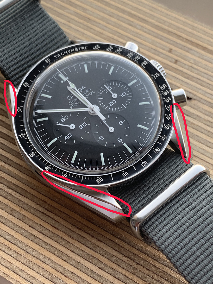

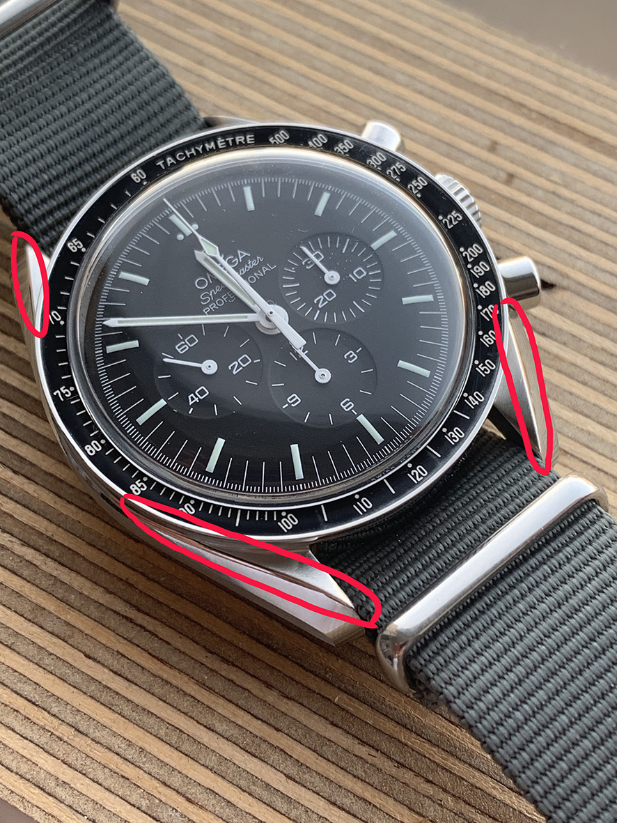

I sent these images to Omega to show the areas I'm not happy with.
291
1,394
Annnnnnnd....
A couple of minutes after posing the above (and sending those shots) I got an email from them. They are replacing the midcase. It will be engraved with the original serial number.
Really happy to have this resolved.
Moral of the story; don't drop your speedy on a bathroom floor. If you do, be REALLY clear about how you want the repair to be carried out.
