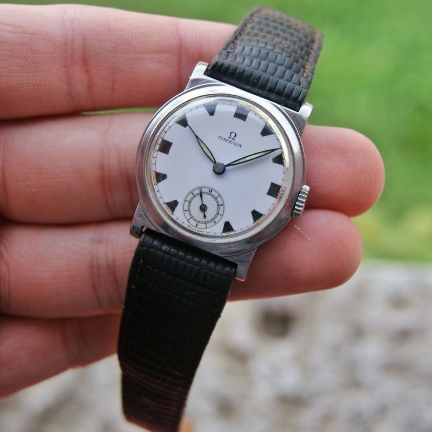

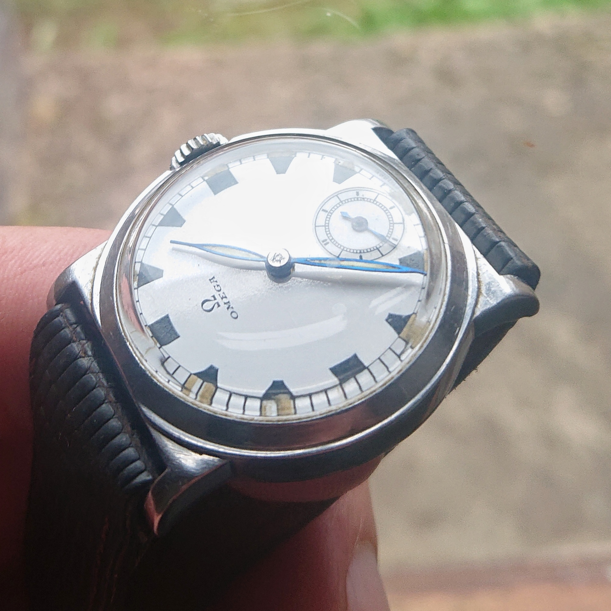

I recently bought an Omega Foibos CK275 from 1935. The watch looks great for its age, the dial looks intact and never renewed. My only concern is the main handset which is not in the catalog. Their size seems correct, the color certainly matches the original second hand, and the radium is the same color as the dots on the dial.
The dial has no scratches to indicate a sloppy switch of the hands. What do you think about this watch?

Maybe someone did a non sloppy switch of the hands... and lumed the dial to match?

These hands look nice and I would not mind to have them on my watch...

Yeah, maybe...
I mean, your two options are:
1 - It has had the hands swapped, and the dial re-lumed to match.
2 - It shipped from the factory in 1935 with the hands and dial lume it has.
Based on the catalog image, option 1 would seem the most likely.
Based on AJTT, option 2 seems possible. Although as has been mentioned many times in the past, not every watch in AJTT is quite as it should be.
Without a full and detailed history of where the watch has been since 1935, it's really impossible to tell I think?
As it stands, I think it's a handsome watch. Congrats.

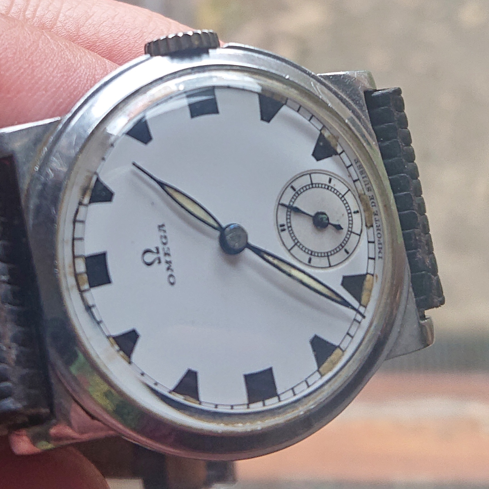

Well, the catalog picture does not match the advert picture either. Take look at the minute track under the lume markers👎
That is likely to be the fault of a wrong crystal.
620
4,971
Tend to disagree, nowhere in the picture of the catalogue model can minute markers be seen behind the hour markers. If your observation were true, at least some of the now hidden minute markers would show, don’t you think?
It took me a minute (no pun intended) to see your point. The issue here is that despite the text accompanying the image, the depicted Phoibos hasn't got lume on the dial. The lume plots fill out the two "minute squares" behind each hour marker.

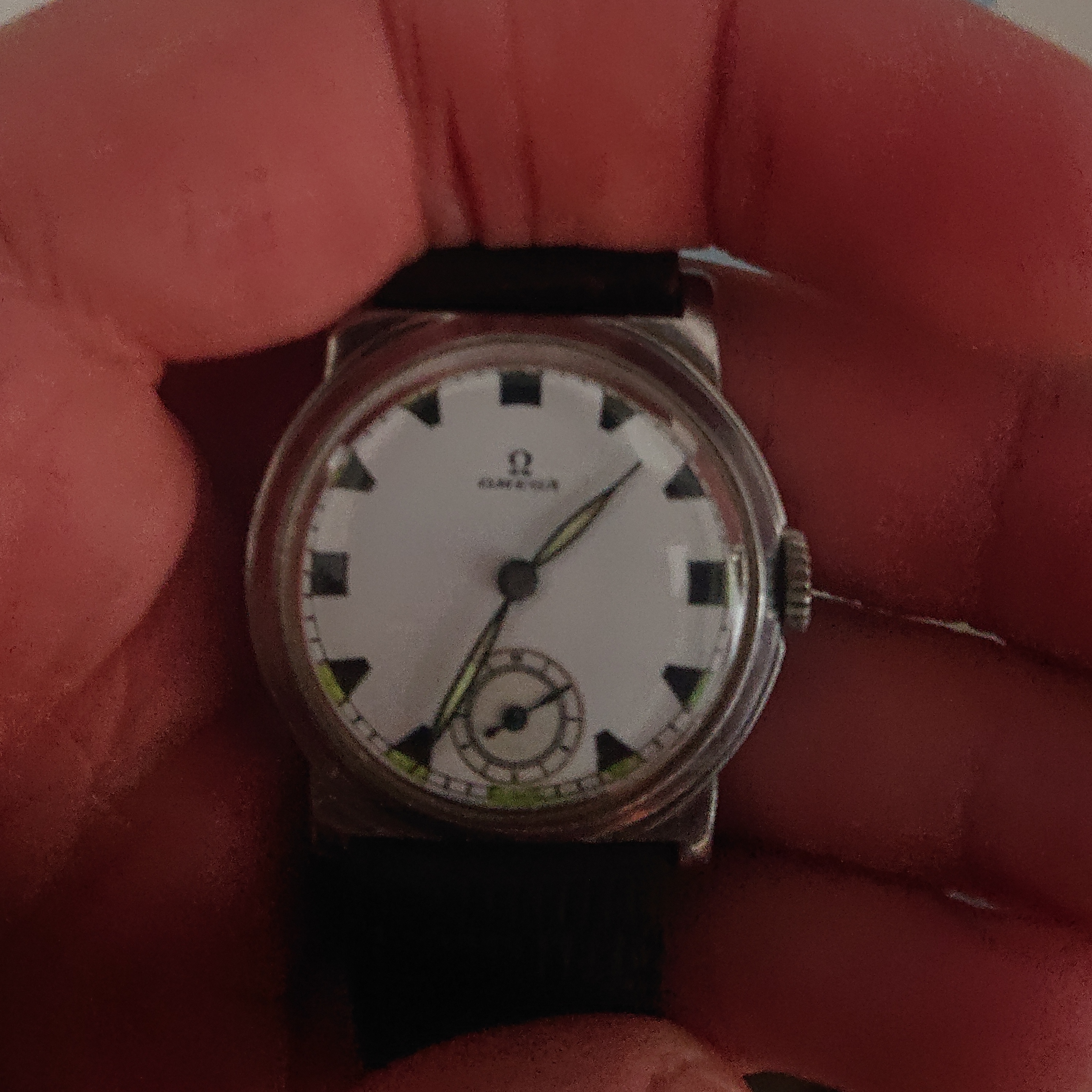

4
9
The radium is still glowing, but only for few seconds. Sorry for the quality of pictures, my phone was a lot cheaper than this watch 😜

Like Jim said: it’s still a nice watch (translated then😉). Hope you can enjoy it a long time!
