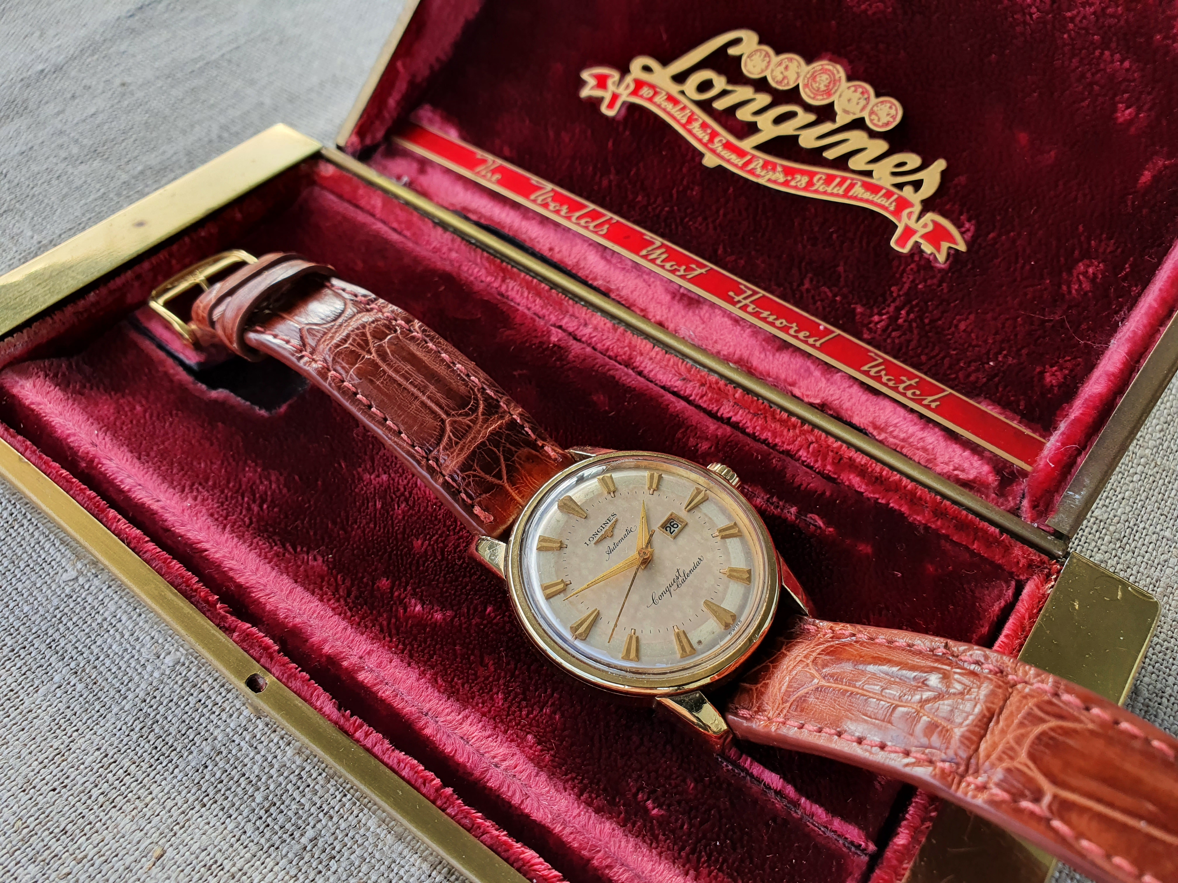

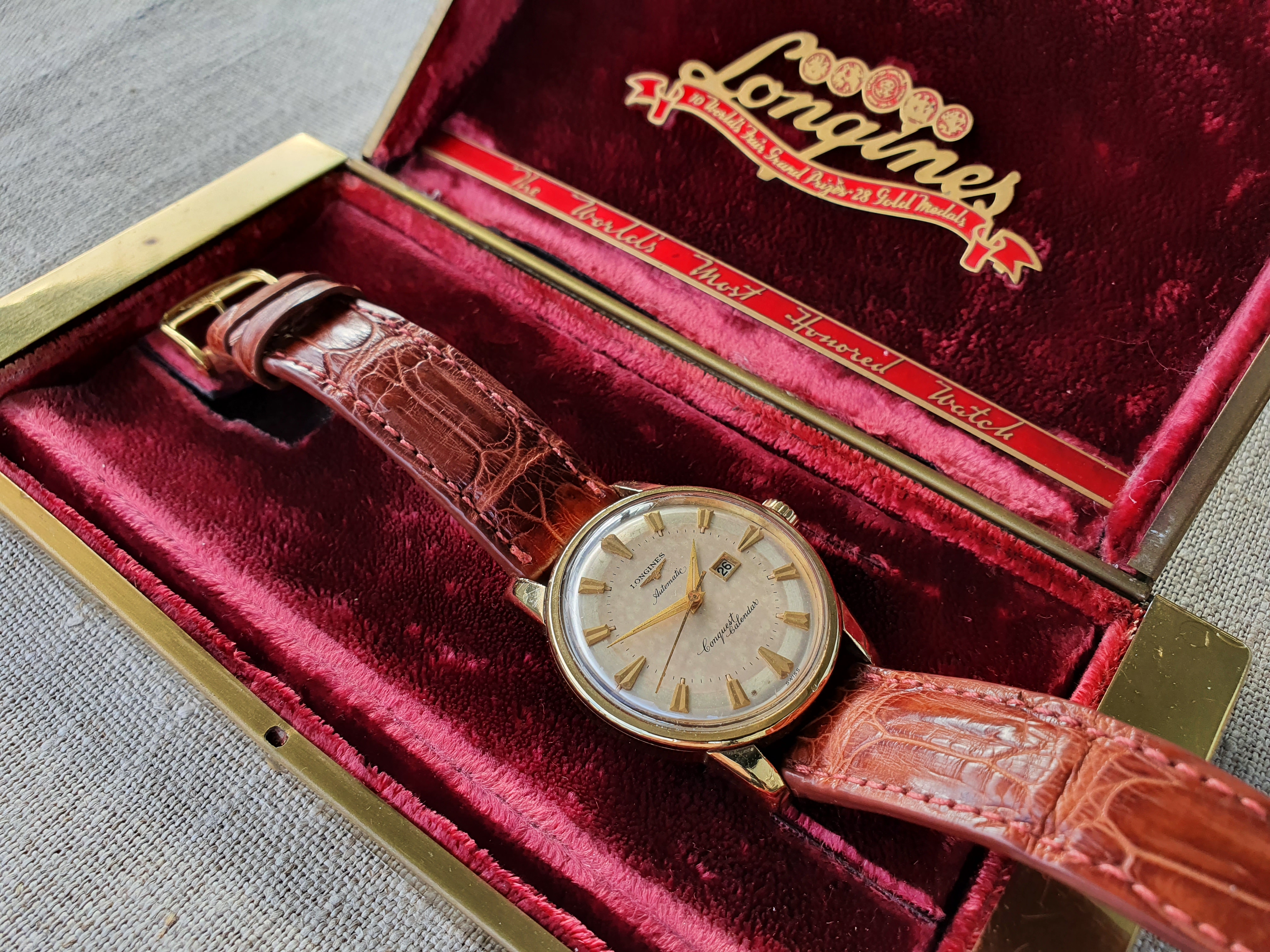

I think it was a mistake- it's been happening to some people with the site apparently. They post and it ends up somewhere else unknowingly..
Nice Longines though!
