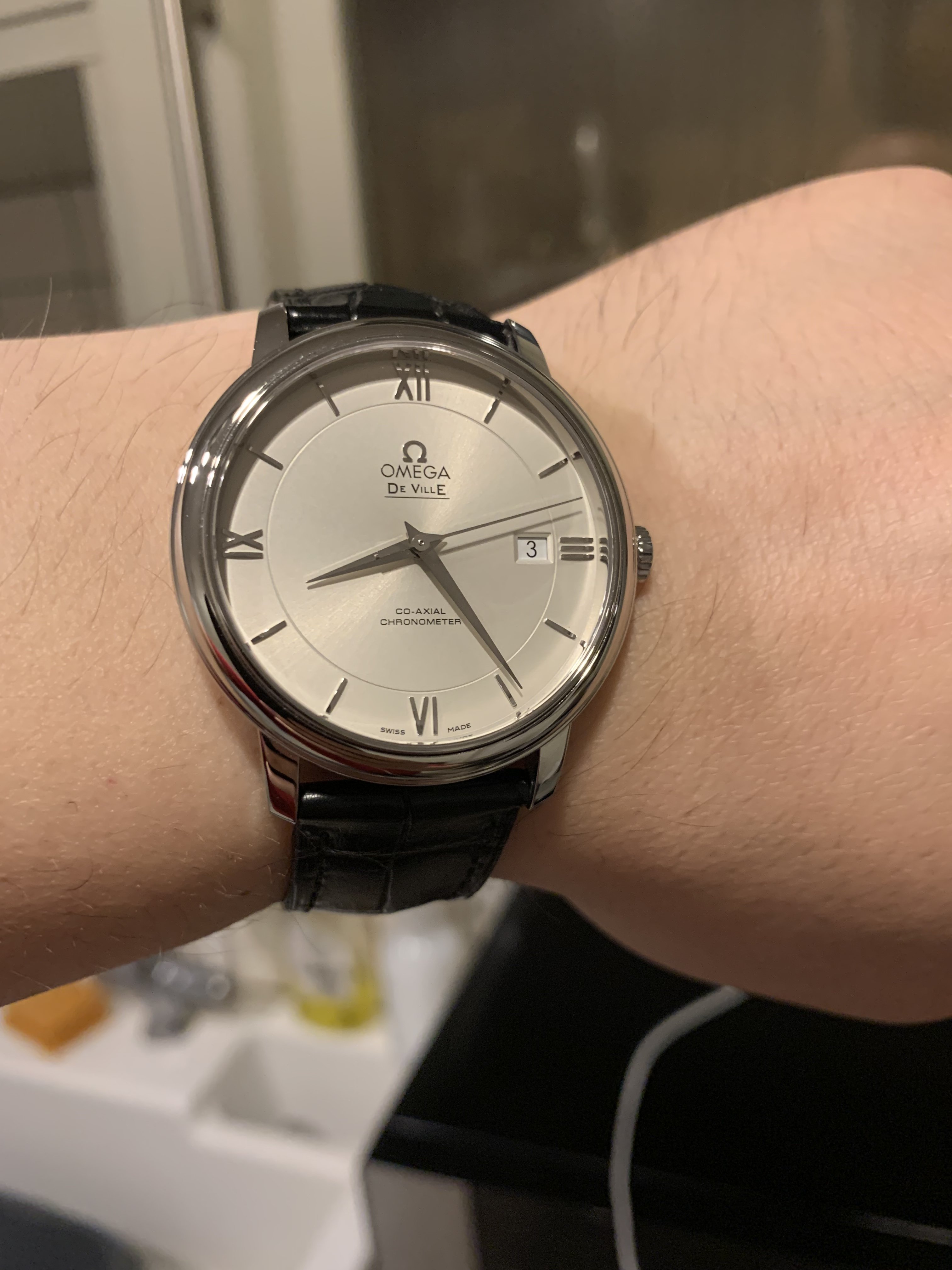

I am inactive at a desk most of the day. The watchmaker at the Omega boutique recommended I give my watch 15 manual winds a day.
Is the 2500D movement designed to handle this? My watch does not have a screw down crown and is a dress Omega DeVille. On some forums people say automatic watches are not designed to be daily wound and this can damage them??

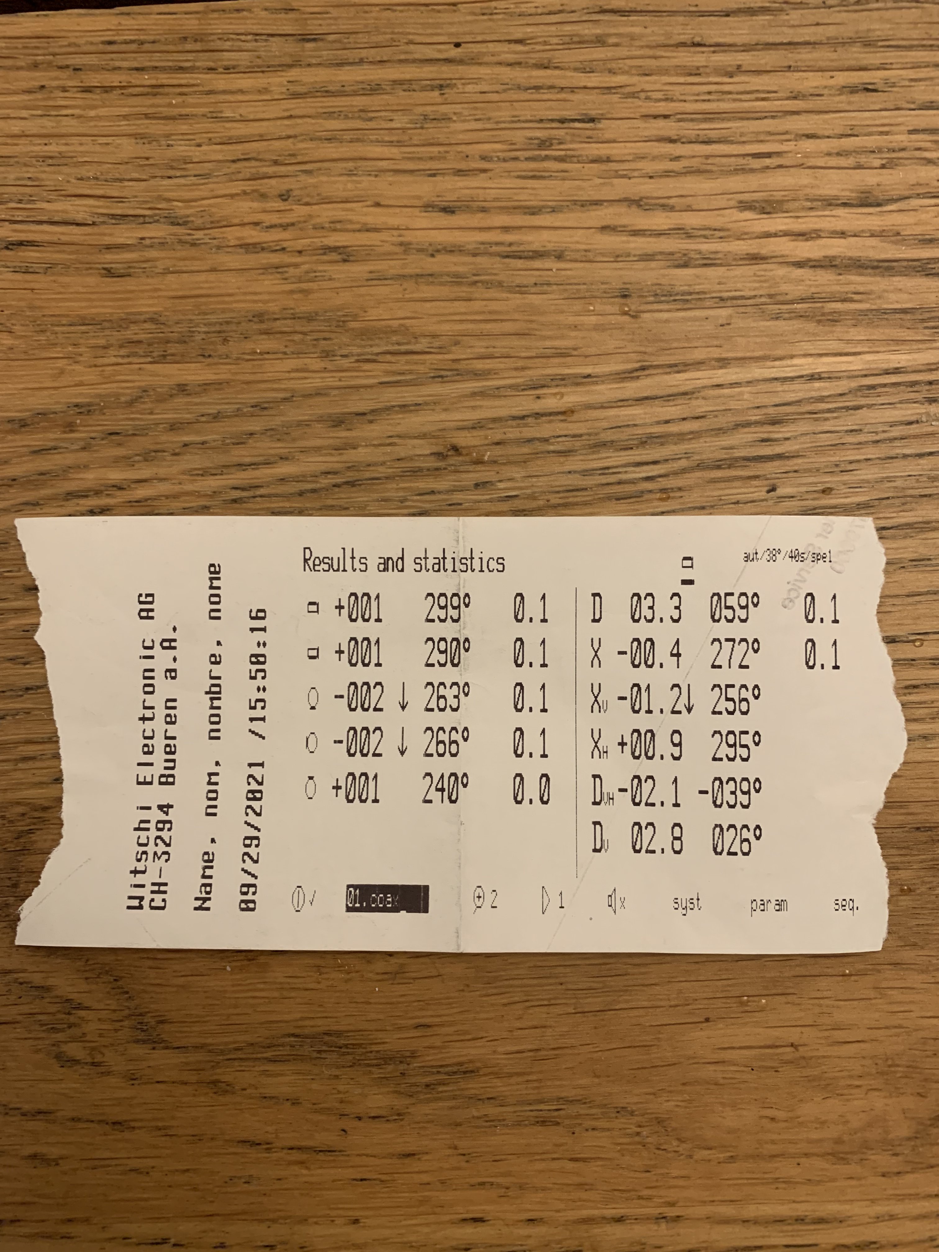

My watch has been at Omega boutique who checked my watch. They tested amplitude etc and see attached pic for results. The watch maker tested power reserve by winding watch manually and letting it rest, all ok. They put it on windmill then letting it rest,all ok. The watch maker said the watch power reserve lasted about 50 hours.View attachment 1294643
My issue is that I would wear daily, my constant walking movement in a day was no longer than 25 mins a day. Additionally, I would walk a bit at work and at home but not much at all. Mostly sitting down at work and at home in the day. I would wear watch about 10 hours a day. Over 6 week period after setting watch 69 manual winds the watch never ever stopped if worn every single day.
After 6 weeks I put the watch down on table it stopped after24 hours. The watch maker said it is normal and I need to be more active OR give watch 15 manual winds a day to give it a boost.

Competent watchmakers can fix BROKEN watches. But they can’t fix watches that run down and stop because the owner isn’t active enough. Ten hours a day on the wrist of a person who doesn’t move much, and there will be times when it runs down. An analogy might be that you’ll drive twice as far on a full tank of gas than you will on half a tank.
5,631
5,815
I never take mine off, even wearing them to bed. Ten hours a day won't cut it.
And, yes, your watch is keeping time quite well, according to that timing analysis!
