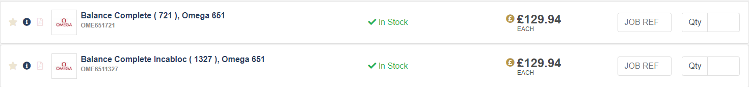

I have a De-Ville with this movement, that my (now mainly retired) watchmaker told me needs a new balance and added "I can't source them any more".
I know this is basically a Peseux/ETA 7001 movement, but can the real experts on here tell me if the balance is the same ?
I can probably get a 7001 balance even if it means an old donor movement as they aren't so thin on the ground.
Thanks in advance for any expert input.

Do you really need a balance? It's unlikely but, if you do, Cousins have them with/without shock protection.

At £129+20%VAT+carriage+cost to fit etc.this is probably gonna remain in its imperfect state which is OK-ish bearing in mind it's probably worn only a few hours at a time, but could be a lot better.
Thanks for the heads up anyway.
After posing the original question, I now know where I can source a new sealed in package 7001 balance at a fraction of that cost, but don't know if it will do the job.

I think Tom's comment was aimed at me and not you. He chose to read my comment as a criticism of the watchmaker rather than a request that you check what you've been asked for before spending all that money. Usually, it's a balance staff but, if he's asked for a balance complete, I can't find anything that says the 7001 balance is the same as the Omega 651.
