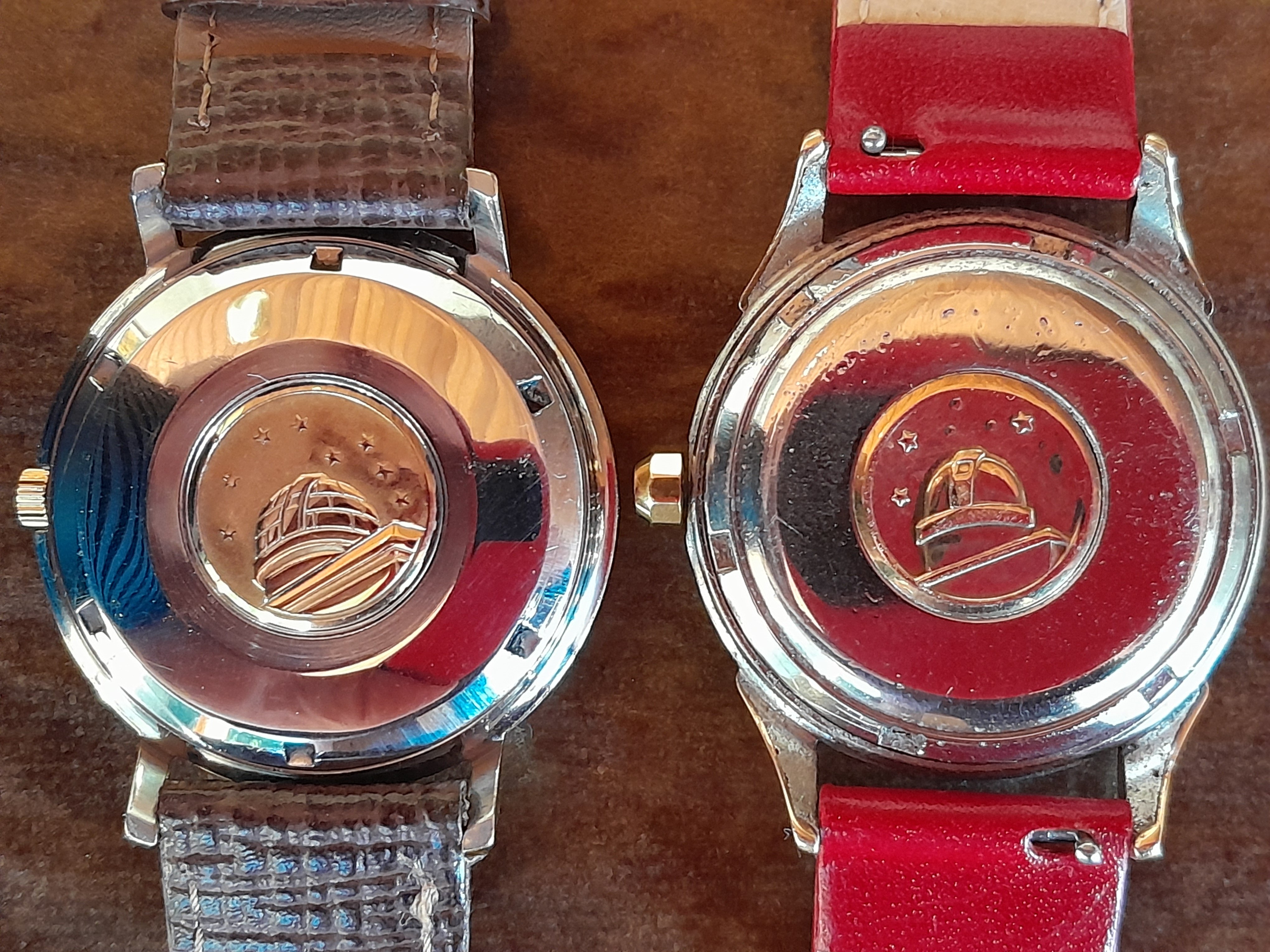

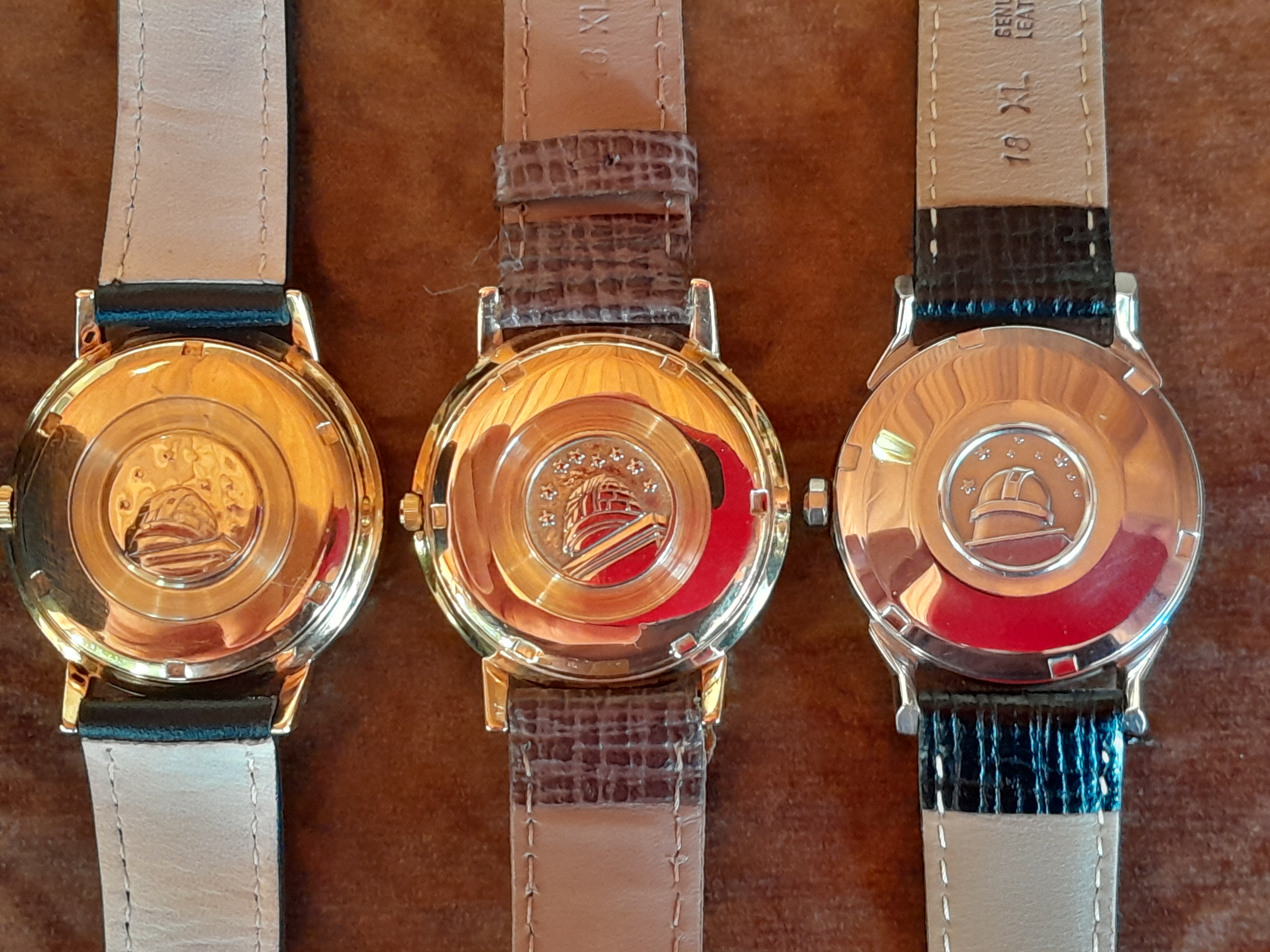

Does anyone know why the bricks on the Constellation observatory roof only appear on some models?
2,683
3,166
My personal theory is the tiled one being the next iteration of the design, they used them both on the same models though to differentiate the case materials
6,835
10,505
originally the 'brickwork' observatory only appeared on solid gold cases
then for reasoning only known to themselves, around 1966 Omega swapped it around for appearing on non-precious cases instead (Including gold-capped)
However, in true Omega style they continued to produce some gold cases with brickwork
edit - here is a link to Desmond's essay on the matter
http://omega-constellation-collectors.blogspot.com/2008/03/constellation-medallions.html

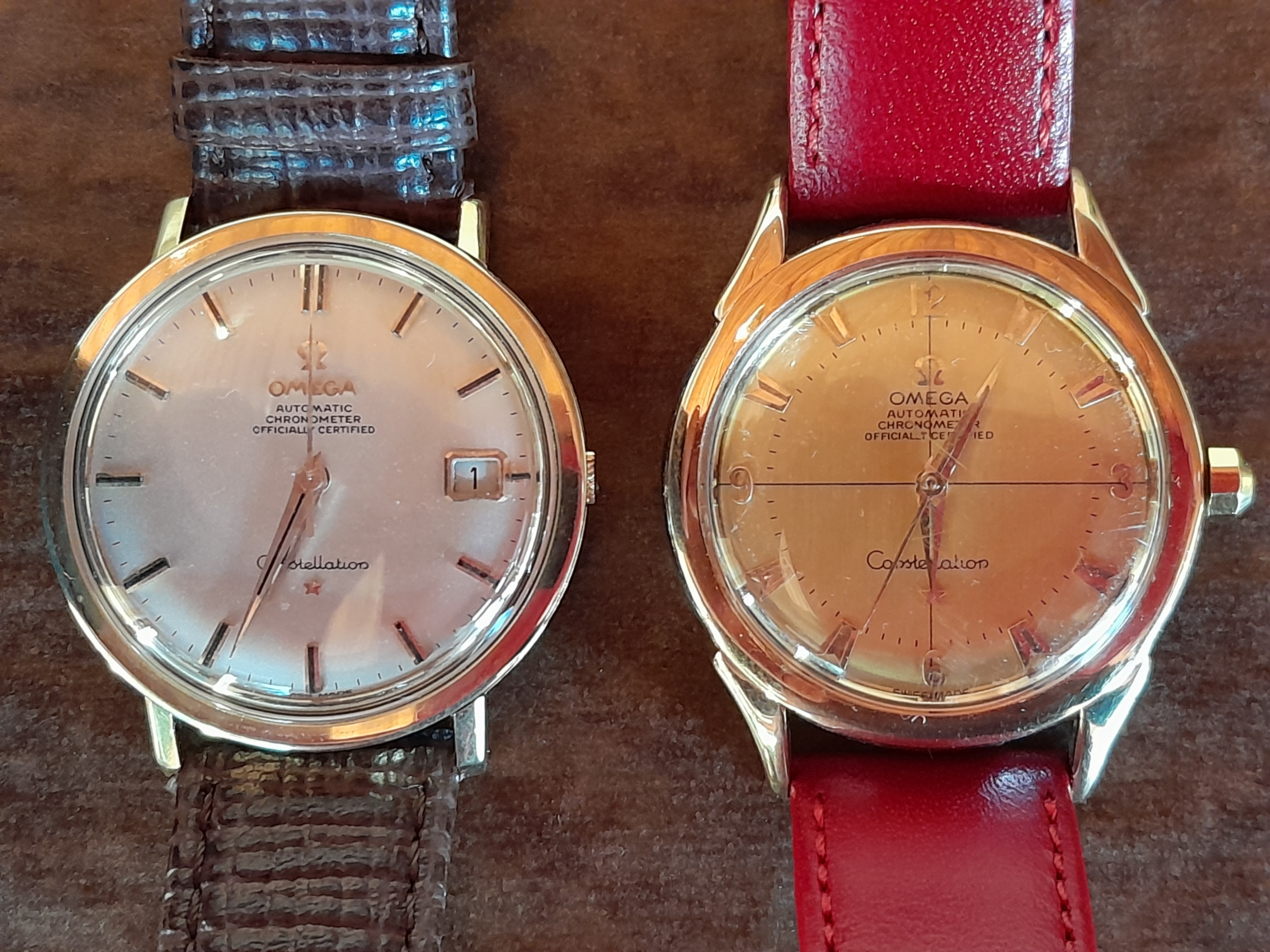

Peemacgee,
Thank you for your reply. I'll read the essay with interest.
The middle watch:
Being a Scot, I would say British rather than English
35mm 18k purchased auction in uk Feb 22
Cal 564, 25,665,xxx
Case 168.5004 1967-69
Serviced May 2023, new glass and new 3.6mm crown

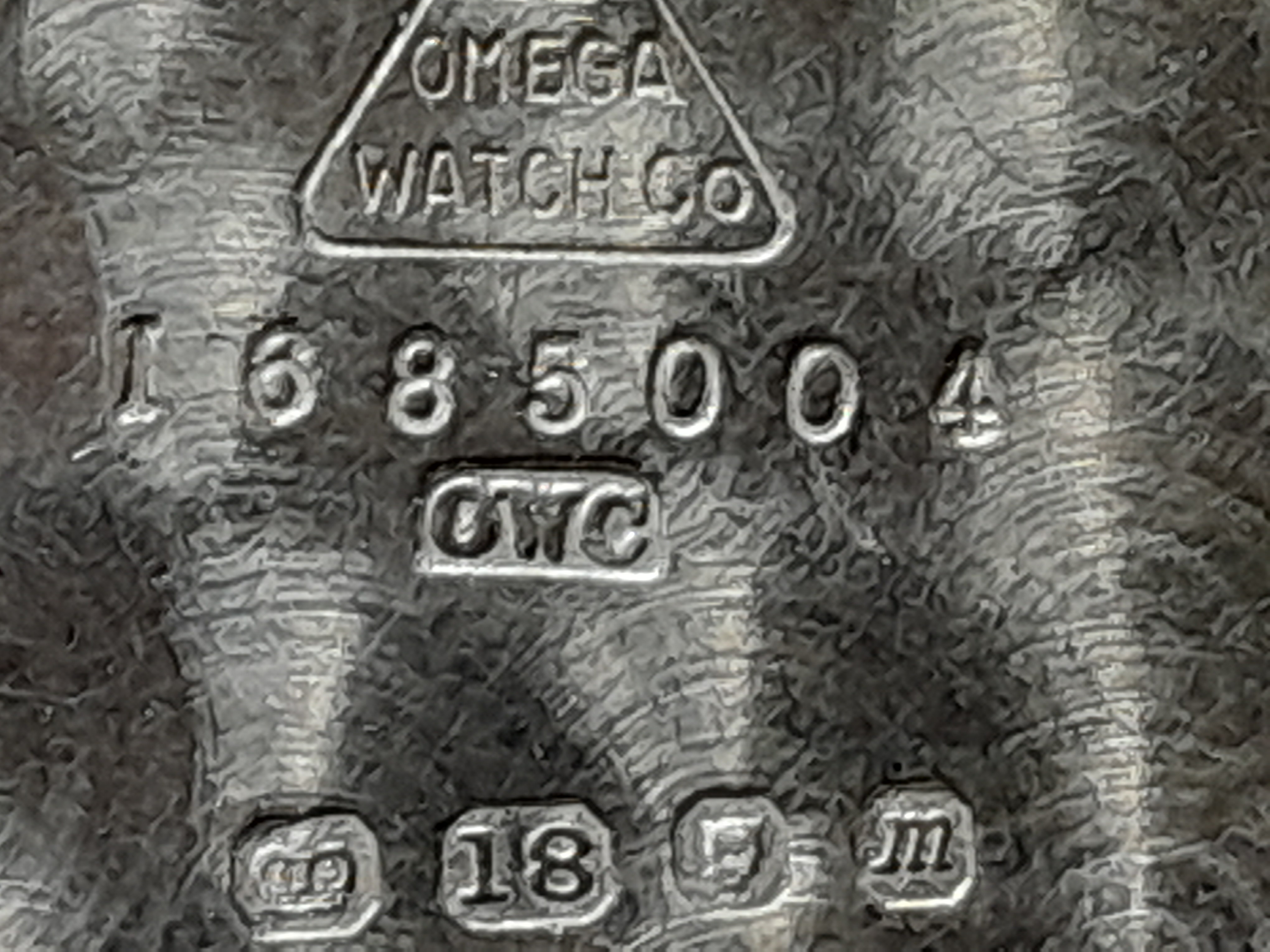

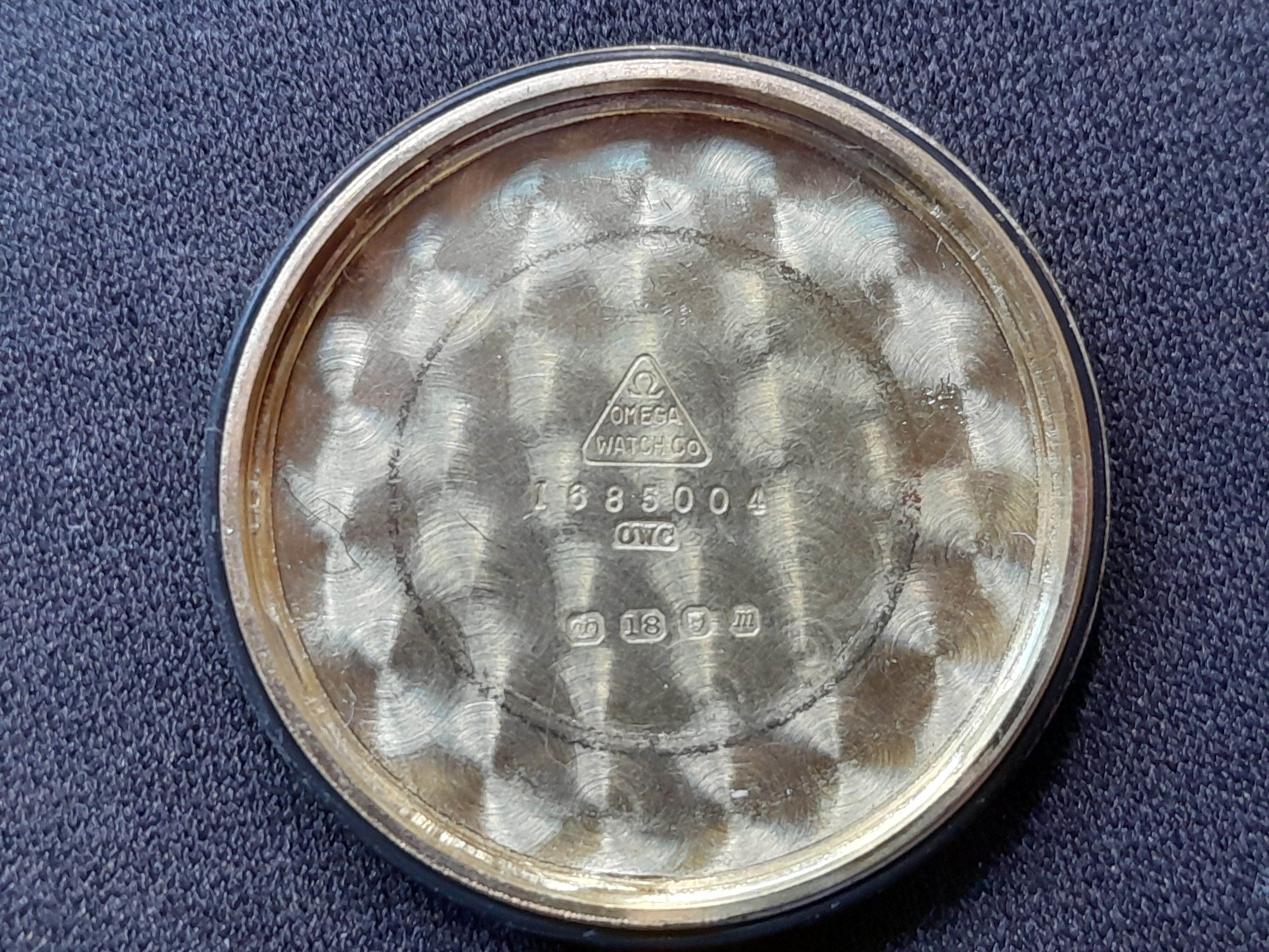

Hi Peermacgee,
Opened the watch and photos are attached. OWC = O watch Company? Surely the crown in the hallmark means it is English?
I must confess that I never paid much attention to this watch.
Thank you.
6,835
10,505

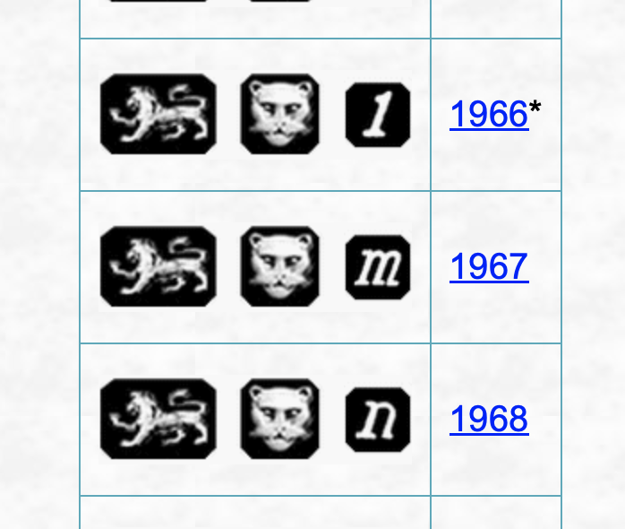

As it is marked 'OWC' 'Omega Watch Company' and has a London 'Leopard's head' hallmark it could be Shackman
OWC is covered in the essay I linked to
The 'm' hallmark is for 1967
