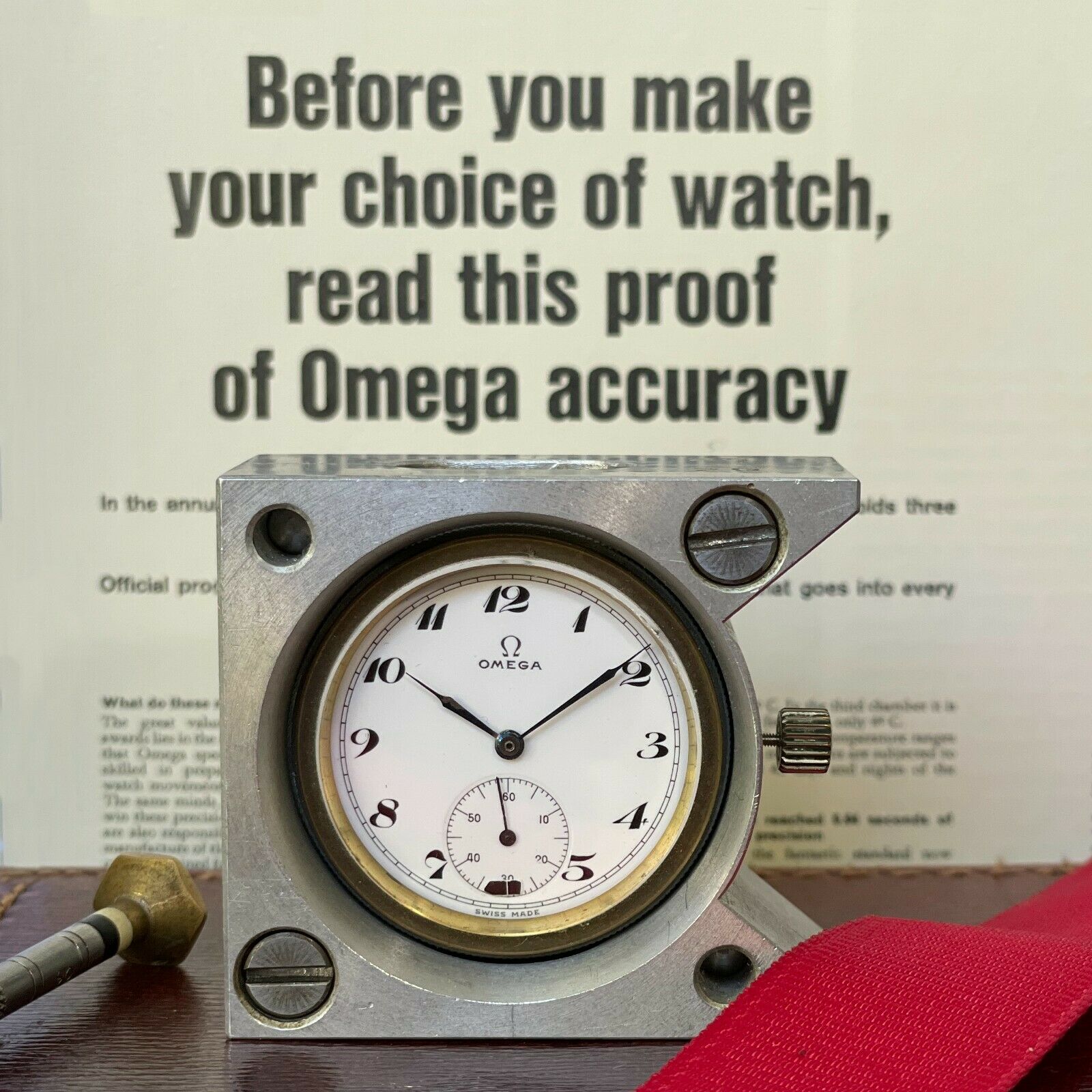

Going to include all the pictures since this one is an interesting and rarely seen reference, incidentally this reference is also the watch @mac_omega wears on a nato strap as his daily.

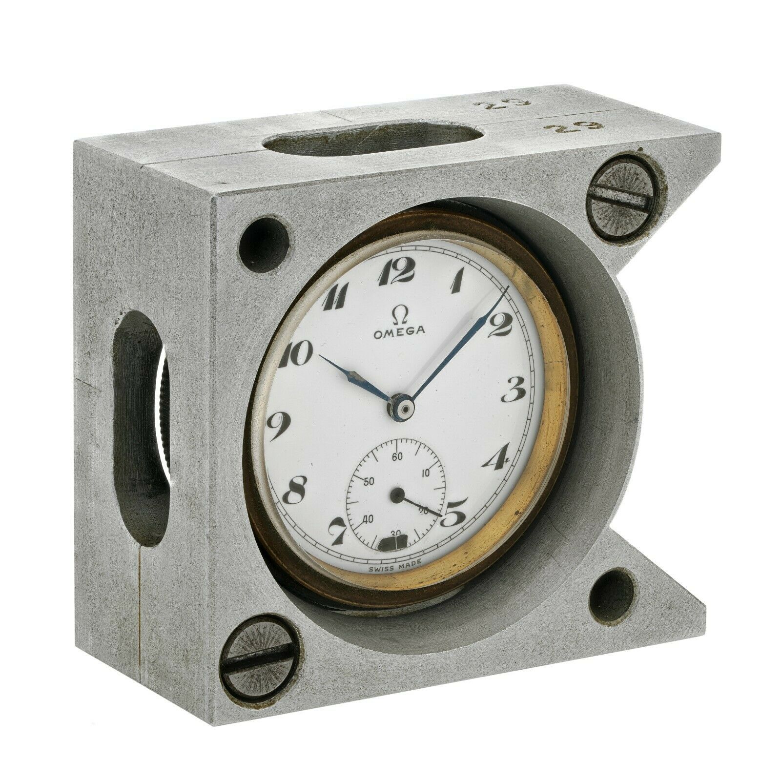

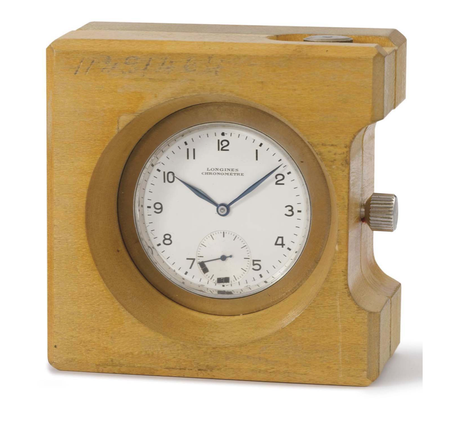

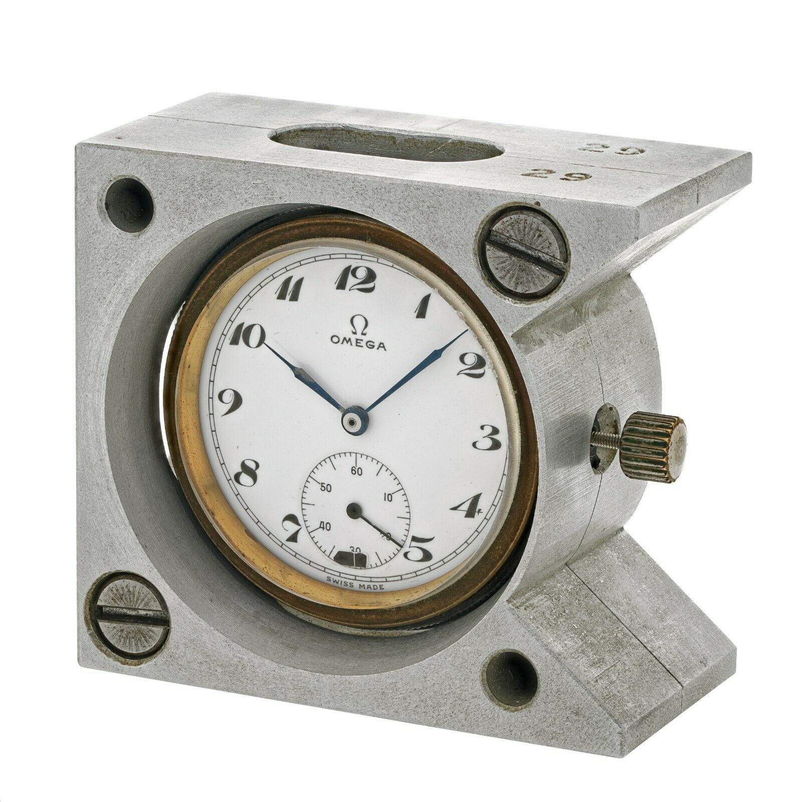

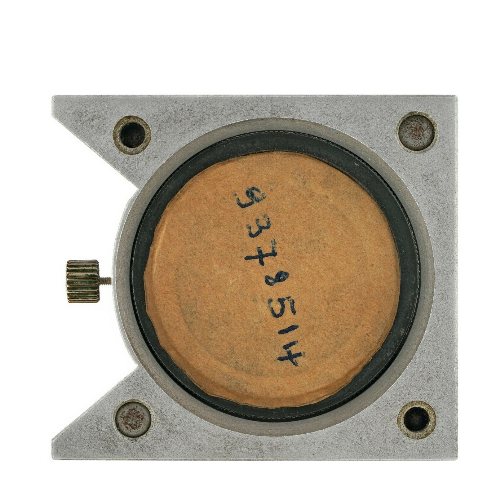

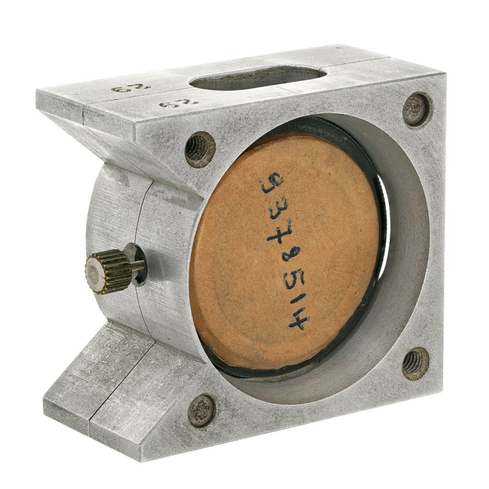

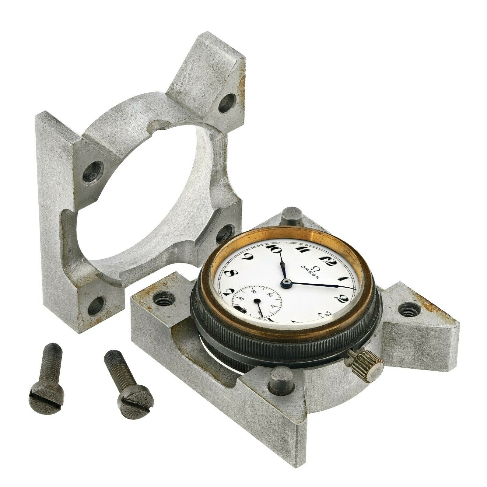

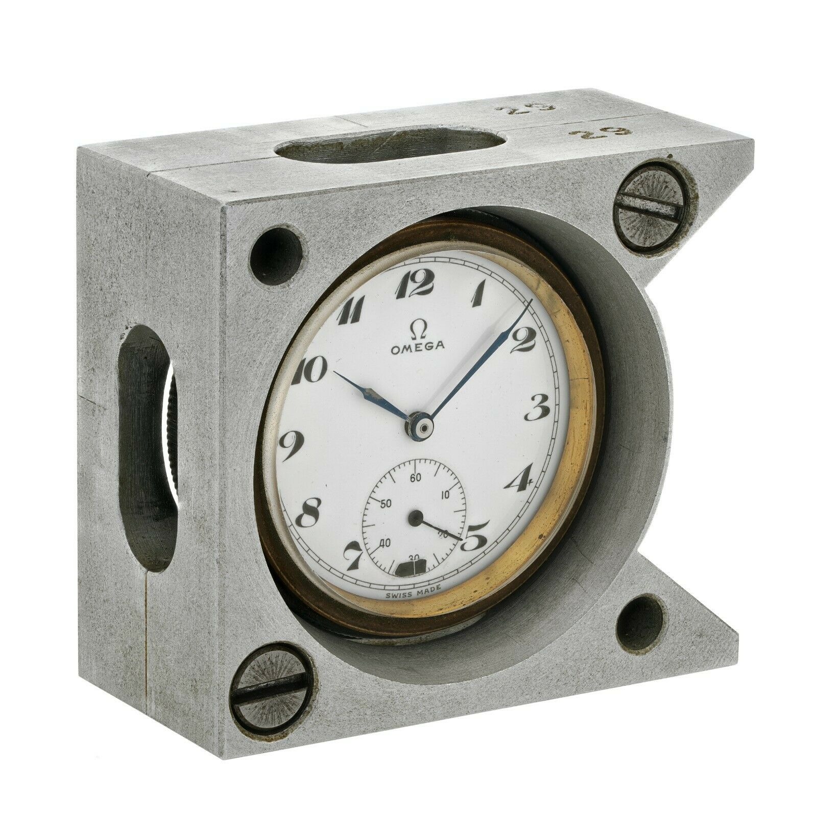

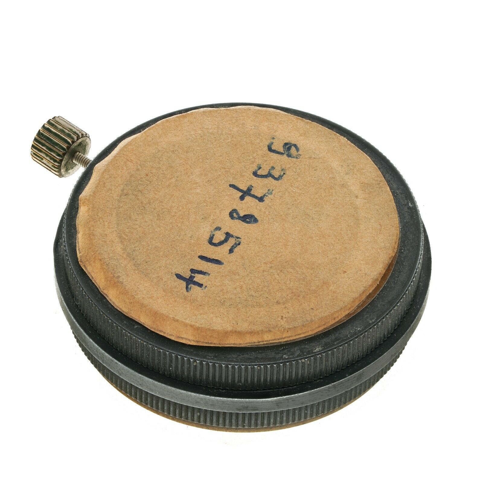

Looks similar to the 30T2 movement. If I not mistaken, it is from 1939...
I really like this case. It is custom made?
609
789

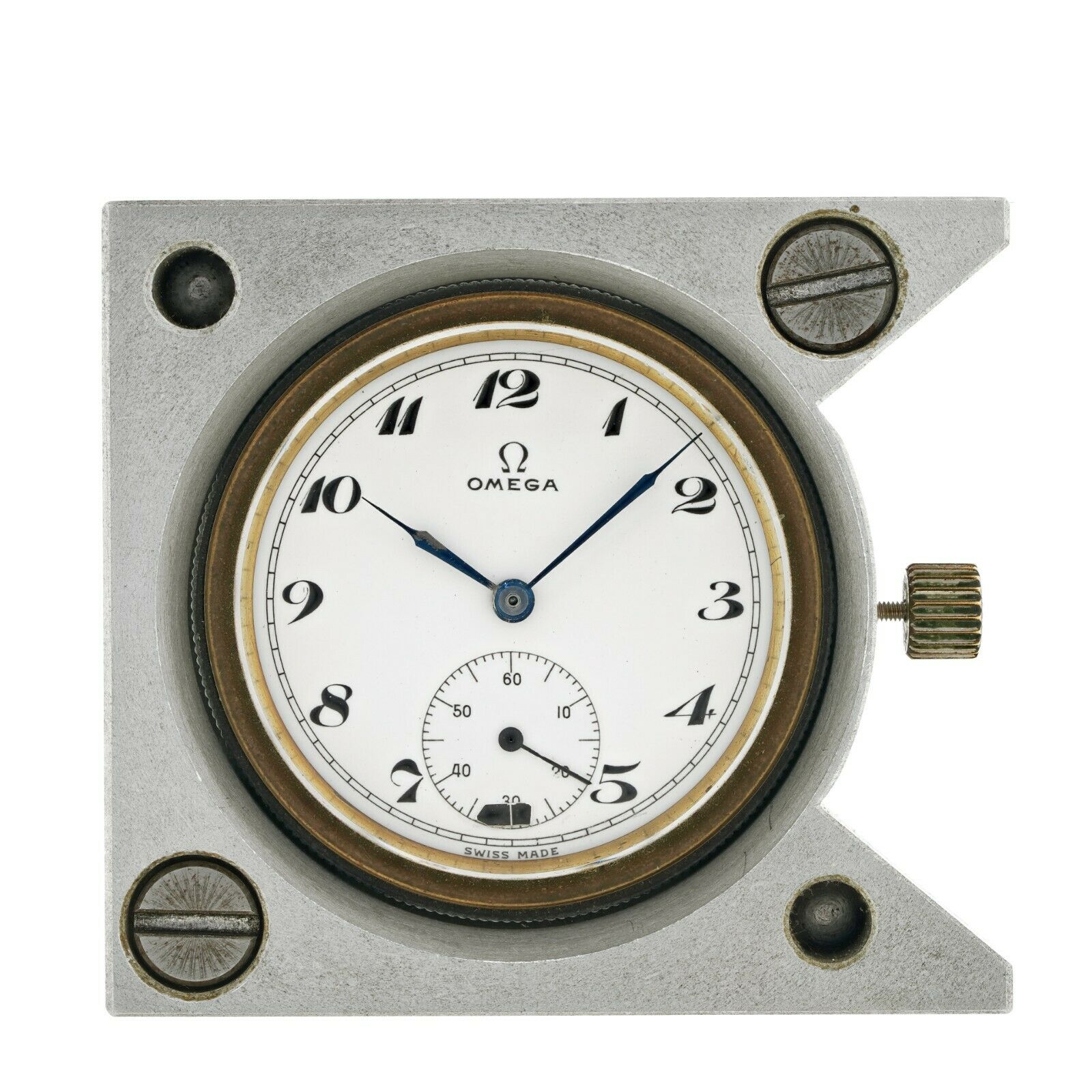

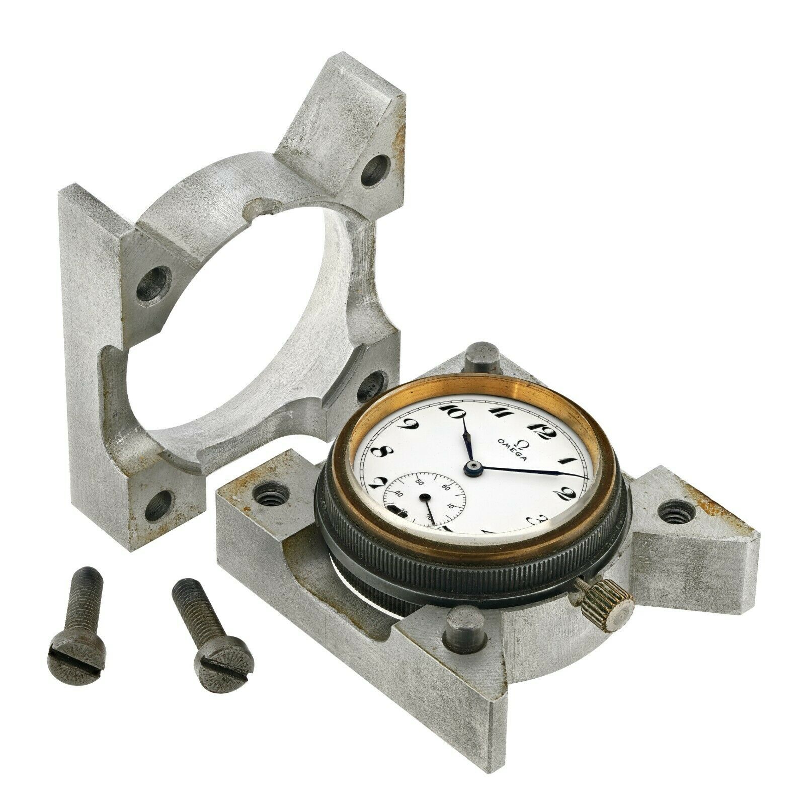

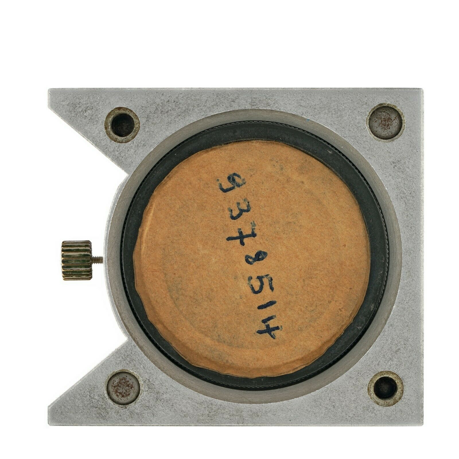

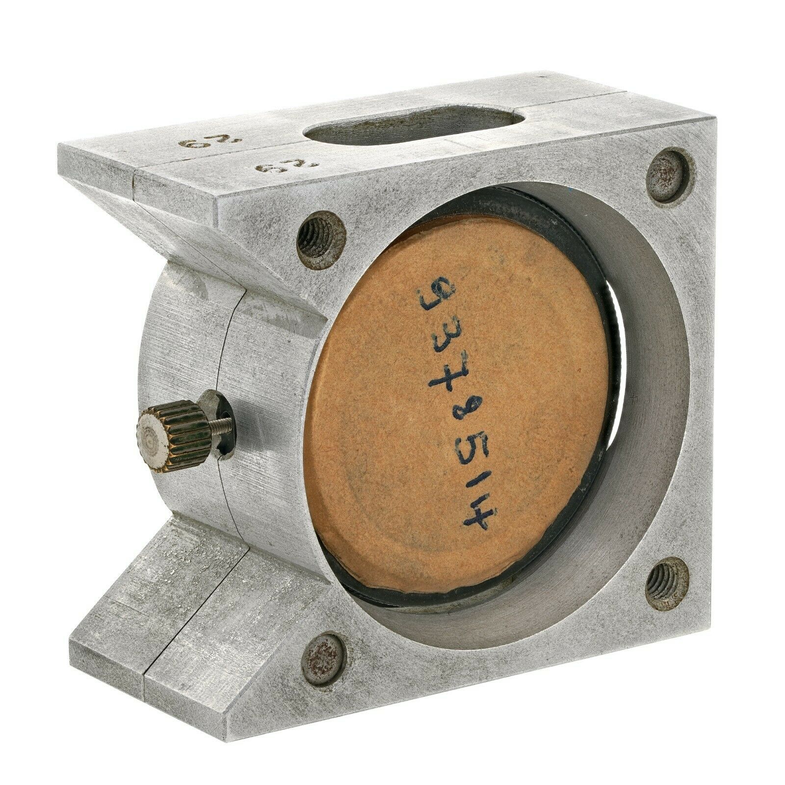

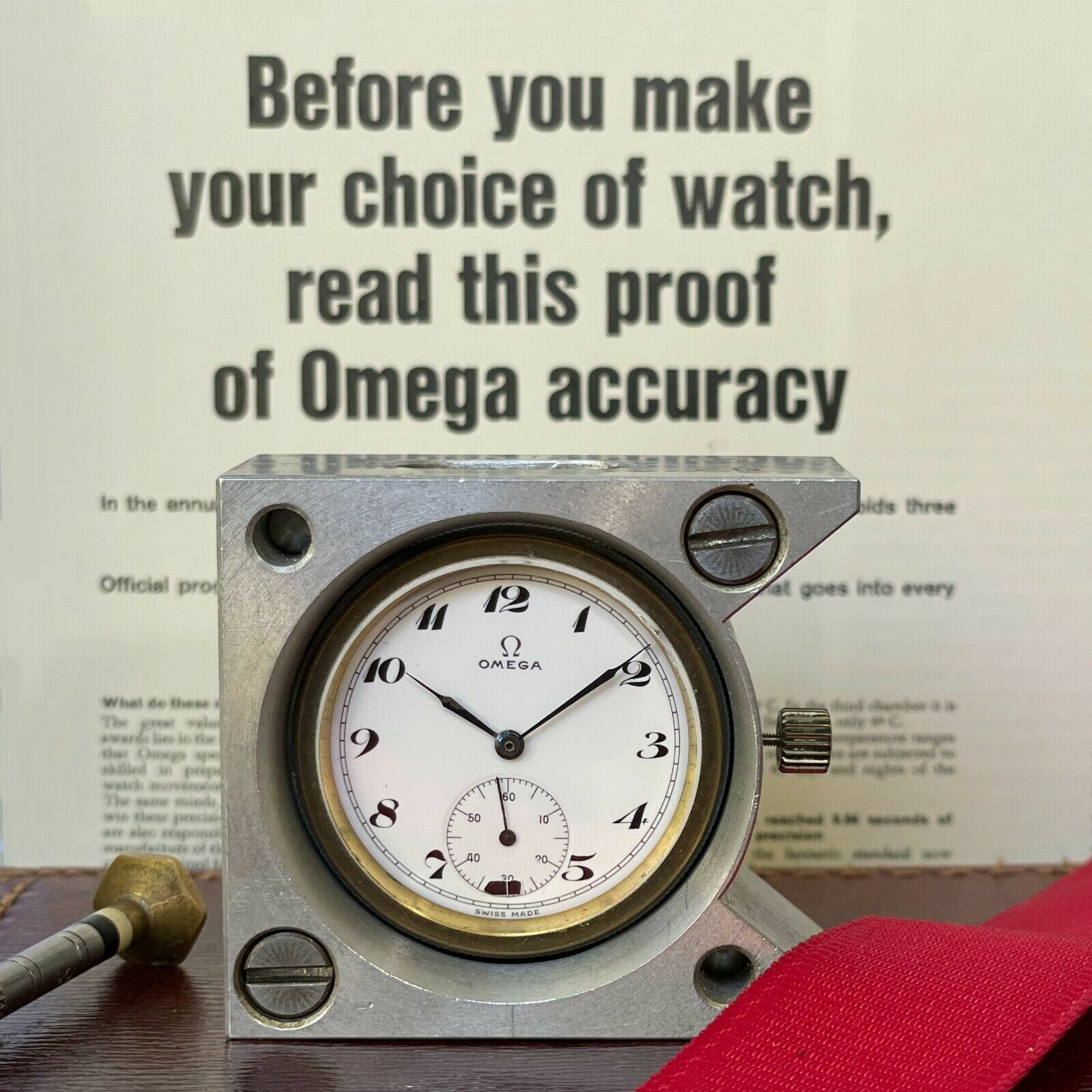

These are the classic blocks used for the movements to send to the Observatory Competitions. Sometime in wood rather than aluminum or other metal.
110
290
Thanks for the reply, I never seen this bock before, I thought it is a custom made case to hold the watch
35,780
40,054

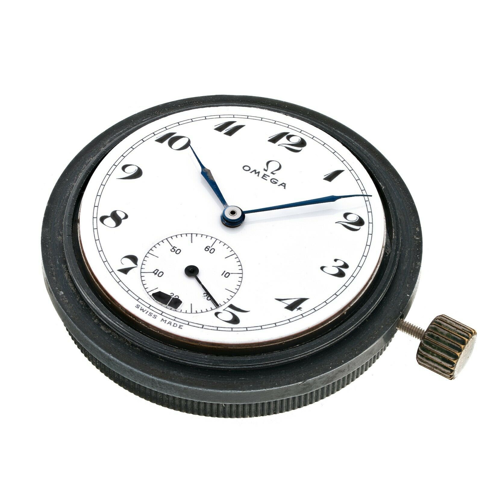

Nope, I think these blocks are due to the need for the movement to be tested in a variety of positions easily during the trials. These watches were not intended for casing and were sort of the best of the best, hand picked and find tuned to the absolute maximum in order to do as well as possible. It’d actually be cool to get one of these to @Archer and compare it to a regular 30T2RG to see what the difference is finishing wise and how well it does all of these years later. Omega, Zenith and Patek were three of the main competitors in this era trading wins, and this movement even eventually ended up forming the basis of the first ever wristwatch Tourbillon.

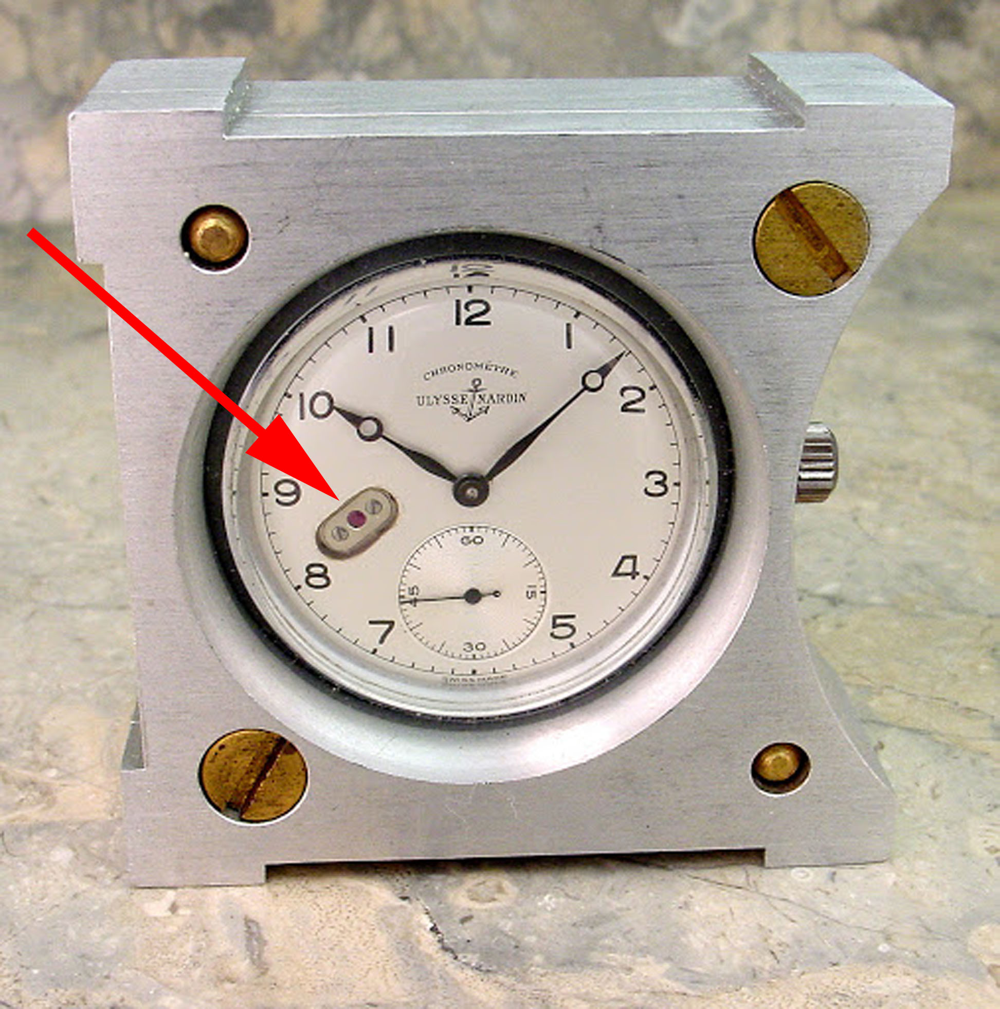

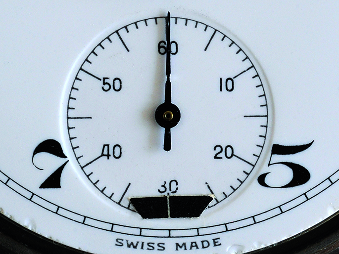

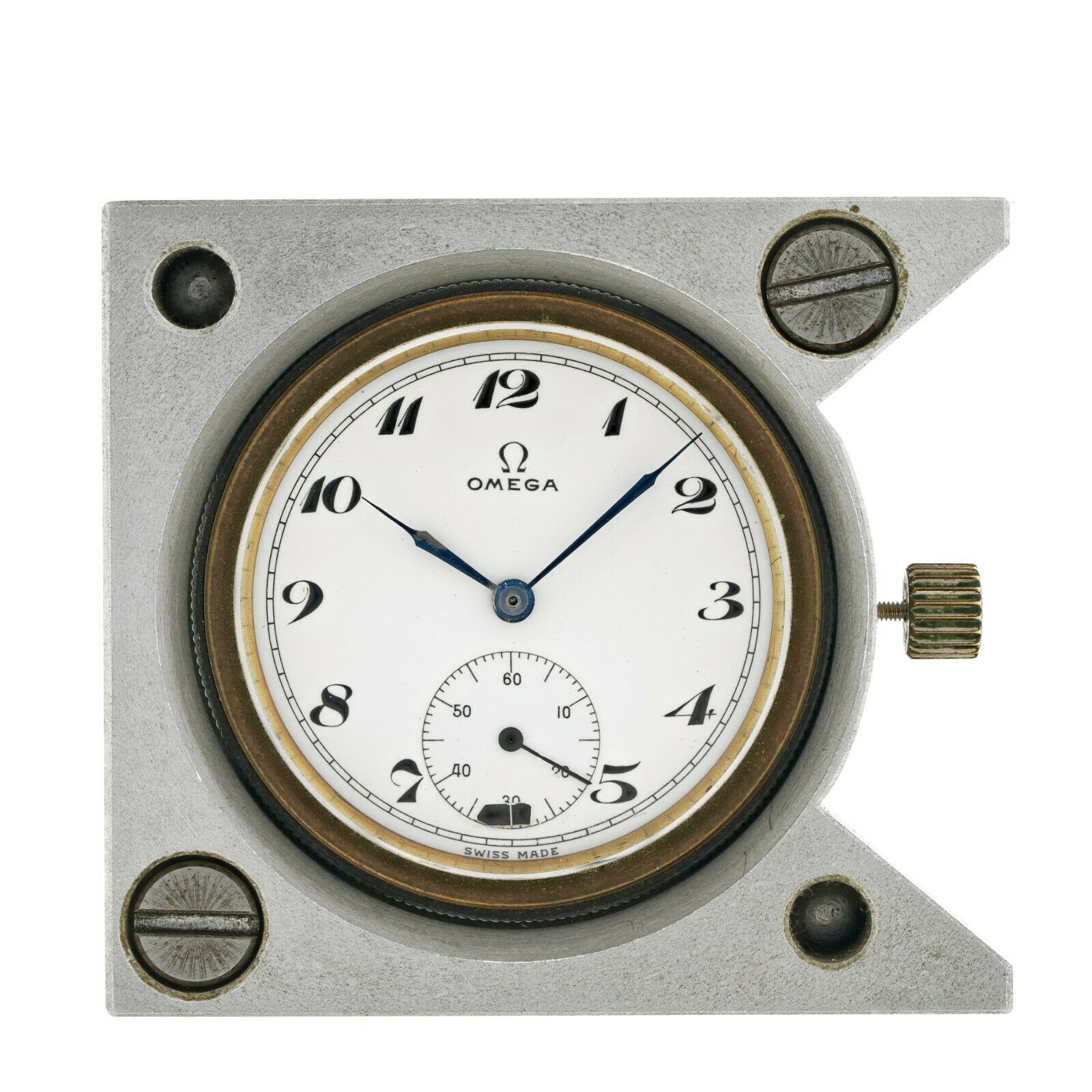

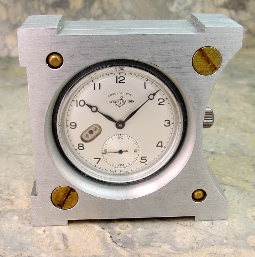

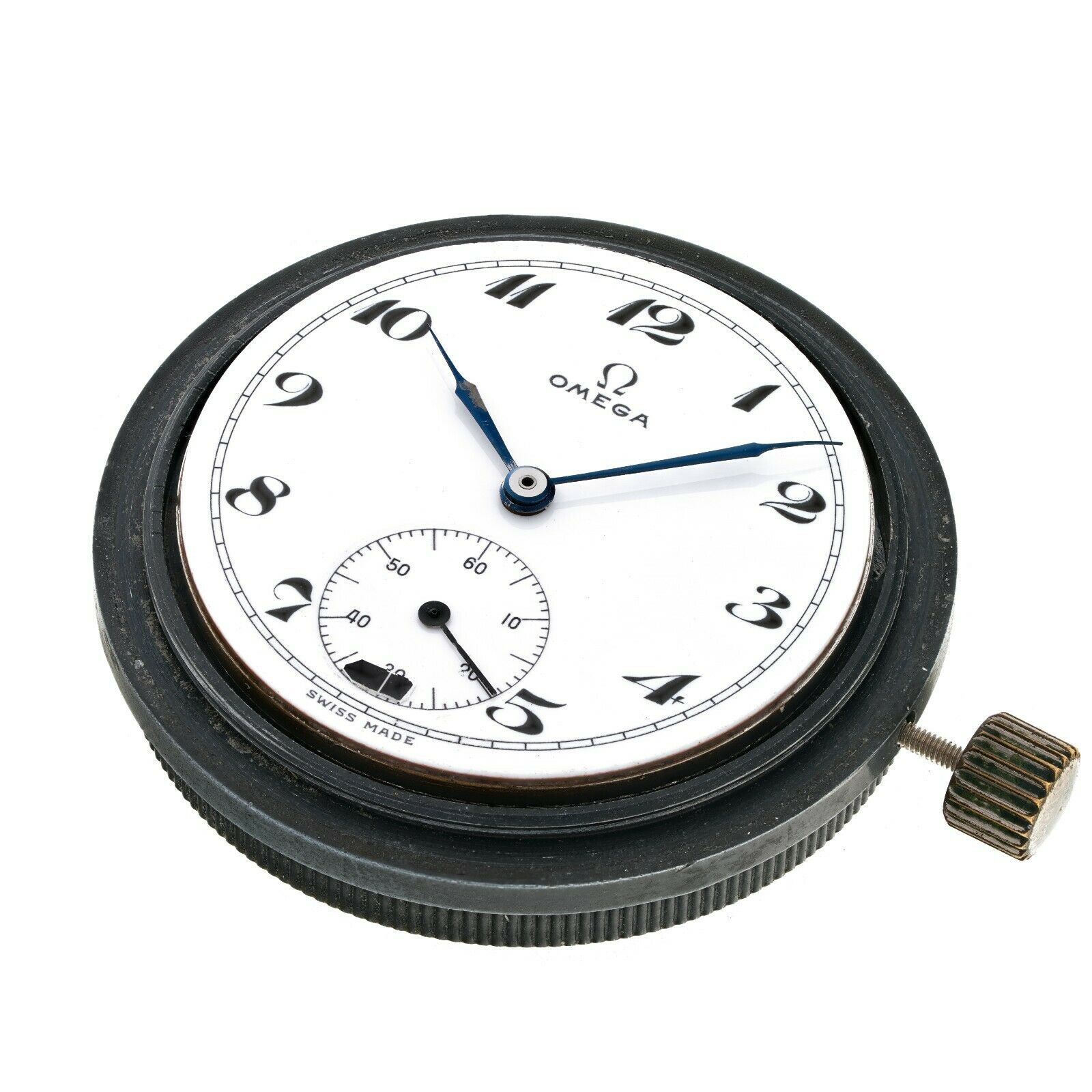

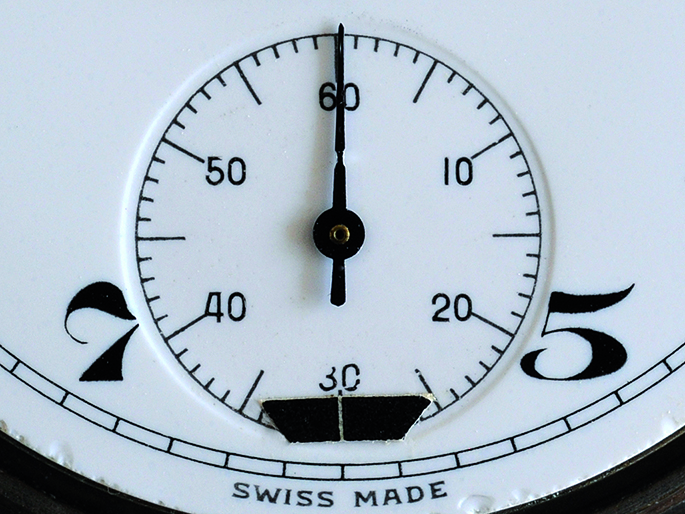

What’s the deal at 6 o clock?
8,292
29,363
It's typical, but missing a second one. The markings allowed for more precise measurements of the second hand. As the hand moves across the sub-dial, it completely blacks out the section of tape, and then again on the second piece ten seconds later.

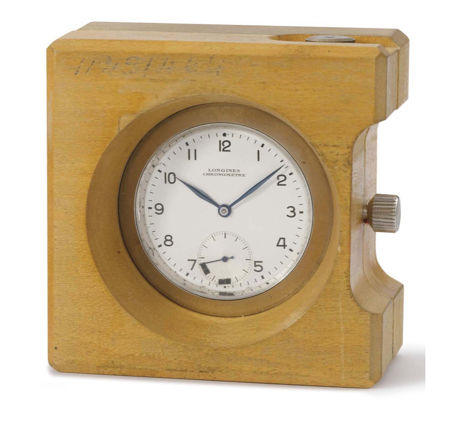

Another of many examples:
609
789

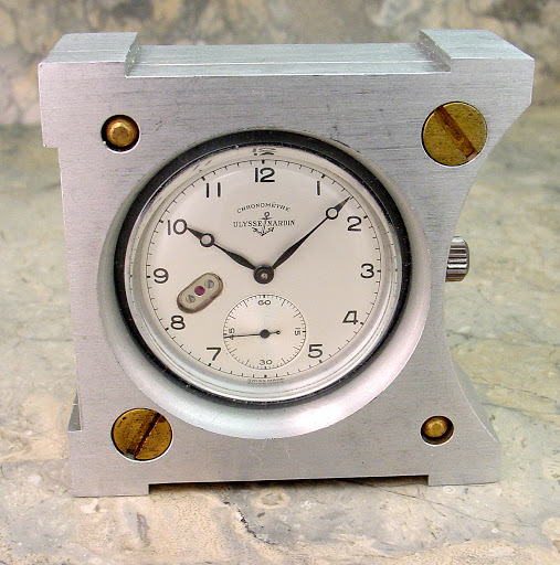

In other cases there are proper windows in the dial allow to regulate the movement with the movement still in the block. Obviously in in different positions.

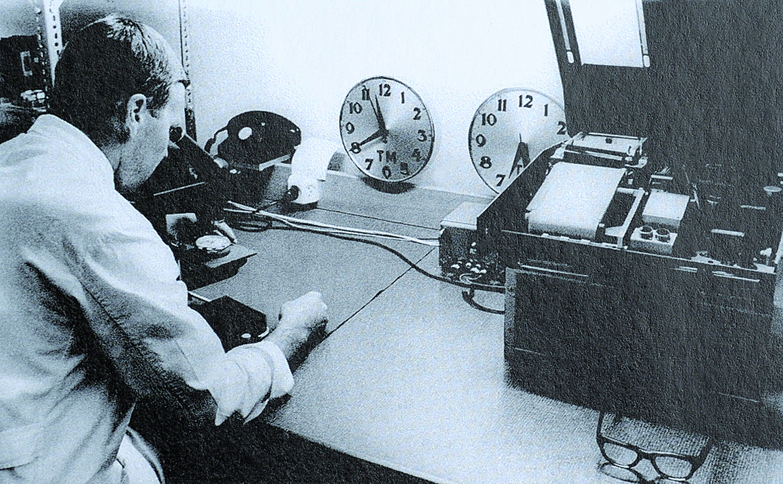

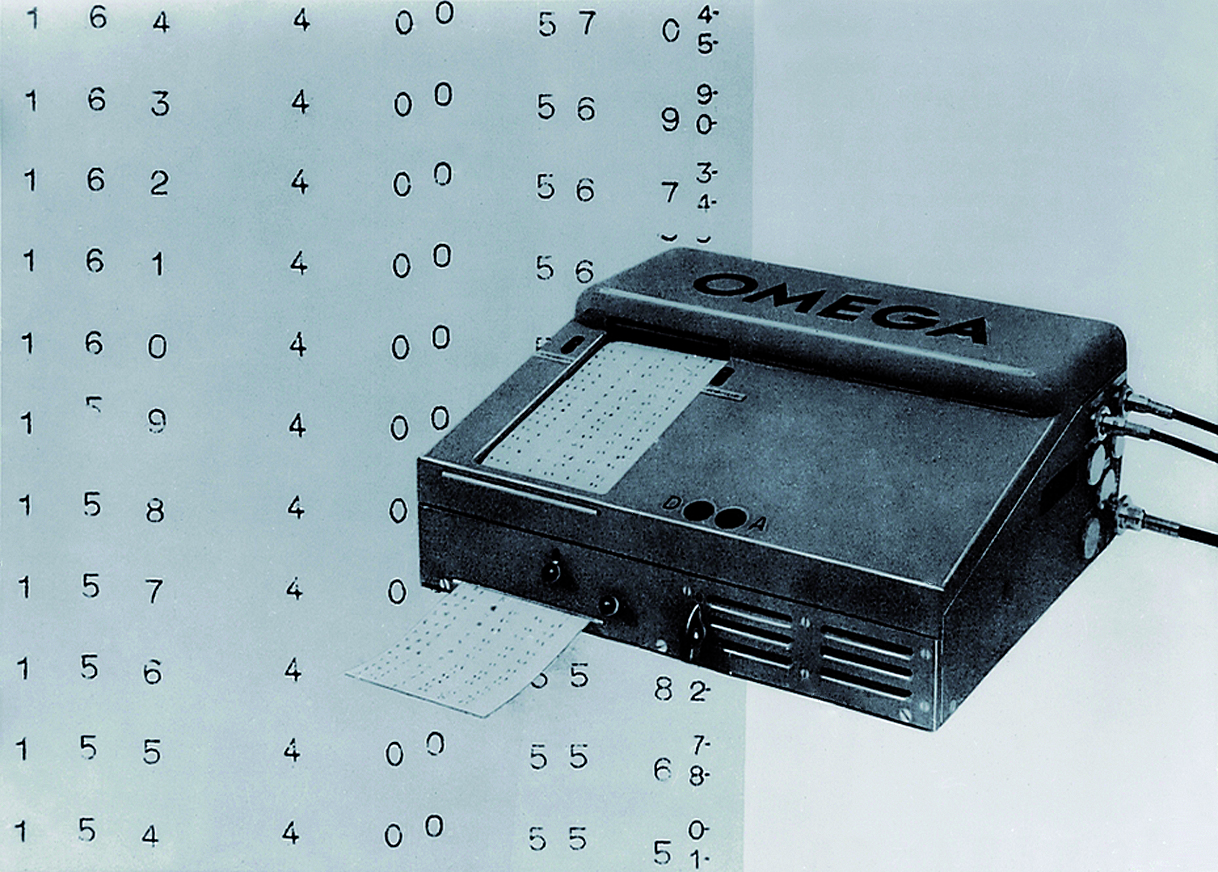

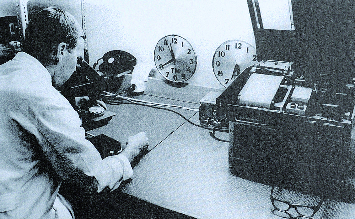

The precision time measuring was not taken "by eye" - it was performed electronically using a so-called time recorder, which was also used in athletic competitions.
When the second hand passed above the white line of the attached cardboard at six the timing machine was triggered by a photocell. The measure values were printed out on a paper strip and thus meticulously documented, accurate to one thousandth of a second.
above: the time recorder in the climate chamber
The last 2 photos courtesy by Omega - taken from my chronometer book

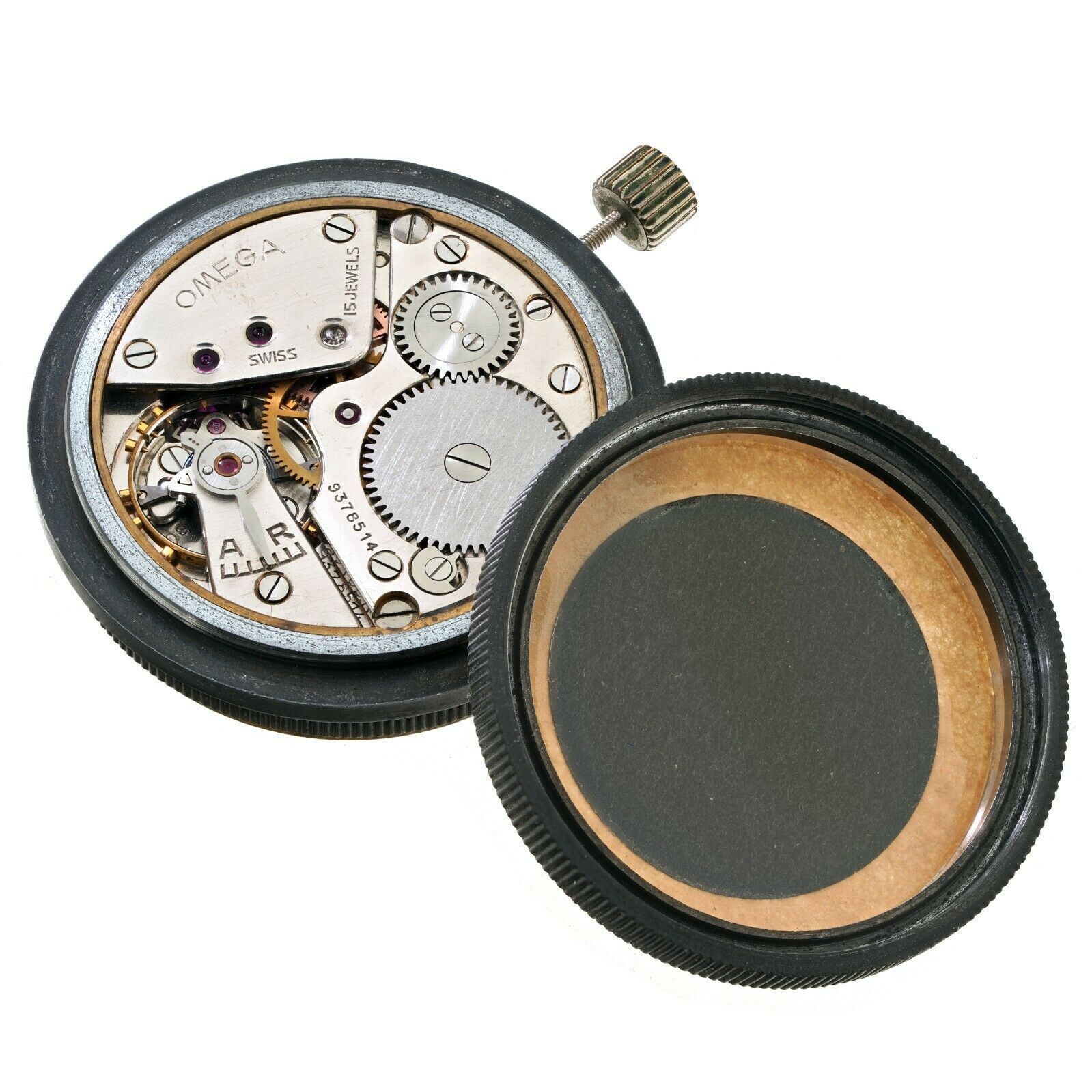

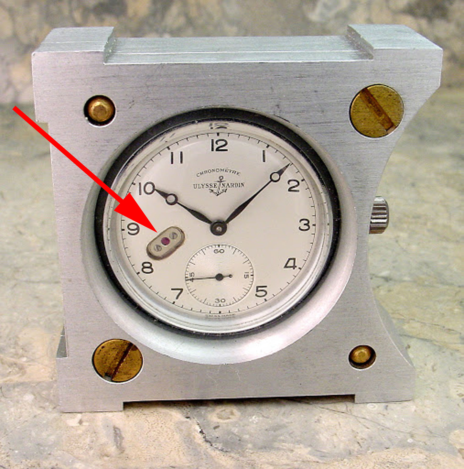

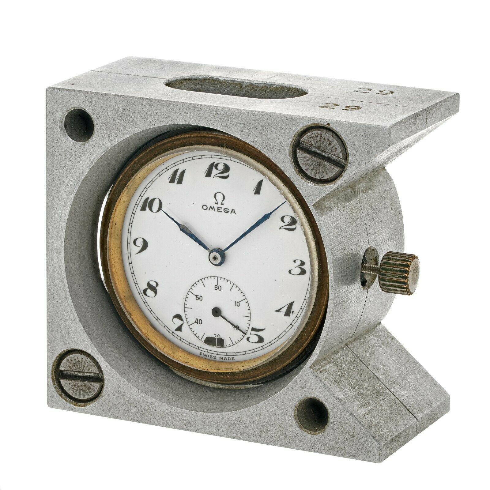

Are you referring to the spot at the red arrow?
If so, that has nothing to do with regulating the movement. That shows (for some reason) the cap jewel on one of the wheels in the movement. These are typically done on the balance, but could also be an escape wheel.
