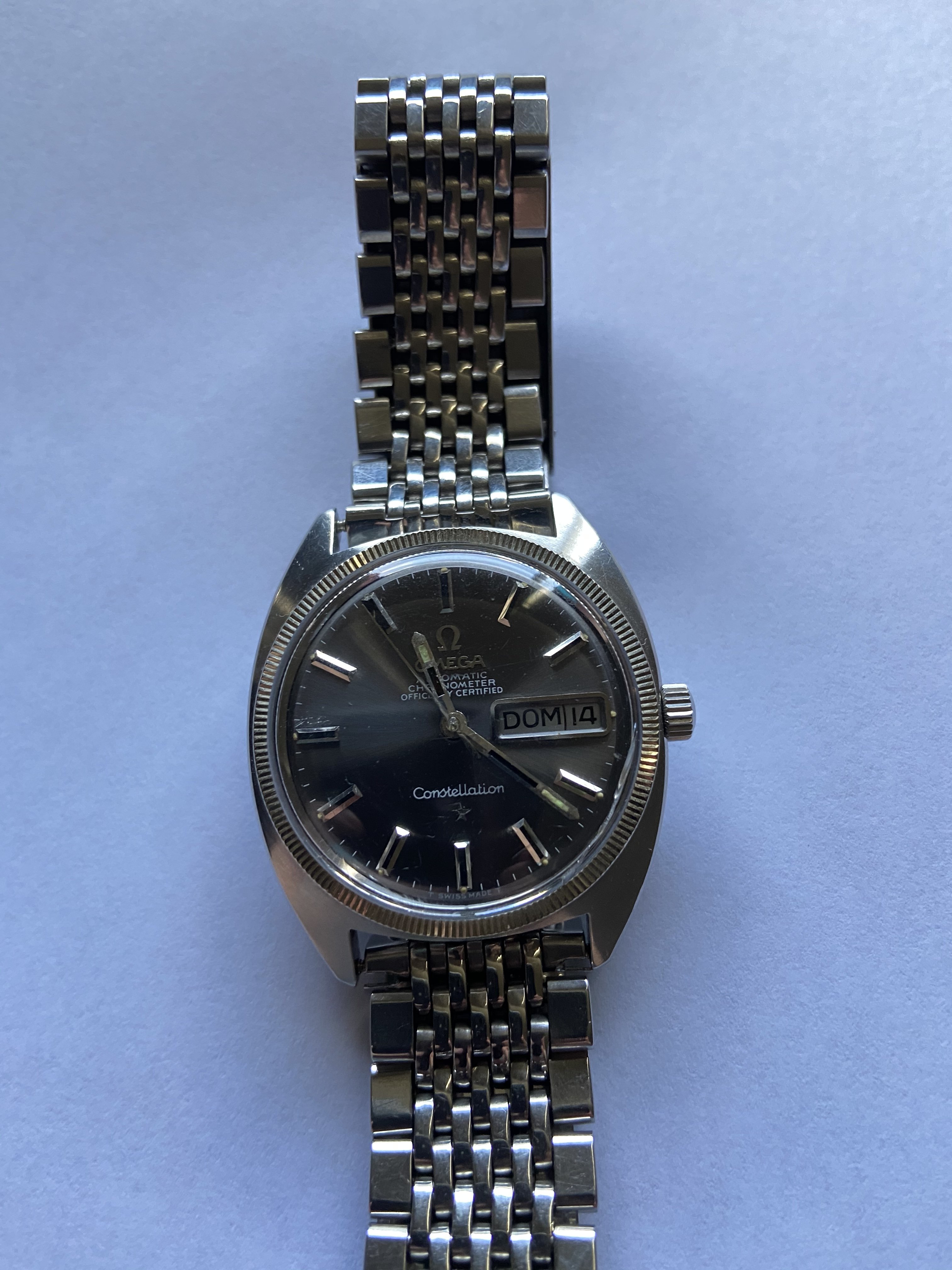

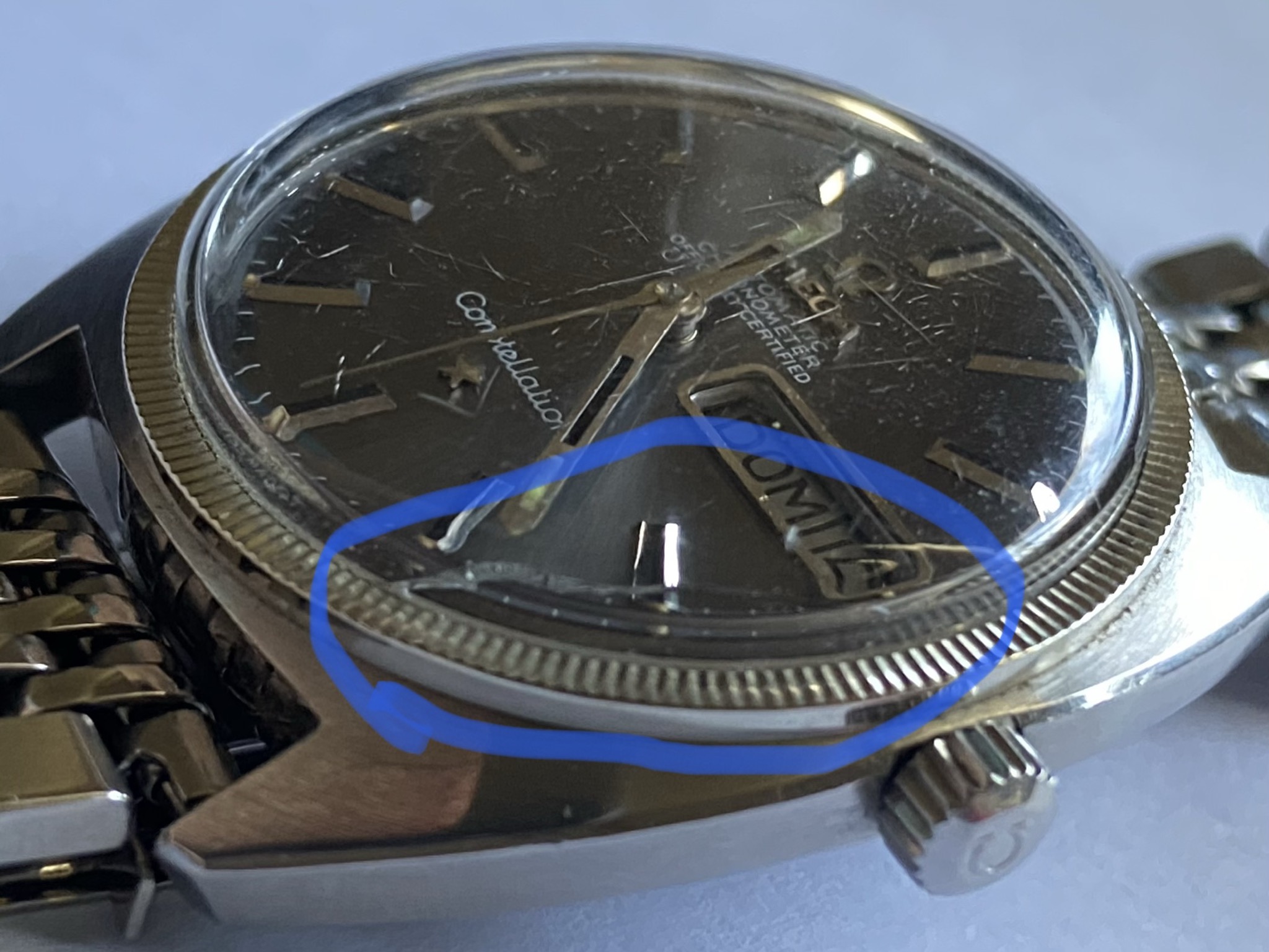

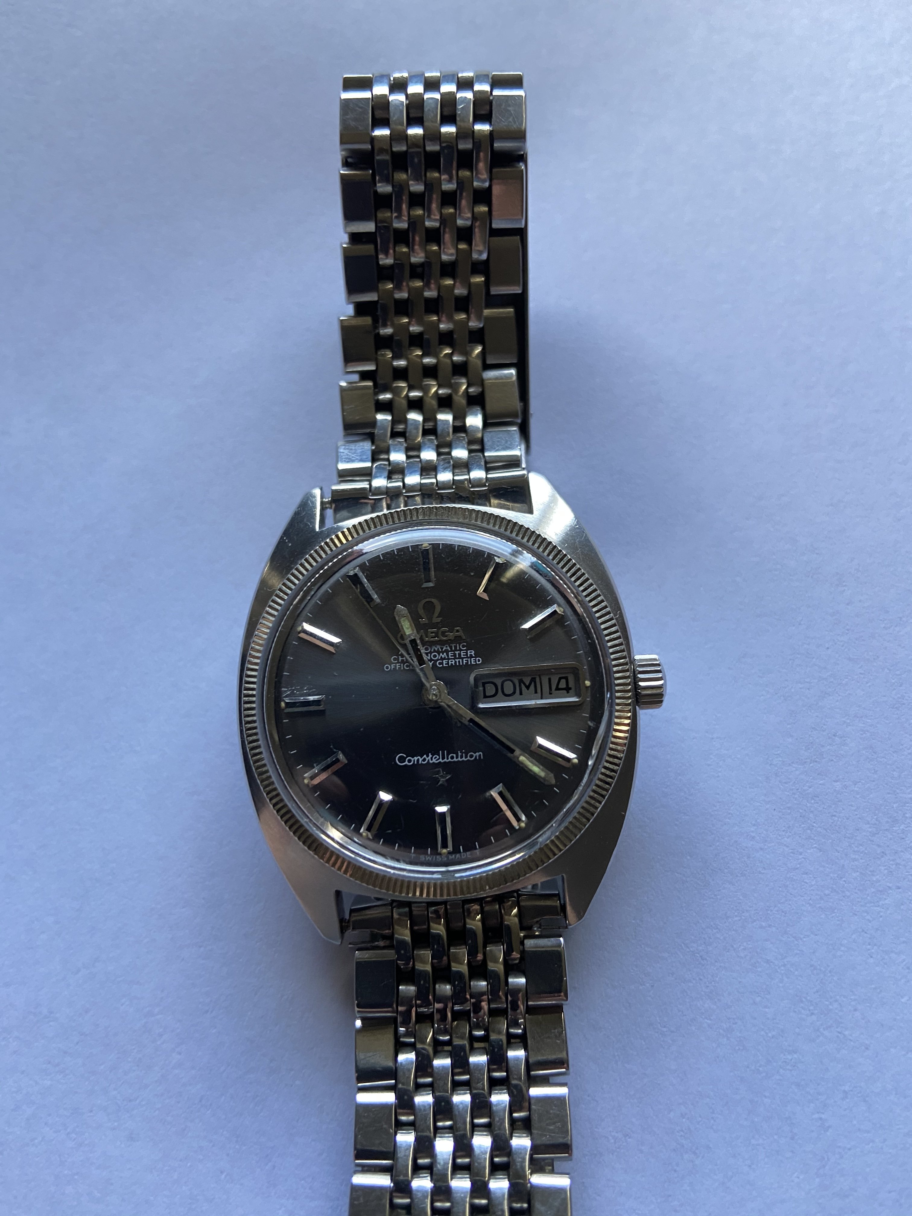

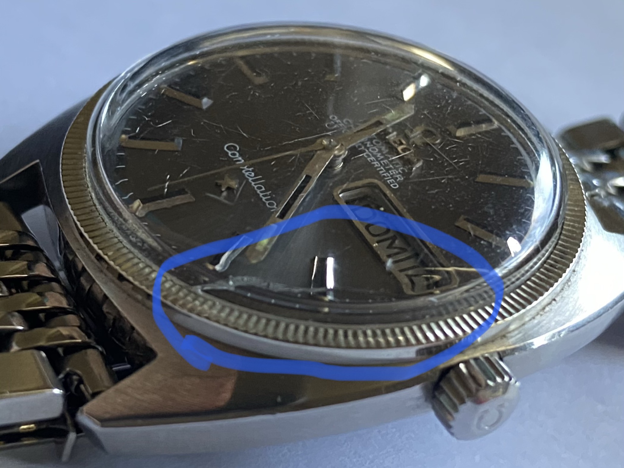

Hello everyone, I recently inherited an omega constellation which is from the early 70s I believe, the watch was my grandfathers and everything is in perfect condition except the crystal which got a small crack when I took it for maintenance but I have been having some trouble finding a replacement one, so I was hoping this forum could help me find one. Thanks in advance.

Sorry, are you saying that the crack happened whilst the watch was in for maintenance?
If yes, then shouldn't your watchmaker replace this free of charge ?
and PS - thats not a small crack - thats a large one !
PPS - pity, as its an original Omega crystal, as it has the symbol in the centre of the crystal

Yes the crack happened whilst the watch was in maintenance and they are going to replace it free of charge but they told that I needed to find the crystal myself, so any help finding one would be appreciated.

That should ne their job...but if you can tell me the case number inside the case back, I'll look up the part number for you.

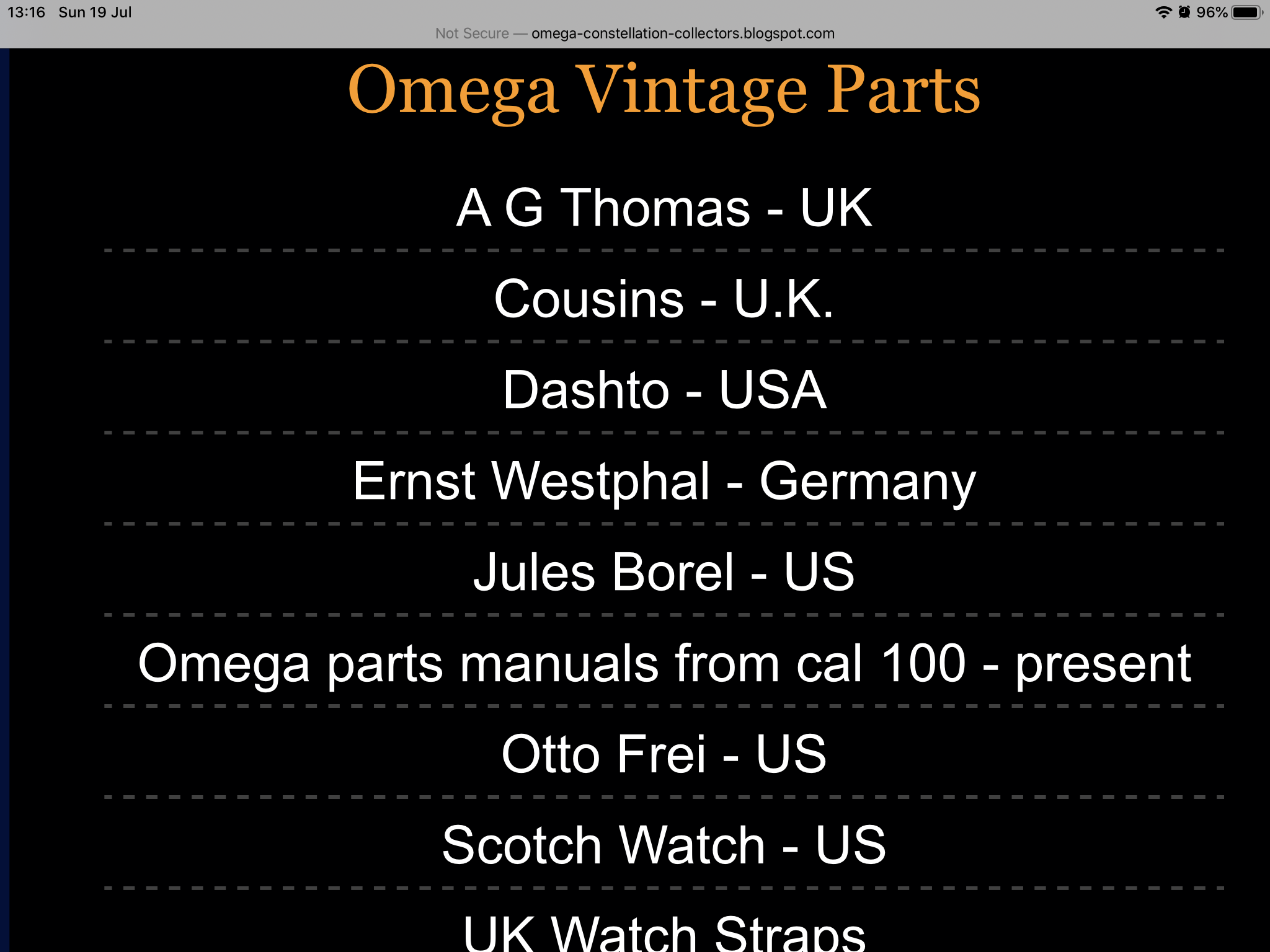

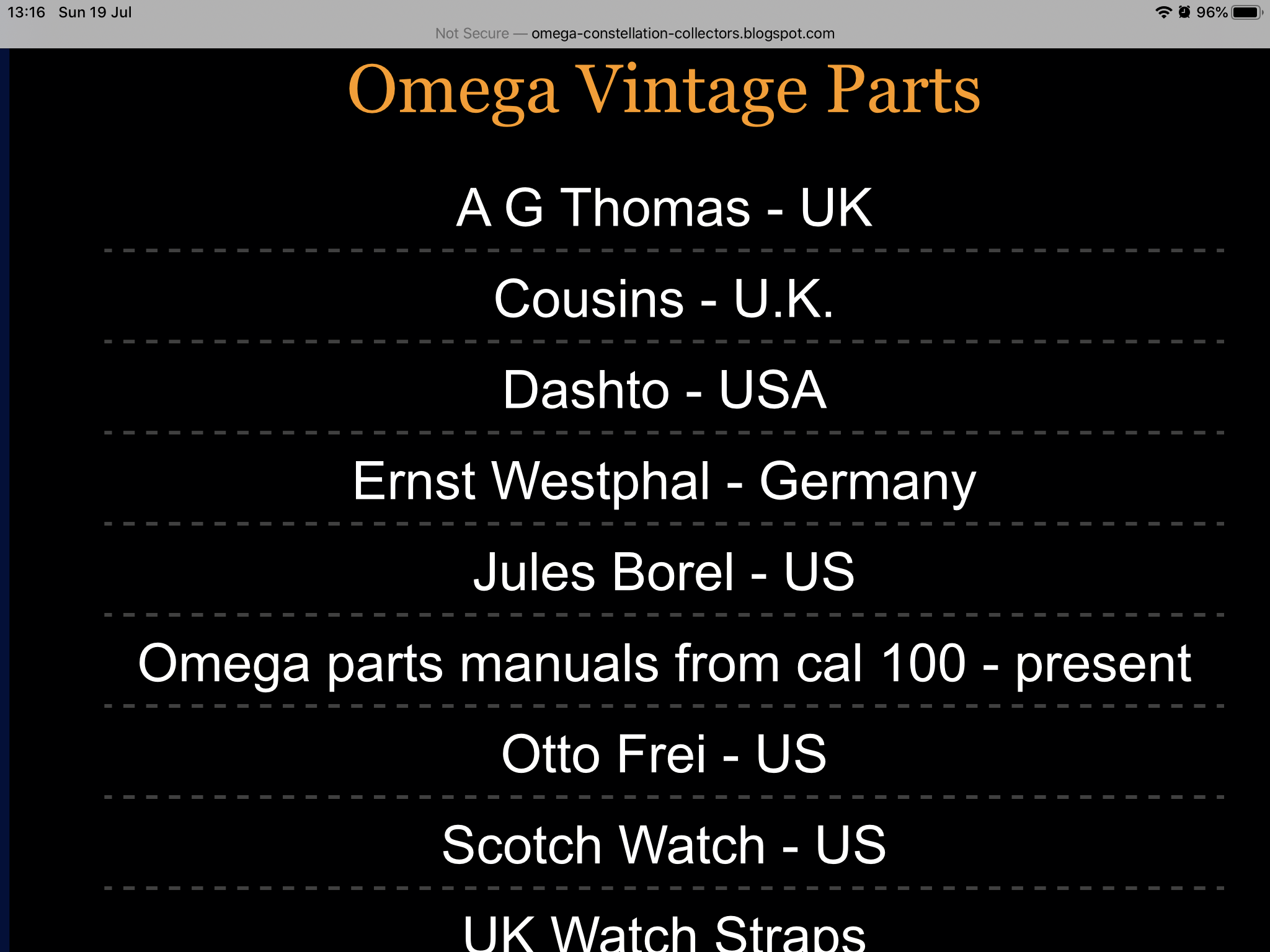

Have you tried the usual suspects? - screenshot shamelessly stolen from Desmond’s invaluable site

I have not yet looked at any websites other than this one, this is my first time with a problem like this so I figured I’d start in the forums, but with that being said I will definitely check out this website. Thanks.

It’s a C case with transitional dial script, a day/date and knurled bezel so has to be a ref 168.029 (unless a Franken which I don’t think it is). It can’t be anything else really!

I don’t know much about the watch itself but I appreciate the information you have given me and will see if it matches when I get the watch opened. Also I believe the bracelet is the “beads of rice” one is that so?

Crystal for that is 063PZ5118
