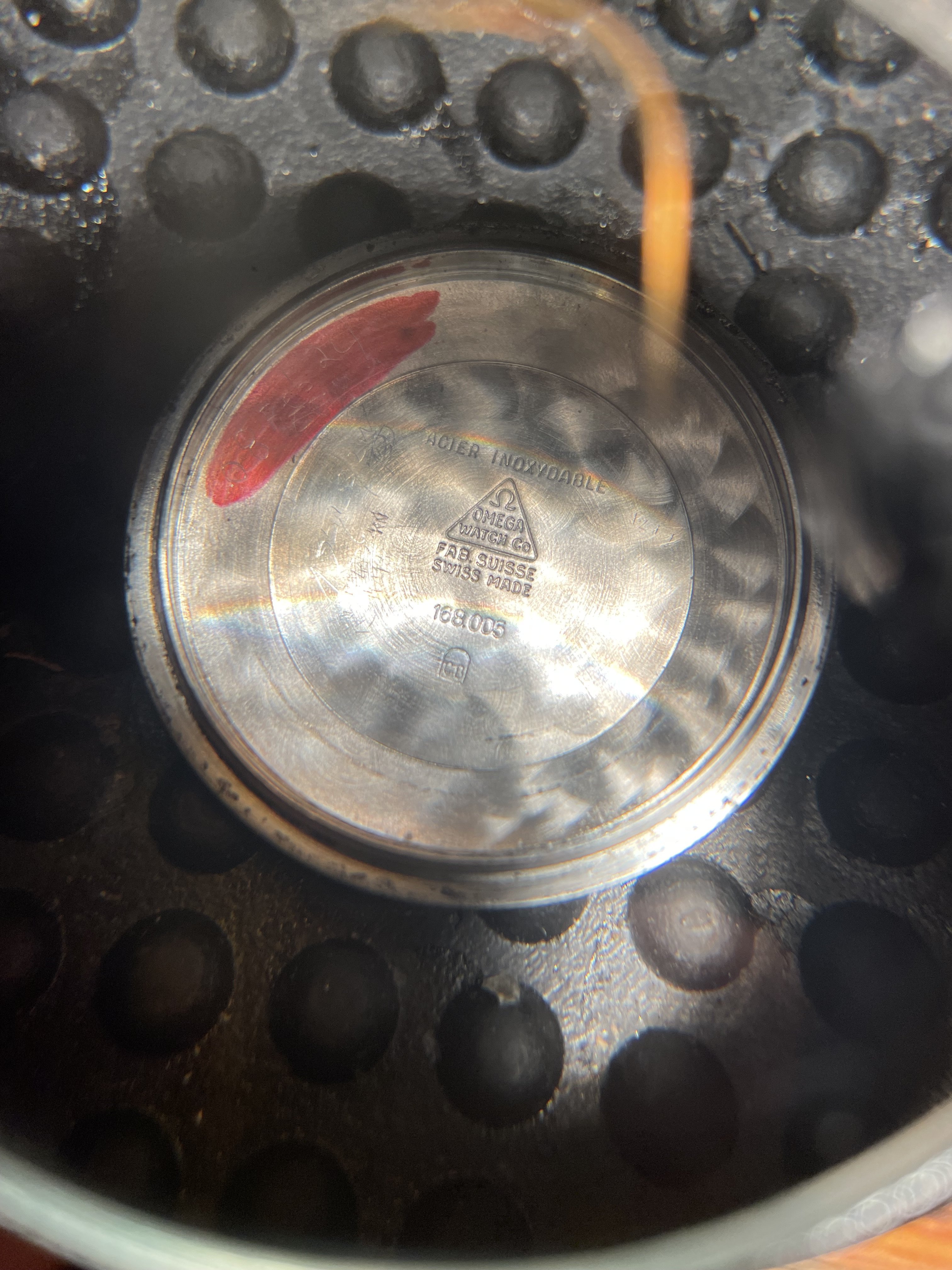

The dial on your watch does not belong to a 168.005.
Make sure your watch is a correct 168.005 then order the crystal.

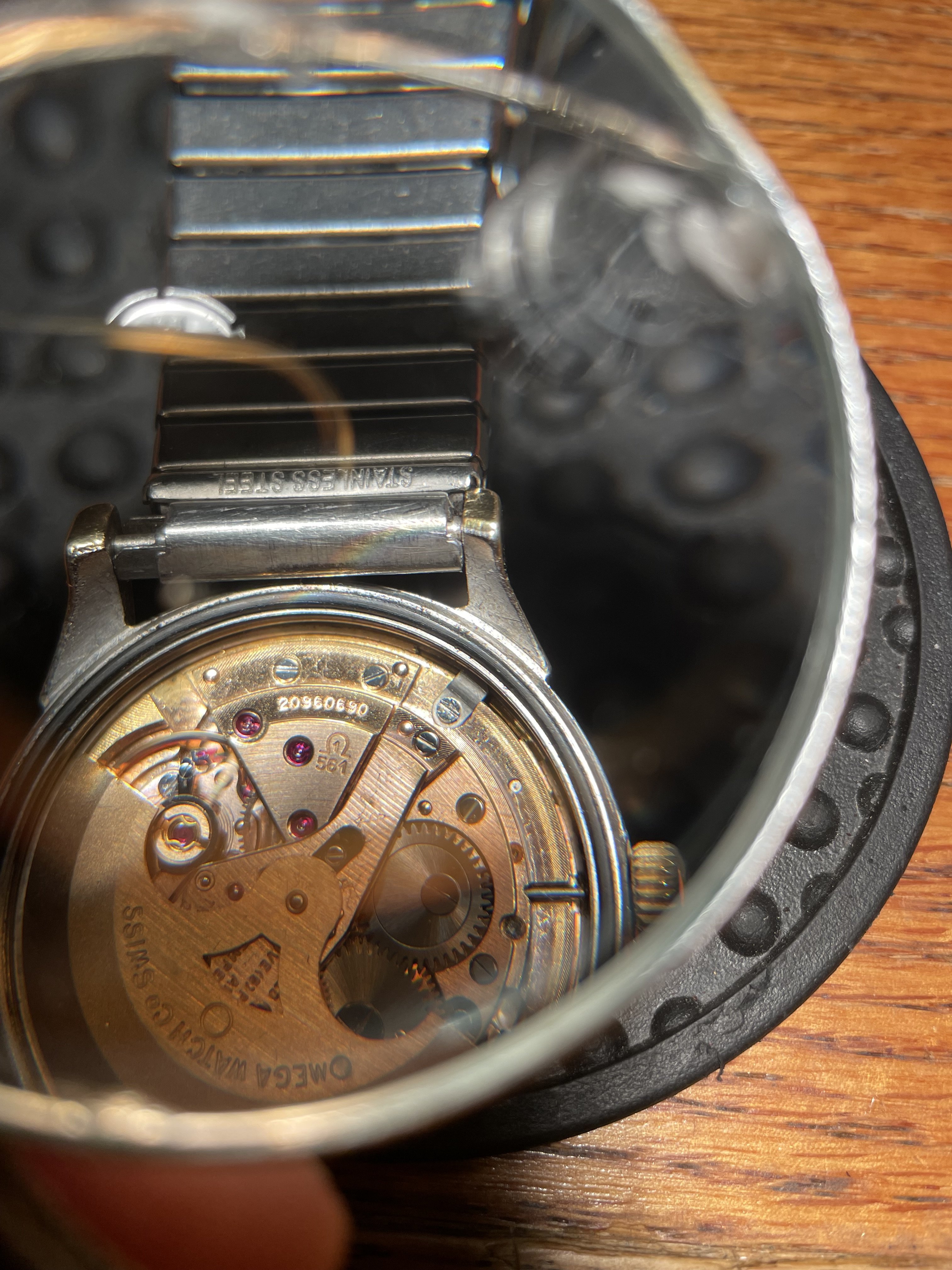

I'm attaching two more pictures, one that shows the inside of the back where you can see the numbers 168.005 stamped into the metal and another where you can see the serial number of the movement. Hoi, does this confirm it is a "correct 168.005?"

Here are the two further images so you can see the case reference number as well as the movement serial number:
I think it's more likely that dial is re-dialed. There are no minute tracks and the text aren't in a configuration or font that I've seen on a pie pan dial.

Just a follow up.....I took a really close look at my crystal and it does appear to be the original, or at least an original Omega crystal because I see the very, very tiny Omega symbol in the center of it when I'm looking at it from the inside out, as when I have the movement out of the watch. Tempted to get another original installed rather than a knock-off.....
