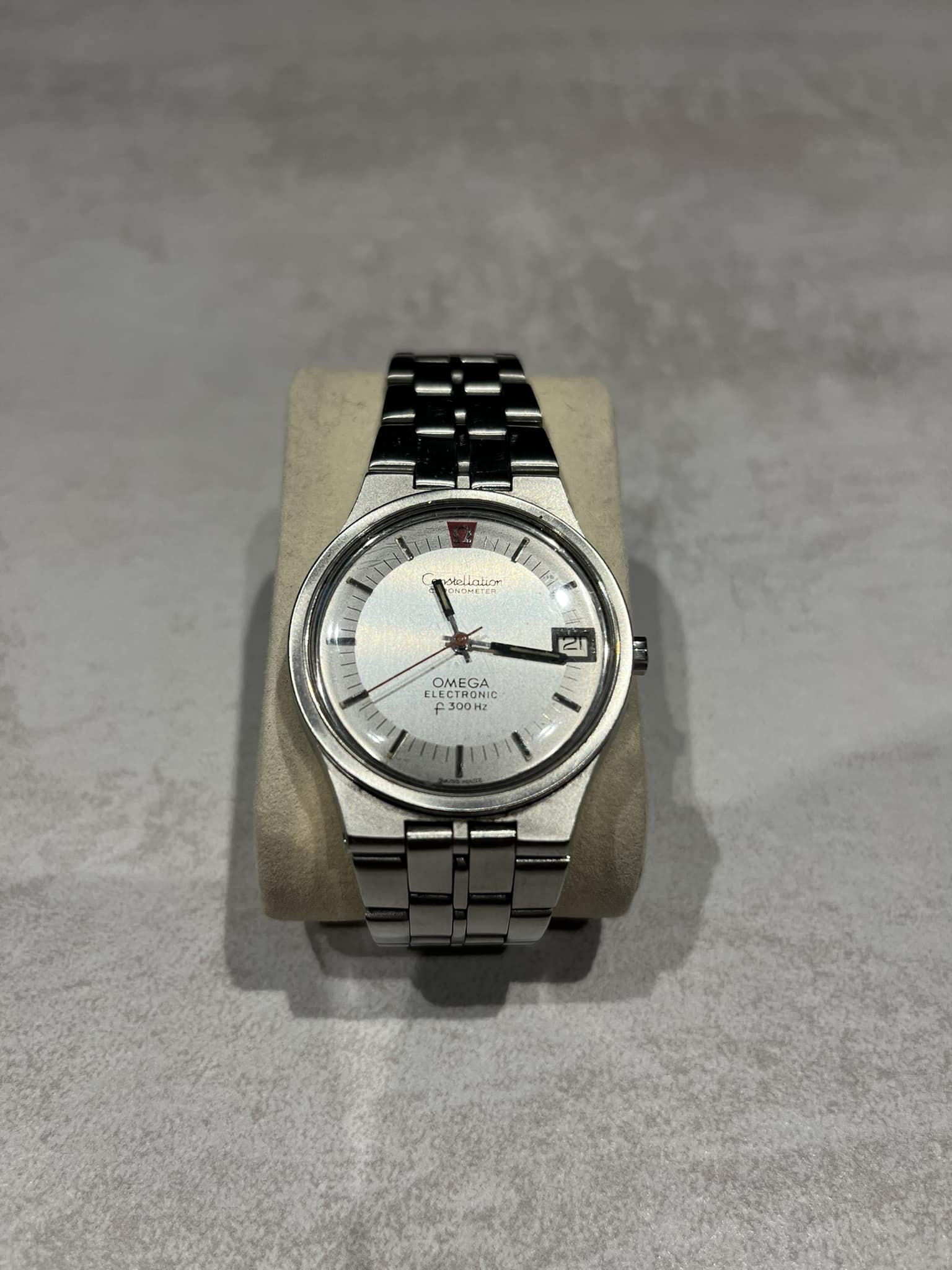

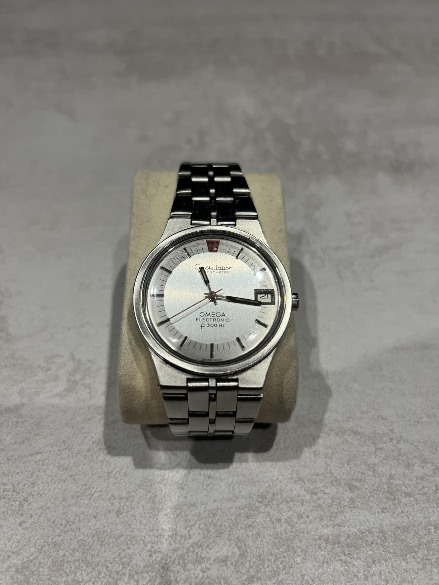

Hi guys,
I wondering if should buy this watch a friend of mine is proposing to me at 400 eur
I have already 2 Bulova Accutron Spaceview and I love this kind of movement
I am waiting for more photos.
What do you think ?

I like it and price seems ok. The integrated bracelet is cool, but would check it's in good nick and doesn't need any links or repair to fit your wrist as these may be hard to find.

Thank you guys for answering me. In the end didn't pull the trigger because the seller told me that the watch had some erratic behavior on changing the date, so I changed my mind and in the rush, I bought an Omega 1611 Albatros at a good price.

That’ll be broken teeth on the plastic date wheel. A common fault with these. Not good. You were wise to avoid.

Thank you padders for getting back to me , I saw this kind of problem in many 32Hz Constellation, I did,t know they have a plastic wheel for date , now it have more sense

Indded, very common to have a problem with the plastic date wheel .. not a major problem though ! The specialized watchmaker do replace those with a steel wheel today .. watch comes out like new ! 😉

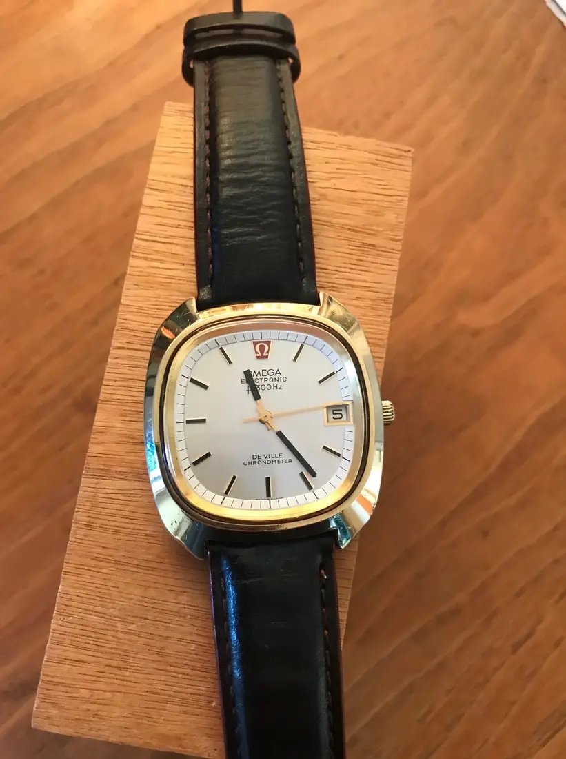

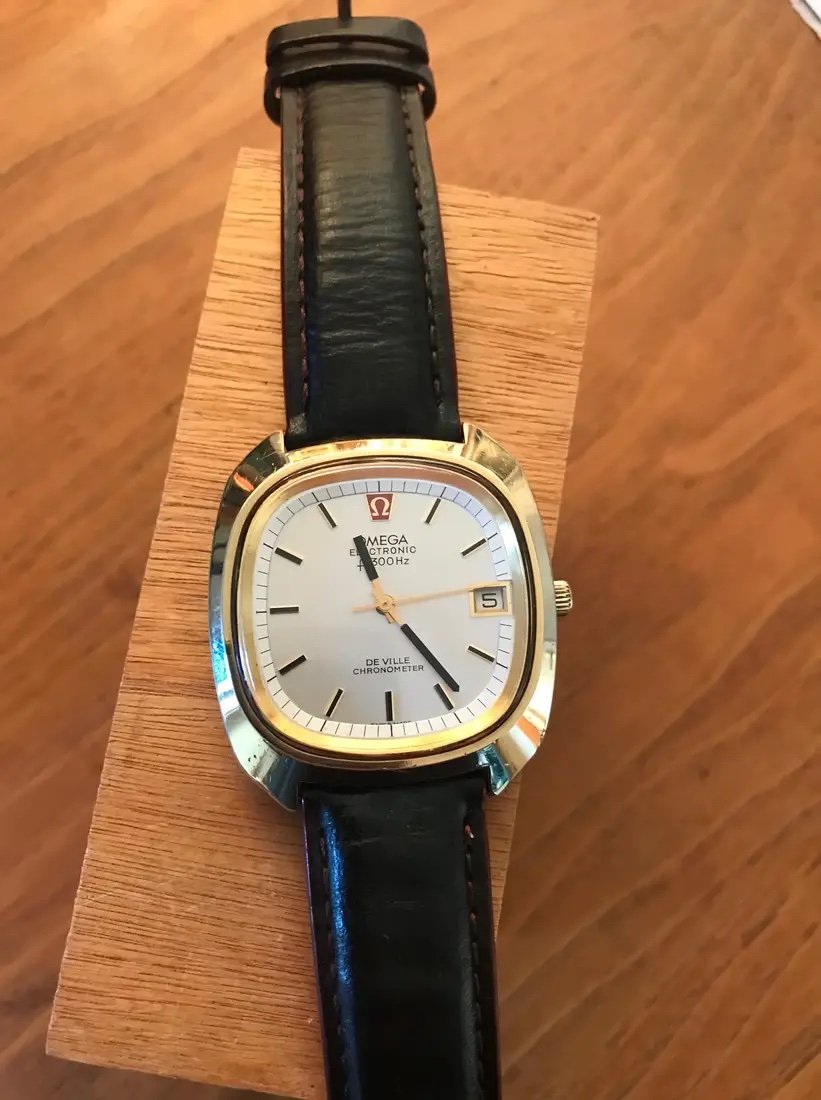

If and when that time comes, I'll give you the coordinates of the specialized watchmaker I am referring to ..
Here the watch he fixed for me
