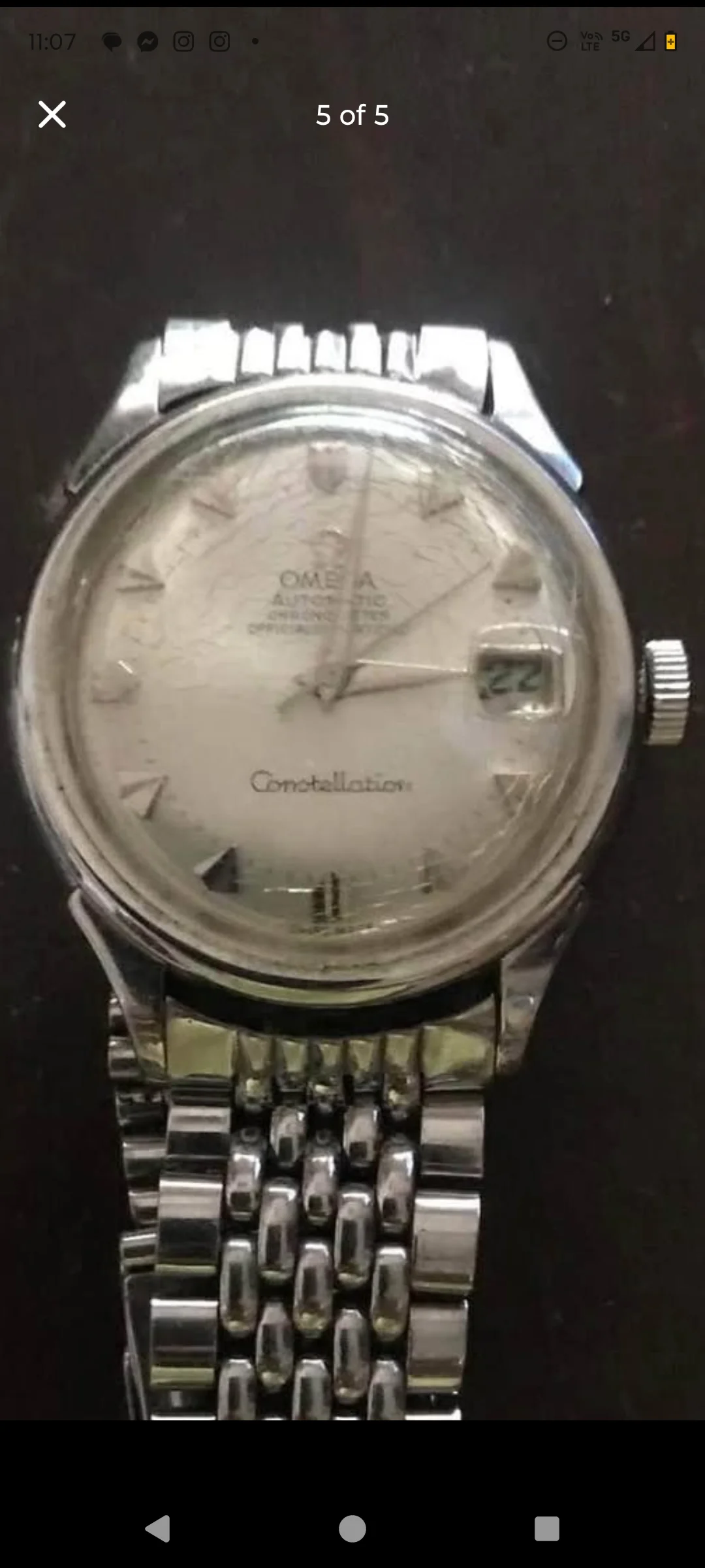

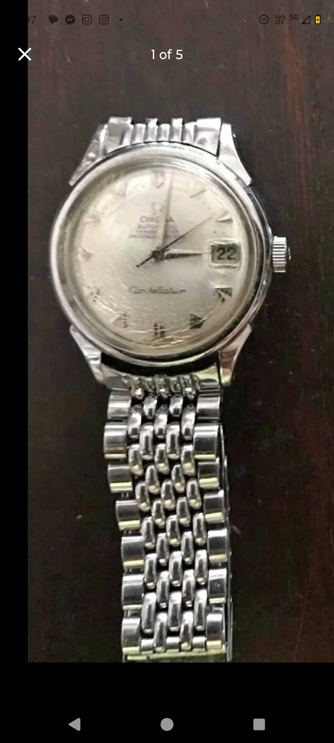

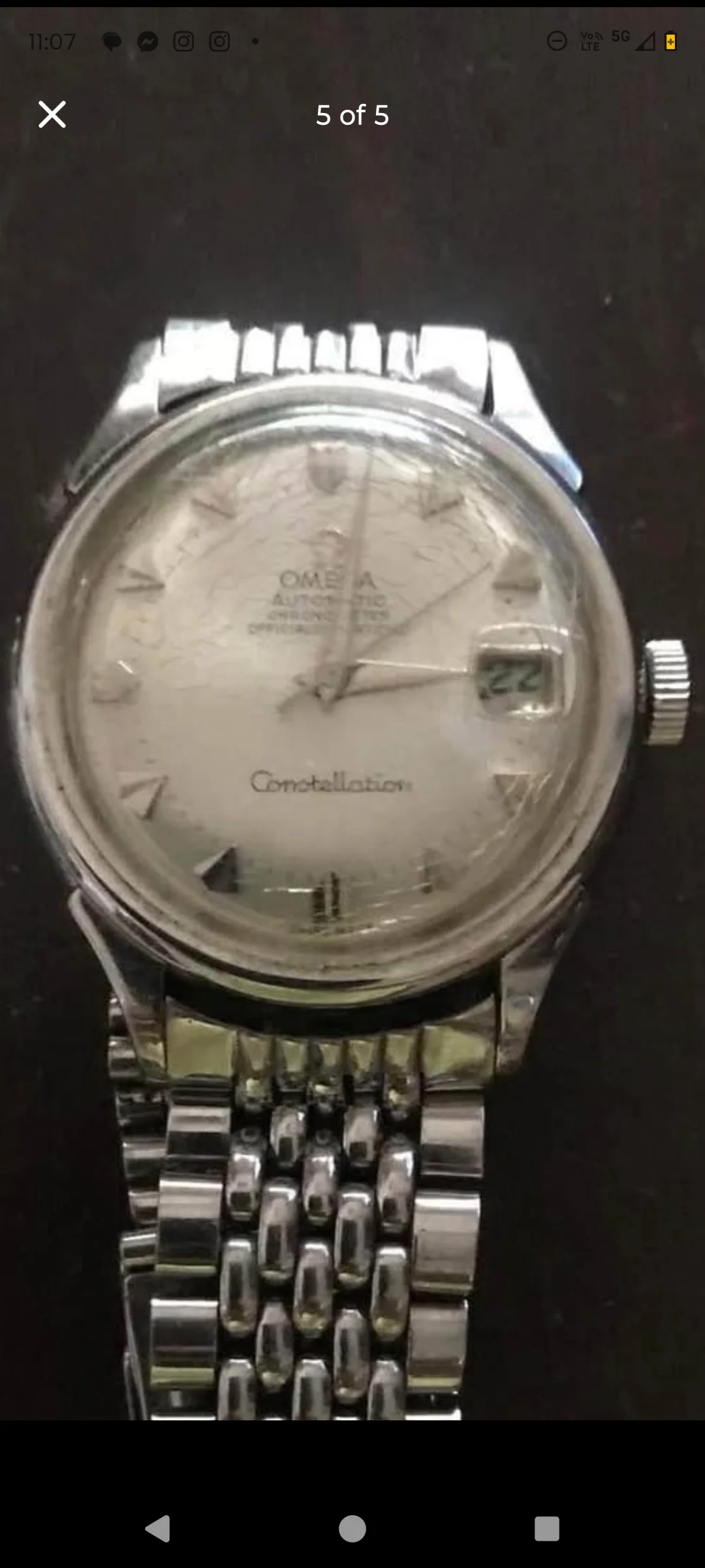

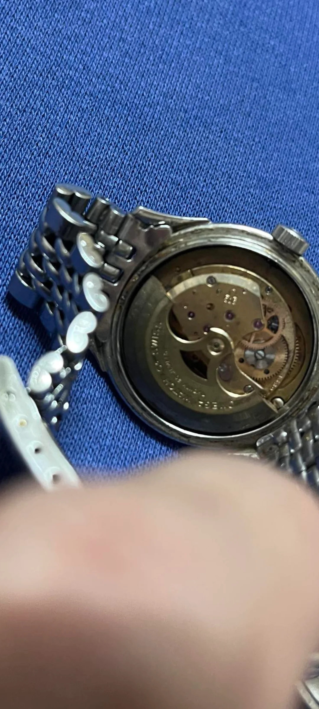

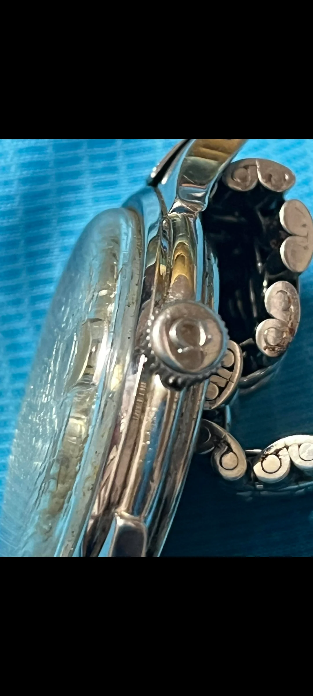

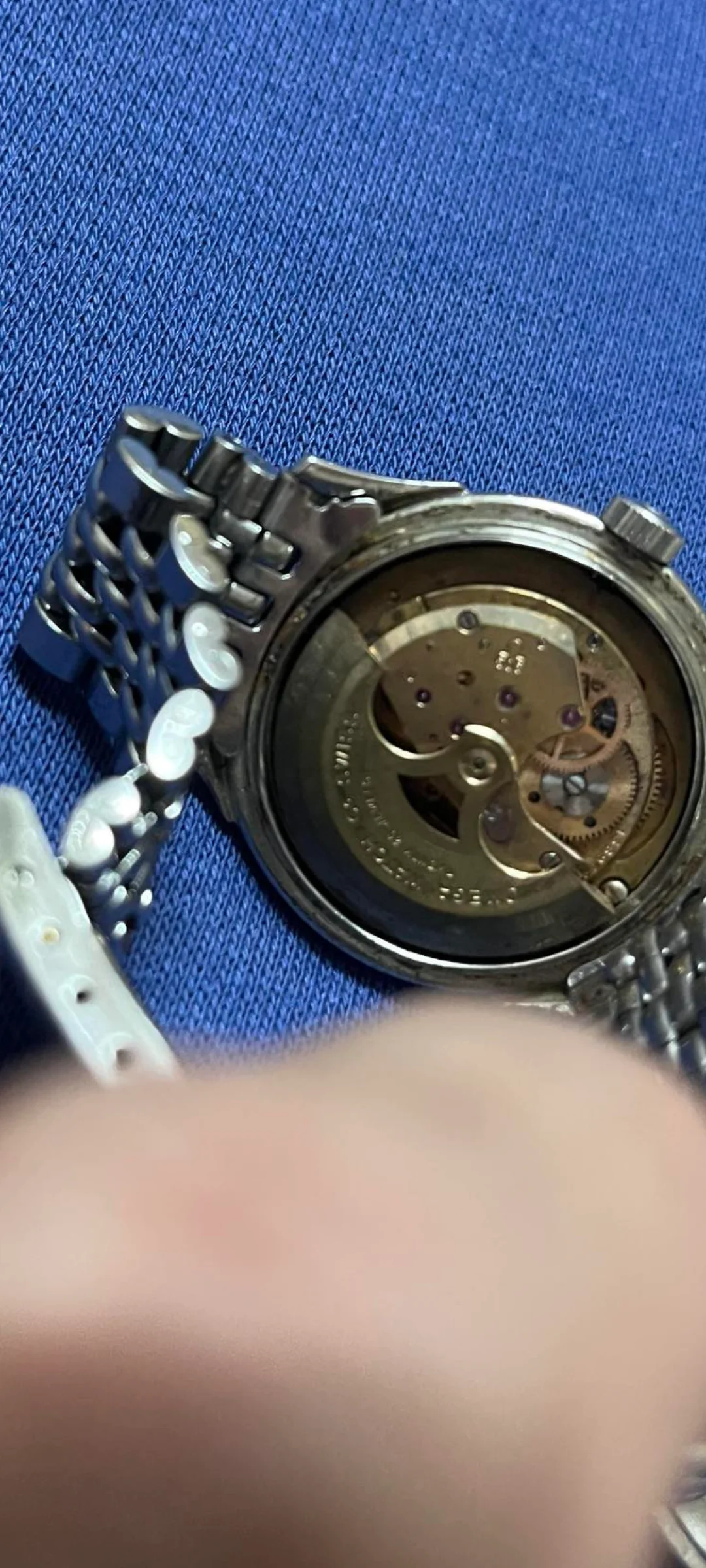

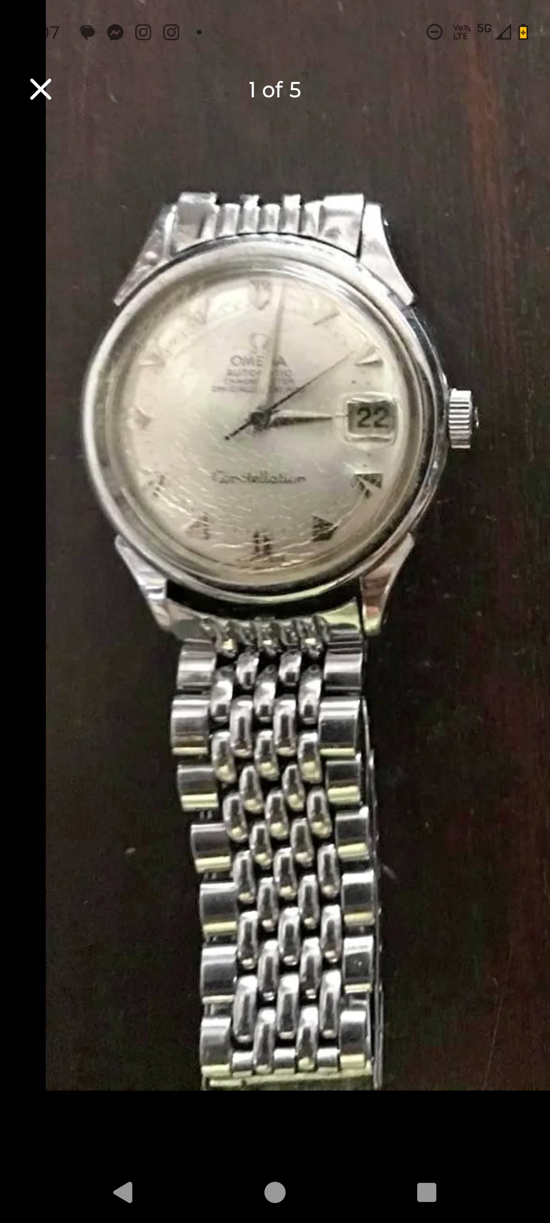

Hi everyone.
Apologies for the bad photos. It's all the seller was able to give me .
I assume this is a Omega Constellation 168.005 Arrow Head.

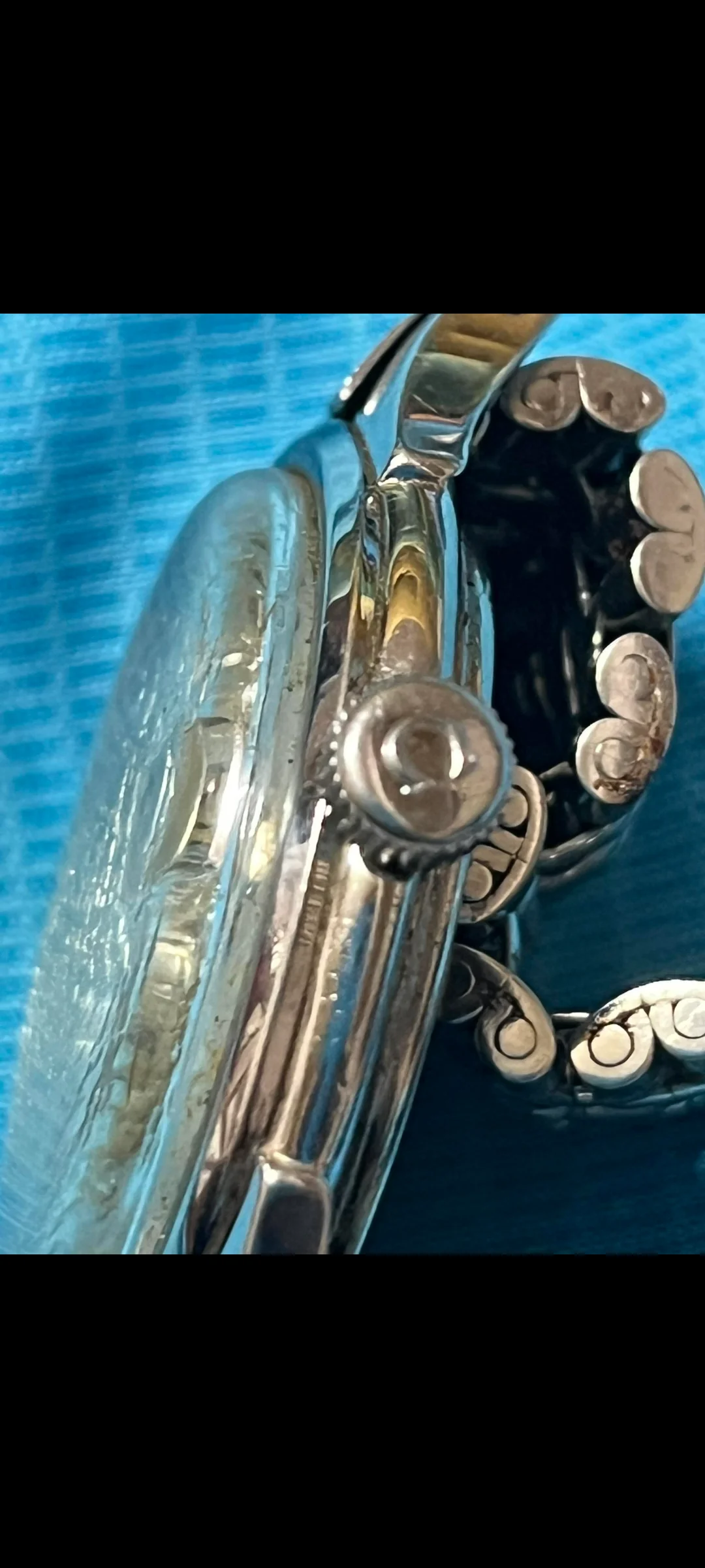

From what I can see. The dial seems to be in good shape. Crystal is toasted but that can be replaced. Watch would need a service .
Crown and bracelet is wrong (deal-breaker?)
Seller wants 500 USD$ for it. Worth the gamble or run?
24,843
55,270
The photos are suspiciously poor with the hands blocking the printing, but even with the awful photos, the dial looks wonky to me. I wouldn't buy it based on those photos unless you need some parts. I suspect that almost nothing is good about this watch. If he would take $100 for it, maybe it's worth a shot.
96
156
Surely it's harder to take photos that far out of focus than it is to take a decent snap these days. Sellers have to do better than that.
3,790
6,452
It is a 14393, not 168.005. Dial has been repainted and hands are too long.
Only good things are those arrowhead markers which can be removed then transplant onto a 168.005 dial that has black painted hour markers.
6,852
10,538

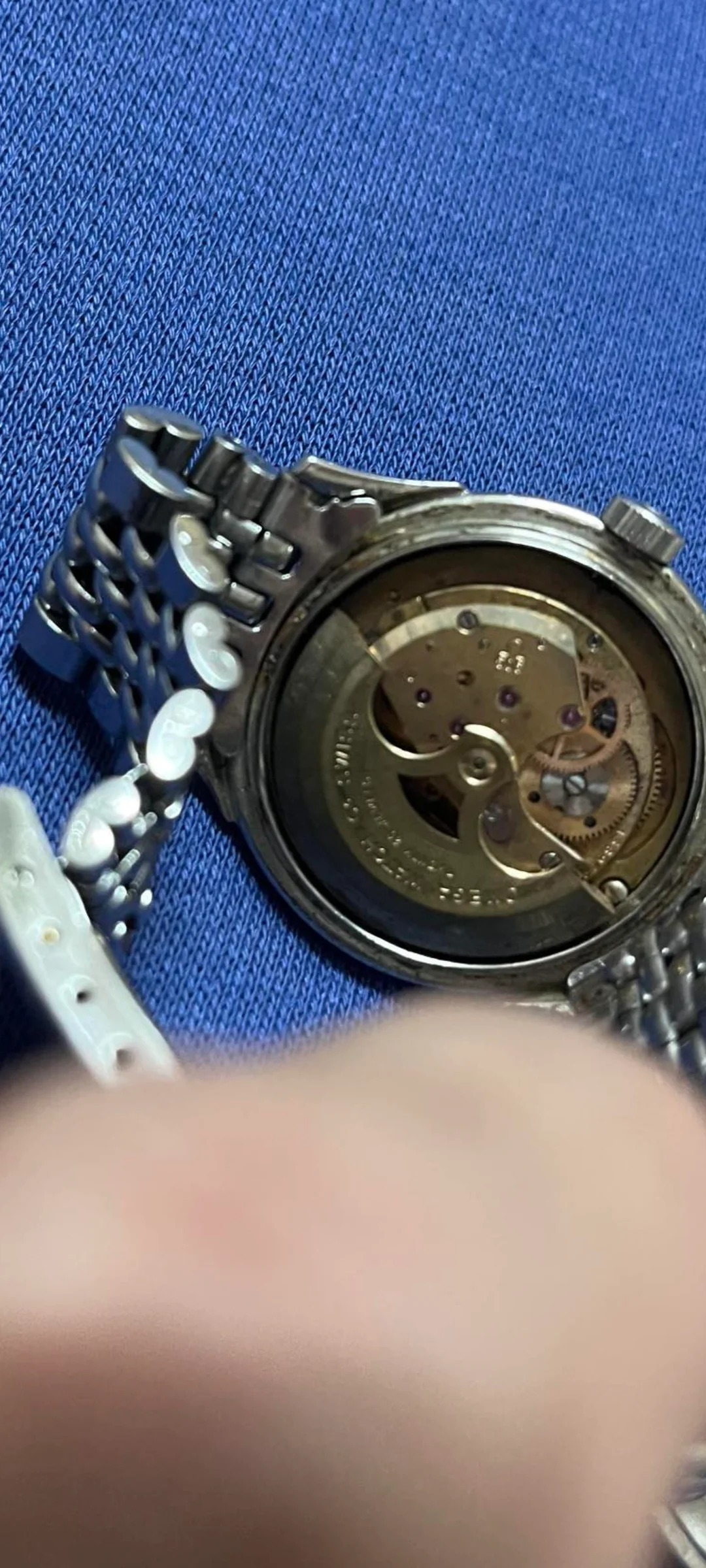

Perhaps earlier than a 14393 with that movt and spring bar holes in the lugs? 😉
The dial is a mess - it could even be a fake or at least made up dial as it’s missing the star.
I’d recommend you save your money and put it towards a decent watch.
