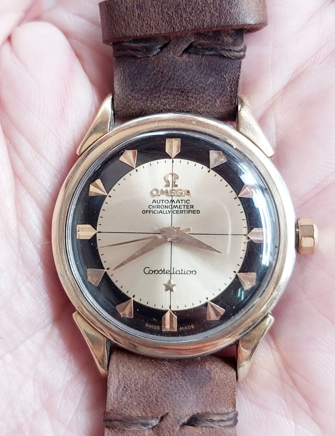

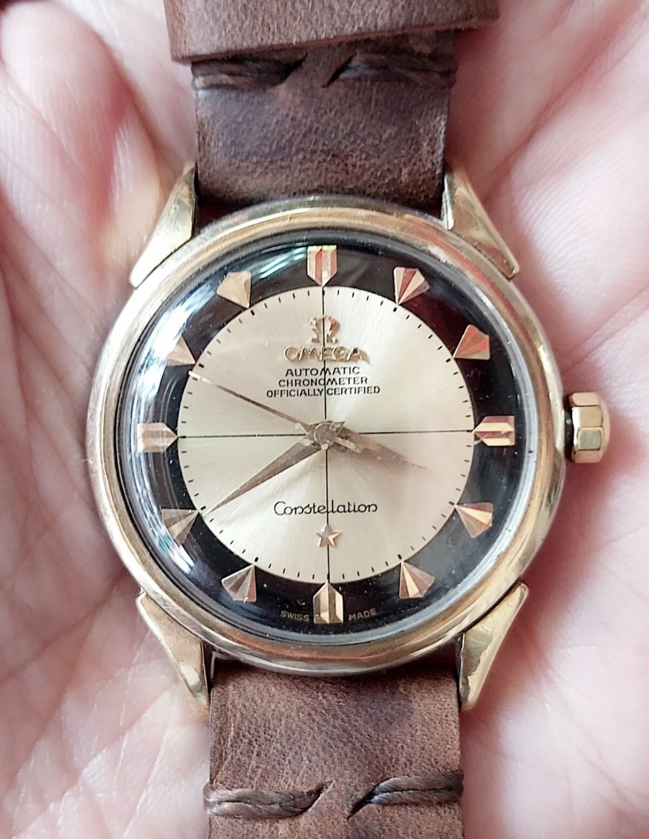

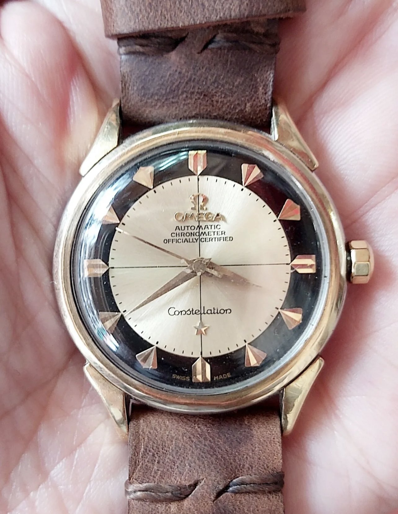

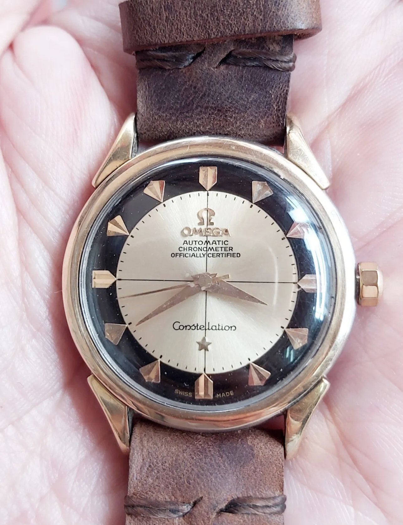

Omega constellation: can this be a factory dial? Help needed.
10,806
16,815
Unlikely I'd have thought but the model and year would help since it has text not normally seen before the late 50s. Note the black printed text is not aligned at all well with either the applied logo or cross hairs, and the star and line aren't very well aligned either but some of this might be down to parallax
912
1,255
I don’t know if this style exists as such from the factory. But this example looks like repainted at some point. Cross hair looks a bit thick and usually it shouldn’t cover the “L” from the word “constellation”. The fonts are also a bit different than expected.
That said, the style of the dial is pretty cool.
