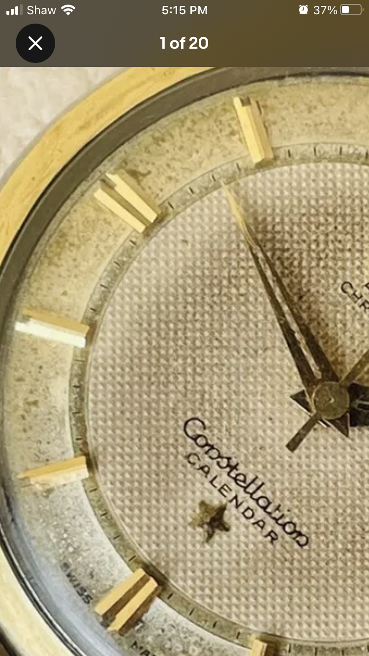

Can this be cleaned? If so, how? Many many thanks!!

This watch is beautiful but the dial is just a bit too dirty for my taste. Can I’d be cleaned to look even 50% better?

At great risk/expense of ruining the dial. I wouldn’t risk it.

I agree with Scarecrow Boat. Touching a dial is risky. It is so easy to take off a layer or some script. I usually roll some rodico across to pick up loose dirt and or debris. Then if it’s still that bad I might roll a damp que tip across it but never rub just roll. Then dry with another one instantly. That’s the best you will get without big risk but even then with my method, there is a big risk. It’s just an unknown. It all depends on how the dial was punished during its life.

Only bid on this is you'd like it as is. Seller provided clear pics, so you get a good idea but I wouldnt expect it to clean up at all.
