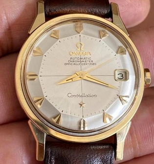

Hi, in 3h I'm about to purchase an Omega Constellation from 1966 but after doing some reserach I'm not sure
those hands with luminousity (?) q1GSBMm ever gets combined with the arrowhead-shape? Do anyone know for sure?
Thanks a lot!

Well, you might want to introduce yourself, as a courtesy, post more and better photos (including caseback in and out and movement) rather than links, and give us an indication of the price. At 50 cents it’s a steal, at 5000 dollars it’s overpriced.

But also are you sure that it is a 1966 watch?
Whilst arrowhead doglegs do exist, they are uncommon and tend to be early types i.e. 14900/14902s (very occasionally later but only very early 167.005/168.005s -like 1963)
Arrowhead dials like this do not appear in any Constellations as late as 66 unless transplanted from another watch.

I tried to embed the picture but I failed hence the url. I'm sorry but the picture is all I have. I haven't seen the watch in person yet. I'm mainly interested if anyone knows if originally the arrowhead combines with those hands. I know that the Constellation comes in a variety of combos but I haven't seen that one. (Auto 561, Ref 168.005).
I completely understand if nobody is able to help in such a short notice! I might buy it anyway.

To answer your question - A non-lume dial should not ordinarily have lumed hands.
However, a previous owner may have had them swapped out to see the hands in the dark.
(note: there are earlier -50s- examples of lumed hands and non-lumed dials that some think may have started life that way - perhaps as 'special order'?)
It depends on what you are looking for in terms of originality but at the risk of repeating myself - if this is a 1966 dogleg, the hands are not the problem - the watch didn't come out of the factory with that dial (no constellation did that late) so it is a 'frankenwatch'.
what is the movt serial number?
Is $1700 the price the seller is asking for this watch?

Wow okay, fantastic information. Thanks a lot! So then it might not even be worth like 1200 dollars? I know it's probably hard to say without looking at the movement etc. All 8 stars are visible but two are pretty worn out. It's a bummer because I really liked the look of the watch.

If it is indeed a 1966 watch, it has a soft-ish but ok case, worn down medallion and incorrect dial.
As a nice dress watch it is worth whatever someone is willing to pay.
As a vintage collectable Omega, it is essentially a parts watch - not worth half of the asking price.
Arrowhead doglegs are really quite uncommon as they are something of an anachronism (the dials were originally meant for earlier case references not doglegs)
So you are setting yourself a very tough task to find a genuine one, if that is what you really want (think years, not months, of searching)
A genuine one should be no later than ~1963 but preferably earlier and in a 14900/14902 case.
Better to look for a dogleg pie-pan (along with an awful lot of other folks) and post here if you find something you like.

Yeah I agree about the date-magnifier on Teddys watch, it looks terrible. But I have to admit I really like the doglegs conbined with arrowhead dial. But I wan't it to be mostly original. The seller seems clueless (like me) so what if it actually was from 63 and not 66? How would one go about to control it? Serial number on the movement? I guess I could live then with hands not being 100% correct and maybe try to convince myself that it was a rare special order.

The only way to approximate the year is to see the serial number.
Teerapat's watch (in your link) is an outlier and sourced in the Far East - where rules about Omegas get very sketchy due to specials Omega produced for the eastern market.
Stepped dials are a whole new ball game.
Arrowhead dials in a 14900 or 14902 are uncommon.
Arrowhead dials in a 167.005 or 168.005 are very uncommon.
The hands wouldn't bother me if the ref / movt was in the right timescale.
Do you have any other info from the seller you can share?

No unfortunately the seller was not willing to open up and show the movement (might be a red flag but not sure) so I cancelled our appointment. There is not even a pic of the movement to show. But if I get the right tool he might let me try since he doesn't have any other buyers (that I know of). Of course I'm also scared to damage the back of a watch I don't even own...But in the unlikely case that it actually is an early serial number that could have been produced in 1963 I guess it might be a good buy. Maybe worth a try!

I wouldn’t risk opening someone else’s watch with an opening tool.
Consider using a rubber ball instead.
However, as a gold capped watch you would need to be careful not to accidentally remove the gold medallion.
Best advice would be to find a friendly watchmaker to open it.
