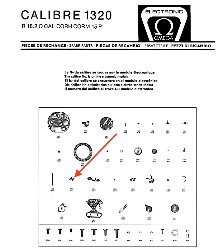

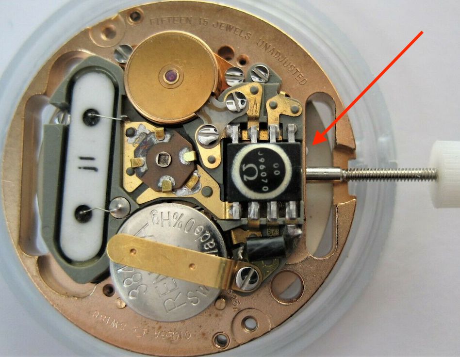

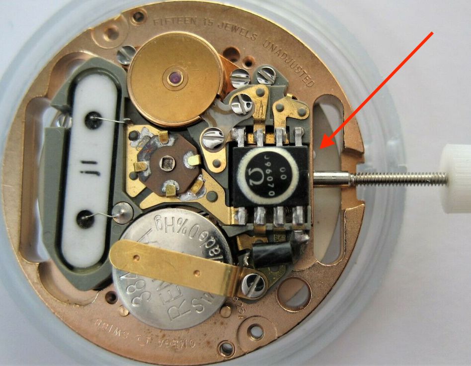

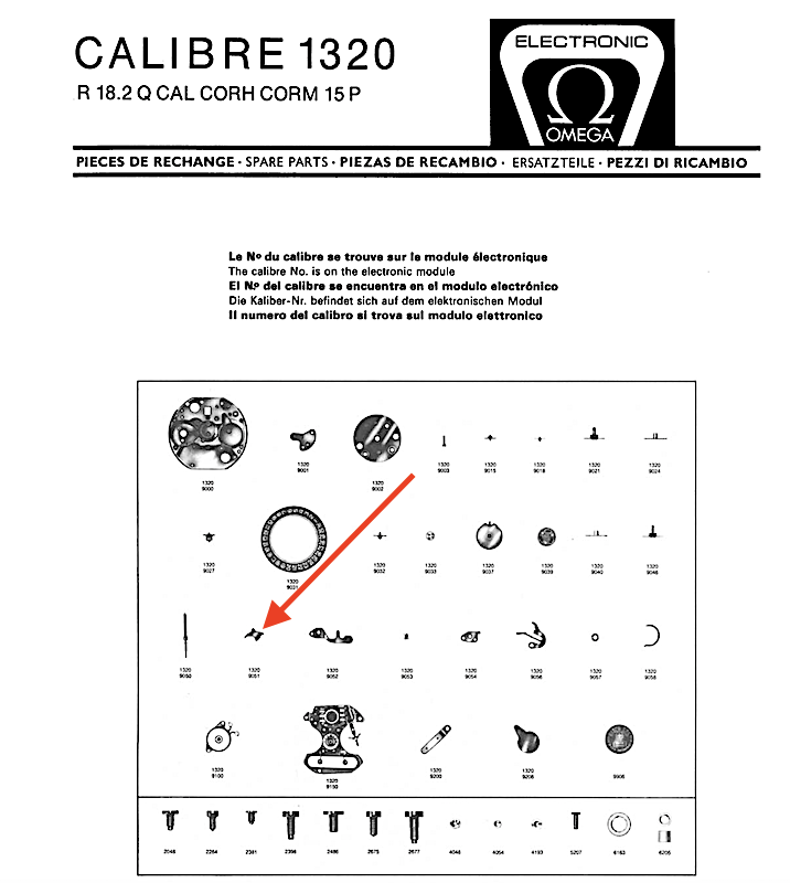

I have been looking all over the web for what should be a easy question but I cannot find a service manual anywhere. I just picked up a 1973 De Ville 196.0028 with a 1325 movement. Amazingly a new battery brought it to life and it is keeping good time so far. I would like to remove the movement so I can do a really good ultrasonic case cleaning. For the life of me I cannot figure it out. There is no obvious lever.
I do not want to disassemble a 50-year old, working quartz if I do not have to but I am thinking the stem lever must be under the circuit module. Before disassembling, I wanted to check if anyone here knows how to do it.
Thanks in advance. I will add some photos this evening.
7
3
I saw that thread. In the end I do not think his suggestion is correct. The commenter didn't claim to know the answer he only gave a suggestion. I have seen pictures of the dial side and the nub he points out is part of the stem mechanism but it is not something that can be depressed.
7
3
Thank you so much for this. I was so worried about breaking the movement, I must have not pushed hard enough. I just needed someone to confirm it was the right thing to do.

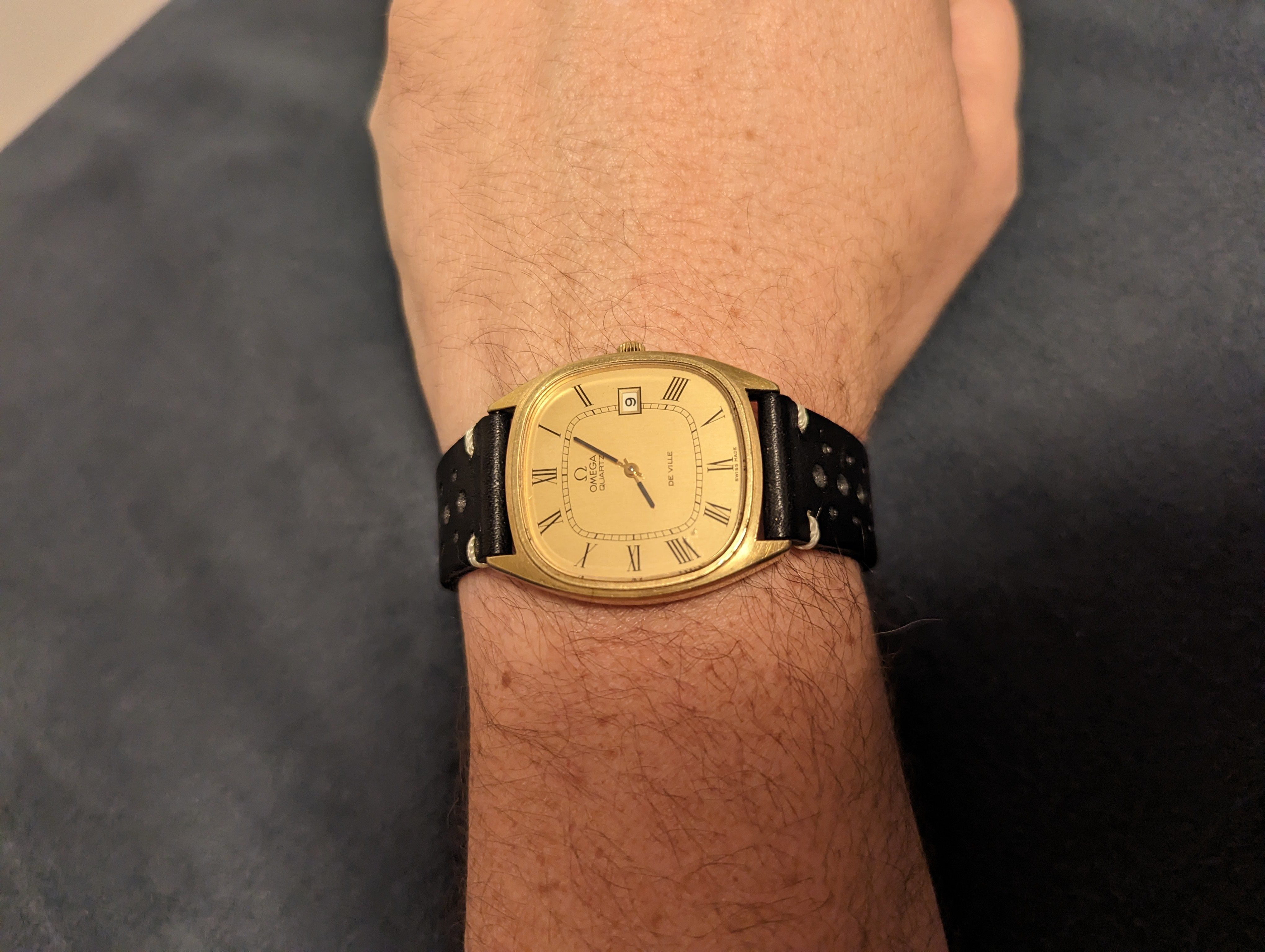

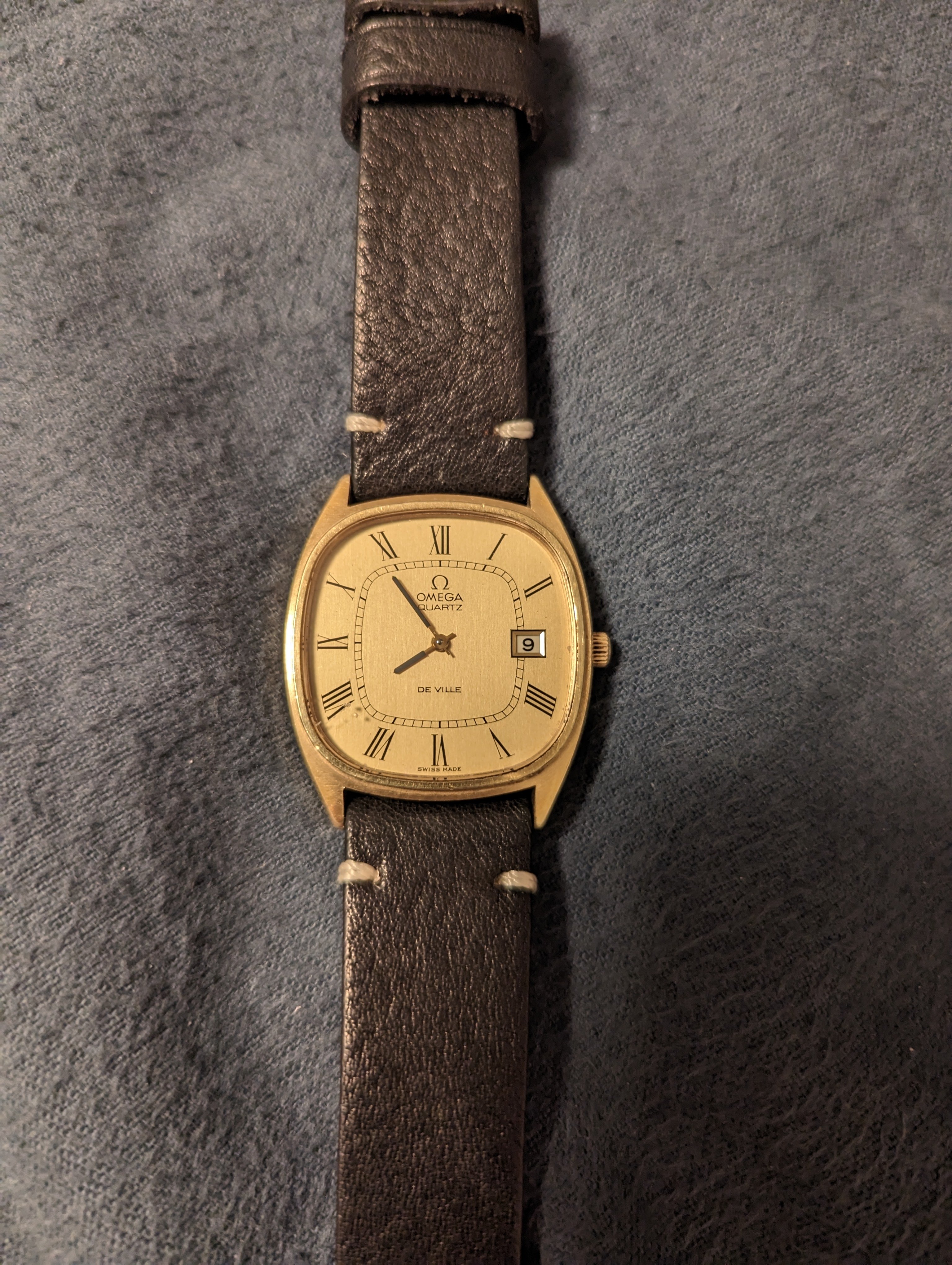

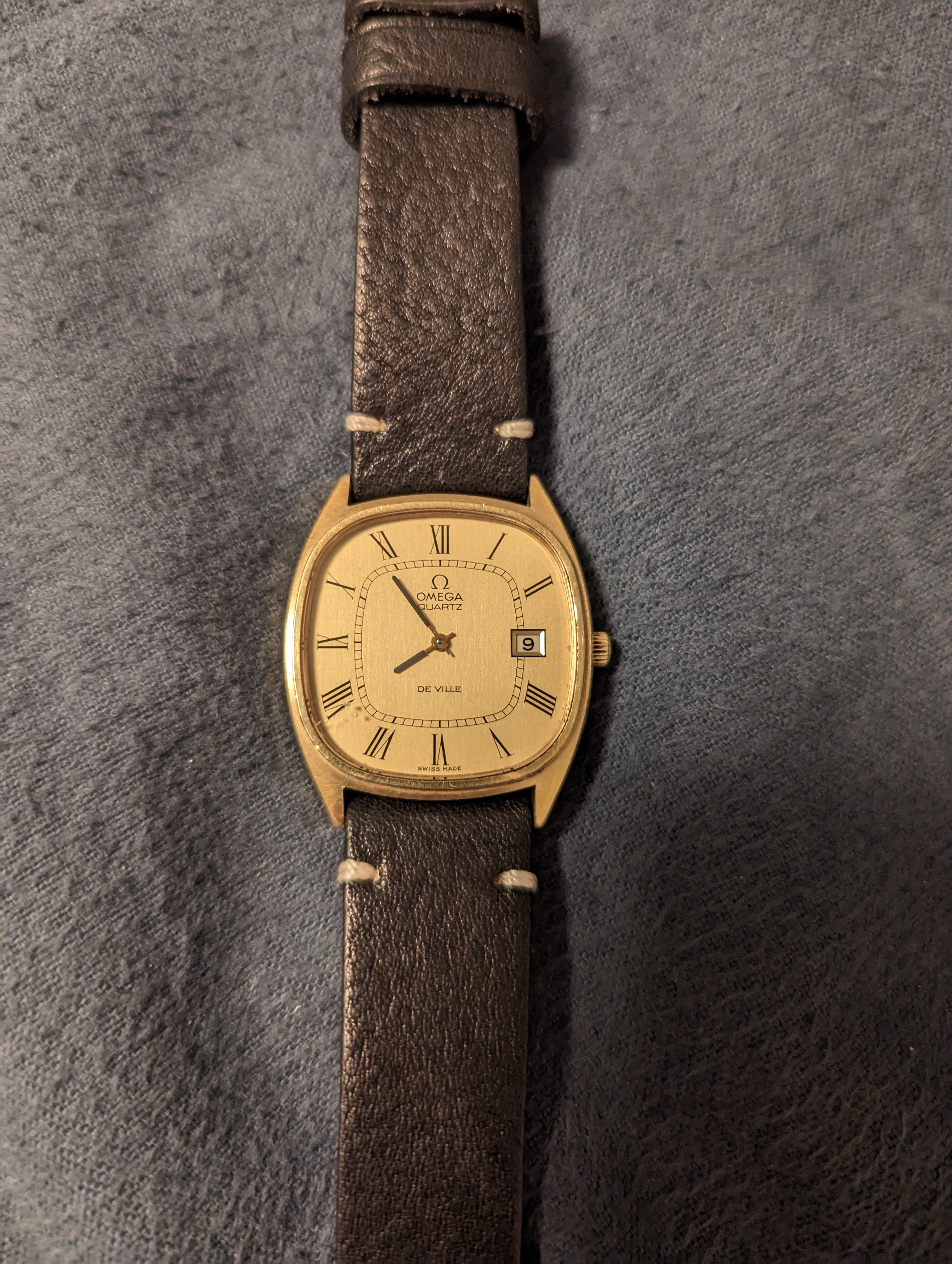

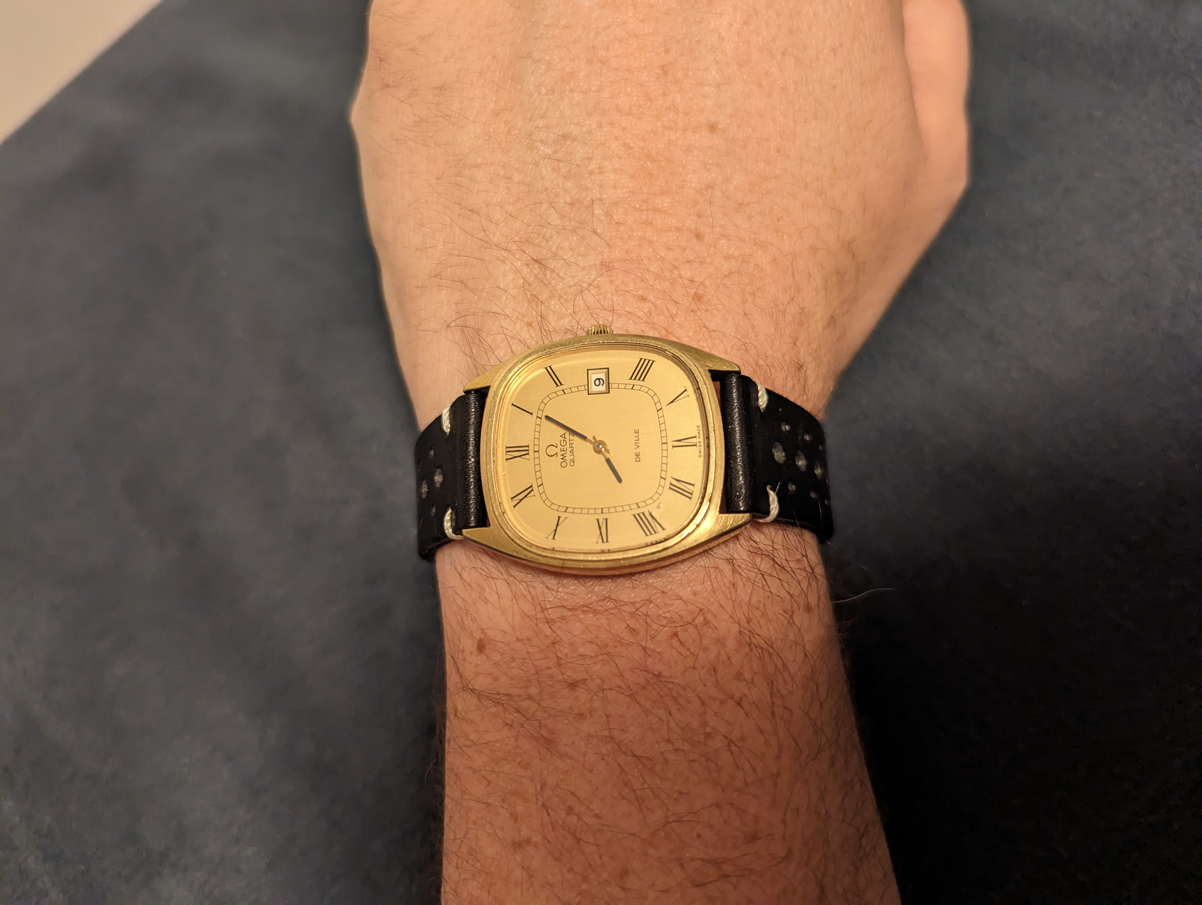

Here are a few shots of the watch on my 20cm wrist. It's 20mm lugs and case shape make it wear larger then its 34mm diameter would suggest
