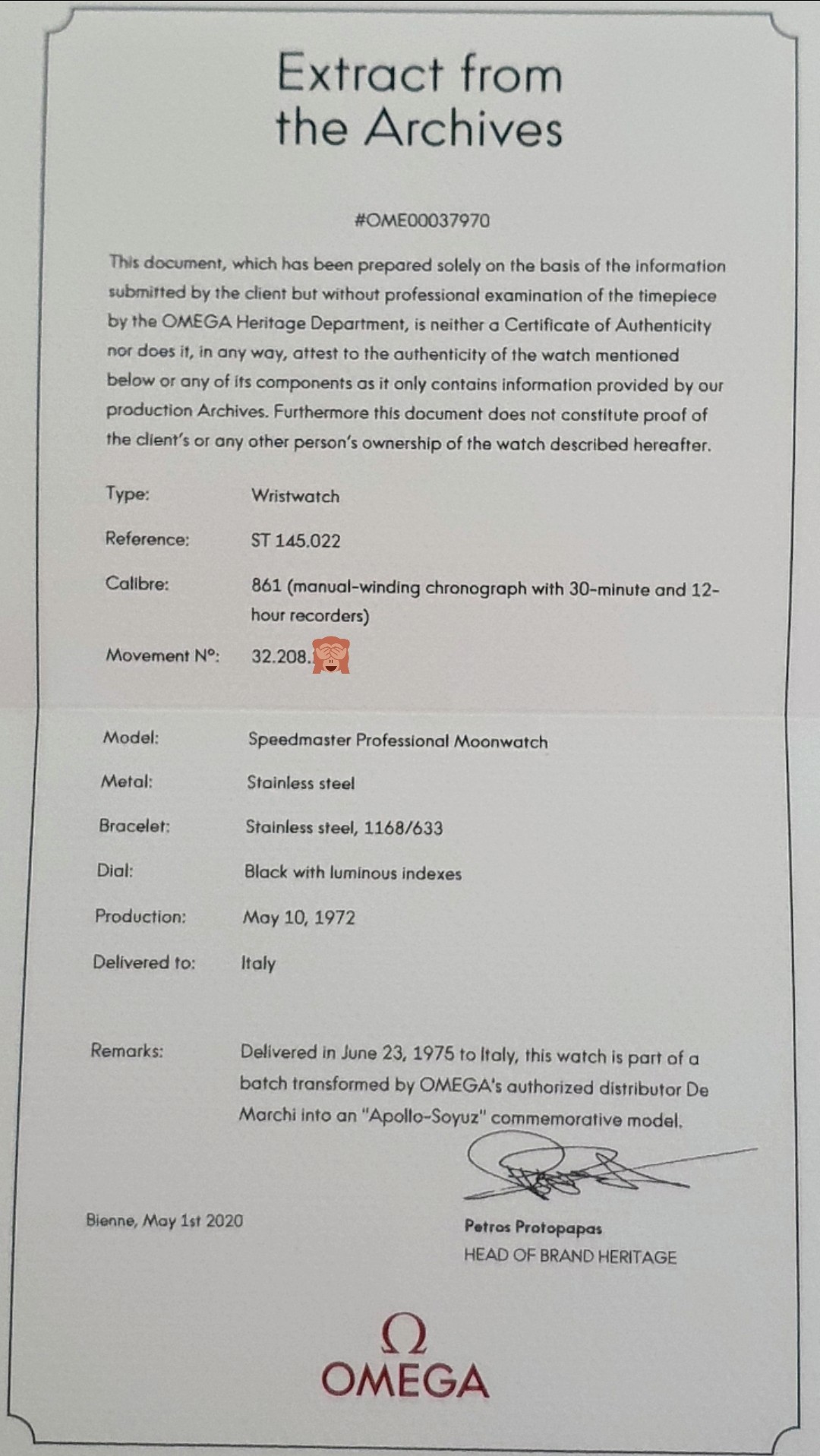

I don't understand why there is disagreement about Demarchi receiving spare parts.
If you accept the Omega extract as accurate that a watch was part of a batch transformed by Demarchi AND you accept that the Demarchi watches had everything except the case with 5.5mm pushers, then why is there a reluctance to believe Demarchi received the parts from Omega? How could they transform a watch from parts they didn't receive? I don't understand this part of the discussion.

To me, the extract could simply be saying that the watch is an original speedmaster that has some parts from the AS edition but should be considered original because it was transformed by an Authorized dealer. That is not the same as Omega saying the watch is an AS edition. They are simply saying it isn't a franken. Is this in agreement?

Now you are talking about AS De Marchi...
The answer is "yes", what you are describing is what the extract says, and the "most likely" scenario. I accept this.
It is also "very likely" that De Marchi receive service parts. I accept this too.
The questions that remain unanswered, specially if you transformed 70 to 100 watches, which by the way I doubt there are this many, is:
Where is the invoice for a large quantity of parts (dials, bracelets, casebacks? Who controlled and did the engraving?
Omega has never accepted that the watches were transformed in Bienne, and they issue the extract indicating they were transformed in De Marchi Torino, so the logical conclusion is what you are saying, that the invoice for parts used to do the transformation existed, but is gone. I am ok with this.

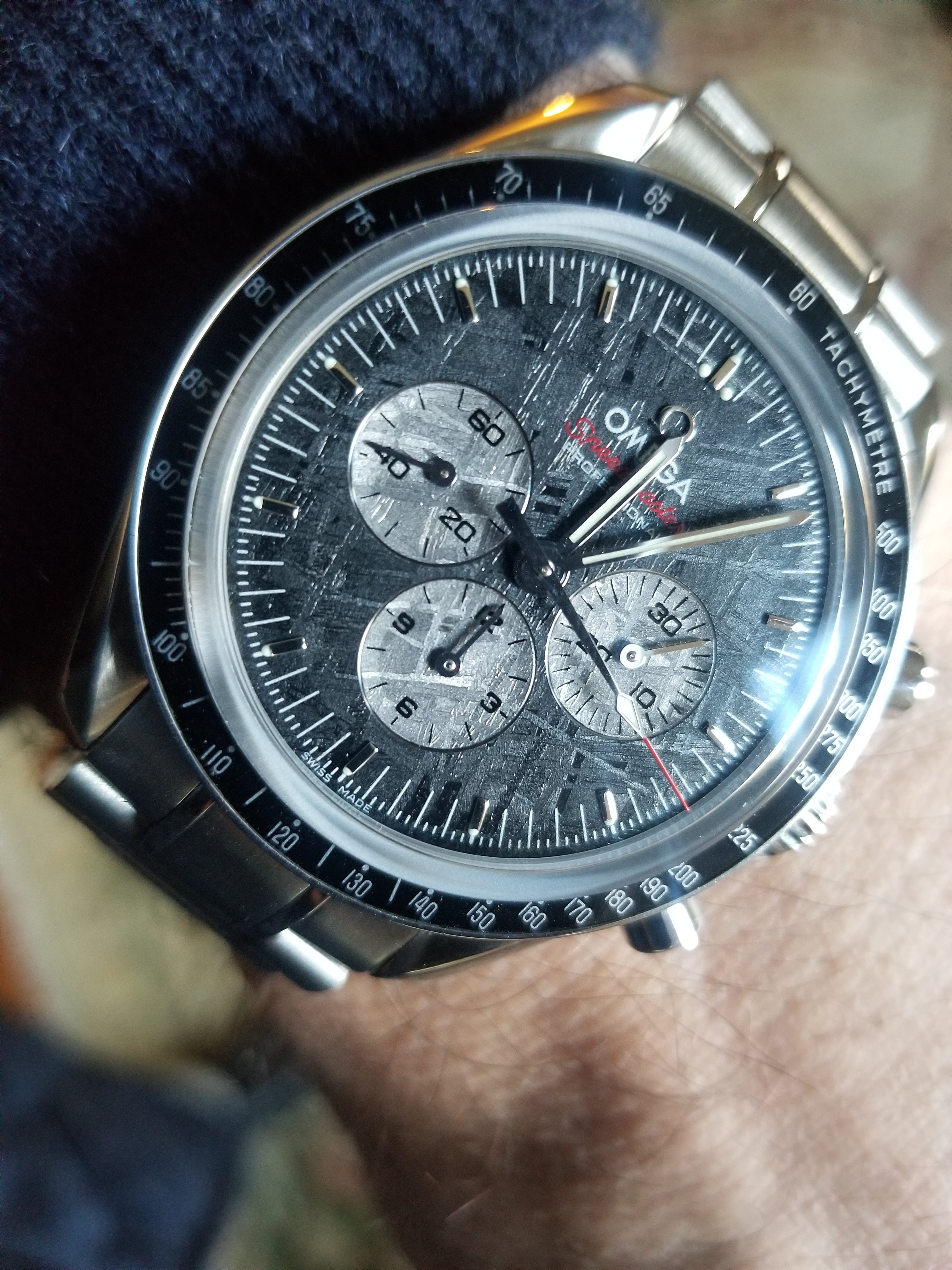

Oh, this is as close as I have come to an AS. I am jealous of your soon to be two AS watches!
Please post pictures if and when you get your new watch.

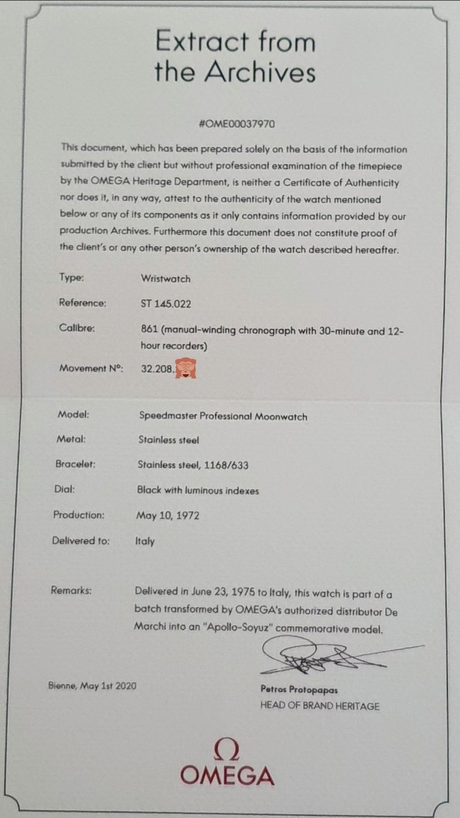

In my post I mentioned that numbers between 400 and 476 were either assigned or planed to be used.
And in fact, they were used: #416, #461, #468 and #469, with no duplicates found. There could be more.
Attached is a copy of my extract indicating it is an Apollo Soyuz commemorative edition, and there are facts to sustain why Omega reach to this conclusion (which I did too, doing my own research).
Regards
Great watch!
I will post pictures!
