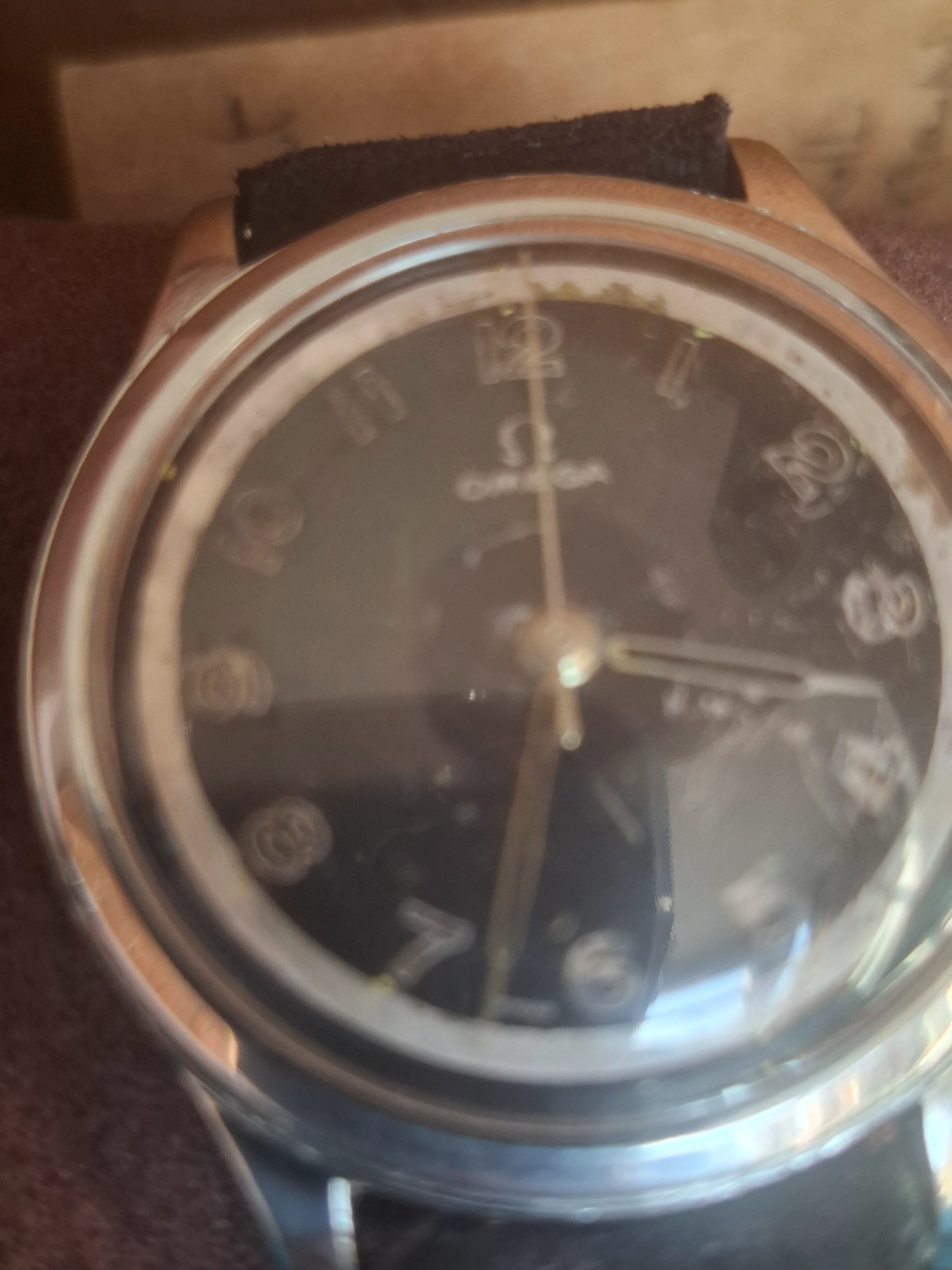

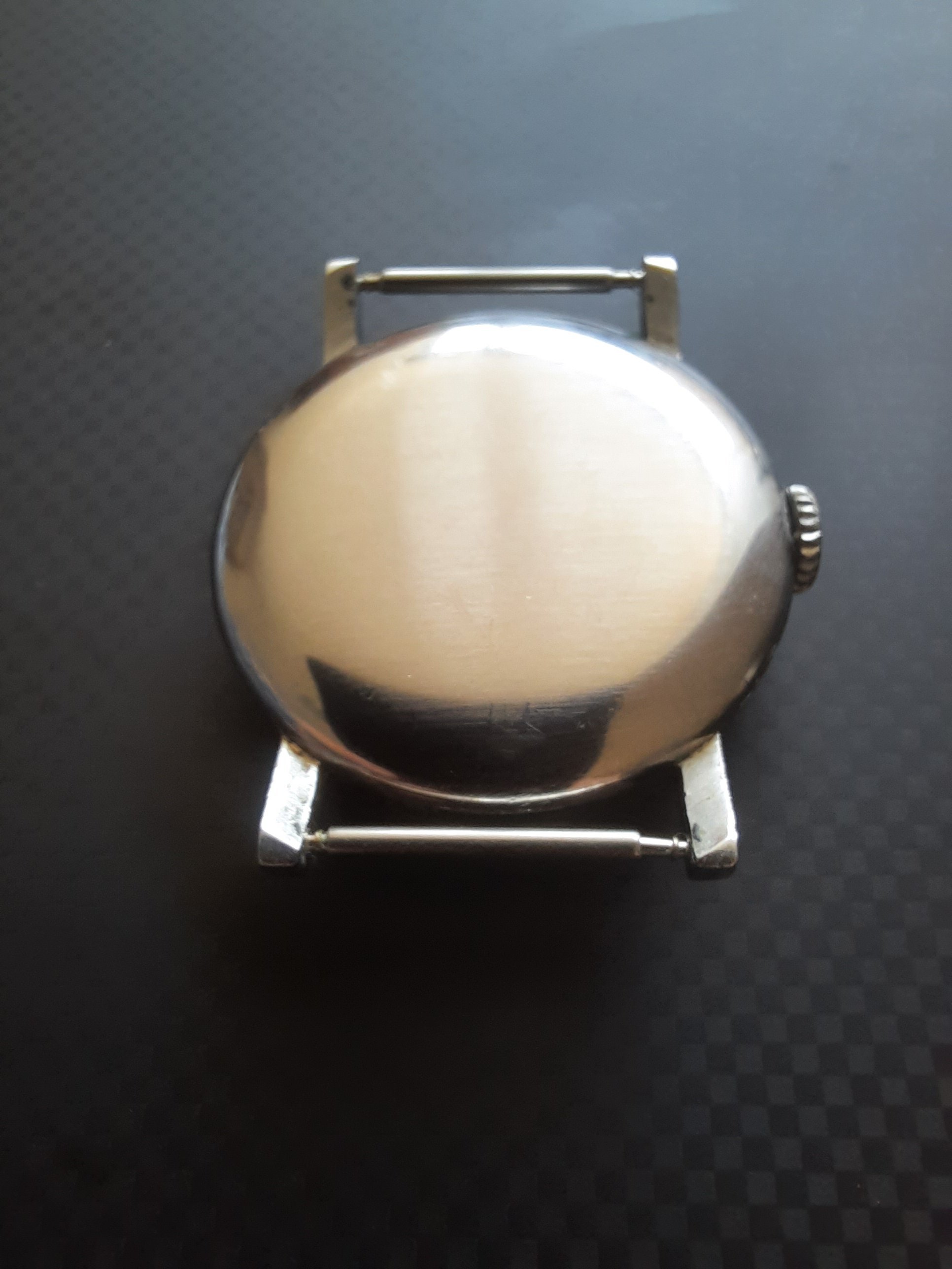

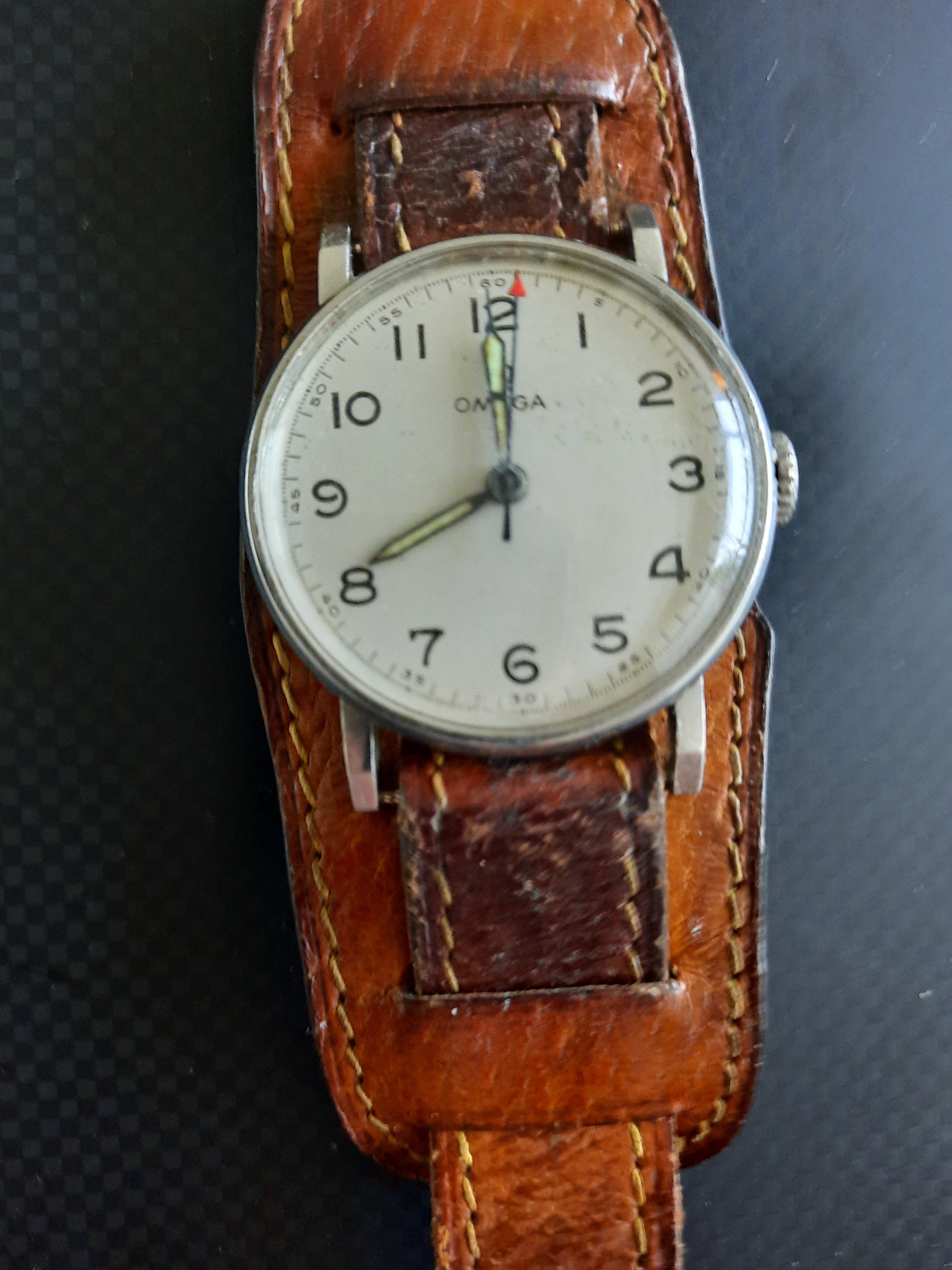

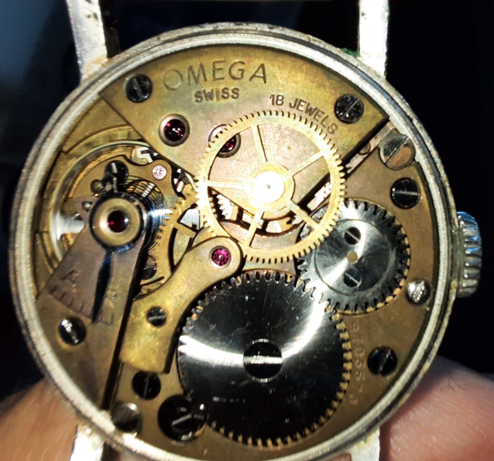

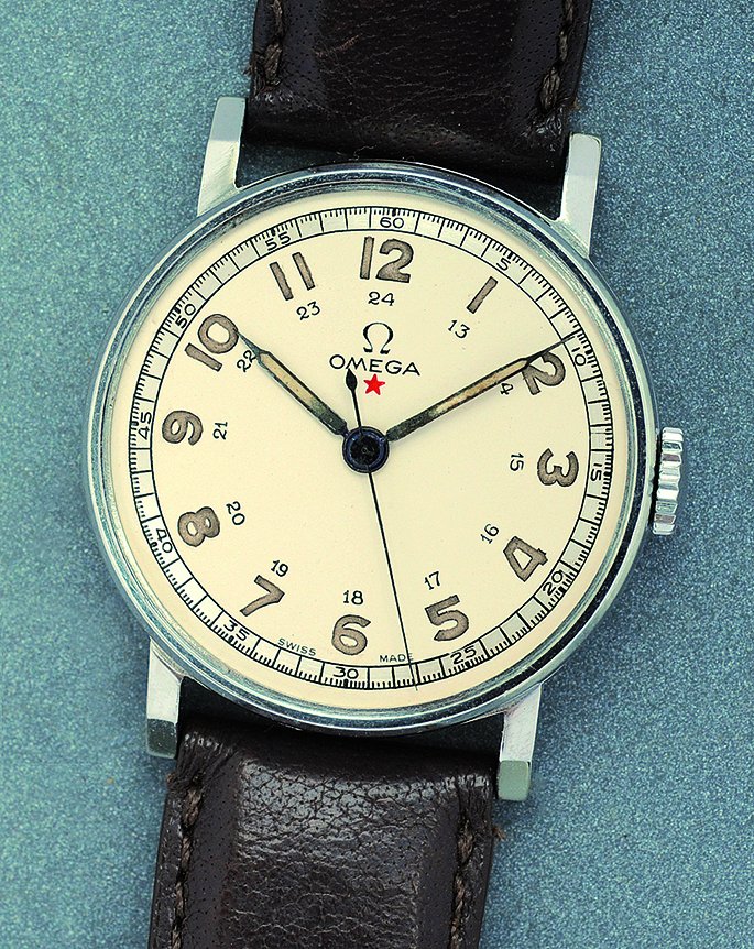

I was on the way to buying a British AM 6b/159 WW2 Omega pilots watch last week. This literally crossed my path from an estate sale, so I jumped in an bought it blind from the face photo without the benefit of a pic of the movement or the movement number.
It arrived and happy to say that the movement number 9703579 dates to 1942, in addition the movement is 18 jewel rather the 16 jewel movement fitted to 6b/159 RAF Government purchases.

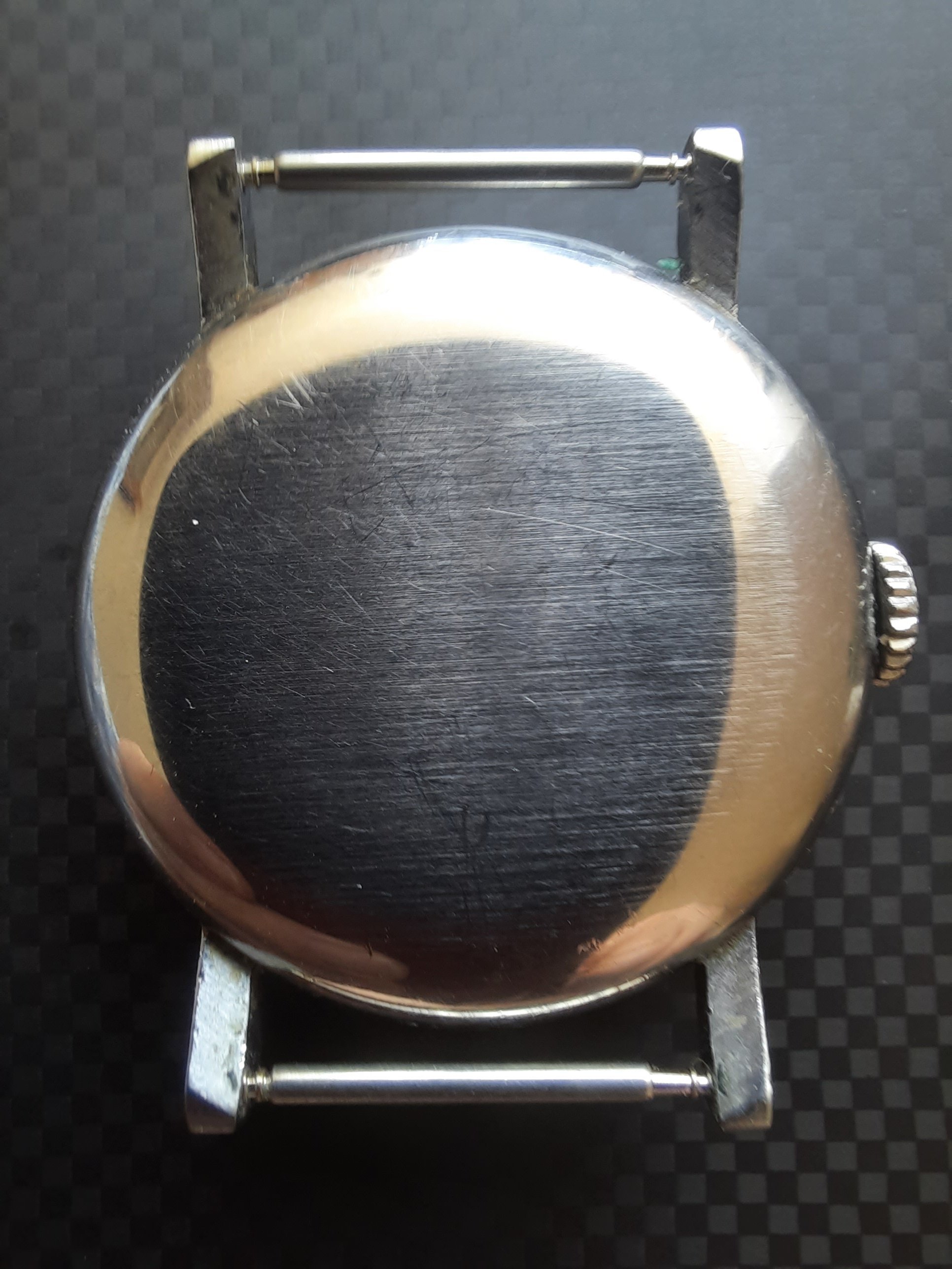

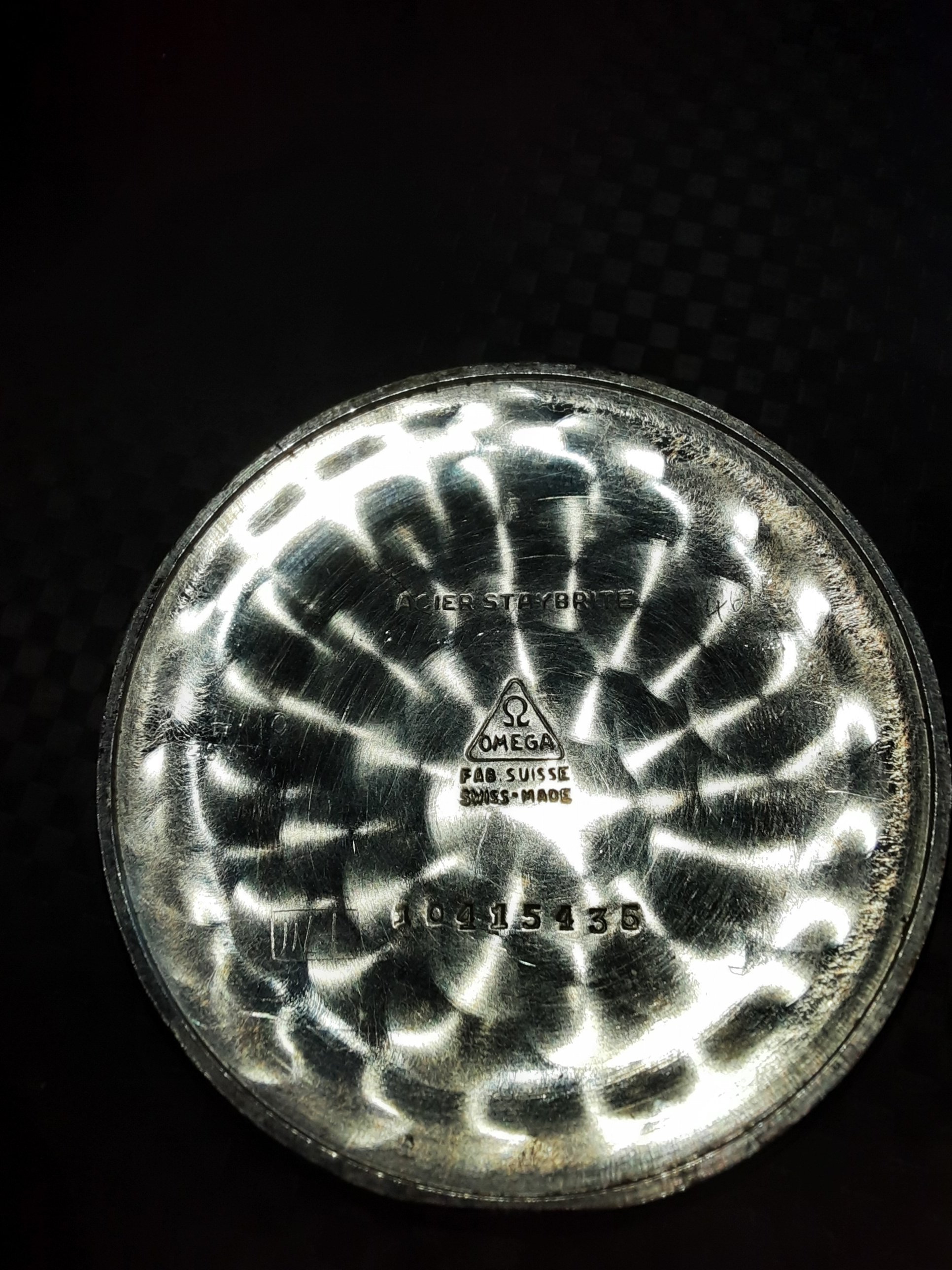

The watch due to the military leather band with the backing pad has suffered minimal wear to the rear case which is un-numbered and in perfect condition. Internally the case back has the case number rather than a contract number and a hyerogylphic which is similar to Russian acceptance small arms in period.
The face is similar the 6b/159 RAF contract face but with lumed hands and a second hand with a red pointer.
The outer track is segmented 5-60 in 5 second blocks. Overall the watch and the movement is in good original condition
I would be interested to know if anyone has seen anything similar. Due to the Omega archives being closed, I can't apply for a factory letter or gain any further detail.
Thanks in advance.

Fantasy Repainted dial and some unmatching hands. What do you mean by "... Russian acceptance of small Arms ? "
8
How interesting, I suppose fantasy made leather strap and wear, so tell me what would you expect a face to look like on a 18 jewel 1942 Omega, the digits are precise to 6b/159, if you were to create a face for a watch, then better to use blued hands found on an 6b/159. What you say makes no sense, there are identical faces with different hands to be found, are these all fantasy.
My observation on the oblong bisected marking inside the case back is based on some 40 years of working with Soviet smallarms and their re-issuing marks. Happy to provide you with a tutorial if the subject interests you.

Enjoy your fantasy, isn't that what fantasies are all about anyway?

Why do they always have to argue when given advise
Absolutely, after all I didn't pay $3500 for a faked 6b/159 with a re-engraved case back
Very simply because it was a statement rather than advice with no explanation as to why it could be regarded as a fanatasy.

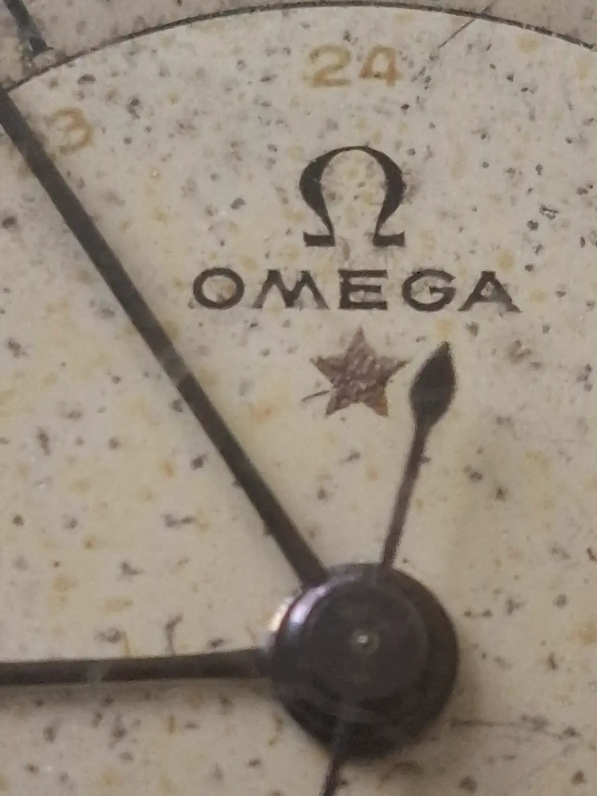

"Russian acceptance small arms in period."
This is new to me. Can you send a link so I can read up?

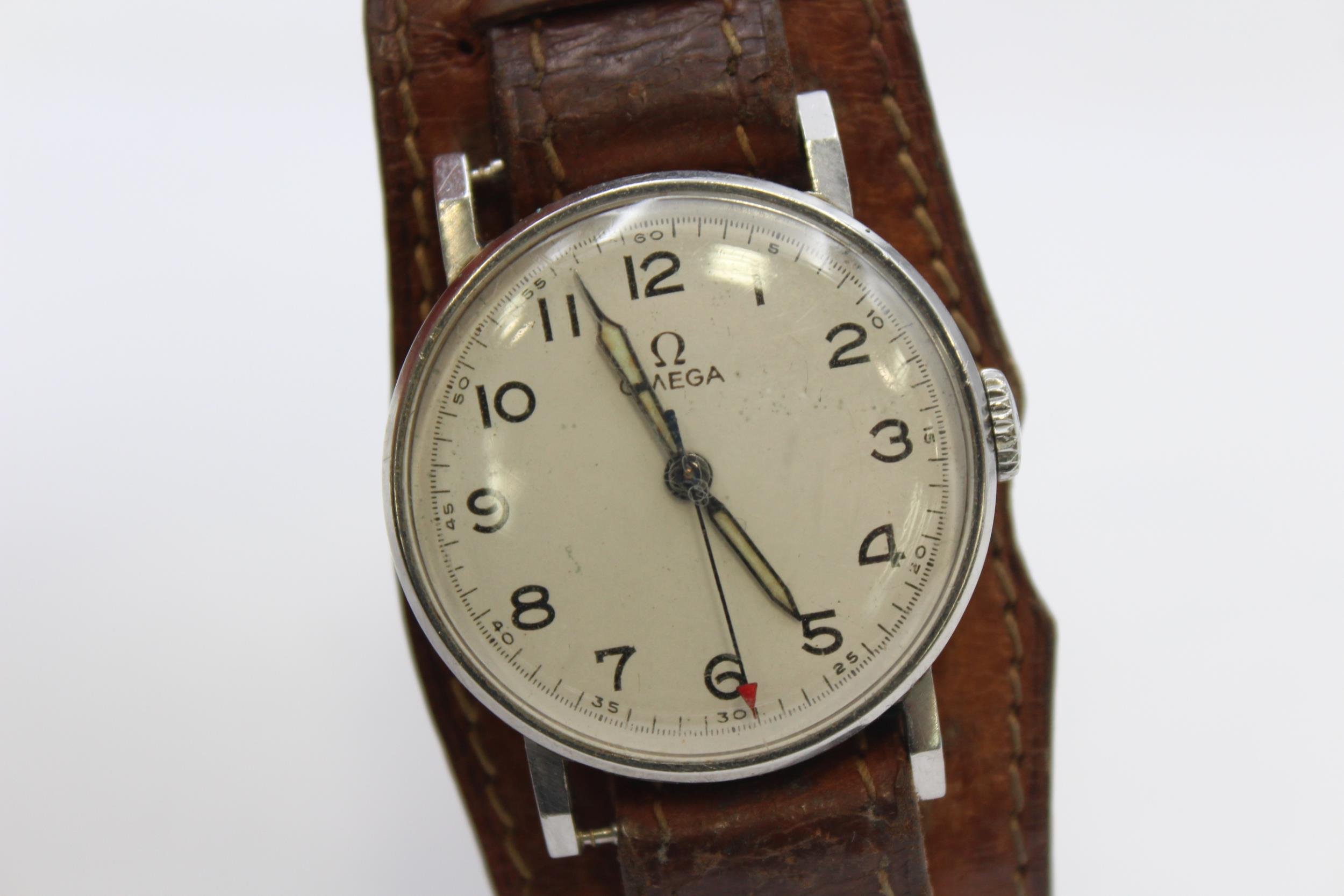

It is a strange stamp on the inside case back that I have never seen. This is what I have seen on the 6B/159.

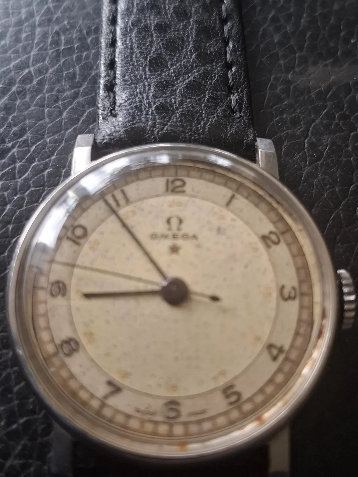

Not sure why you chose to buy this over the 6B/159 which I assume you would have had time to verify as correct. Instead you have something different altogether. Maybe price related?

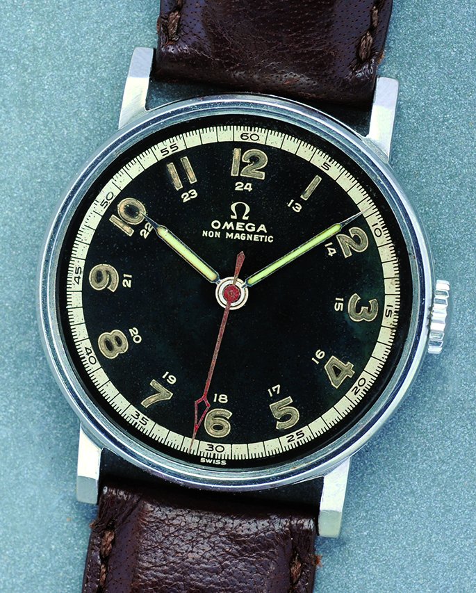

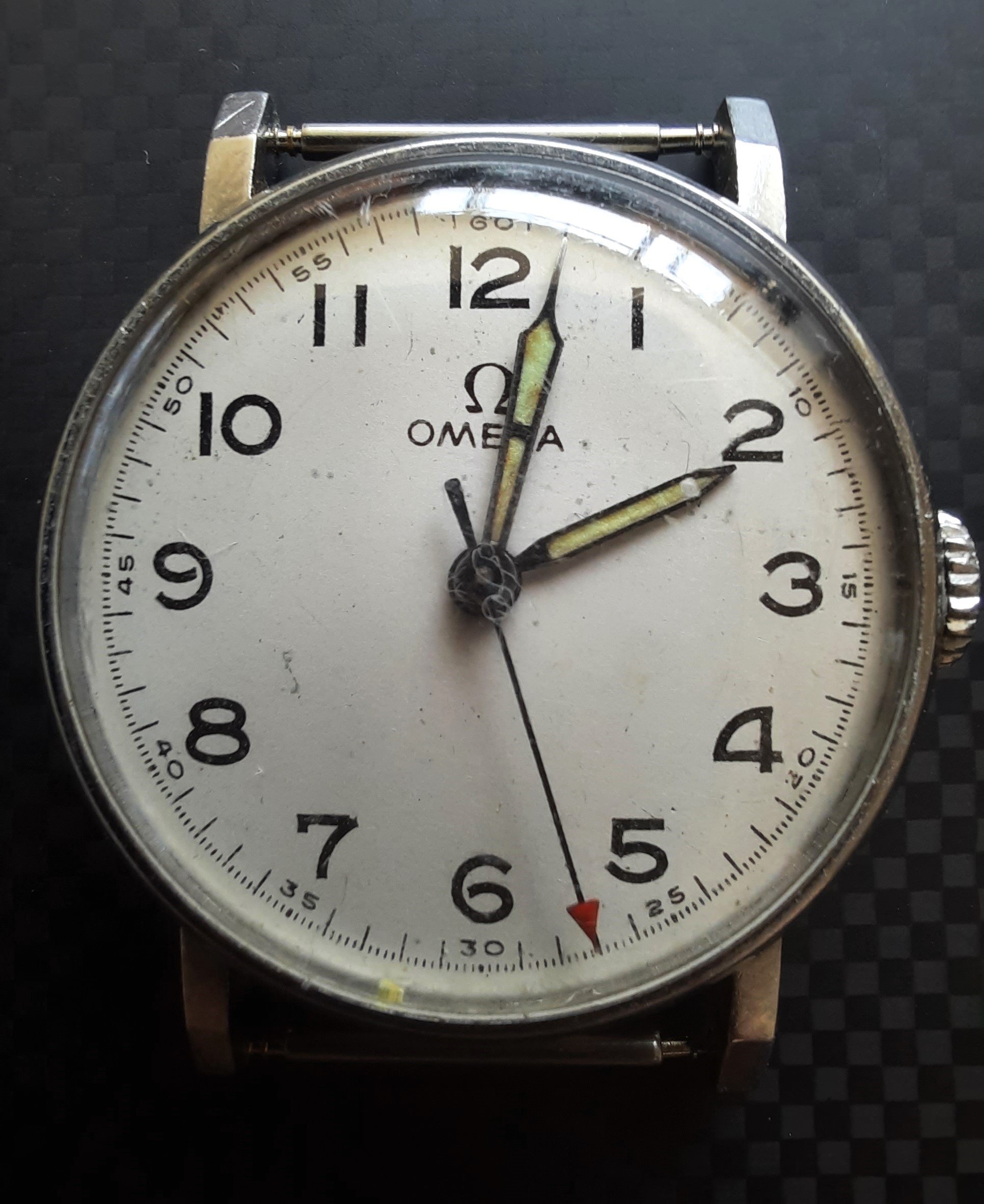

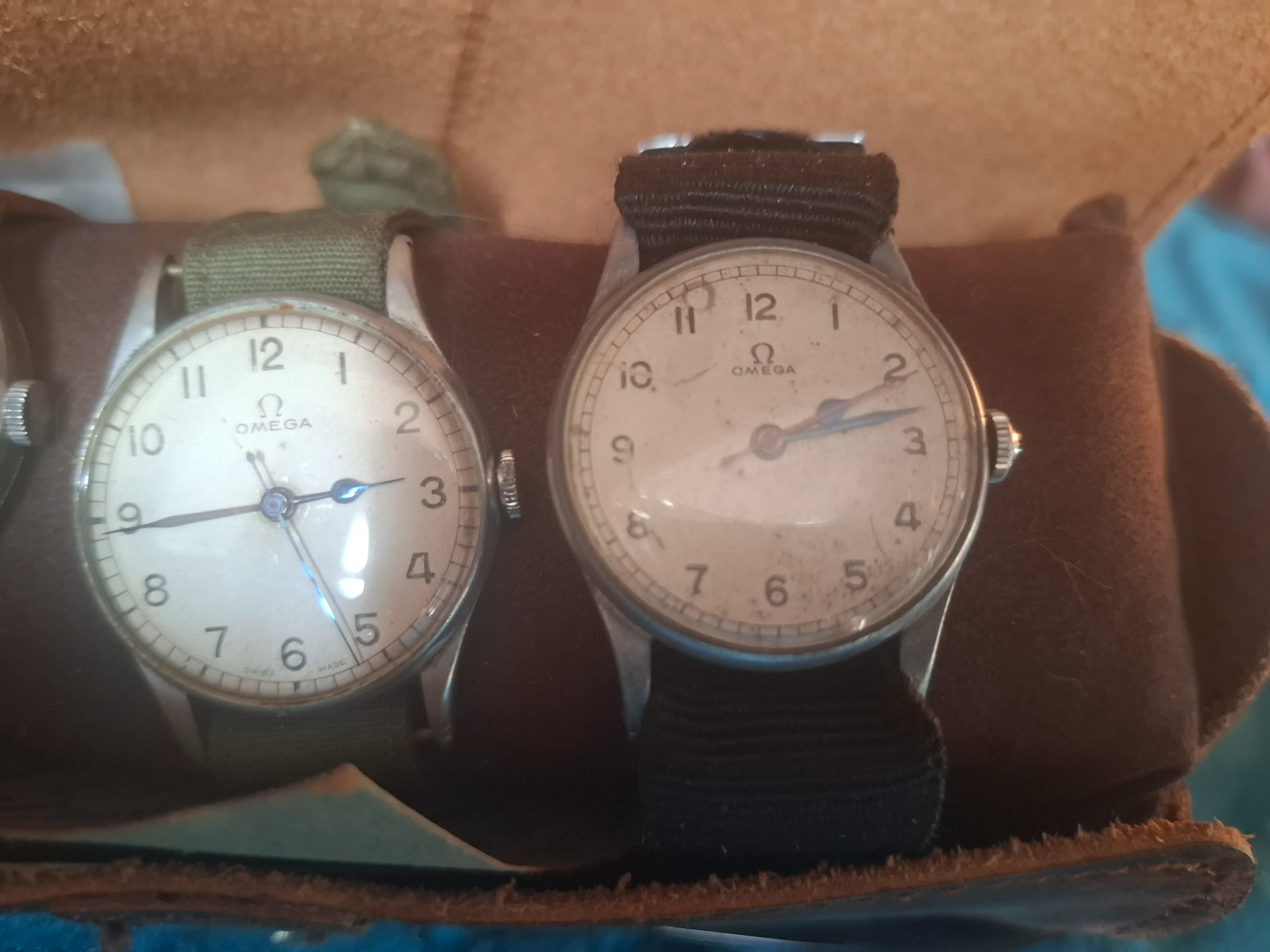

@DavidA, what you have here has nothing to do with a ref. 2292 or any other UK military watches.
You have got a ref. 2242 with correct case and movement but a completely wrongly reprinted/restored dial.
The ref. 2242 was ordered and used by the R.C.A.F. but was also available and sold to the private/public market.

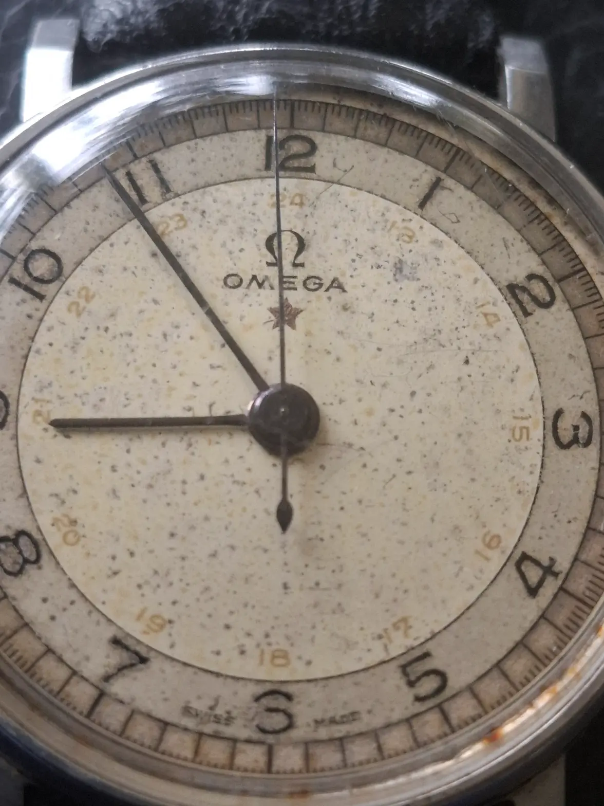

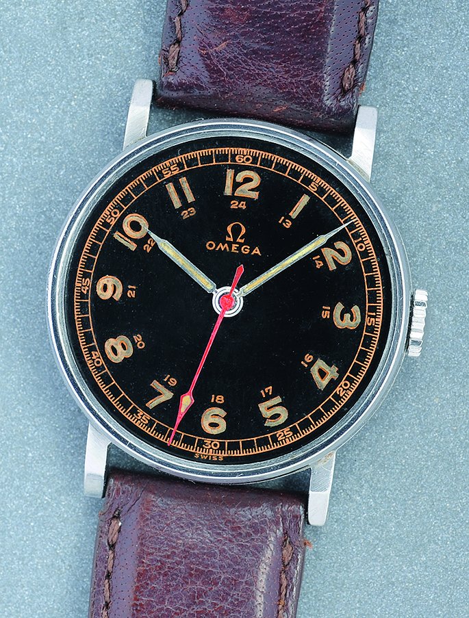

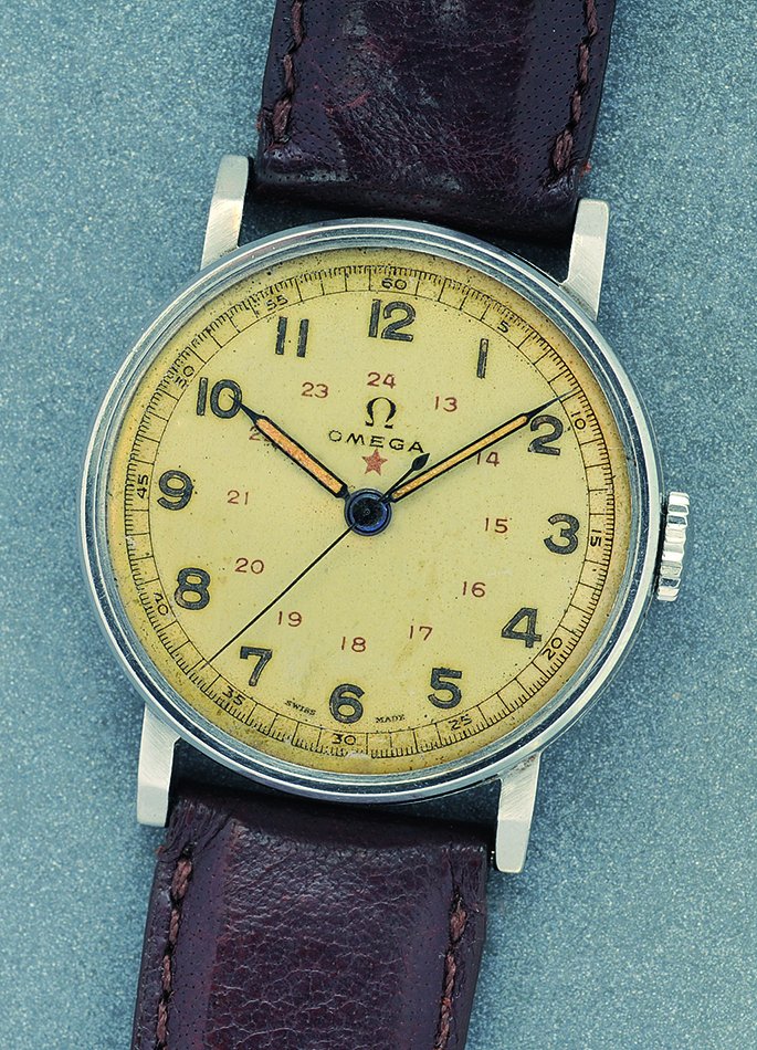

here are some samples of known correct dials:
the next without "non magnetic" and the less common copper coloured numerals and seconds track:
and the bright version with printed numerals and tracks:
and a bright version with radially orientated numerals - note: this is a correctly reprinted dial
hope this helps you understand what you have and how wrongly your dial has been redone.

Here is a link to a relatively new web article on post war Soviet Refurb markings, towards the end you will find the geometric shapes used to identify refurb depots. Most of this has gained collectors interest since quantities of WW2 era Russian small arms have been sold by the Ukraine. The marks also appear on other refurbished small arms such a the Colt 1911's supplied to Imperial Russia through Great Britain during WW1, which is where it came into my small arms researches following the fall of the Berlin Wall over thirty years ago.
Repair depots & refurnishment facilities markings | m9130.info
There is no suggestion that the marking on the watch has any connection to Russia only the similarity of a marking I have not seen on a watch before.
Yes it was, and for a completely different reason, as I wanted a 1940's period watch to use, so rather than buying a very collectible 6B/159 to wear in a WW2 period car, this came up, I was unable to verify the face or the movement number prior to purchase, however for the price it suited me well enough to wear without worrying about damaging a more valuable historic watch.
Good morning, excellent thank you, so very good to see original examples as a datum point to work from. I would hope that when the Omega archives re-open that I will be able to find out at least which country it was supplied to, and perhaps the dial type. Following on from your advice, at that stage I may well have it restored to the original format, if I could find out what that was.
16

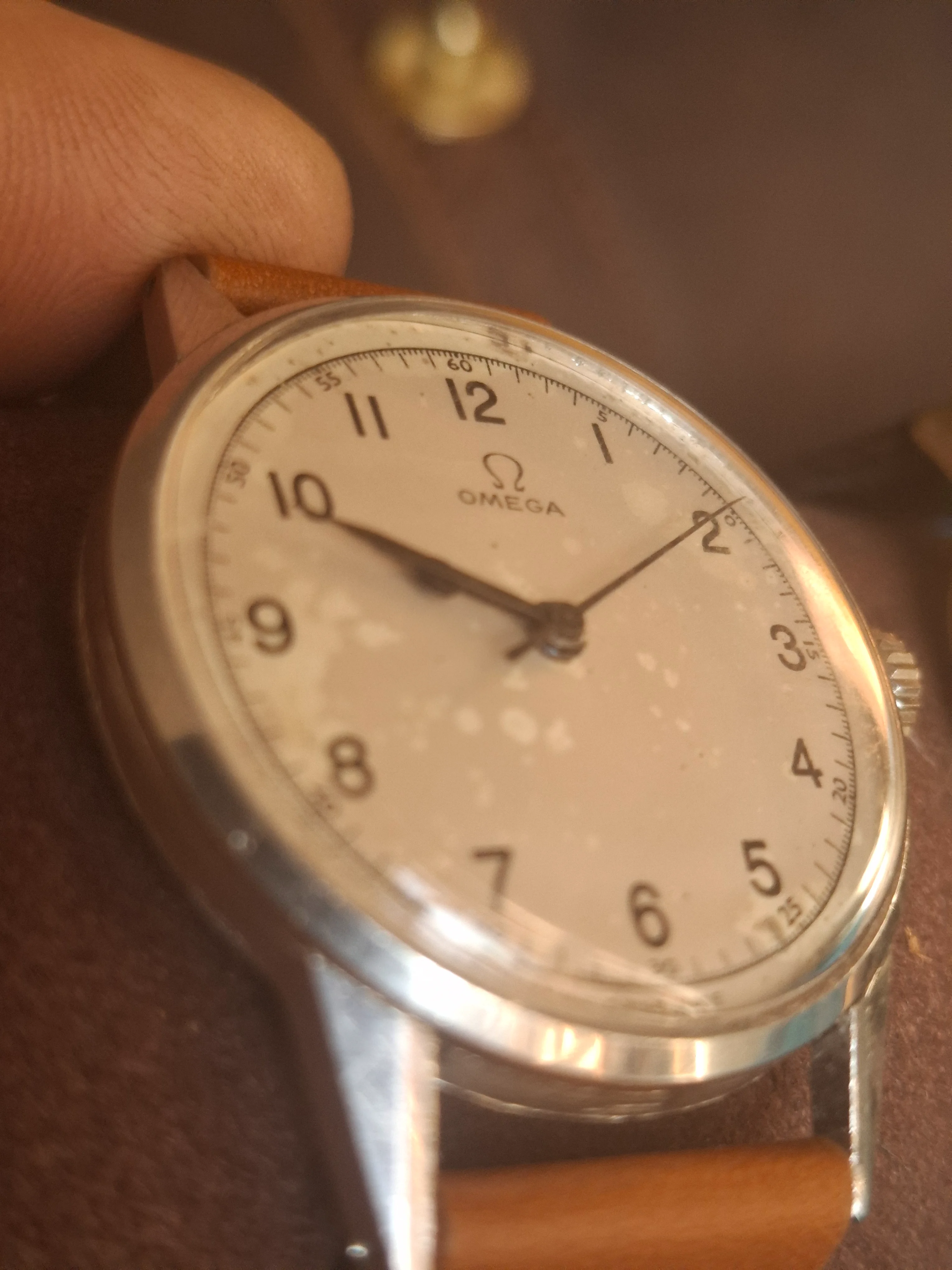

Some great information, I think my watch may have incorrect hands after seeing these examples. Always learning.
3,646
7,756
The hands on your watch are 100% correct. Your dial does not have lume... so lumed hands would be wrong.
16

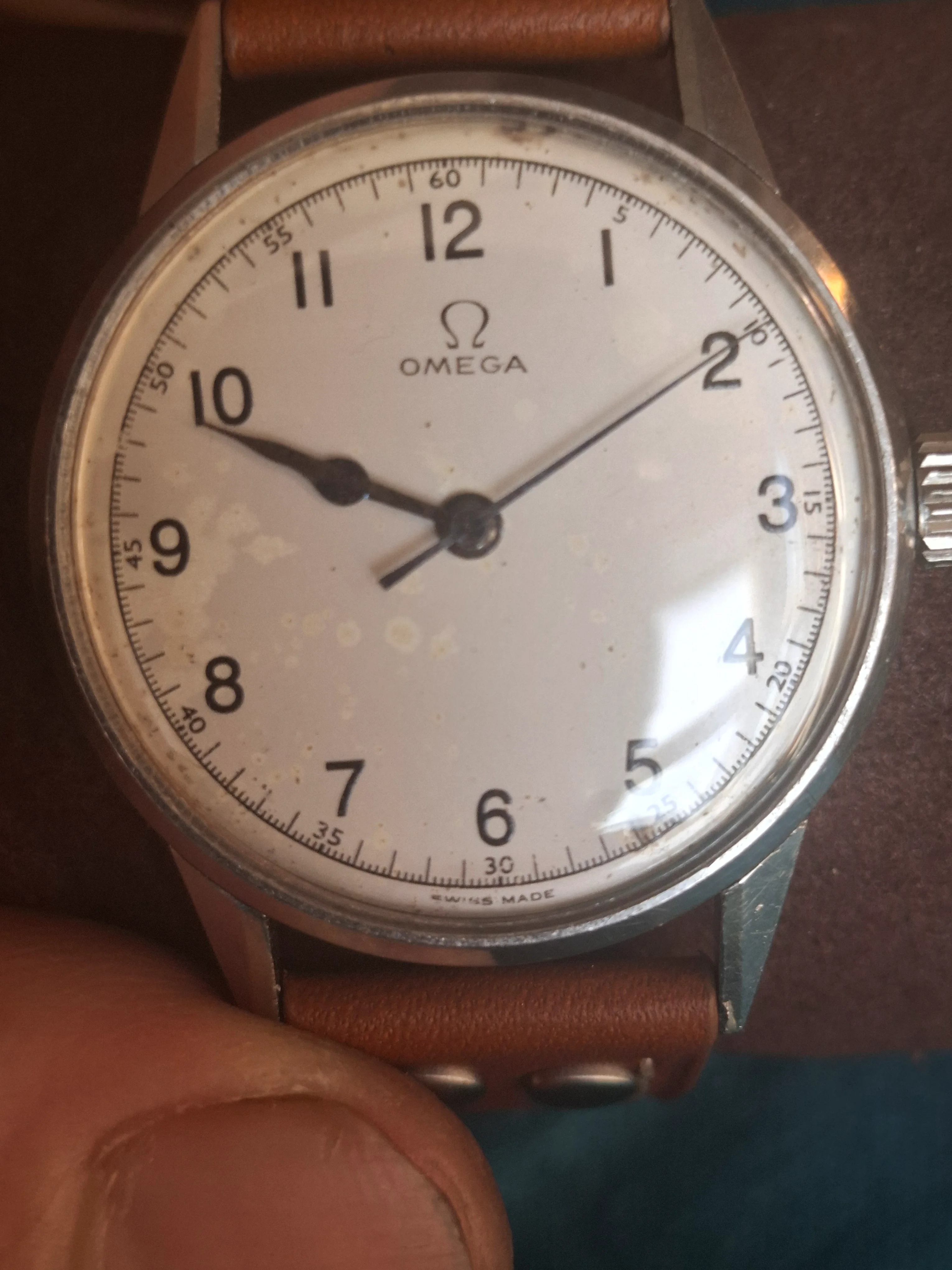

...........and this one appears very similar to what people are calling a fantasy dial. I like it, and don't mind where it came from. Its not RAF specification, and does have some unusual spots, buy I like it.
Enjoy your watch.
