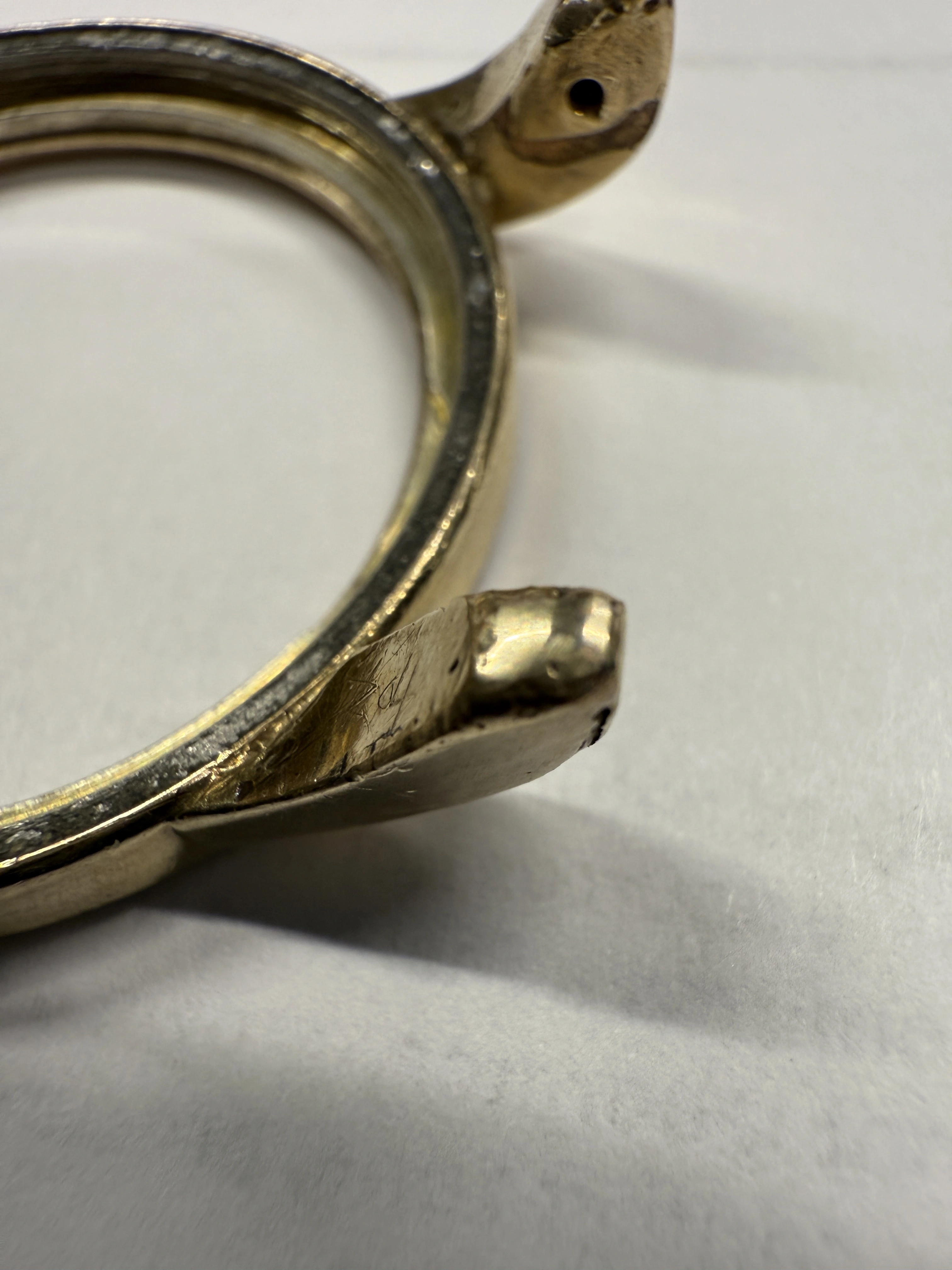

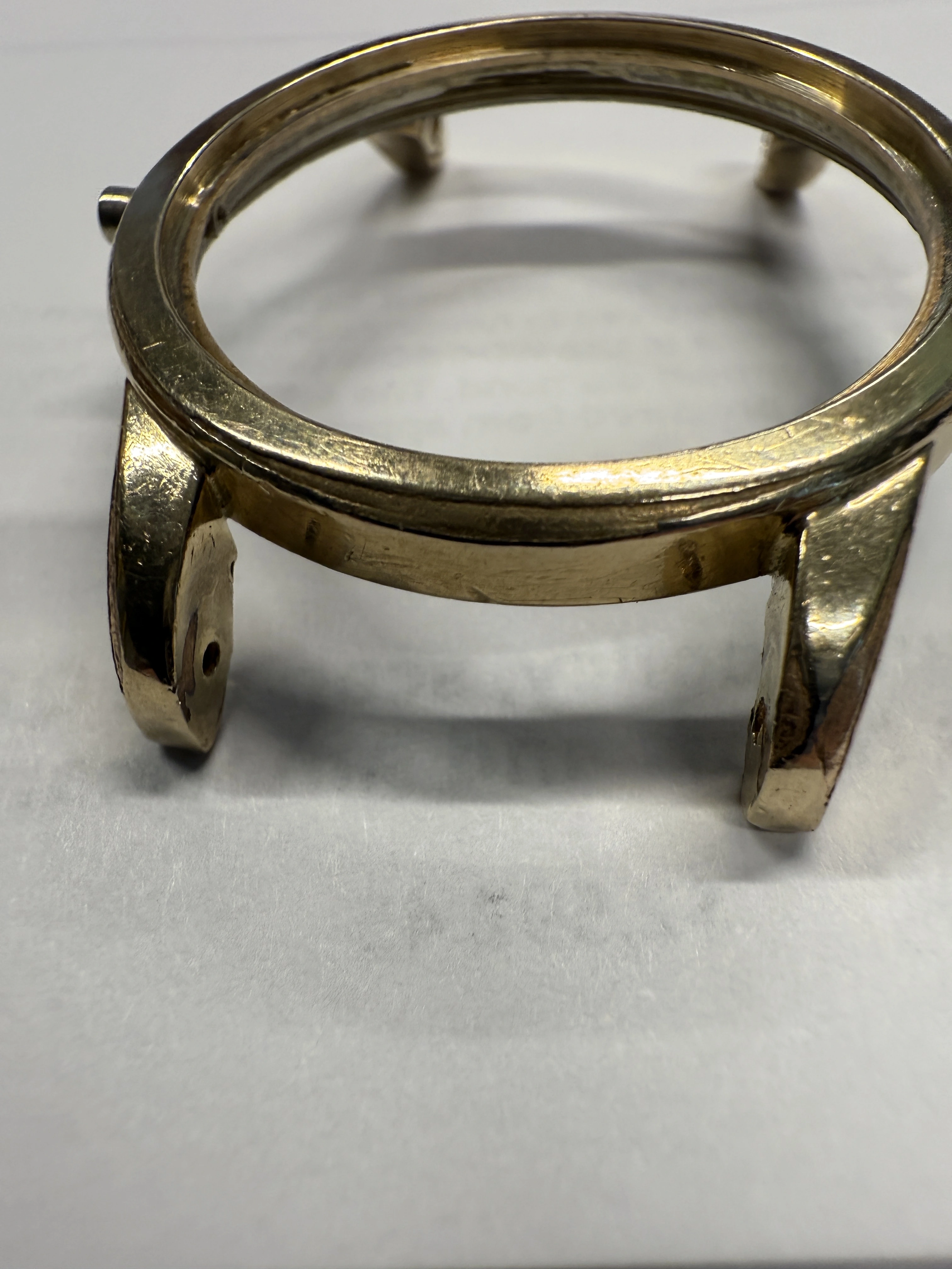

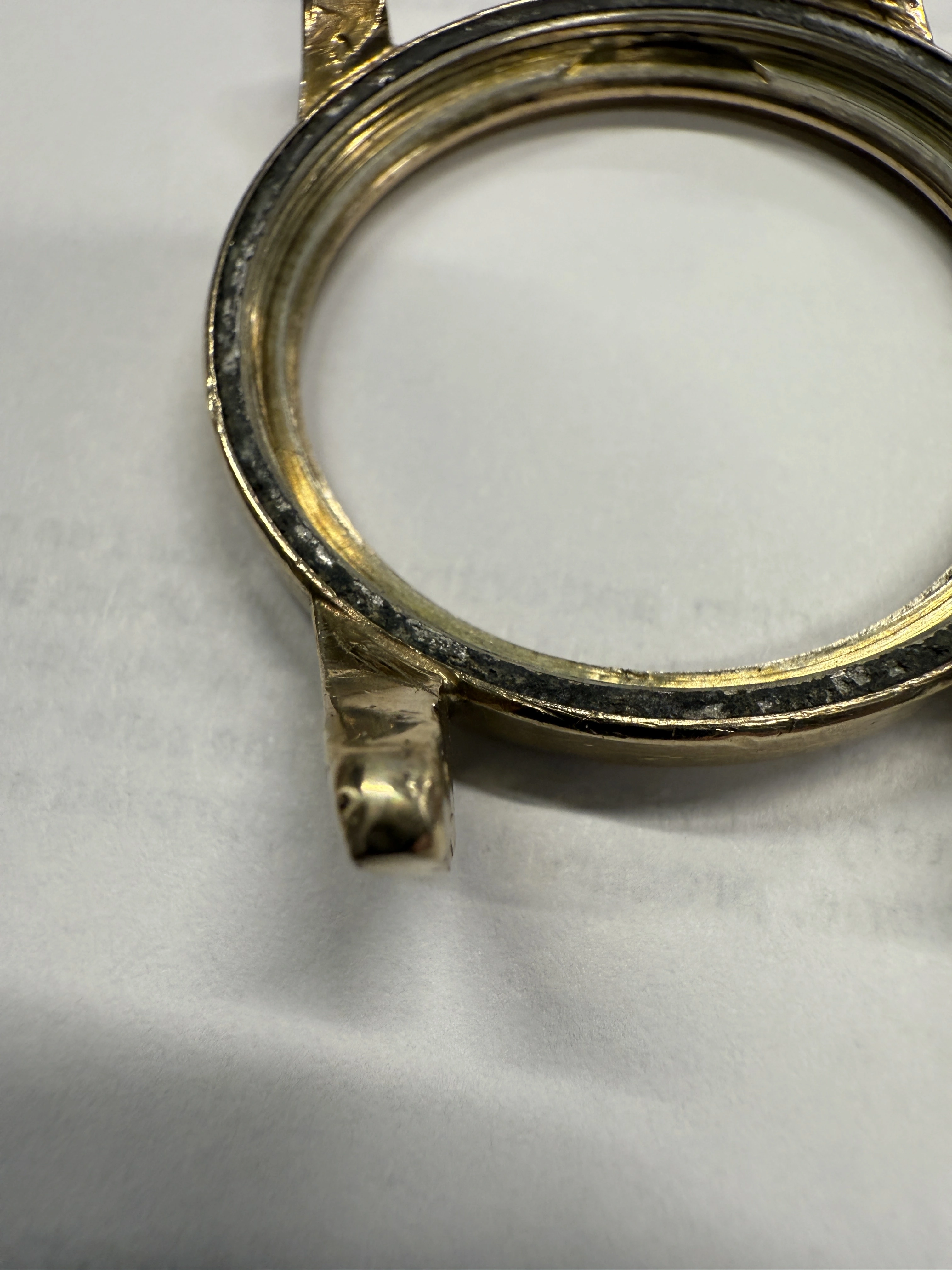

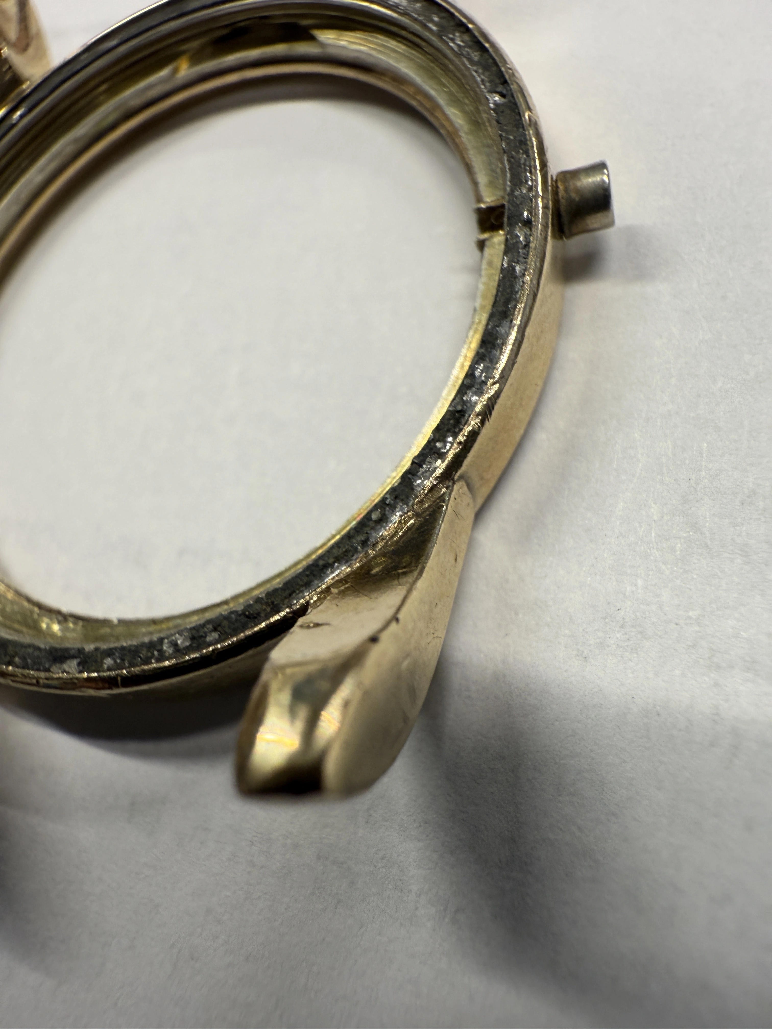

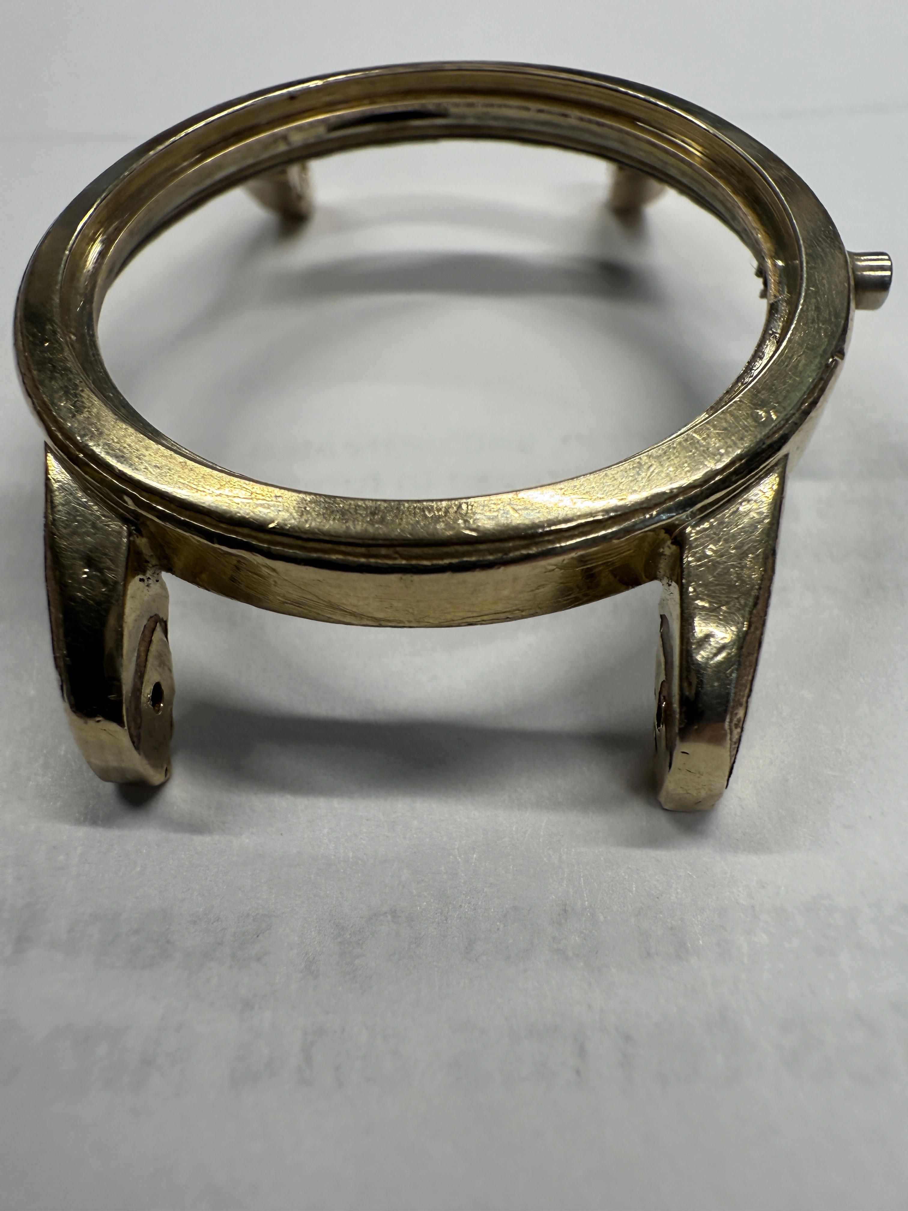

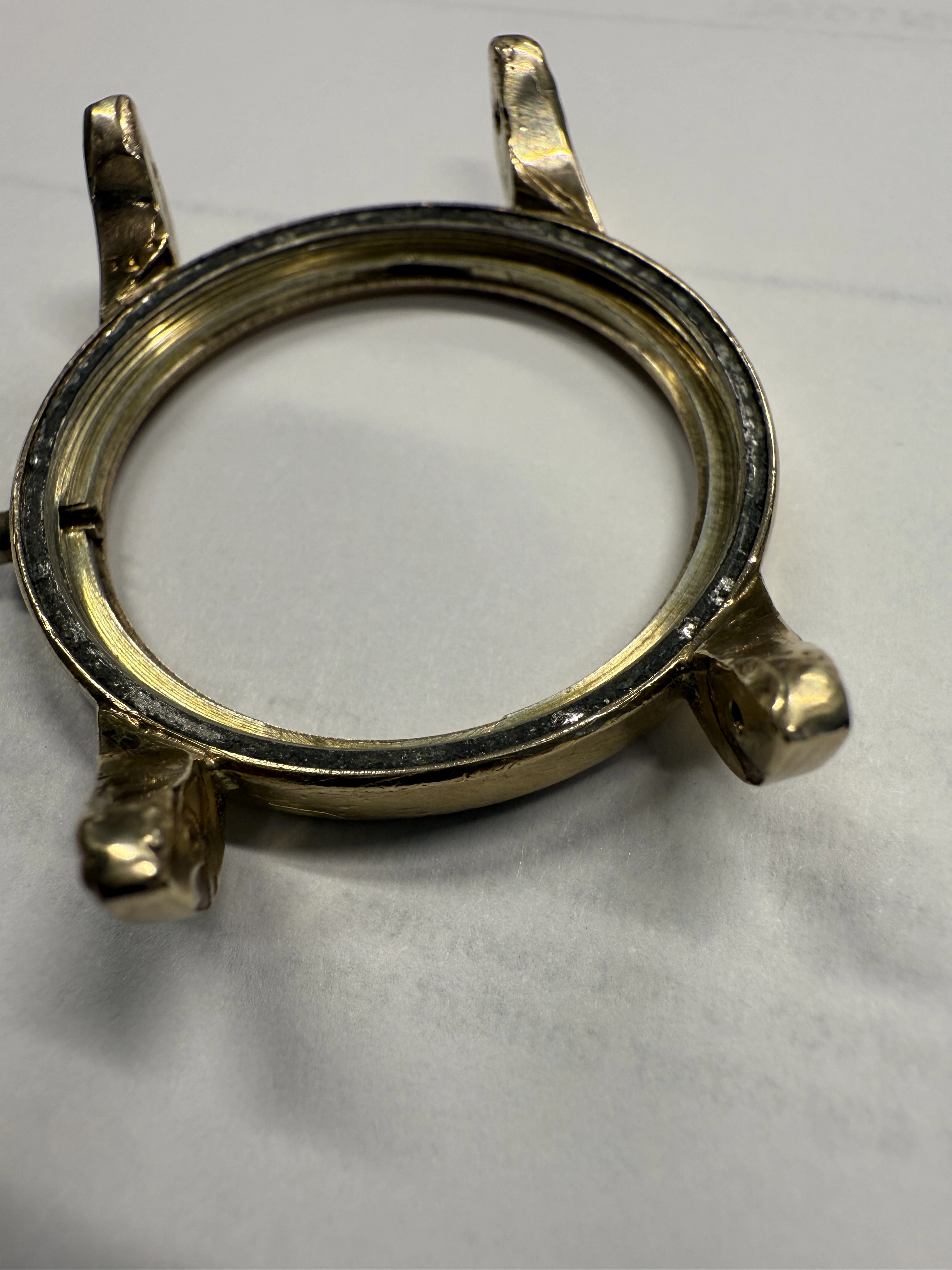

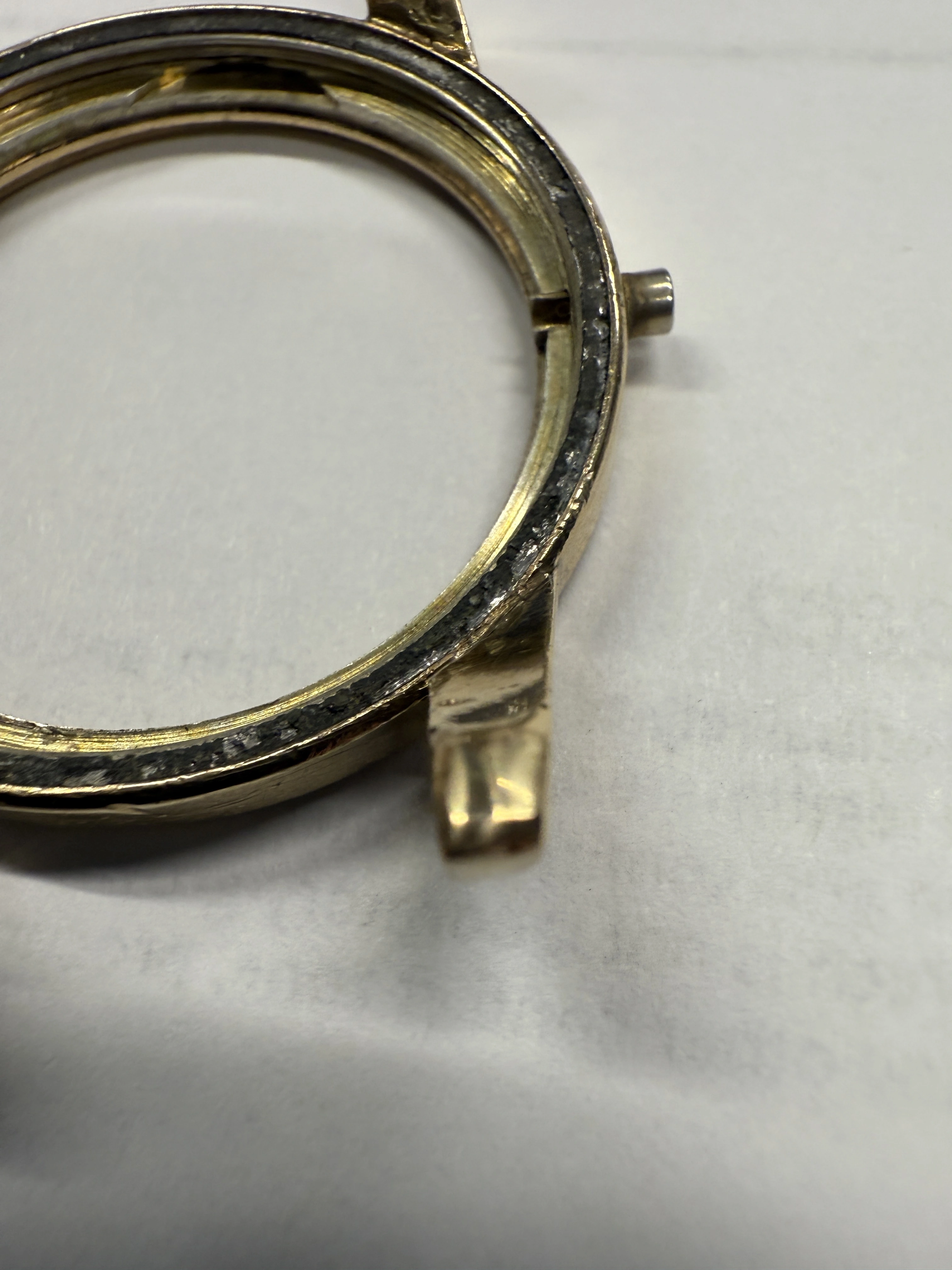

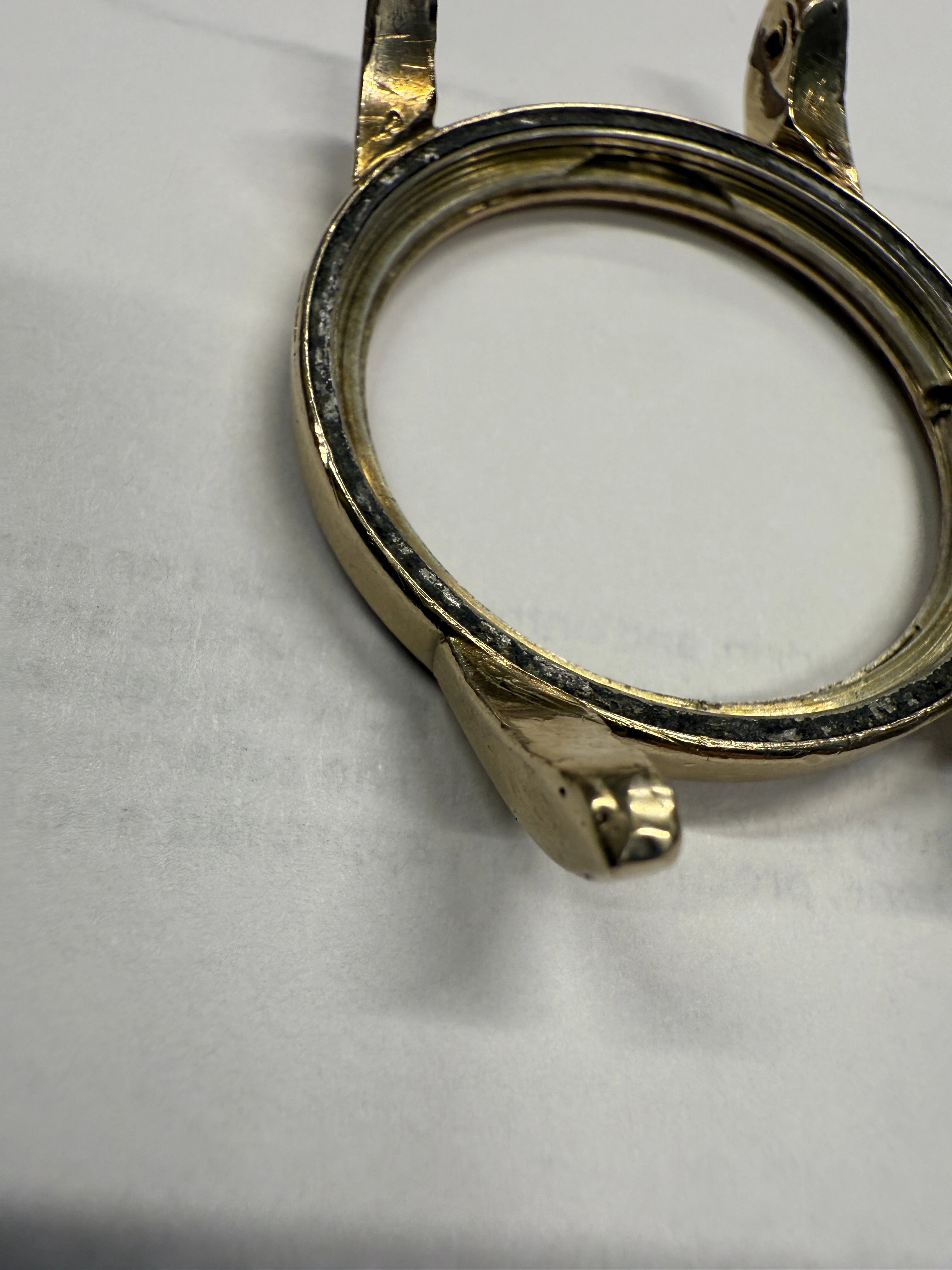

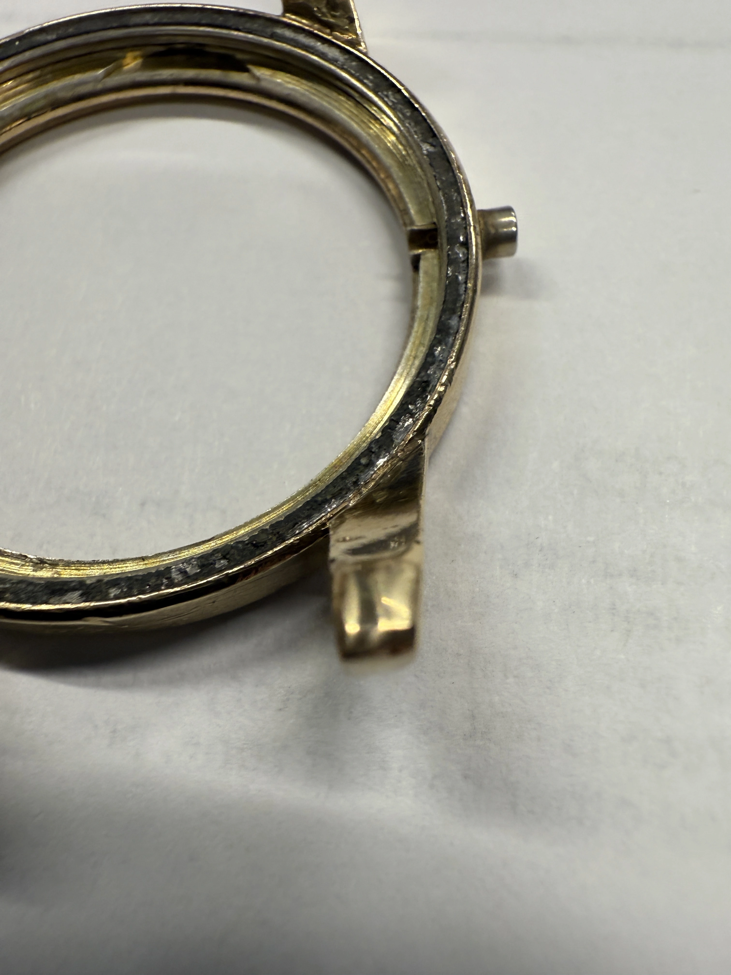

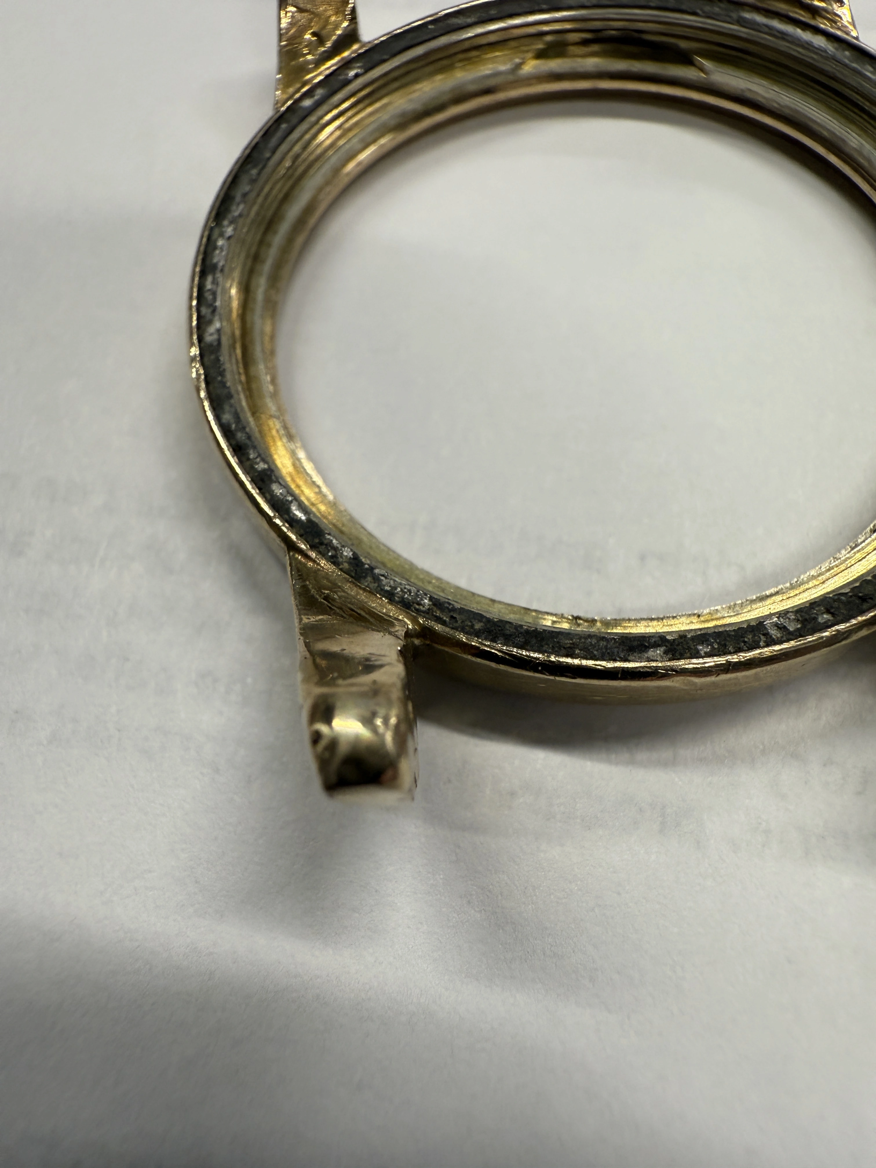

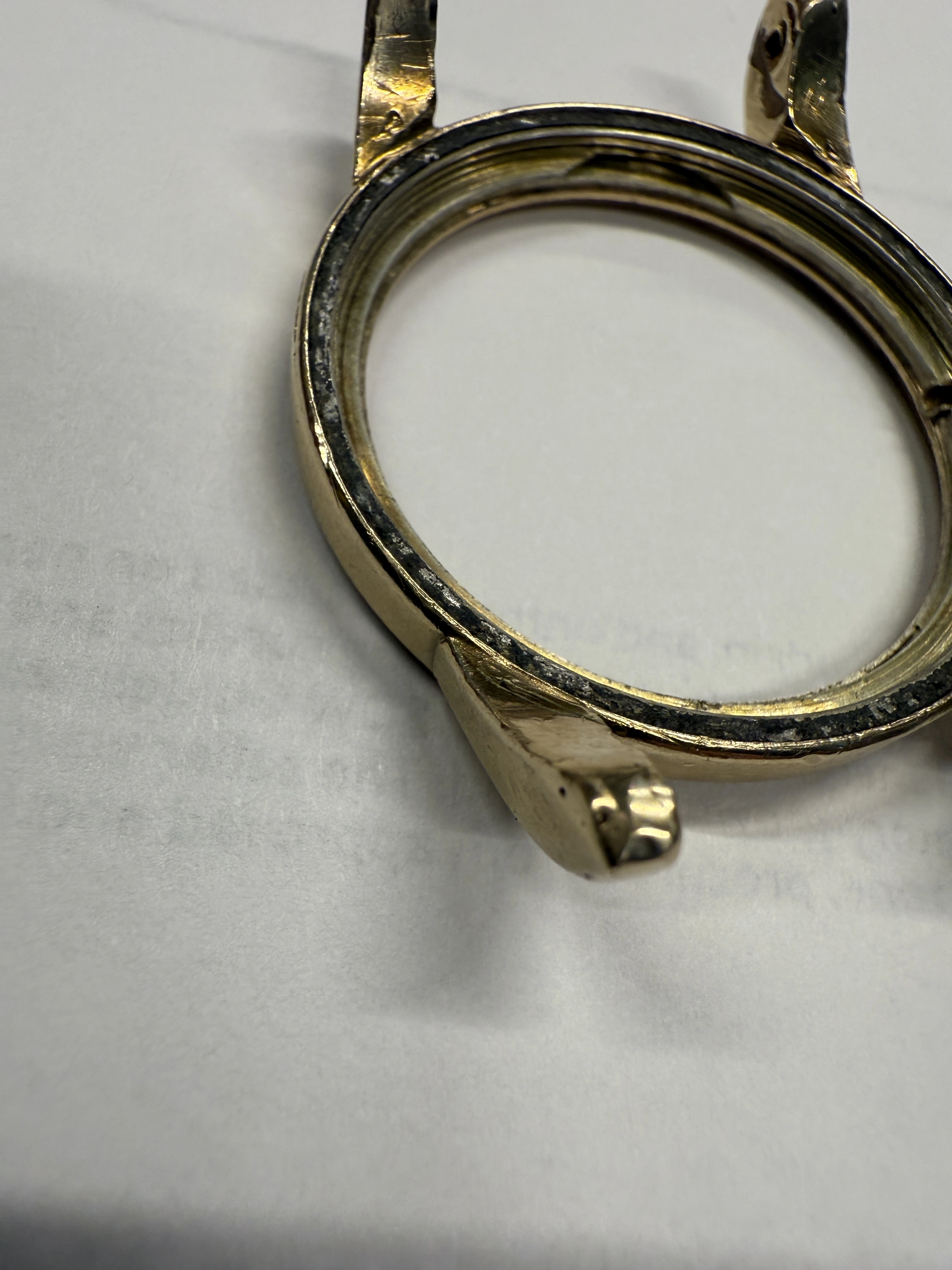

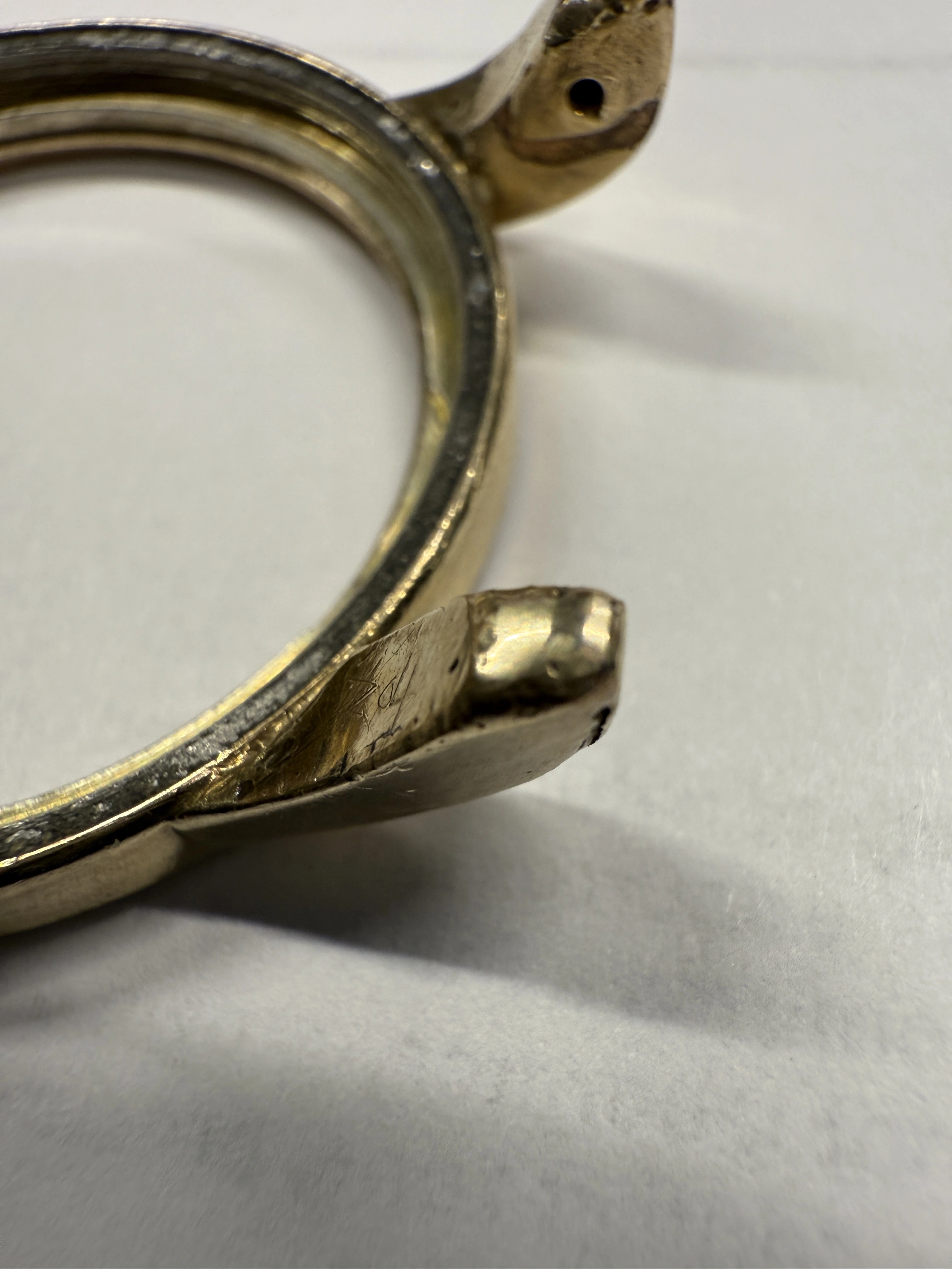

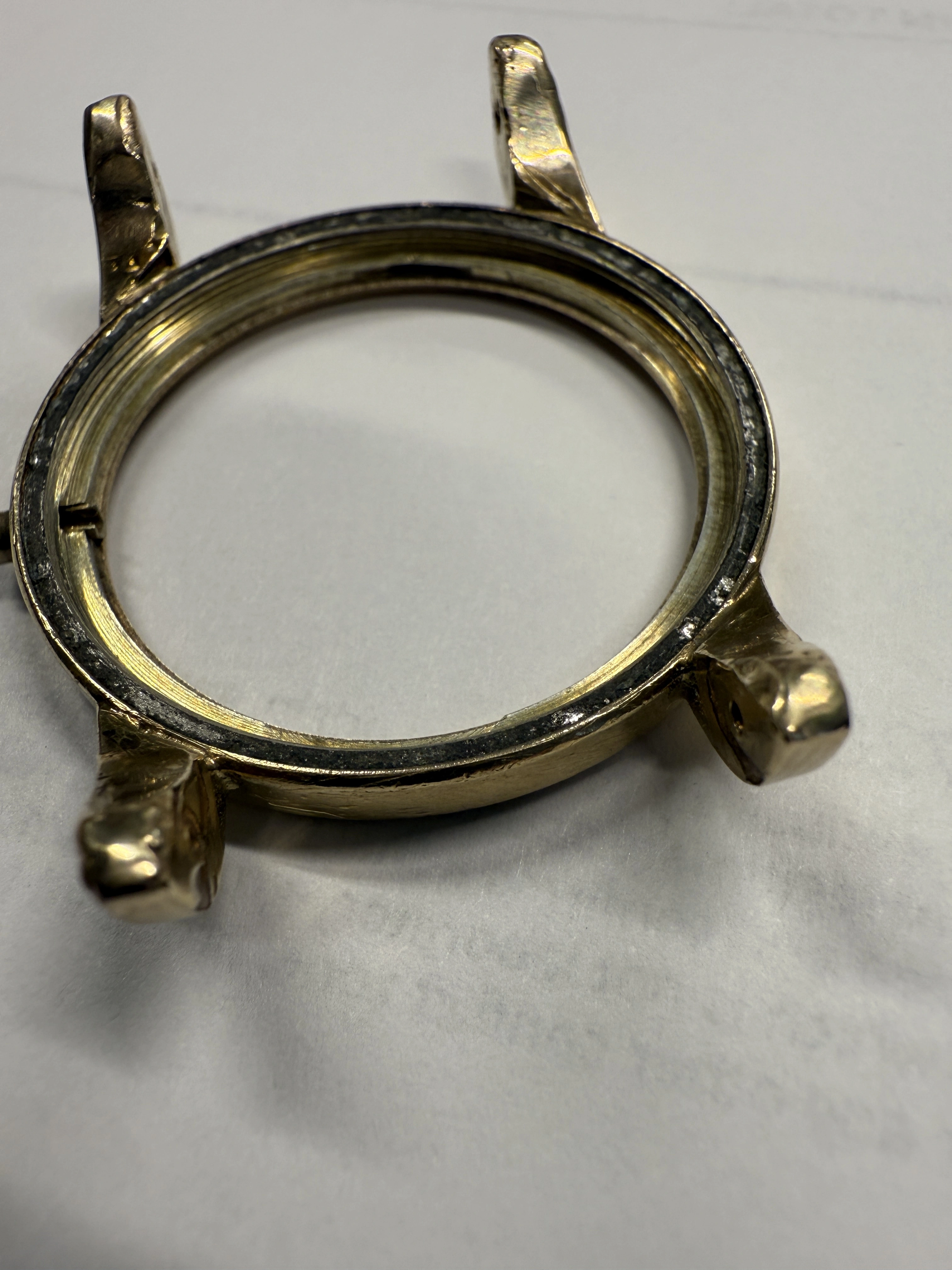

There is a matching chunk missing from the case as well. Where the gasket is missing. Looks like someone attempted to drill a hole in it. Or tried to pry the back off with something that twisted.

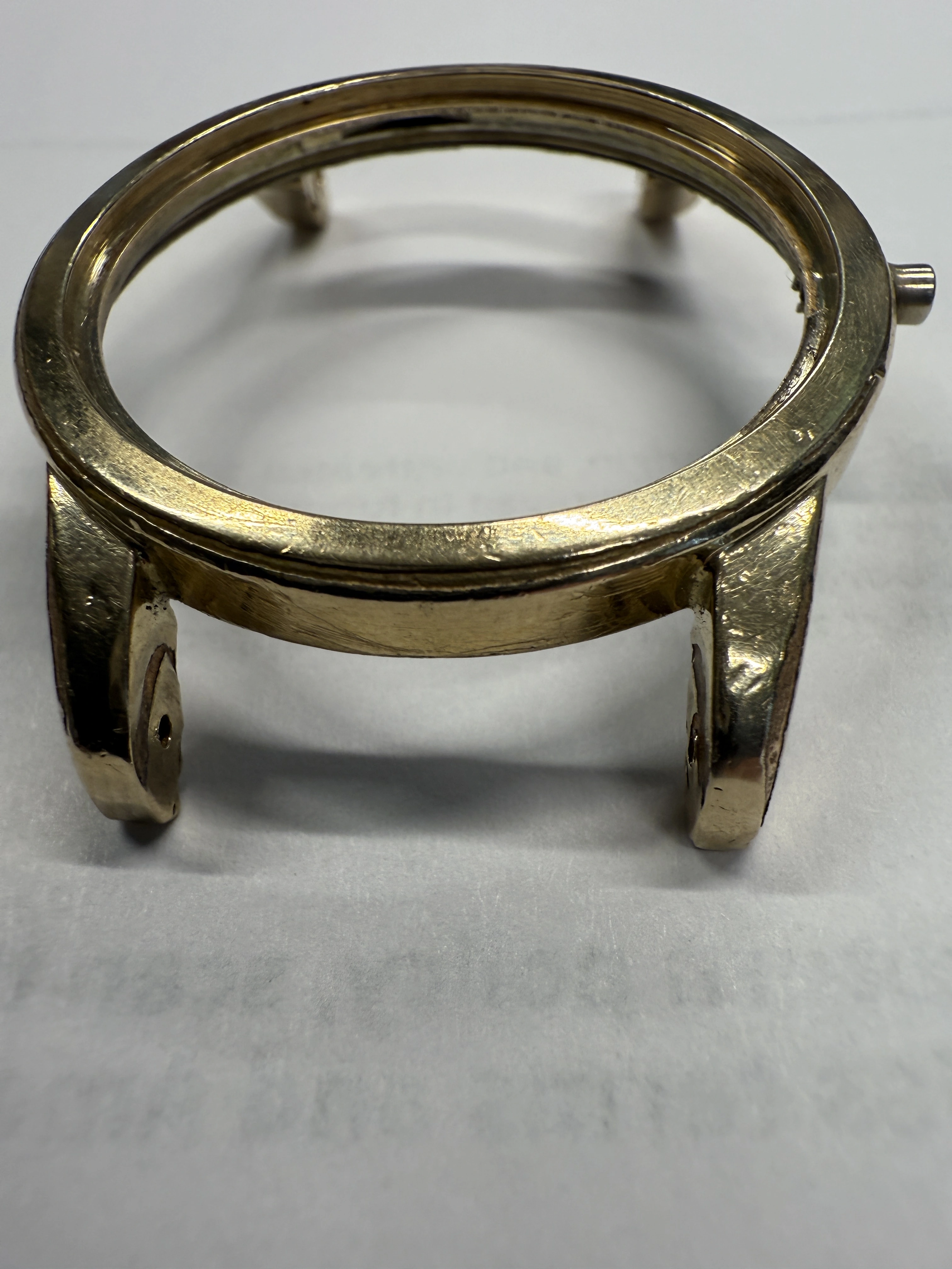

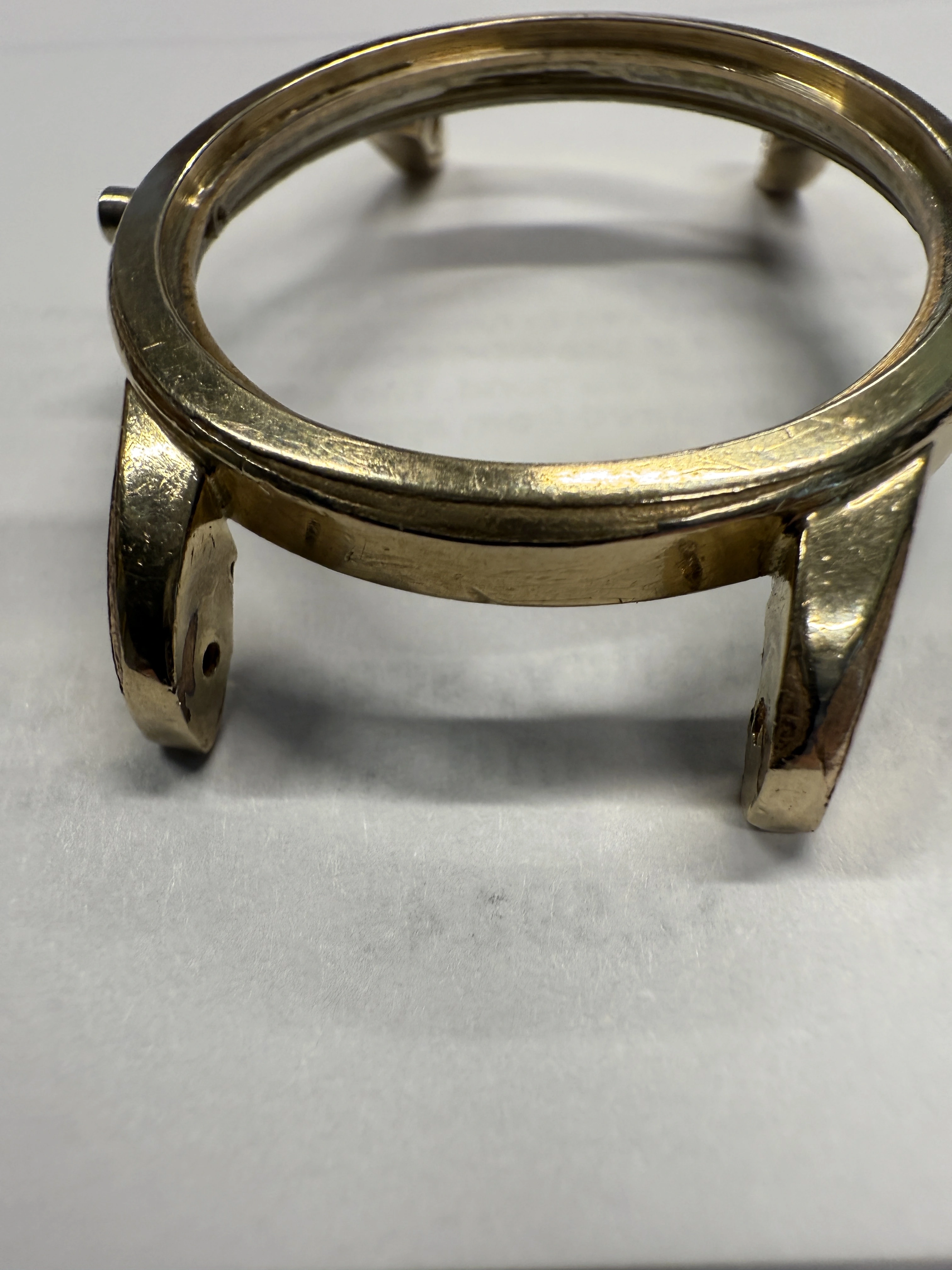

Repairing stainless steel with a laser welder is very effective and usually has excellent results.

Mind you, if it's near the threaded part of the case, that could pose a problem.

I have a feeling this will work even better on gold capped watches but yet to have a try.
