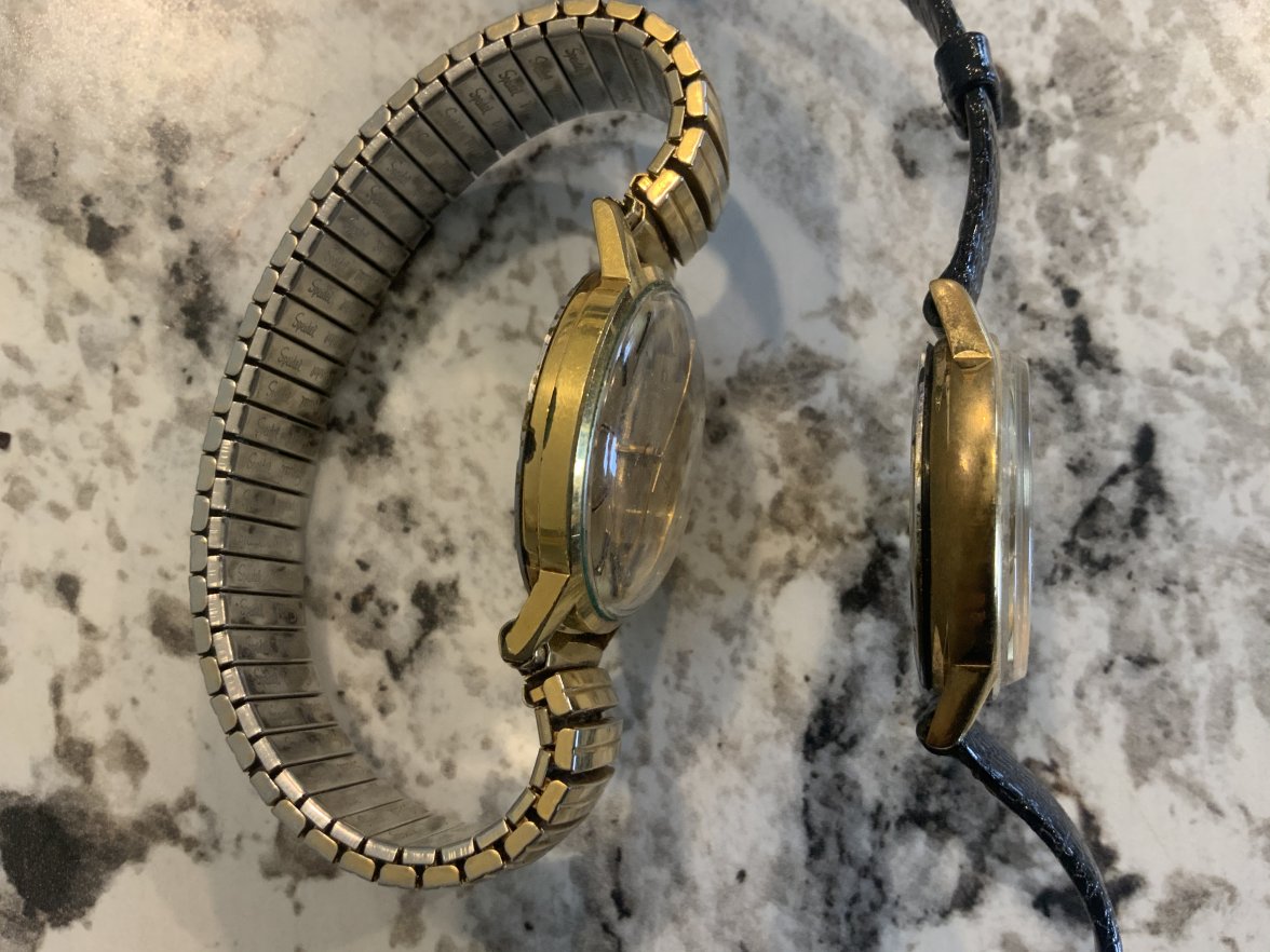

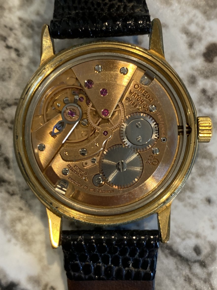

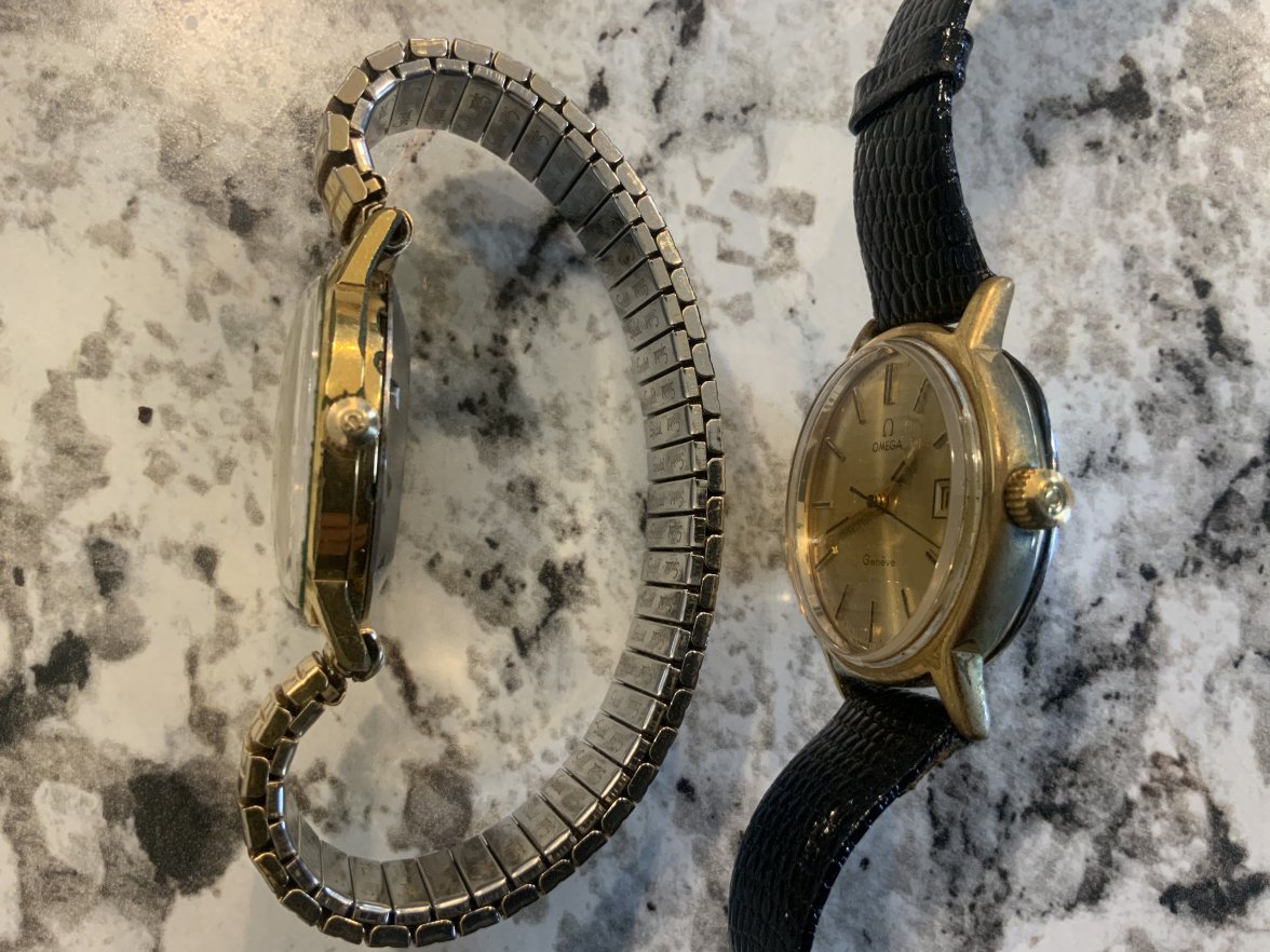

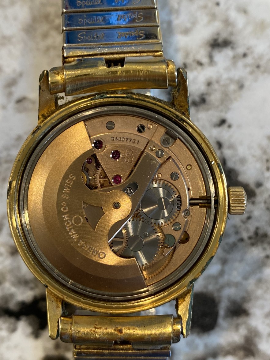

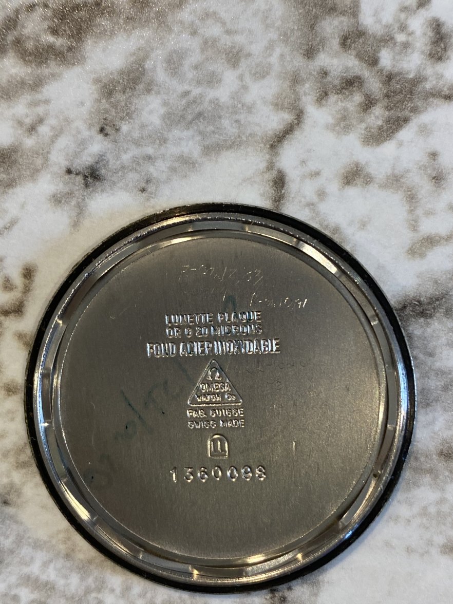

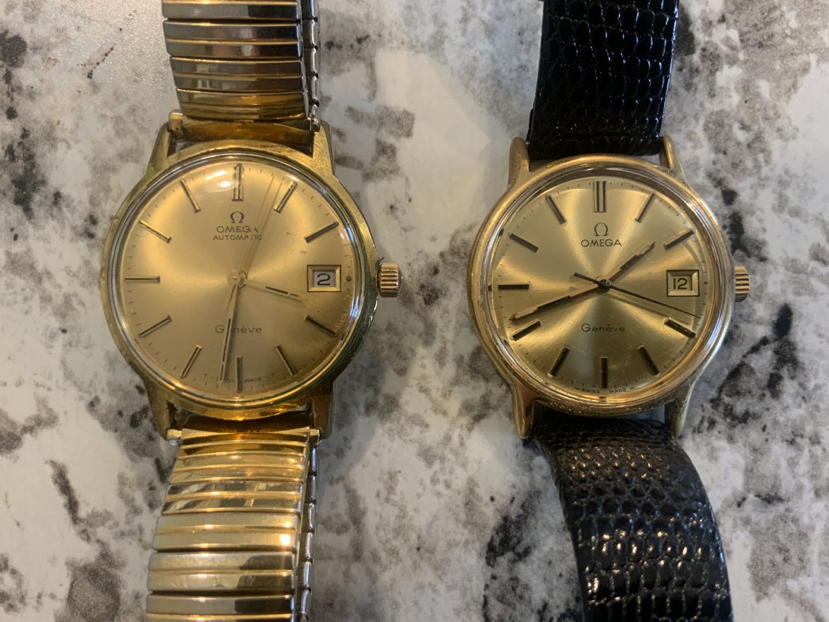

Hi,
New to this forum but not to the world of Omega.

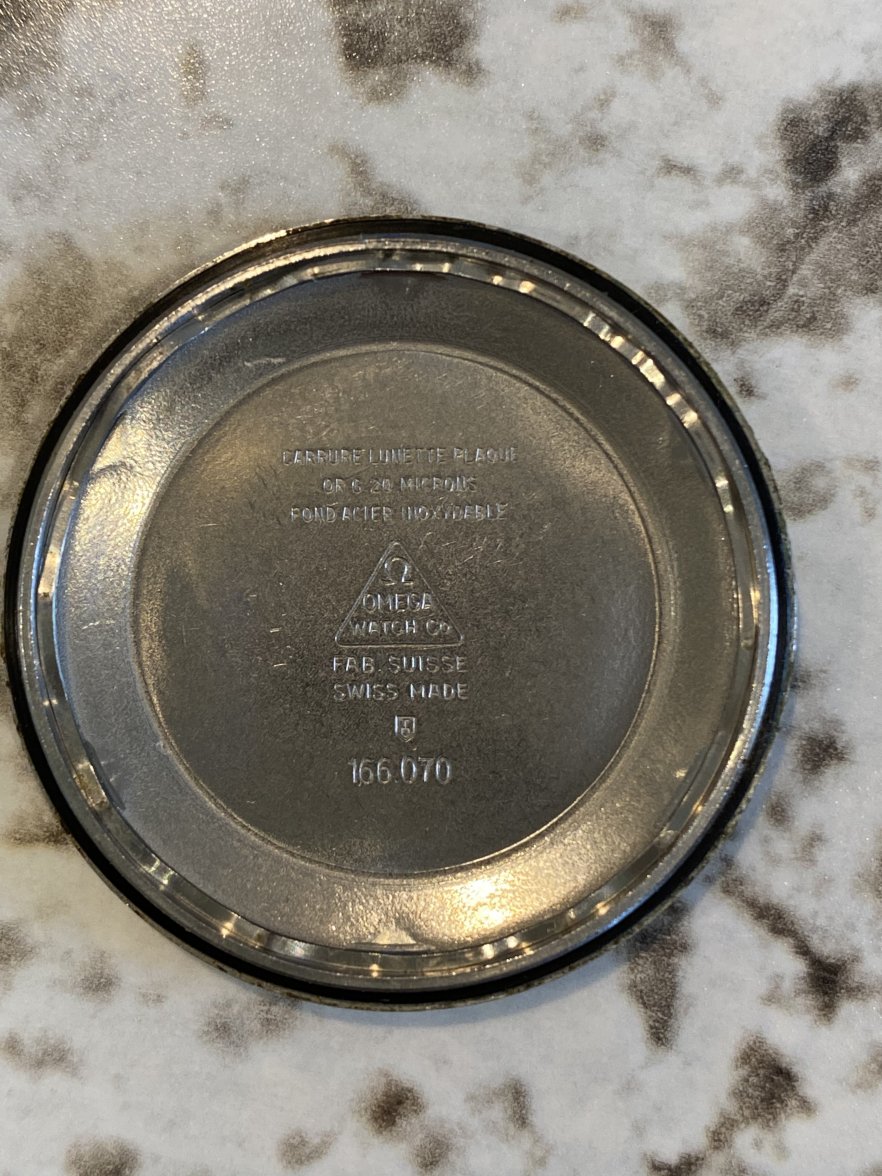

I have two old Omega Geneves. One reads 1360098, and the other 166.070. Both are ok mechanically, but the cases have been seriously damaged on each. On the former, I had paid to have the case replated, and a horrible job was done. The edges were all smoothed out, and then to add insult to injury, the plating only last 5 wears before starting to come off.
I would love to know more about these watches too. I’m guessing they are likely pretty commonplace on the Omega line of the time. Anything to watch out for?
Are the cases fixable? Are there places to but replacement ones? Any help is definitely appreciated.
Thanks!
Erik

You might just keep your eyes open for similar examples that aren't running or have bad dials but nice cases and then use your movements and dials. Fixing those cases is of course possible but cost prohibitive.

I’ve had a case worked on and replated by replateit.com in Canada. I was very pleased with their work. Your first watch looks very badly damaged around the lugs. Get in touch anyway and see what they’re able to do.

Thanks Chris.
Yeah, they both are pretty rough. The top one is still original, if chewed up. The bottom was messed up in an attempt to replate it.

Condition is way to poor to replate. In order to do a nice job. You would need to sand all the worn areas so there is not rough spots between the still plated and worn areas.
Top is garbage. Pop the movement and toss the rest. Second is better, but if it were mine. Keep movement. Dump the case also.
Cases pop up on Ebay, so might find something or sell the movements and use the money to buy a better watch

The first thing to do is remove that Horrible speidel bracelet - that has caused catastrophic wear To the inside of the lugs ( then throw it away or just place in a draw)
As others have said, just look on ebay for replacement cases (Set up a search)

Especially the top case is beyond repair IMO. Either way I would say look for cases on eBay or maybe even a Geneve with a nice case and a horrible dial so you can pop your movement and dial in.

As stated, there is a lot of sentimental attachment with both watches. The top one was my dads (he couldn’t wear leather bands, hence the Speidel - can’t complain - he wore it for 40 years!), while the other belonged to my uncle. Neither one will be sold, but rather will be passed down through the family. Making financial sense isn’t really the issue. As such, if the cases can be fixed, I’d prefer that. The second one was likely too mangled by the previous attempt at replating. At least the first one, other then the obvious damage, is still “original”.
I honestly have no idea what can be done to fix the first one. I don’t know at one point they become actually unrepairable, as compared to the repair being economically unviable.

I wonder if you could just learn to love them as they are. Their sentimental value is due to the fact that they were worn by your father and uncle, so some people could appreciate them as heirlooms in their current condition, without trying to restore them. These were entry-level cases, and not meant to last forever, and the most skilled case restorers don't specialize in this type of work. They primarily work on stainless and gold cases. Regardless of cost, I think that trying to repair them is just going down a rabbit hole, where additional work could actually make things worse. Unfortunately you've already experienced that.

Likely a bit far gone for that. The one that was replated poorly is just plain annoying. That’s a bit of an open wound.
And my dads watch could stand to look better then it does. Especially with the chunks missing. And no, I don’t really know what is possible. I could totally restore a vintage Hemi Cuda convertible with nothing but just the VIN tag. But I don’t have a clue at what point a case becomes unfixable. Which is what I’m here, trying to learn.
