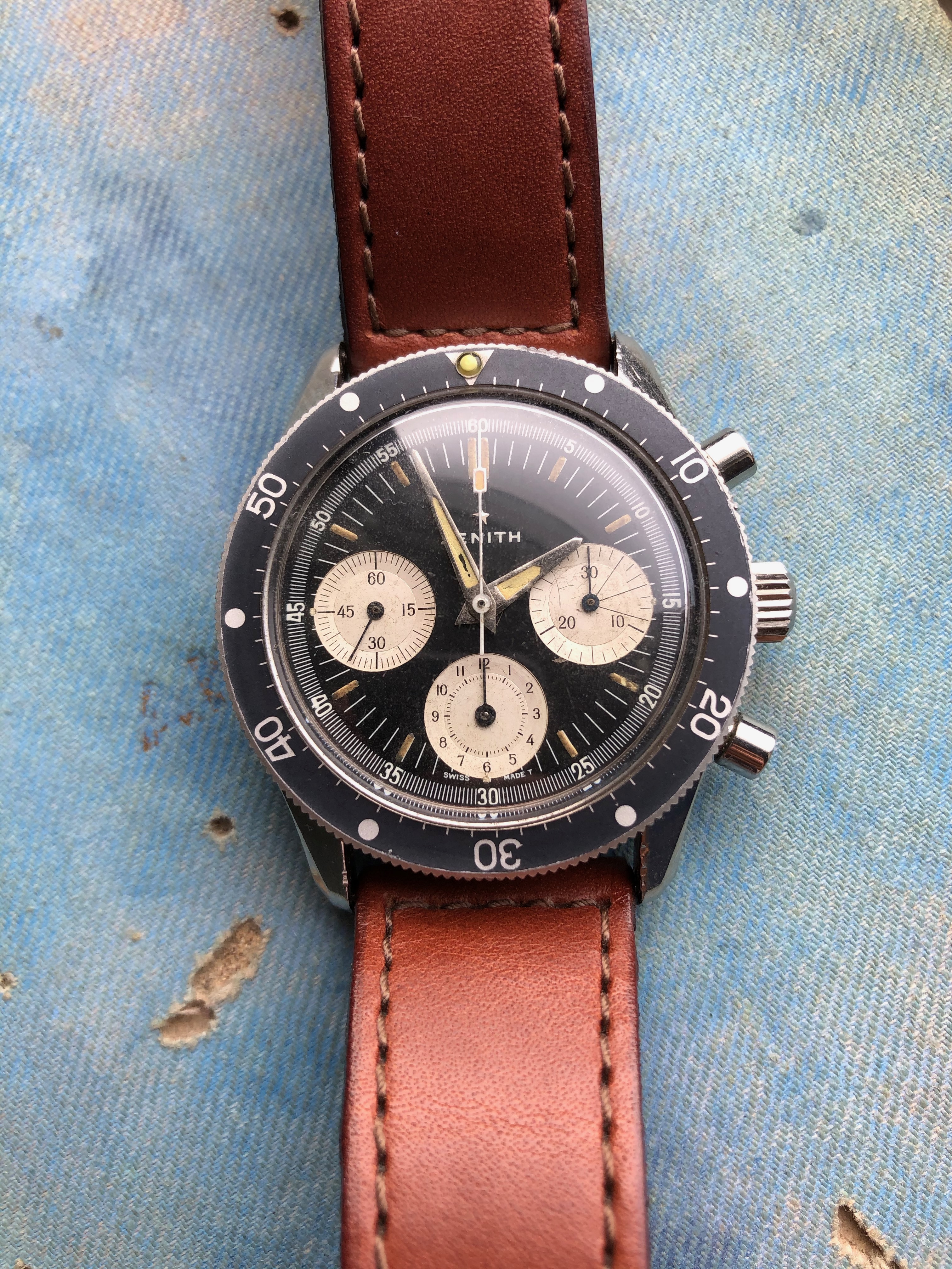

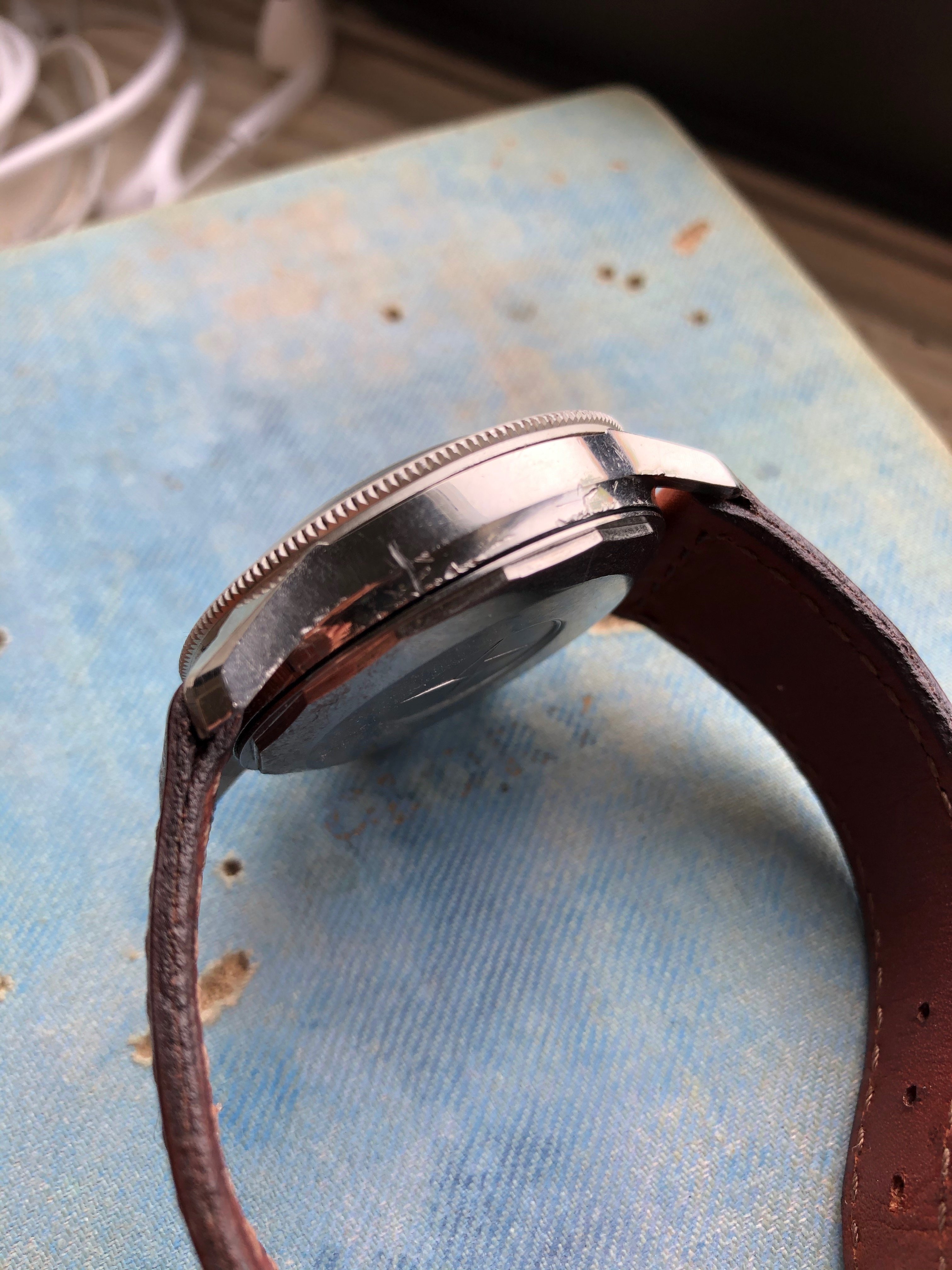

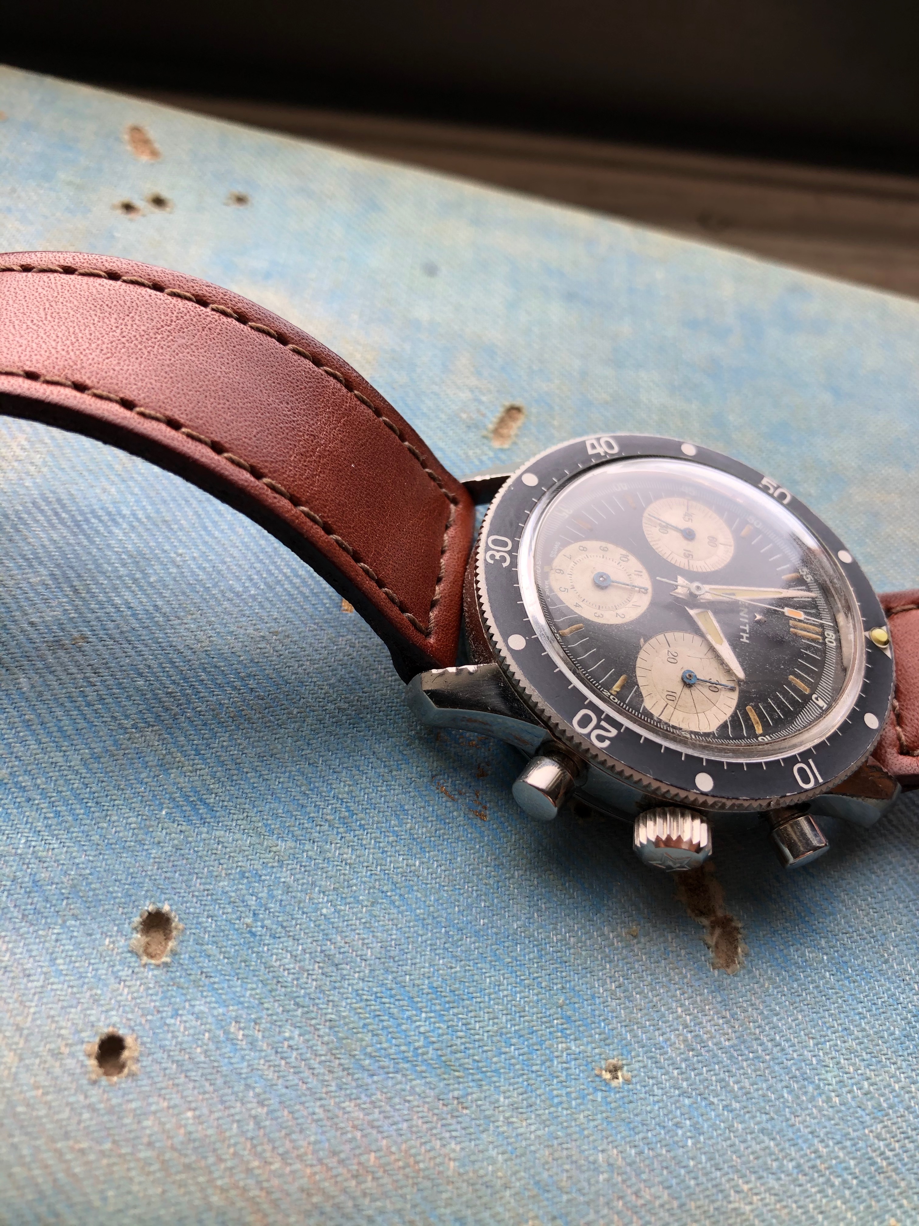

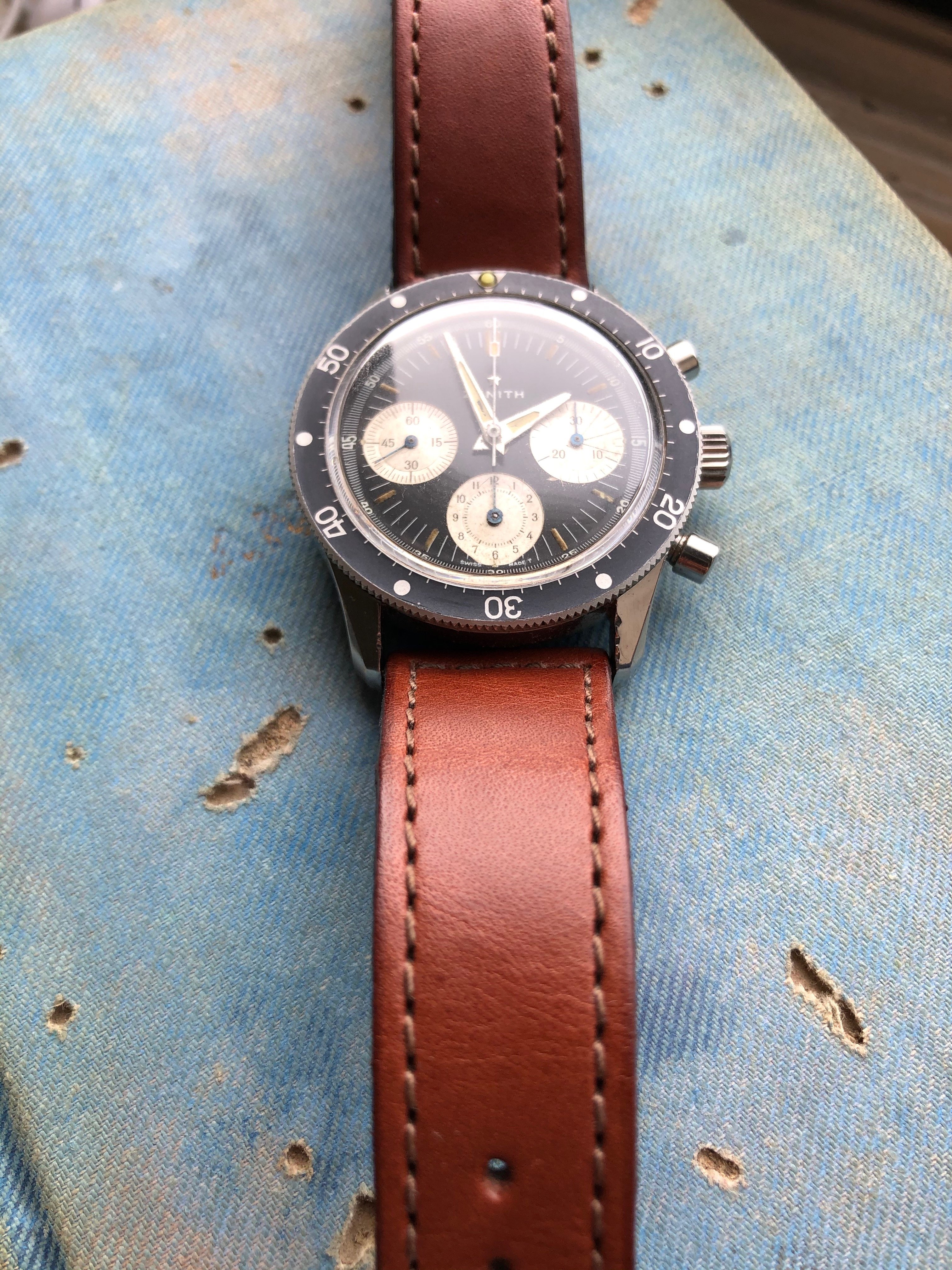

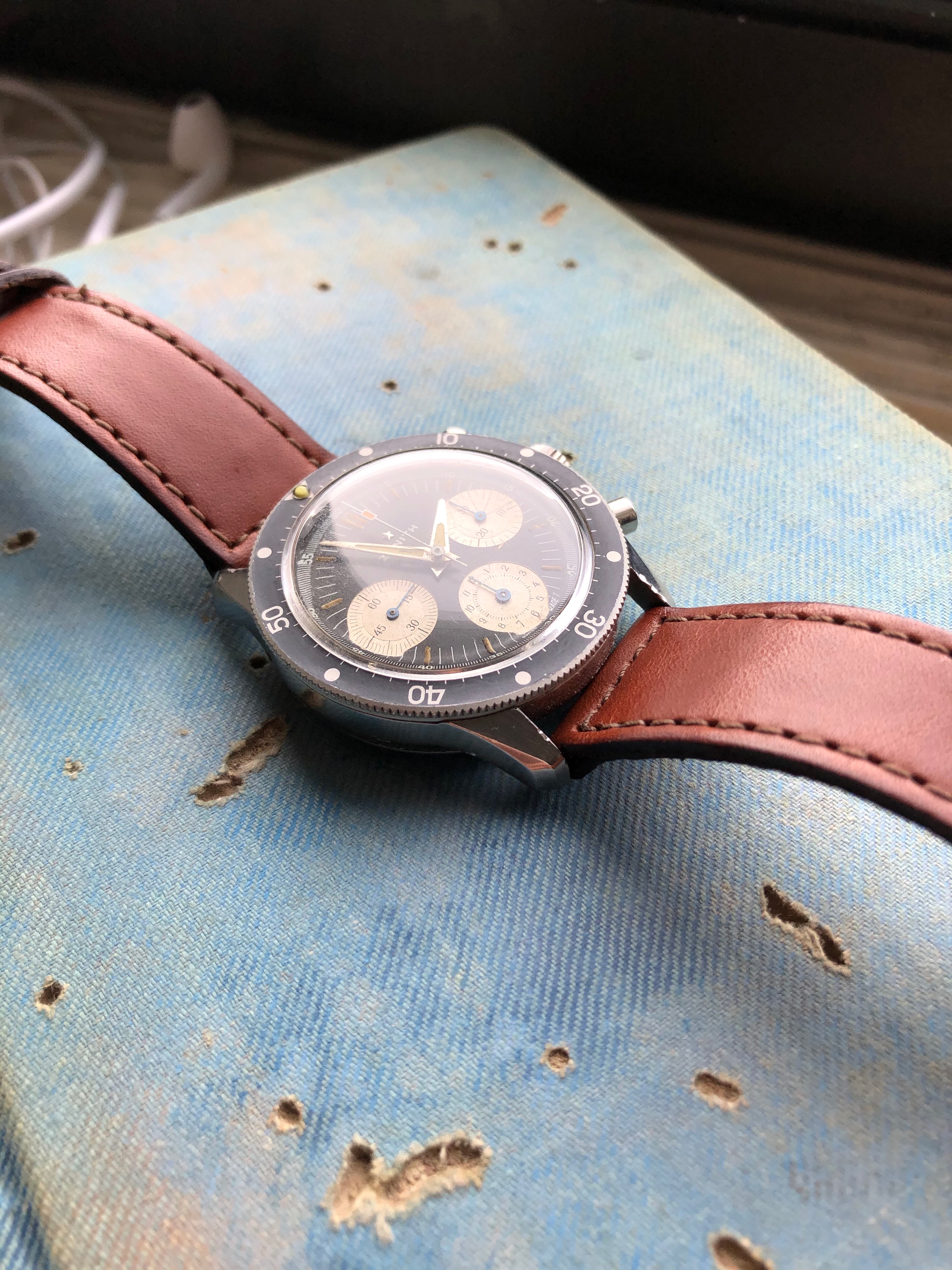

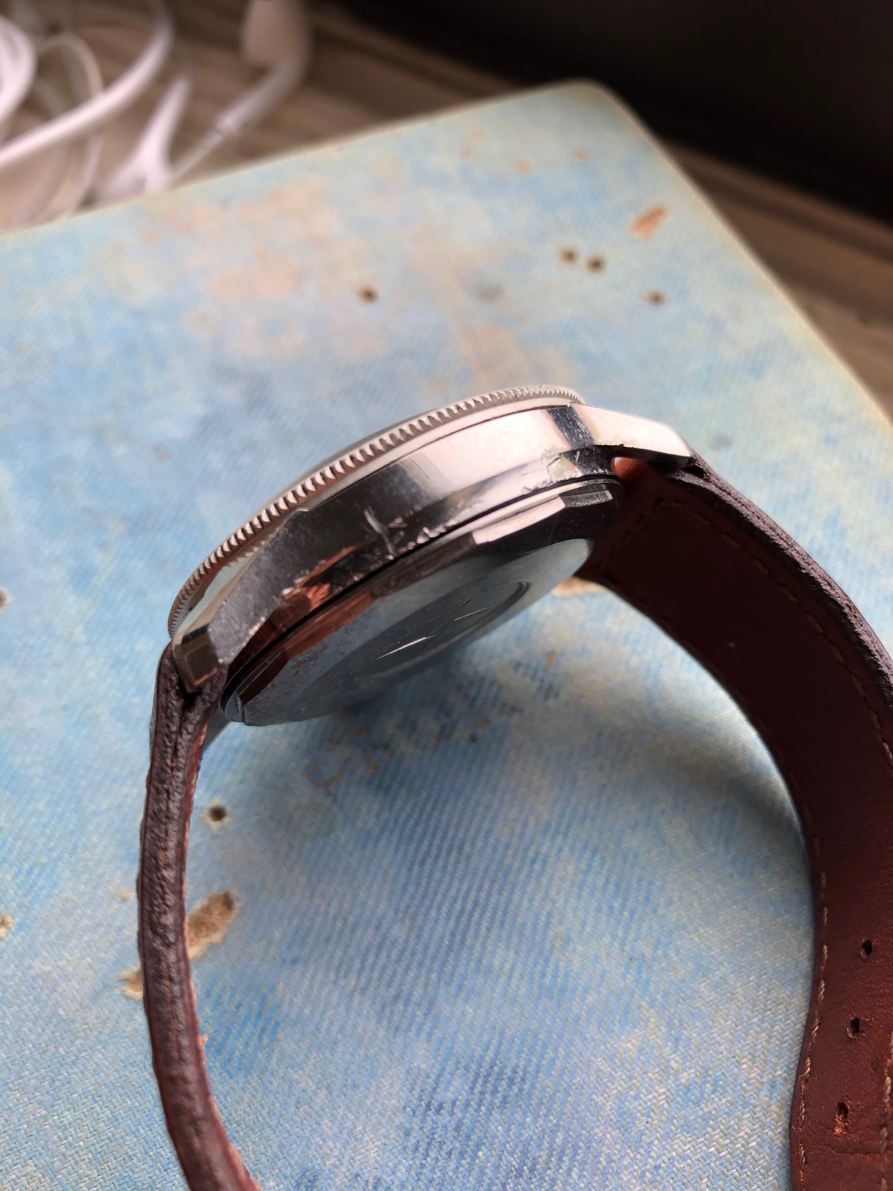

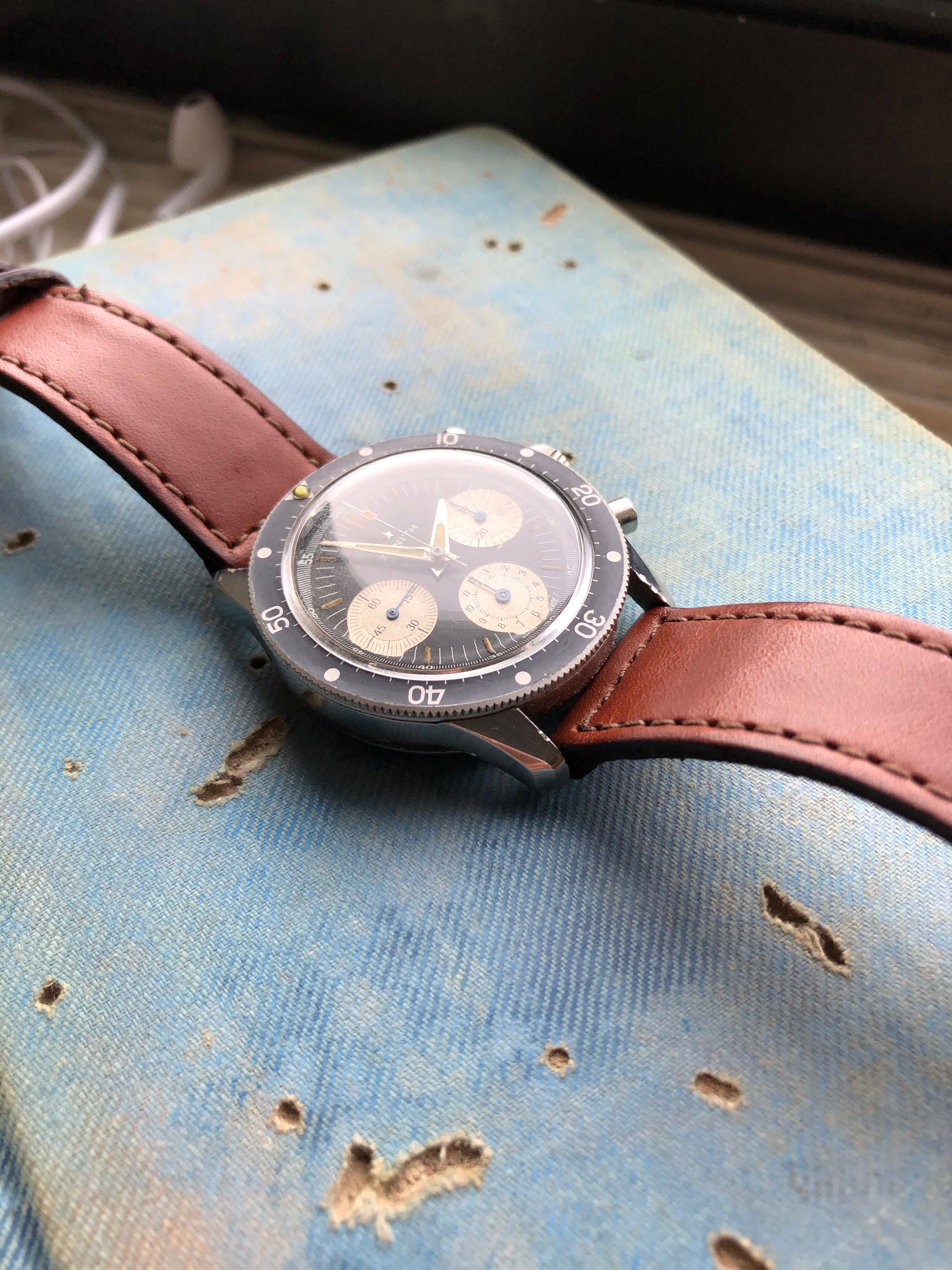

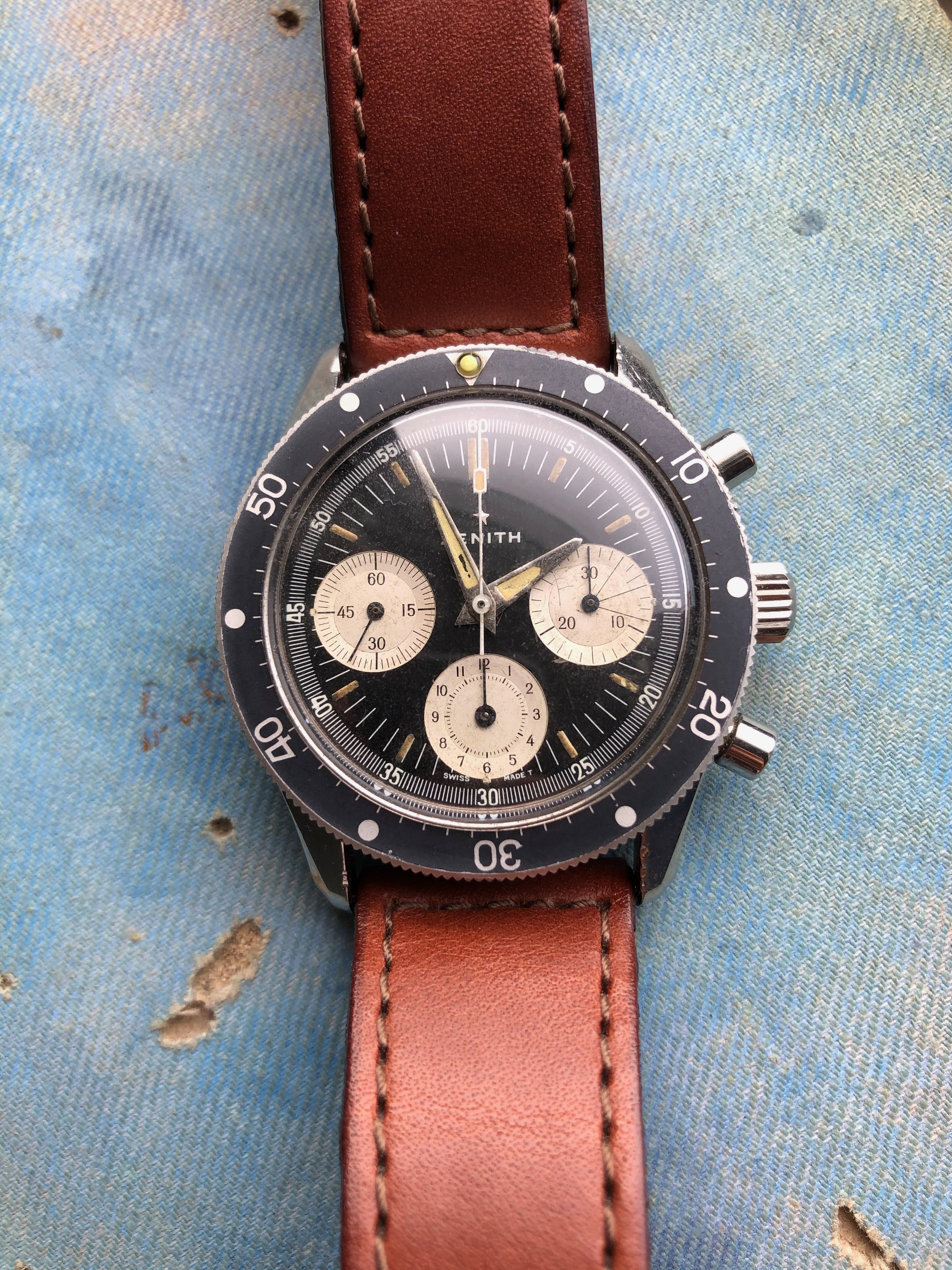

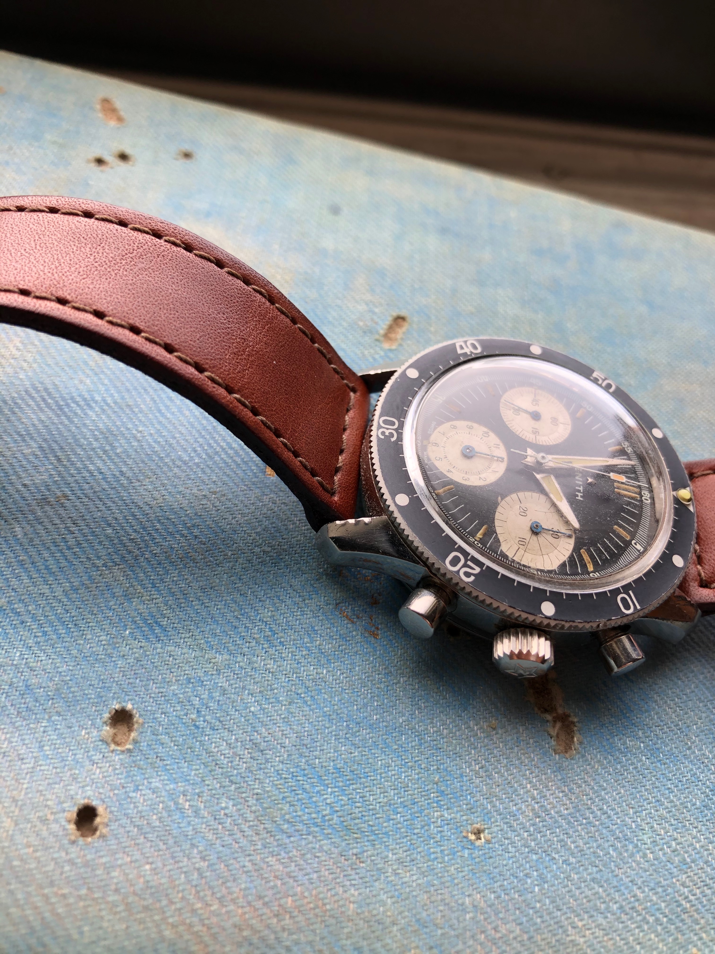

Hey, folks-- I have this A277 that I love. In fact, I love it so much I want to do right by her and started to wonder if it was possible to "fix" a few minor blemishes where, e.g., someone let a bracelet chew up the lug edges. The snag is I really don't want to end up with a new-looking case. I love the patina overall and the real sense that it has had a life, and a "new" case with the aged dial etc. would be a disaster.
Does anyone have any experience with, essentially, touching up a very specific/limited area on a case without disturbing the overall wear everywhere else? It's really just the top inside lug edges,
Some pics below--I tried to take some shots that highlight the areas ...
975
1,517
That last pic is the other area that has a bit of chewed up edge where case meets back...

Do you know if it would be possible to restore just the very edge/corner of the lug, without ending up with a completely polished lug? It's hard to see, but there are micro abrasions on the flat surfaces of the case--just the kind of very light scratches that come from wearing the watch. If they laser welded the dings on the corner, I would think they would need to do some sort of polishing of the welded area. I wouldn't want that to extend beyond a tight area around the weld.
Perhaps this is a conversation that needs to be had with the welder. Any US-based options out there that come recommended?
781
1,340
I think your last thought hits the nail on the head. There is bound to be some work goes on around/outside the damage as the new material overspills a fraction and has to be worked down.

Repairs might involve adding material by laser welding (over-filling the surface) and then refinishing back to original specs. It's pretty hard (i.e. impossible basically) to just do spot repairs that blend-in well without refinishing the specific surfaces that are being repaired. They can certainly leave the other surfaces alone, but the watch might then look unevenly finished.
