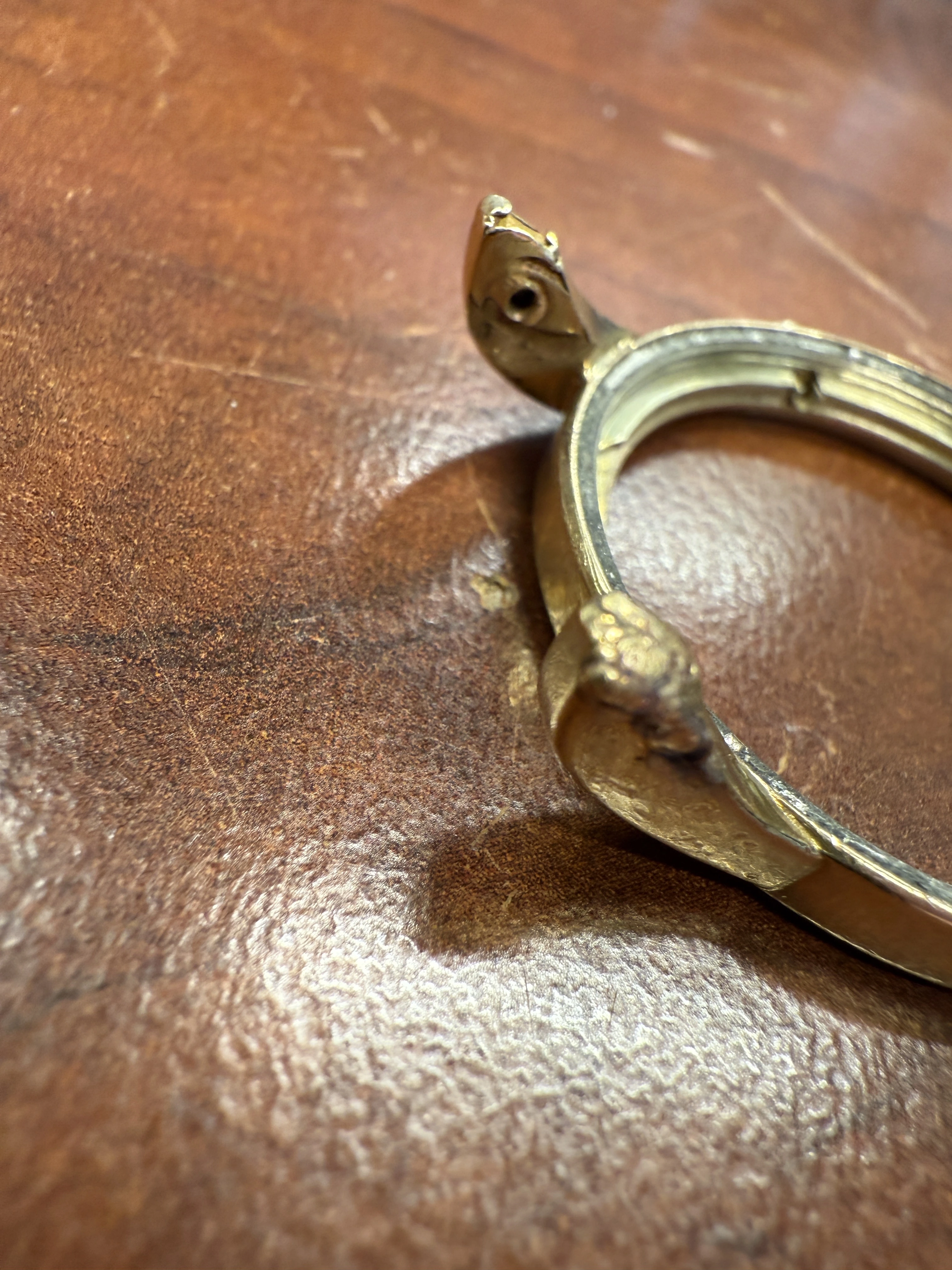

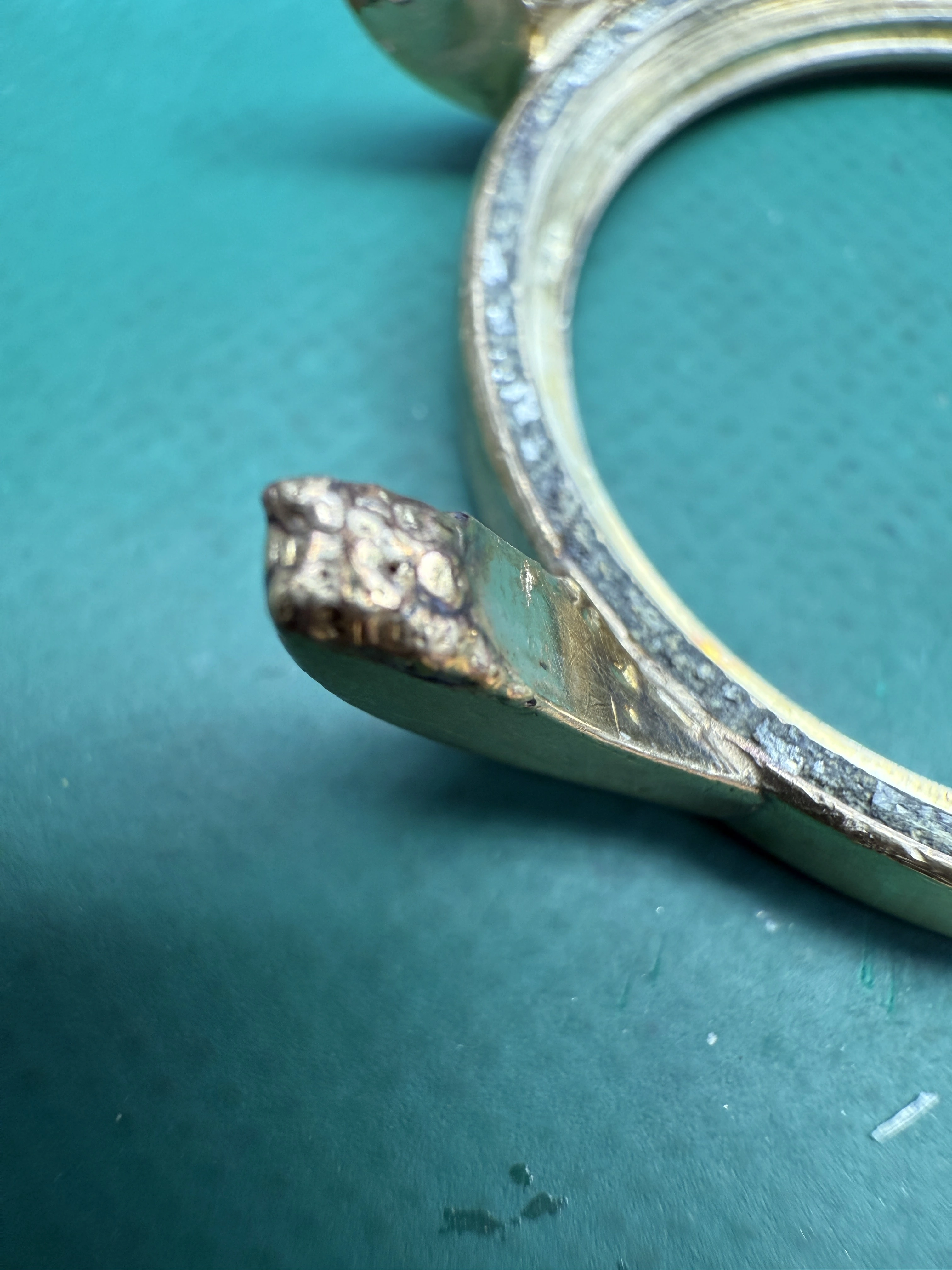

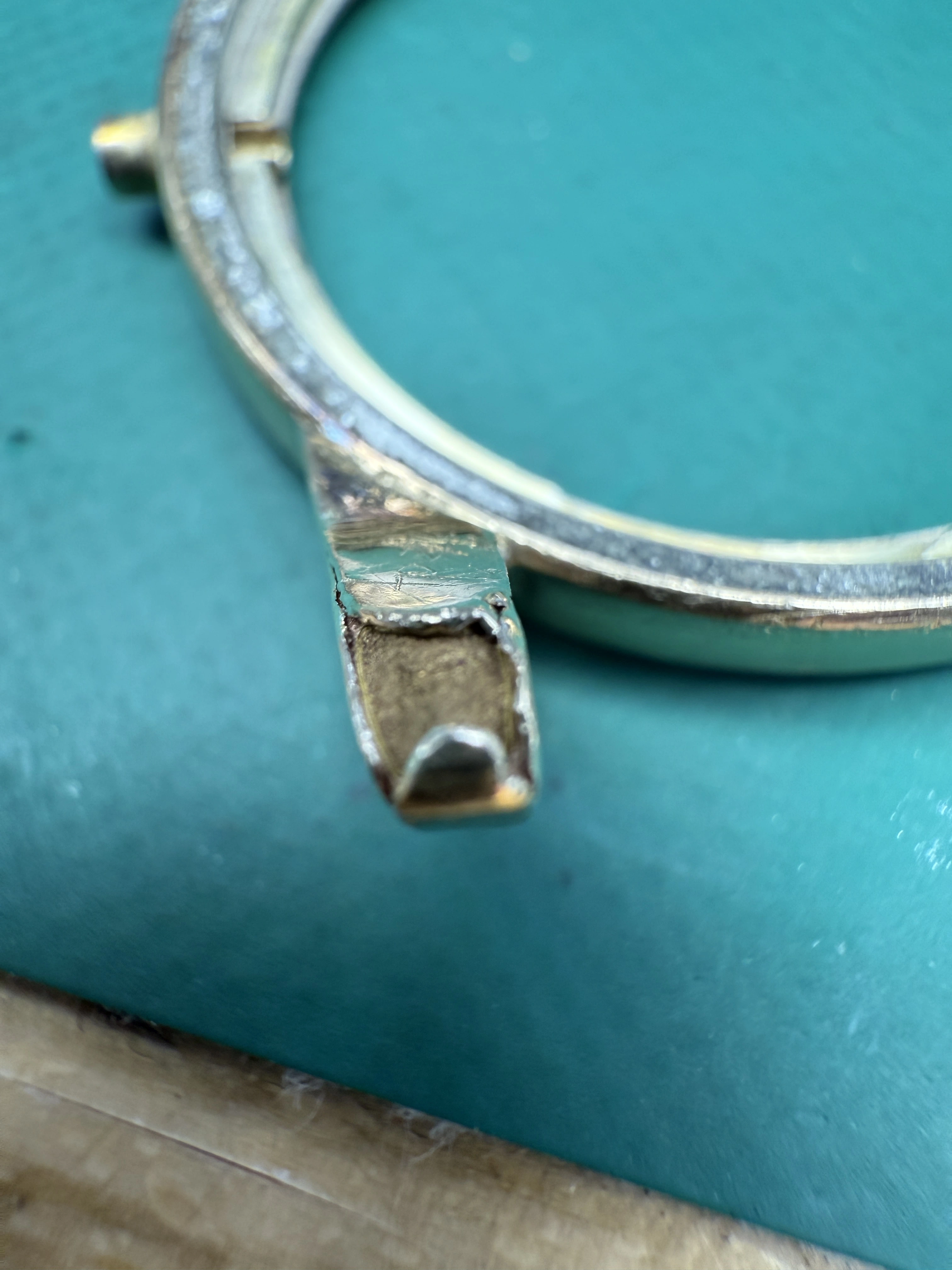

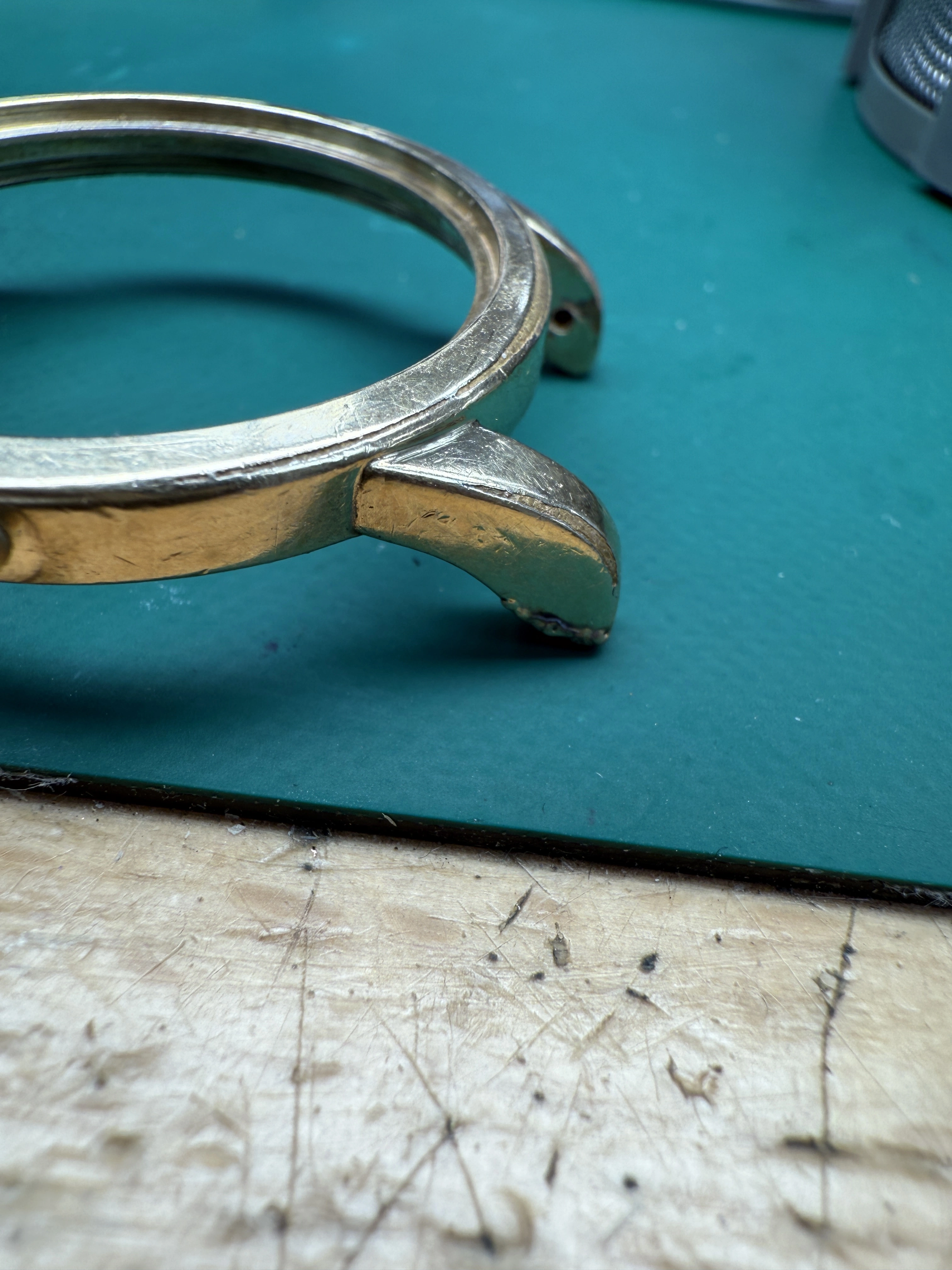

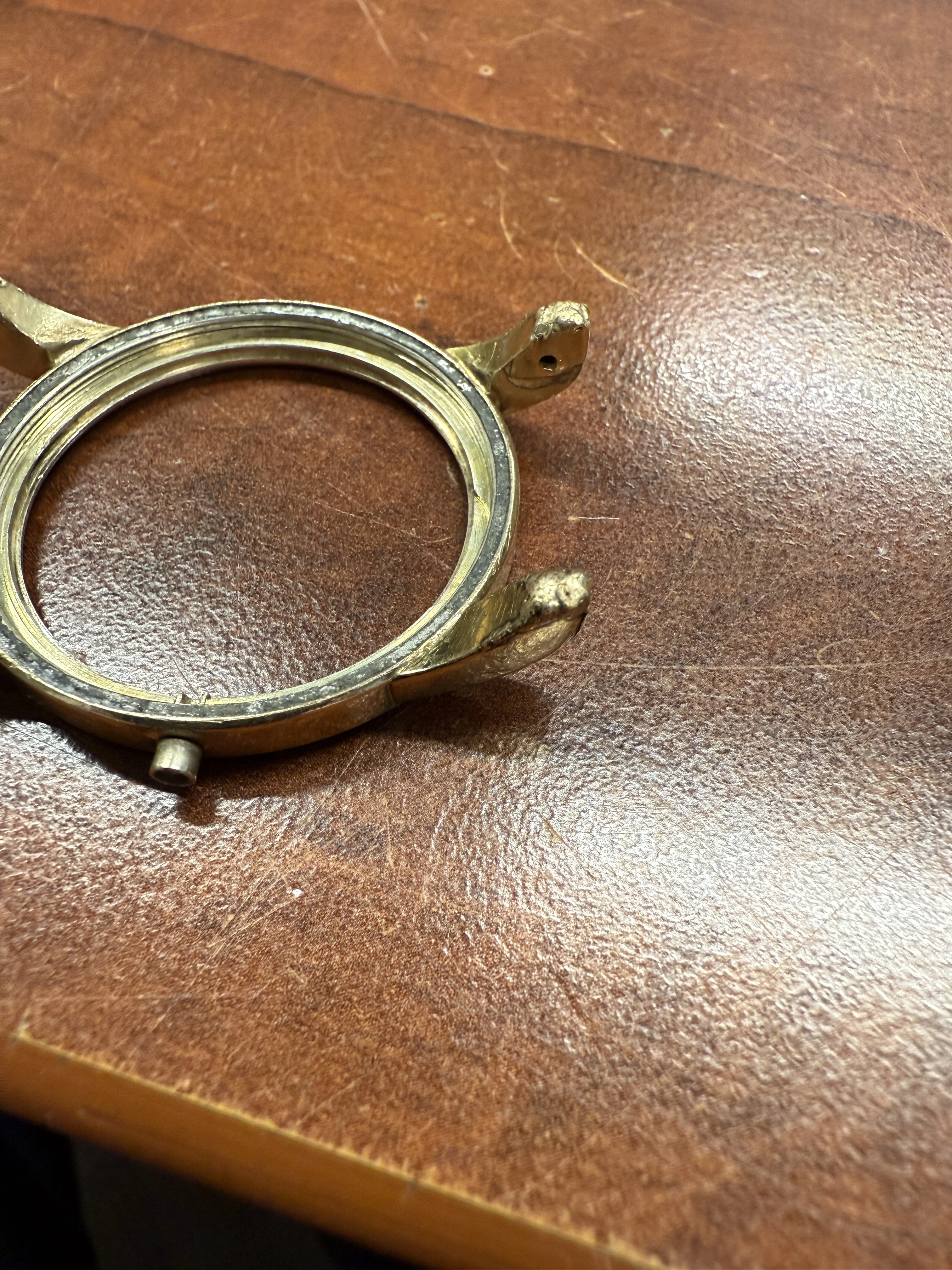

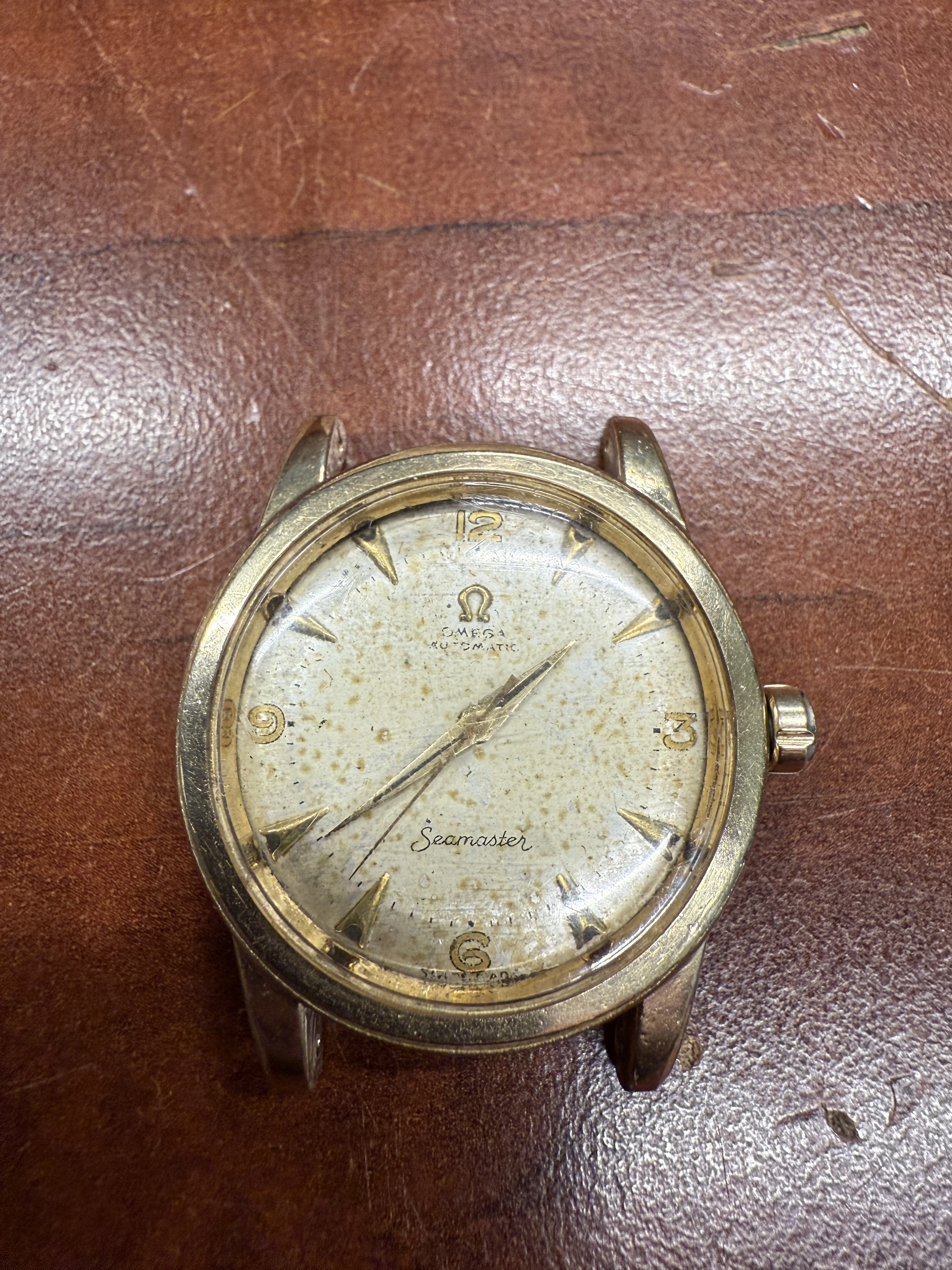

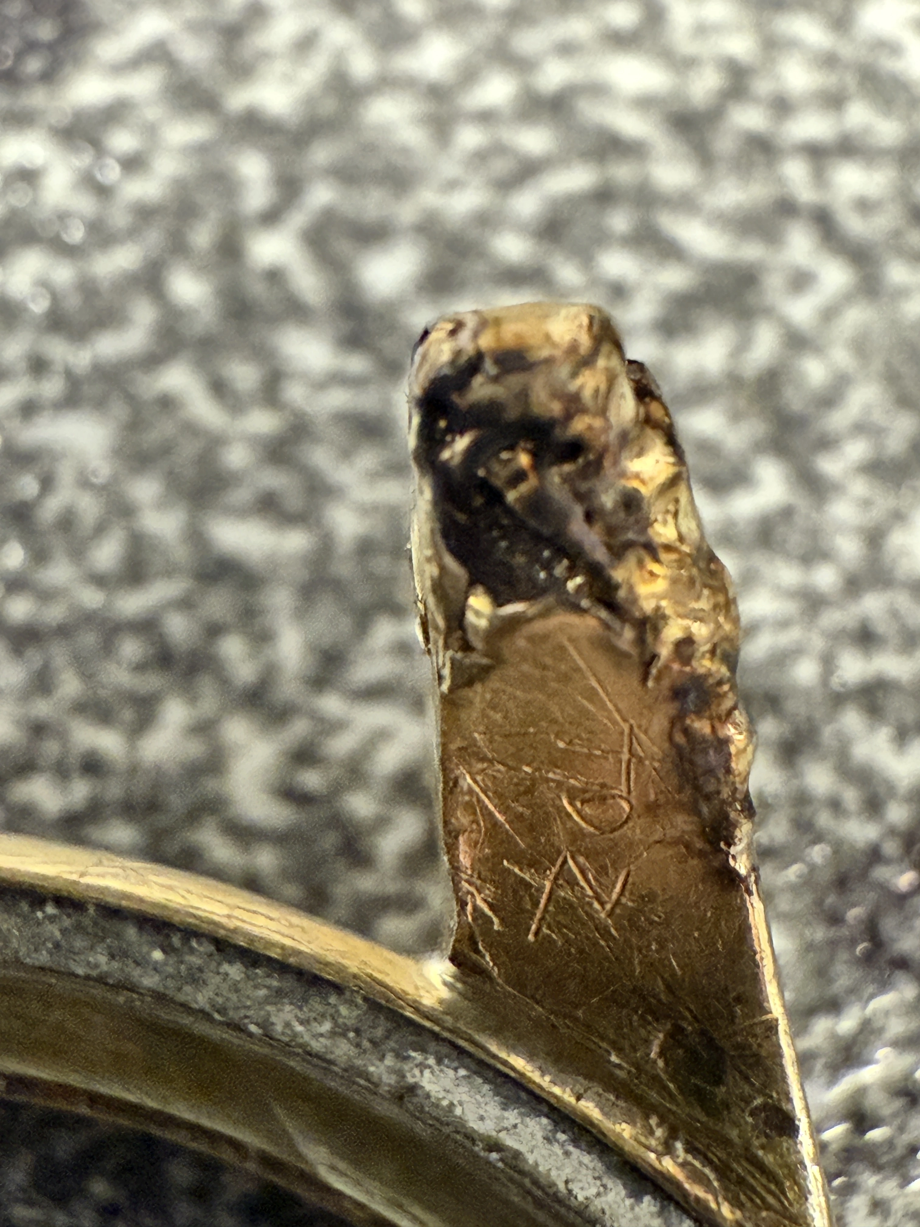

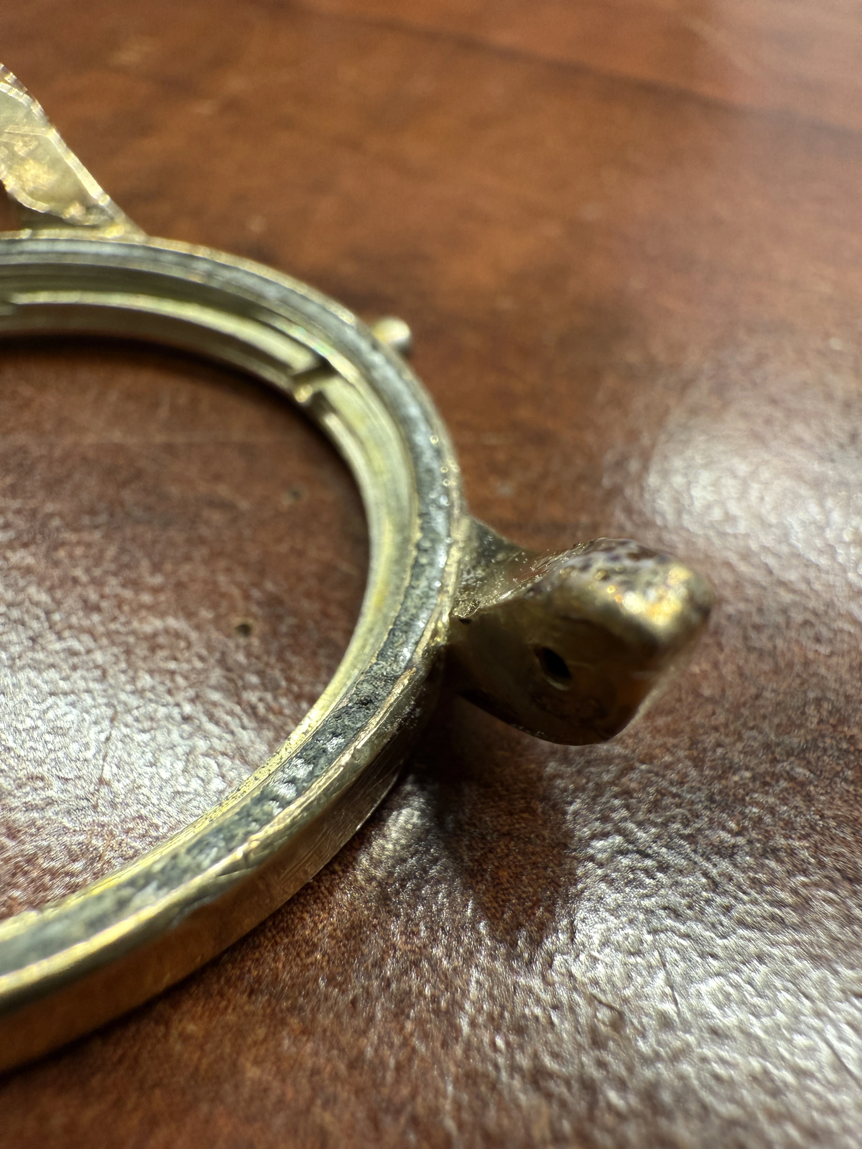

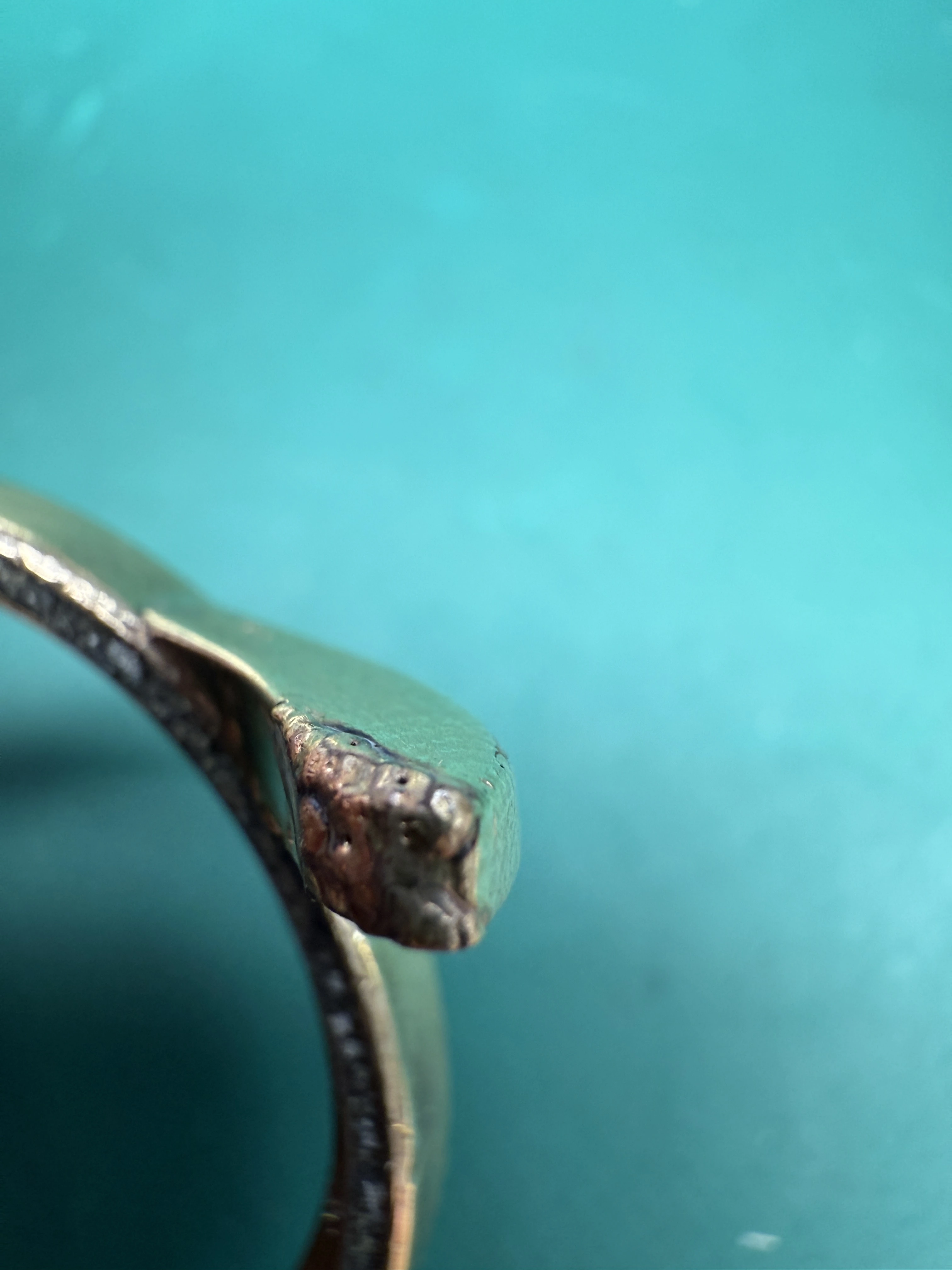

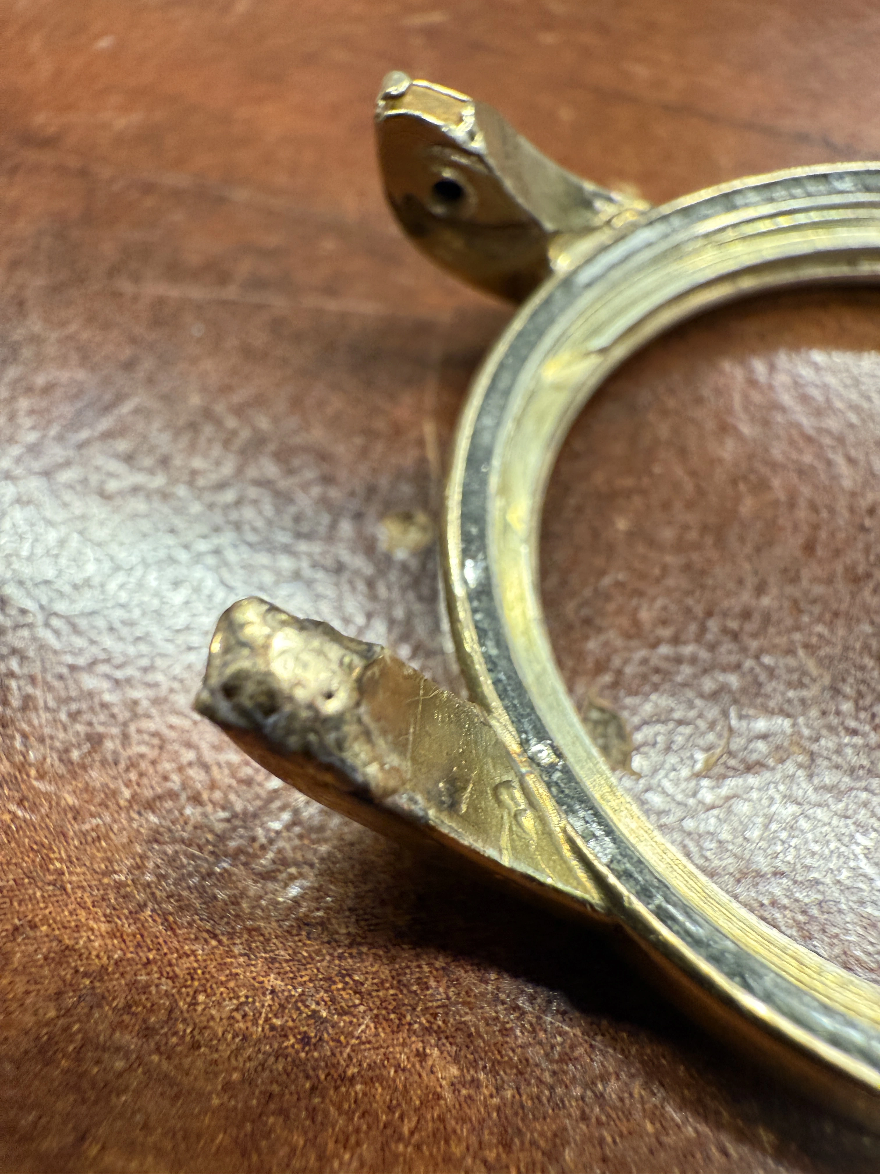

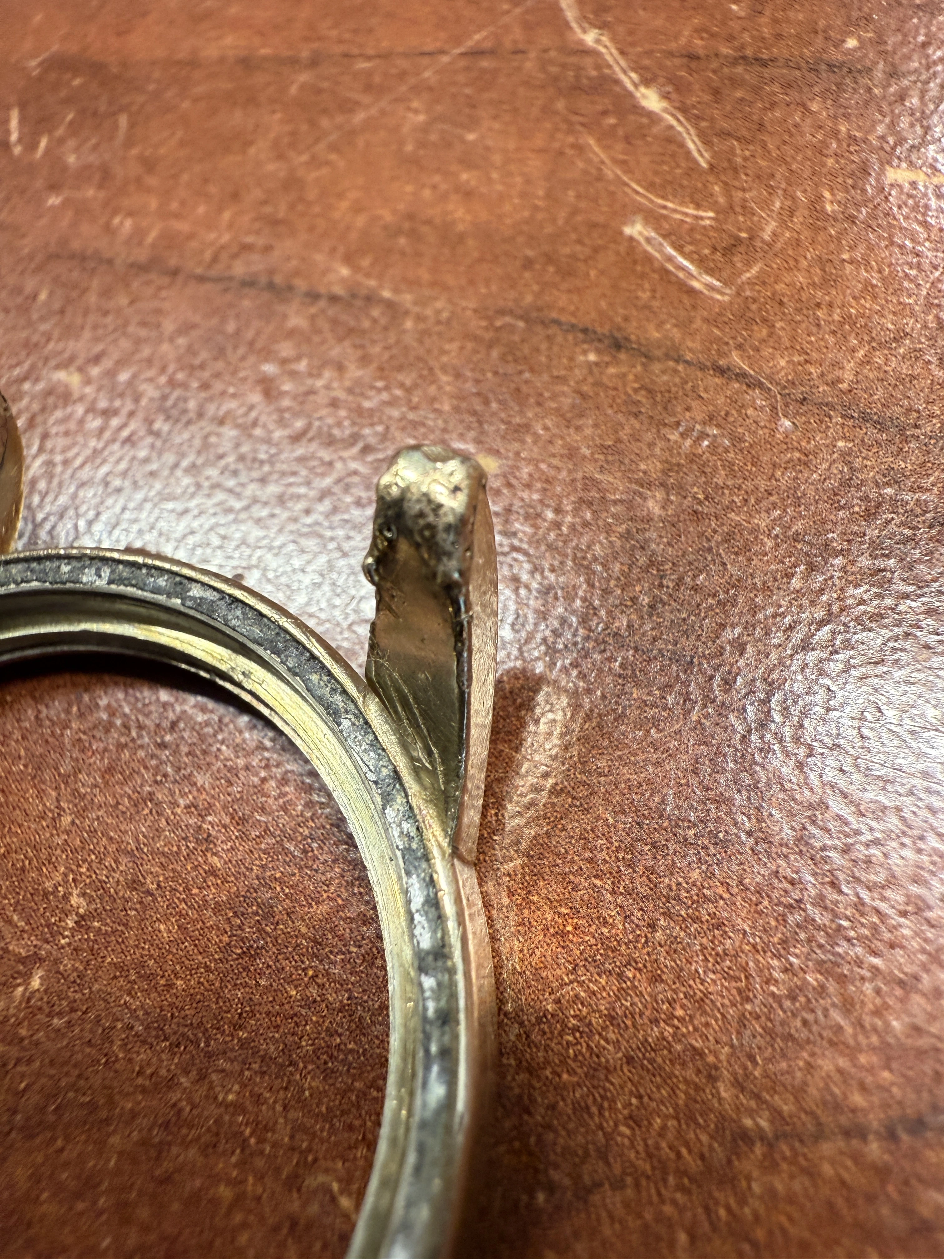

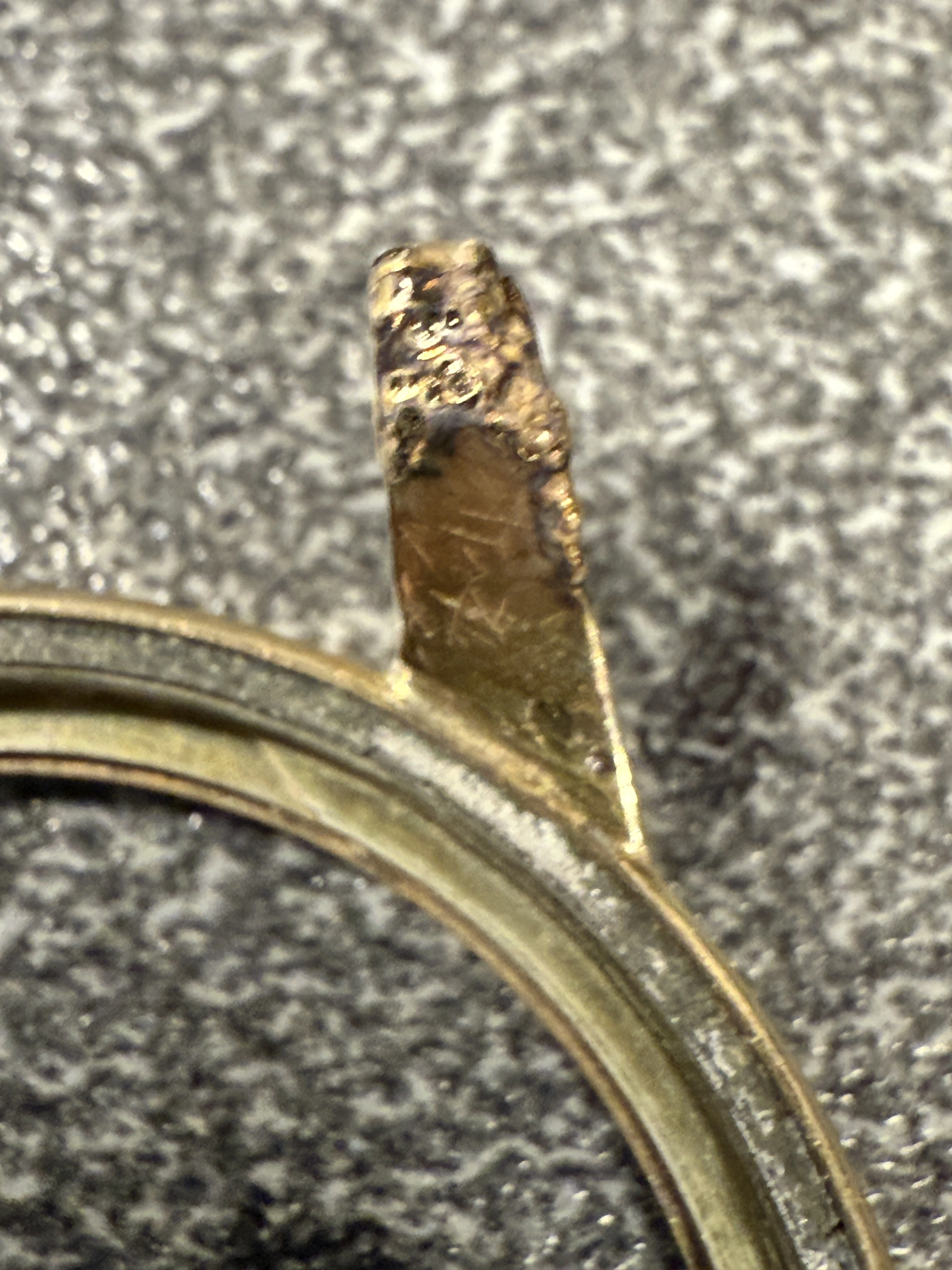

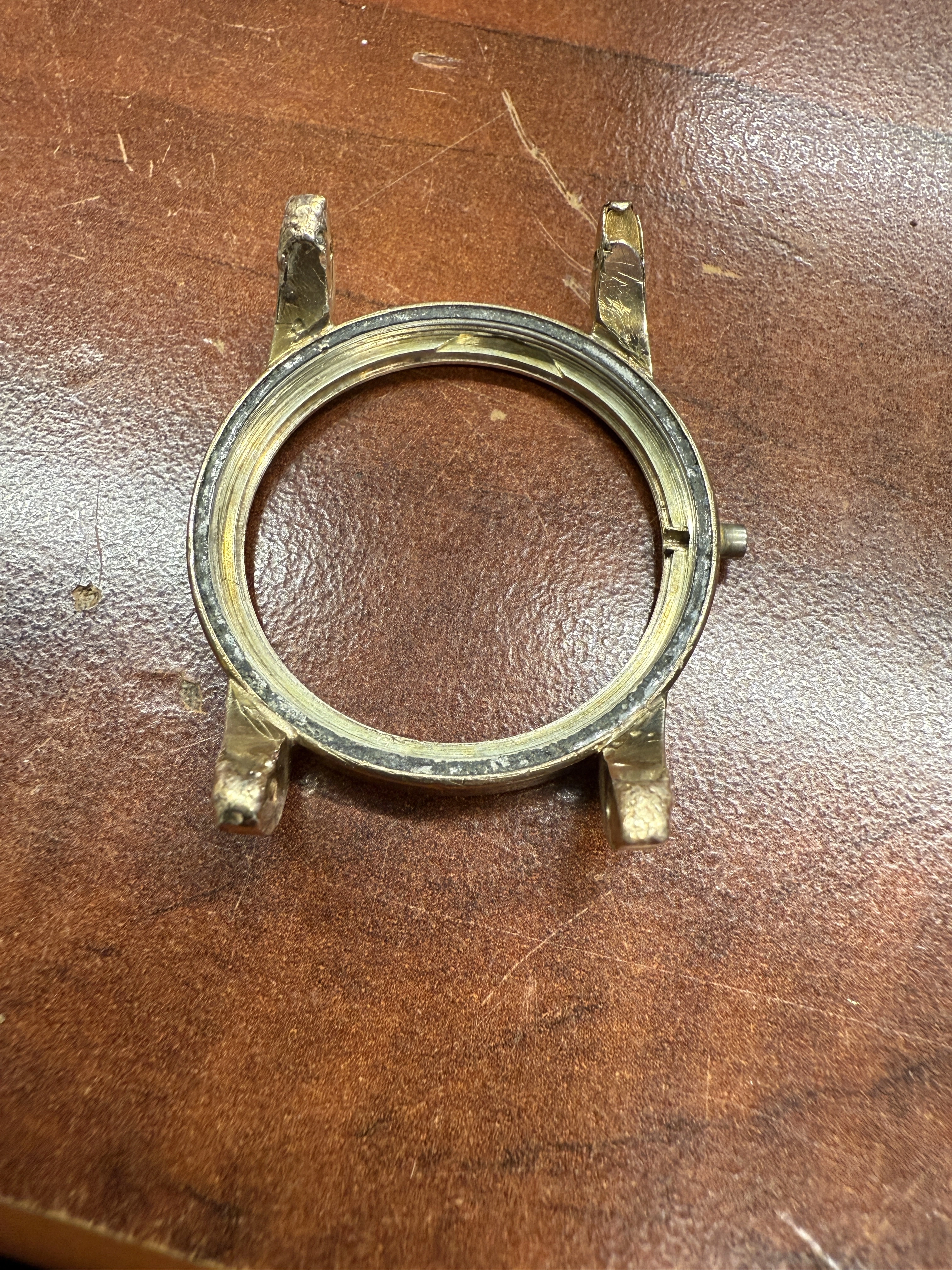

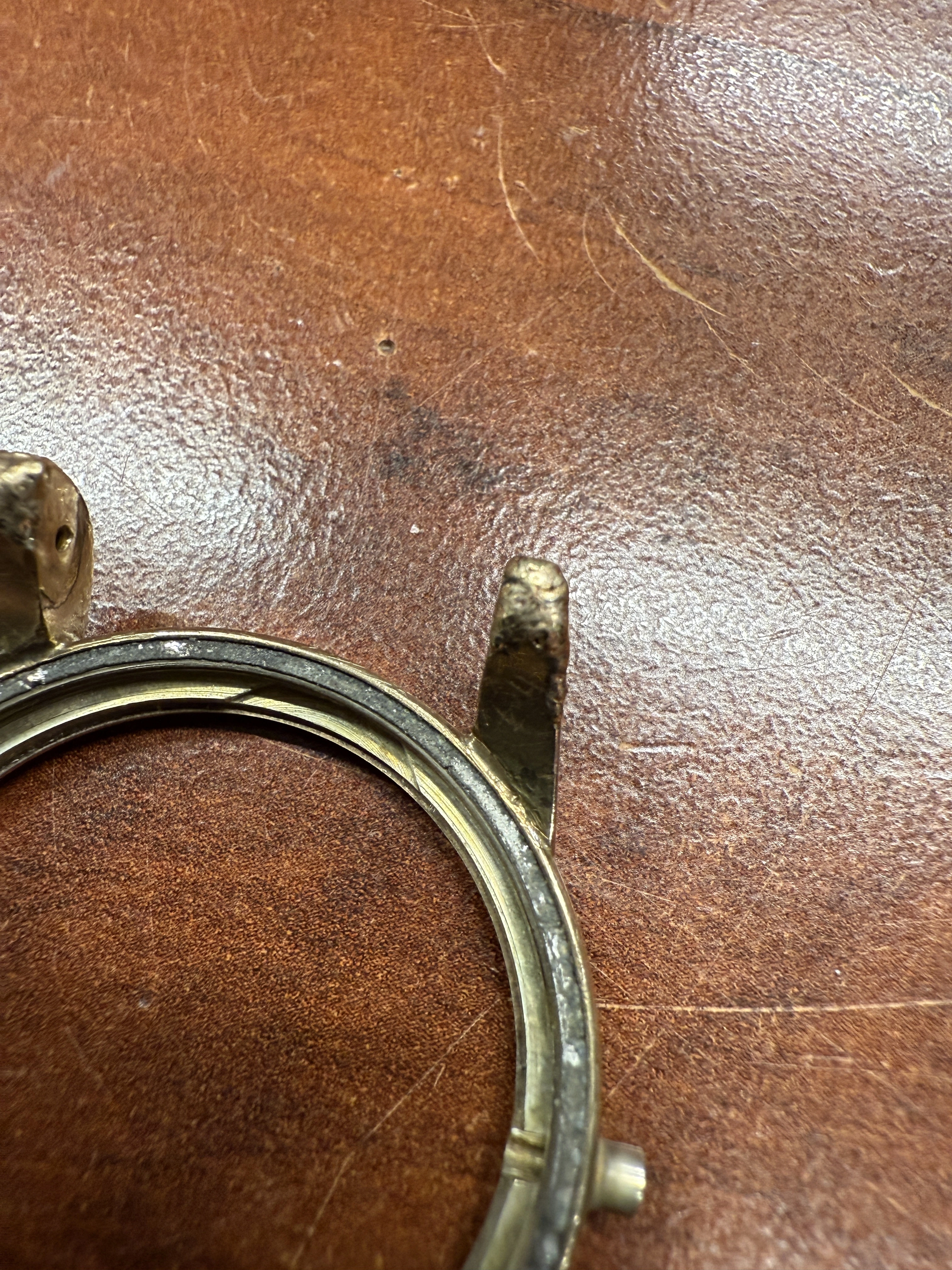

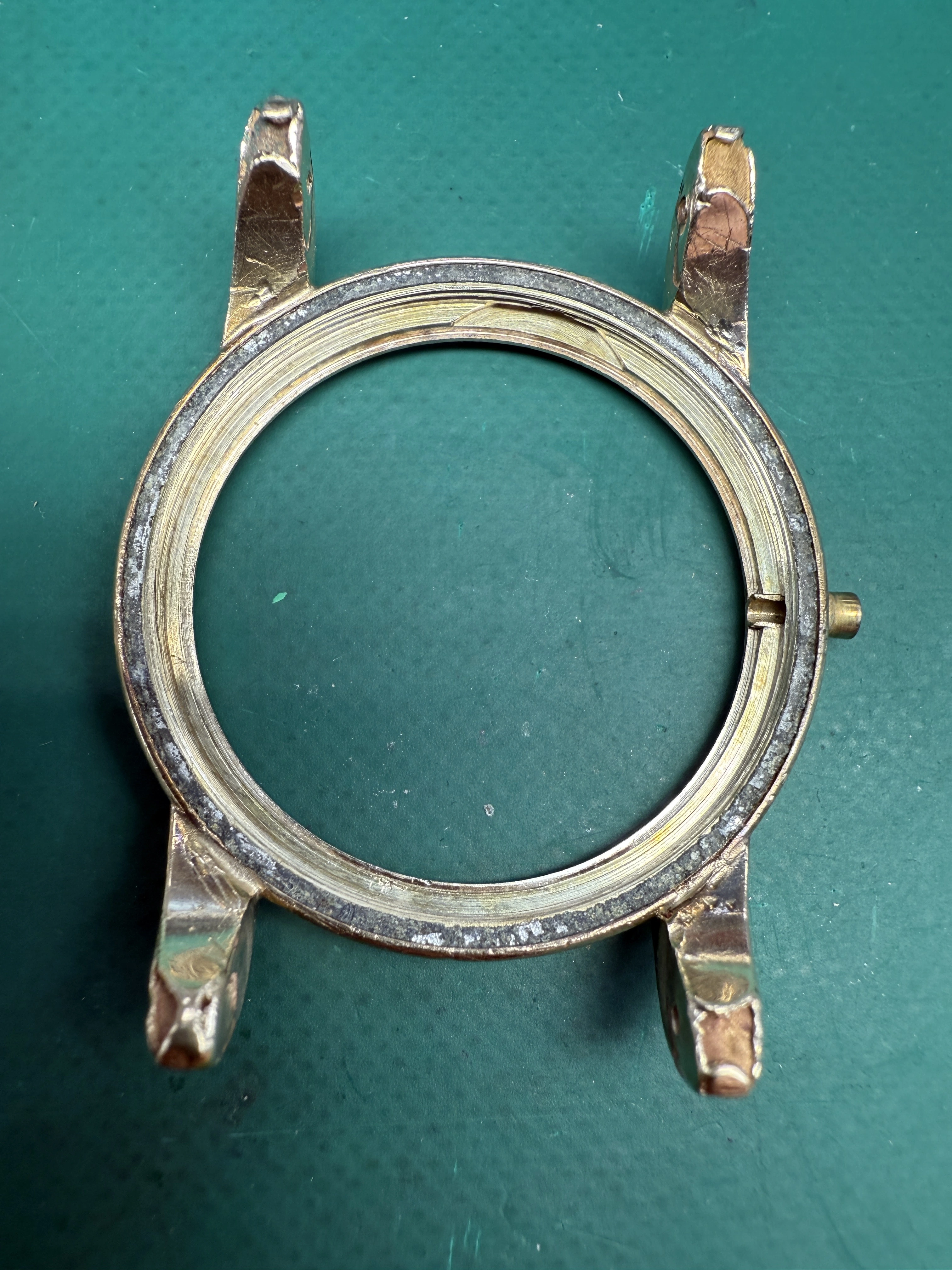

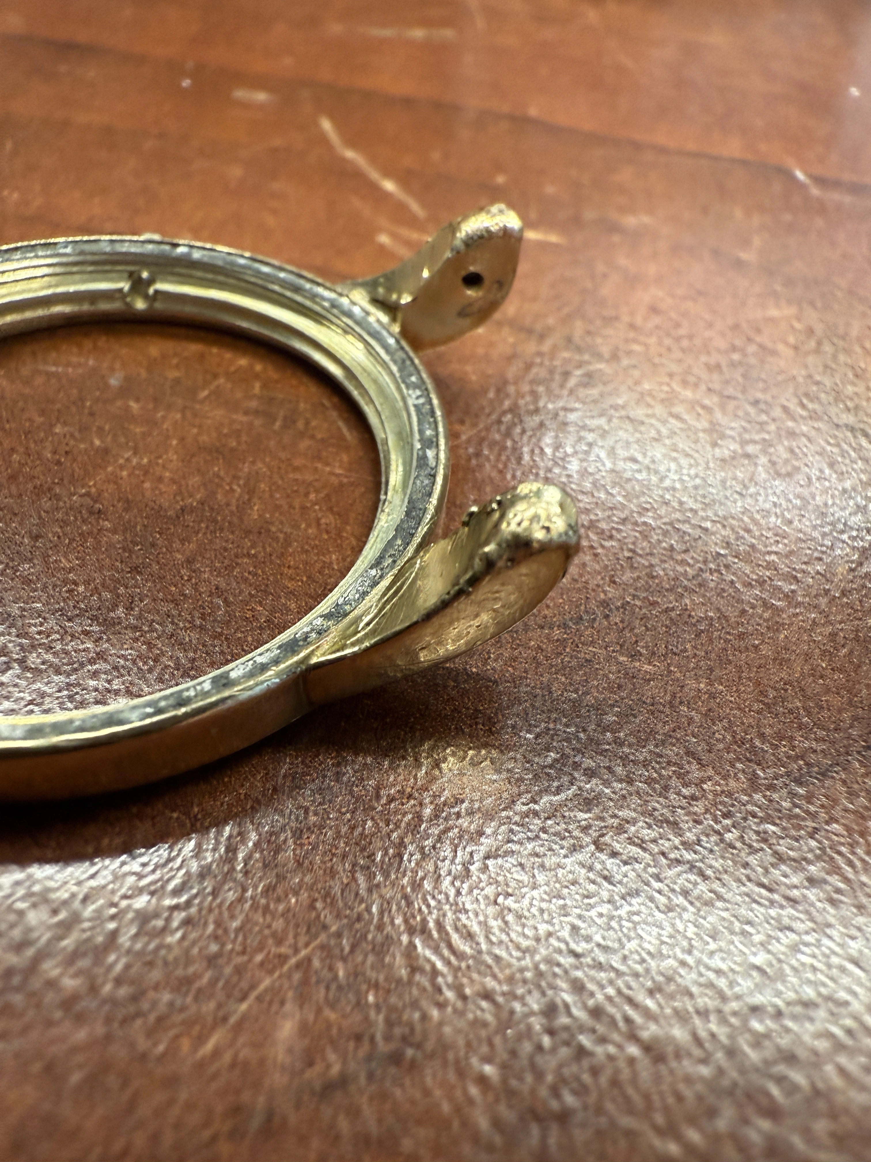

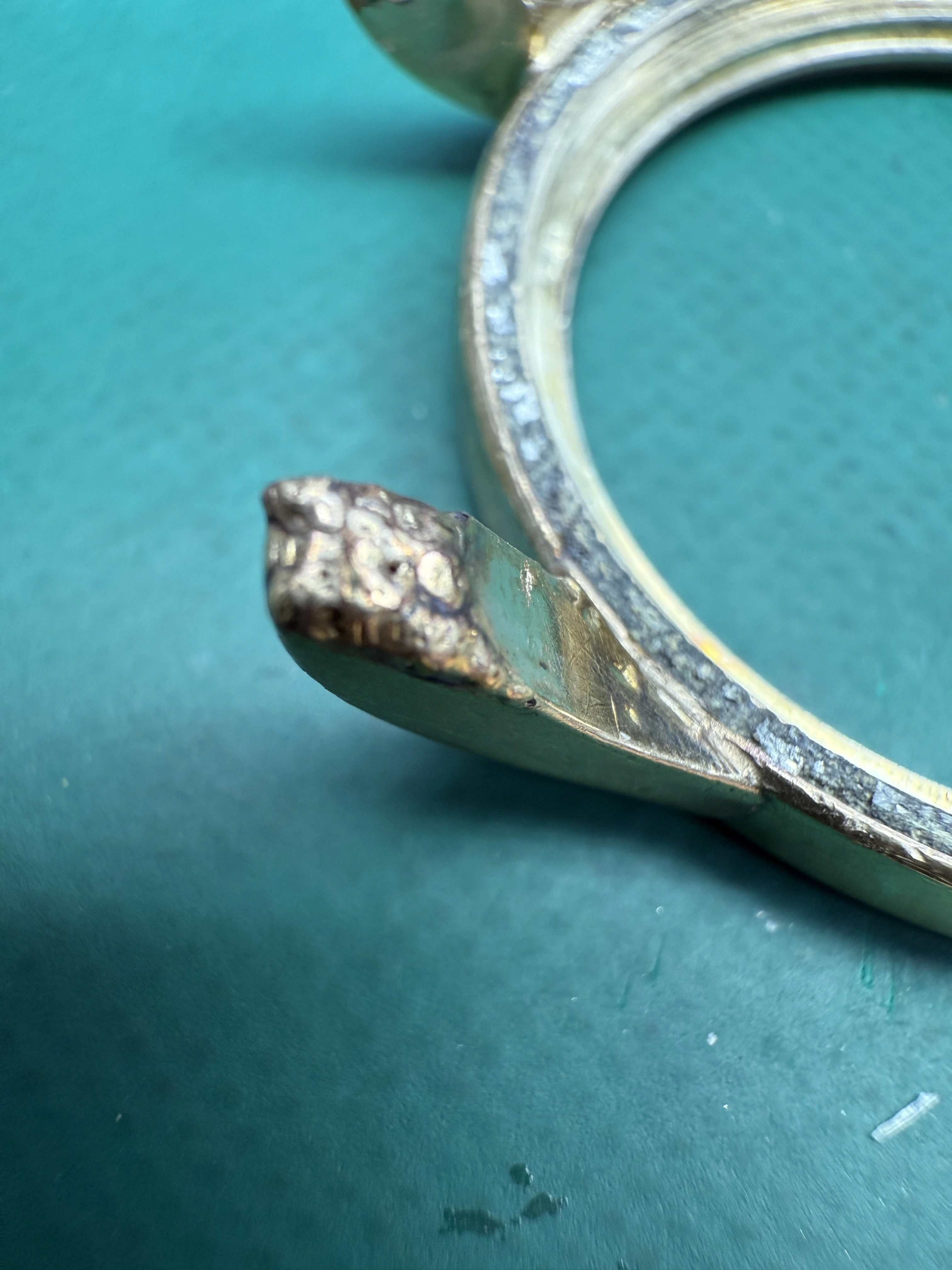

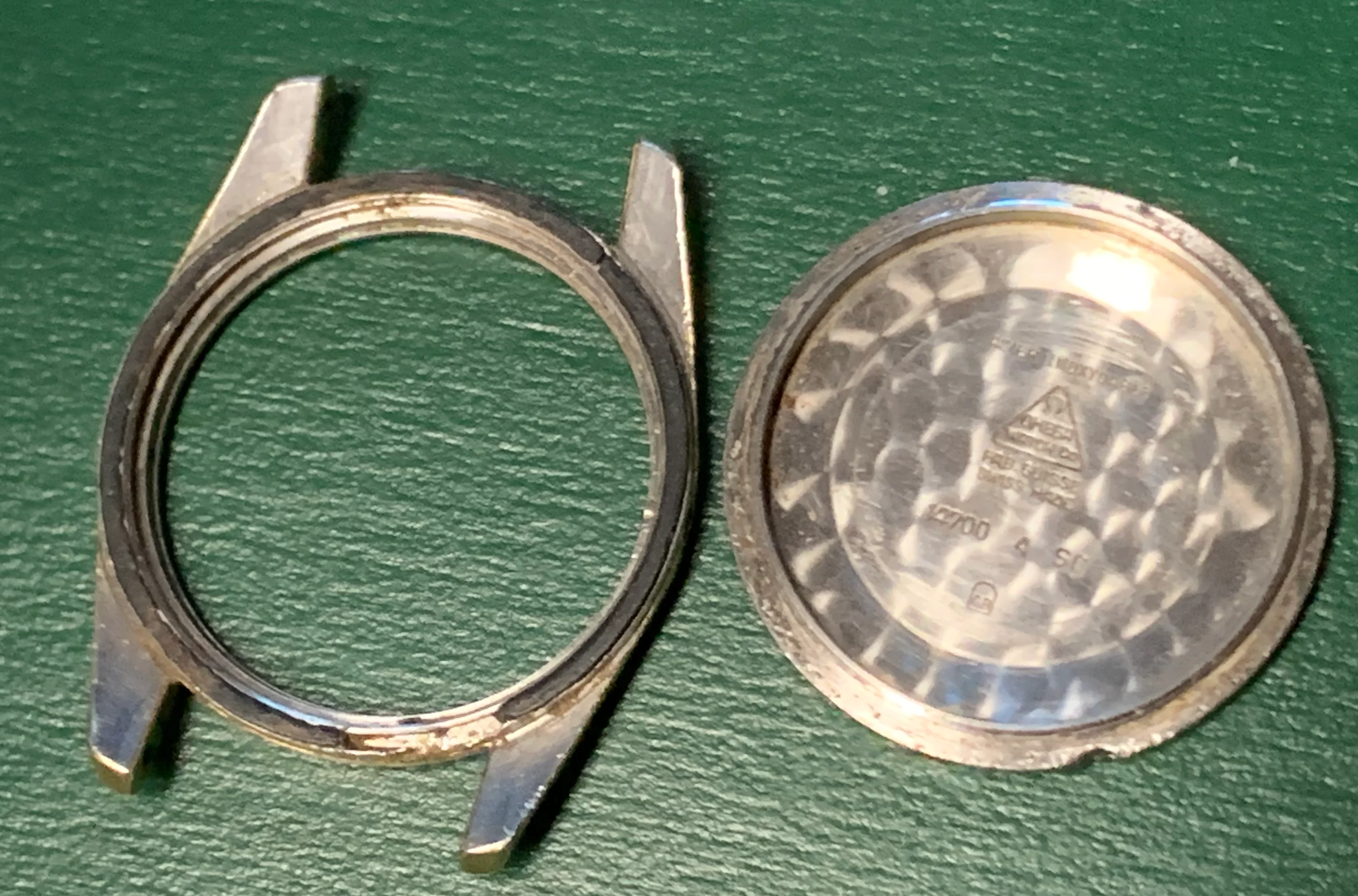

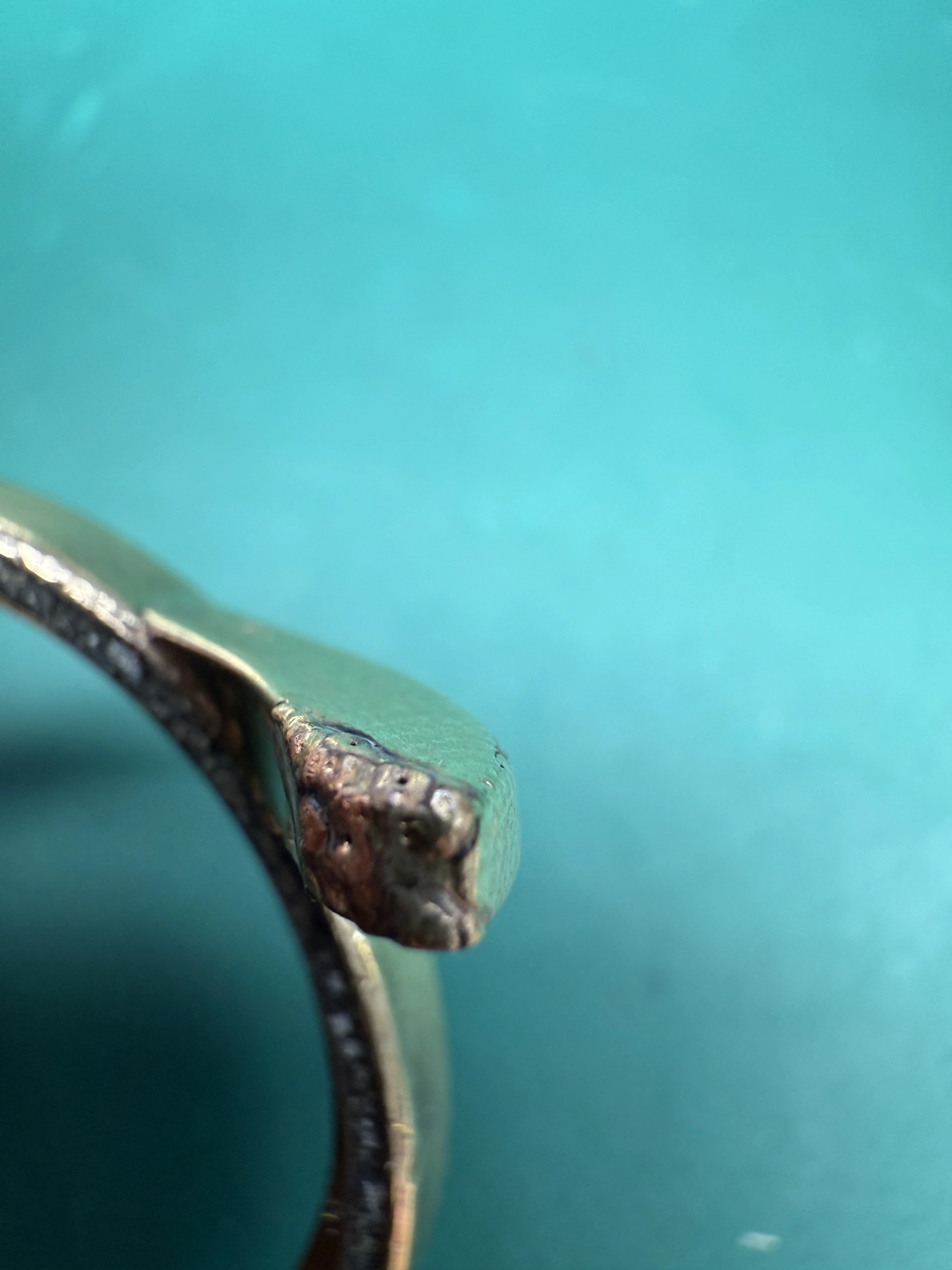

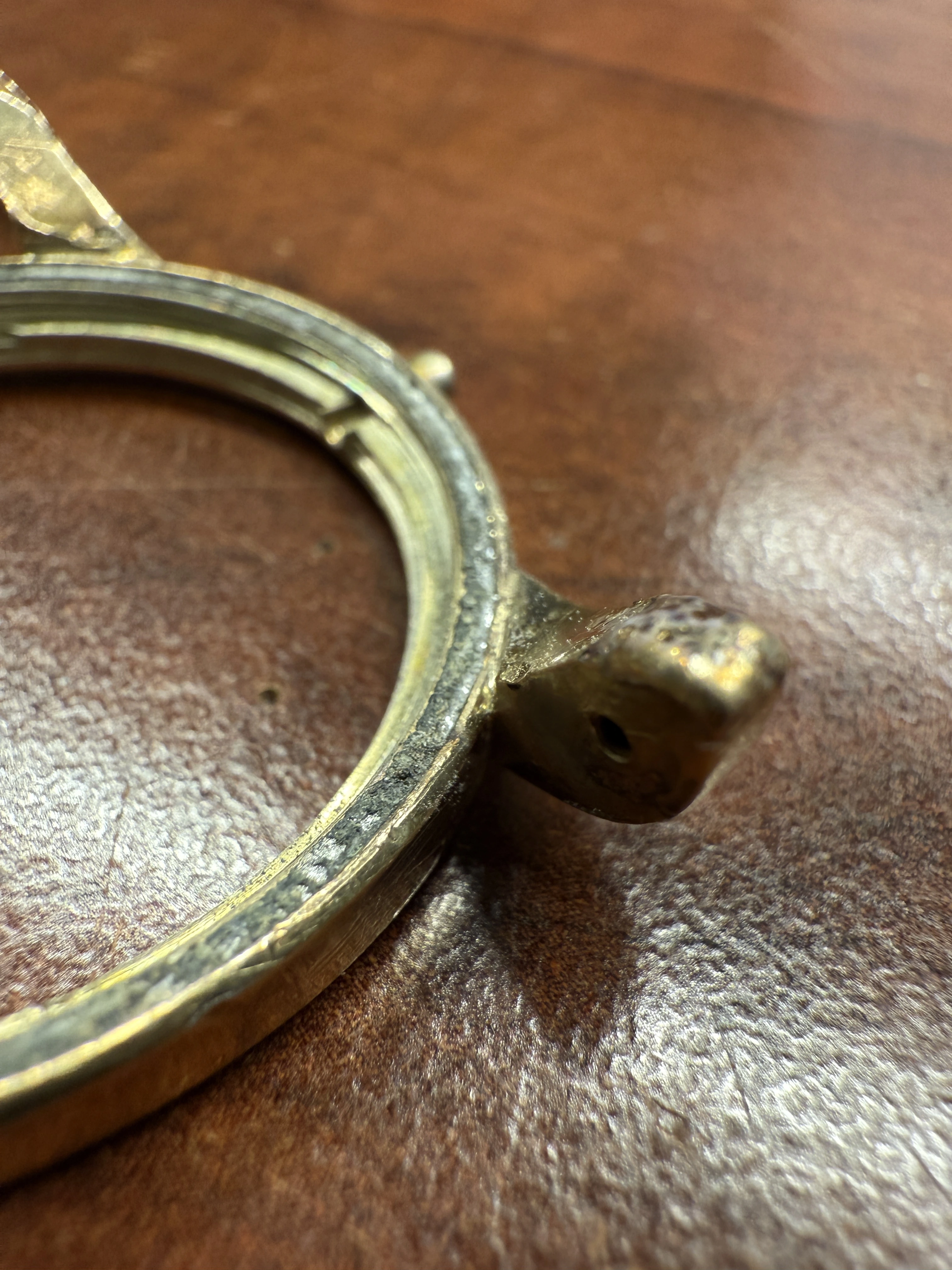

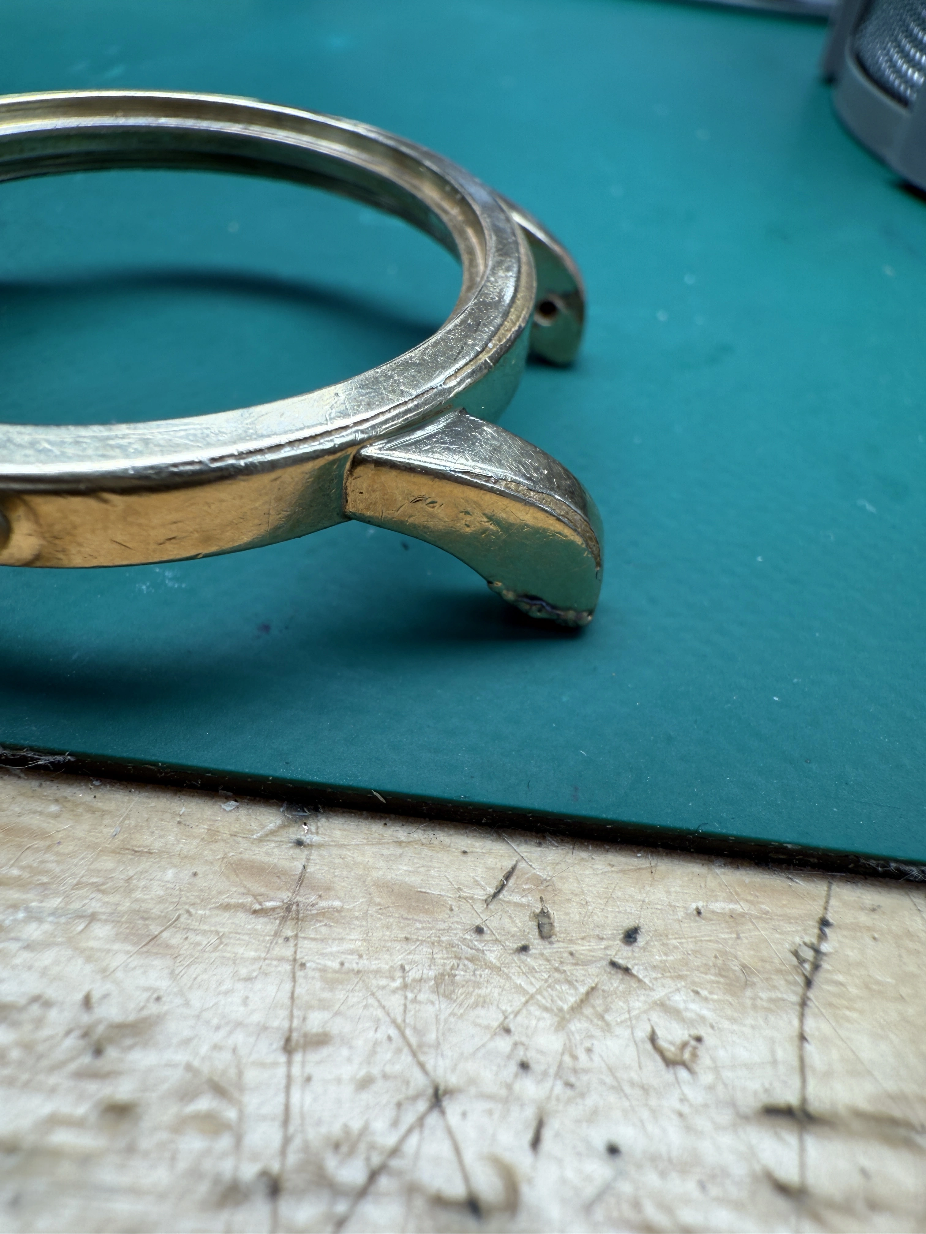

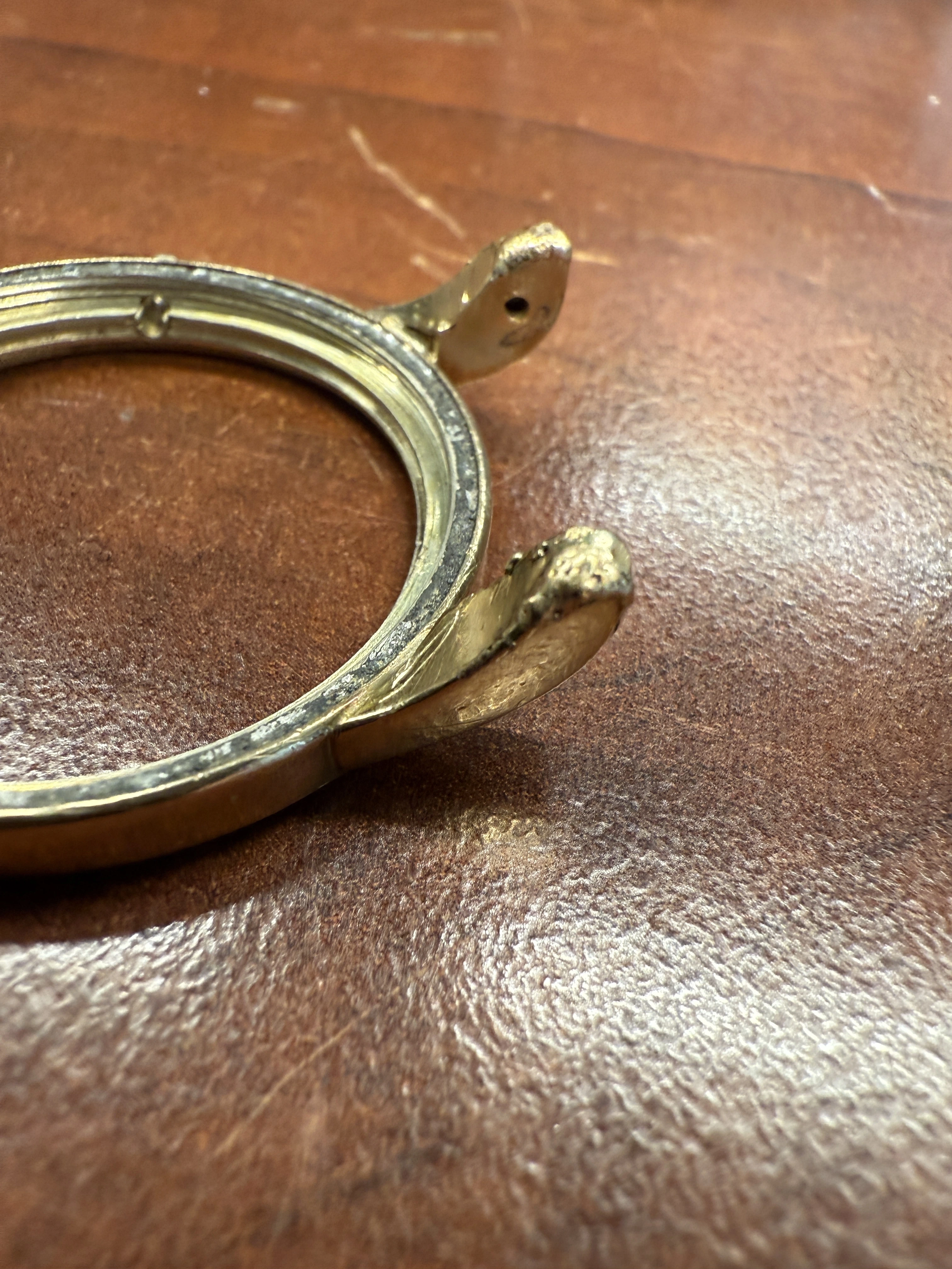

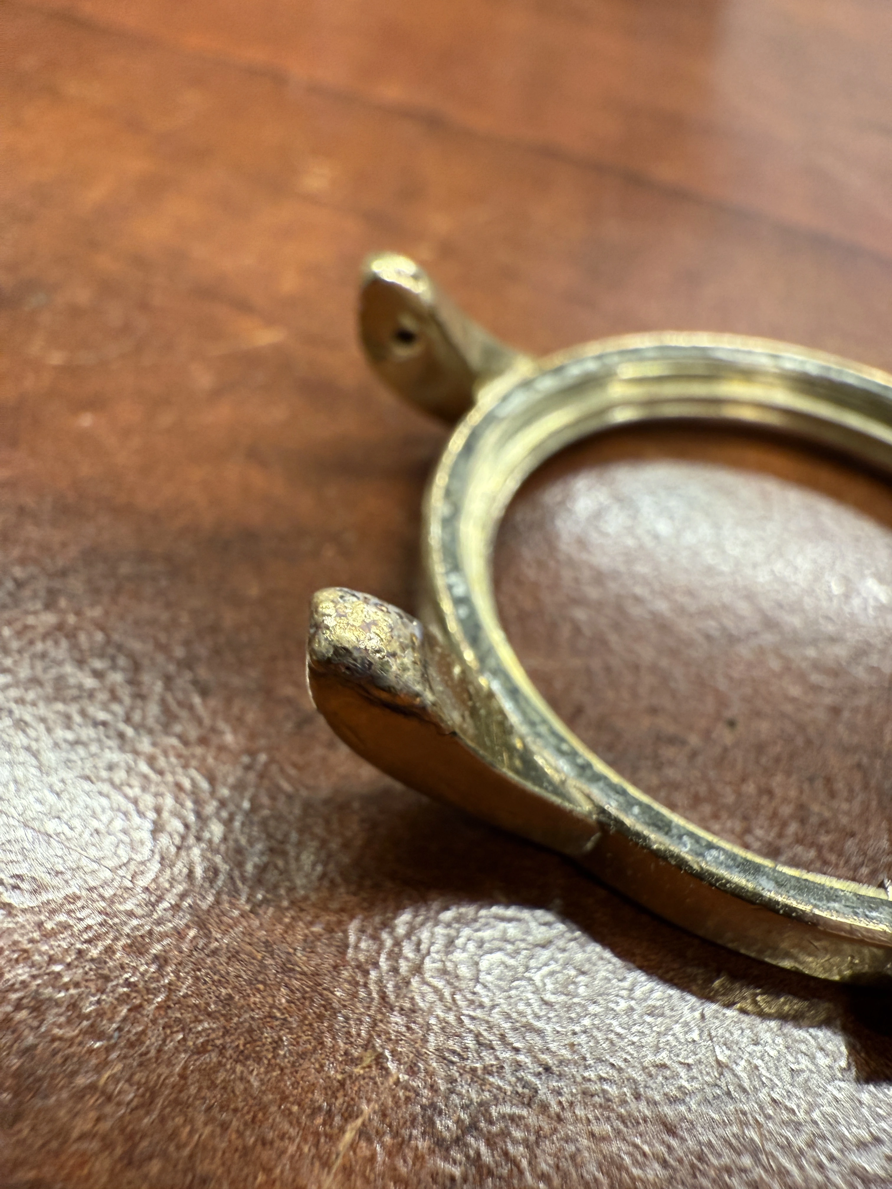

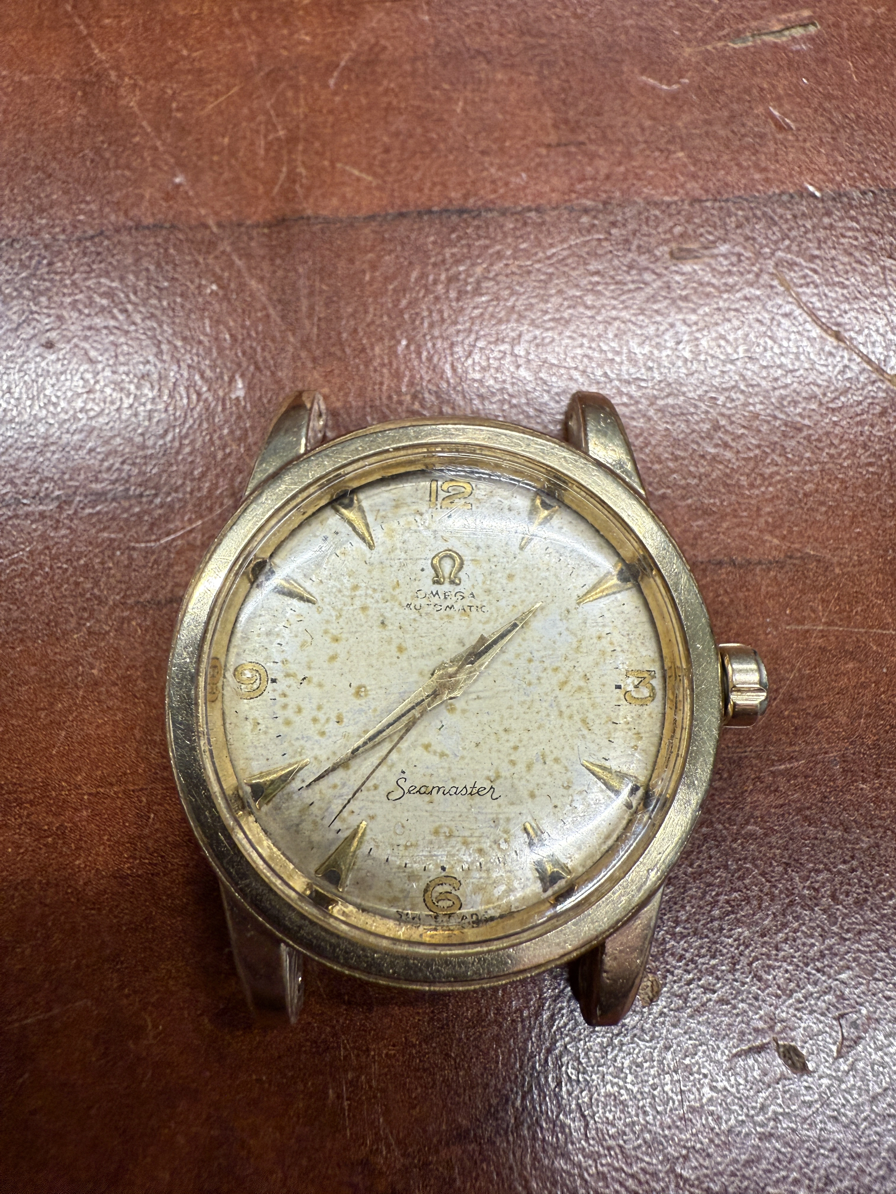

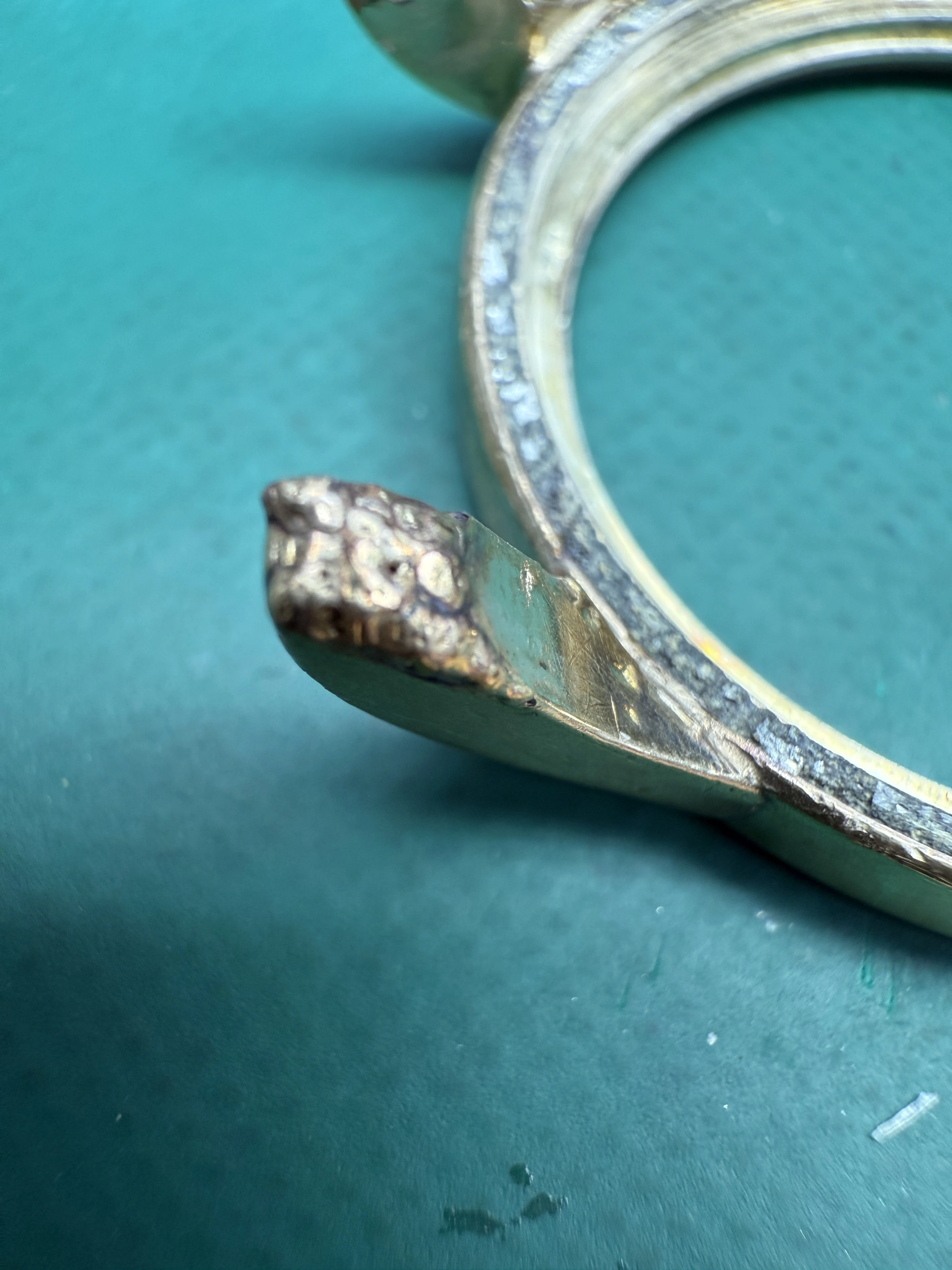

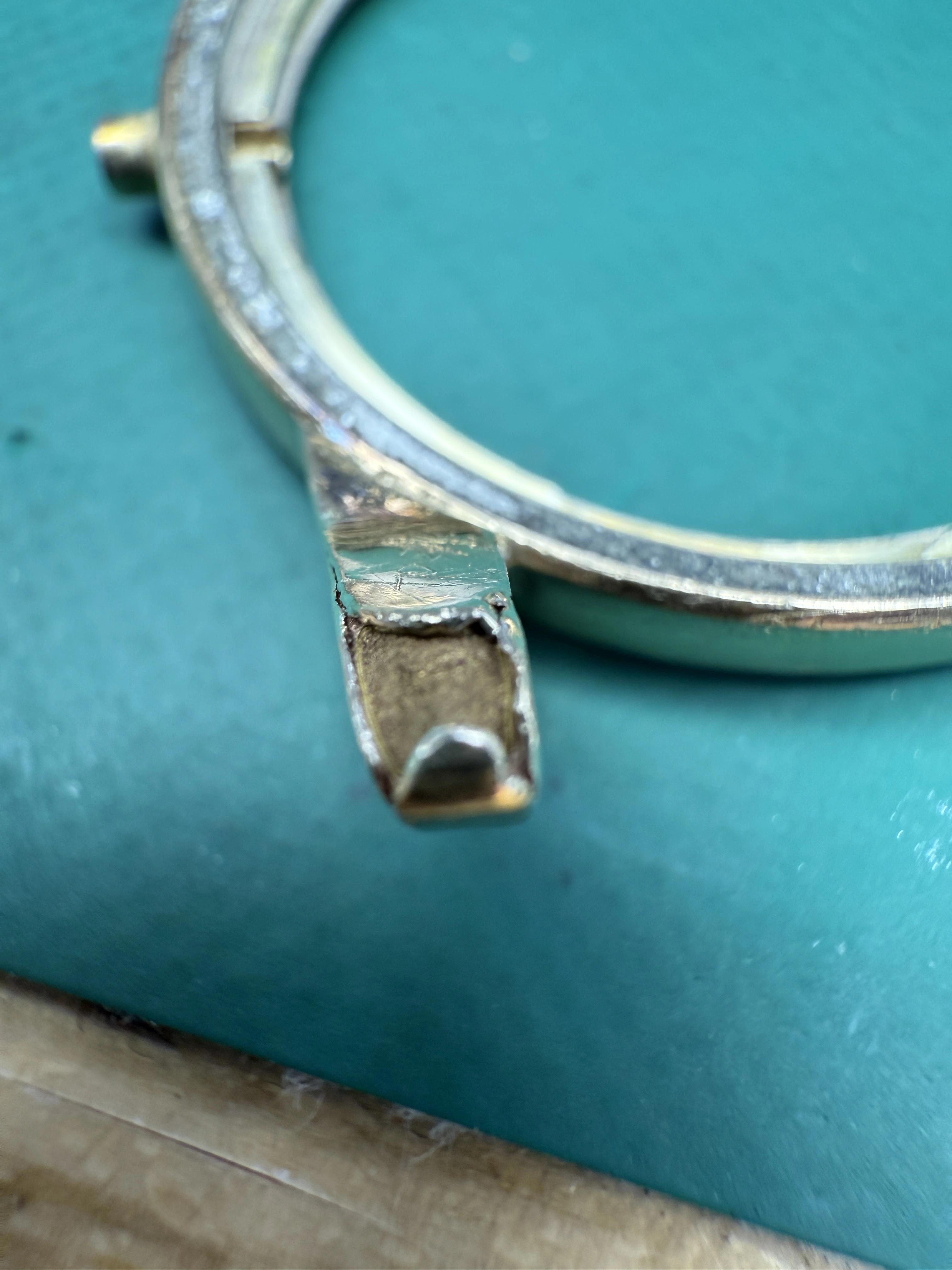

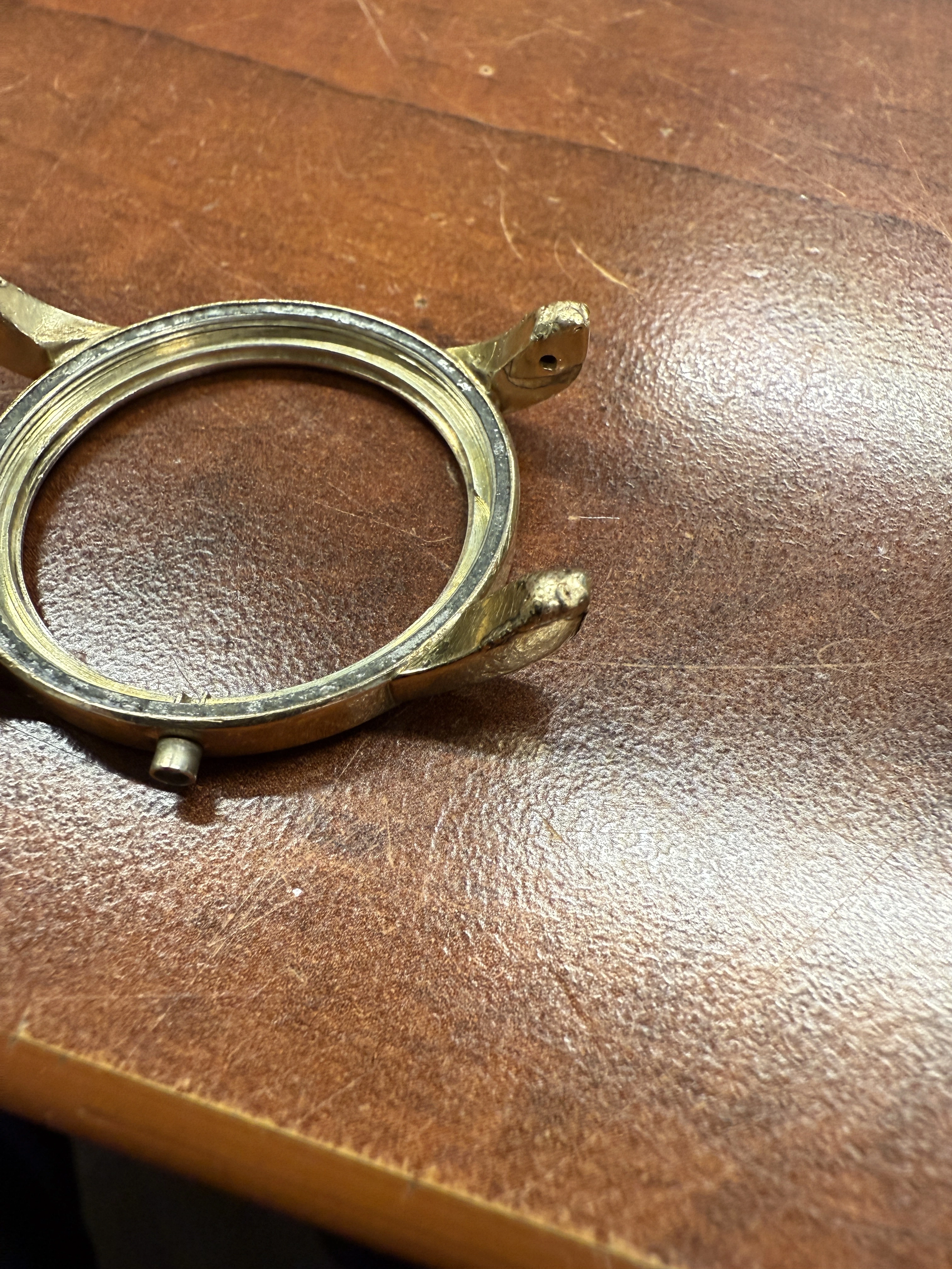

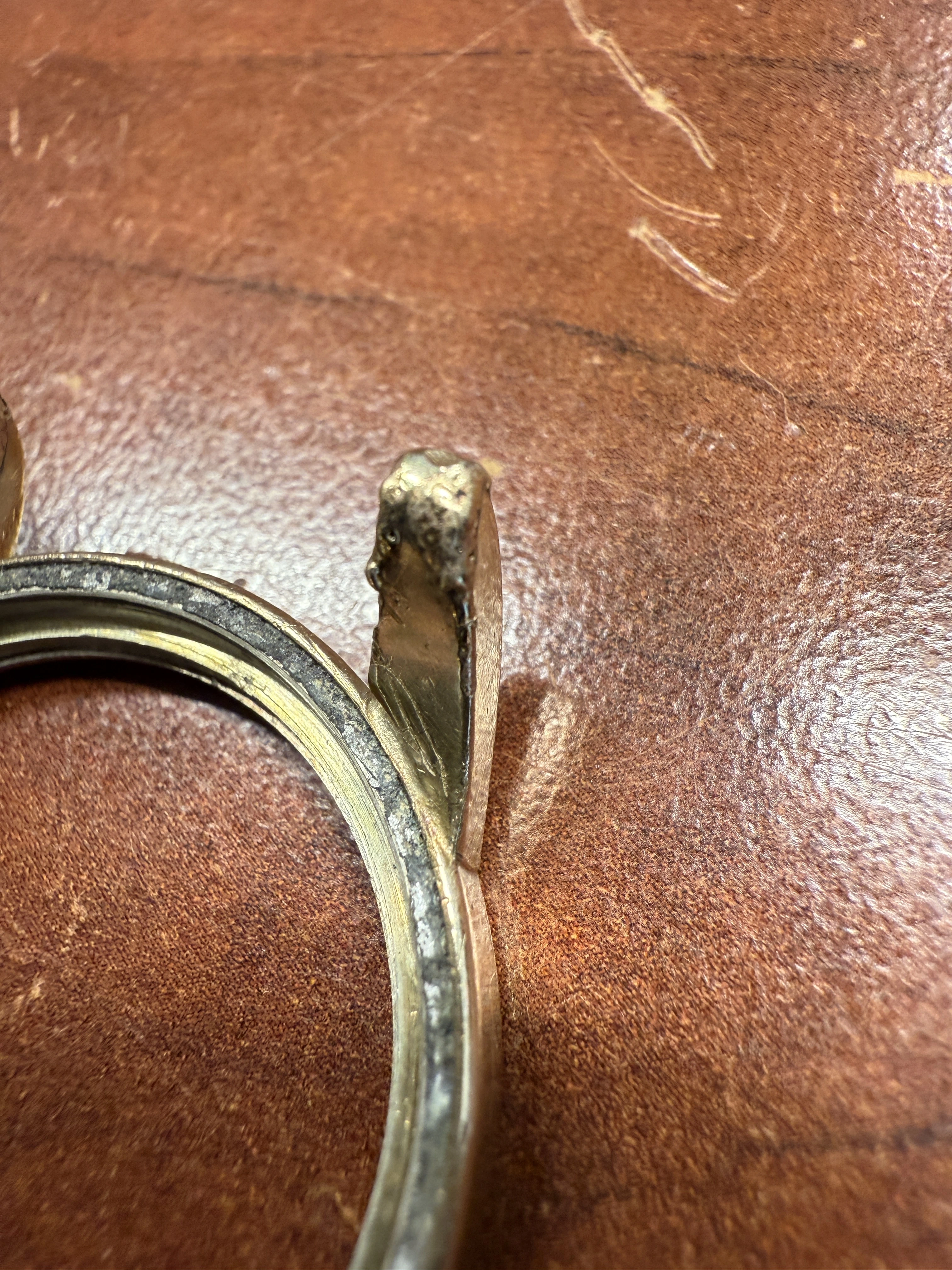

Here we have a very worn out Omega 2577-11

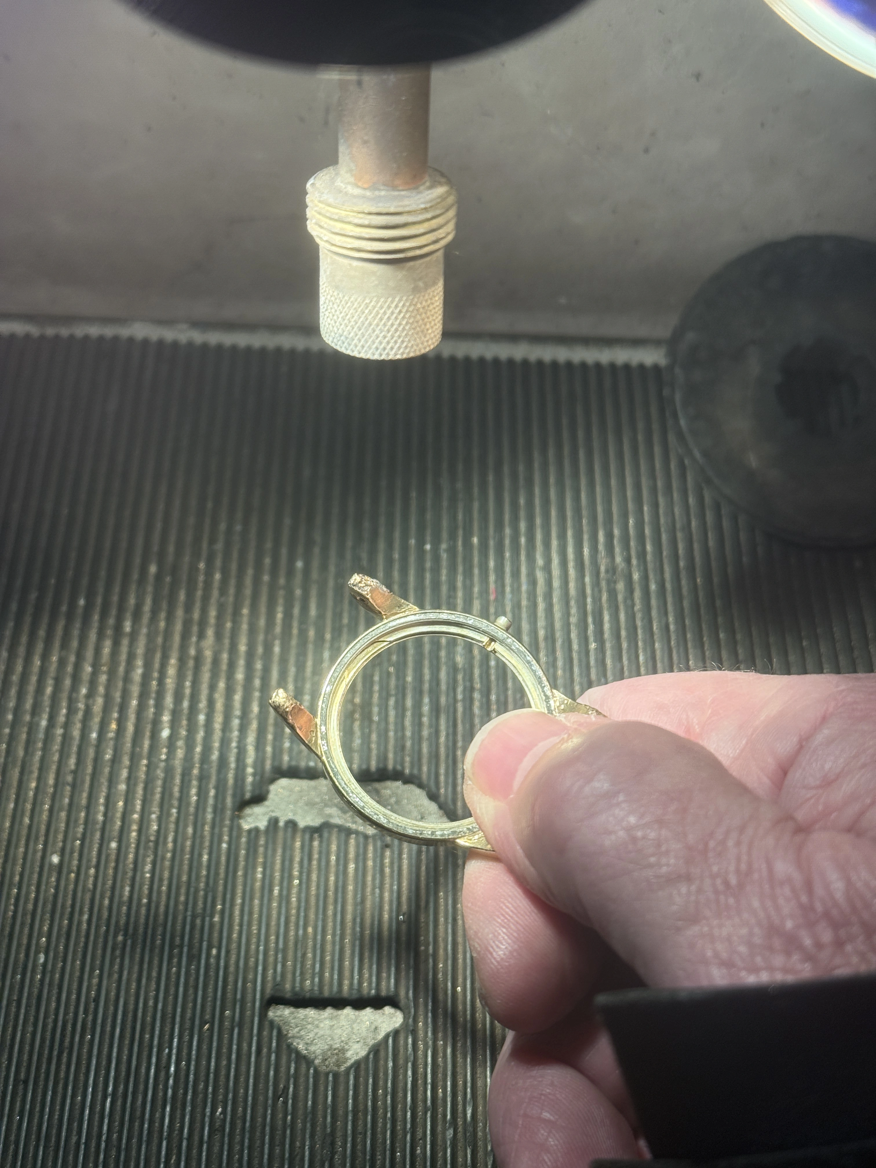

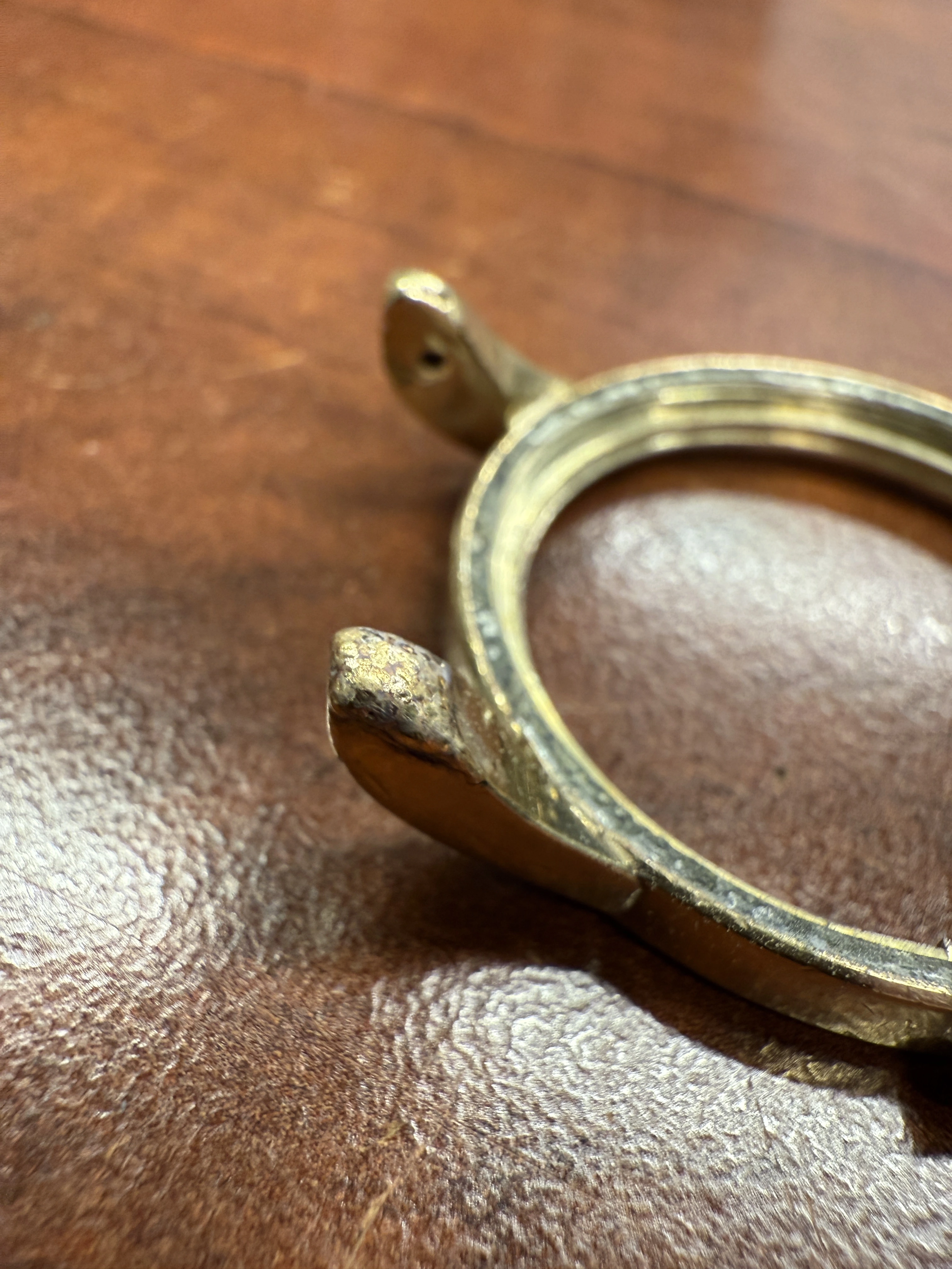

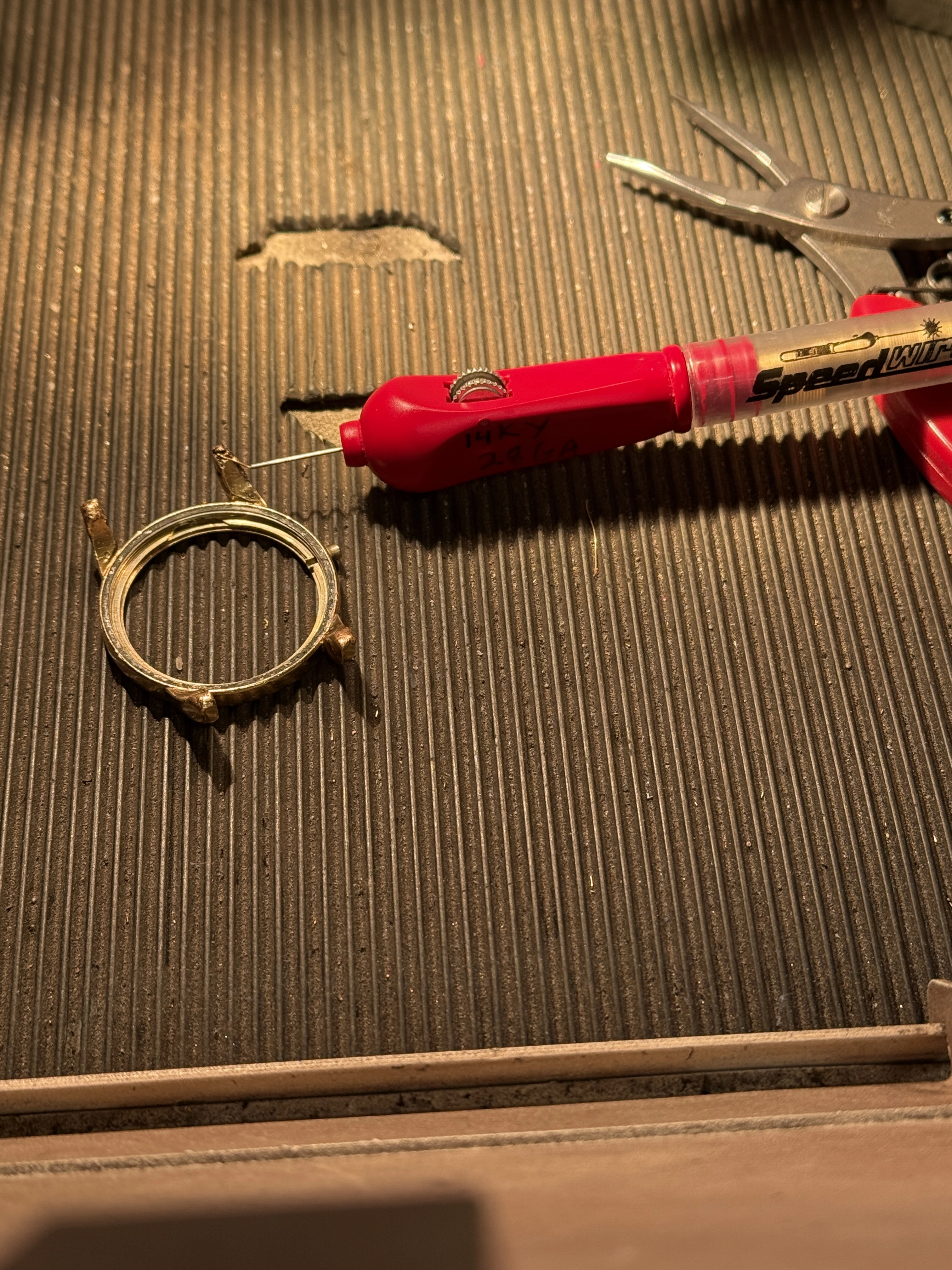

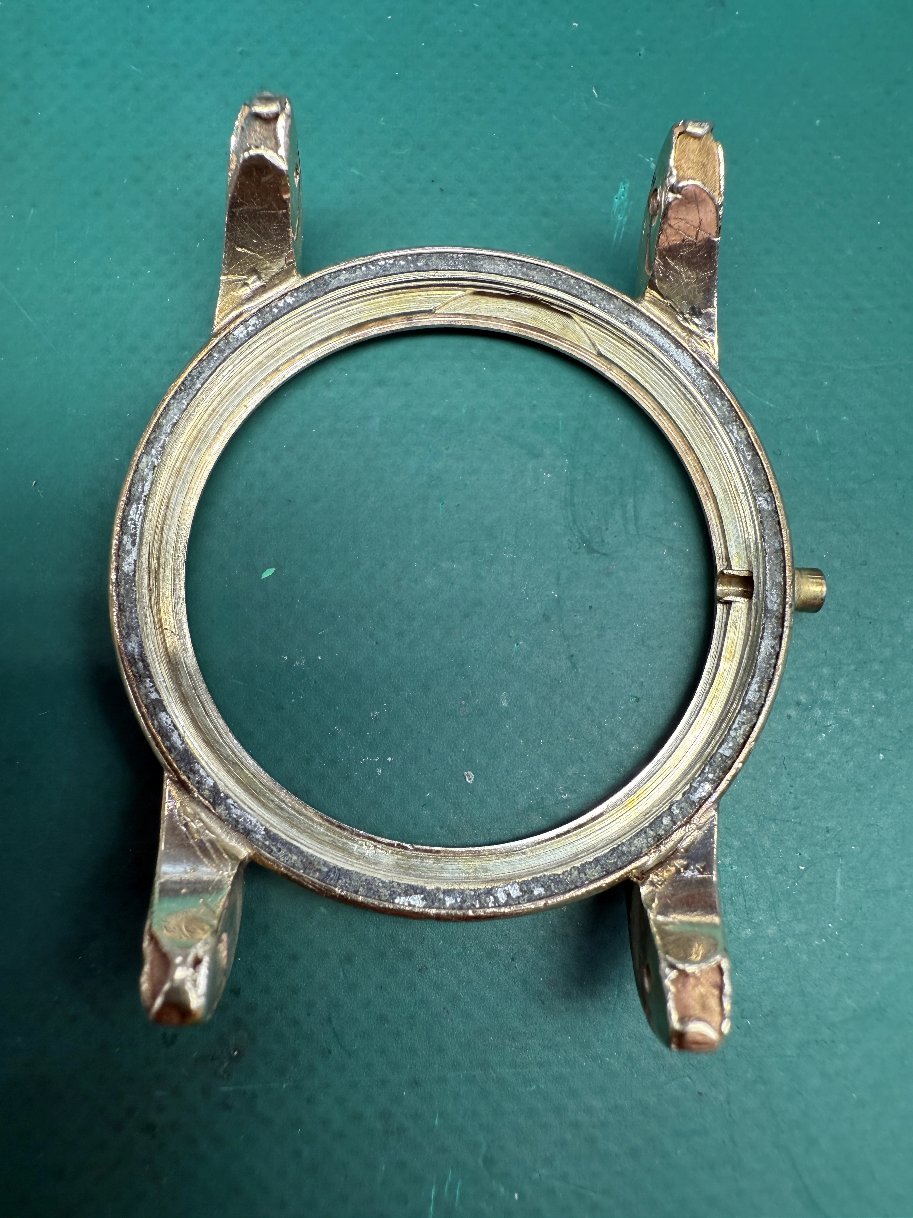

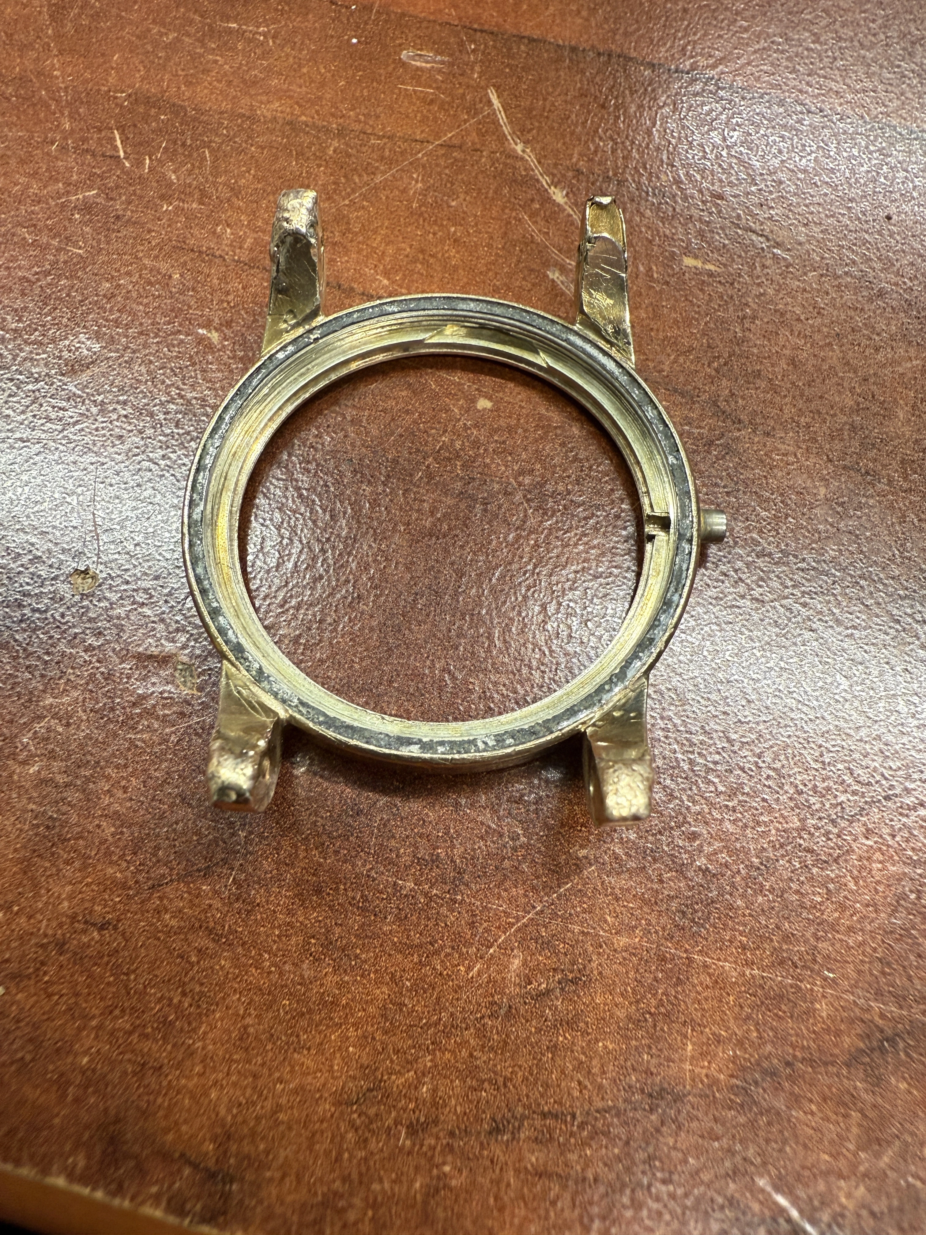

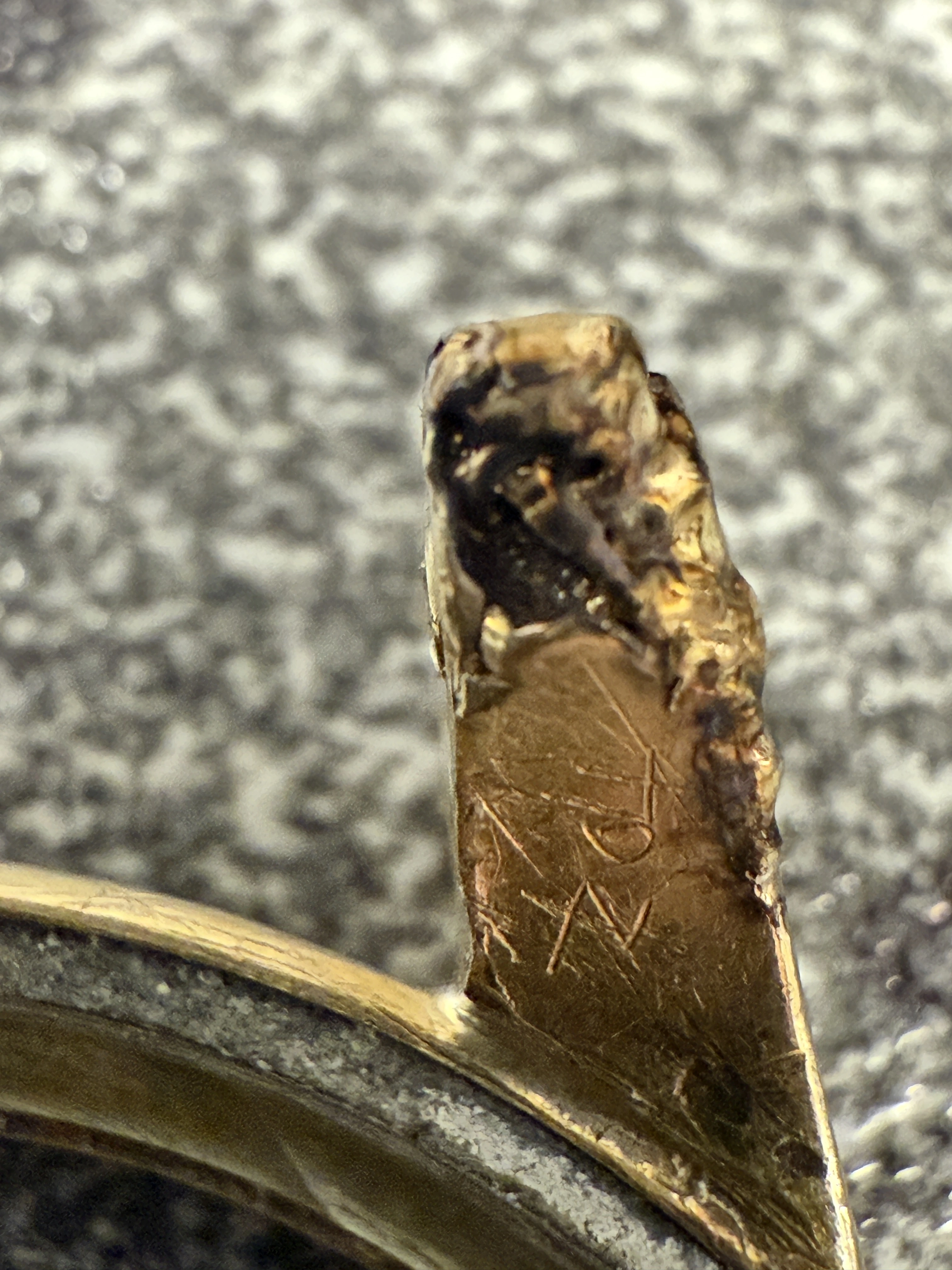

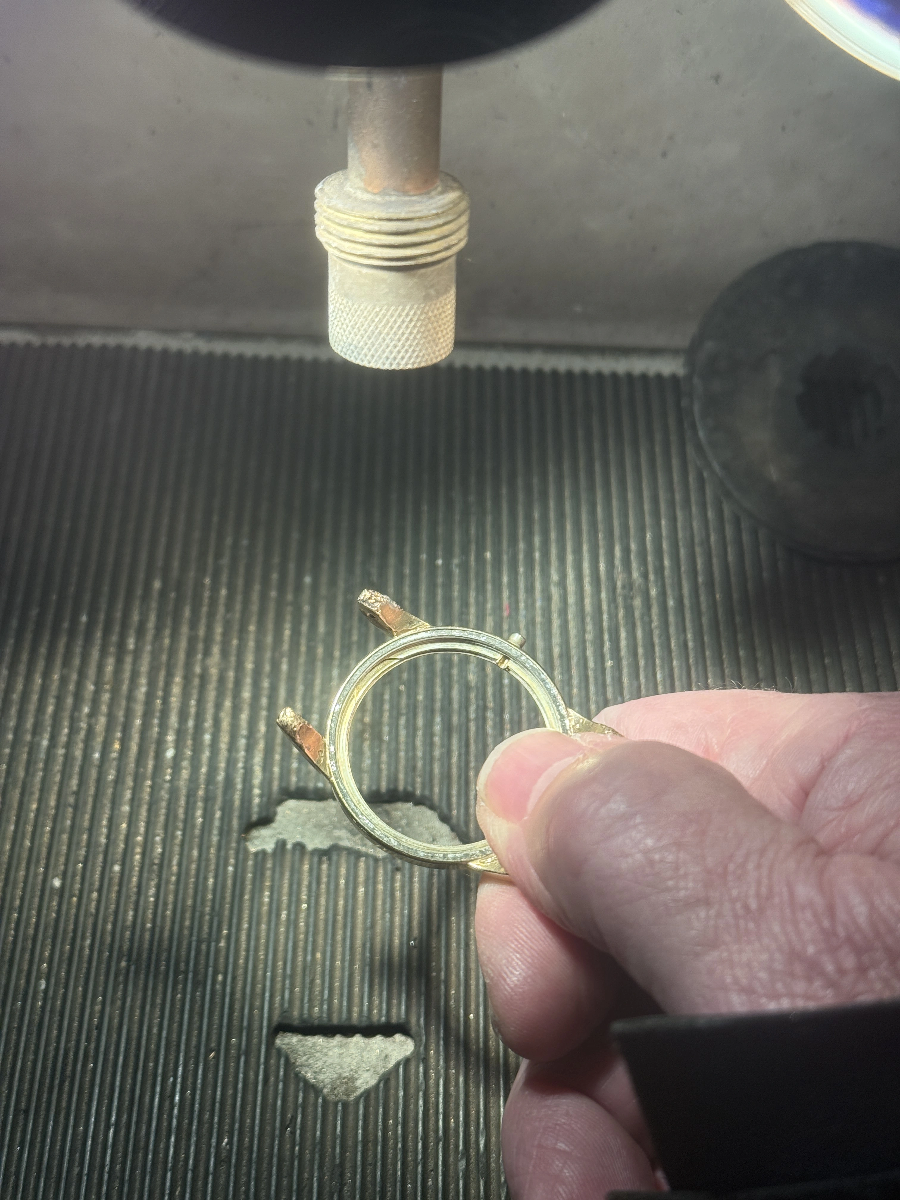

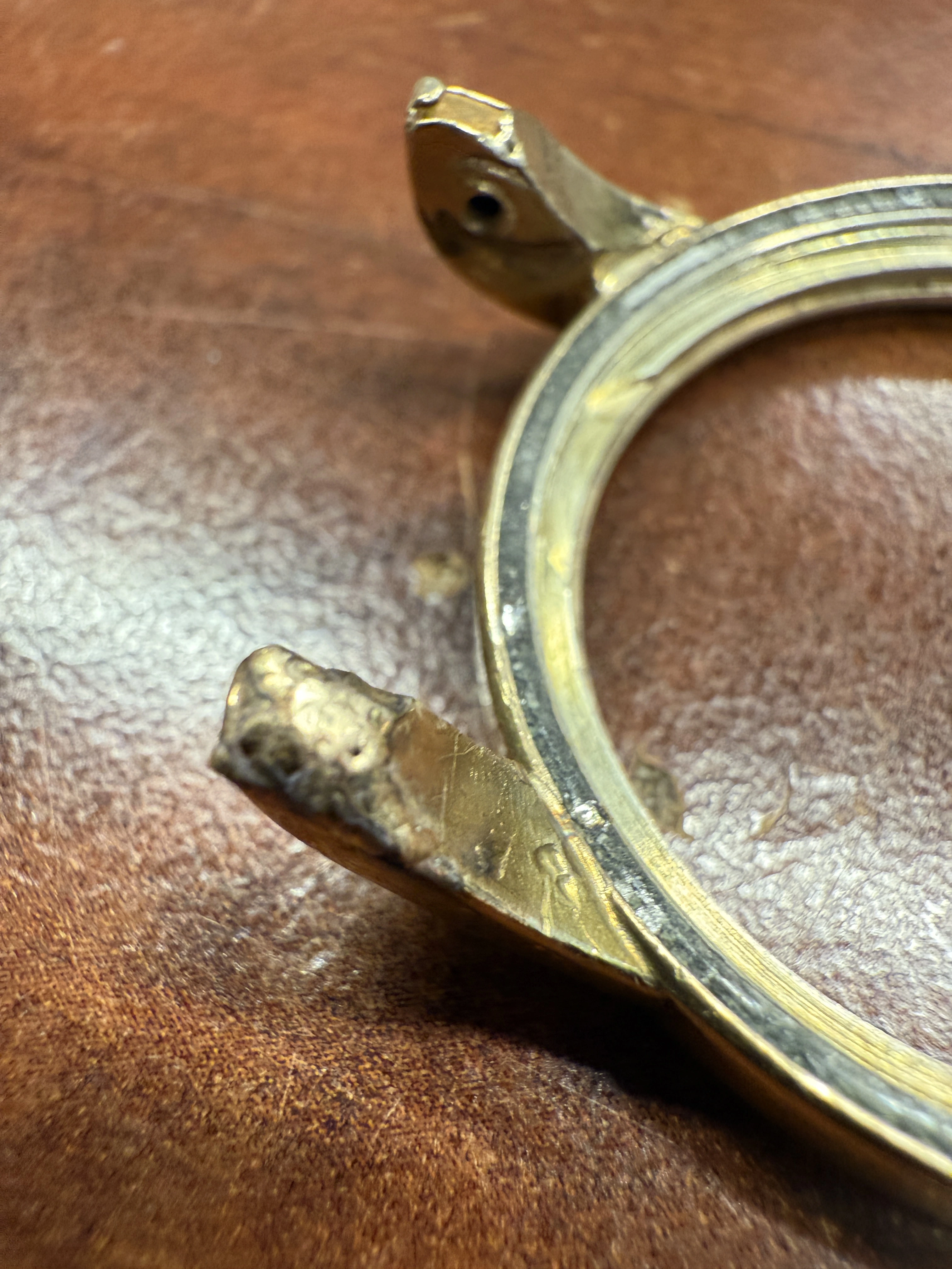

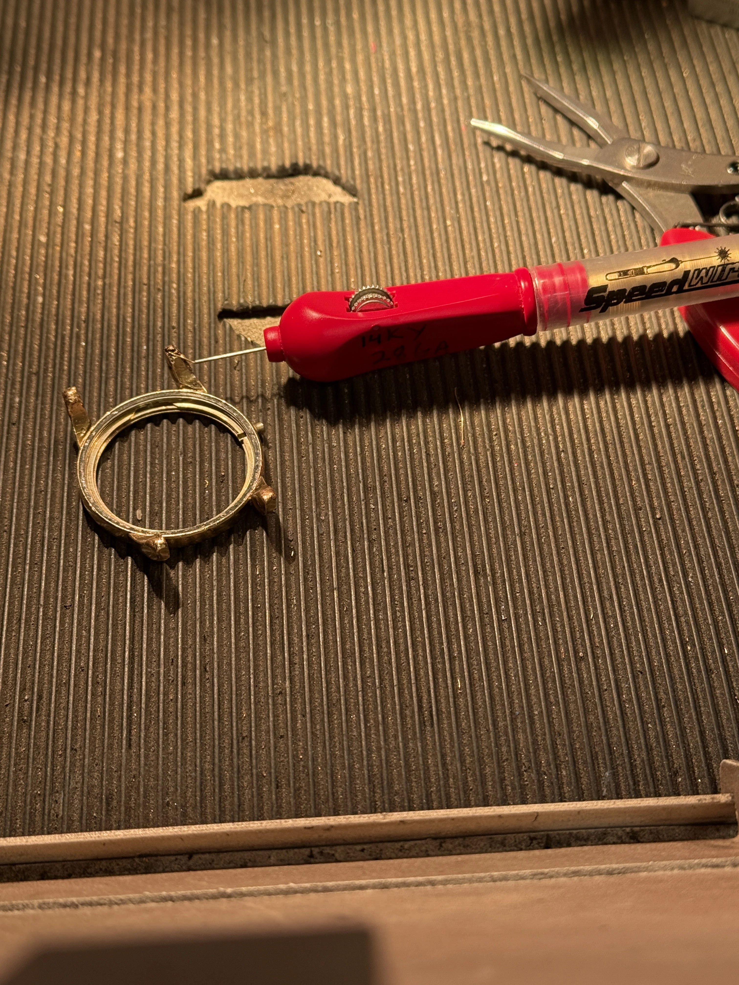

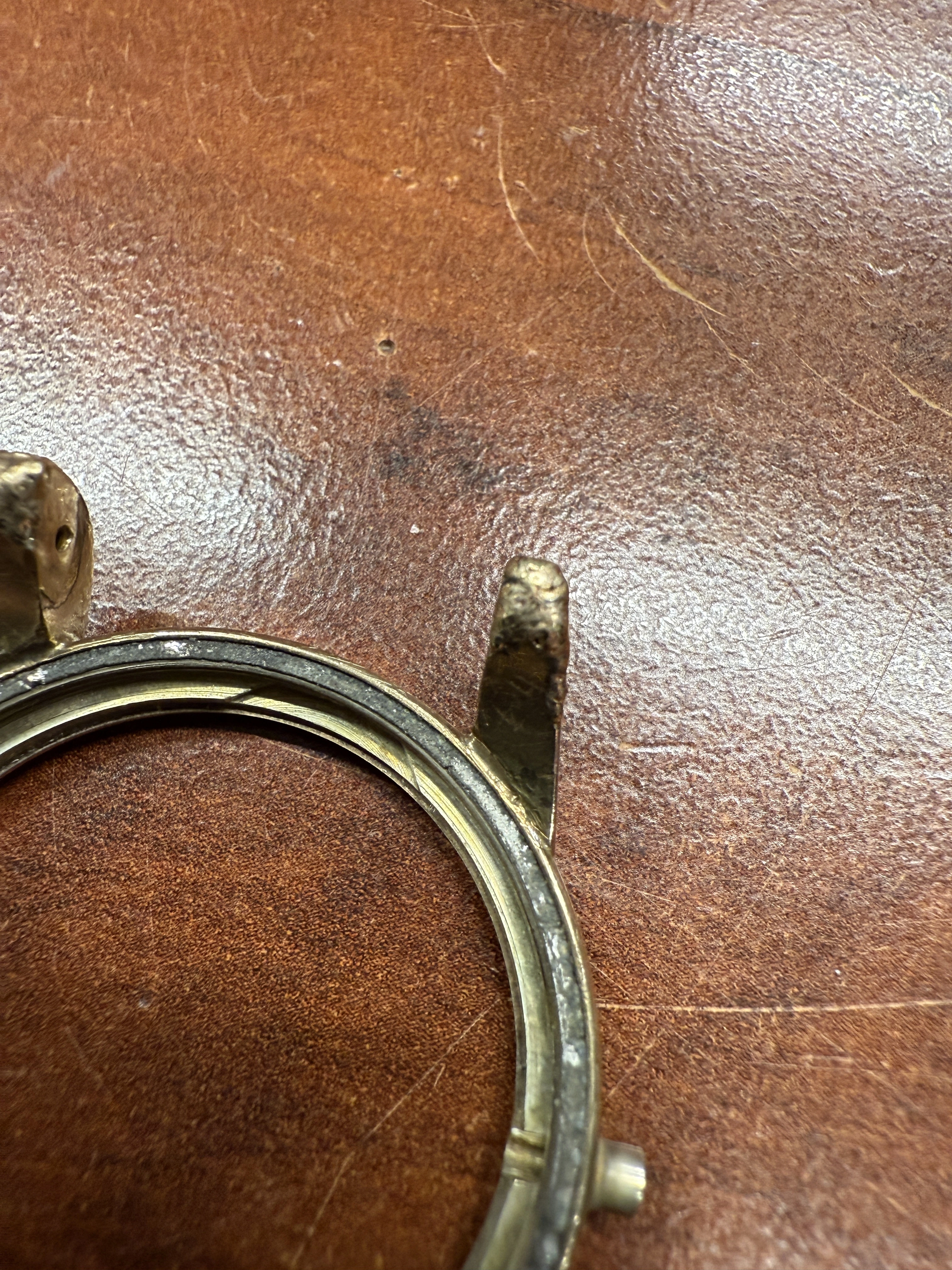

Started filling in 10k gold wire with laser welder. No idea how this is going to turn out as it's the first time we have tried this. Here are some pics of the worst lug after some filling.
This watch is from my personal collection and will continue to post pictures as we progress.

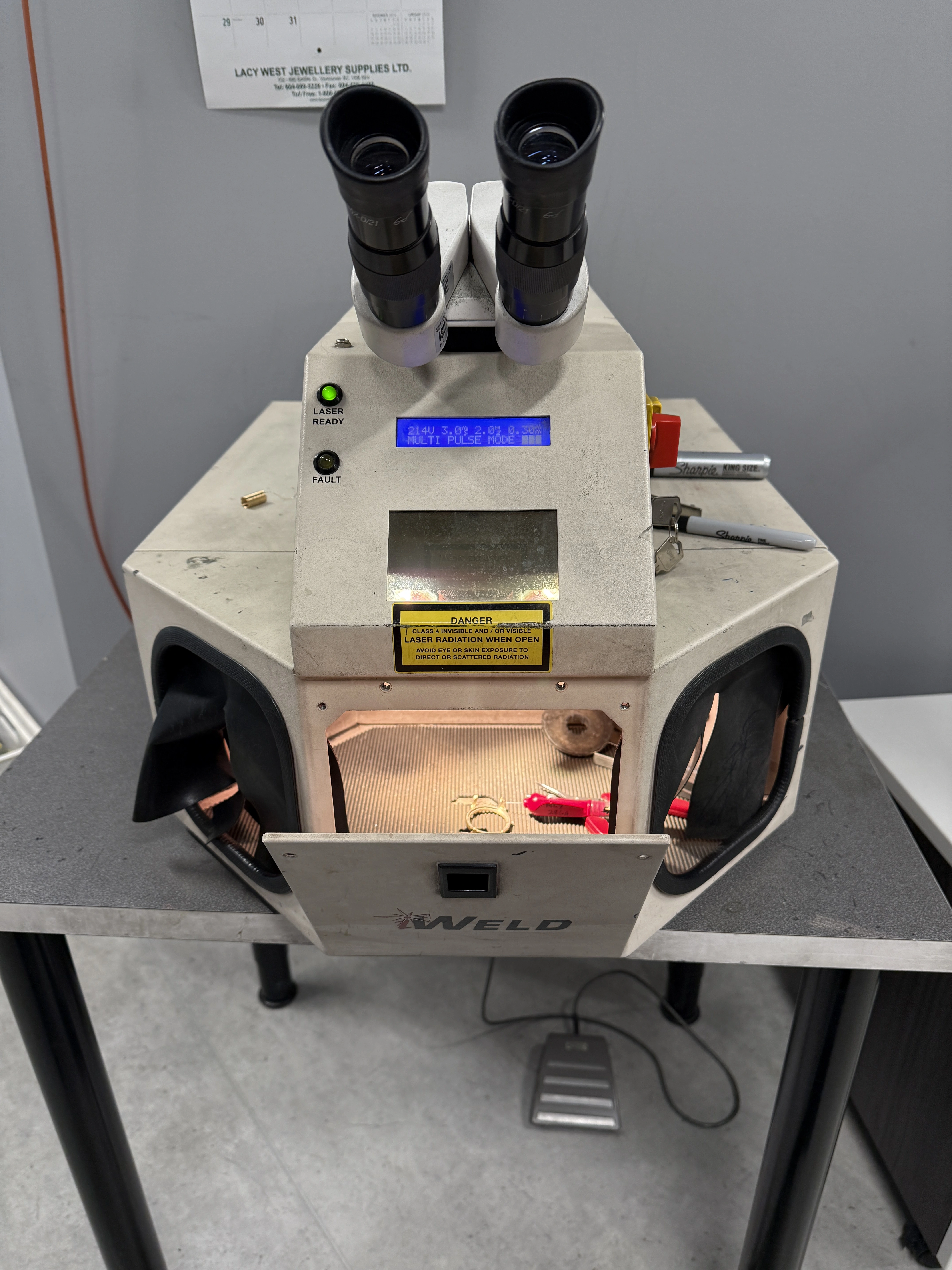

I have not tried laser welding yet. What sort of machine are you using?
Have plans myself for some case restoration, but not gold. Main issue is that to plate base metal one needs a copper strike, which traditionally requires cyanide. Rio Grande may have a cyanide free strike.
Most base metal contains tin. Which reacts with the acids in the plating and pickle.
I have considered straight up welding. Too many projects at the moment. Hand sewing straps takes time. Waiting for parts also takes time. Fiddling with balance springs takes time.
I did try using the fiber laser on a cheap case, but it warped the metal.

I'm very interested in seeing your progress; please keep posting pics showing even the small steps. Laser welding is something I am interested in, but never have tried. Looks great so far!

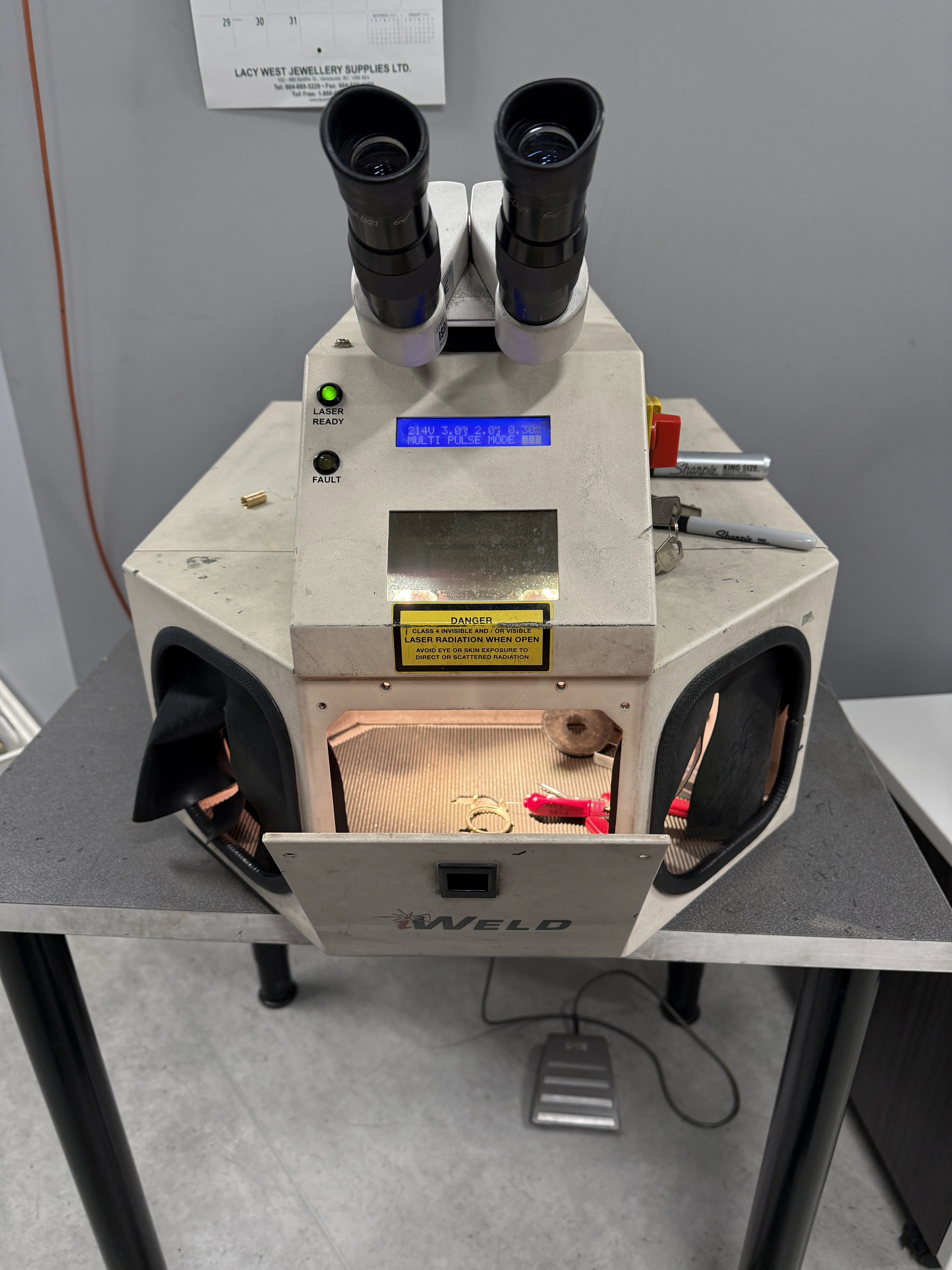

We have a LaserStar 80 joule welder. We've had it for about 15 years and it's still working great. Would love to upgrade to a more modern unit but for now it's more than adequate.
Laser works great on stainless steel, platinum, gold, silver but not so well on some base metals, brass and pewter.

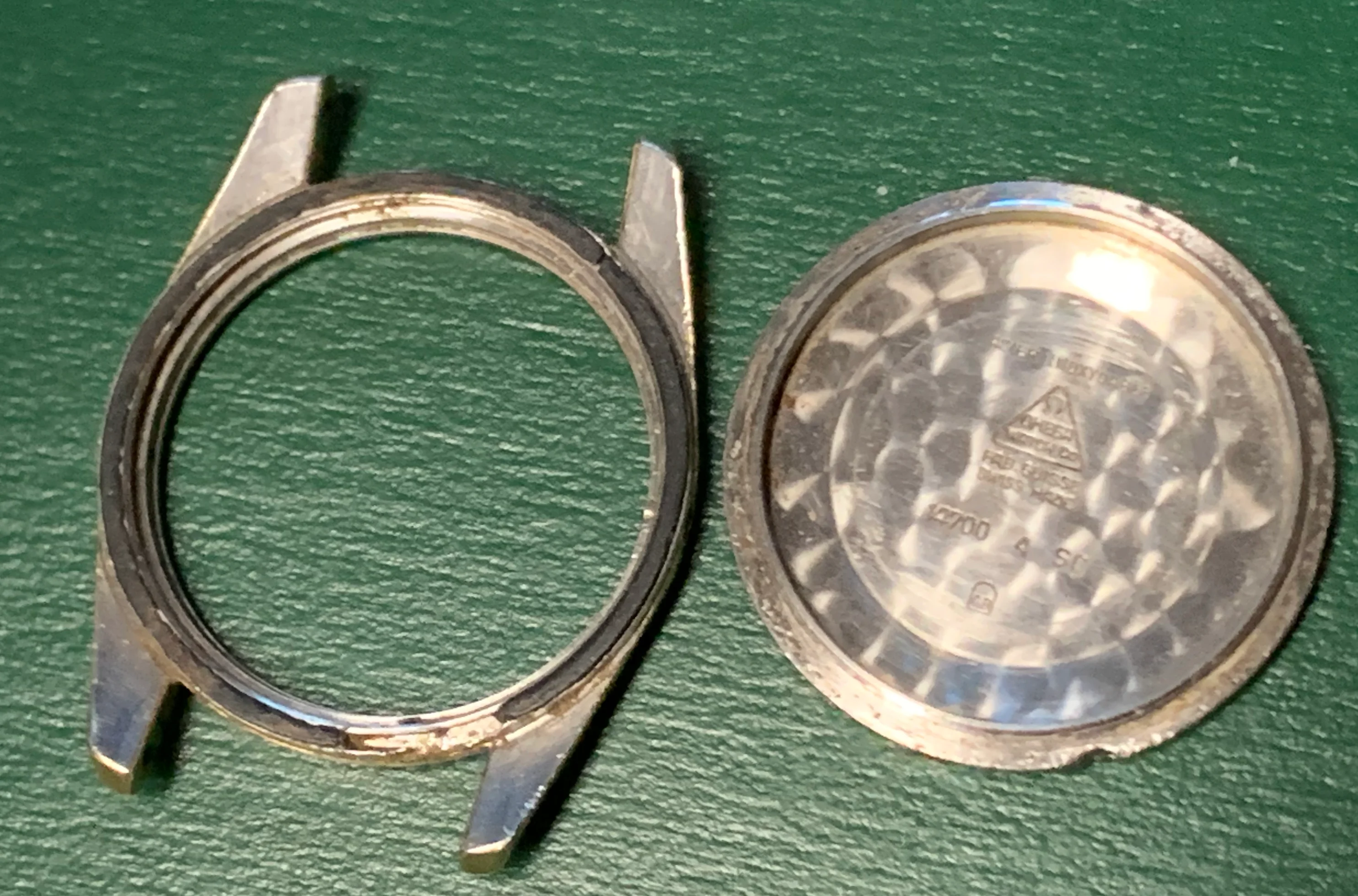

Here is a shot of a trashed 14700 - 4 case someone took a byte out of. Also missing the bezel.

I was wondering when someone would mention why are doing this watch. Truth be told, this watch has no sentimental value at all and the $ value will only increase a little at best if successful. Which is the reason I chose this watch. If something goes wrong and I really mess the case up, then not a big deal but if it goes well then, I will have confidence offering this service.
On second thought, it may become sentimental if this project is successful.

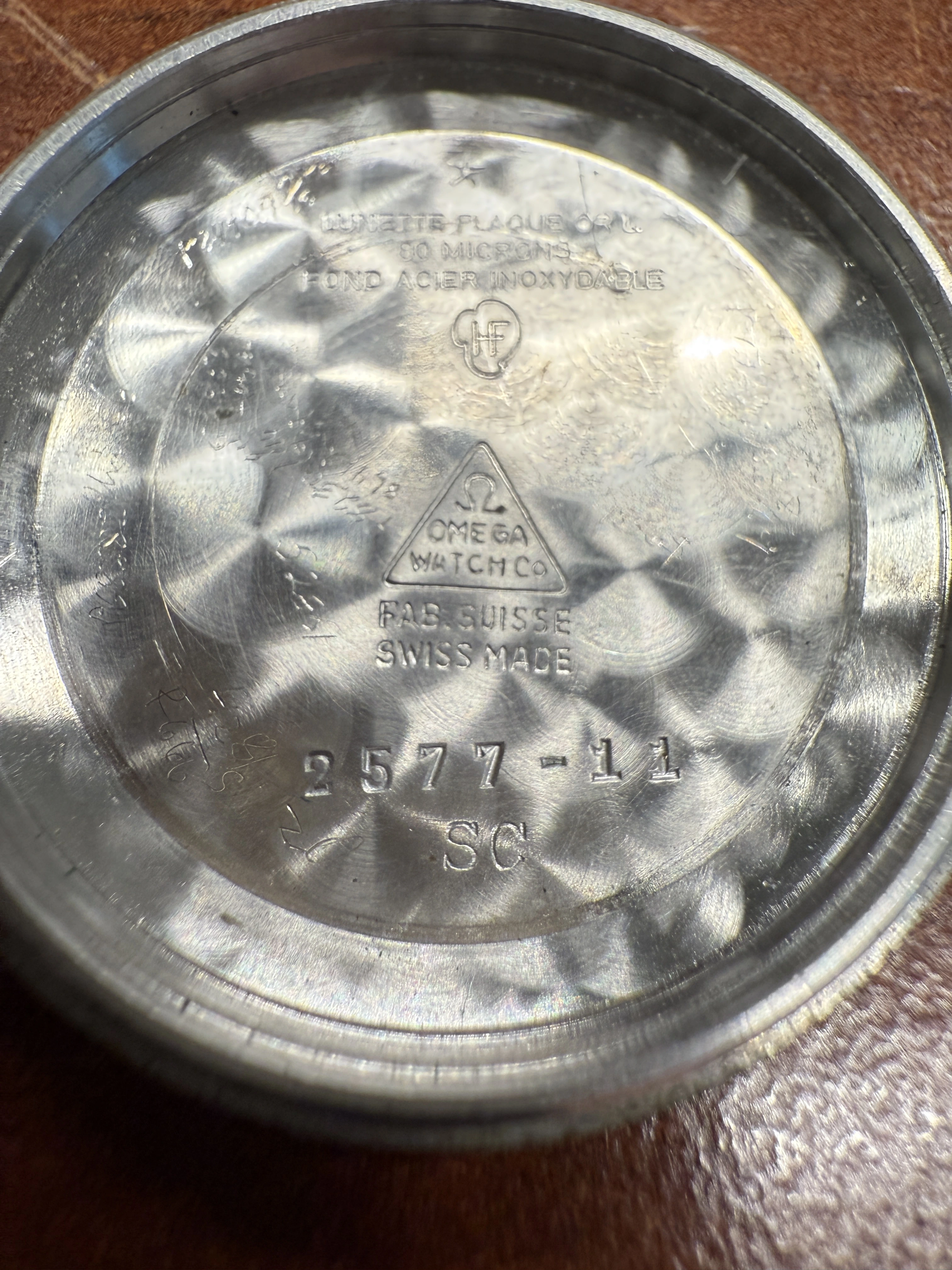

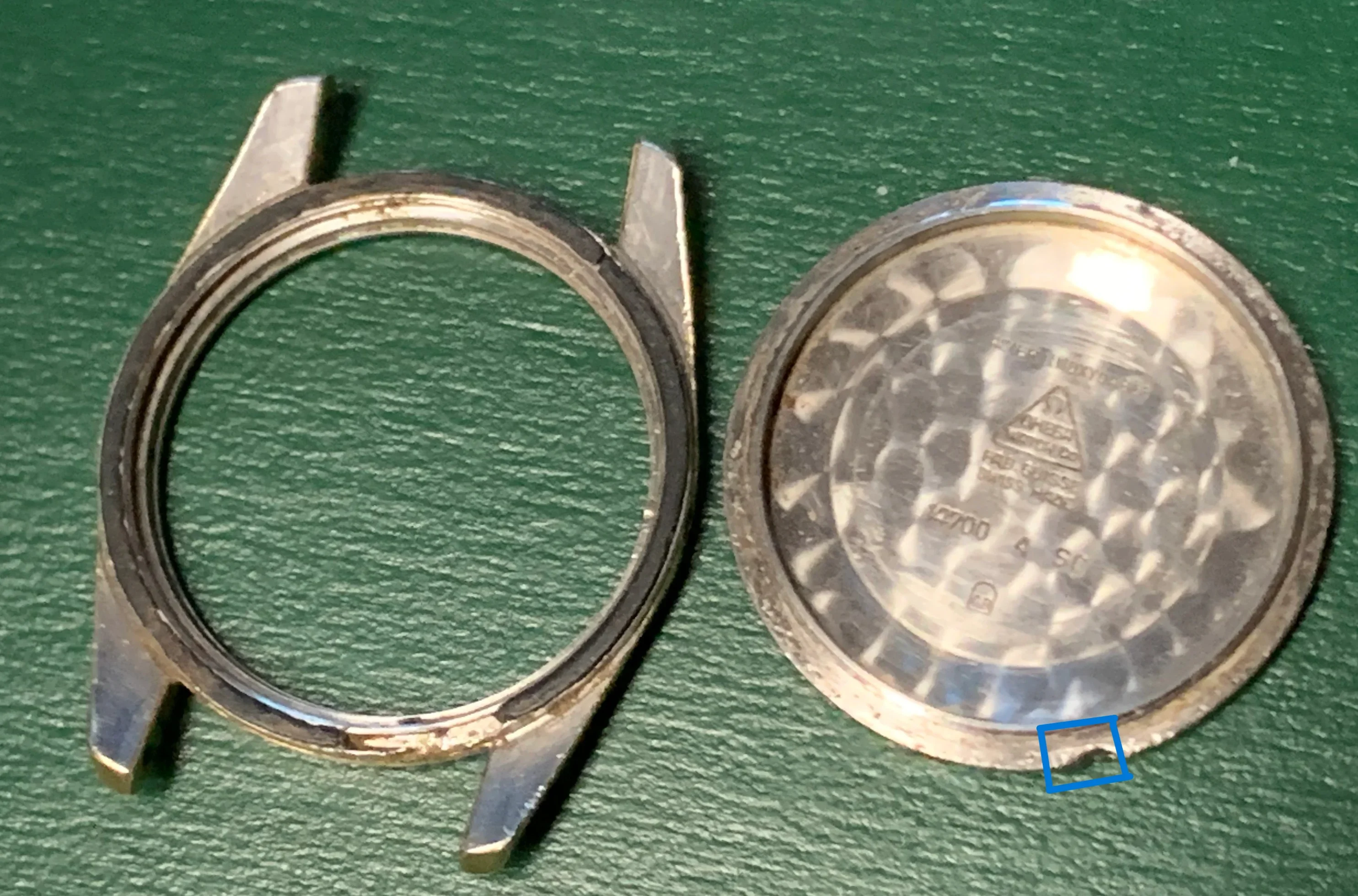

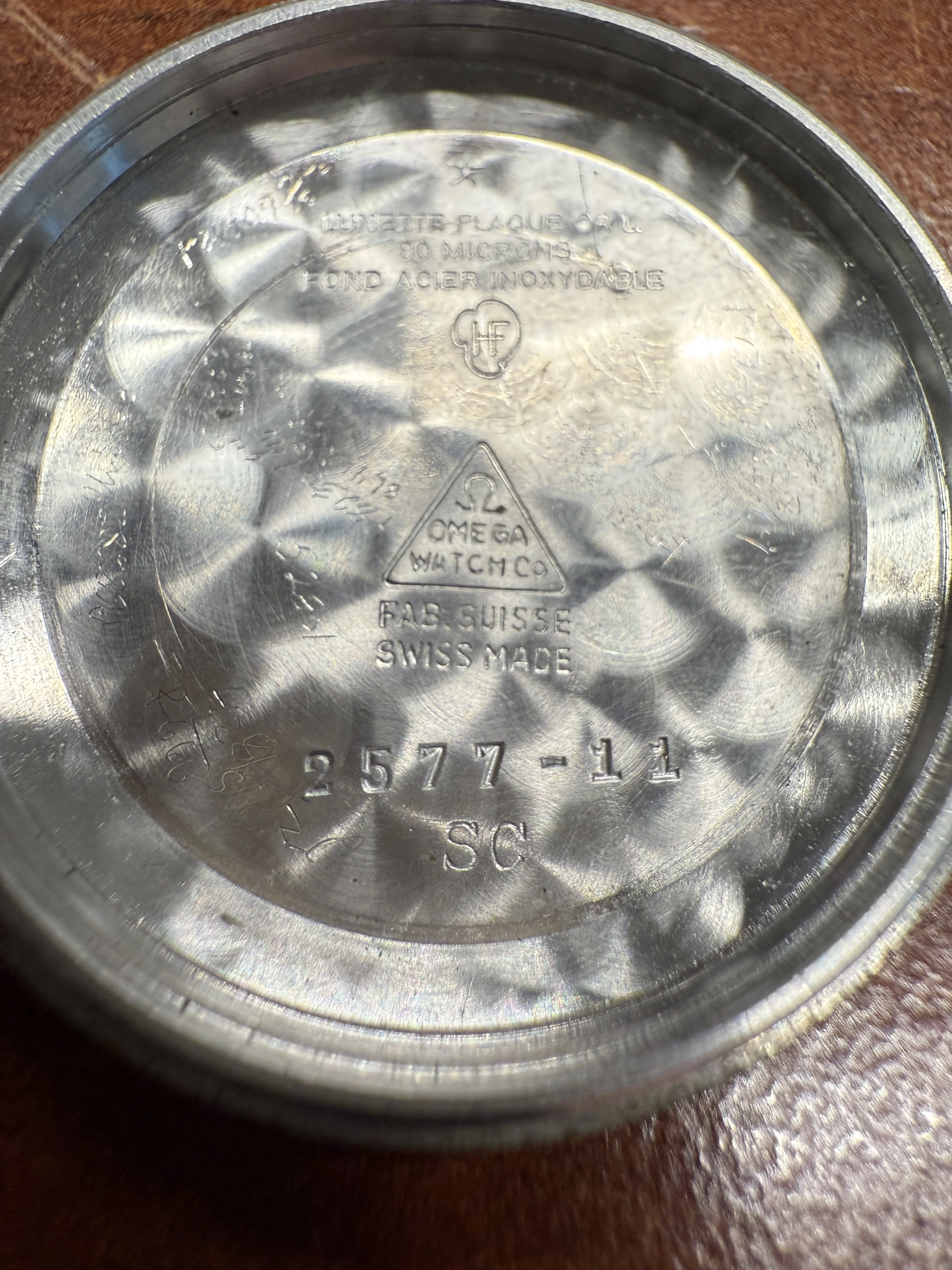

Are you referring to the chunk out of the caseback?

Just realized I was using the 14kt wire and probably used 3/4 - 1 gram already.

I've got about 1.5 hours into it already.
Yup.
There is a matching chunk missing from the case as well. Where the gasket is missing. Looks like someone attempted to drill a hole in it. Or tried to pry the back off with something that twisted.
I actually got this for the movement (552) of course I now have another 552 movement (mostly) waiting for a new sweep pinion and some other things. This is how such parts watches breed. Downside is the midwifery fees add up quickly.
