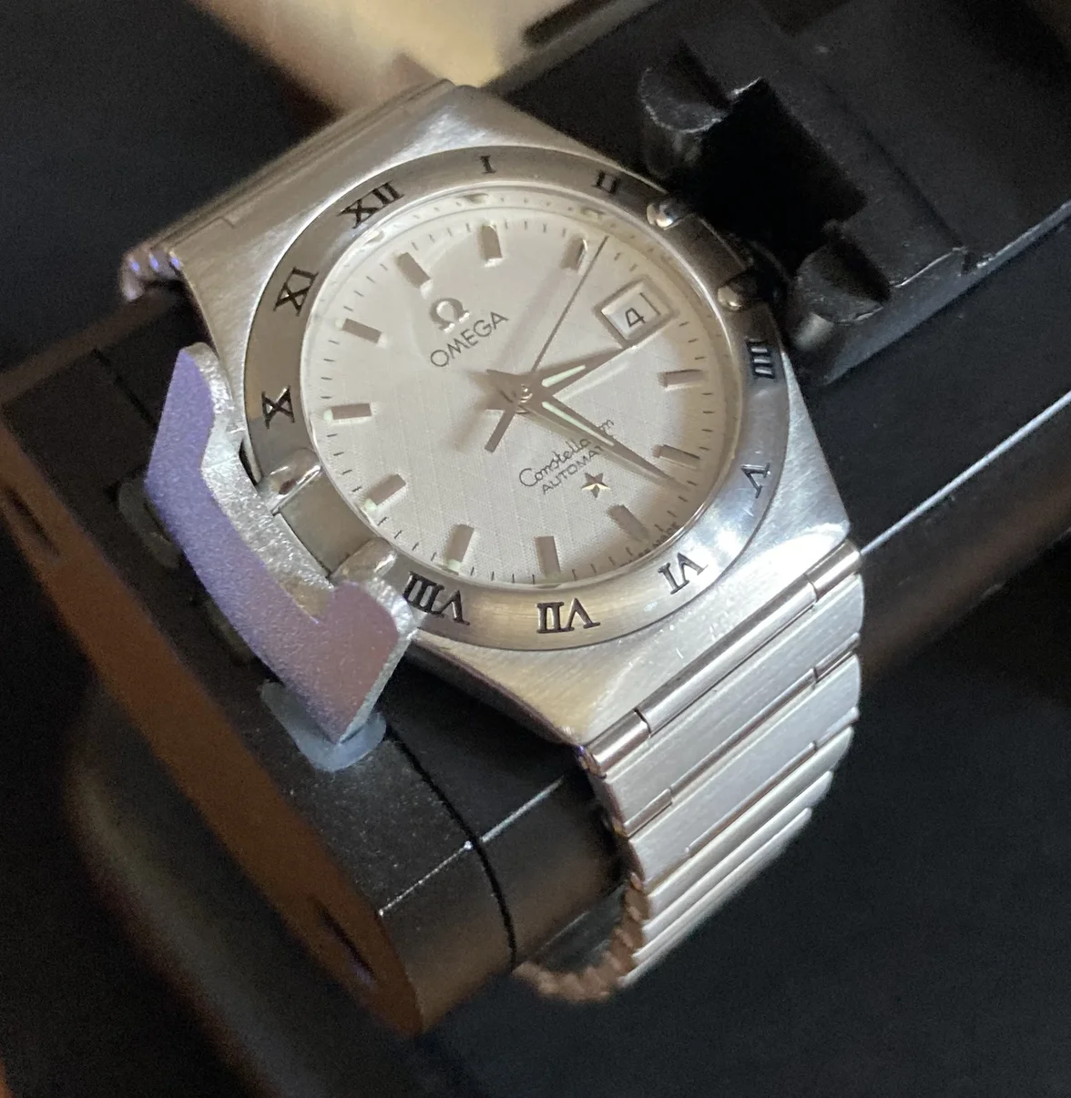

Hello everyone,

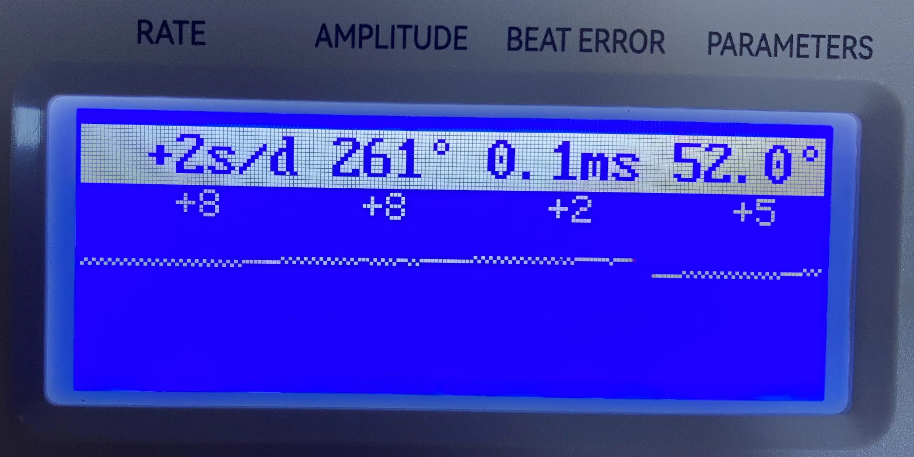

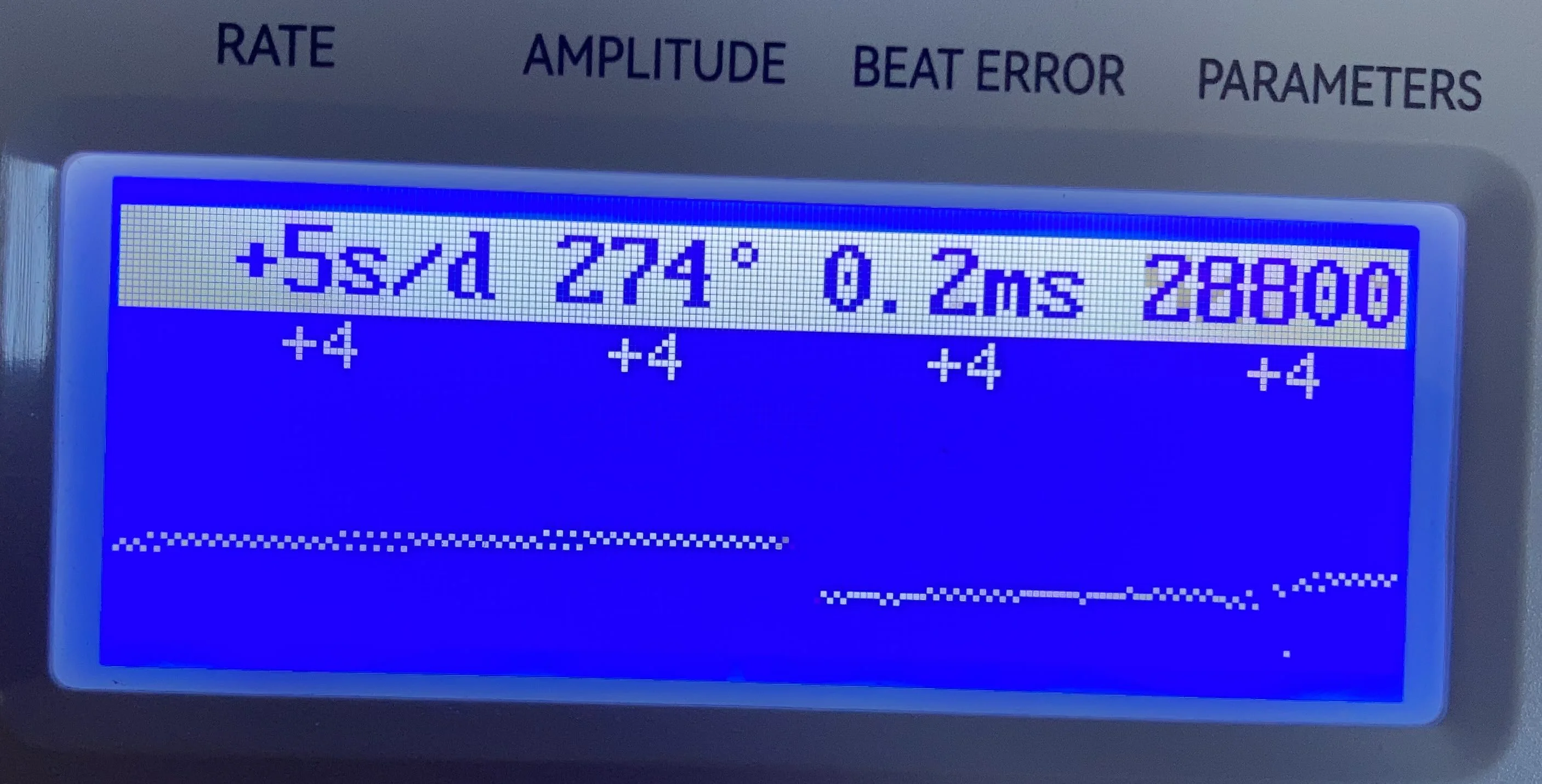

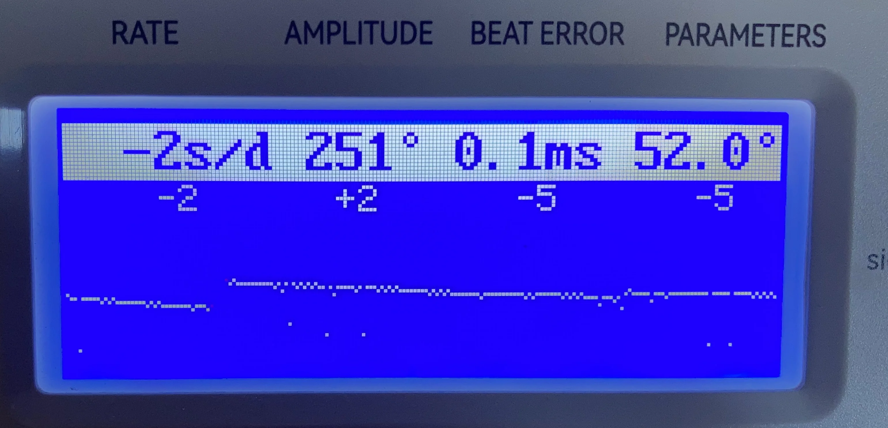

I’m having an issue with an Omega 766.1201 cal. 2520 and would appreciate some ideas.[
I serviced the movement and it generally runs quite well and can run continuously for about 48 h. Initially I replaced the complete balance assembly with one from a 2520 donor because of a broken balance staff. On the timegrapher, the readings look good in almost all positions, with good amplitude and a clean trace. I thought I fixed the problem, the watch is freshly serviced and I can gift it to my wife, which I did.
However, while wearing the watch it randomly stops. Once it is given a shake or the crown pulled out and pushed in again, it will run normally again. Sometimes it runs fine on the wrist for a day, but then stops again out of nowhere. It happends at different times, the hands are not involved in the issue. I also demagnetized the watch properly so that should not be a problem. There is also no hair or dust. The mainspring is not sticky, moves freely and breathes nicely.

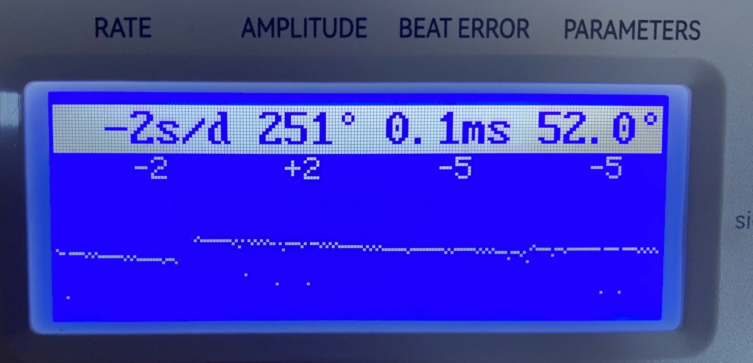

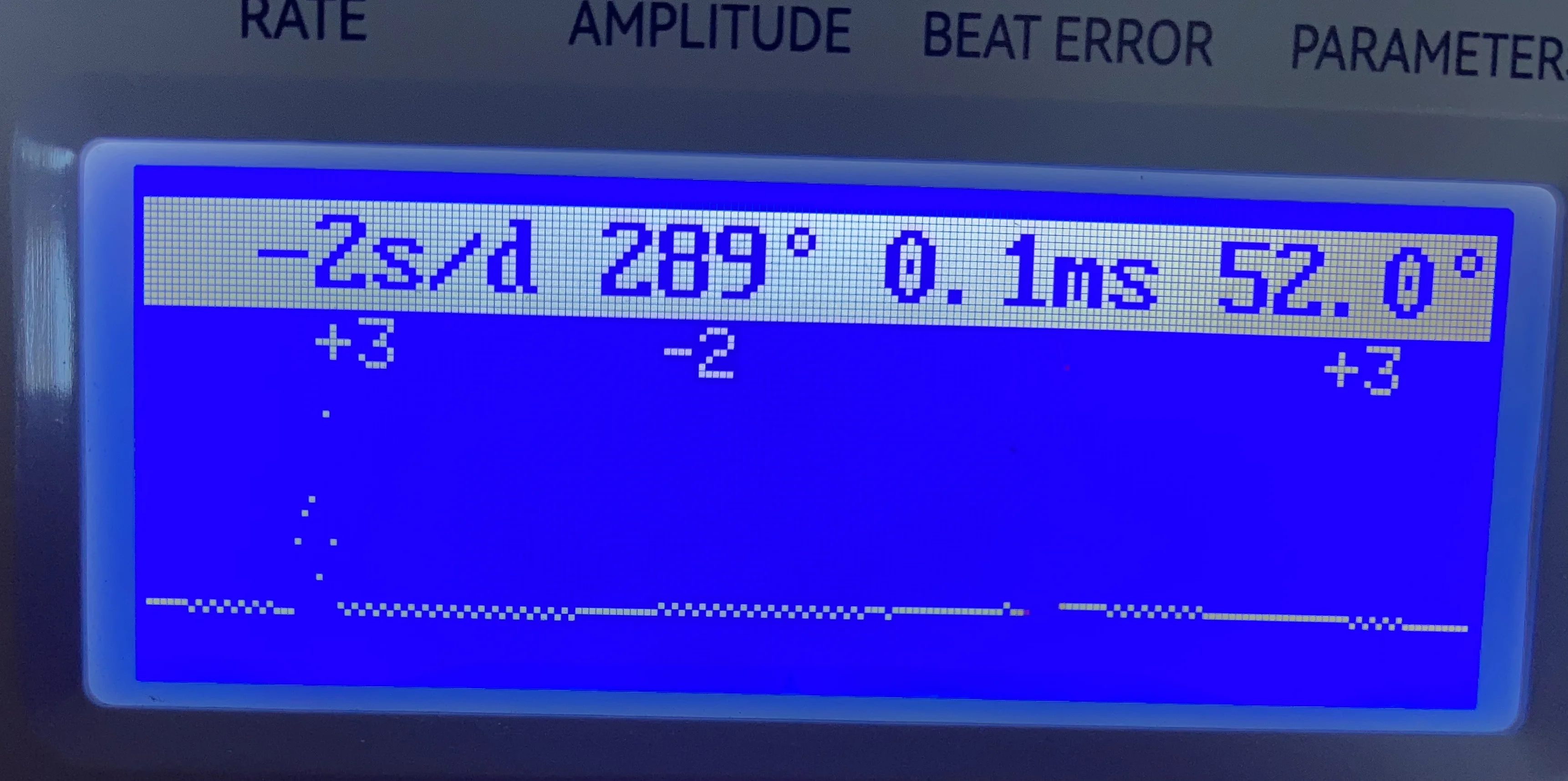

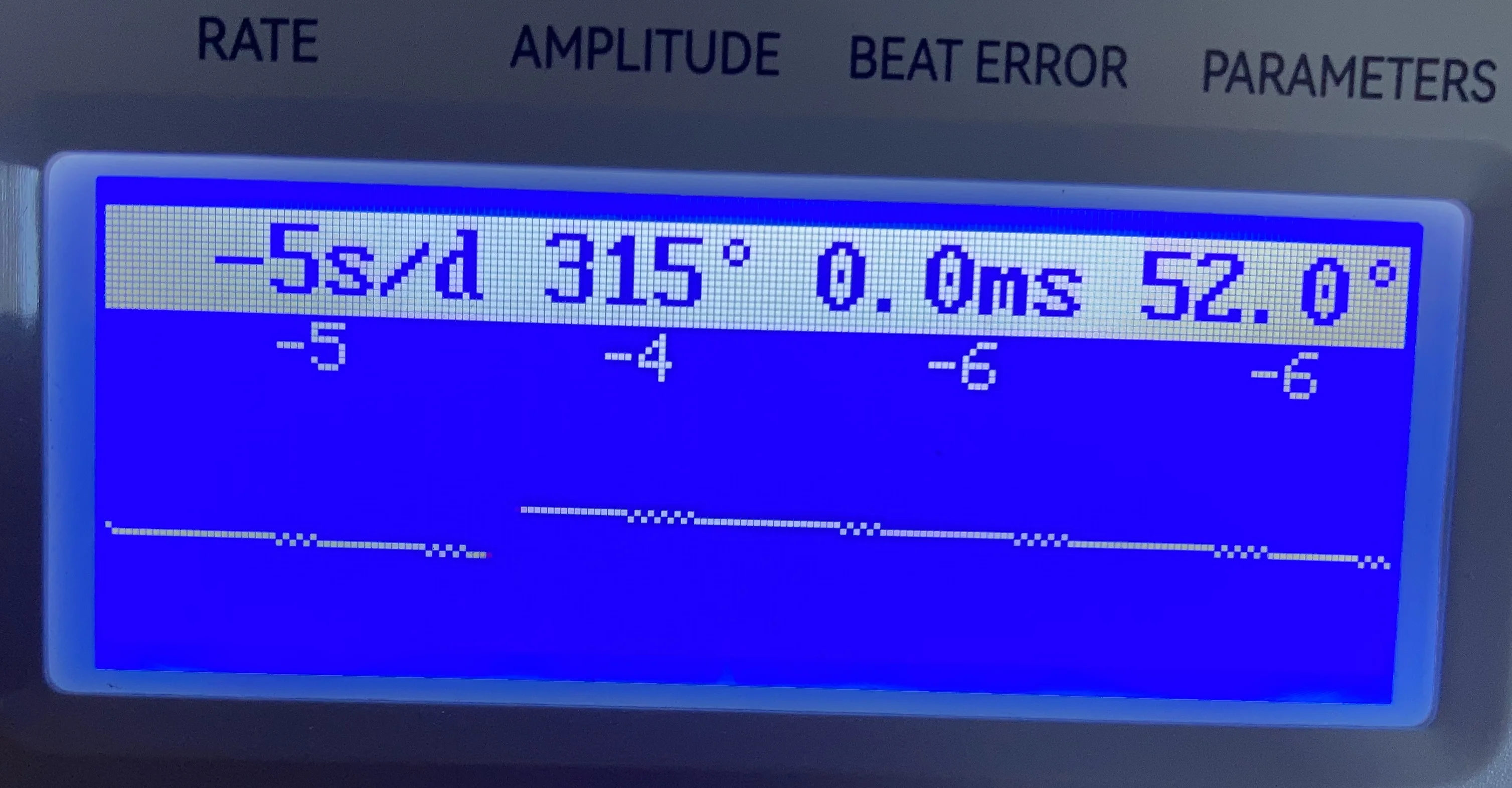

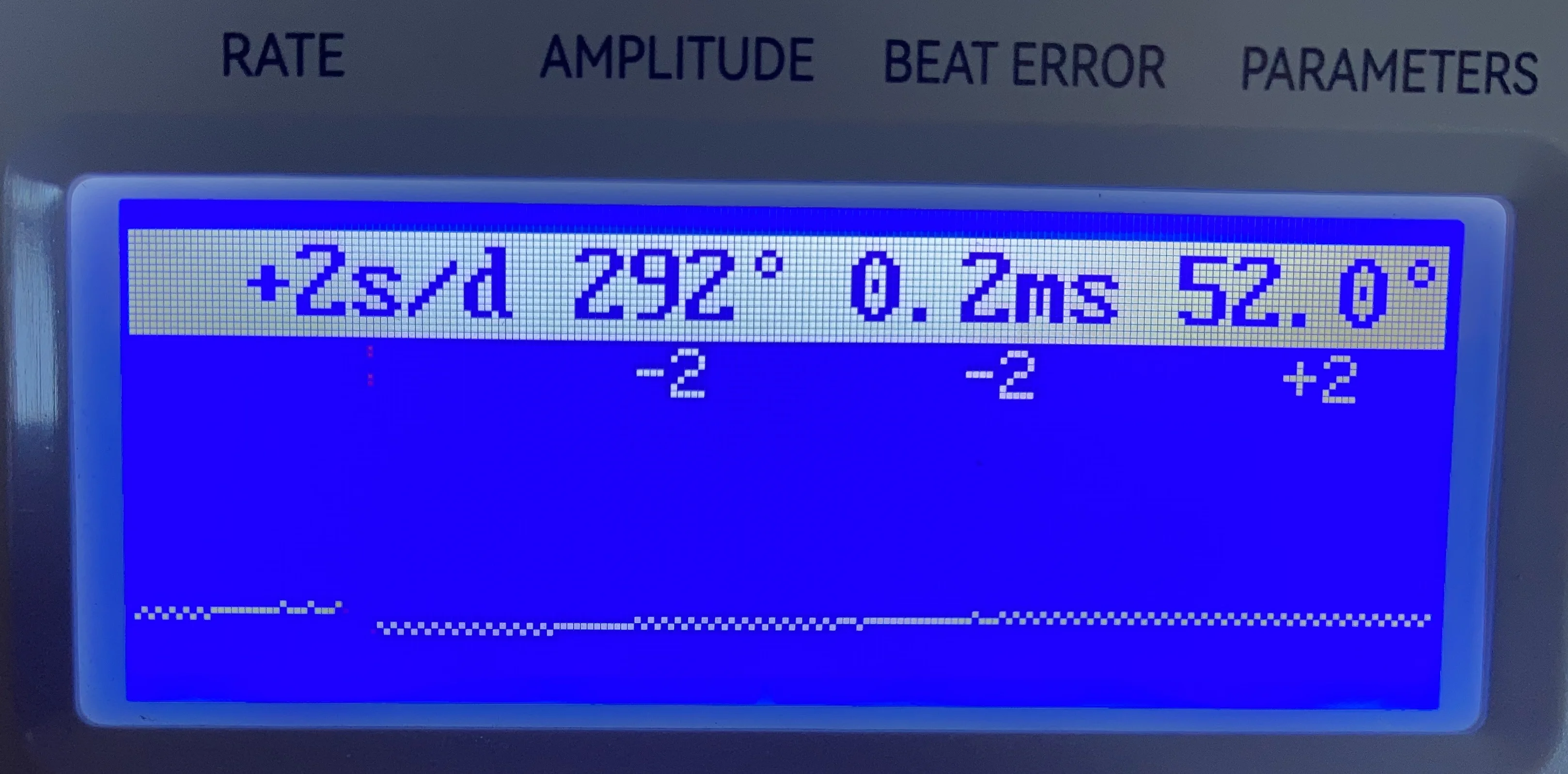

I will attach the timegrapher readings for all positions. Looking at them I could only suspect something being wrong in the CU (crown up) position. I realised that that the movement is very sentitive when it comes to oiling the cap jewels of the balance assembly. Maybe the oil in the dial side cap jewel is not uniform and thus creates this problem?
Any thoughts on what could cause such behaviour or and experience with this particular movement would be highly appreciated.
Regards
DU:
DD:
CR:
CD:
CL:
CU:
