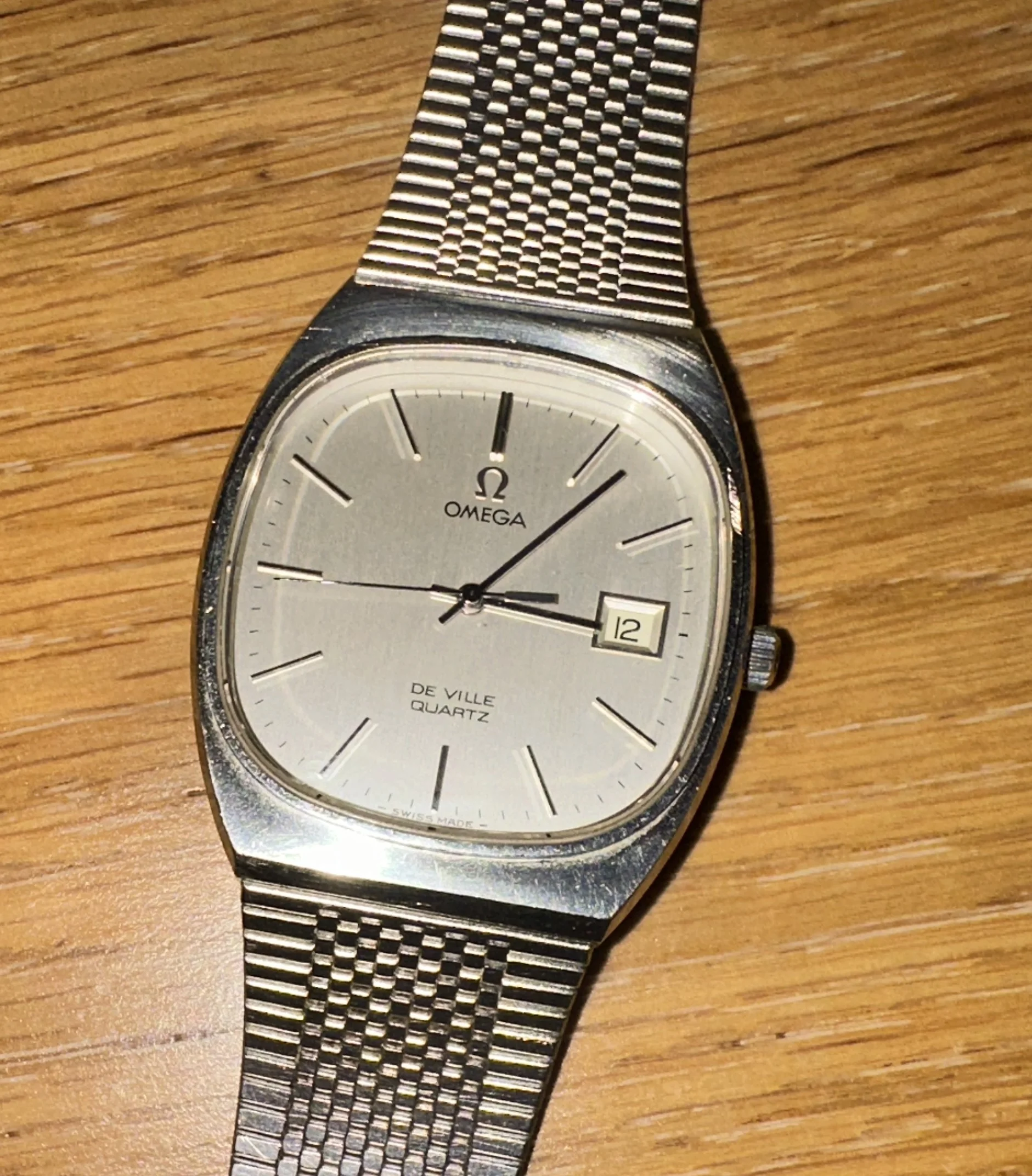

OMEGA De Ville 1342 stopped running

Hi,
Noticed a few weeks back that this OMEGA De Ville was running a few hours slow after it had been set a few weeks prior.
Now it's happened again and I've gone to set the time and after getting it to the correct minute the seconds hand has stopped and will not move past this position.
I've heard there is some common issues with the stepper motor of this movement, but hoping this is just in need of a battery replacement.
I'm not sure when the battery was last changed as I bought it second hand off eBay late last year.
Thanks,
James

UPDATE:
Took the watch apart and tested the battery using a multimeter - reading 1.58V so it's not the battery.
Put the battery back into the watch and it's fully working again - set the time correctly so I will wait and see now in a few weeks whether the watch is still lagging a few hours behind.
Thanks,
James

Thanks for the info, the watch is having the same issue again (lagging hours behind and when setting the time the seconds hand stops past a certain point and then flicks back and forth between a second) so I've bought a new battery to see how it gets on.
Cheers,
James

As a first point of call yes, but I’ve heard that the cal 1342 has issues with the stepper motor which can give out the same symptoms at first.

Seconds hand catching on the baton marker at 9:00?

It’s slightly below 9 (43 minute marker). If the battery is removed then put back in it will work fine but will run slow and then stop when trying to set it again.
