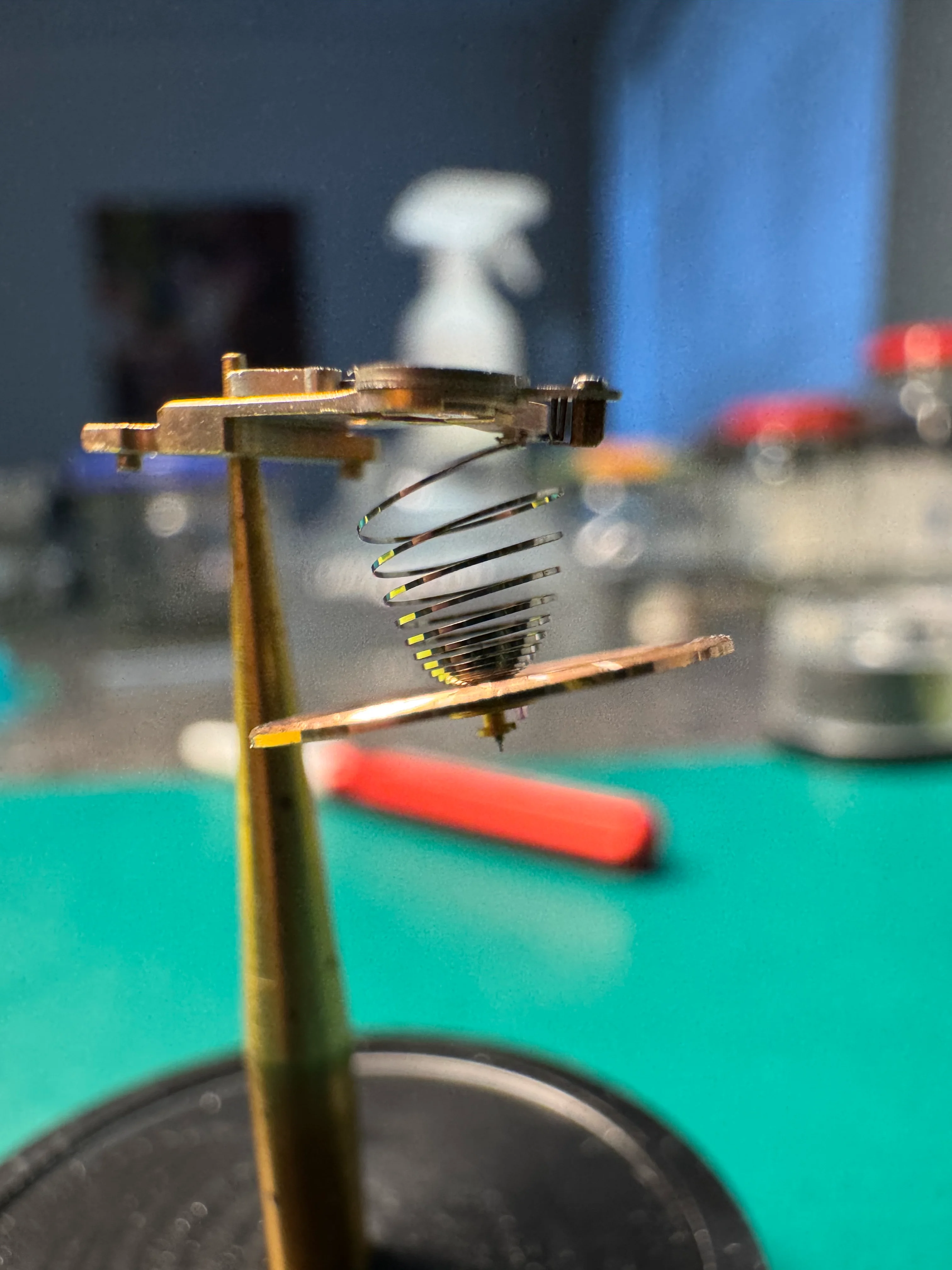

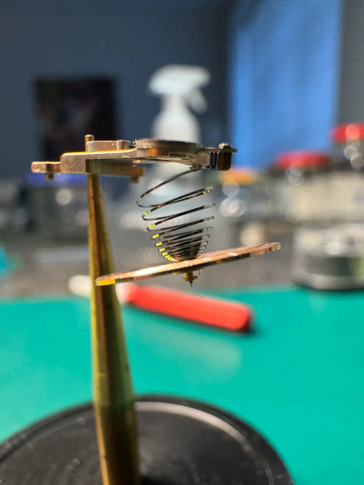

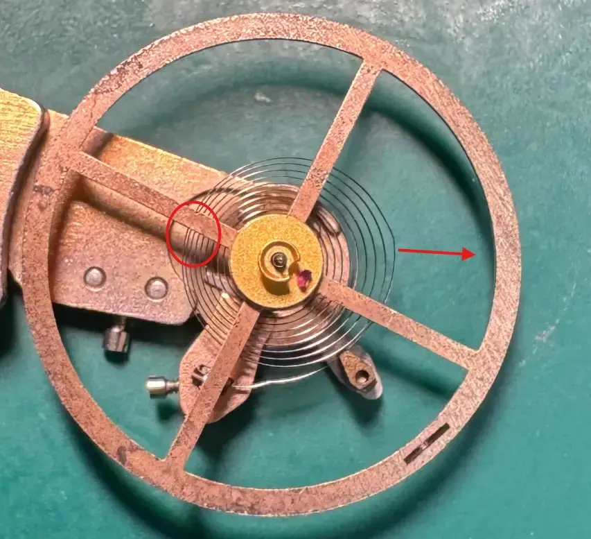

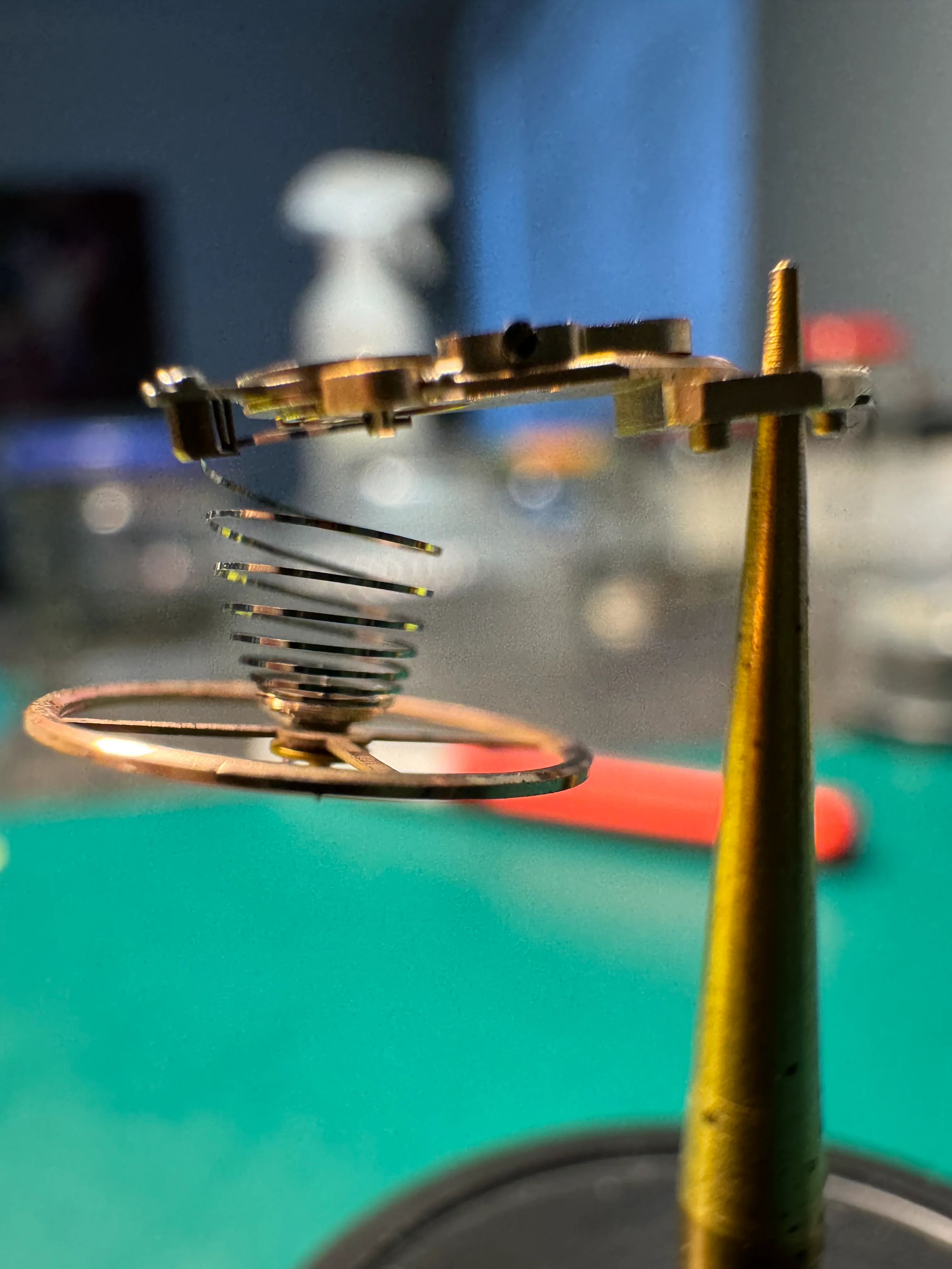

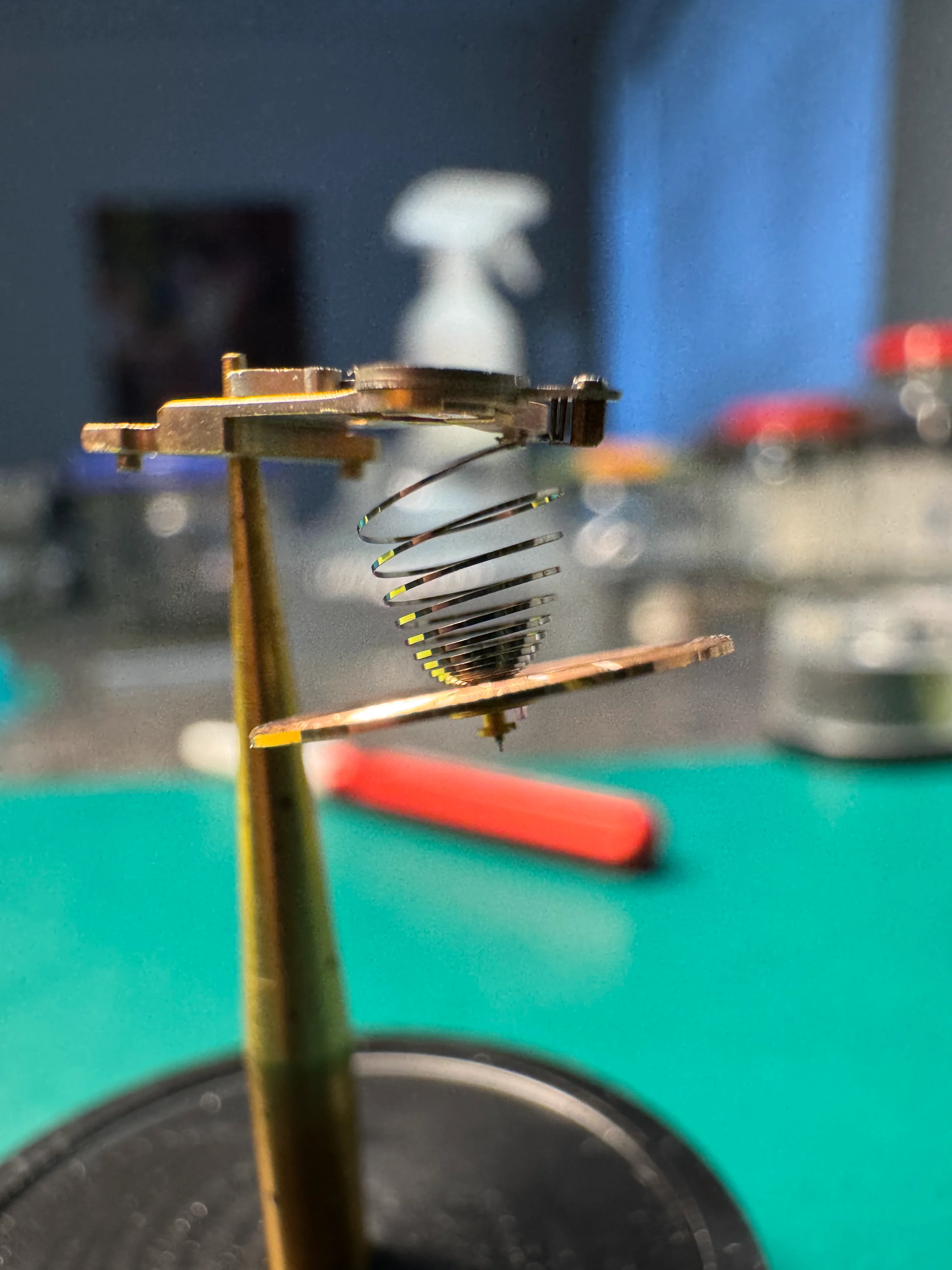

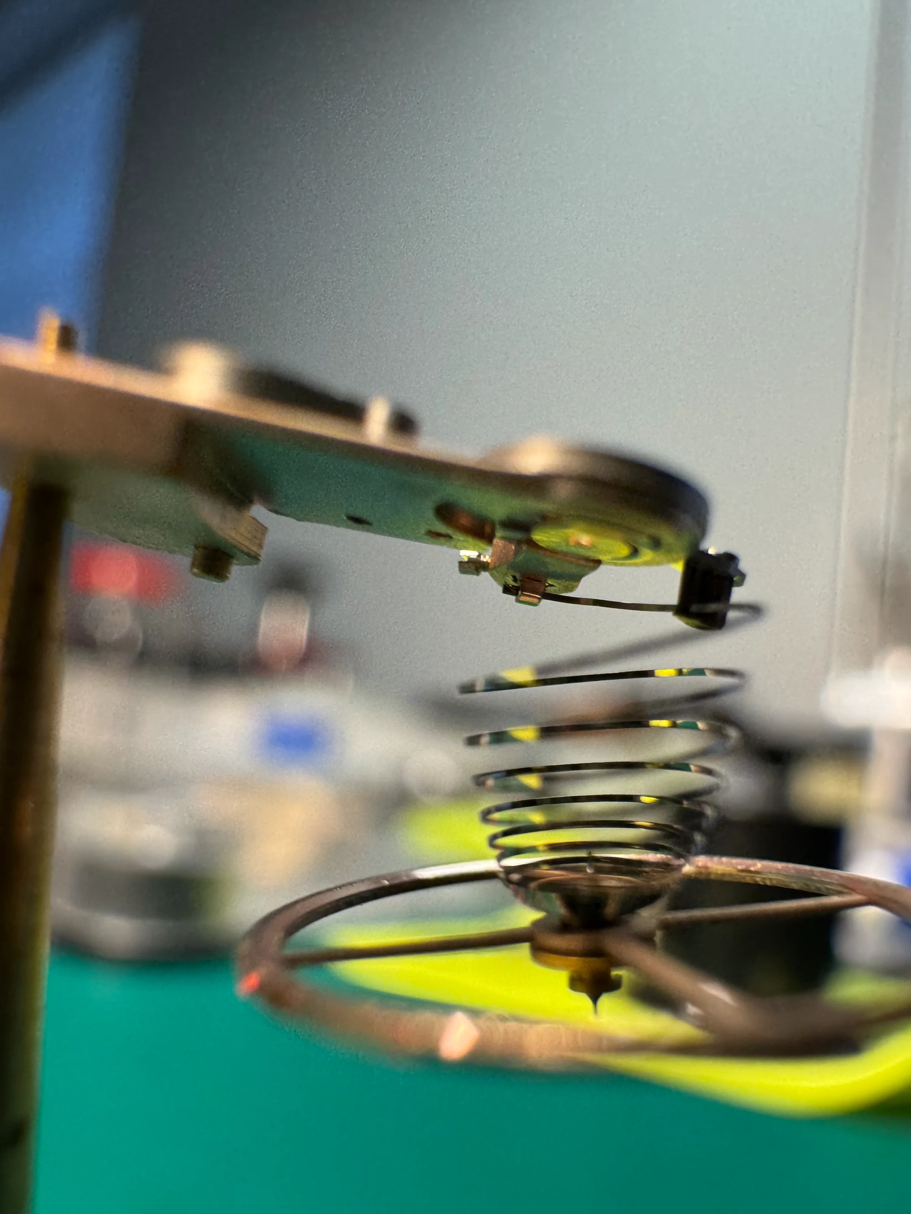

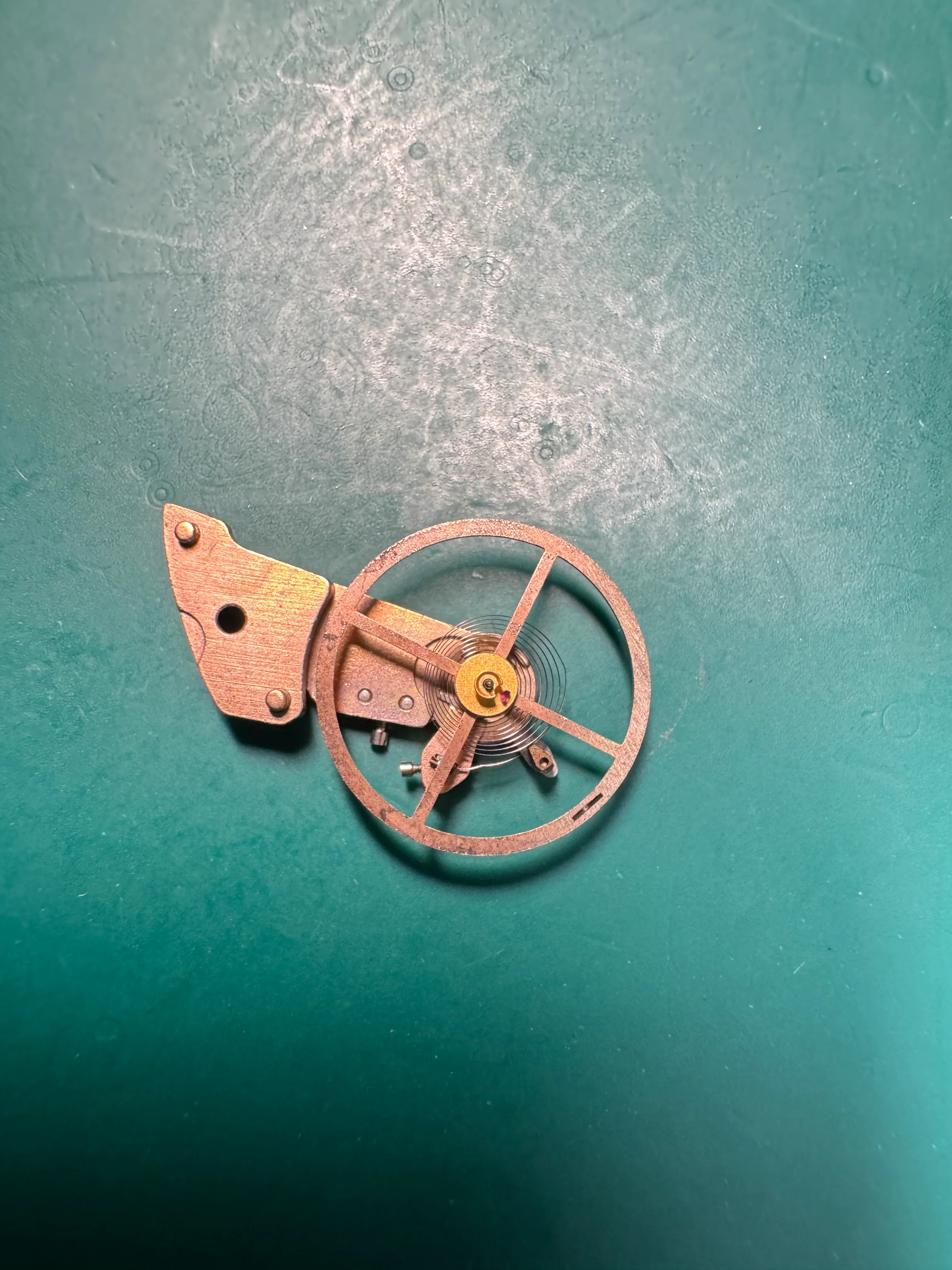

Hi everyone,
Here’s a detailed summary of what I’ve done and the observations so far:
  1. I removed the balance lower jewel (hole jewel) from the plate and the upper jewel (cap jewel) from the balance cock.
  2. I fully disassembled both jewels, cleaned them thoroughly, and reassembled them.

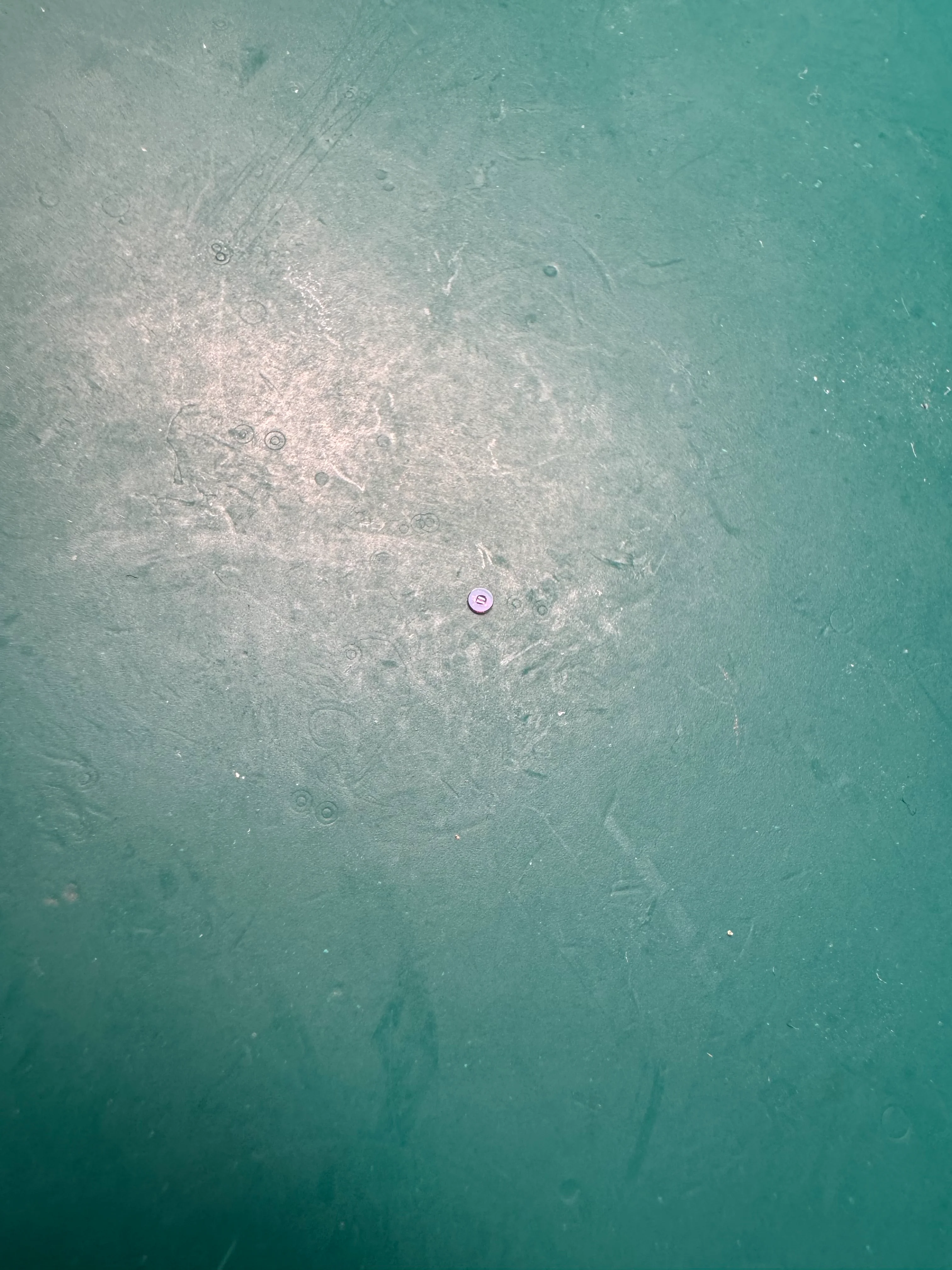

  3. I installed the hole jewel into its metal setting, pressing it fully until it was seated flush, then placed a tiny drop of oil on the cap jewel and reinstalled both jewels into the plate.
After installing the balance without the upper jewel, the movement would not start. The balance seemed to stick on the lower jewel, probably due to excess oil.

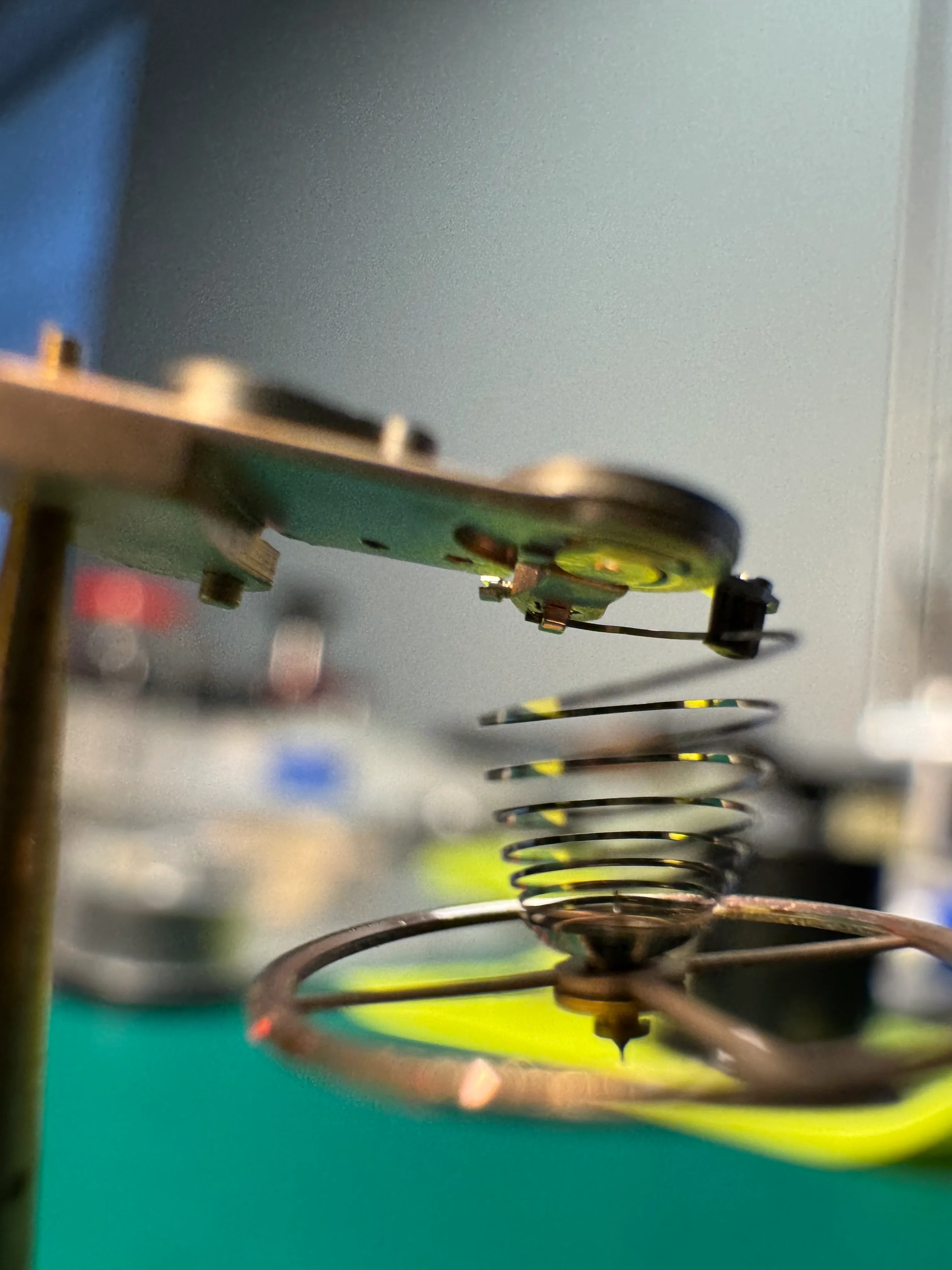

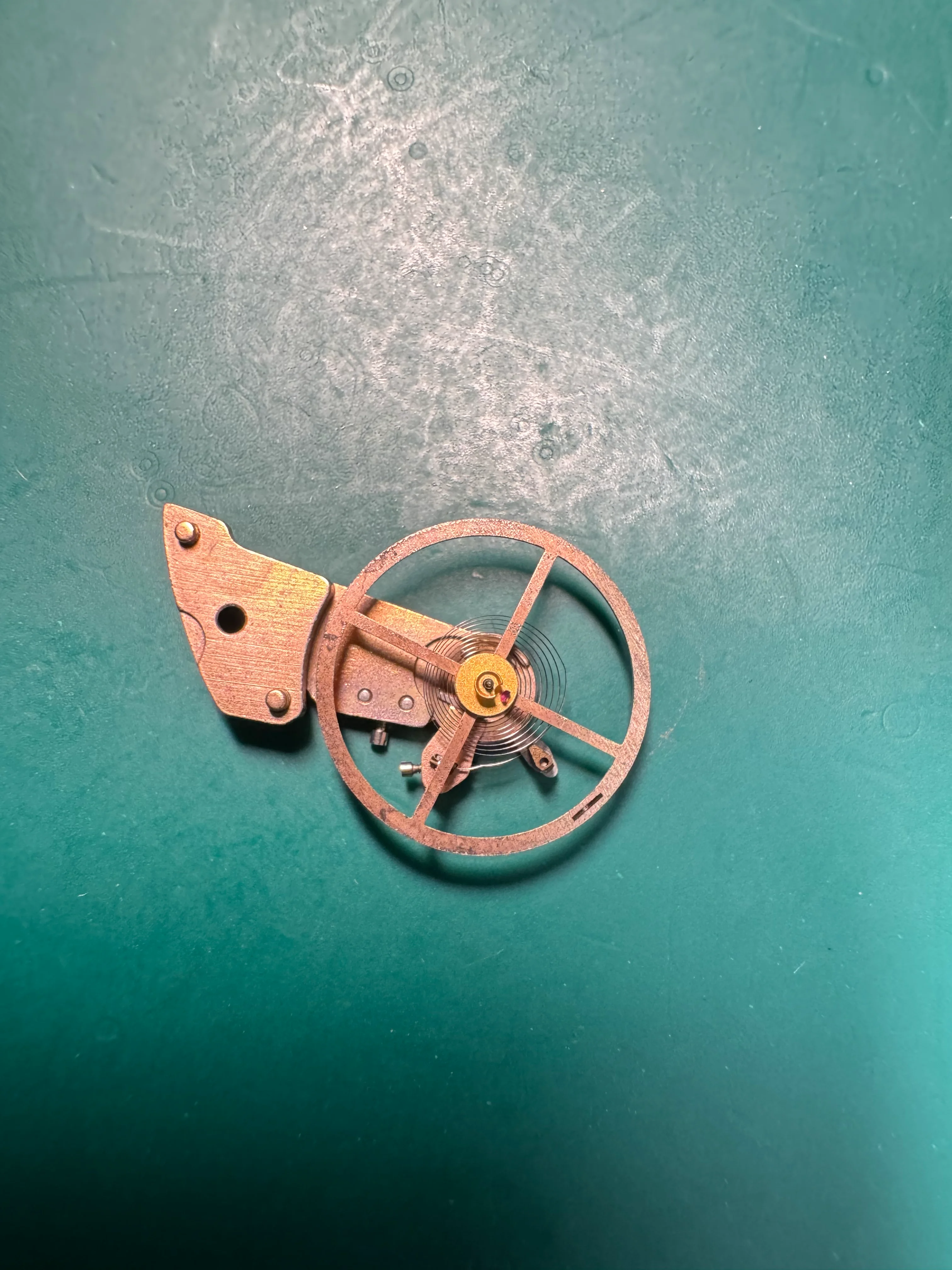

While trying to remove the balance for inspection, I may have slightly damaged it, as now the balance rings appear to sit with uneven clearance, and the balance does not have uniform endshake.
Given this, I have a few questions:
  • Is it realistic to try fixing this myself using only two tweezers without prior experience with such delicate assemblies?
  • Or would it be better to practice first on a cheap Chinese balance from AliExpress before attempting more delicate work on the Omega 565?

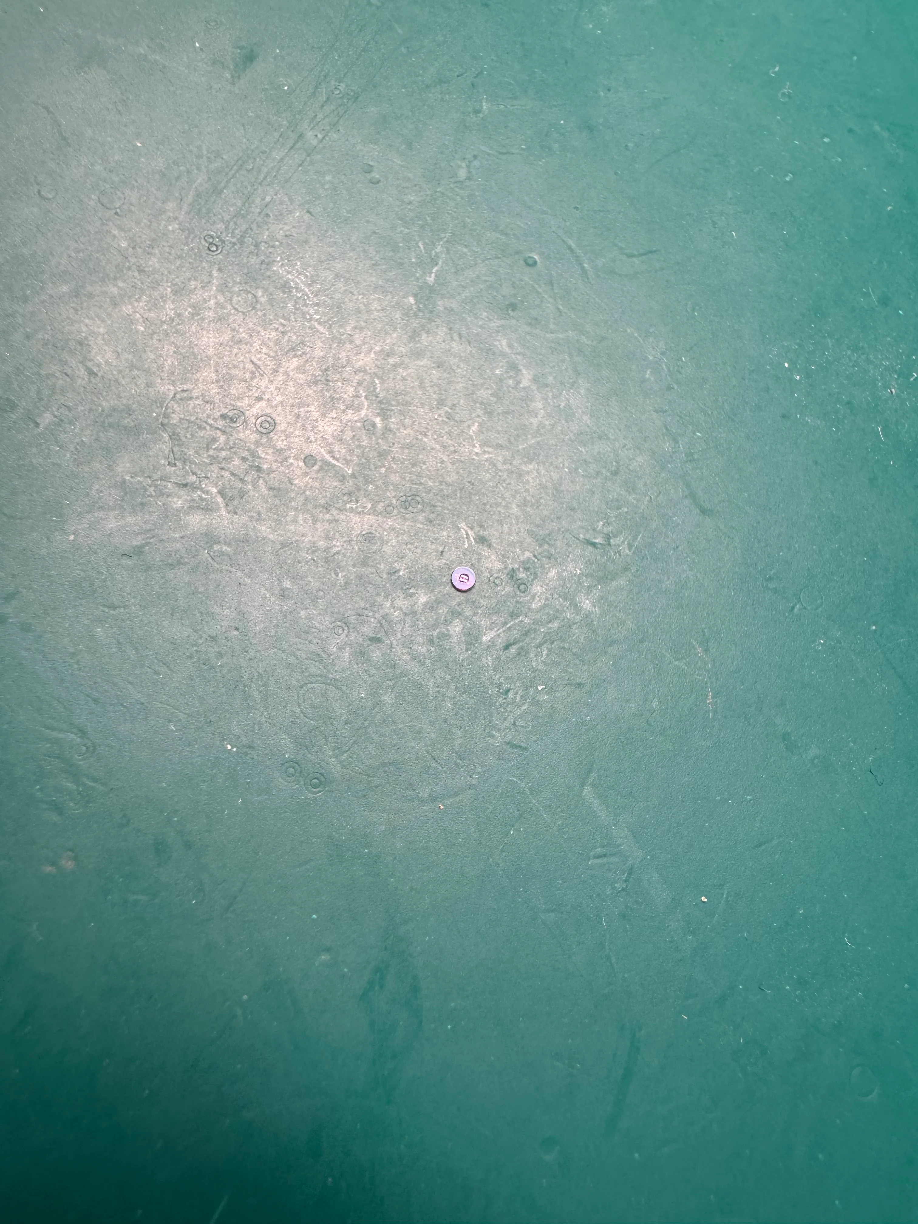

After that, I reinstalled the jewel into the plate and applied the correct amount of oil (see photos below). I would really appreciate your opinion - does it look correct?
I want to learn safely without risking further damage to the balance. Any advice, especially from those who have worked on the Omega 565, would be extremely helpful.
Thank you in advance!

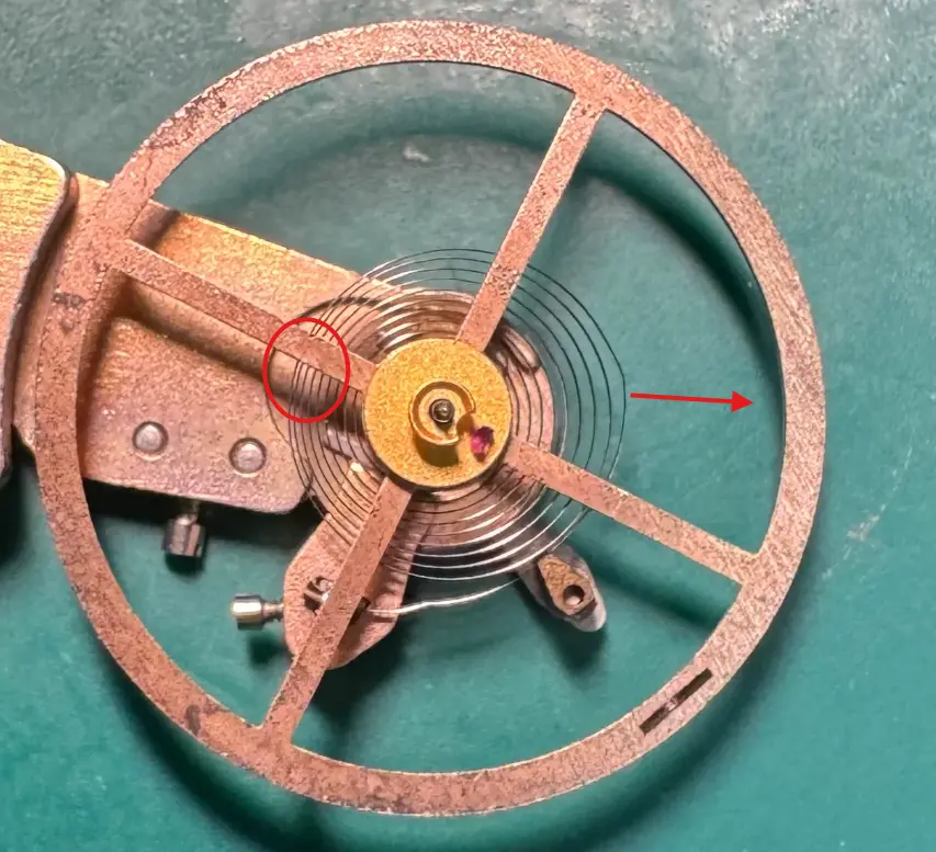

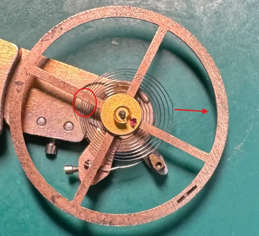

Are you sure you only damaged it later on? Because that would perfectly explain why it wouldn't run before.
Personally I think that your hairspring is not that far gone and can quite easily be fixed.
A soft outward bend where the arrow shows should already resolve a lot imo. Then you'll have to see what happends to the "narrow" area where the circle is drawn. Maybe the first bend will also resolve that.
That being said, practicing on a cheap movement or as sheepdoll mentioned: on a pocket watch - might be a good idea. Less is always more with hairsprings. Good luck.
