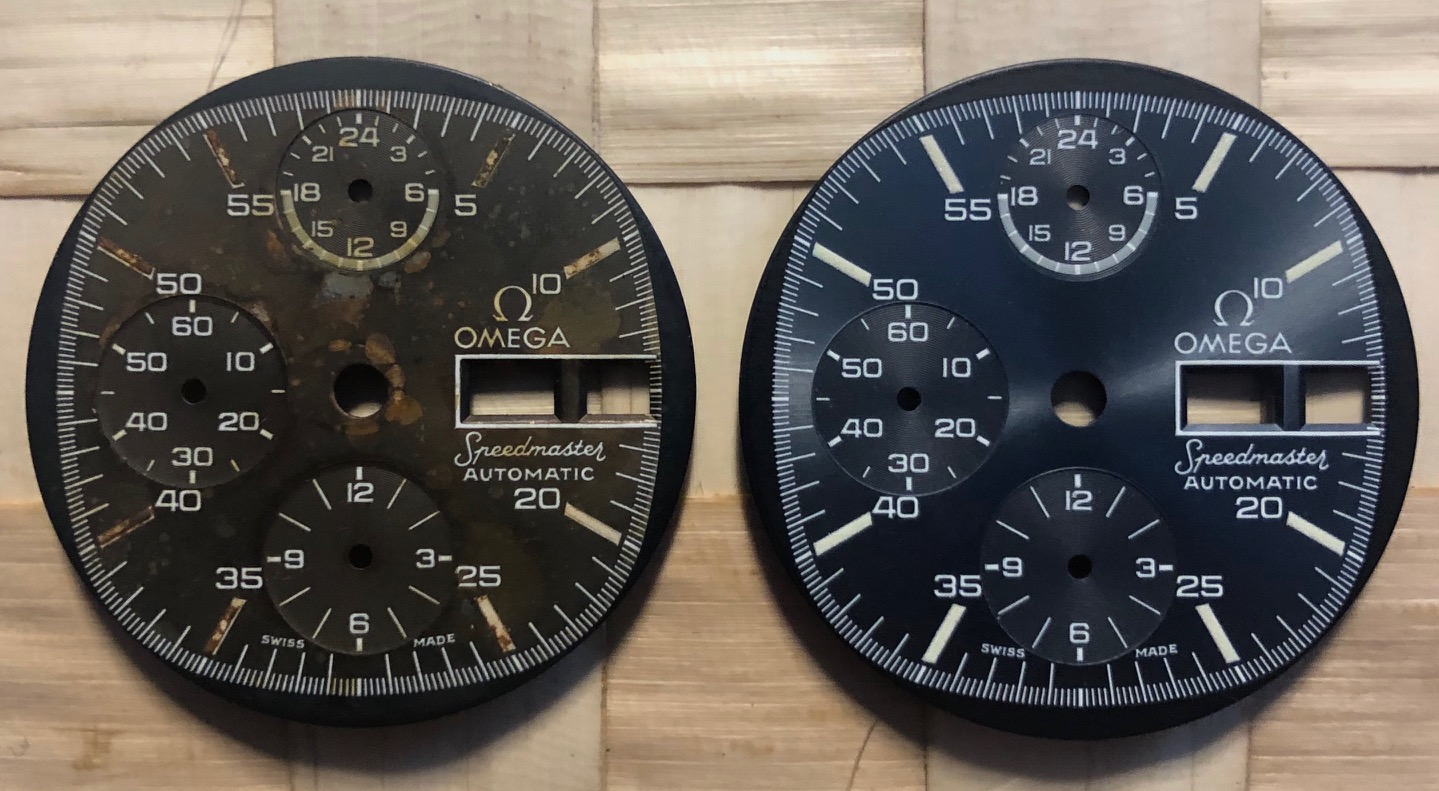

Yes, so I decided, as part of the game, to search them by myself.
I am an Orthopedic Surgeon and watches are just my hobby...

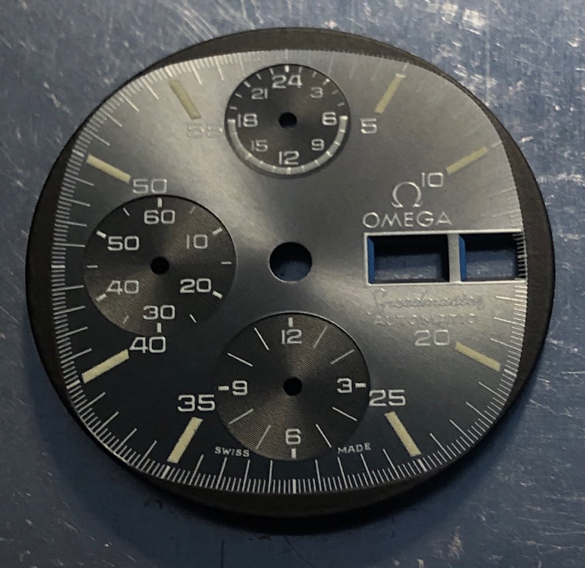

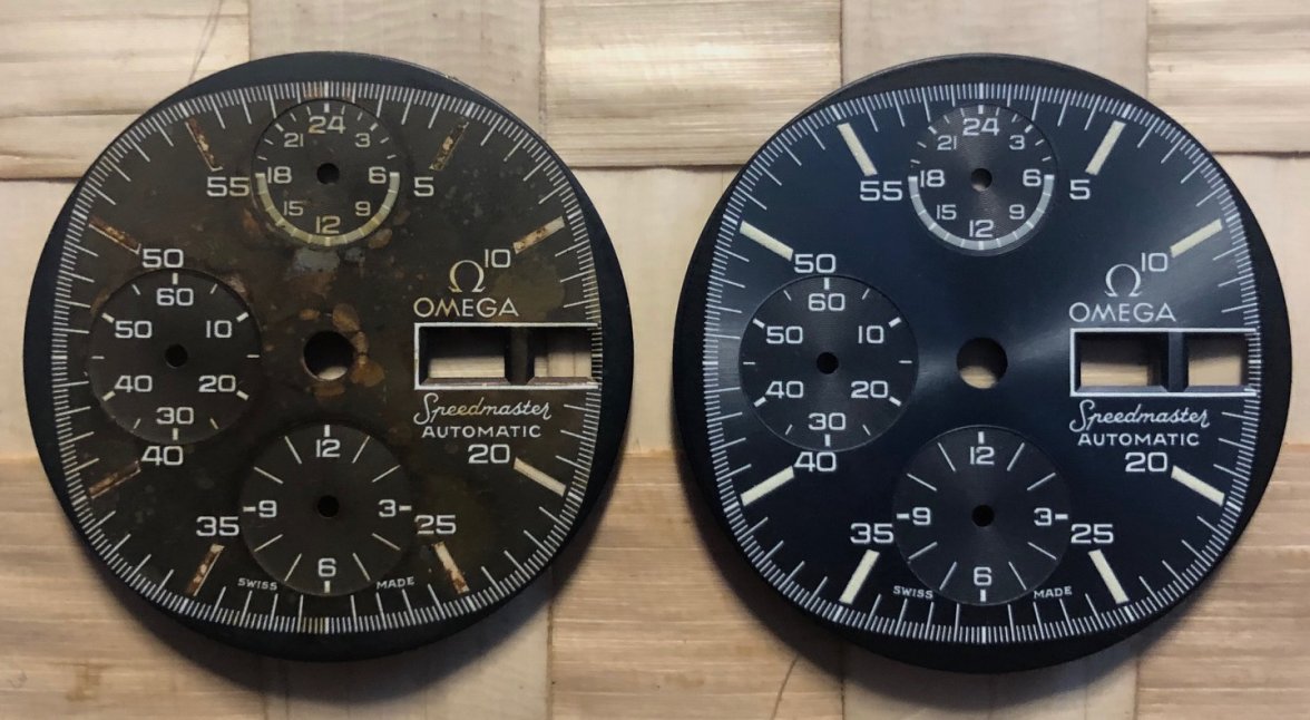

Full respect to you - it's looking really good. Is the dial a NOS or an aftermarket replacement?
362
597
The dial is NOS, I don' t think that there are aftermarket dials around for a TV Dial, but you never know.

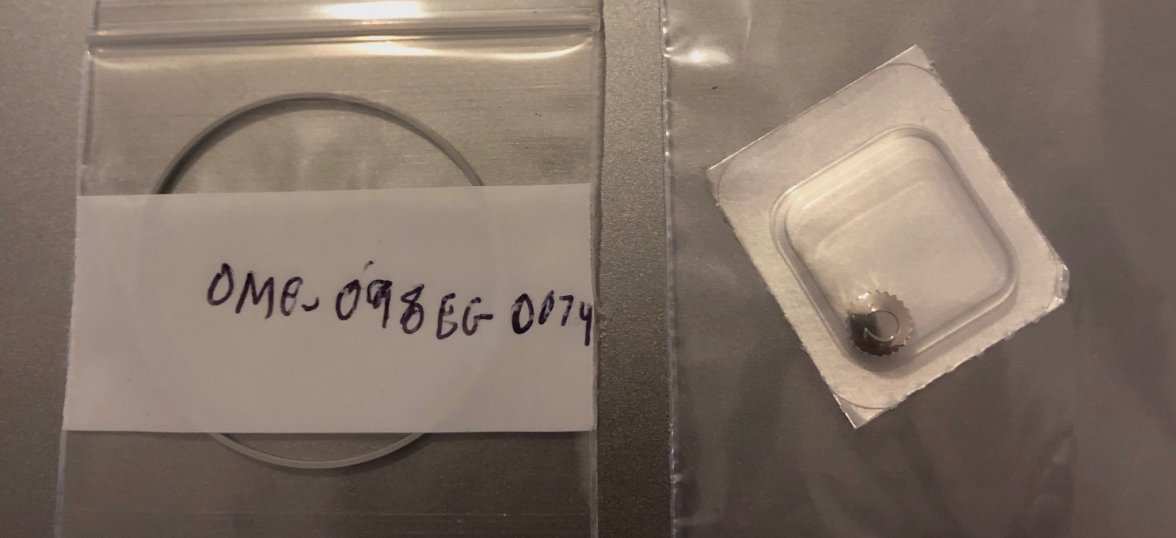

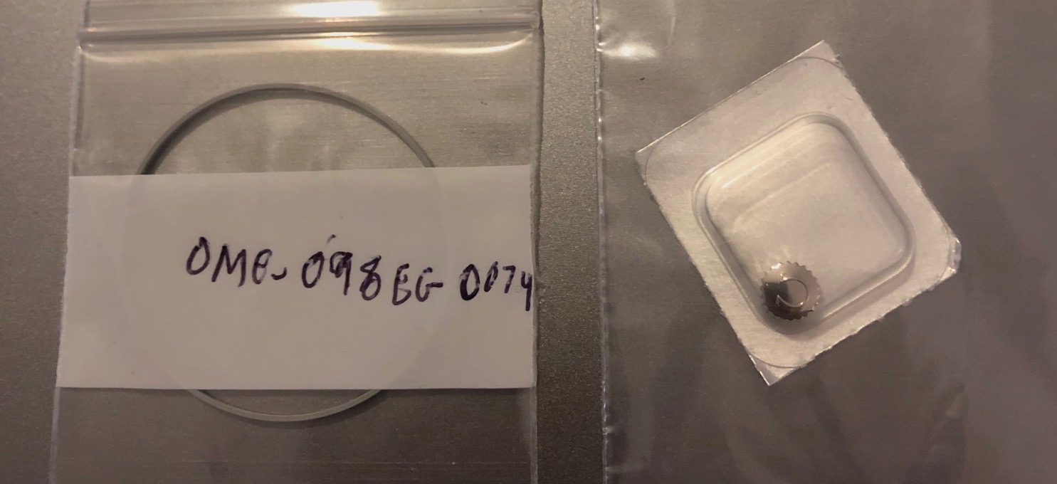

Bezel gasket and NOS crown
Based on the logo, it's likely just a new crown, so not NOS necessarily.
Flip it over and it will tell you week/year it was made on the label...
349
228
Is there a practical difference between new service crowns and period ones for this reference?
30,221
78,033
It depends what you mean by practical. As noted, the older crowns will have a different logo on them, but aside from that a newer crown is likely to have a seal that is in better condition than a truly NOS crown would...

i'm the same guy at the italian watch forum, who's finding the gasket, could you help me a bit more?
i do understand where to find it but i can't find it from what you've talked about it would be there
could you help me with link??
098EG0098 this one and 098EG0097 this one...

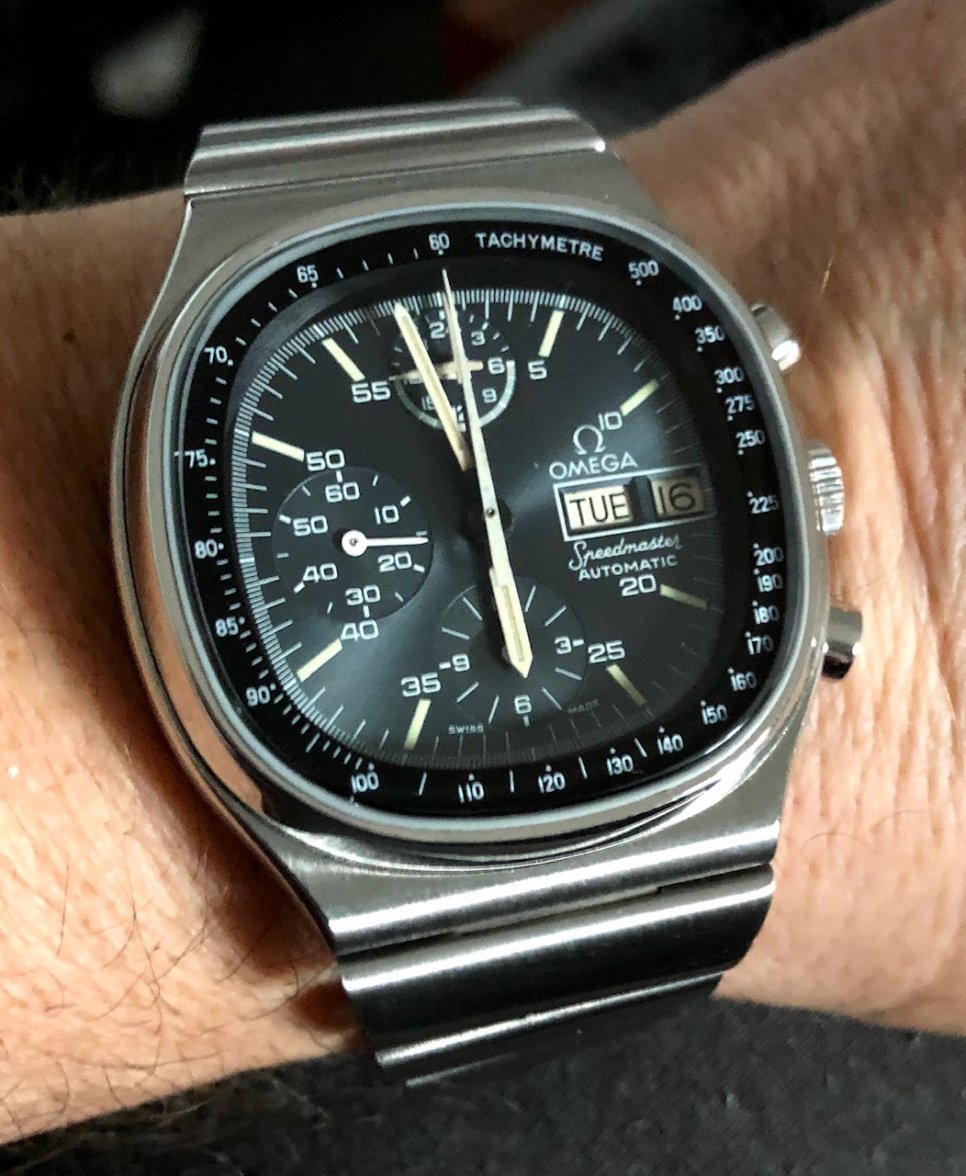

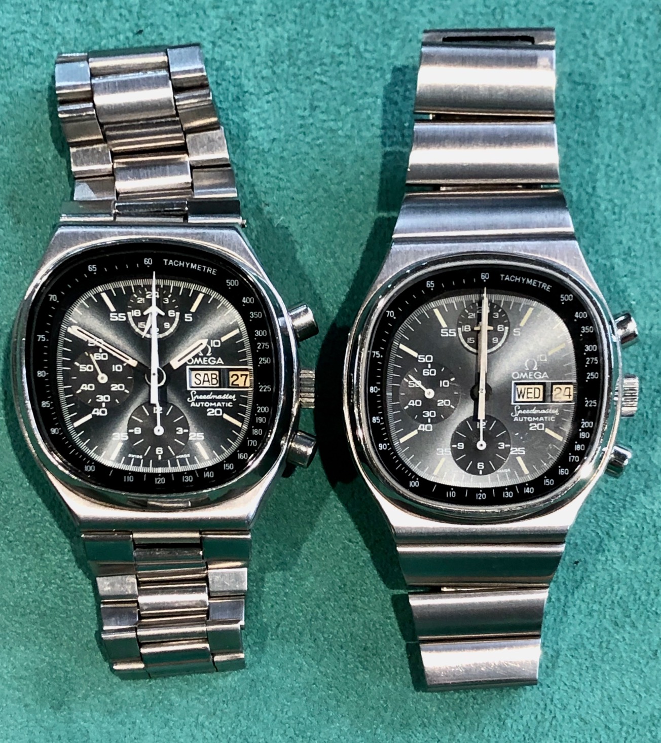

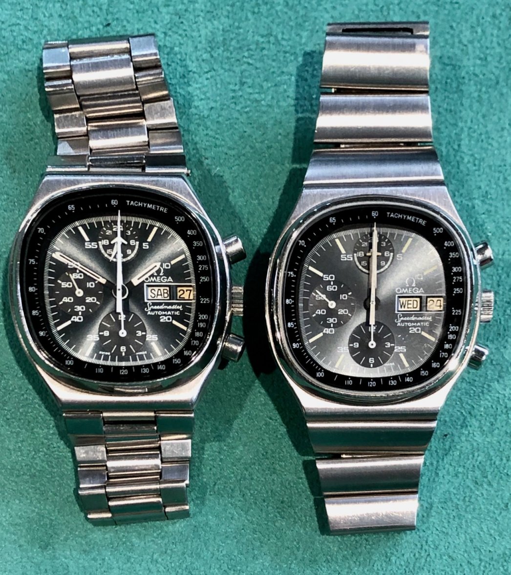

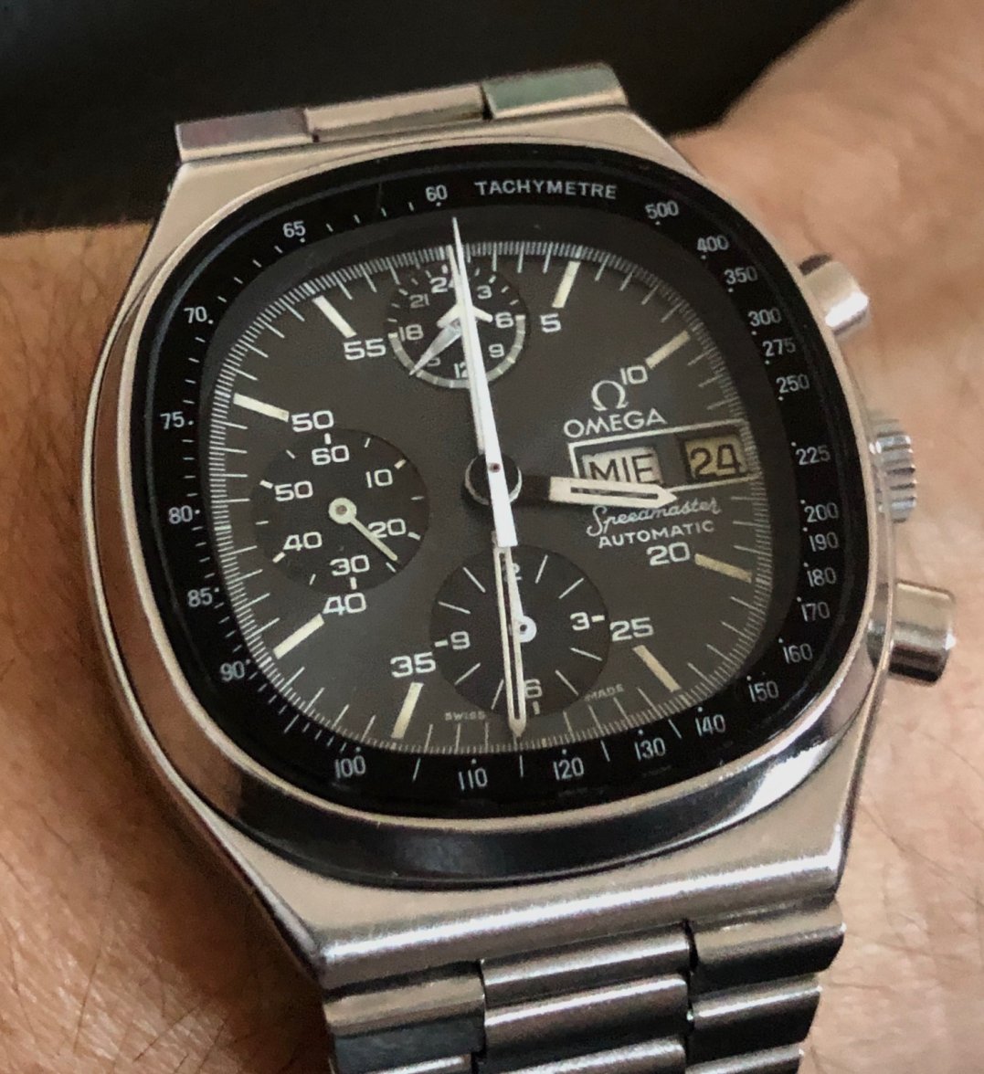

Finally finished and perfectly working!
It took a little bit longer than presumed because of the Covid-19 pandemic
9,311
77,704

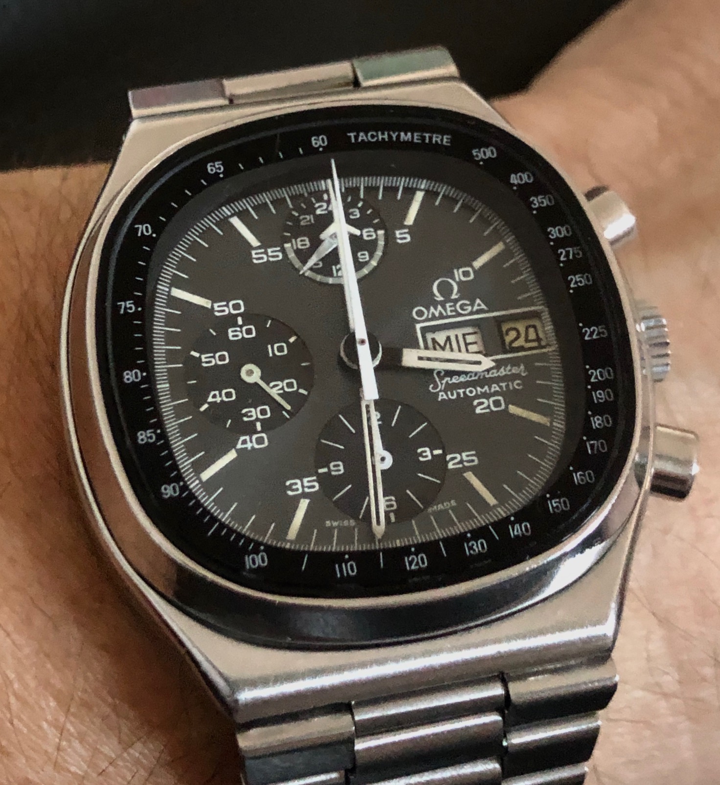

What a job. It looks great!
16,305
45,025
These TV Omega’s get little love but they are cool as hell- totally a tribute to the design risks Omega was taking at the time....unlike some other companies that just keep cranking out the Oyster.

Looks good. Out of interest, what original parts were retained?
