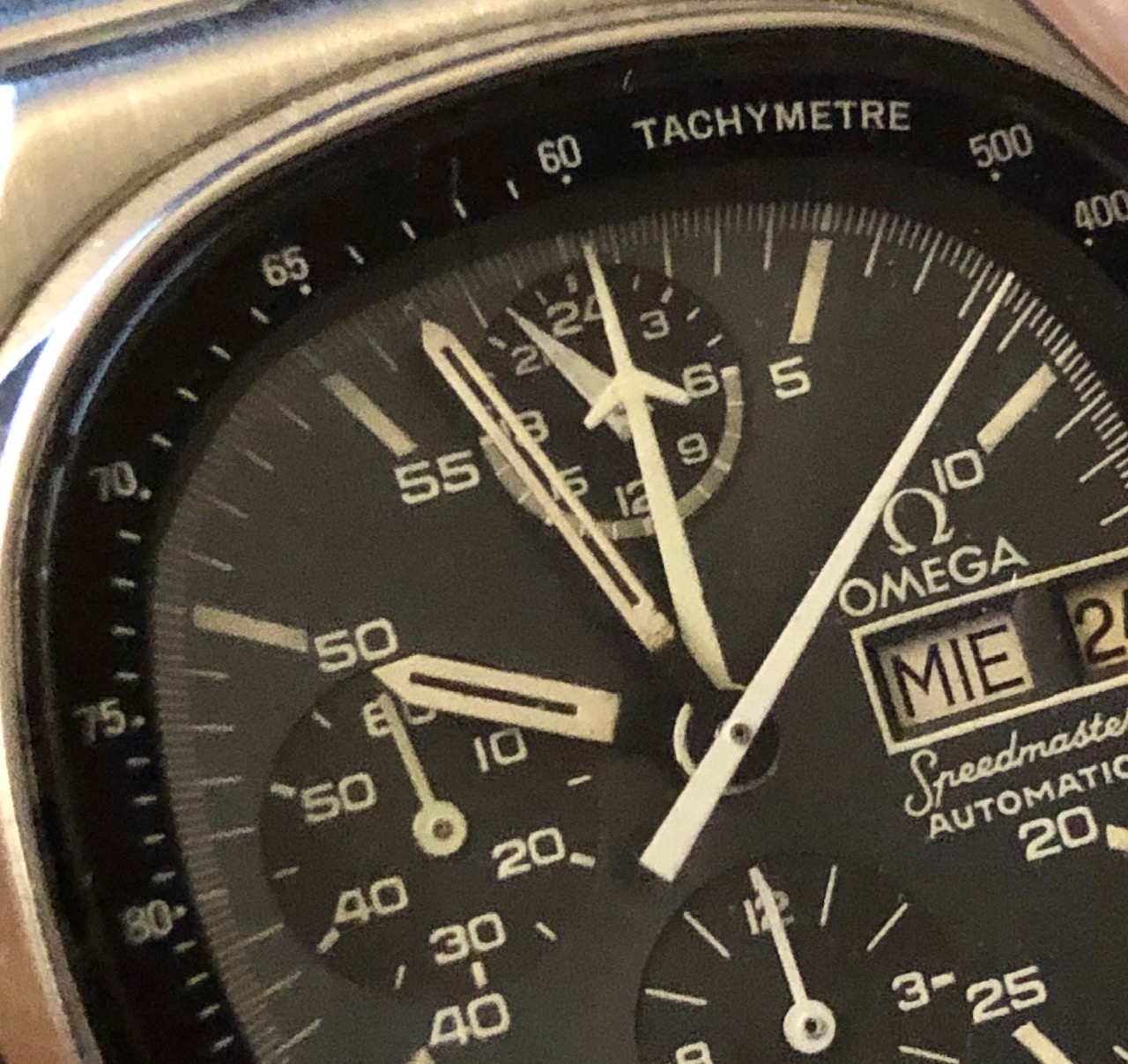

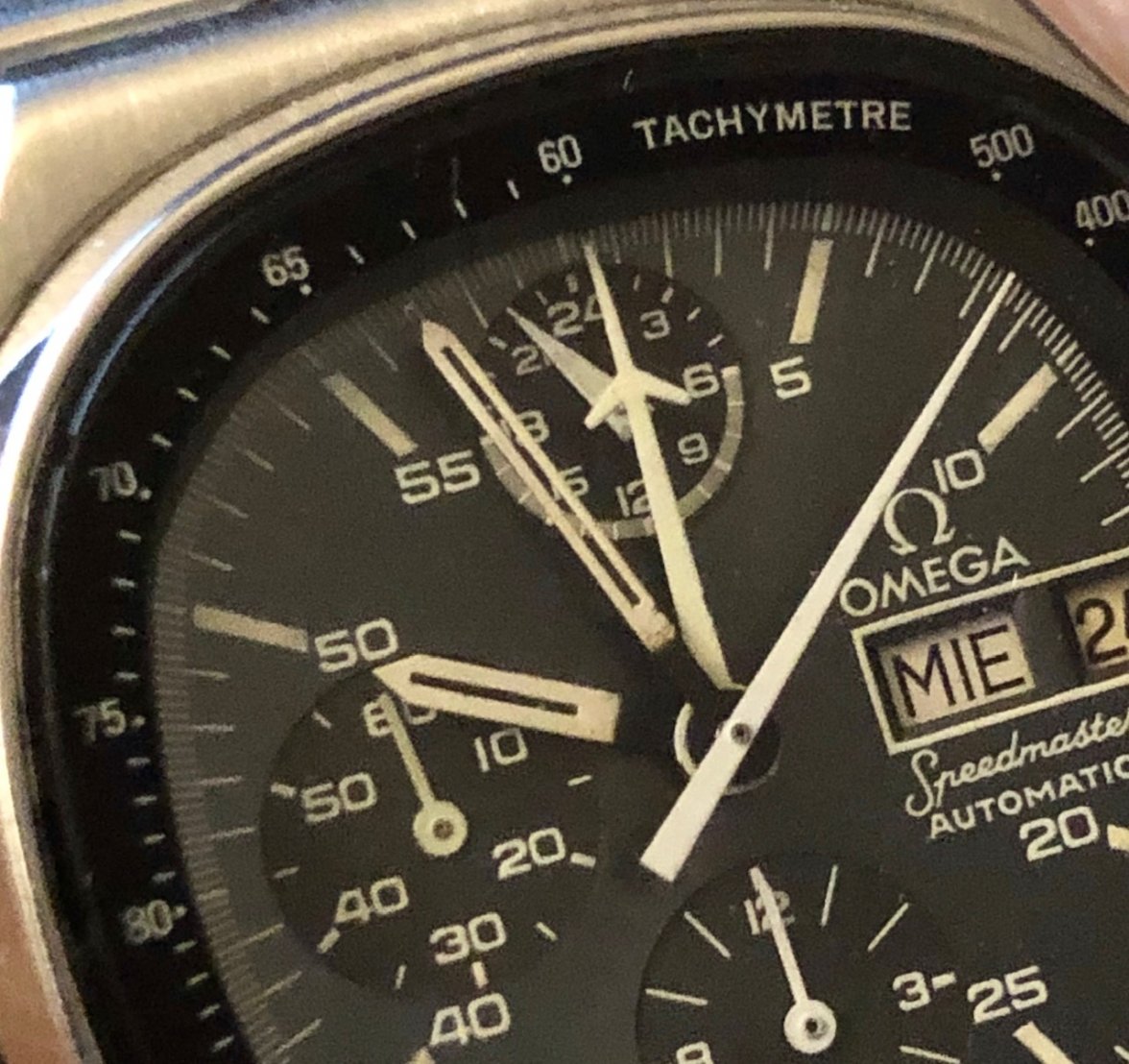

There seems to be an issue with the minute counter hand of the Mexican brother:

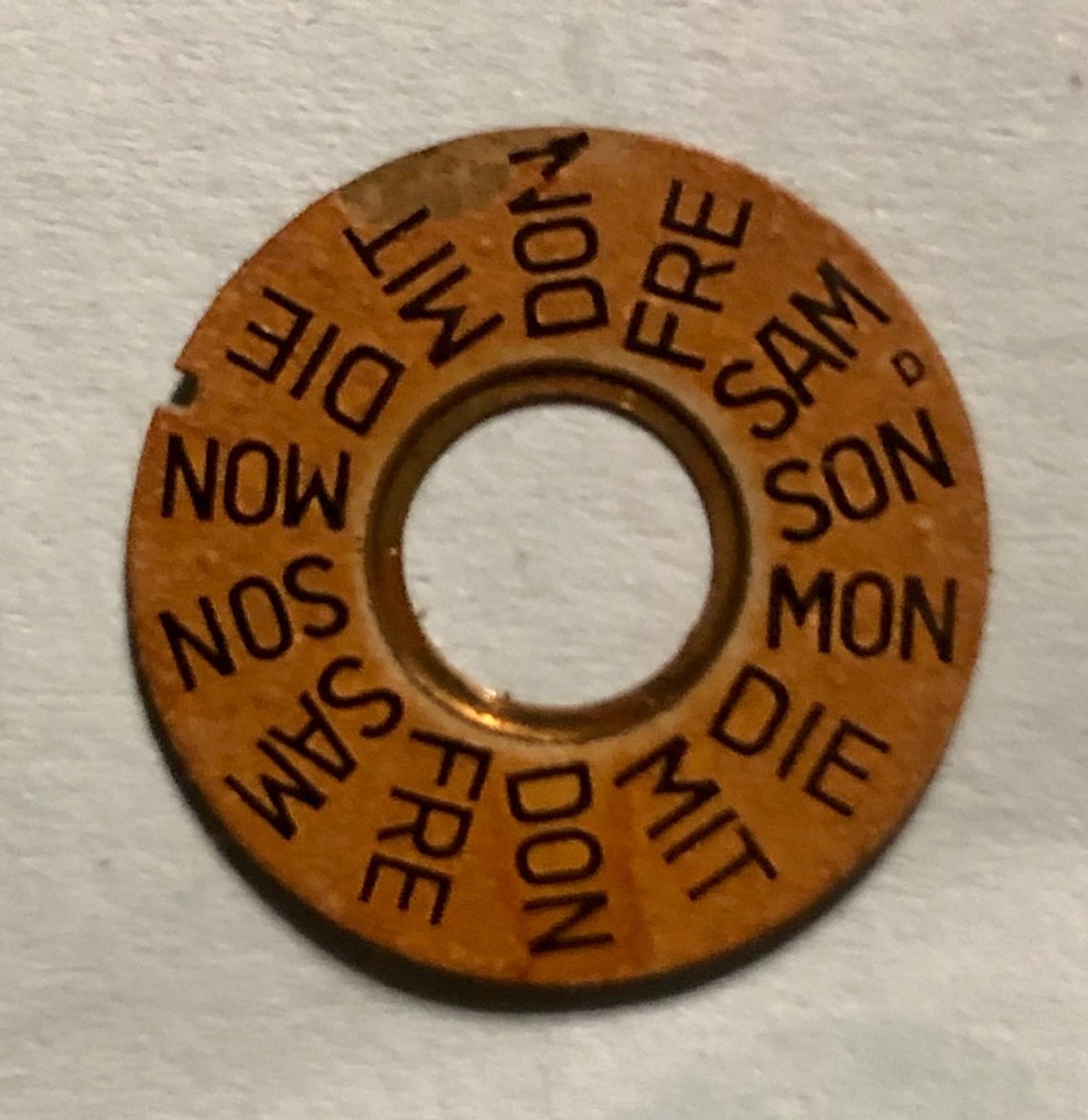

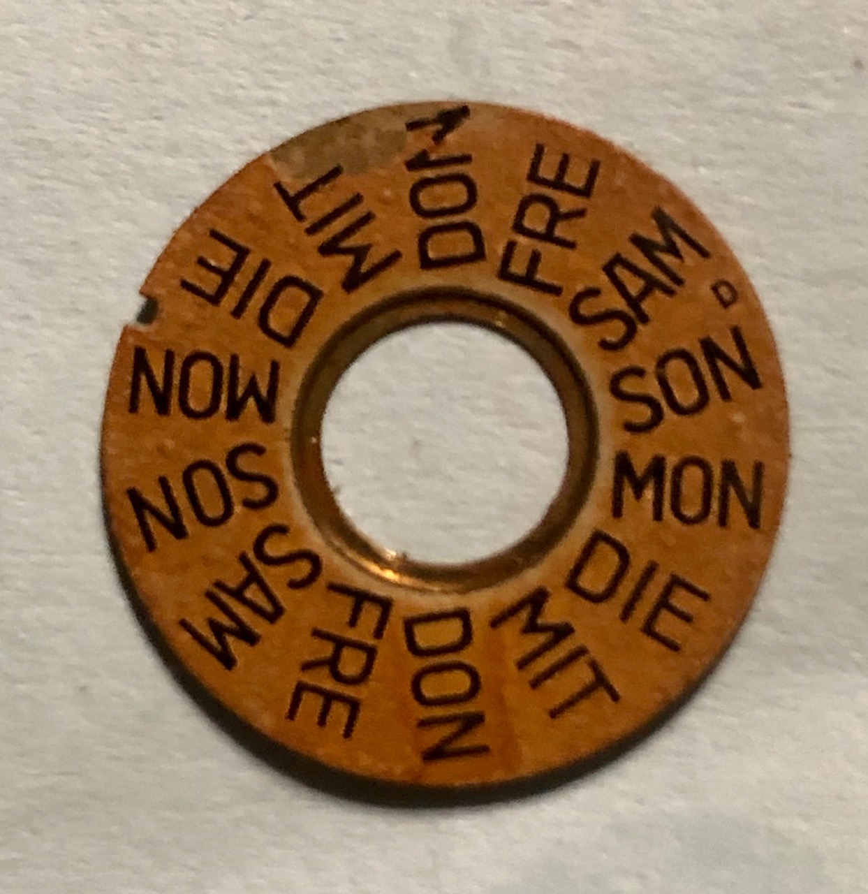

And the date wheel on the restored watch should be the rarer German version:
This is the original watch's date wheel:
By the way my watchmaker is already installing a nos German one...

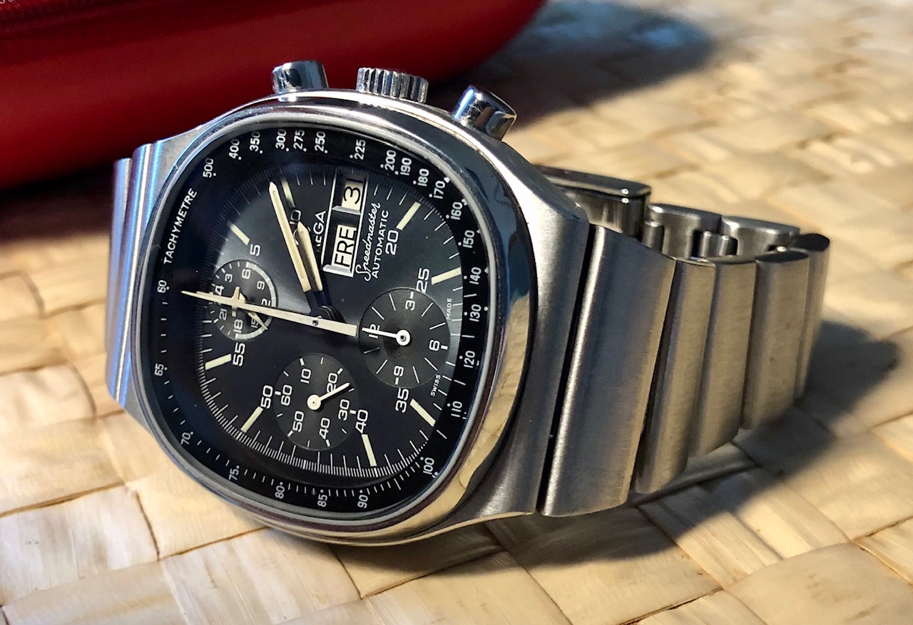

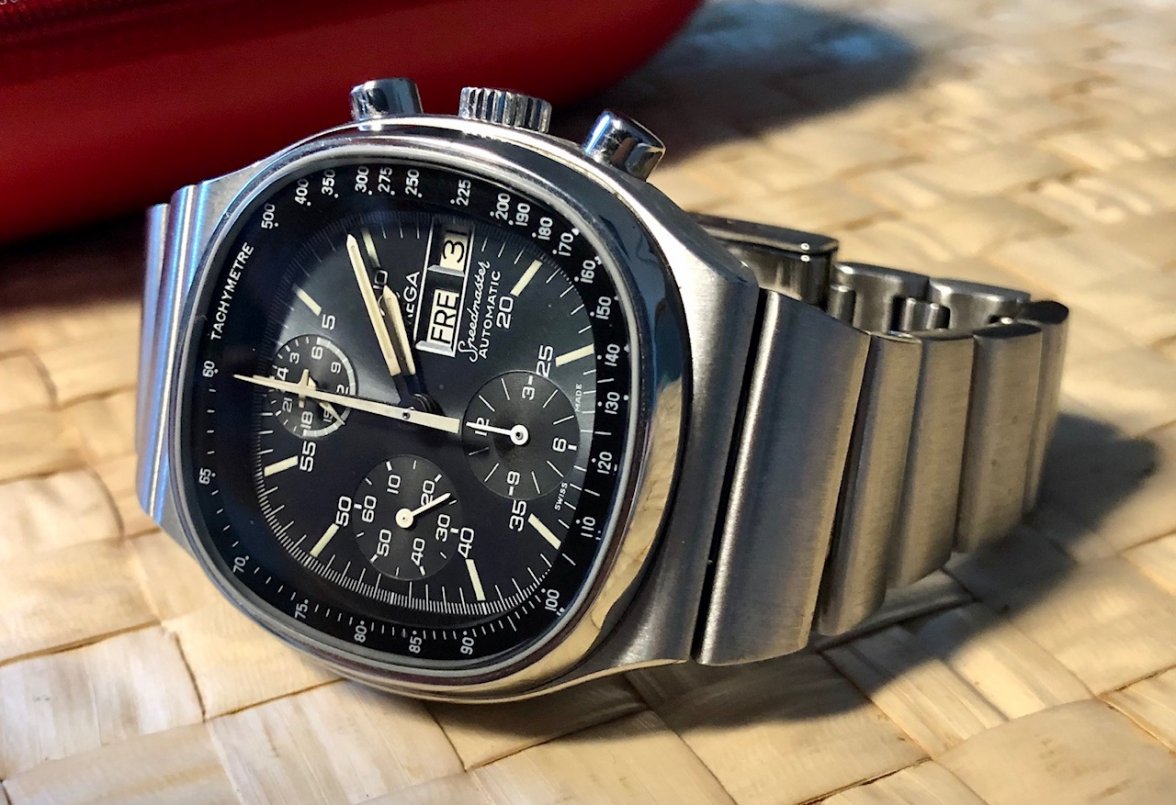

The final result after switching to the right German date wheel.
Mission accomplished!
