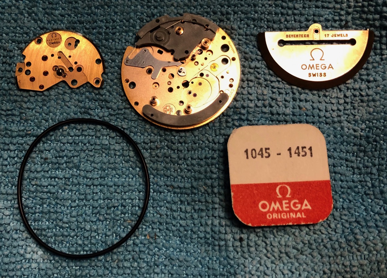

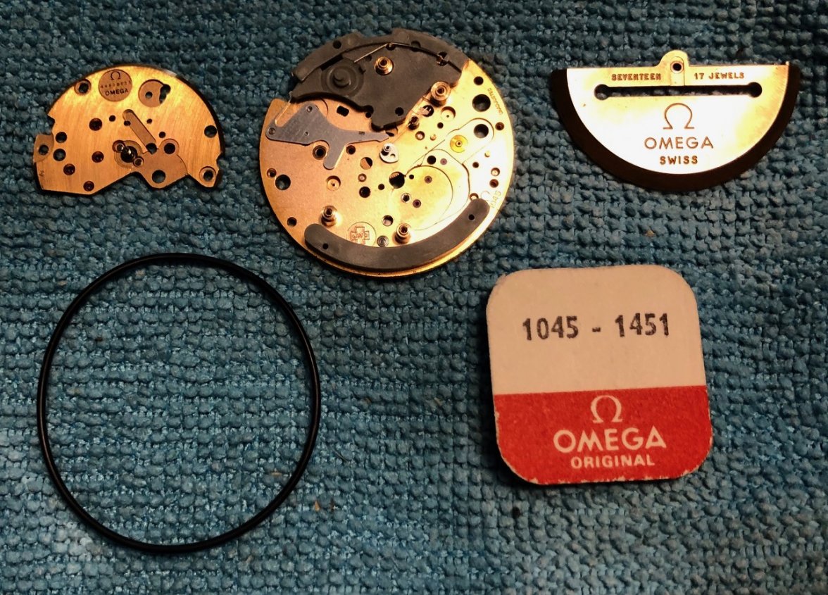

Some more parts that I will probably need to be replaced arrived today:
Just missing the crown and the seal that goes under the bezel and the restoration finally will begin.

I dismantled and cleaned the watch and tried to gather all ruined parts.
By the way it seems that some parts are not longer available from Omega.

This was my amusement!
Sounds like a treasure hunt. I can see the that being a fun challenge....except when it gets frustrating.

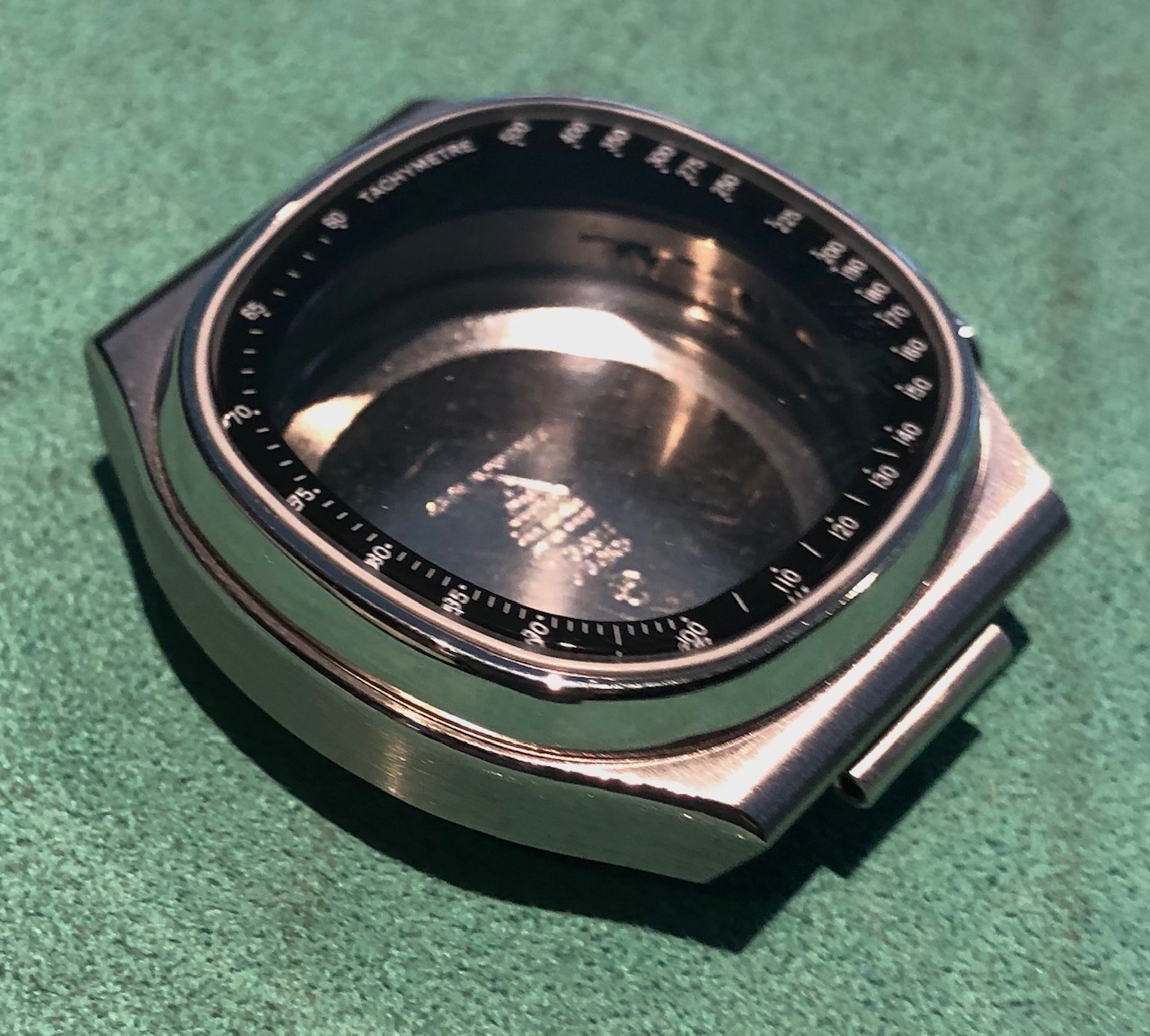

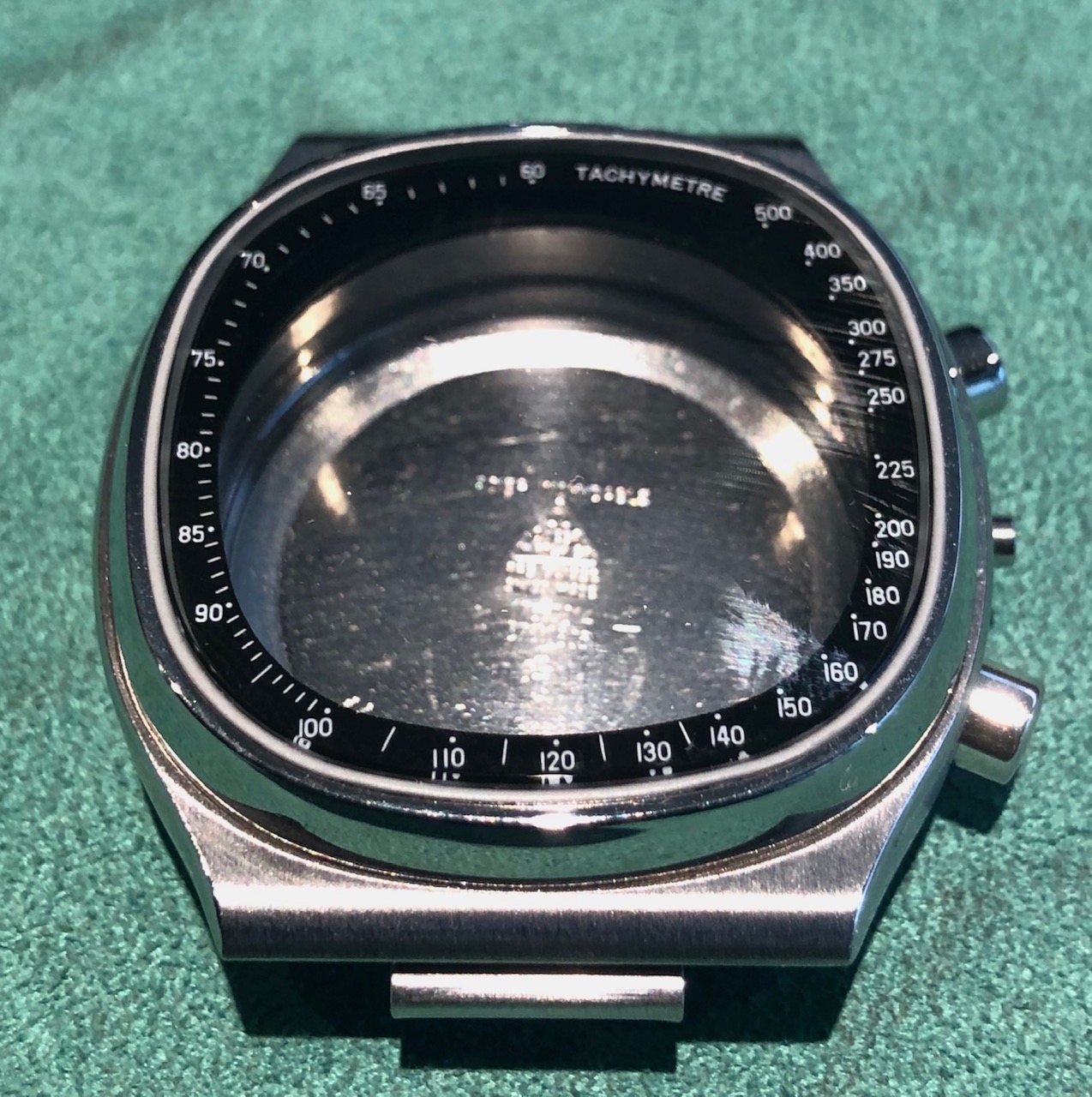

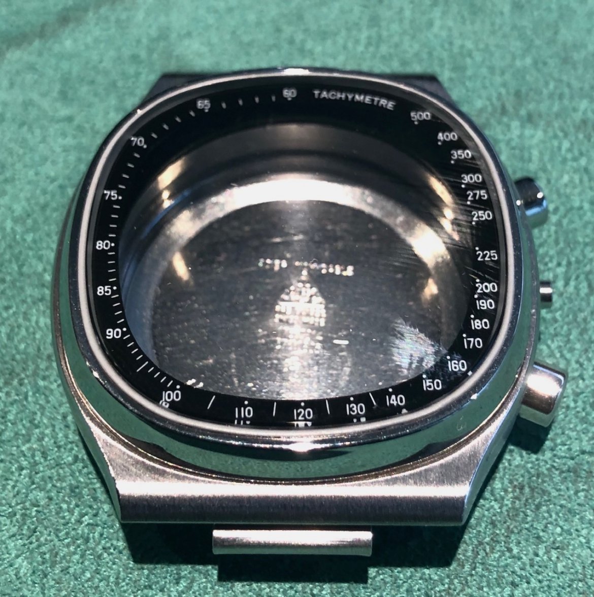

I found a big surprise today when I brought the movement parts to my watchmaker/restorer:

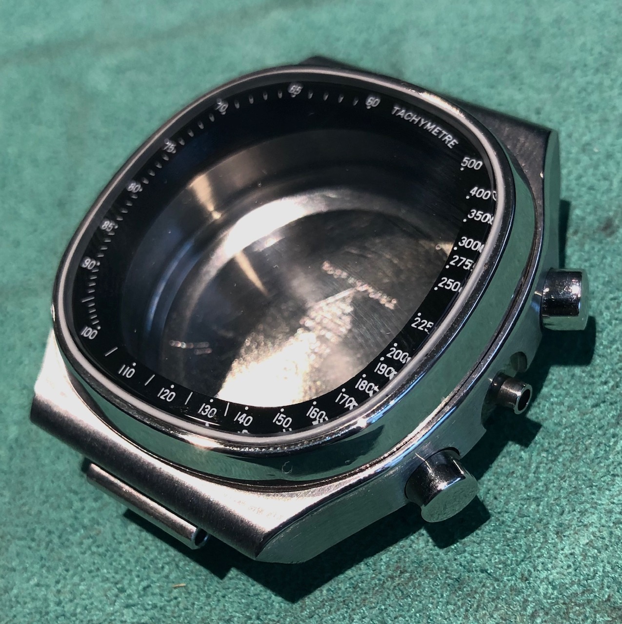

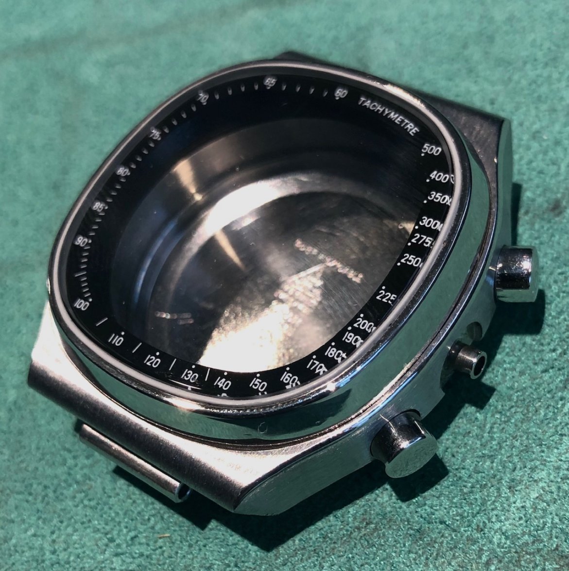

Is that the same case, or another one? If he just partially assembled the parts you gave him, did he/you find a replacement bezel gasket?
362
597
It is the same case.
The gaskets and the crystal are oem new.
Indeed it was a little difficult to find them.
349
228

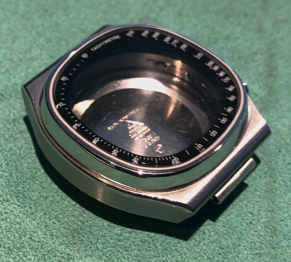

looks good so far.
I'm now curious what original parts will be retained? It looks like very few original movement pieces will remain?

Certainly looks better than page 1..
Now..
362
597
We will try to save as much original movement parts as possible, but with no compromises regarding the function of the watch.
It will be a complete overhaul, anyway.
