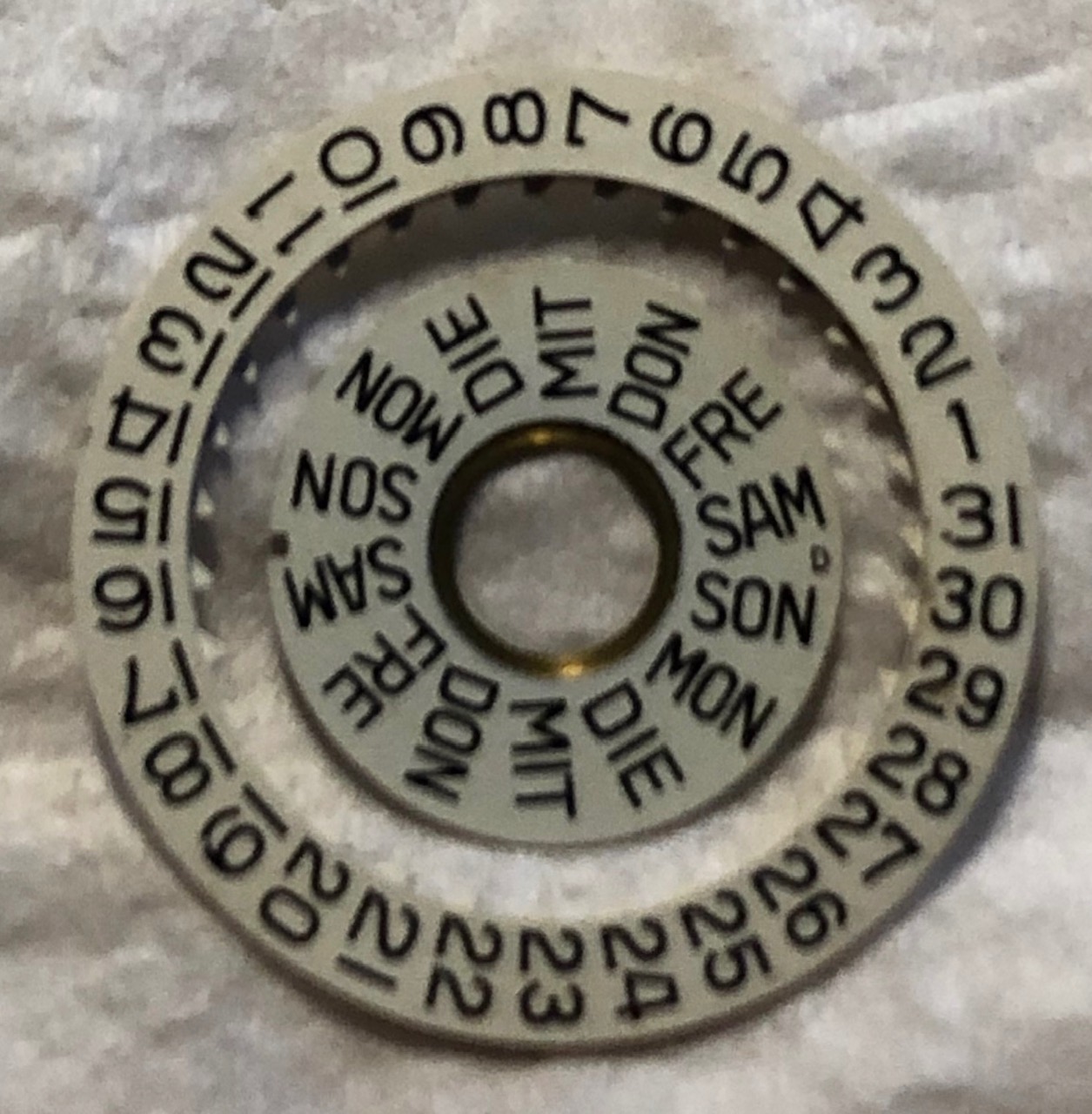

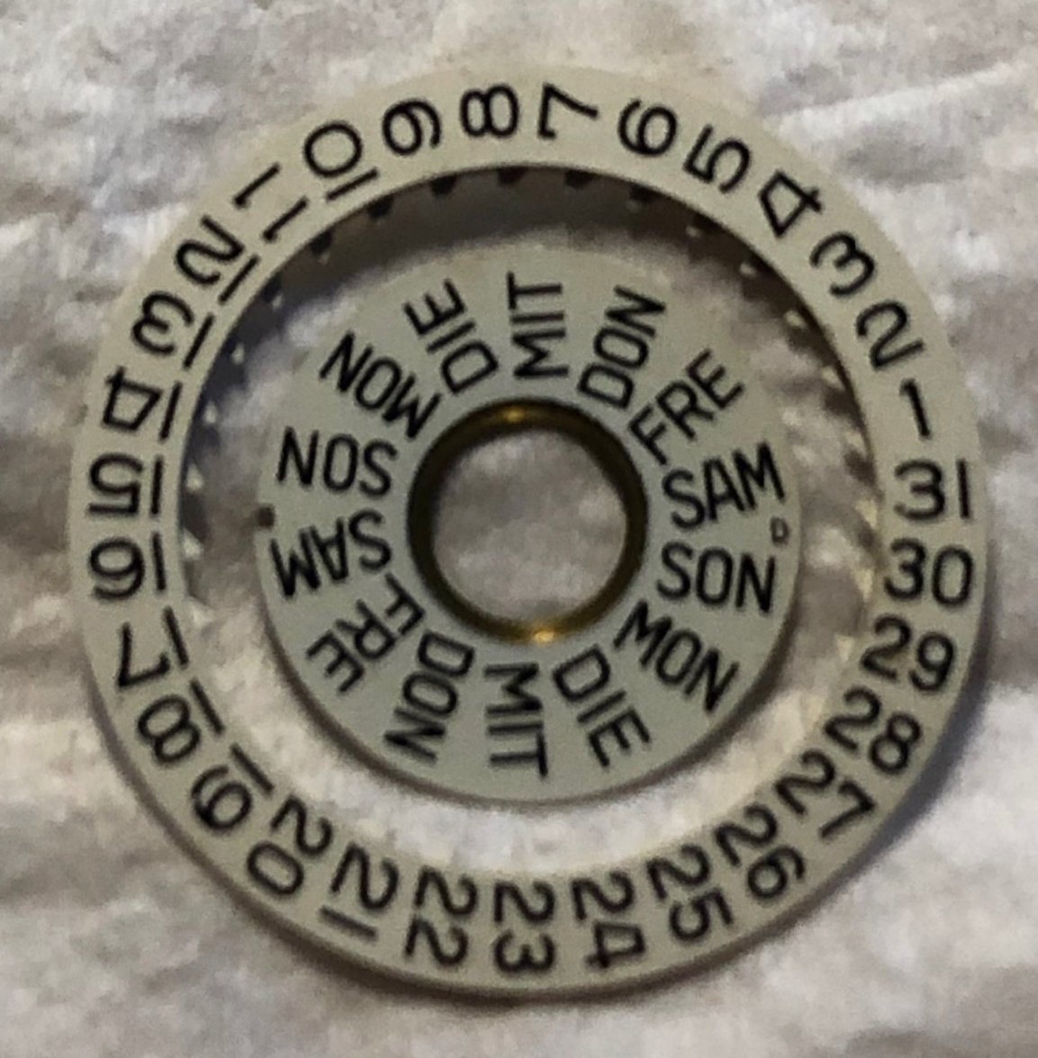

Sometimes you have to be lucky too:
Found a German Date Disc at home: A remain of a Ref. 376.0822 Holy Grail restoration.

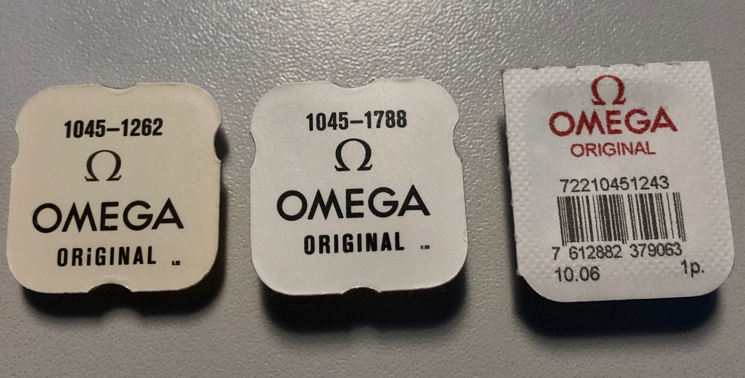

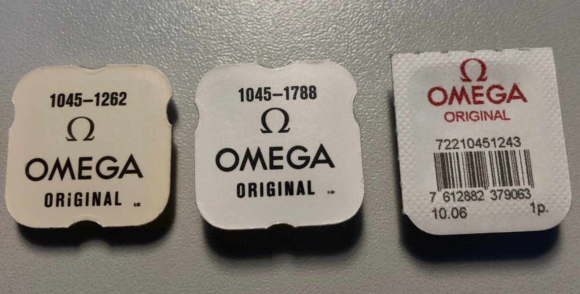

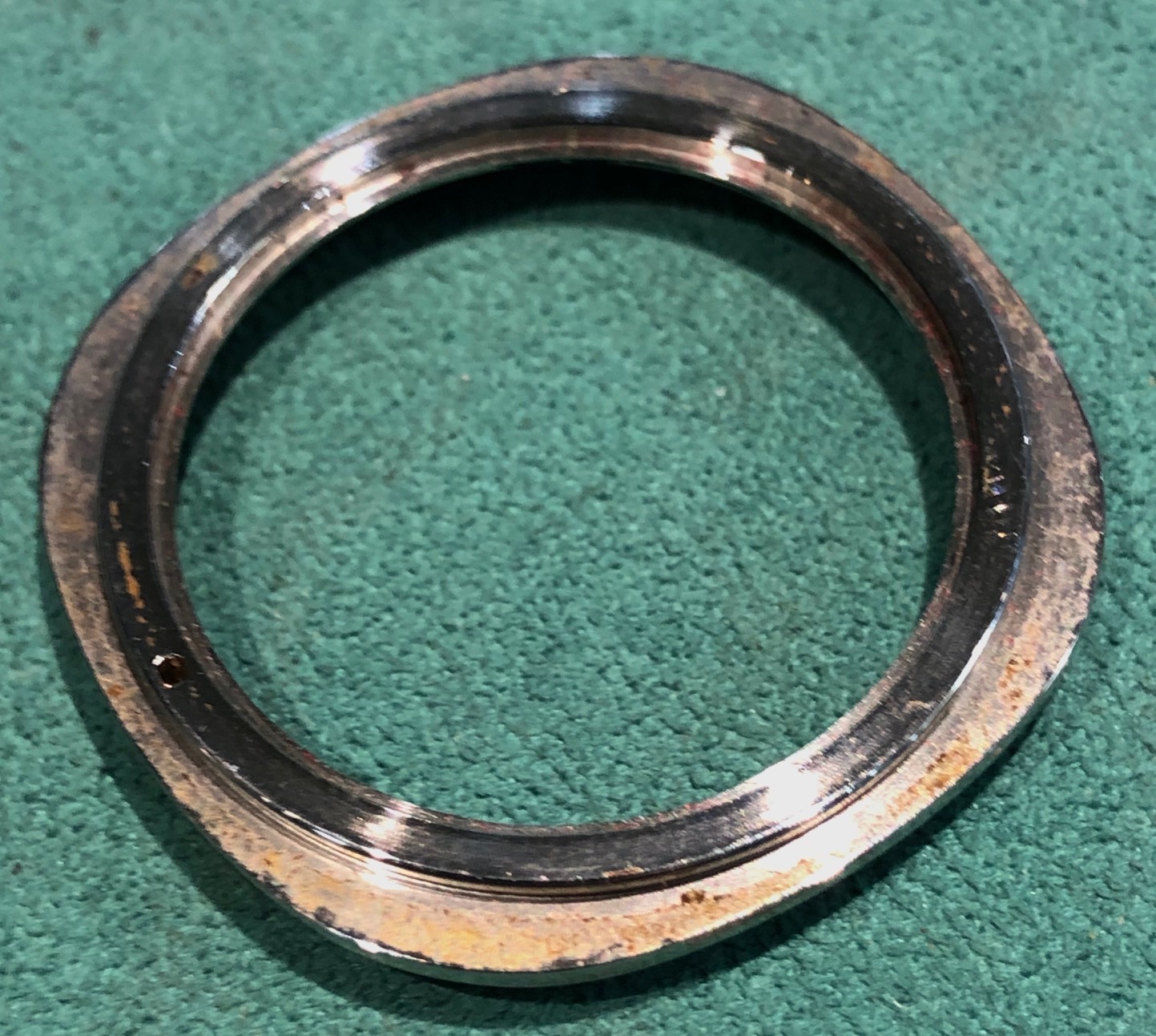

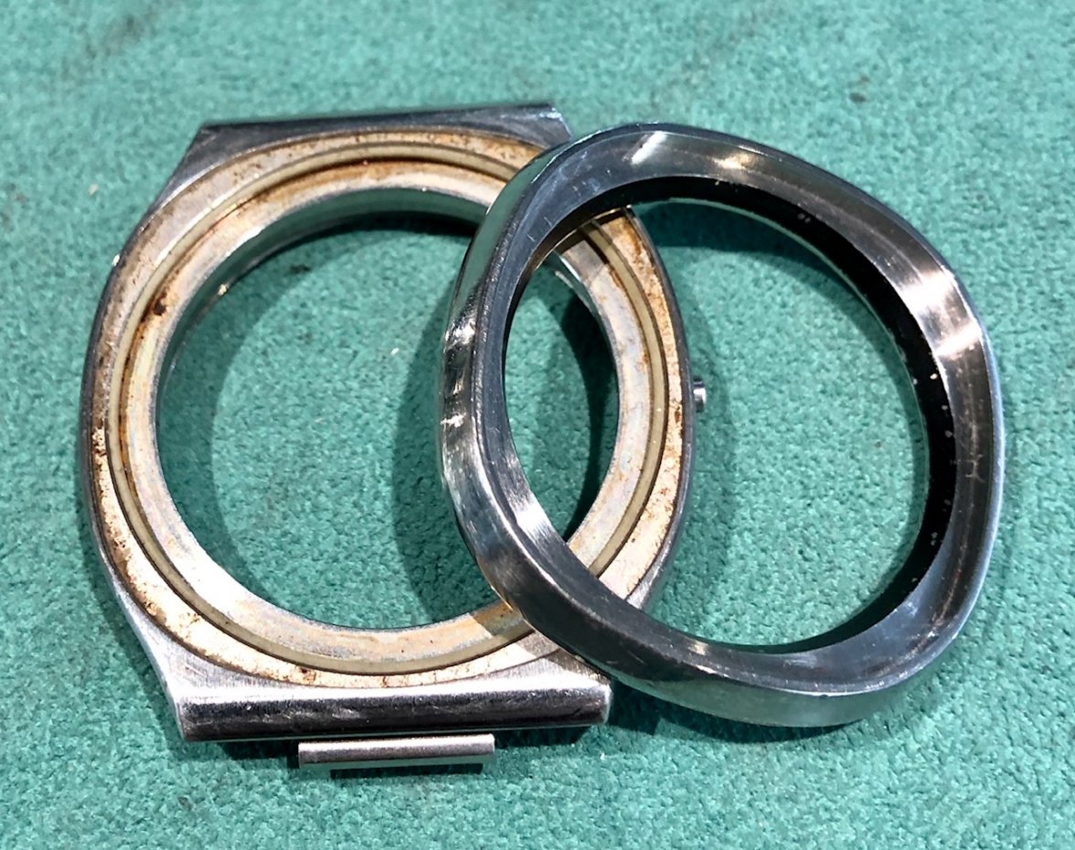

Slowly and gently, from all over the world, the few spare parts needed for the restoration project are arriving.

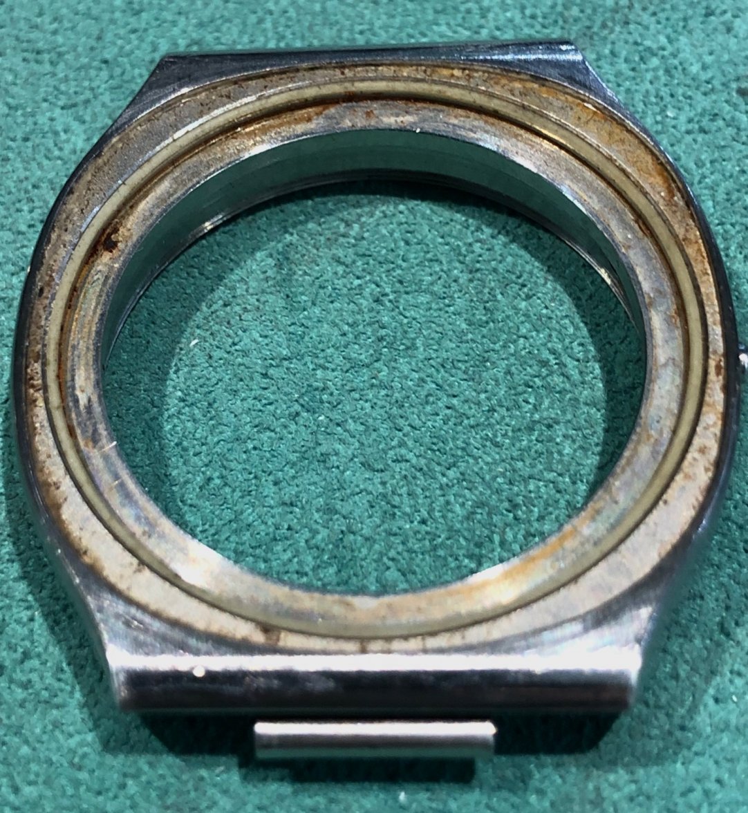

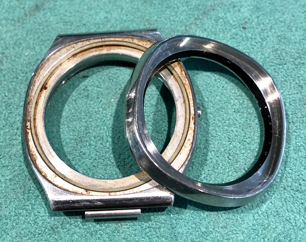

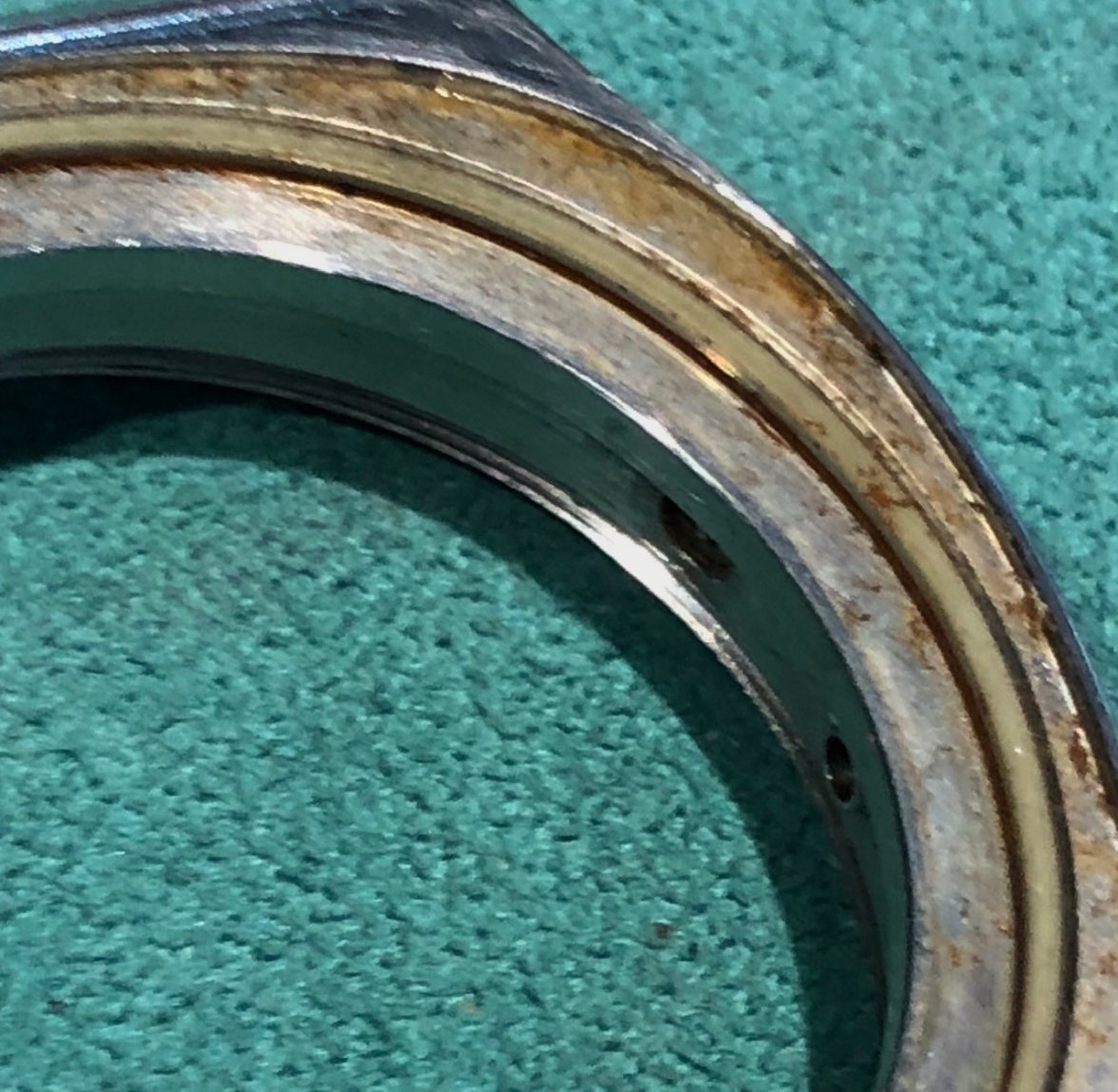

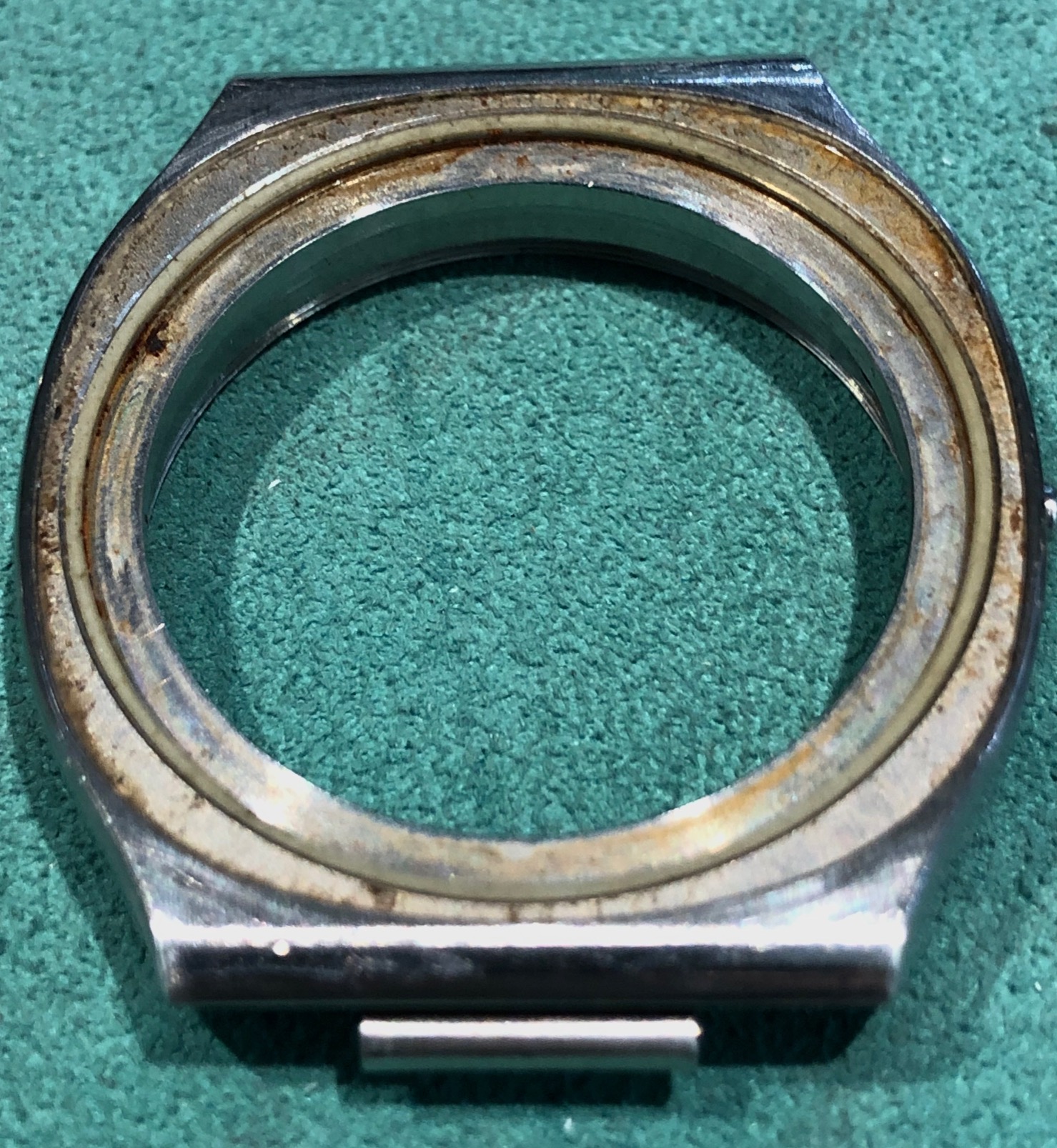

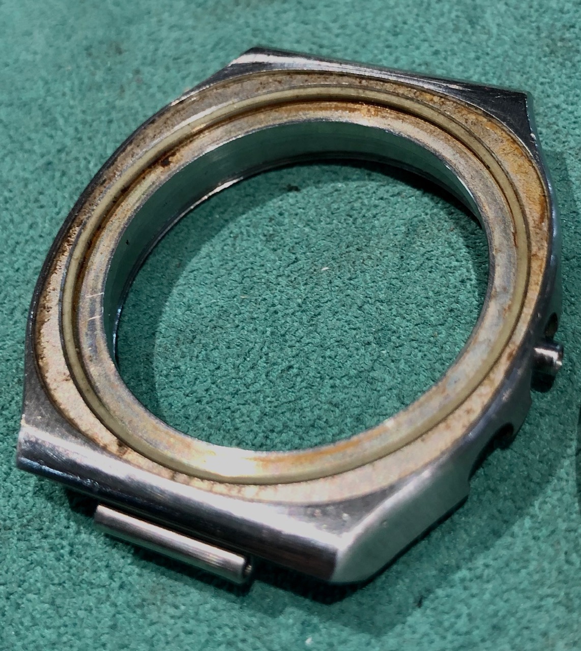

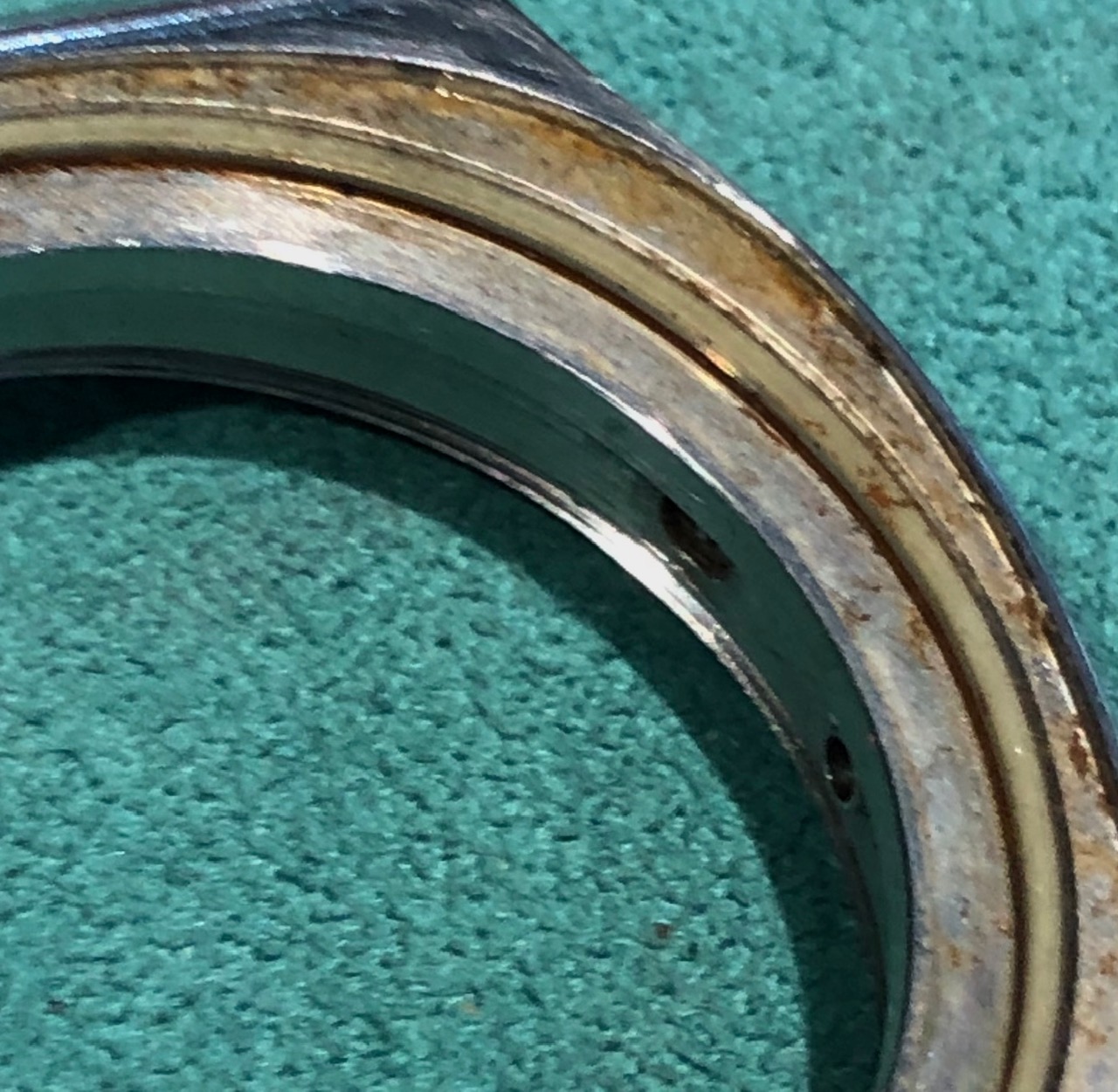

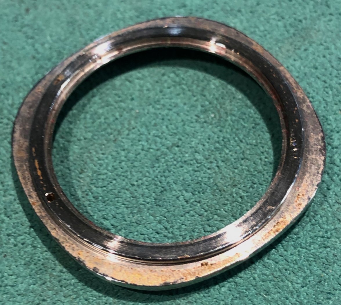

Here another surprise after talking away the watch's bezel.
The problem is that the gasket is not longer available on the free market and probably
it is only obtainable thru Omega (ref. 098EG0074)
Does anyone know where to find a gasket likes this?
30,221
78,032

Cousin's doesn't have it, on eBay I didn't t find anything.
My watch maker, who runs an official Omega Service Center will try to get one.

Yes, unfortunately it is true. The Swatch Group apparently decided 2015 to stop the sale of original parts to independent watch makers.
By the way, I found the missing gasket that I was looking for: 098EG0074 (Ofrei)
