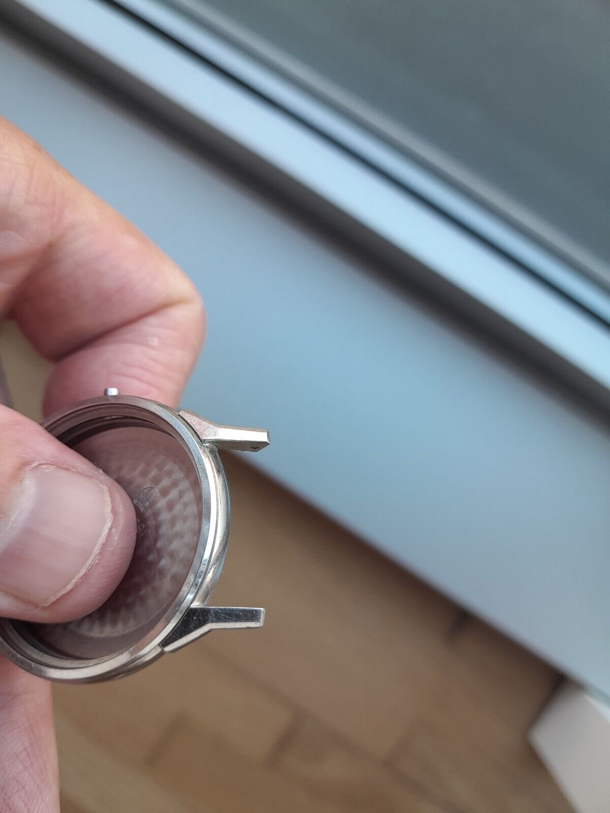

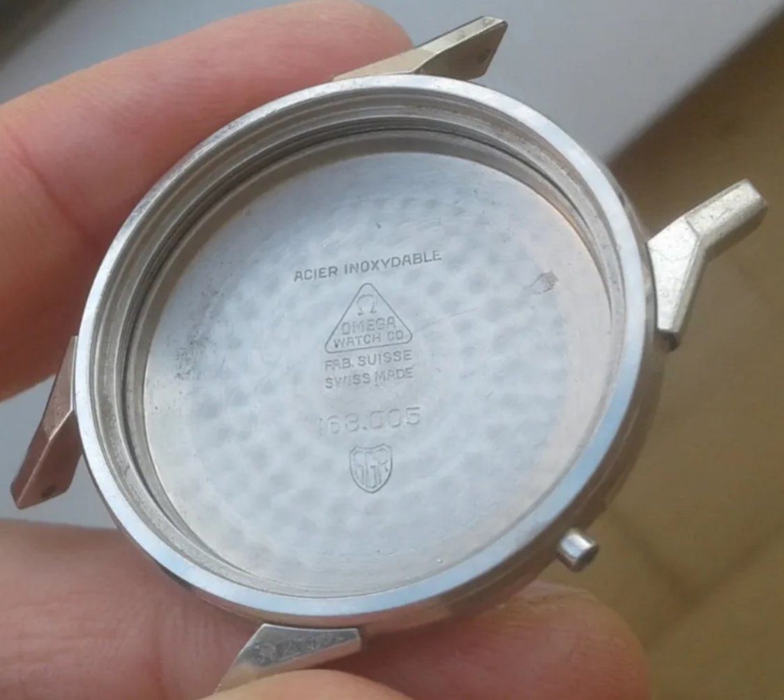

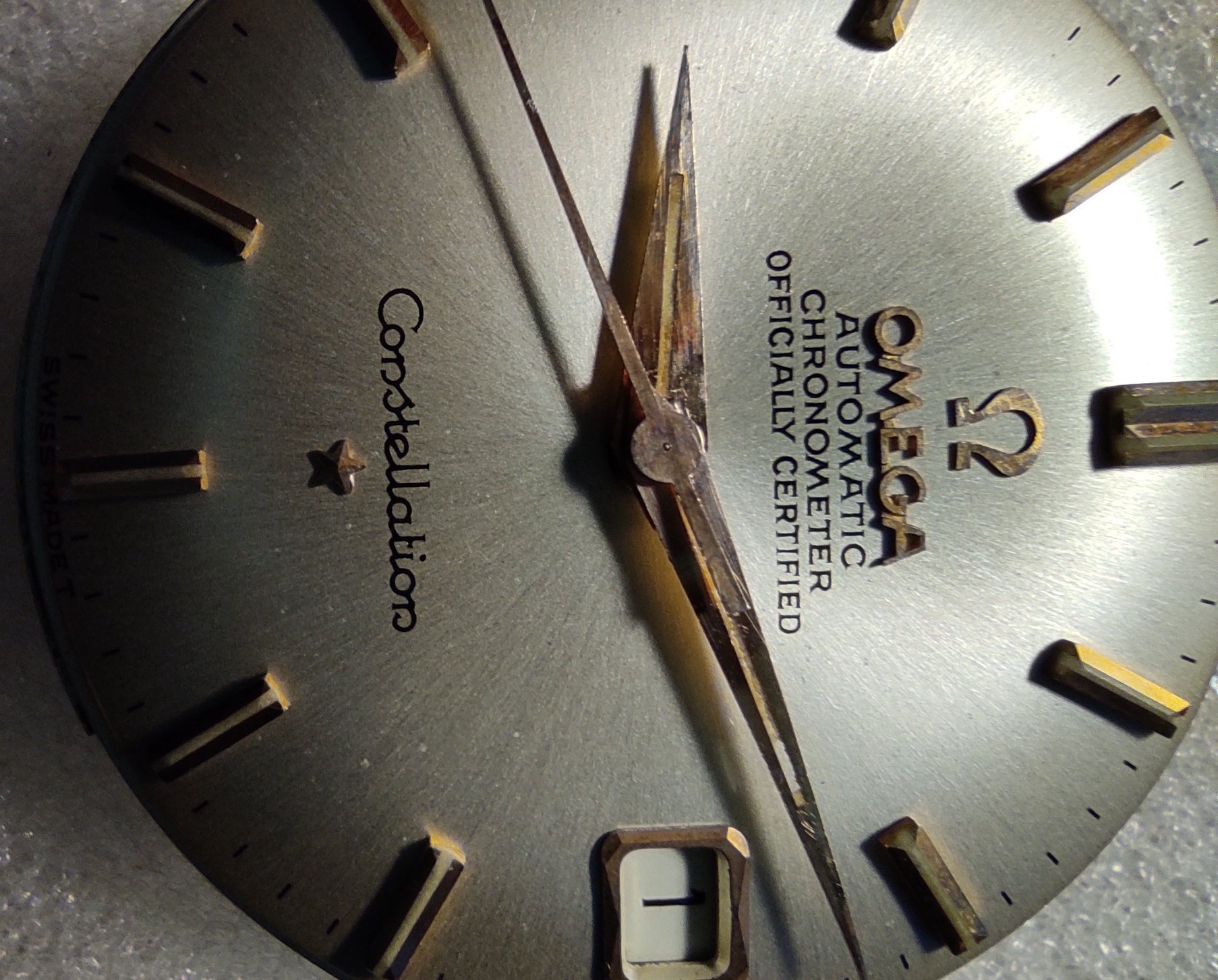

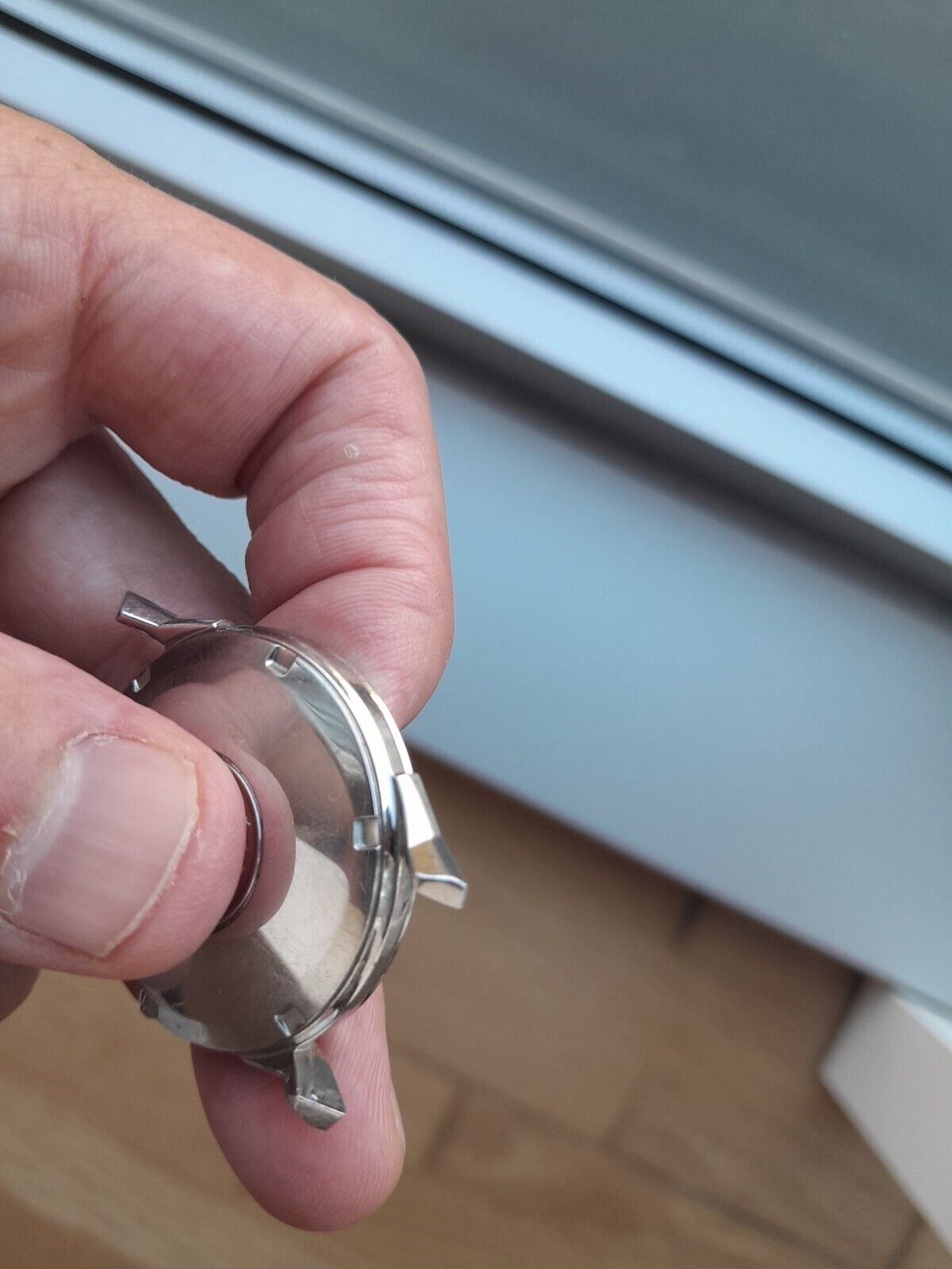

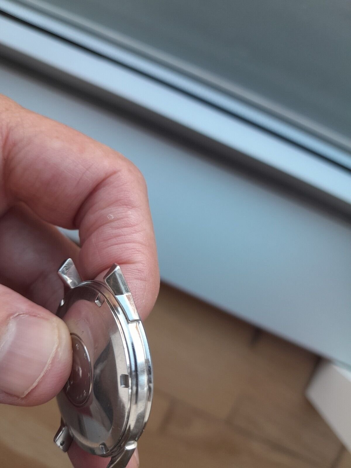

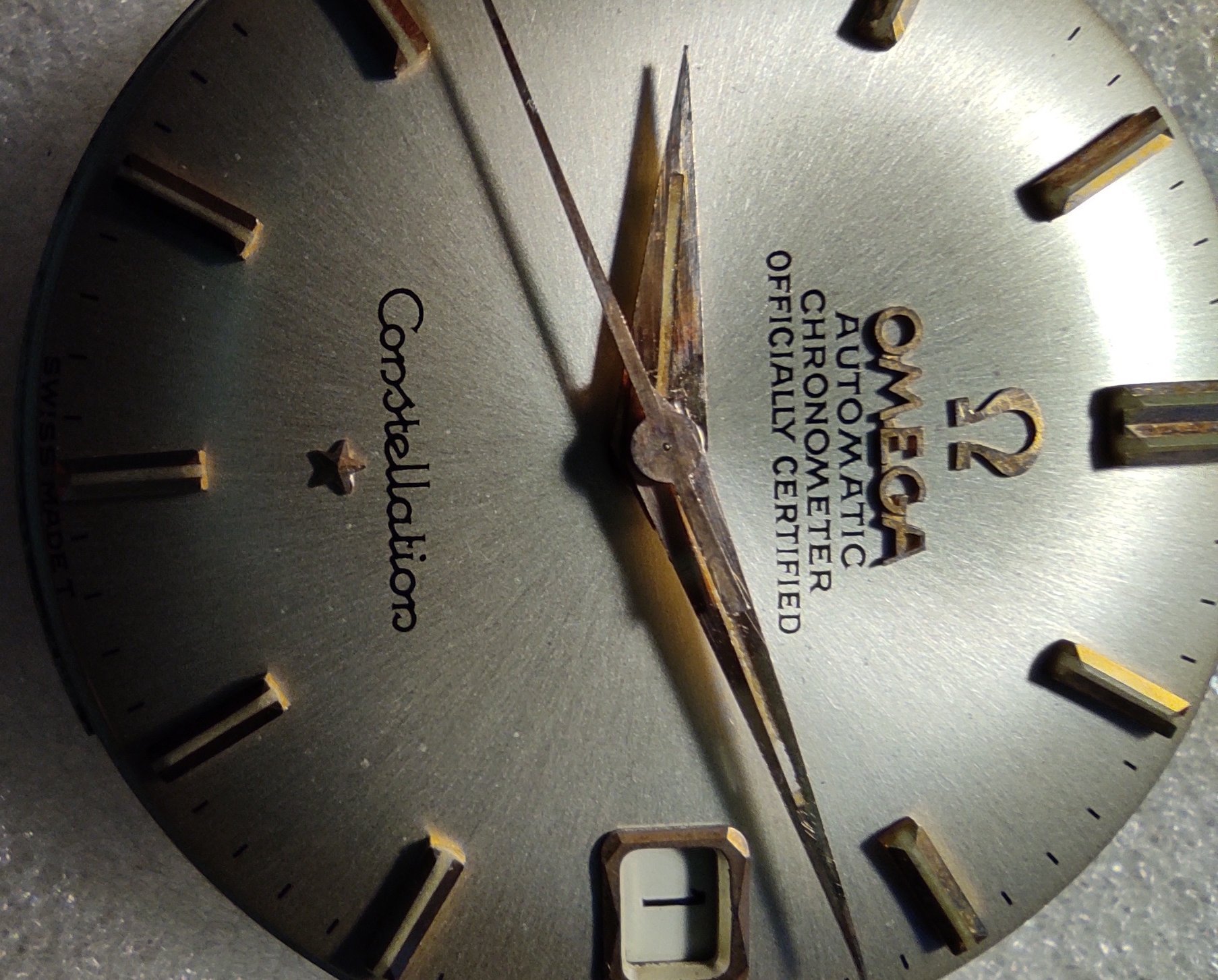

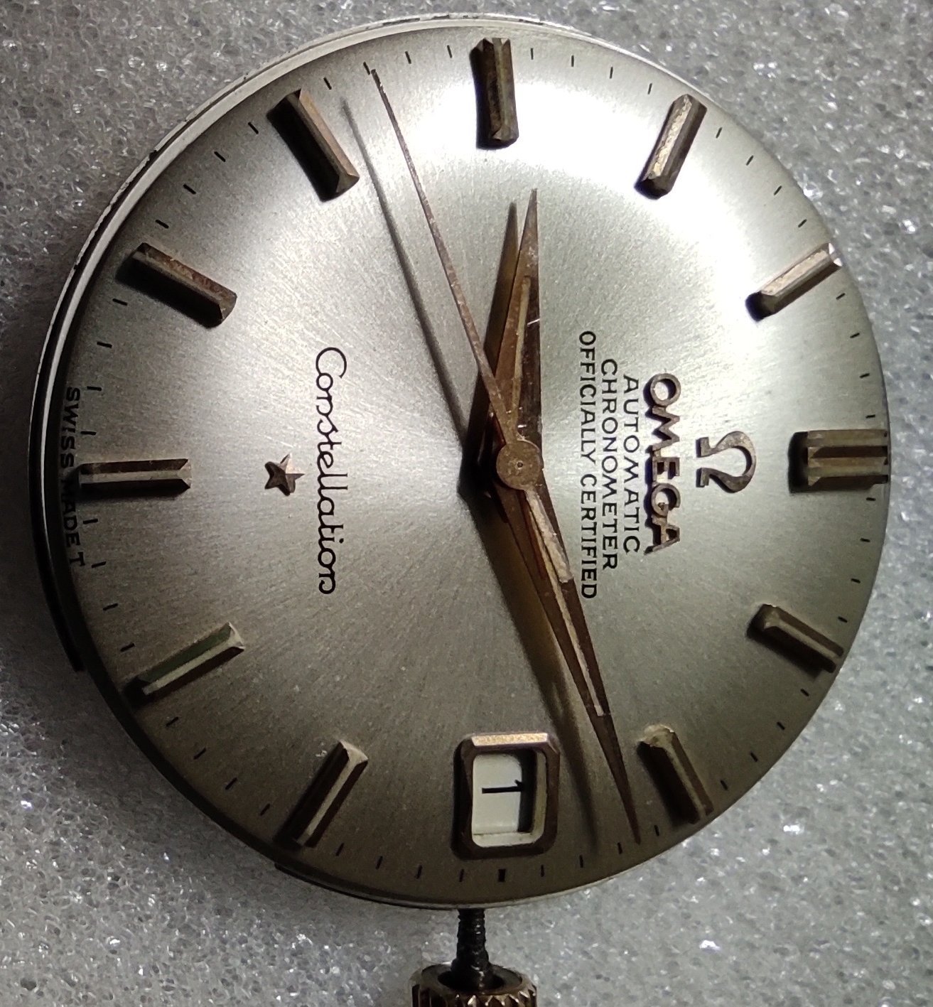

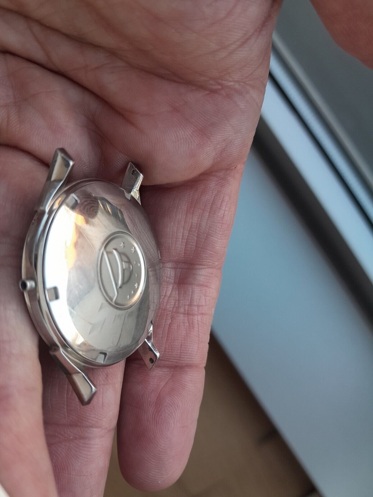

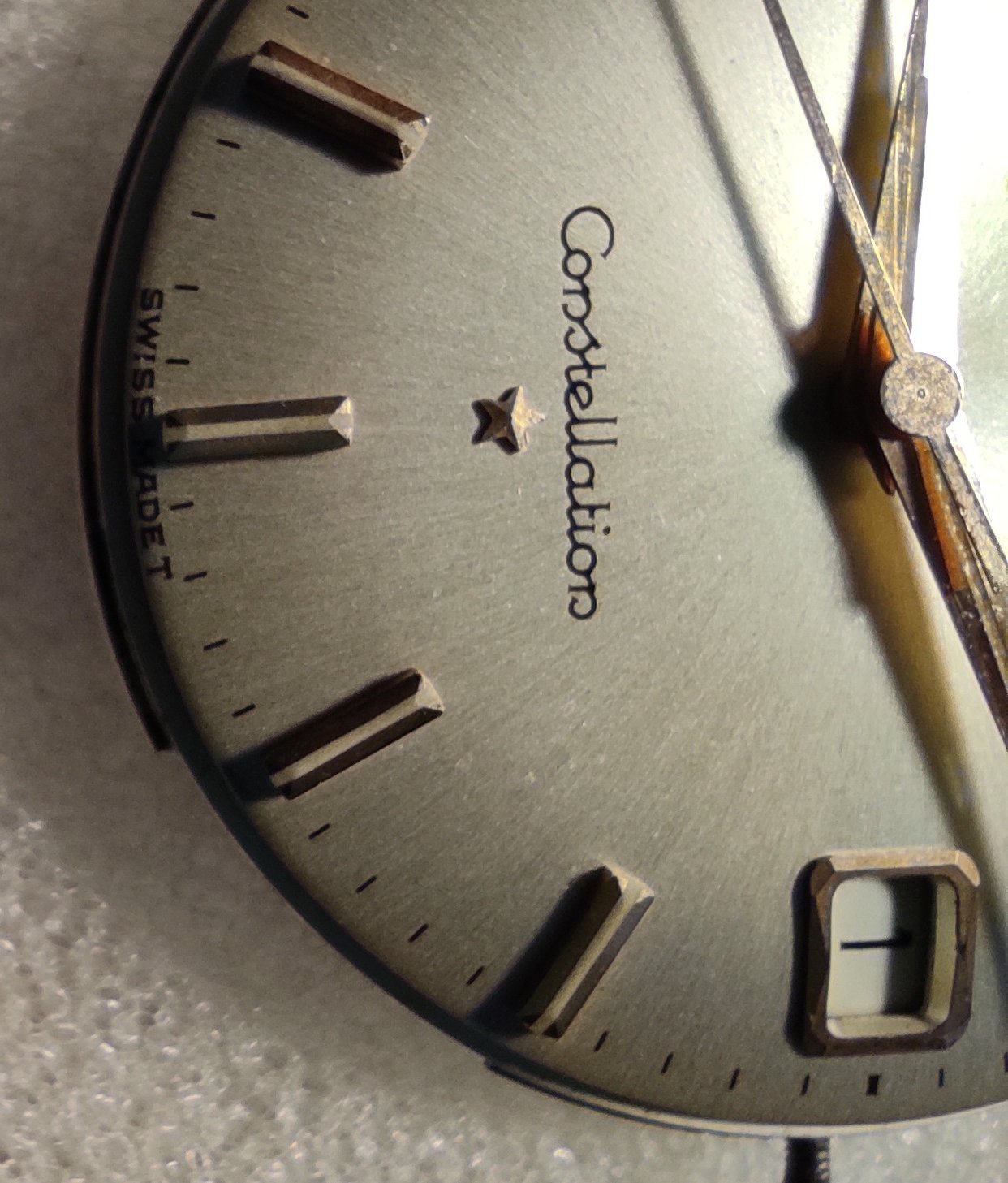

Hello everyone.
Can you help me with the authenticity of these items? Dial is original or a redone? Case is legit?
I sourced them from an ebay seller. Is this 564 ok with a ref. 168.005?
Thank you very much. Every comment is appreciated.
6,852
10,538

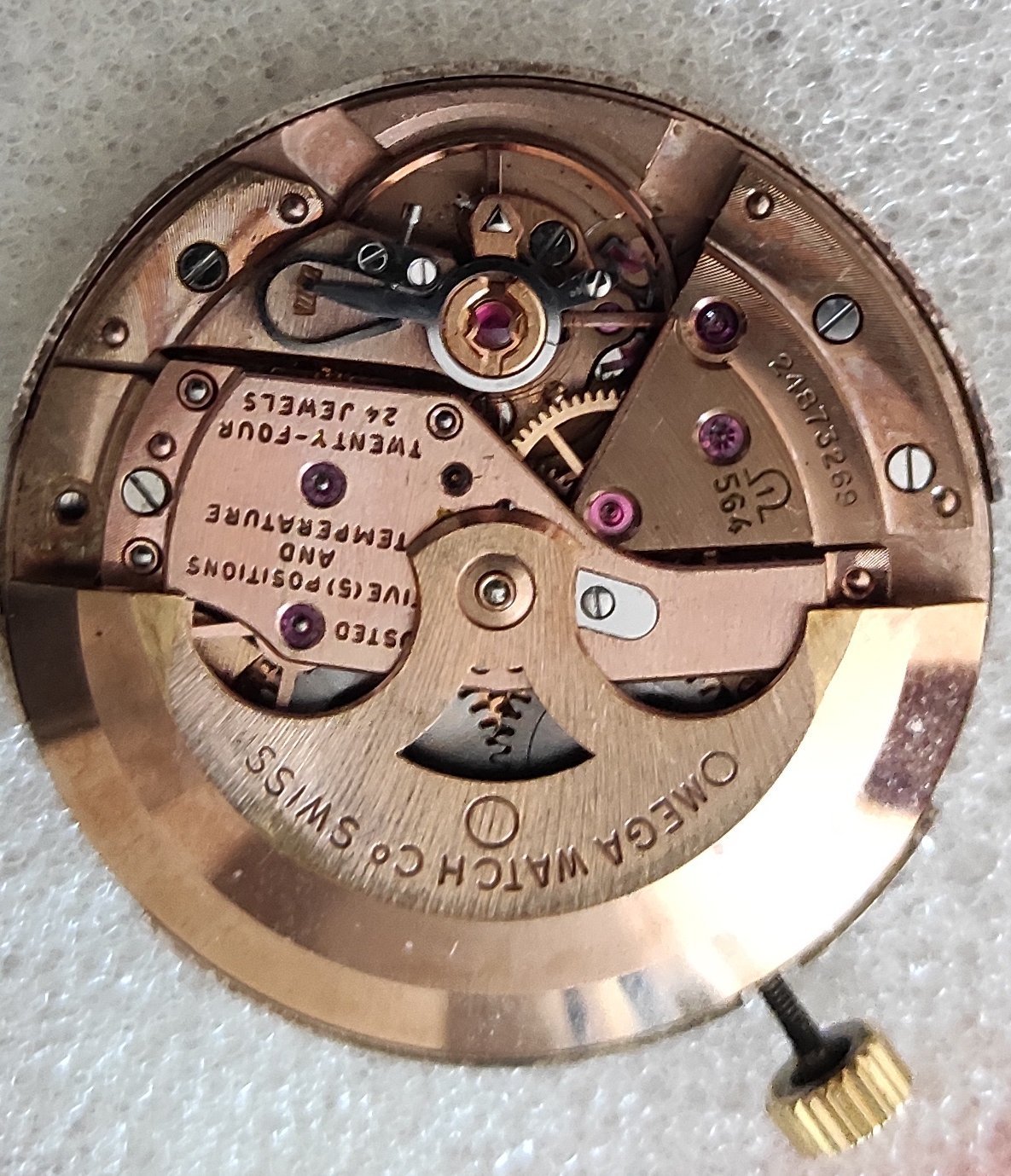

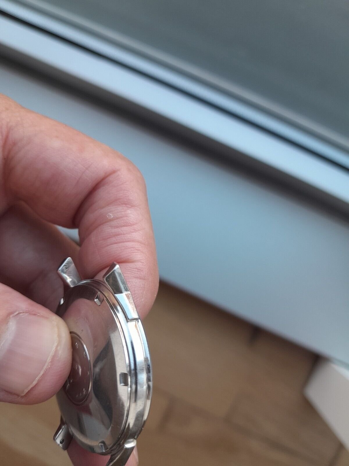

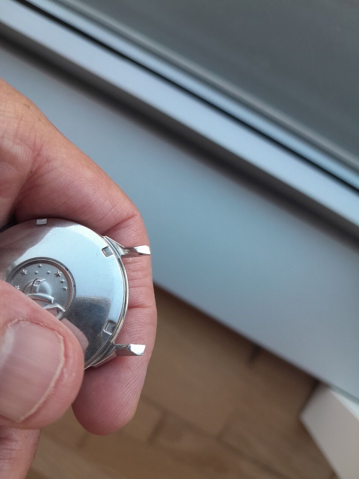

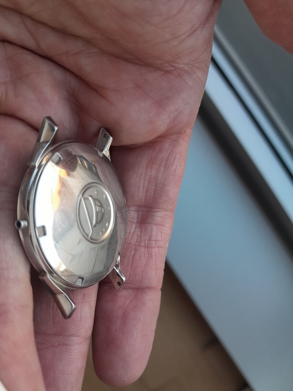

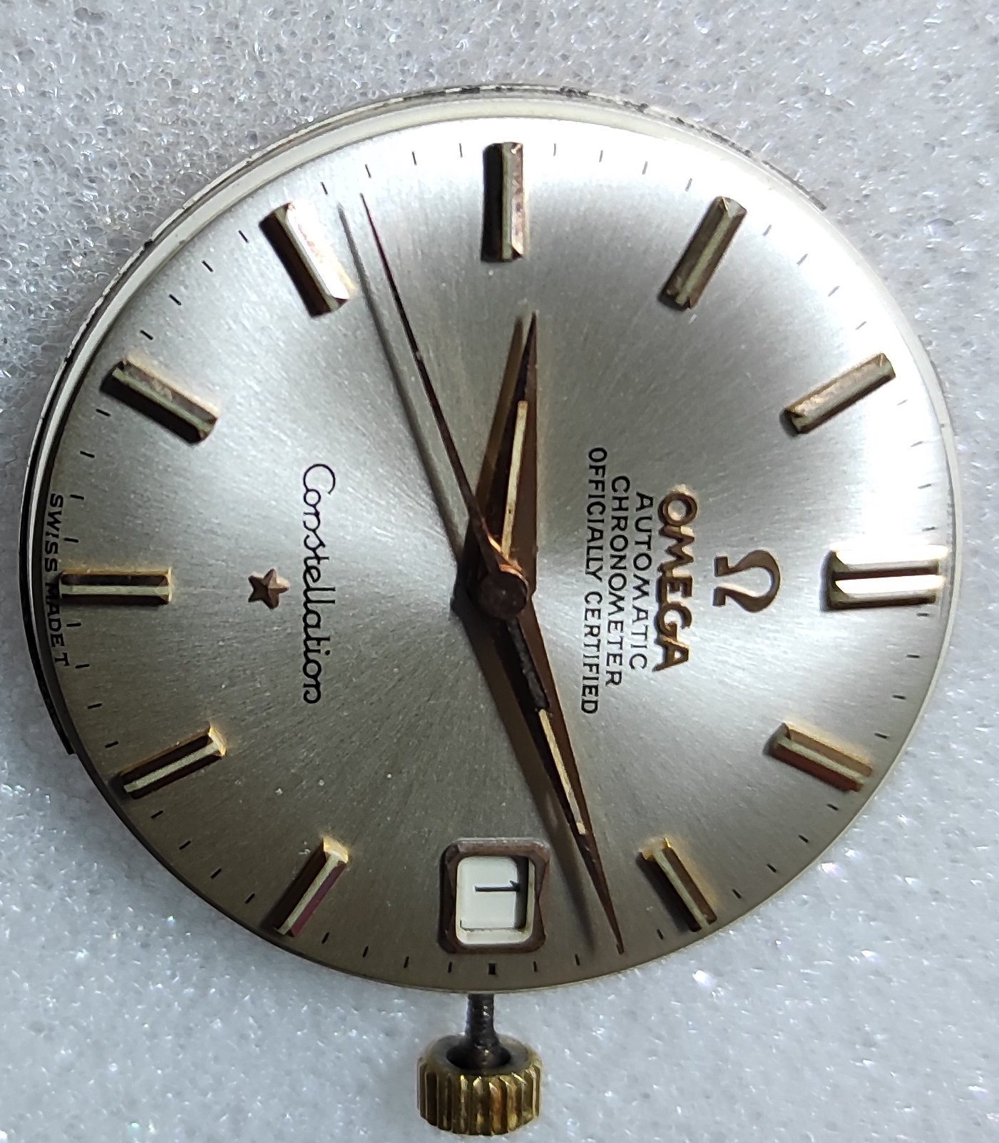

It's a little bit difficult to fully follow the question but.... assuming you acquired the case and movt/dial from a seller/sellers but they weren't fitted together and are asking does the dial/movt fit the case.
The case looks legit (but it would be more helpful if the 'holder' didn't have their thumb on the important inner case back info)
The dial looks legit
the 564 movt looks legit
However, without knowing the origin of the dial/movt, it is impossible to say with all certainty that they fit a 168.005 case.
The dial and movt could come from a late 168.004 or 168.010 references, in which case the dial will not fit a 168.005 case.
It all depends on dial size.

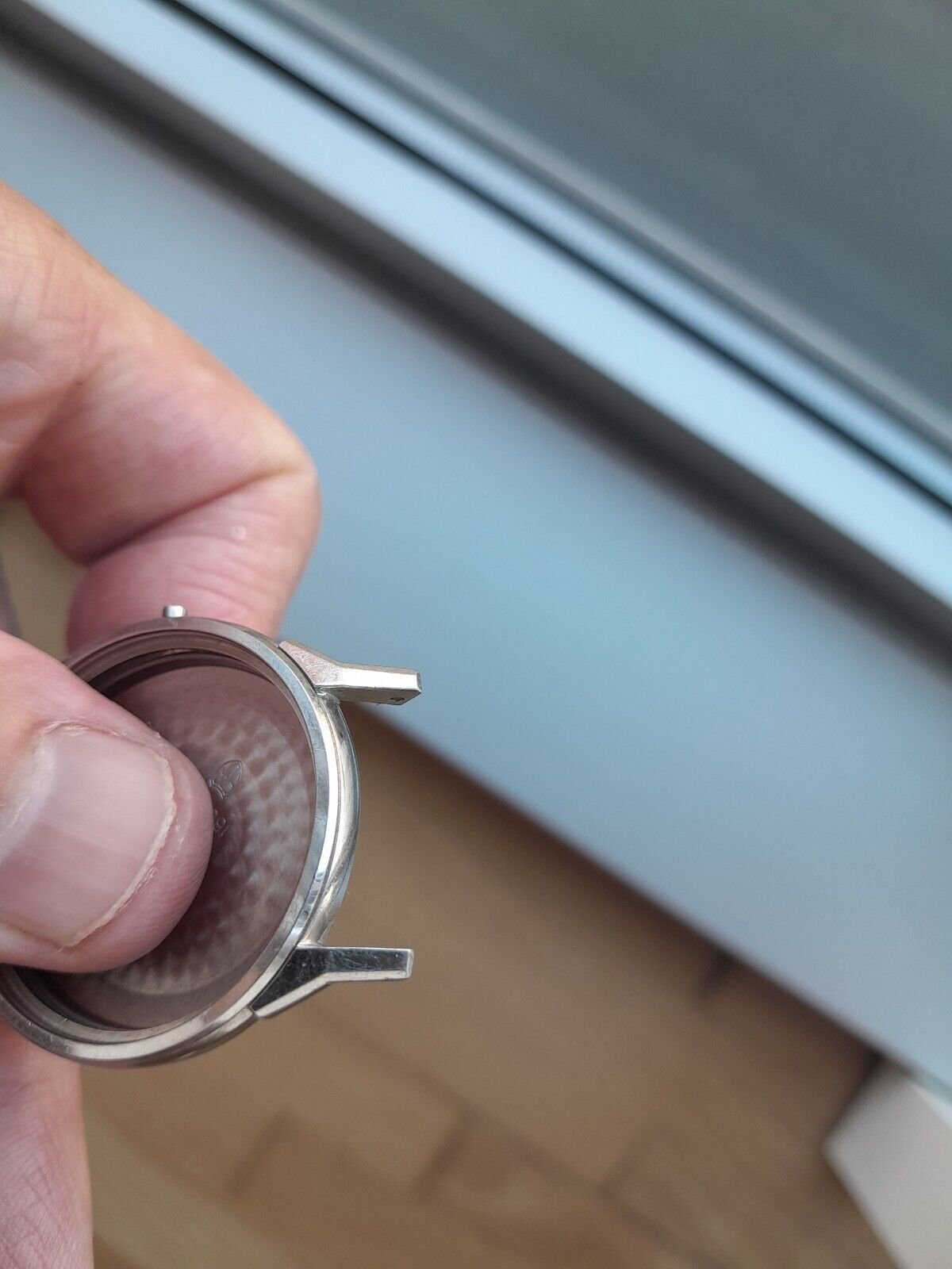

Hello. Thanks for the reply.
That is correct, the two parts are separated.
The dial has the outer diameter of approx. 29.5mm and a "second" diameter of 28mm.. it has a step immediately after the exterior.. as if that circle would fit inside the case bezel or that metal insert from the crystal.
I hope i made myself clear.. sorry for my bad english..
I m attaching a photo with the inside of the case. Thank you.
Ps. The movement is already acquired (in my drawer). The case is not payed and arrived yet... That s why i m asking these questions. And the wristwatch is for my personal use.. is not intended for resale or anything.

So in conclusion, dial is original, movement looks ok and case is not faked... The marriage in between is to be verified by assembly of the watch in the case. Is that correct?
6,852
10,538
That’s about the long and short of it.

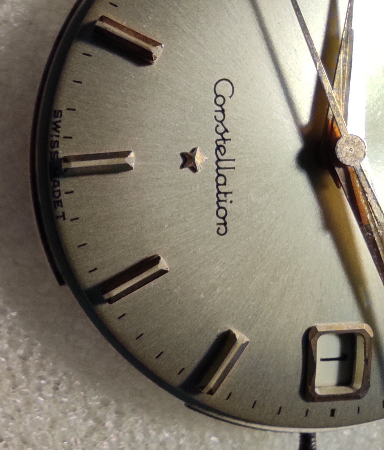

One more thing.. is there something special about those chamfered lume markers? I don.t see them very often.. gold? Brass?
Thanks!
6,852
10,538
Thanks!
They are one type of indices used on various Constellation references, with full luminous ‘inserts’ instead of luminous pips.
They are less common than the usual pips.
The body of each index will be solid gold.
