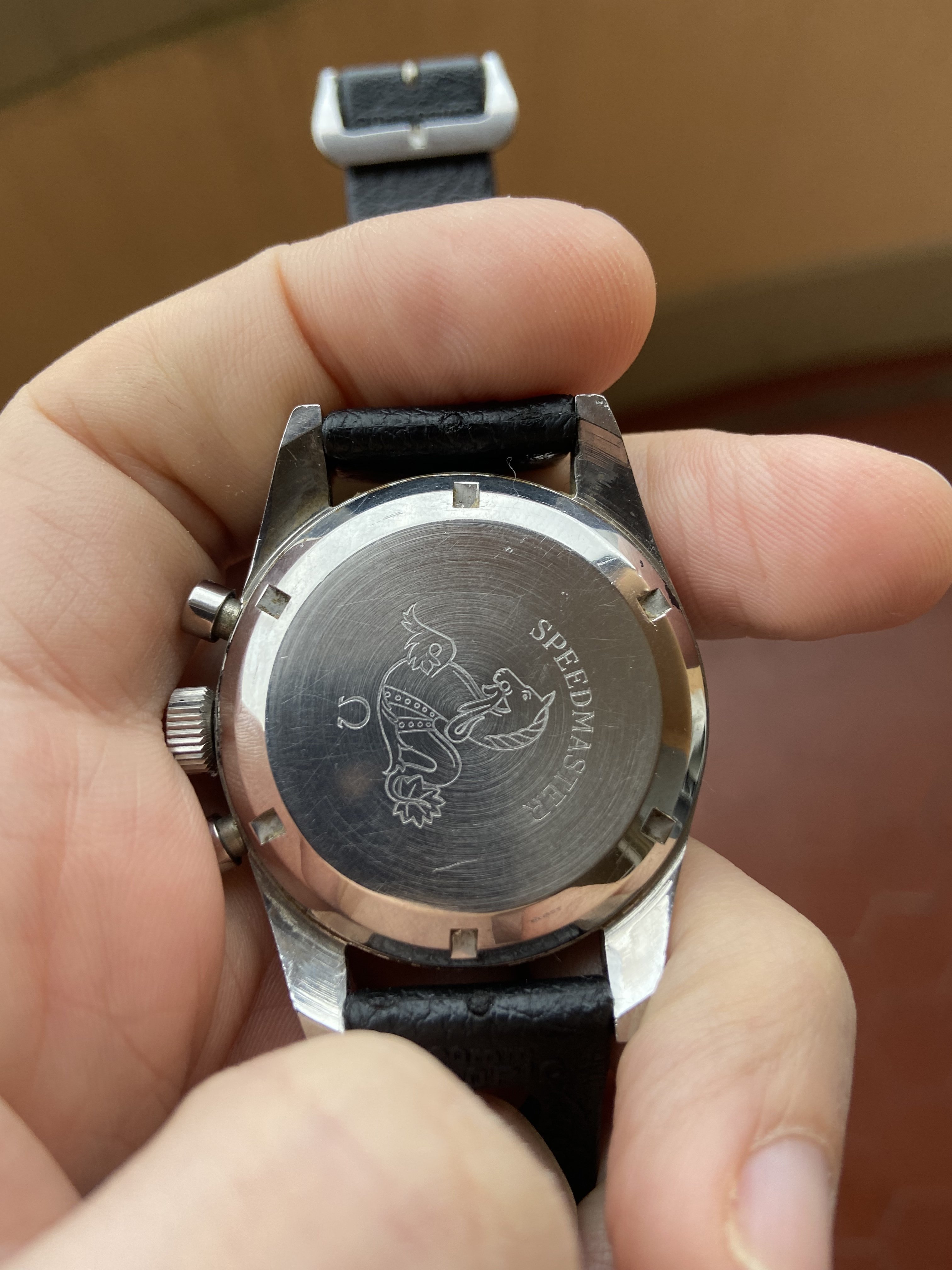

Casebacks were not fitted at random as you suggest, they were fitted sequentially as the watches were made, the -63 iteration during ~1964, the -64 during 1965 or thereabouts and the -65 from early 1966 to 1969. I suggest you read up on the differences between the -64 and -65 cases with particular regard to the lugs. They were made by different subcontractors and are noticeably different. The one you show has -64 tell tales and is missing the -65 bevels. Casebacks very much are a guide to when the watch was assembled, just not a direct year for year correlation.[/

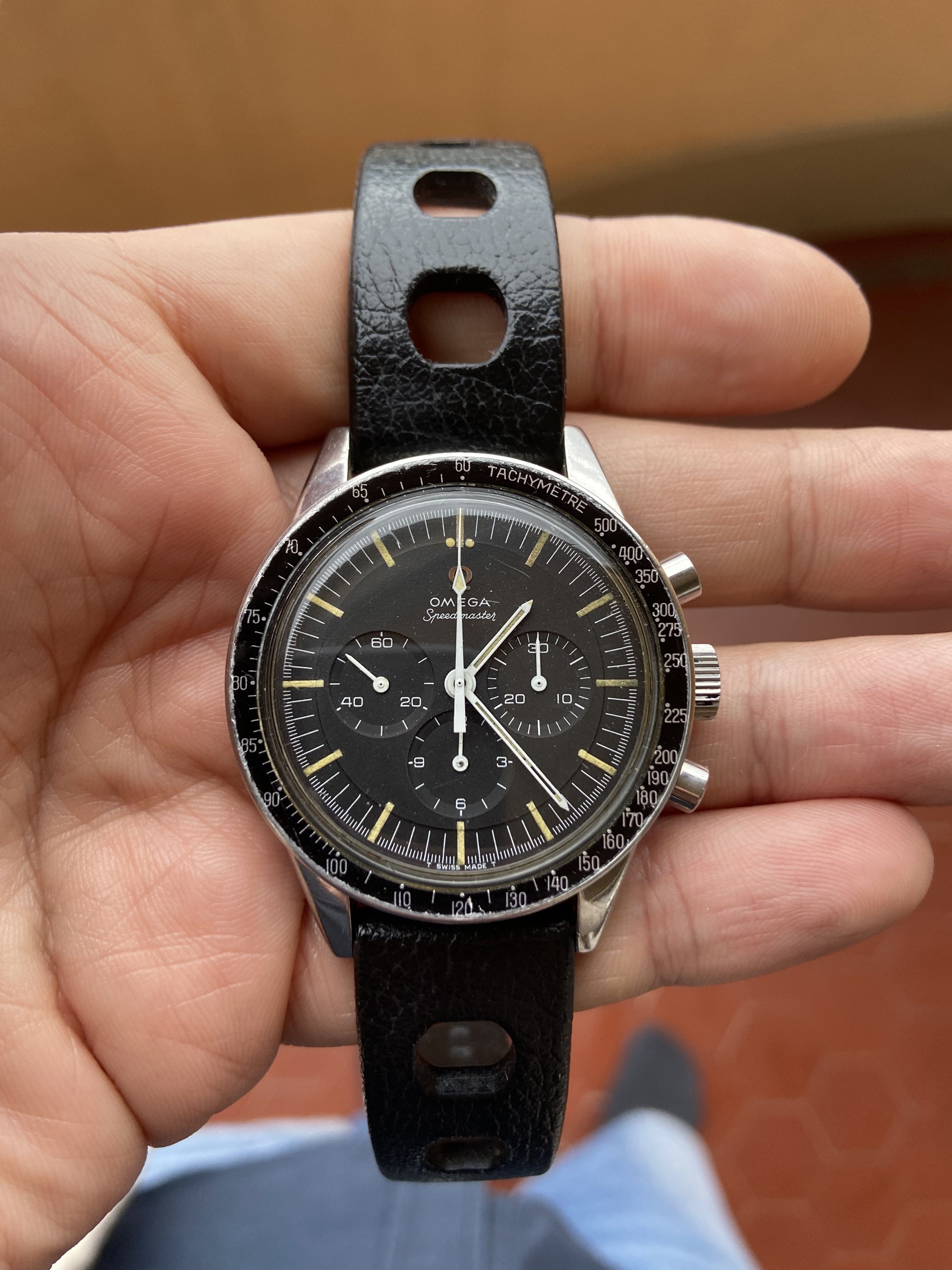

I went to pick the watch up yesterday!
It looks nice i think, but it needs some work on it : crown, hands, service, pushers?
but the dial is nice, the caseback clean, and the case worn but ok i think.

Nice watch. I'm happy for you that everything worked out well. Hopefully you'll find the parts. It would be great if you can keep us updated on the restoration process.

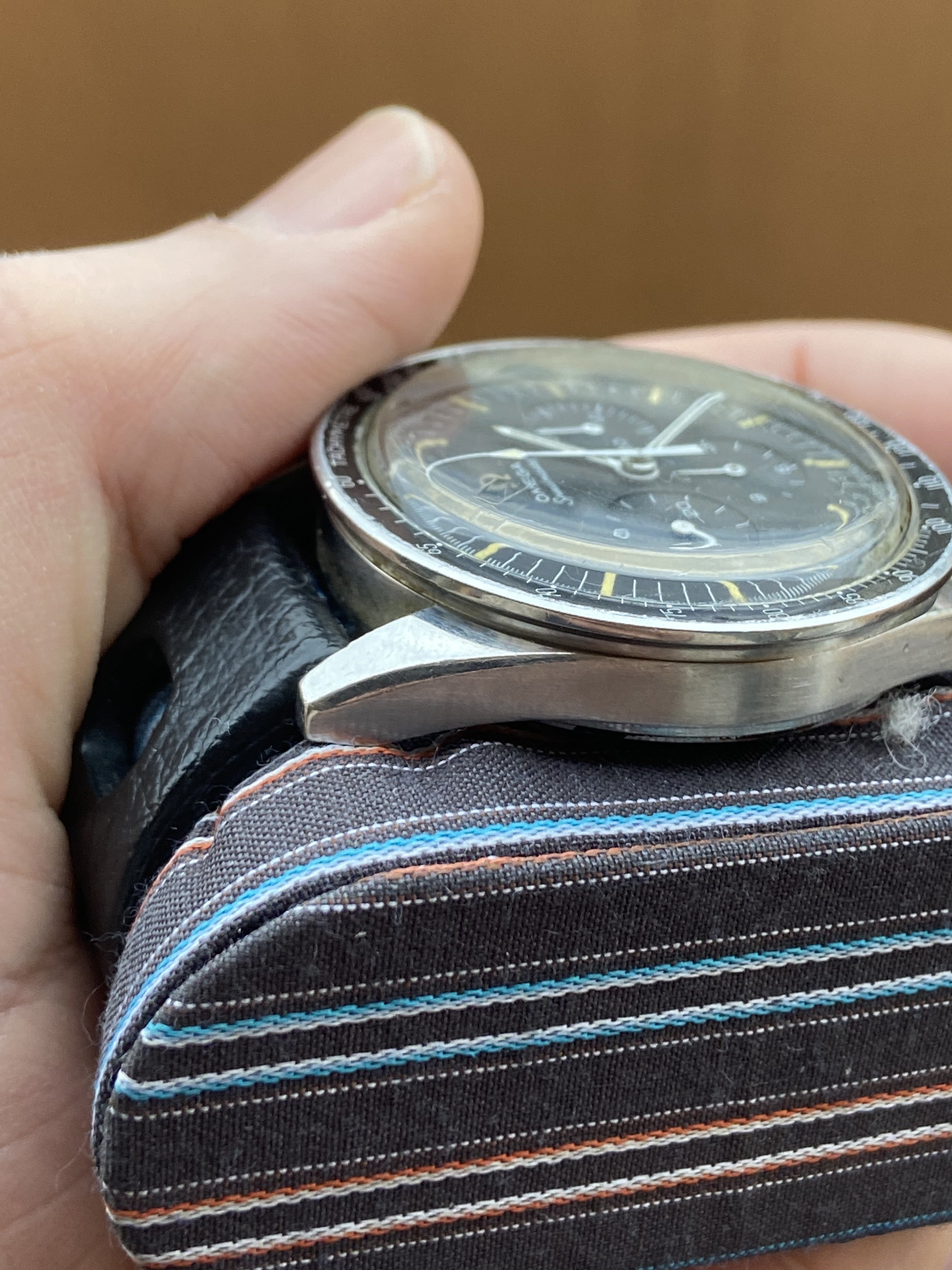

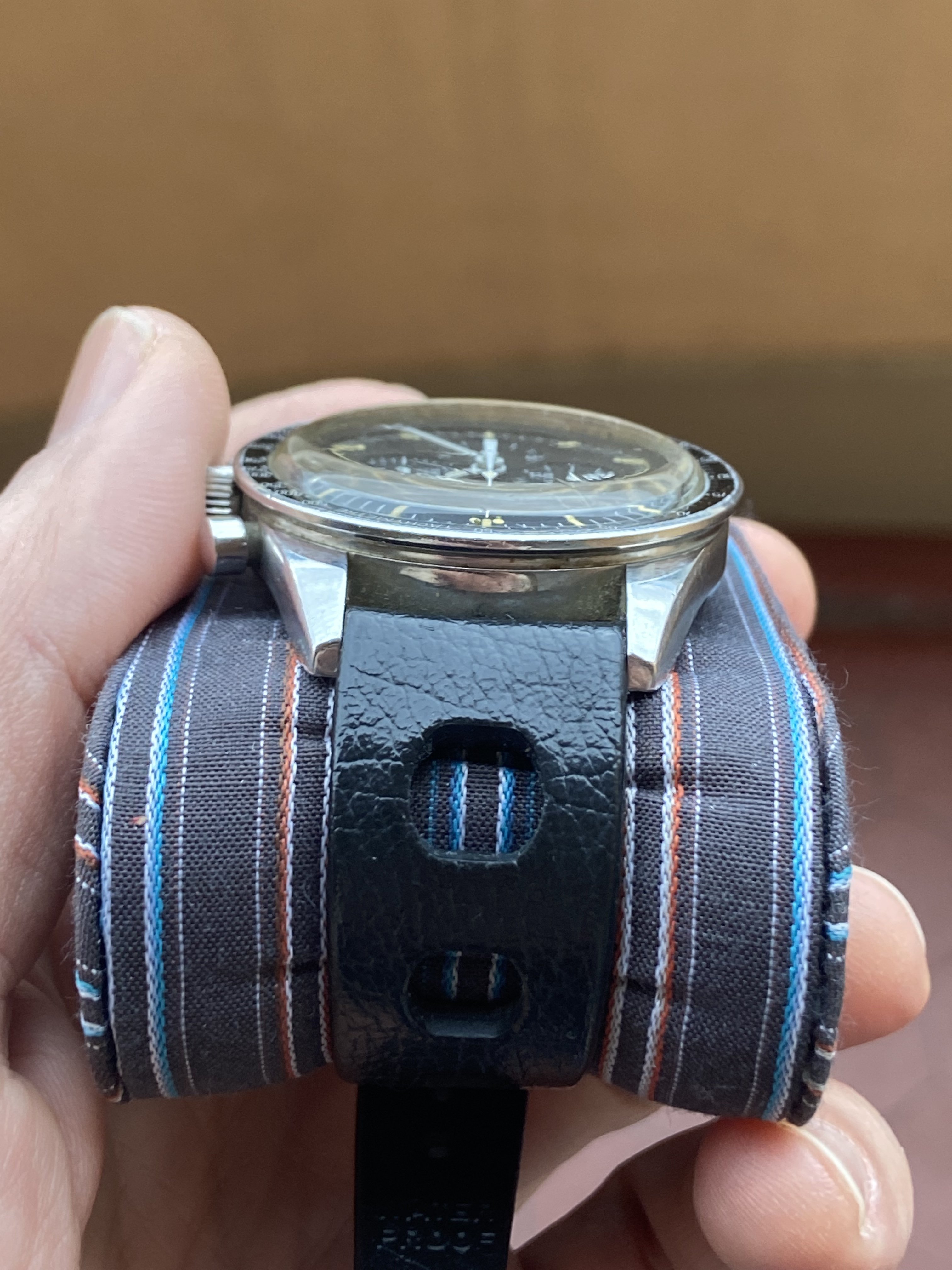

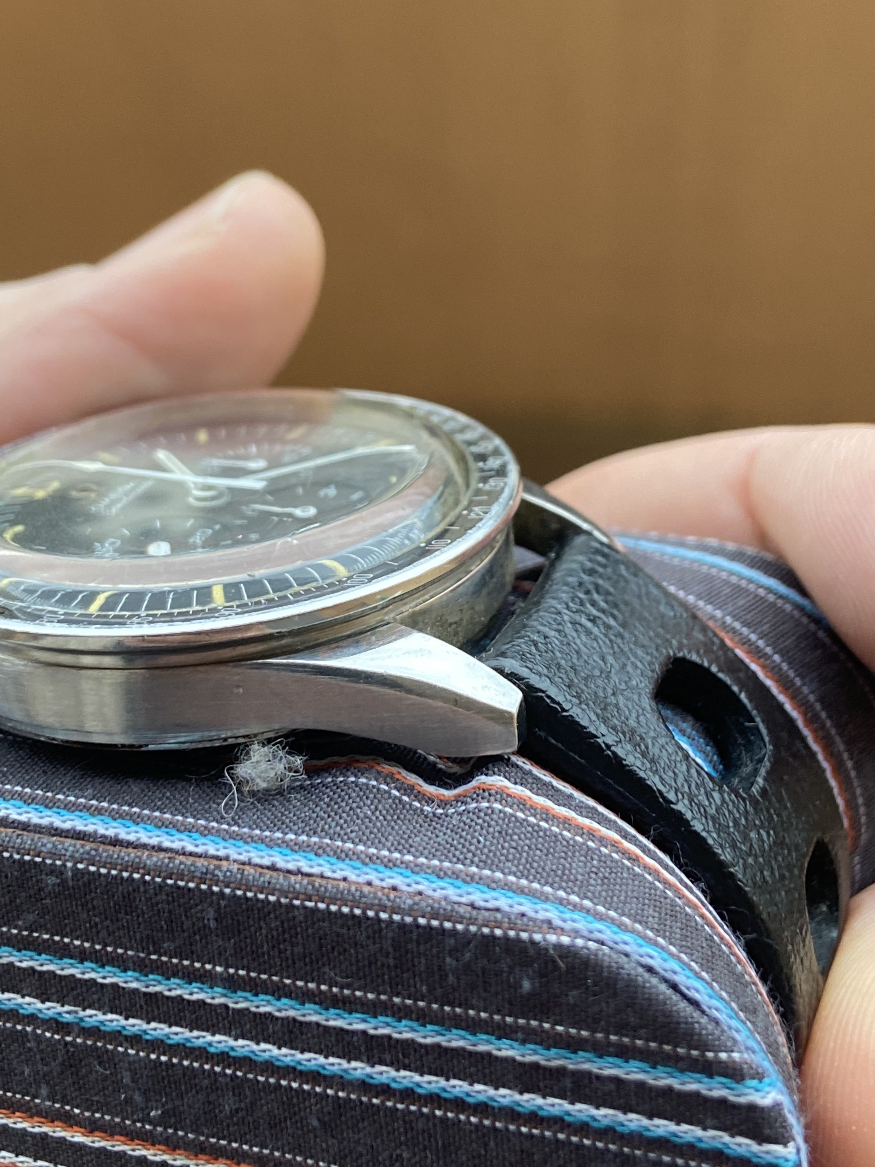

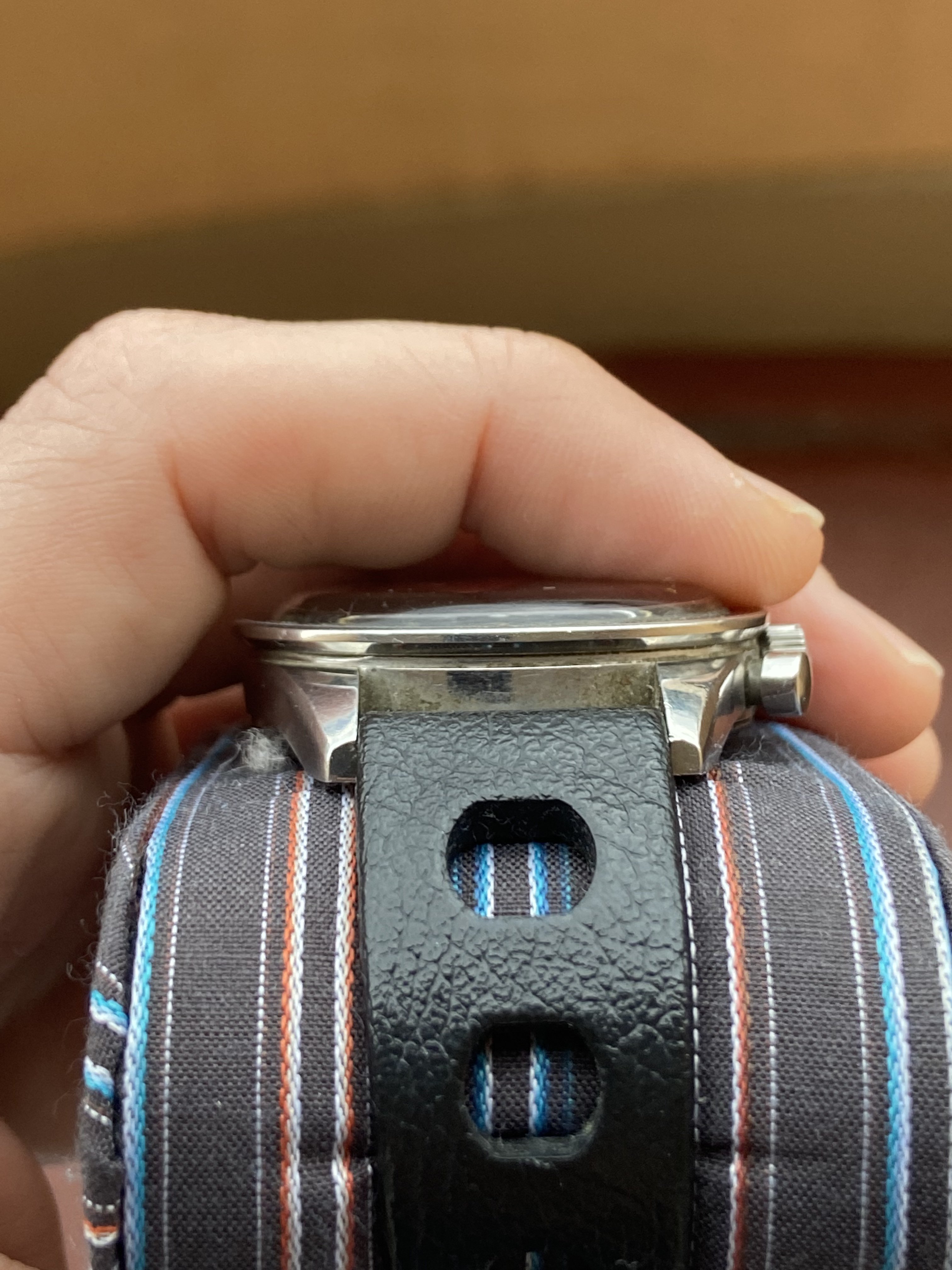

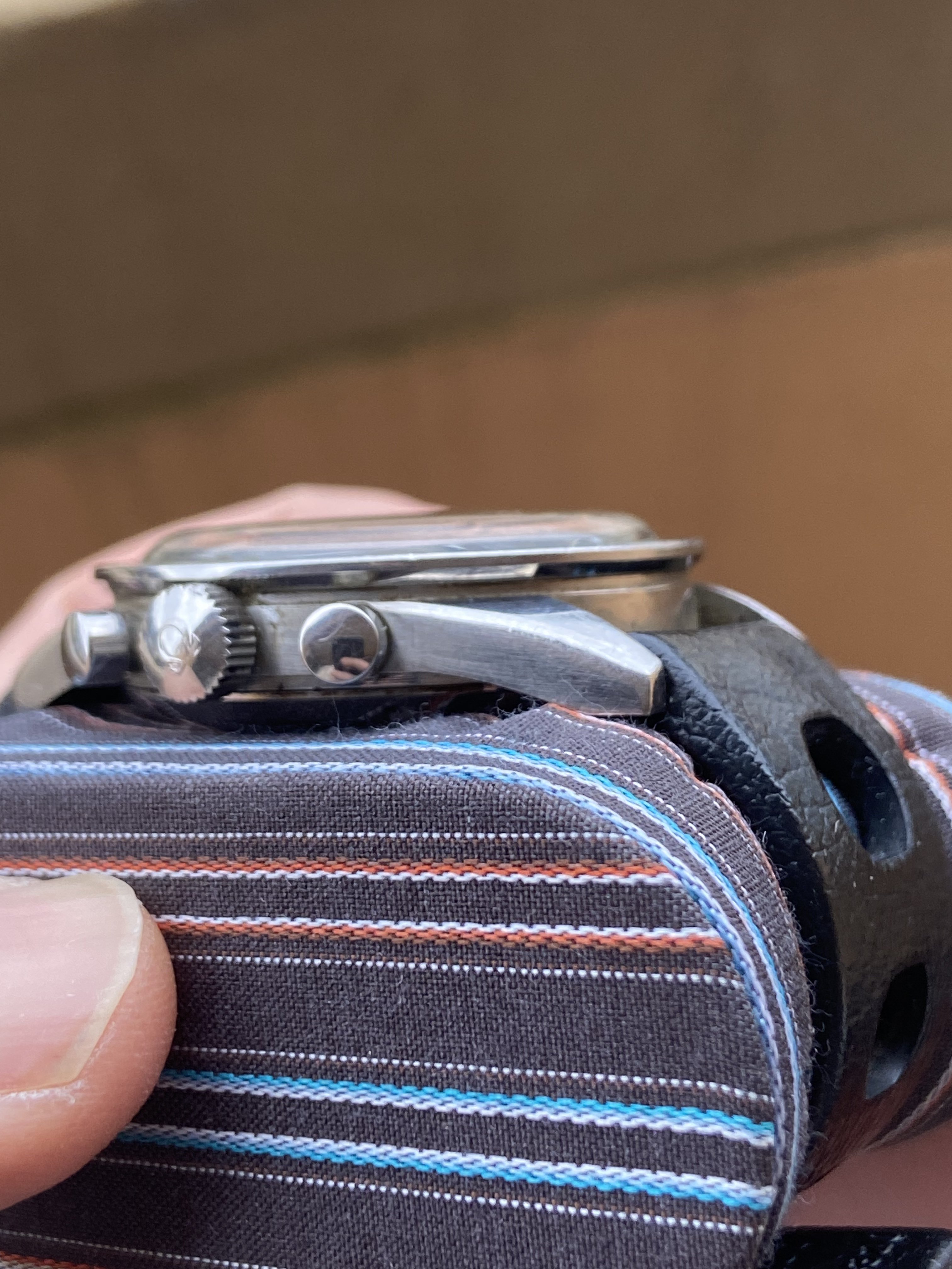

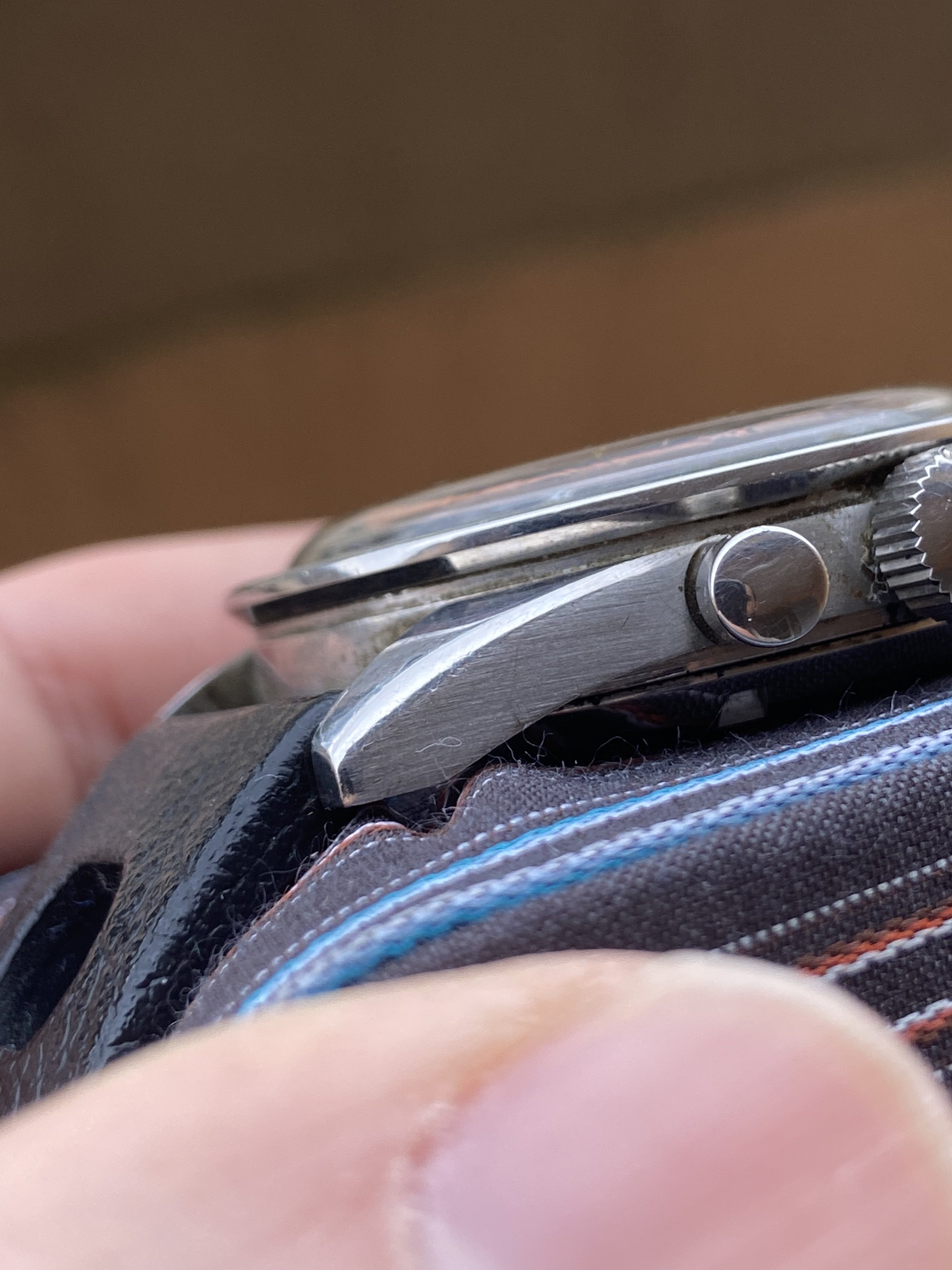

What do you think about the case? It’s a new type for me, so I’m not sure of it.
About the pushers, someone told me they’re service one. It wasn’t so obvious to me. How can we identify them?

Very nice watch overall. I would concentrate on the hands if I were you. Which auction did you get it from?

Yes, the hands are my priority.
Finding the 3 in a good and coherent condition will be hard. So I guess the better way is to find the chrono one first, and the hour minute later.
i found one on ebay but very expensive, and probably a old service one (but who knows without the length)
From those pictures I’d say the case is very good. The original profile and facets remain. Likely not polished or just given a light going over a couple of times.
