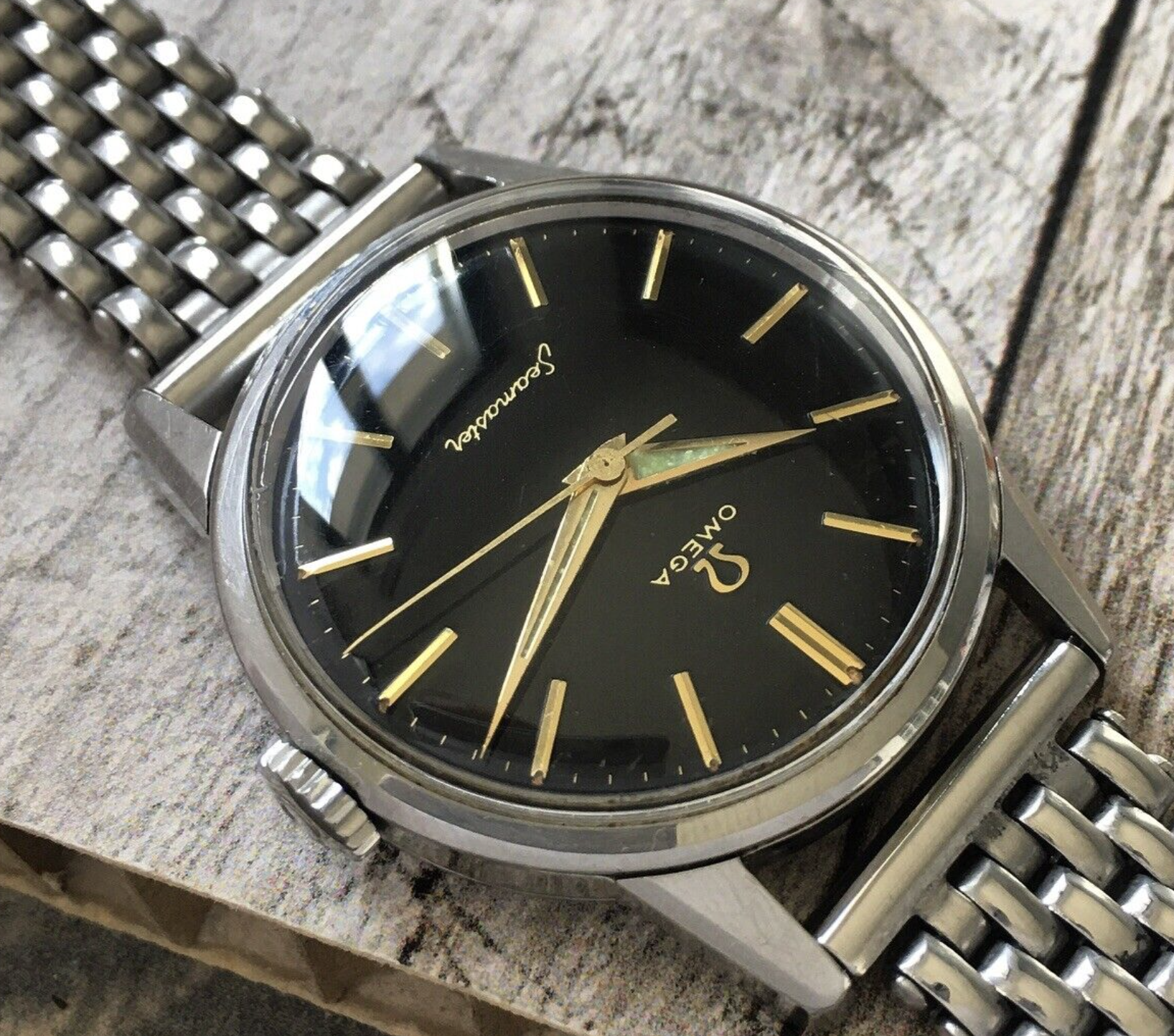

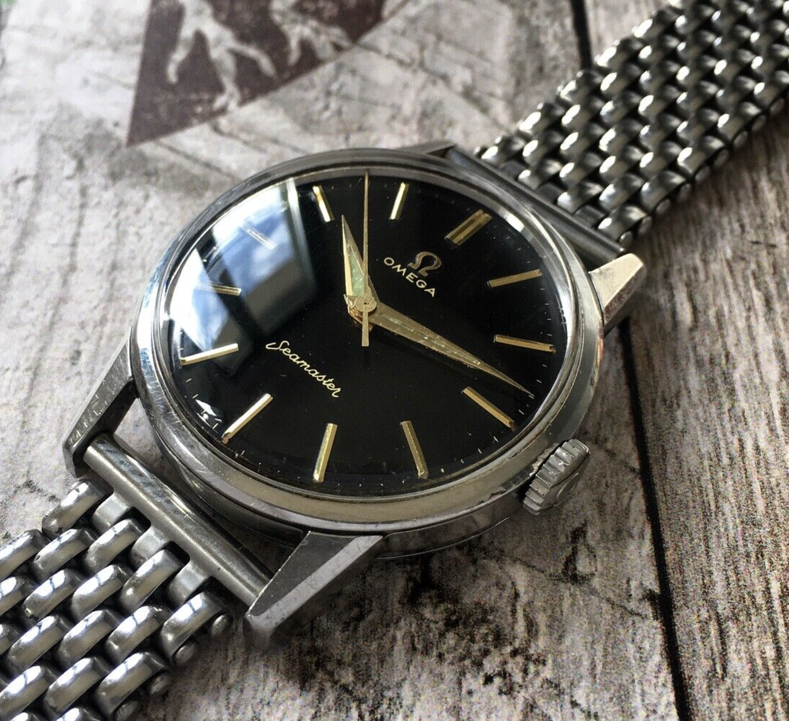

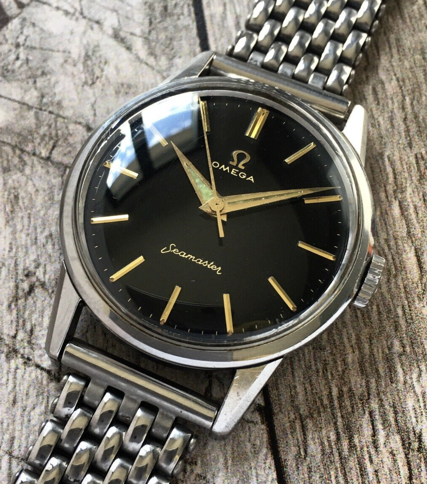

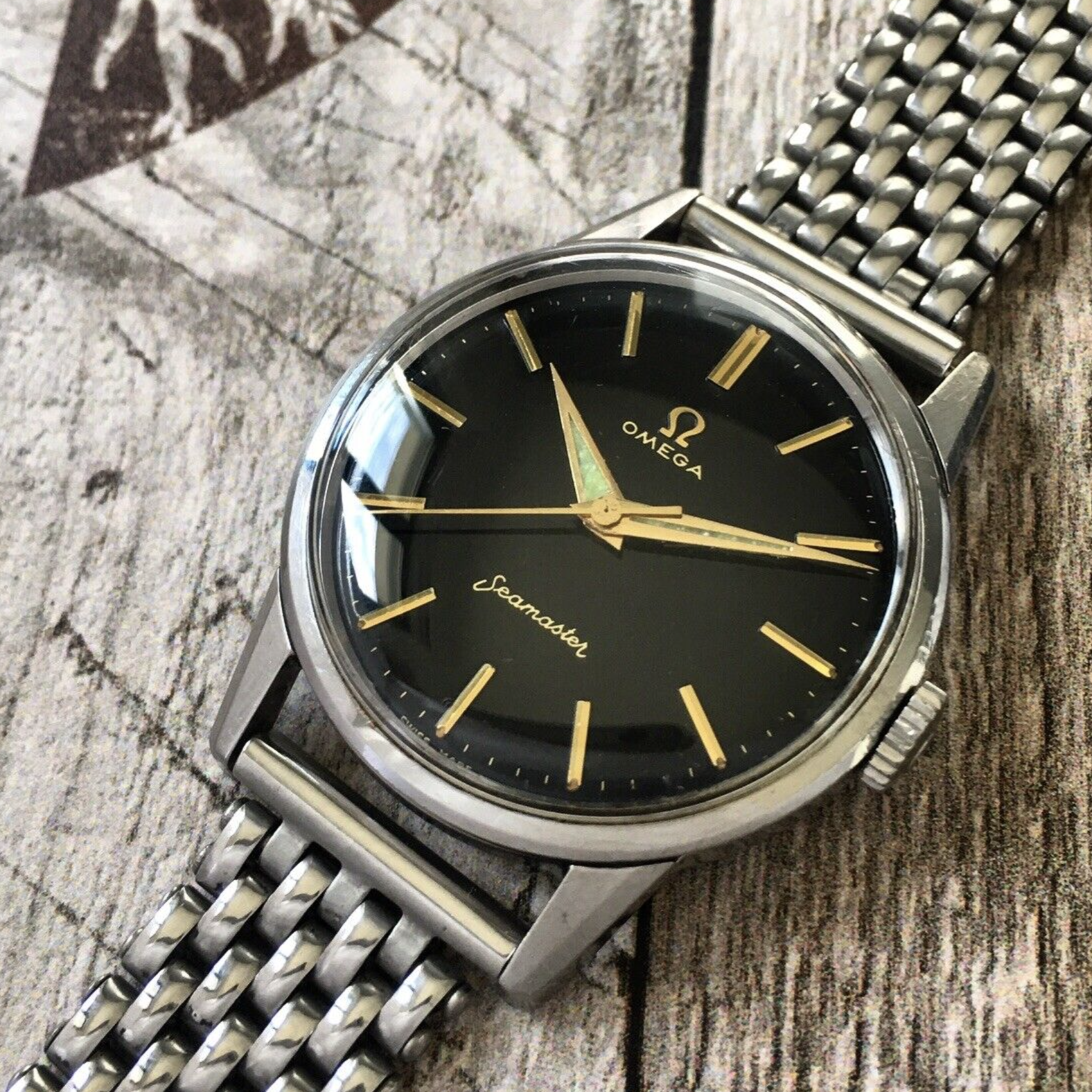

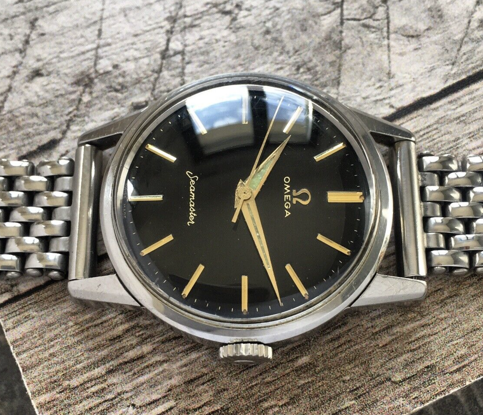

So, here I am again for yet another inquiry. There's on ebay this nice 14390 with black deal, which looks beautiful to my eyes. However, there's one thing that leaves me uncertain: I leaned in some thread or somewhere else, that whenever the watch has tritum minute/hour hand, the "swiss made" text is supposed to have one or two "t". Now, I don't see that in this exemplary. Moreover, I know hands should match the index, and I don't quite understand whether the index has the tritum as well or not. Any help? Everything else looks good to me, but I might be wrong. Do you see other issues on this one?
Here's the ebay link, for your reference: https://www.ebay.it/itm/363579119631?boolp=5&ul_noapp=true

With the coat hanger S that’s likely a radium dial (no T’s) or the brief period when T’s weren’t required.
I did not know that! Thank you sooo much!
There is luminous material in the small gaps at the end of the indexes - have a close look! Its OK.
