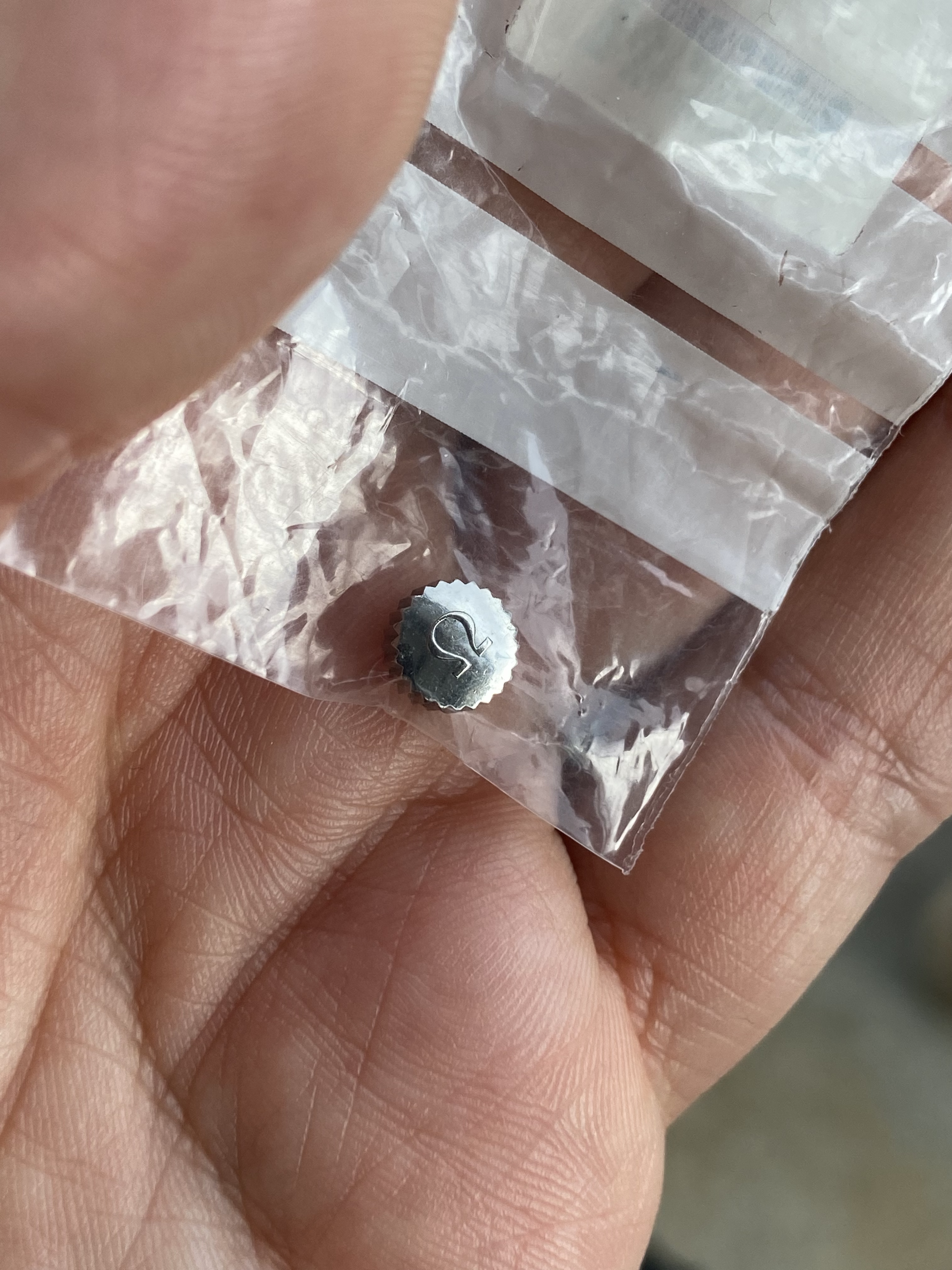

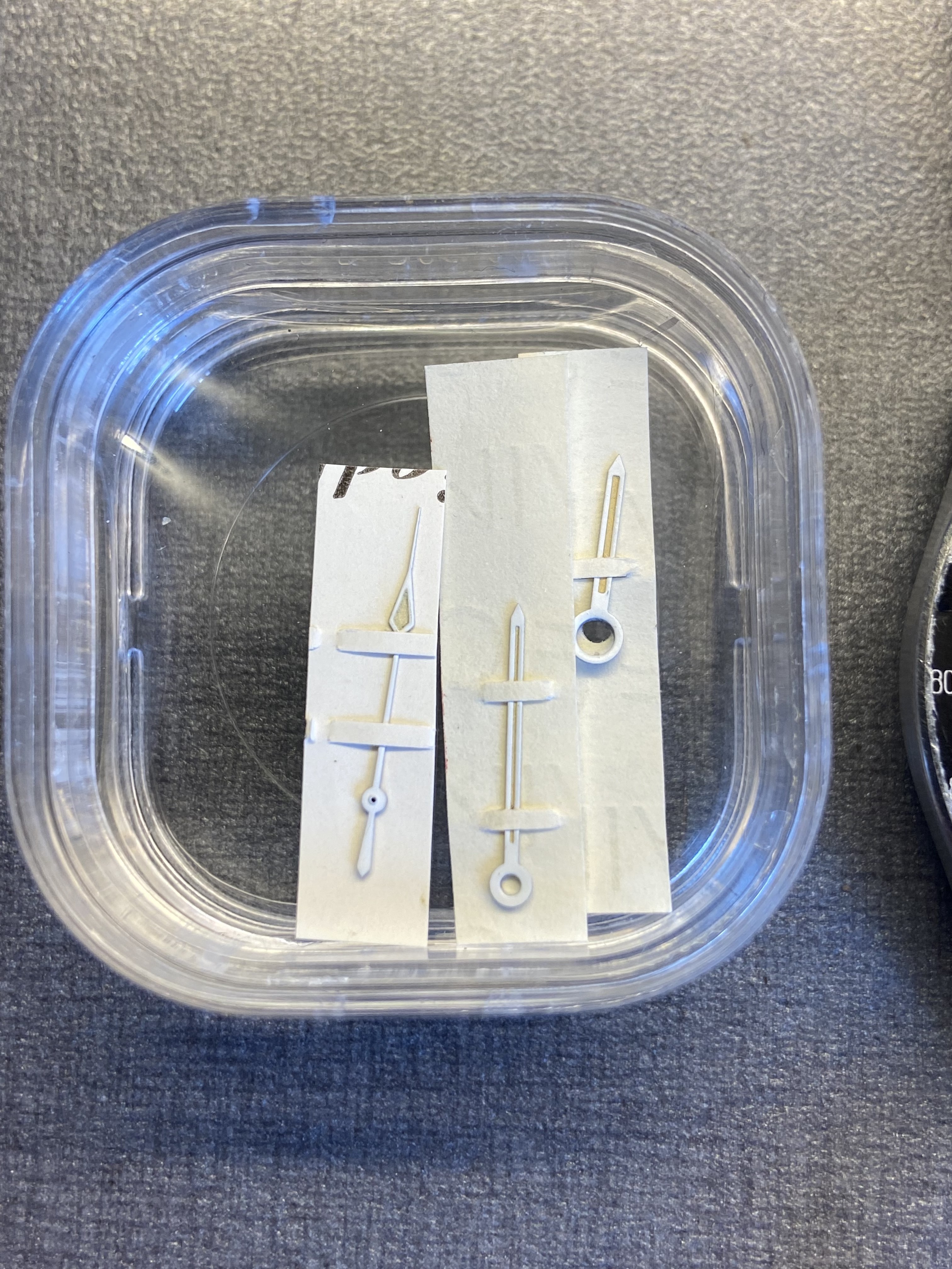

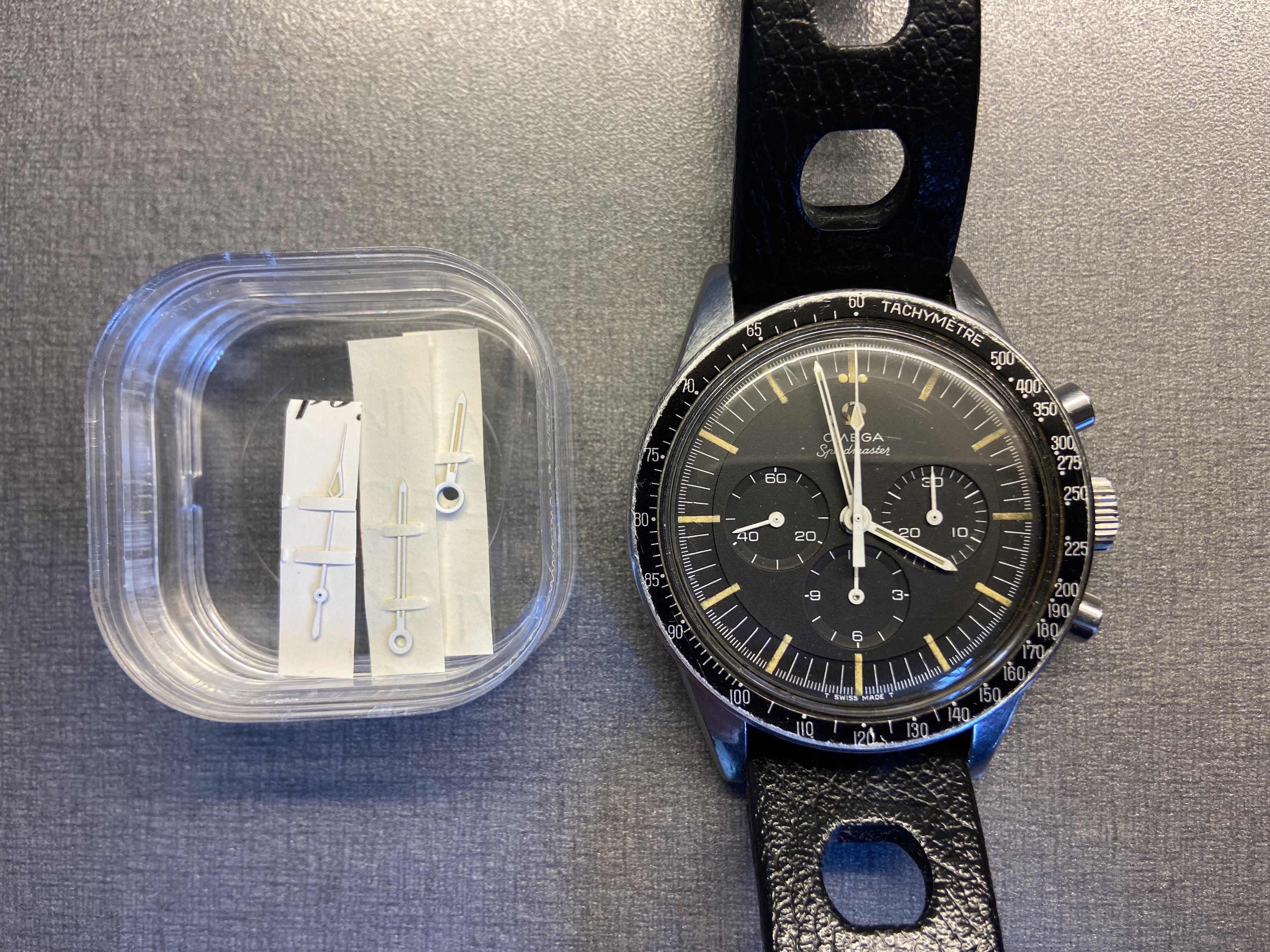

So, it's time for an update!
First, I have the EoA. The watch has been delivered in Switzerland in February 1967. I'm glad there is no problem with it.
It has been quite difficult to source the good parts. I finally found NOS hands, a correct crown and a 1035 (not period correct but..).
Thank to all the members here that help me for it 馃榾
Next step, a full service. 馃榿
