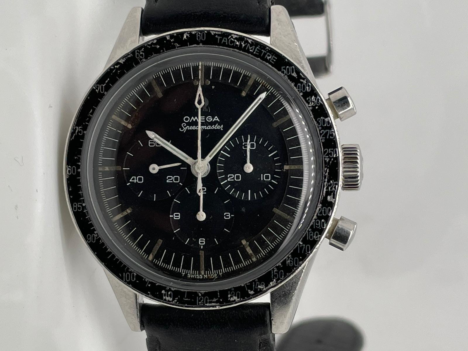

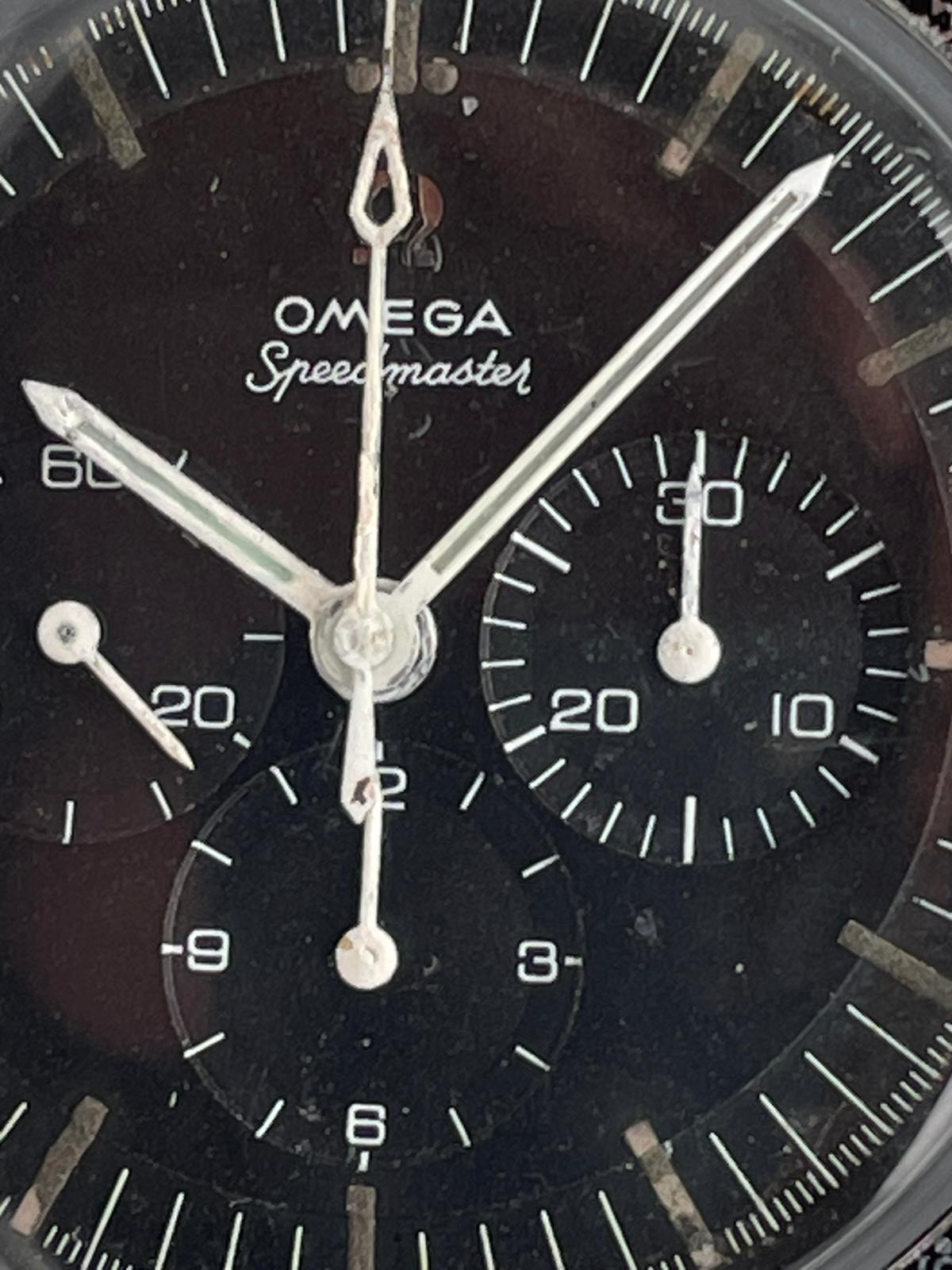

I had an opportunity to purchase an Ed White.
They wanted nearly £10,000 for it,overpriced in my opinion.
The condition was poor,but I did think about it.
It looked like an honest watch,original parts,but with a service crown.
I sent off for an archive and Omega said that the movement number did not match the case reference.
Omega refunded their fee ,which I thought was a bit strange.
I didn't buy the watch,but it annoyed the seller,a local watch dealer who I know.
His opinion was that the watch was honest and genuine.The movement was the correct no. being in the 24 million range.It's possible that the movement may have been transplanted from another make of watch.Many companies used the 321 at that time.

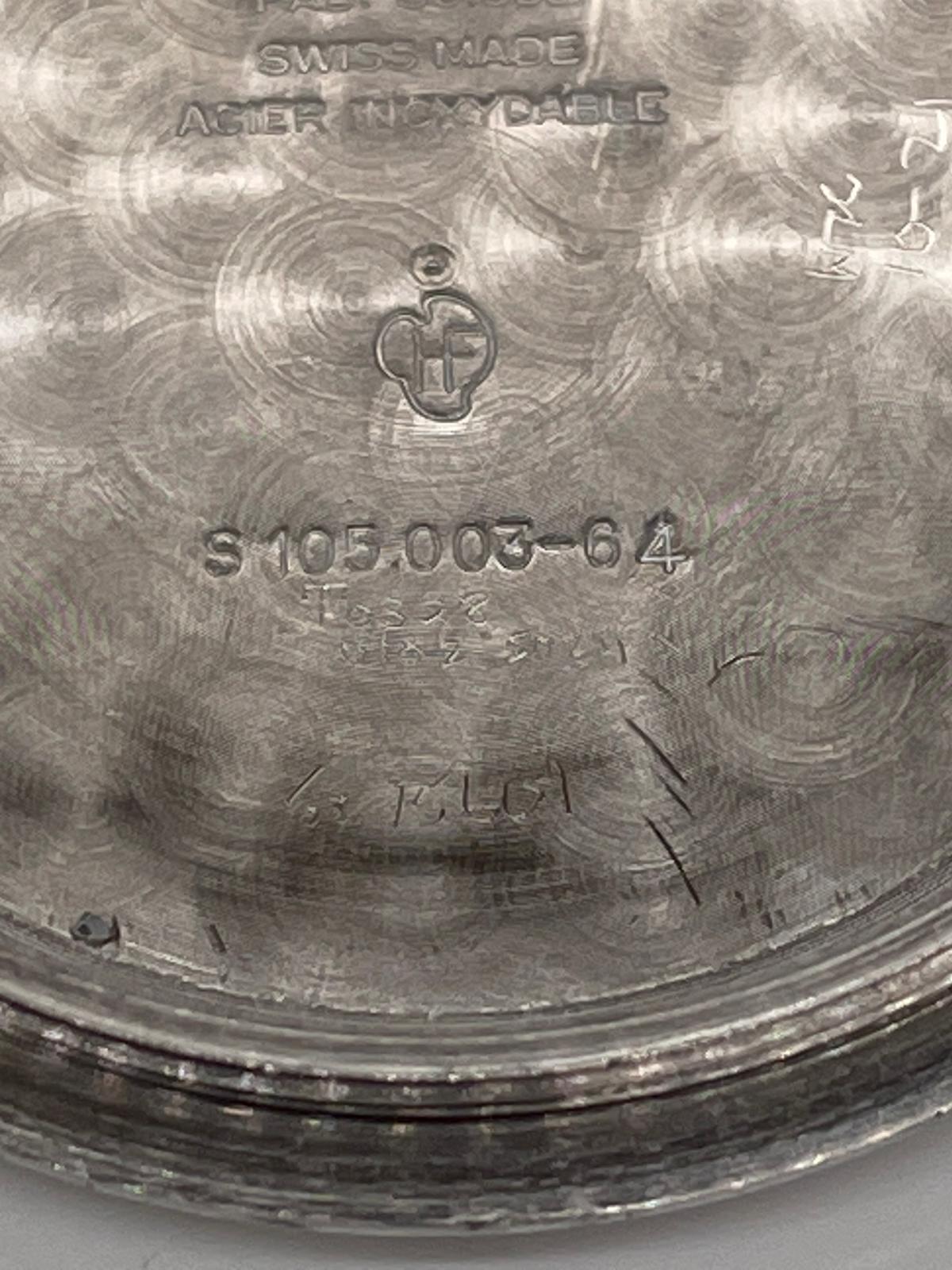

No way a -64 came with a 24m serial. My -65 is only 22.8m

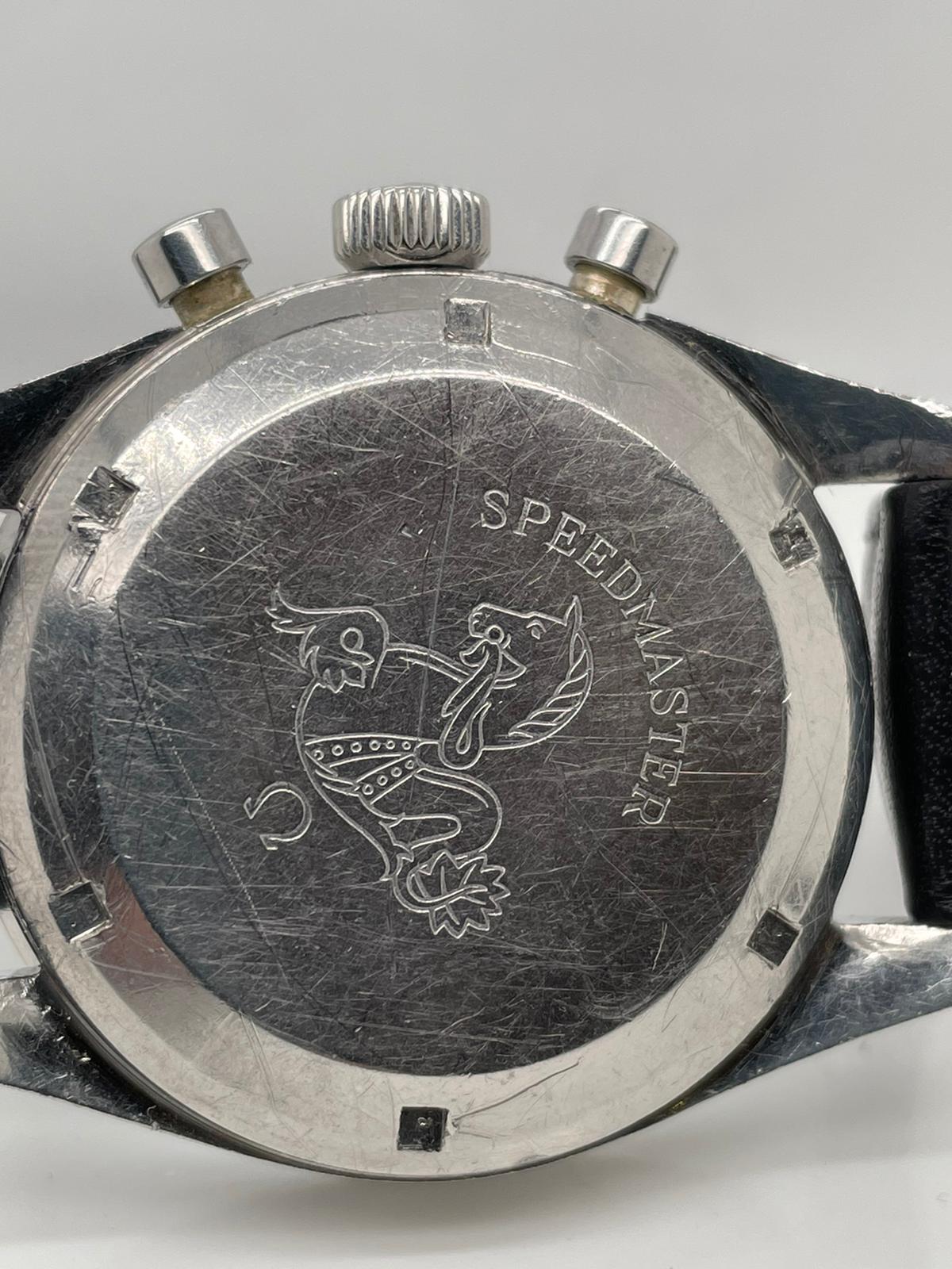

The caseback is 64 but the movement is a November 66
Your caseback may be 65 but it doesn't mean the watch was made in 65.
The number on the caseback is when the caseback was manufactured not the watch.
You can only date a watch accurately from the movement.

But a -64 with serial 25mil can not be right. Thats why Omega museum rejected your request.

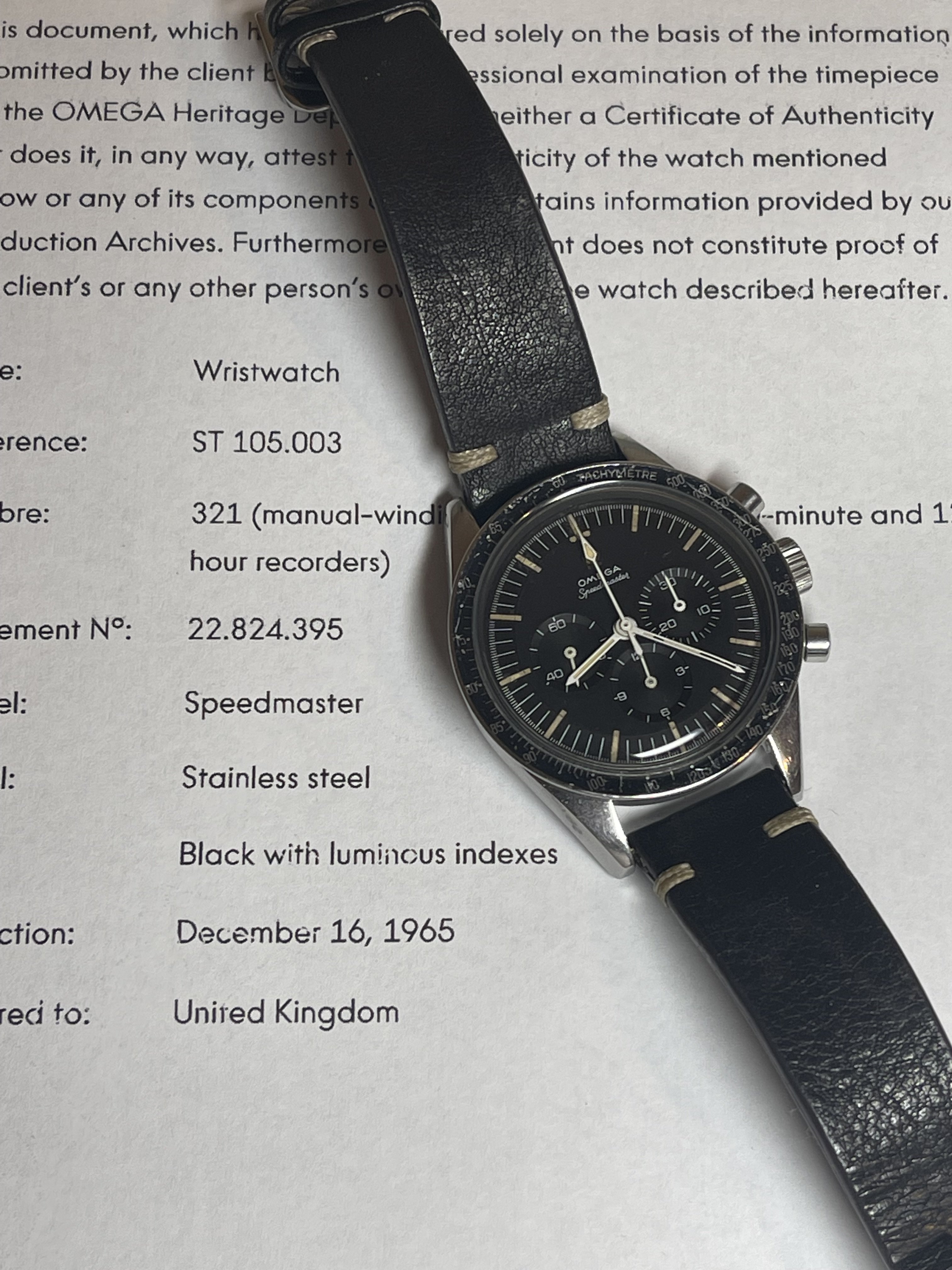

I know when my watch was manufactured, April 1966. The extract says so. I say again there is no way a -64 Ed White left the factory with a 24m serial. Ergo the movement or caseback has been changed. The lugs look like 64 lugs so my money is on the movement. And the EOA refusal suggests this too.
ps you state above that the 321 was used by several manufacturers. Not so. If it was marked Omega 321 it was only seen in a few Omega models. Other manufactures have used the base Lemania 2310 (though not many) but those wont be marked Omega. VC and Patek have used 2310 derived movements so it wasn't exactly commonplace.
pps I wouldn't worry too much about annoying your dealer, he doesn't sound very honest or perhaps very knowledgeable.

Agree. My very late -65 (with extract) has a 24m serial.
No way an original -64 left the factory with a 25m serial movement. As stated this is very likely why the museum wouldn’t issue an extract as the serial didn’t match the reference.

You're right a 64 with a 24 million would not be right!
But the movement is November 66 which means the movement will be between 22.087-xxx and 26.554.xxx according to Moonwatch only book.Casebacks are not a guide to when the watch was assembled,as they are interchangeable and come from a parts bin!
A watch built in1966 with a reference 105.003 with a 24million movement is,on paper an Ed White.Again you are right a 64 would have the wrong movement no.

Casebacks were not fitted at random as you suggest, they were fitted sequentially as the watches were made, the -63 iteration during ~1964, the -64 during 1965 or thereabouts and the -65 from early 1966 to 1969. I suggest you read up on the differences between the -64 and -65 cases with particular regard to the lugs. They were made by different subcontractors and are noticeably different. The one you show has -64 tell tales and is missing the -65 bevels. Casebacks very much are a guide to when the watch was assembled, just not a direct year for year correlation.
