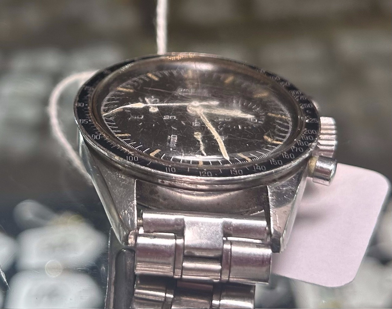

So this one that I followed is an Ed White, reference 105.003-64.
These don't come out so often, so I was thrilled when it came up!
The auction house was not so used to watches, and even wrote the wrong reference…

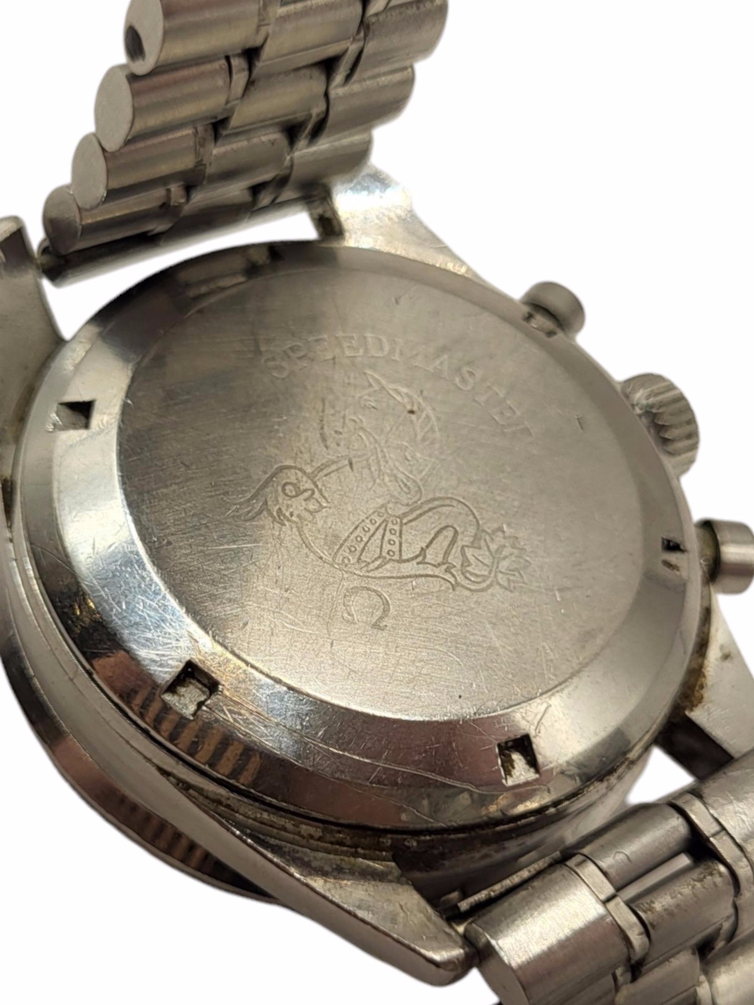

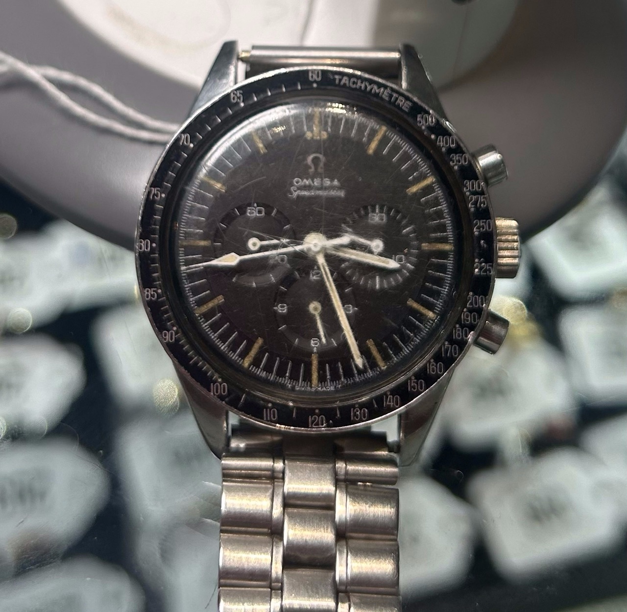

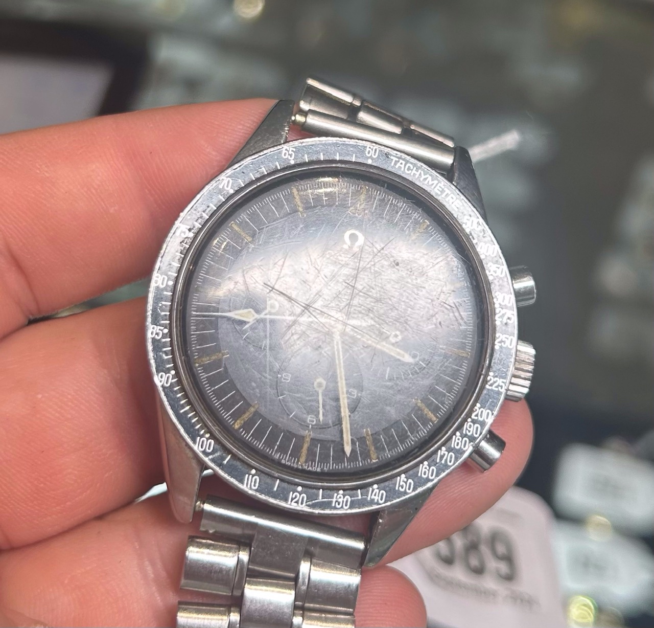

The pictures showed a very well used watch, and it was really dirty, calling @Seaborg !! (which is a good sign)!

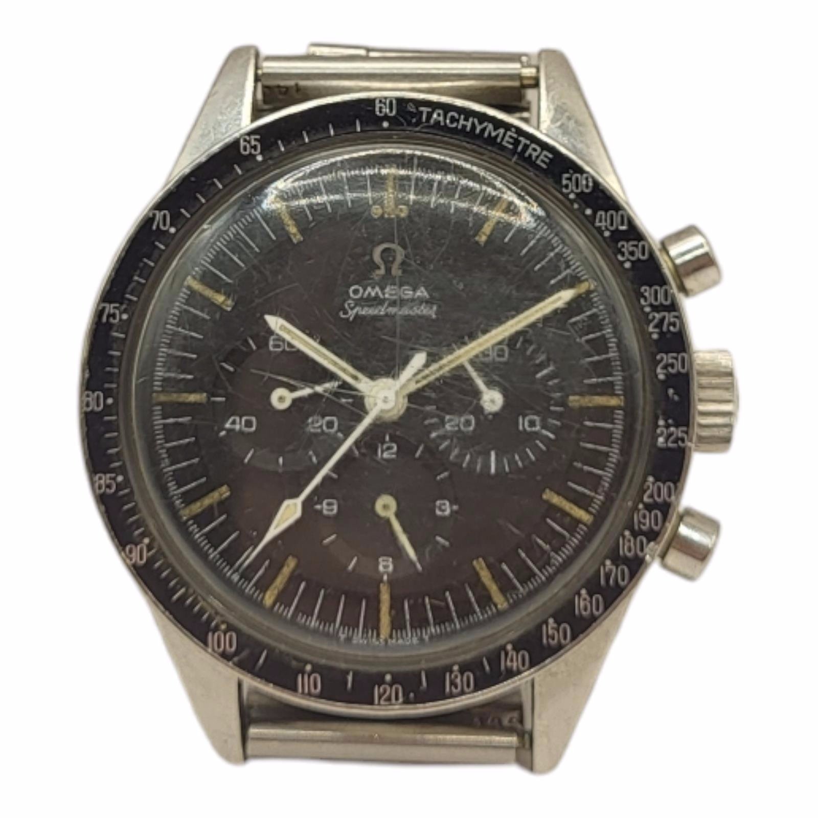

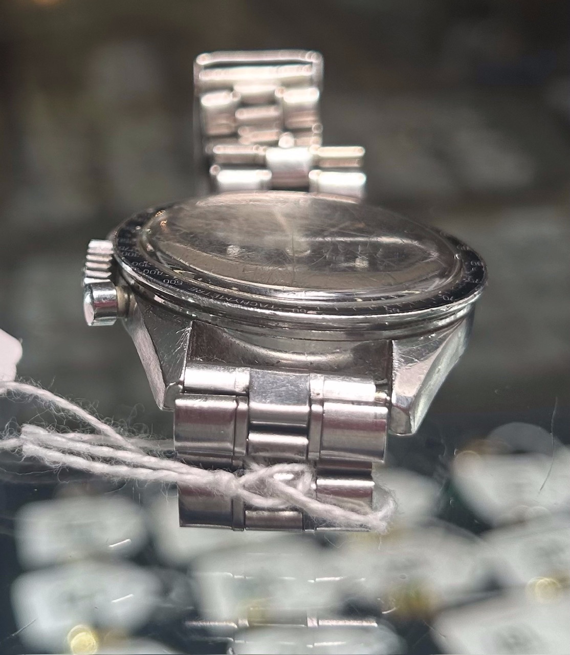

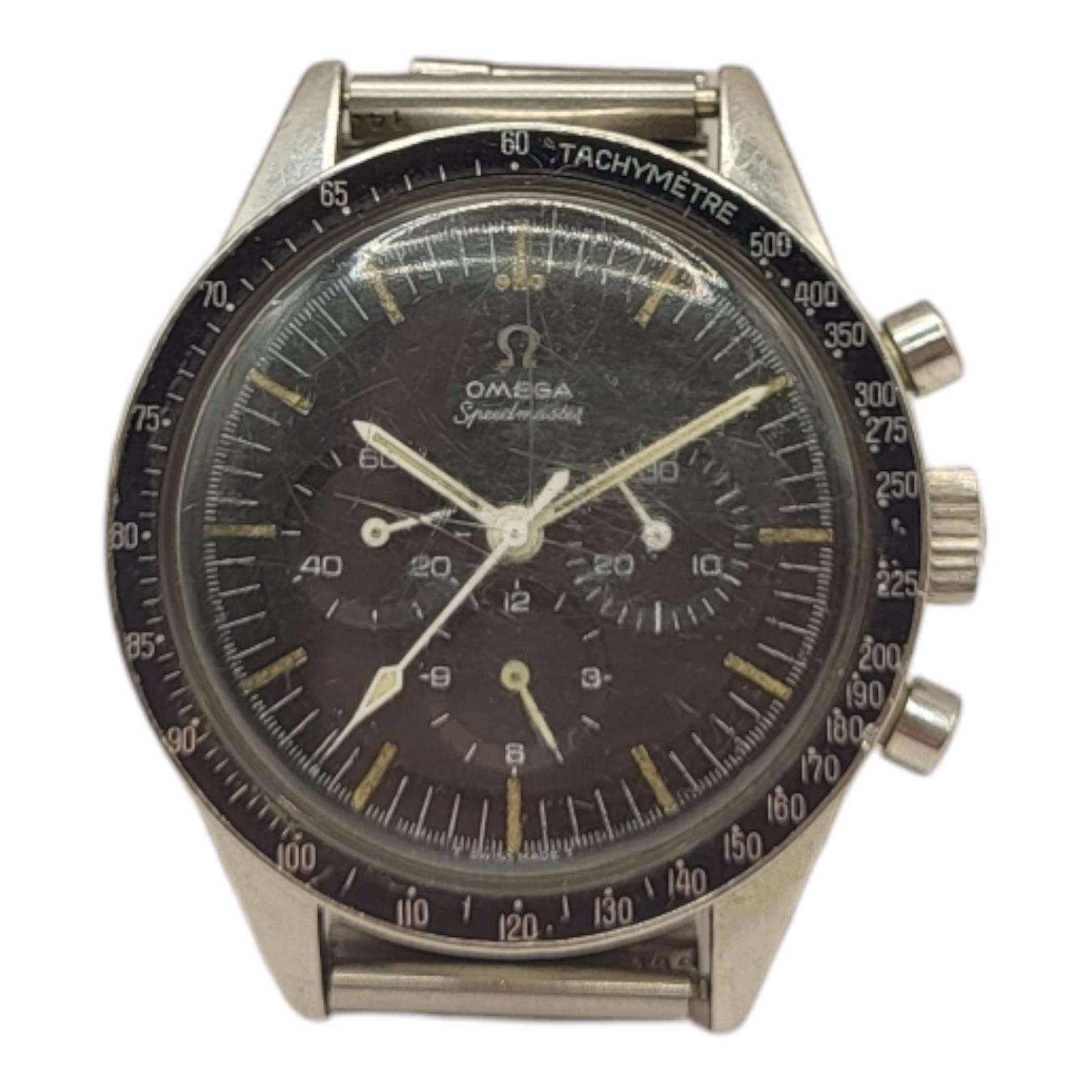

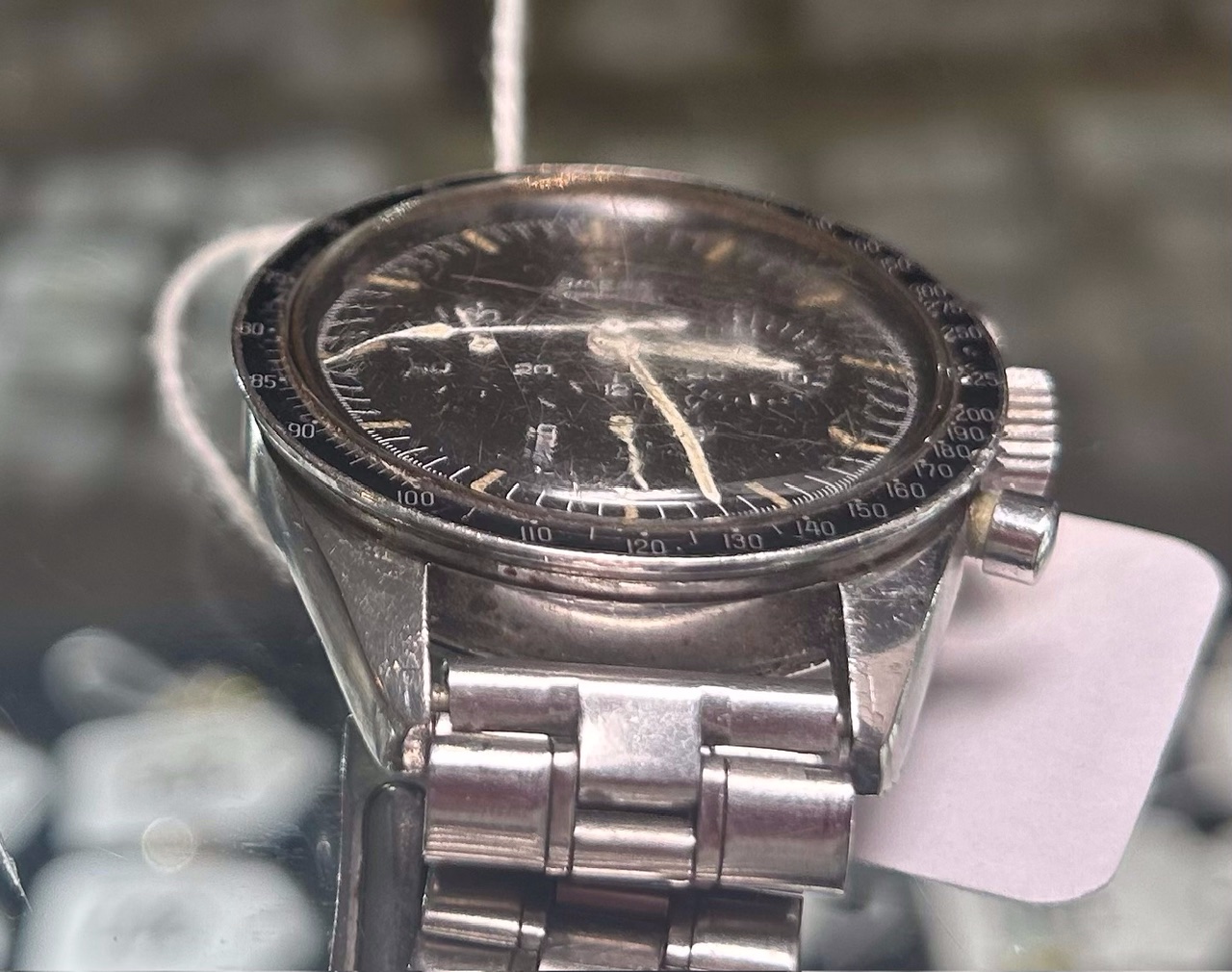

The crystal was very scratched, and trying to assess the quality of the dial was very hard.
I asked for more pictures, I received more, but not the best ones…..How hard is it to take a few nice hi-res pictures….!?🤦
No info regarding ownership or service.
The watch had an estimate at 4510€ /6050$ - 7510€/8400$ including the premium.

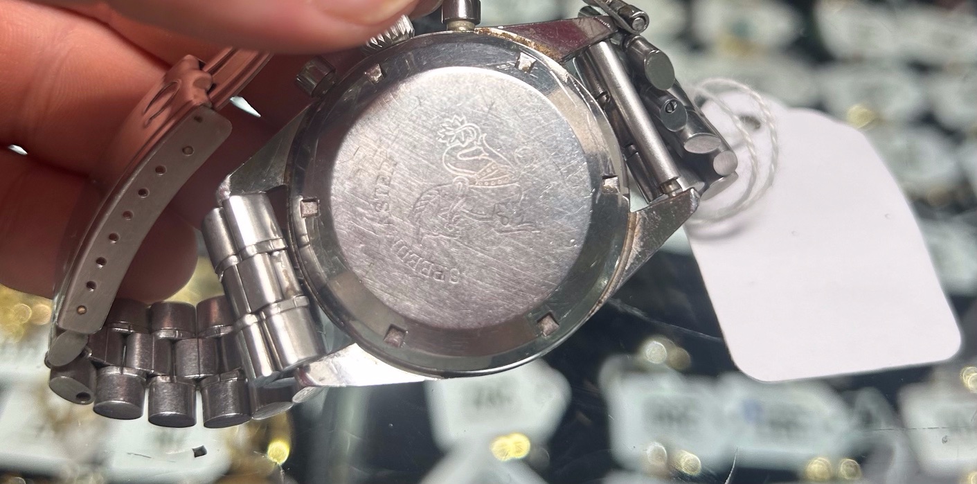

Serial nr 2208833 is correct for the reference.

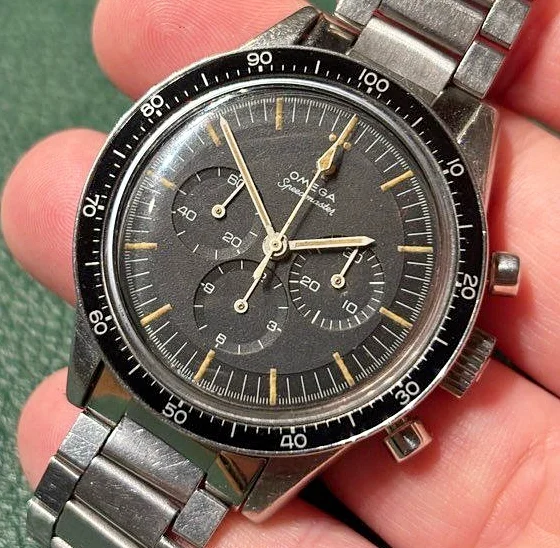

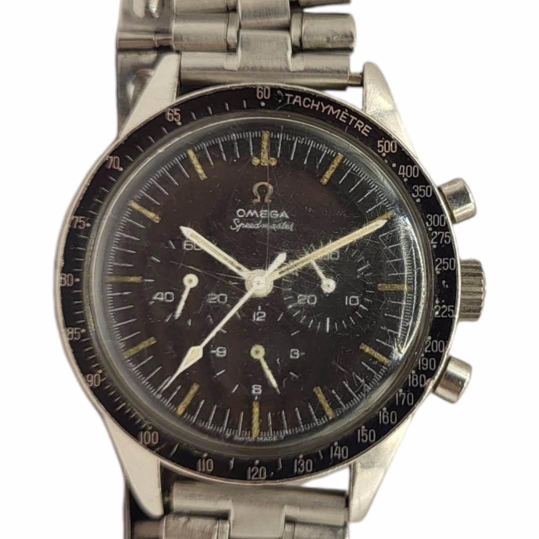

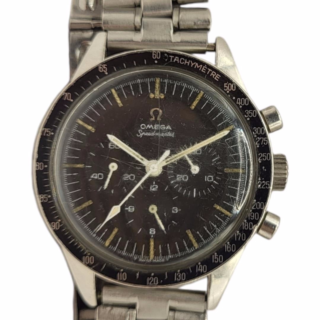

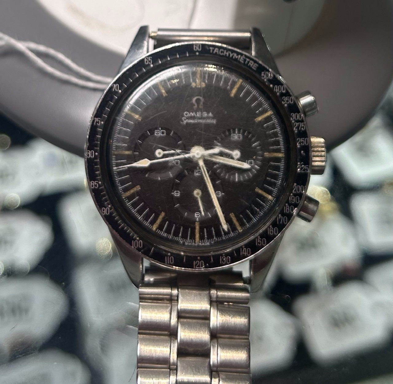

The dial has no Professional text and with close spaced T Swiss Made T at the bottom.
The condition of the dial was a bit hard to assess, but promising.
Impossible to see if the dial was fine, or if it had scratches, oil marks or other blemishes…
The lume looked complete, with a nice yellow color, some of them might have dirt or mold…
I would go for good on the dial and lume.
If in hand, with a loupe and good lights - it could be Very Good…?

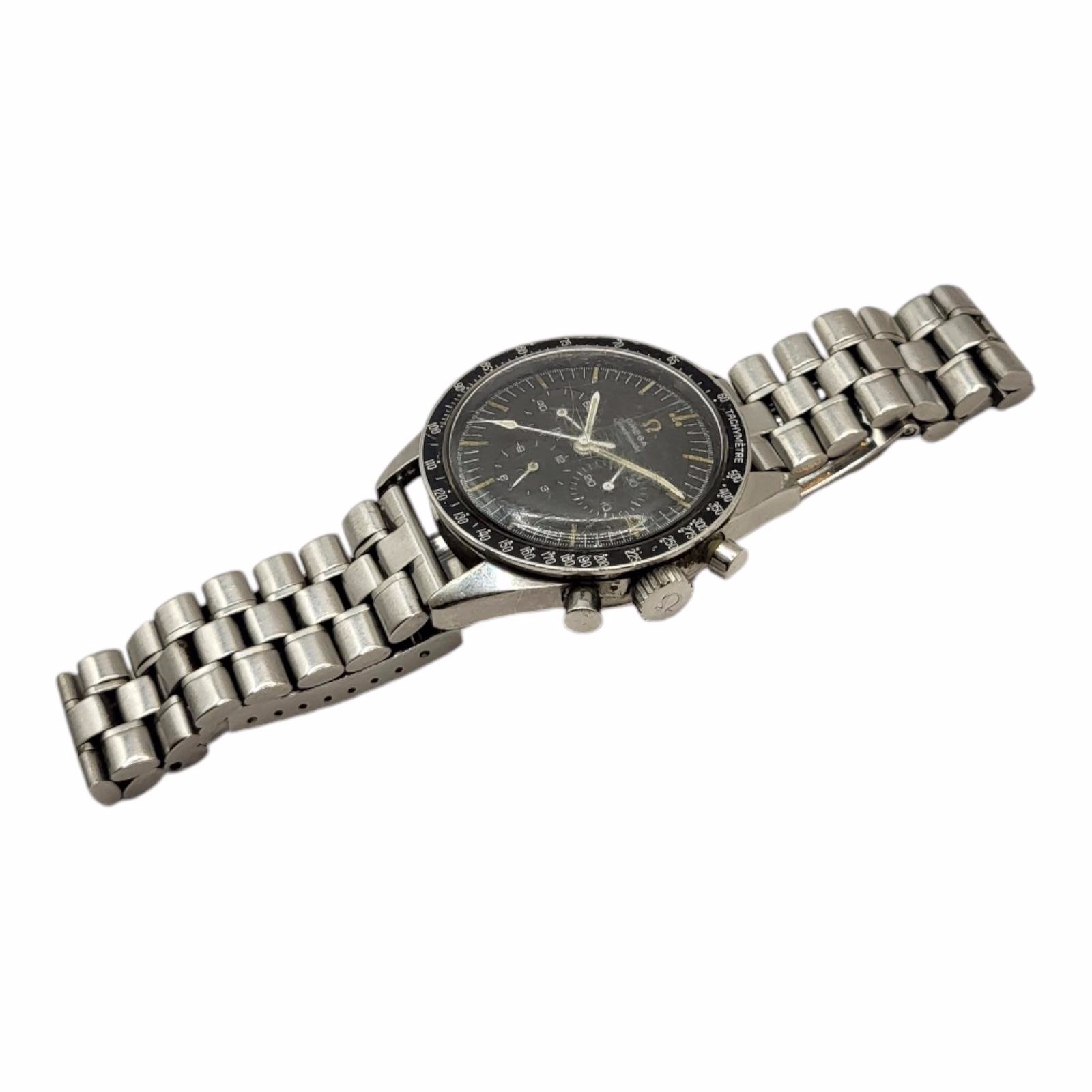

The hands seems to be original, with nice color and no lume loss.

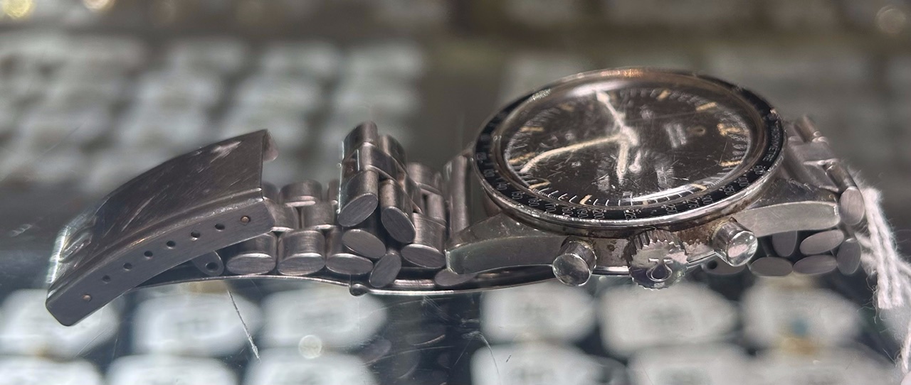

The bezel had a ding at the 80 marker and also above the T in Tachymetre, and some scratches all around…it fitted the rest of the watch.
So Fair for this one.

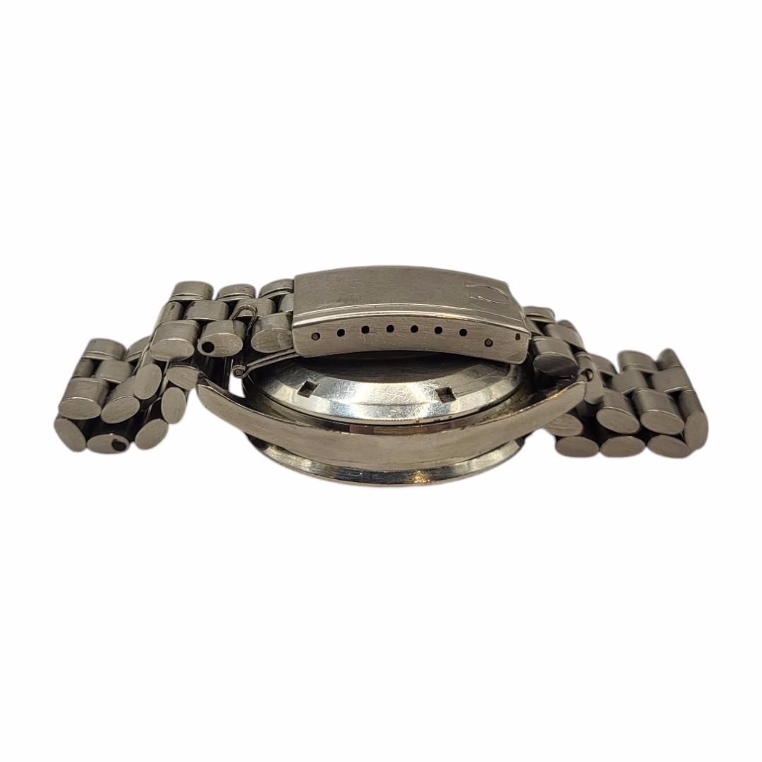

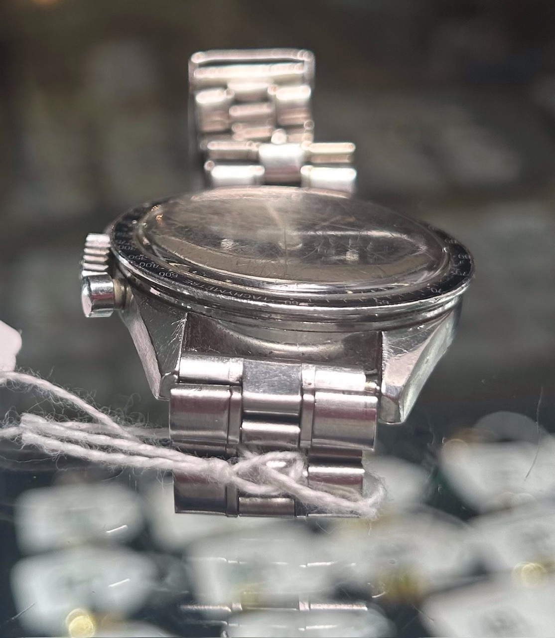

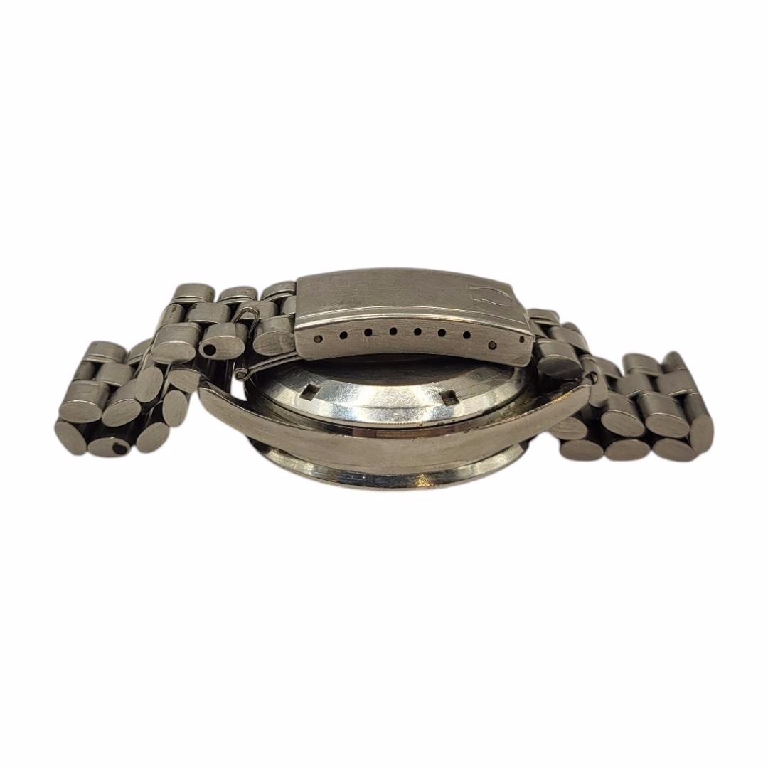

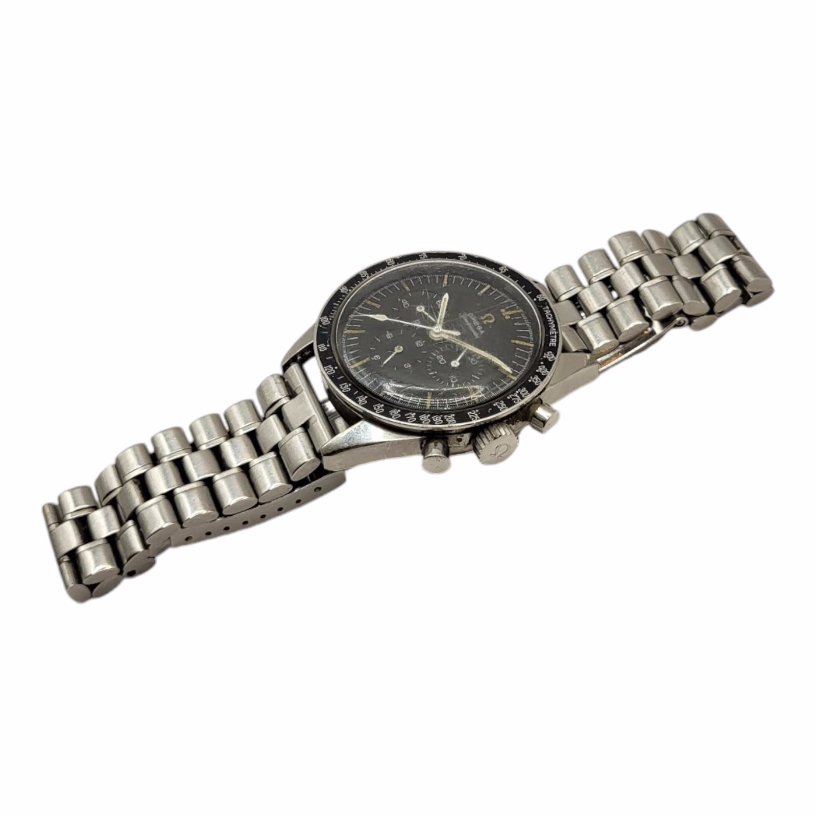

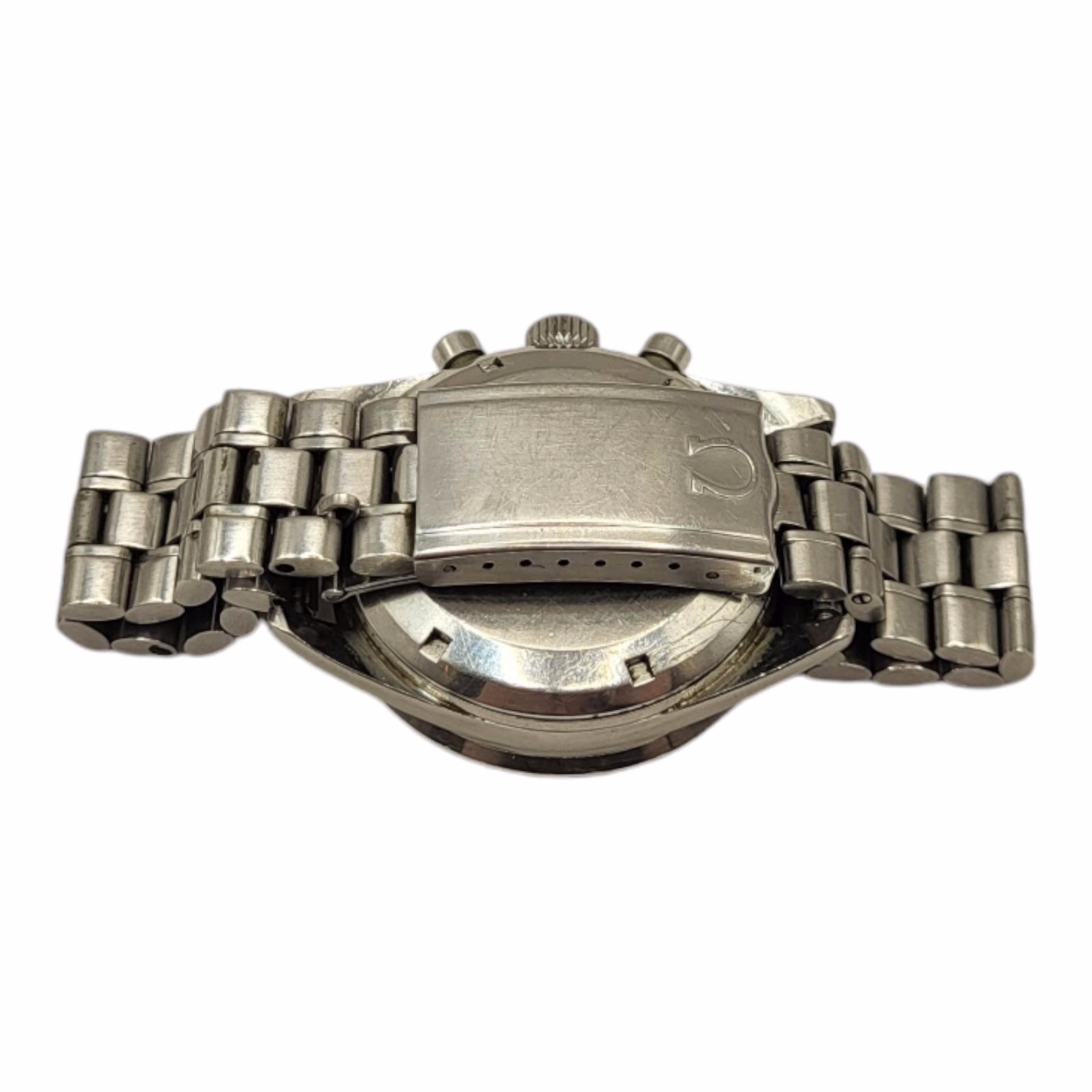

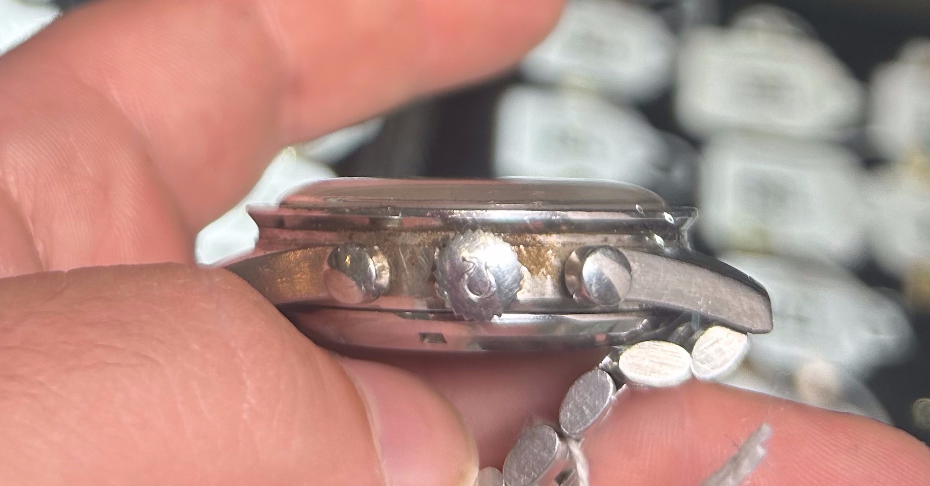

The case has lots of marks and dings, but with some slight brushing left.
It is really hard to see if it has had a polish….
And this is one of the harder parts to assess - Fair maybe or Good minus?

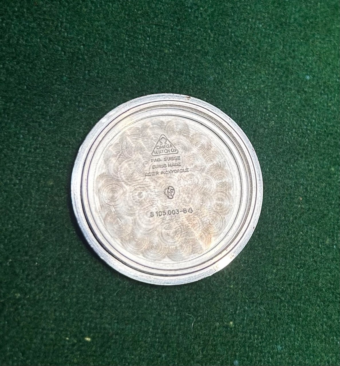

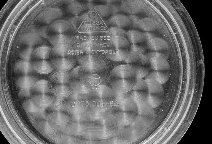

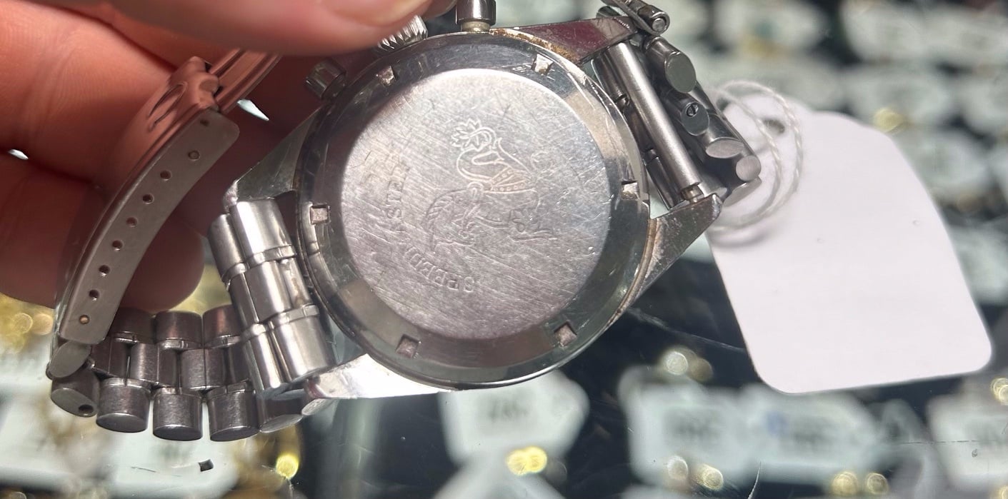

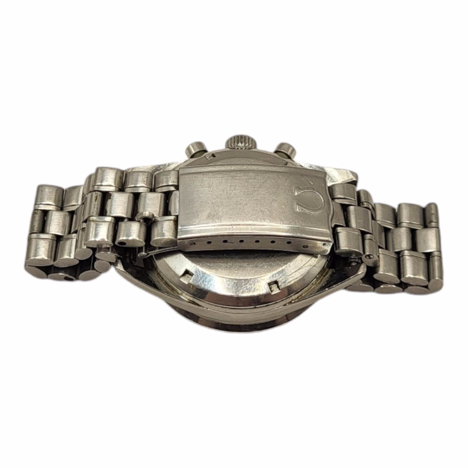

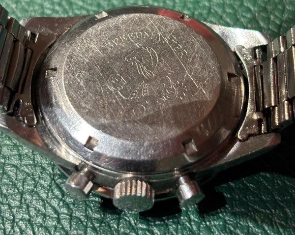

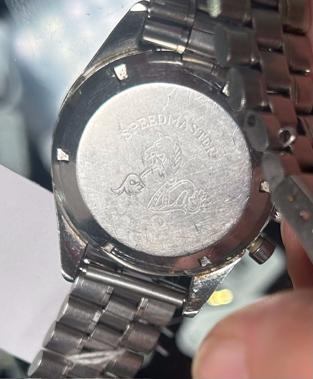

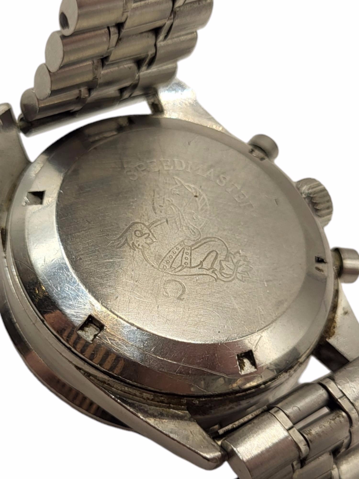

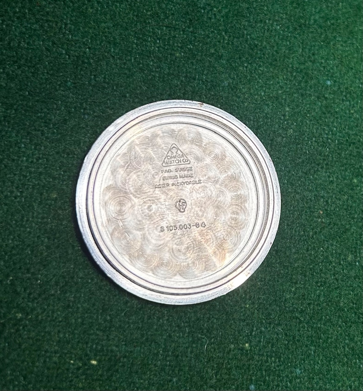

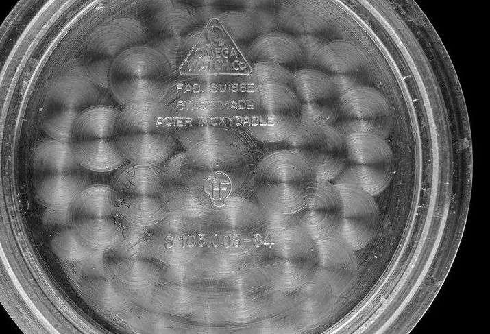

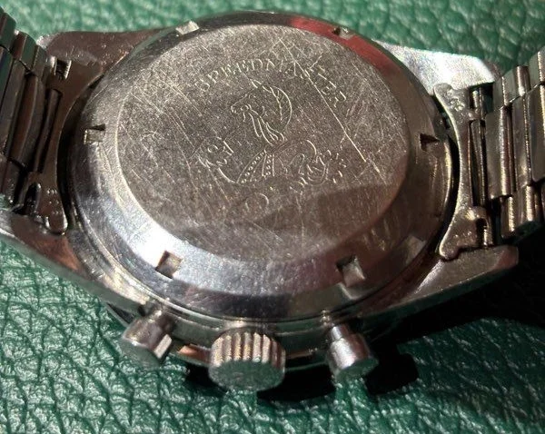

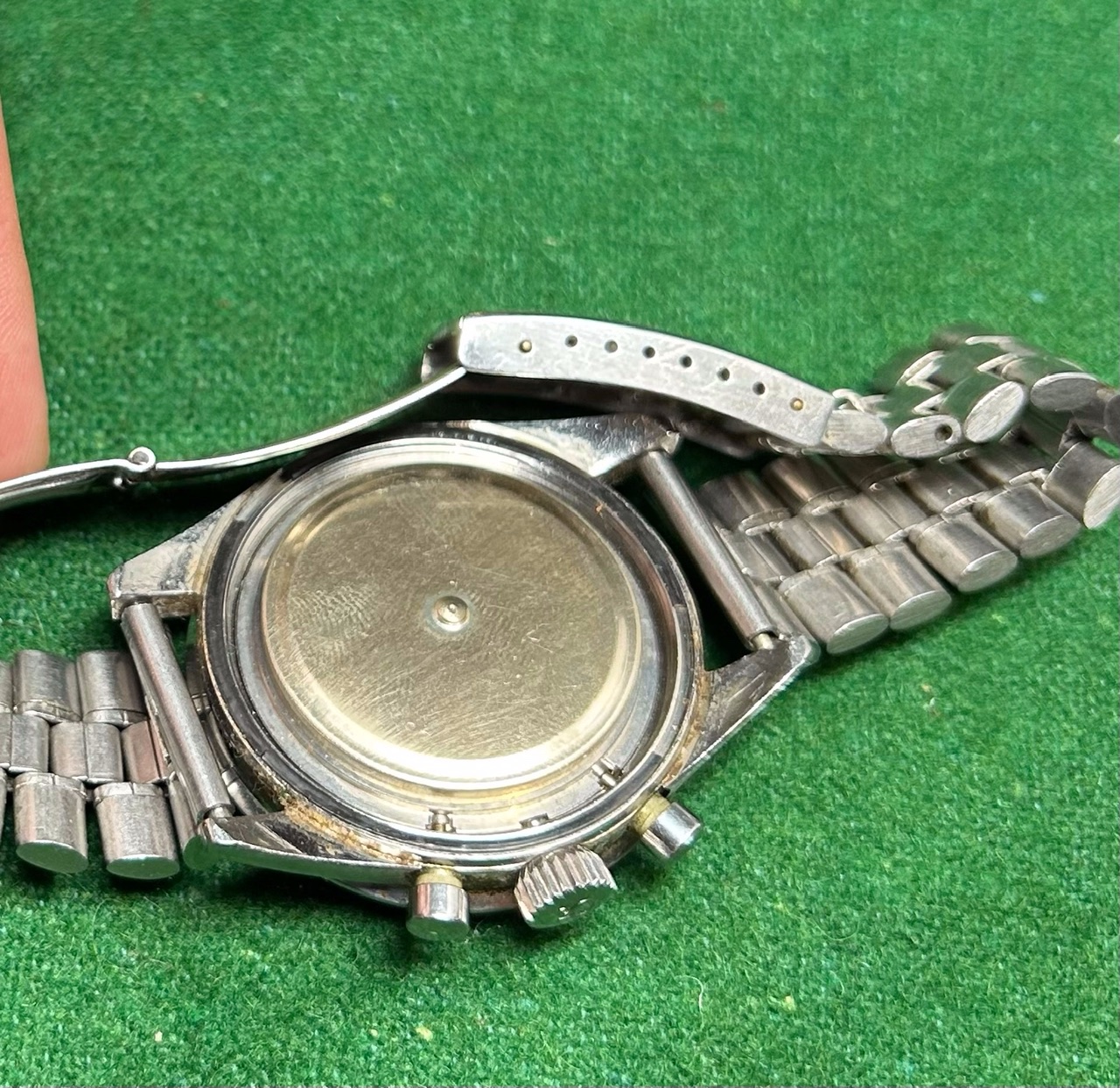

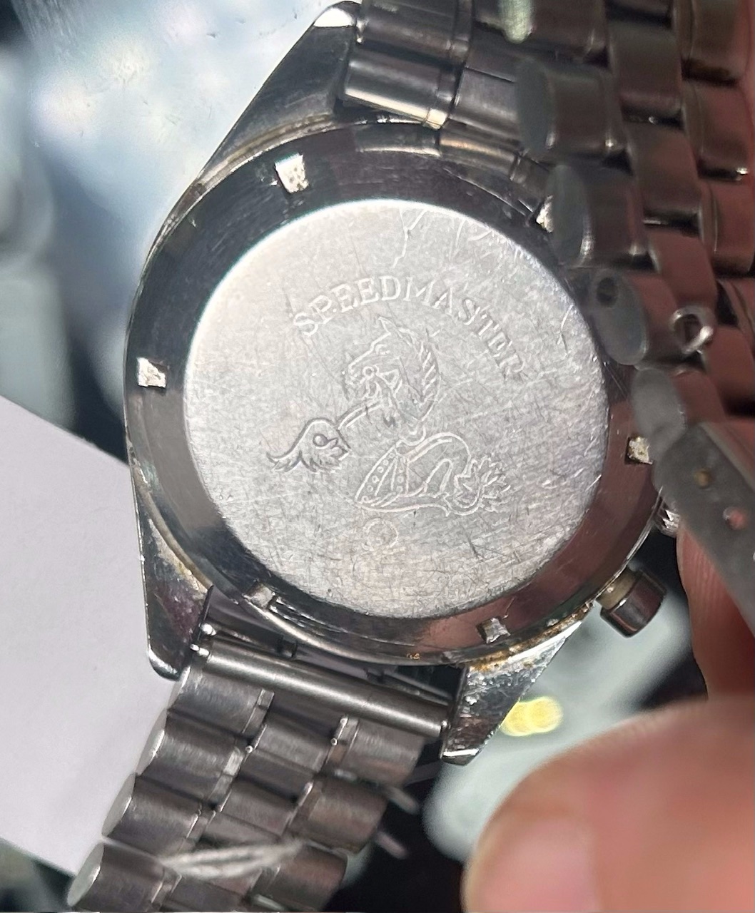

The case back looked nice, but it had 2 deep marks after an opening (it could have been the auction house…they look quite fresh…but a shame!)

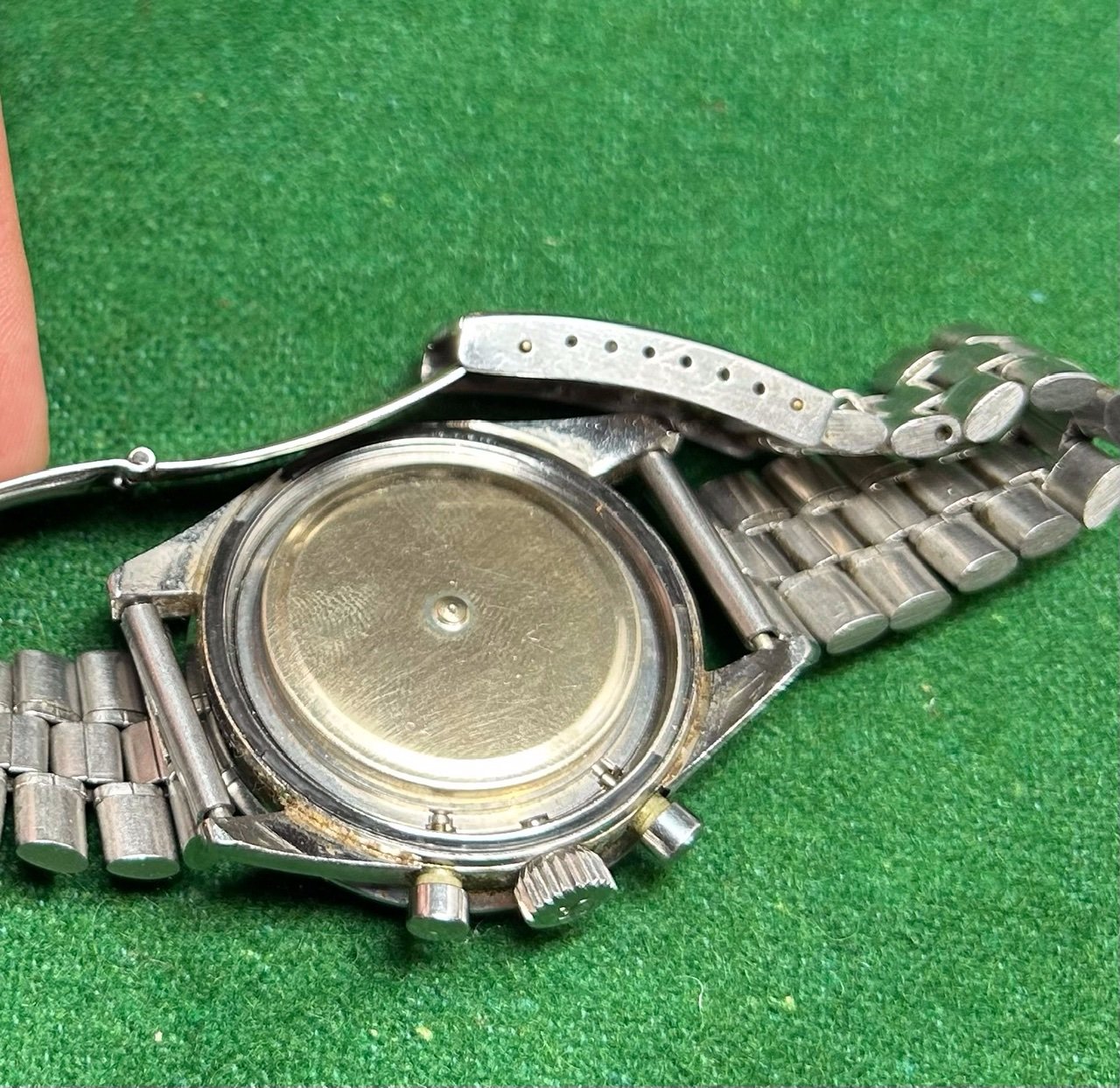

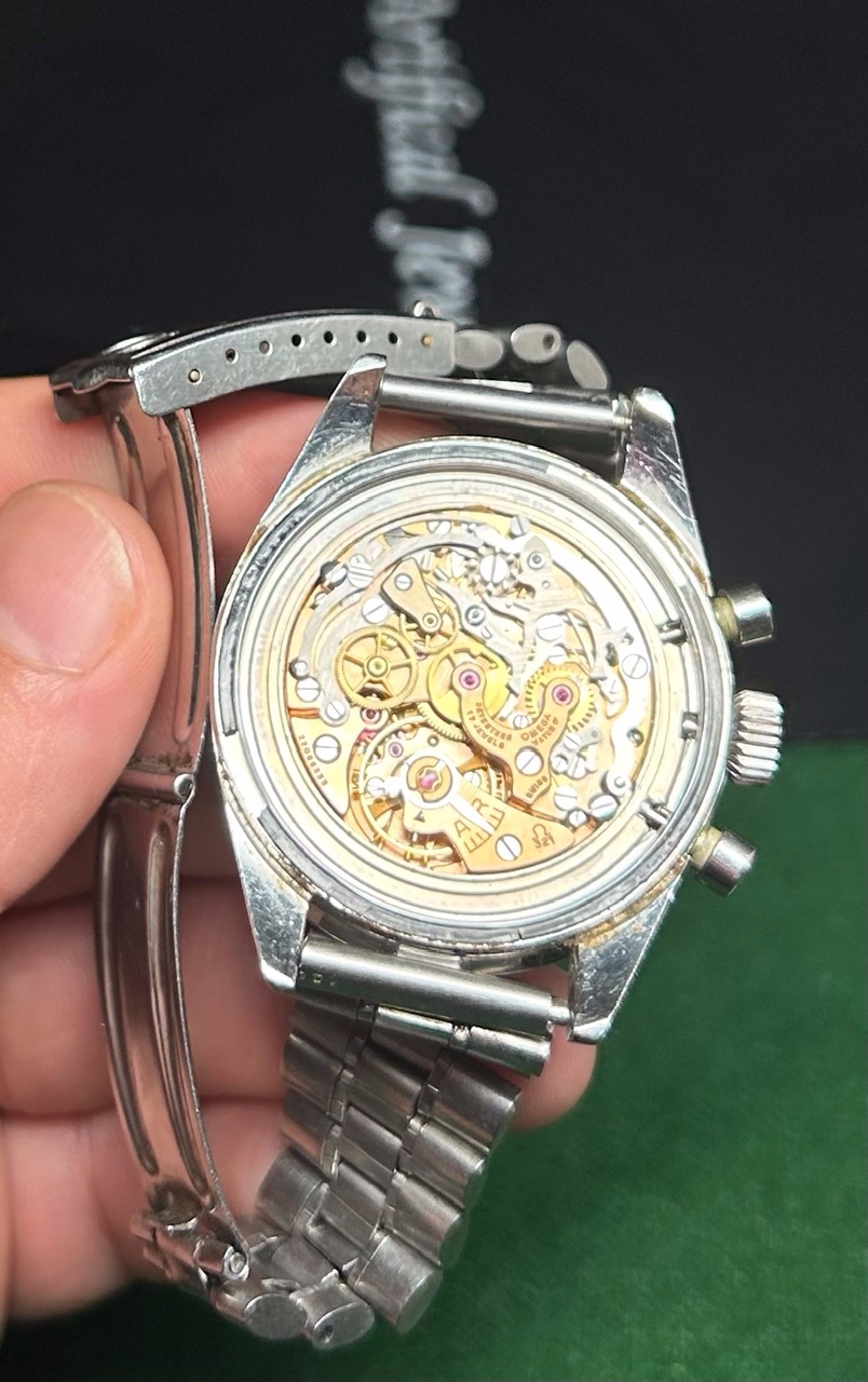

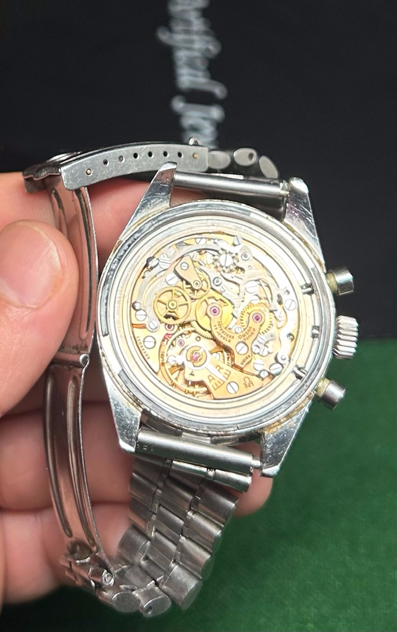

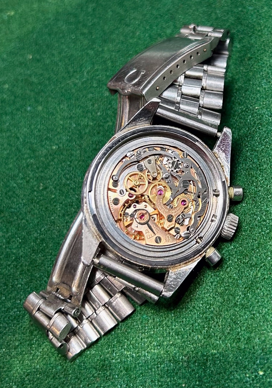

The movement was clean and nice, but in need for a service, no watchmaker marks,
and very hard to see if the screw heads had been worked on?

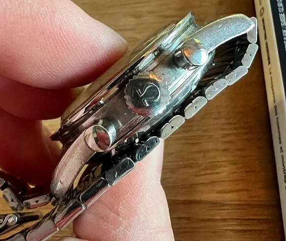

The crown was correct, and the pushers looked old, so they could be original also.
Very nice!
Adding up everything above, and hoping for an honest, a one owner, non serviced watch - I did think that this one was the famous ”Barn Find”!!!

Dial looks dry, and dull. Perhaps a good body colour, perhaps clean, but the markers will always be dull.
The bezel, while DO90, is not an attractive one, being thicker font.
The case is interesting. It is flat sided, the way the late Tom Dick researched, and considered correct now for a -64. Despite considerable wear and light damage, the case retains original lines. Bracelet is without value.
While I think it was rich, I do not think it's a financial disaster.
It would still cost a lot more to have a watch with a better dial and bezel, and a case that is not so worn, on a 7912 bracelet.

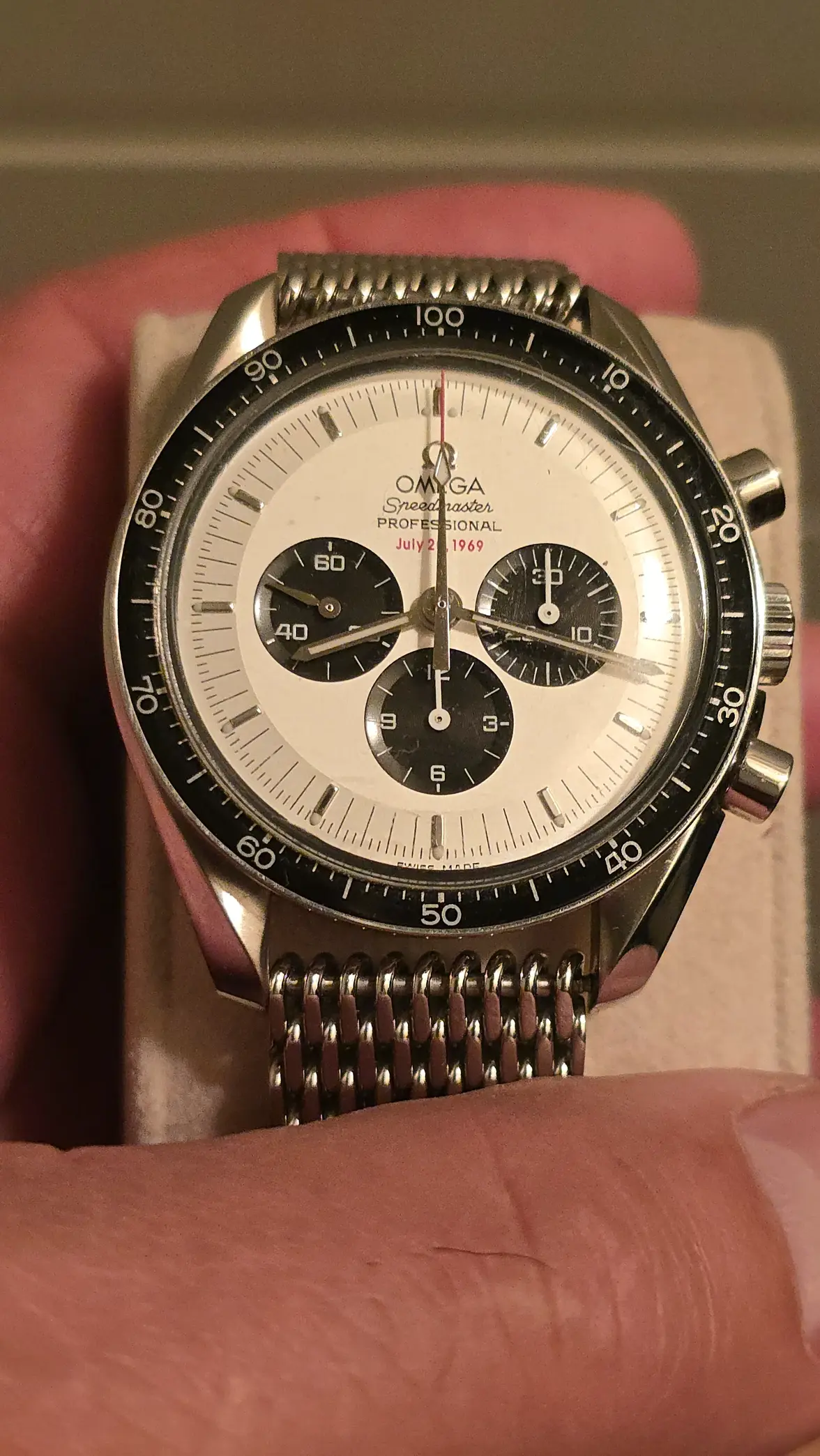

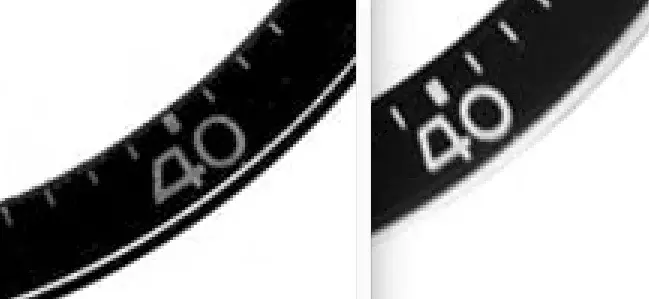

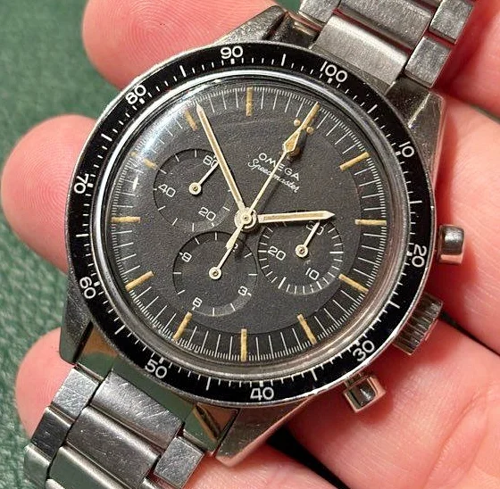

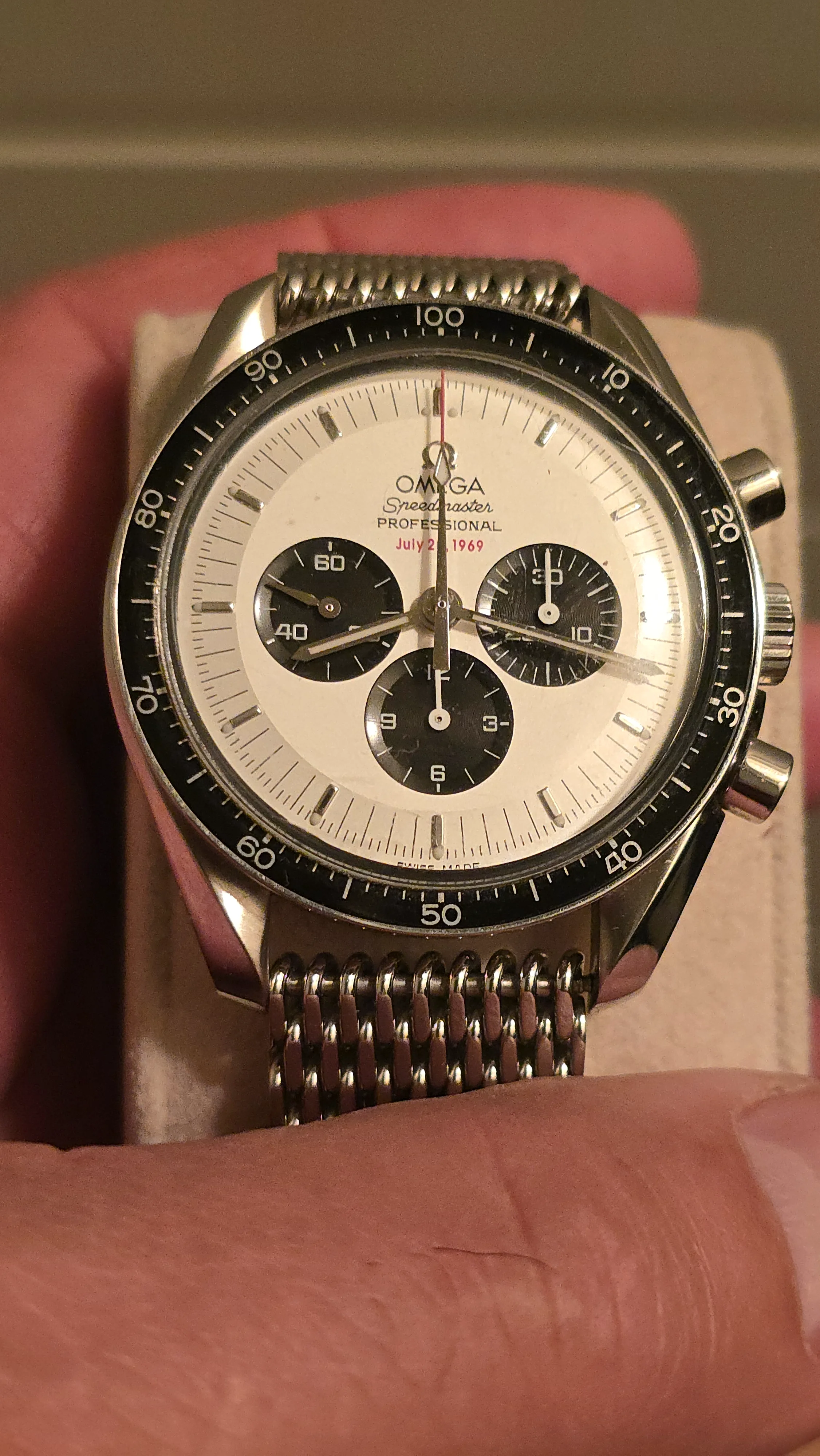

Hans, may I upload this one? seller claims: 105.003-64 18.xxx.xxxx
Comments welcome to train my eyes, esp. concerning the bezel...no pic of the movement. Merci, Jo
3,243
6,798

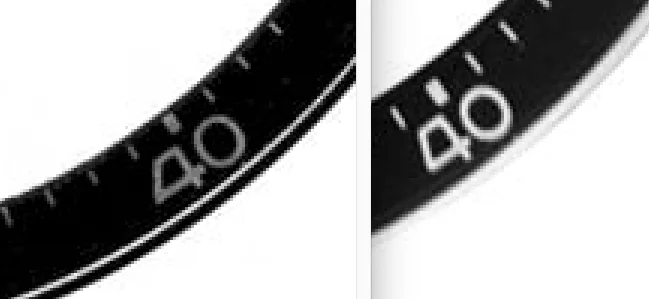

Hans, I looked at the 101-site first - thx for this link.
Thicker (blurry?) font on the service one???
2,629
5,911
TBH, I have a hard time comparing them....the fonts looks the same..
I thought that you could nail the bezel!
Erhmm..maybe some one here on the forum could help out?

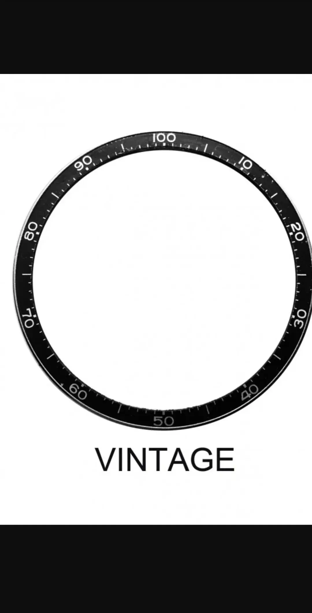

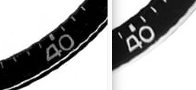

For what it's worth, this is a service bezel from Omega
Focus on the "4" in "40". The vintage is wider/stretched. I think the 105.003 has a service bezel.
2,629
5,911
Thanks Dave!
Learned something new today!
6,558
22,384
Thanks Dave!
Me too. Only just saw this after comparing your post to my watch.
33
43
Very similar to the difference in the 4's on the 105.012-65 MK1 and MK1.5 dials. "narrower" 4 has slightly longer leg as well.
