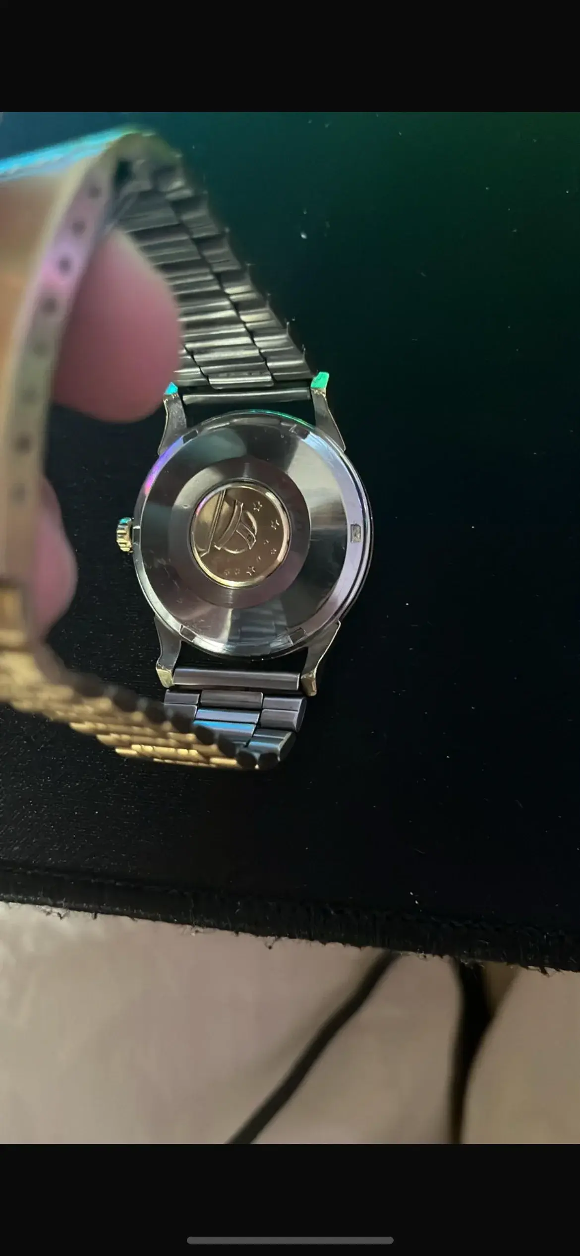

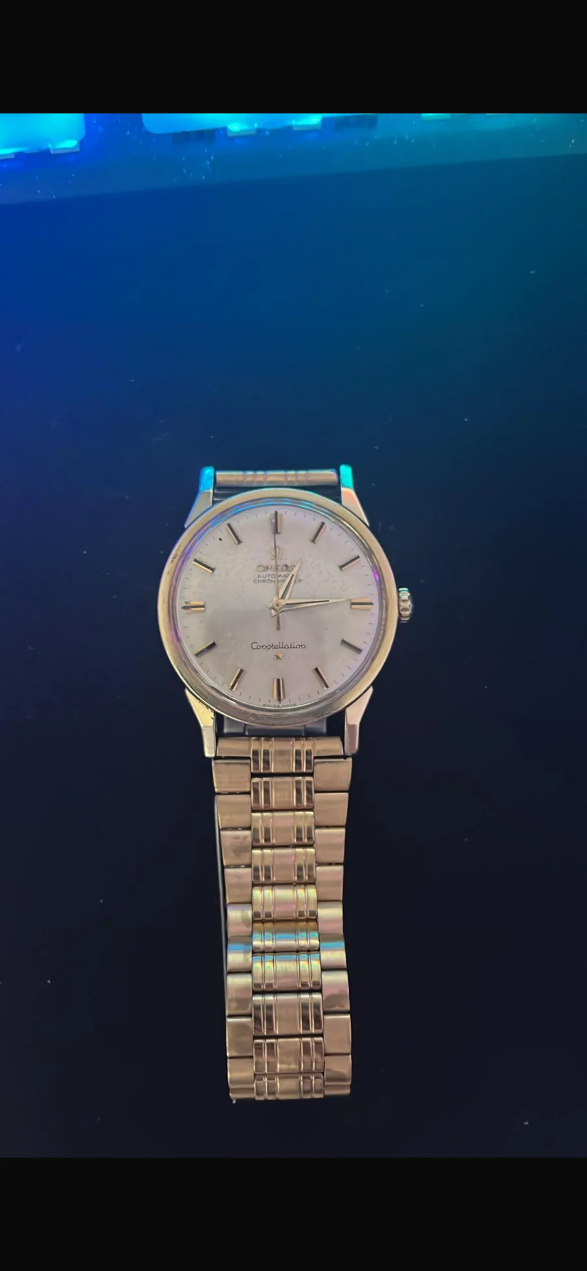

Hello,
a few years ago I inherited this Watch from my Grandfather. Now I got older and started putting Interest into watches, so i took it and tryed to get the exact Model, Blueprints because i got no Papers or a Box for the Watch.
The next thing is the condition of the watch.
So i would say the clockwork is fine. The clockhands are moving but the minute hand sometimes gets stuck at the "pins" on the dial and when i softly hit the watch it moves to the bottom. I know a perect diagnosis is not possible over this Forum, but maybe someone could help me with the model/blueprints and possible solutions and reparaton costs for the described problems.

The minute hand is getting stuck on the lower markers sometimes. It could be bent or misaligned on the pipe. Should be easily corrected when serviced.
3,786
6,442
It is a 14900 Constellation with dome dial, powered by a 551 movement. The hands have been replaced by shorter hands and the minute hand stuck at the markers then get loose.
You need to have the movement serviced and get the correct hands installed with correct clearance.
Good luck.
2,338
1,458
Sounds like minute is loose and drooping which is why it鈥檚 hitting the index. Why it drops to the bottom of the dial when hit.
Tube could be tightened
