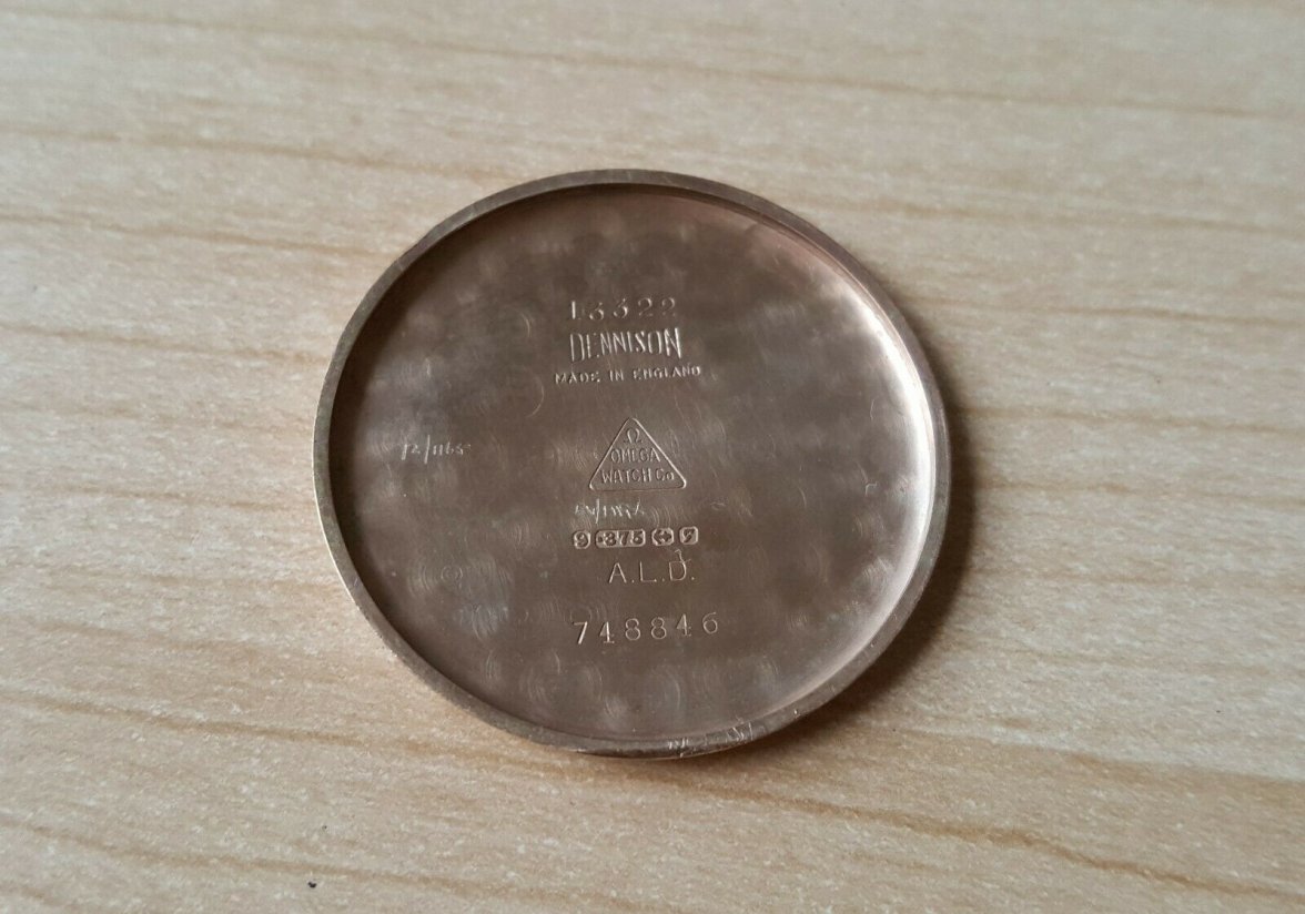

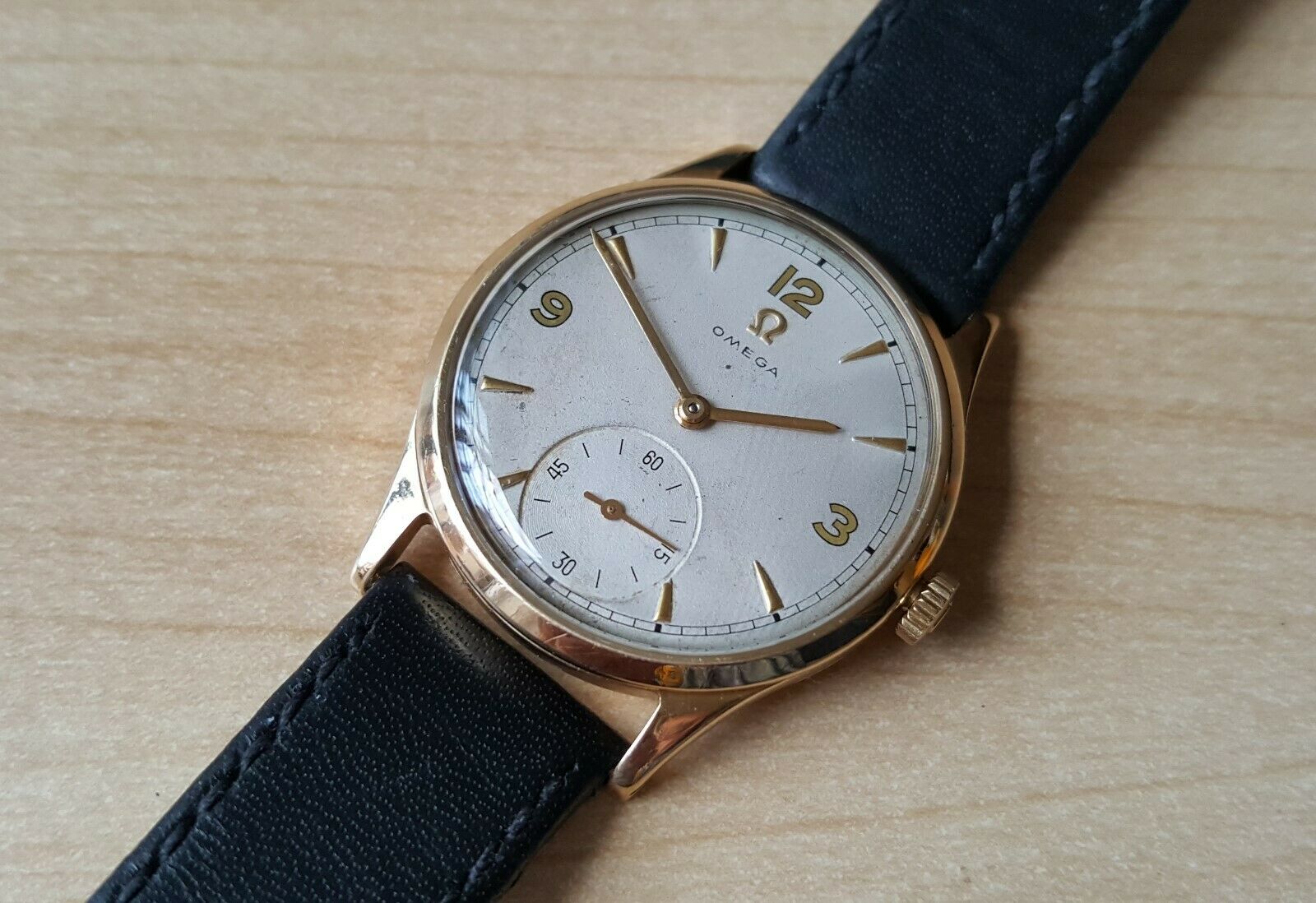

Greetings All,

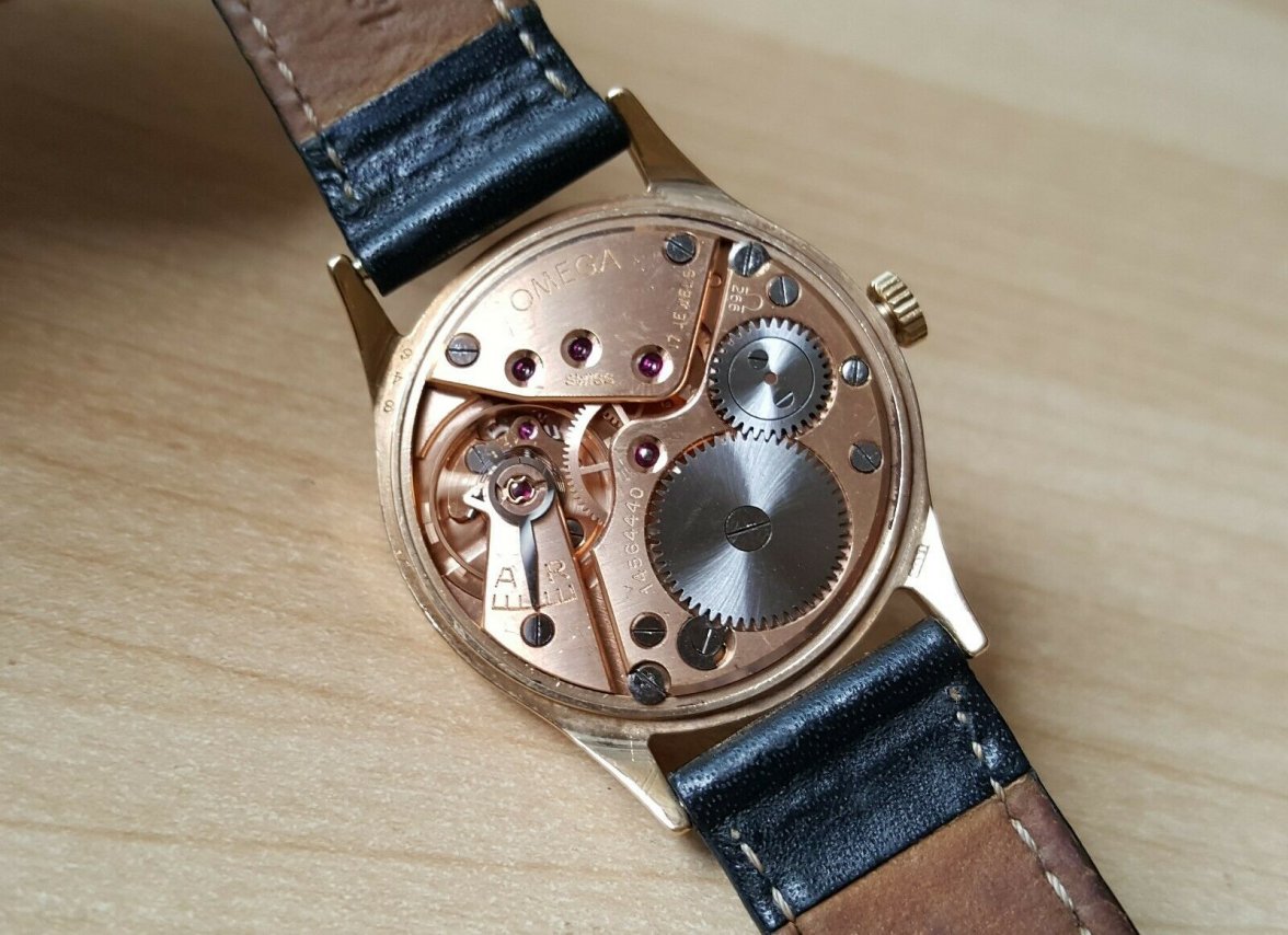

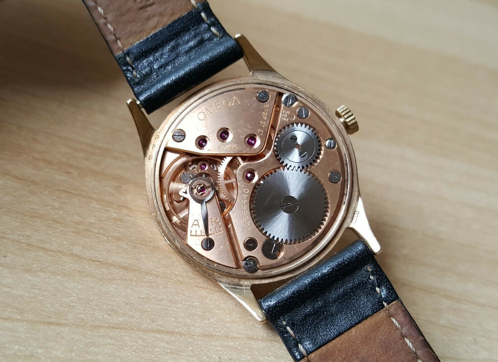

I am new to the forum - and new to vintage Omega.
I recently purchased a watch that was listed as a 1954 Omega (and I have no reason to doubt).
It has a cal. 266 movement.
I think the reference # should be 2800-something. It's almost identical to a 2800-2 (except that the 9-12-3 are not applied on mine, they are painted).

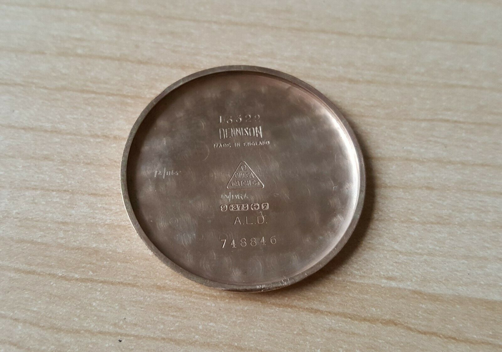

I believe it was cased in England. As it is in a Dennison case. 9 karat gold (.375)
It is in pretty nice condition overall considering the age of the watch and the movement looks to be very clean.

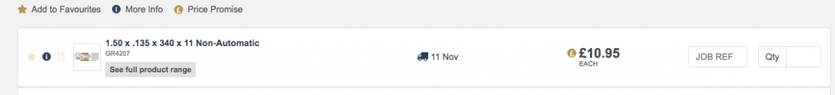

I would like to acquire a new mainspring for it - and give it a basic service. As, I don't know the service history.
What I am having trouble with is, identifying a correct replacement. I tried using the search feature in this forum, but was unable to find anything that helped. I also looked through the "sticky" posts - but didn't find it there either.
I was hoping to source a new mainspring prior to opening the barrel.
Can anyone tell me the correct specifications for a cal 266 Mainspring?
Any help is greatly appreciated.
Here are a few pics of the watch...

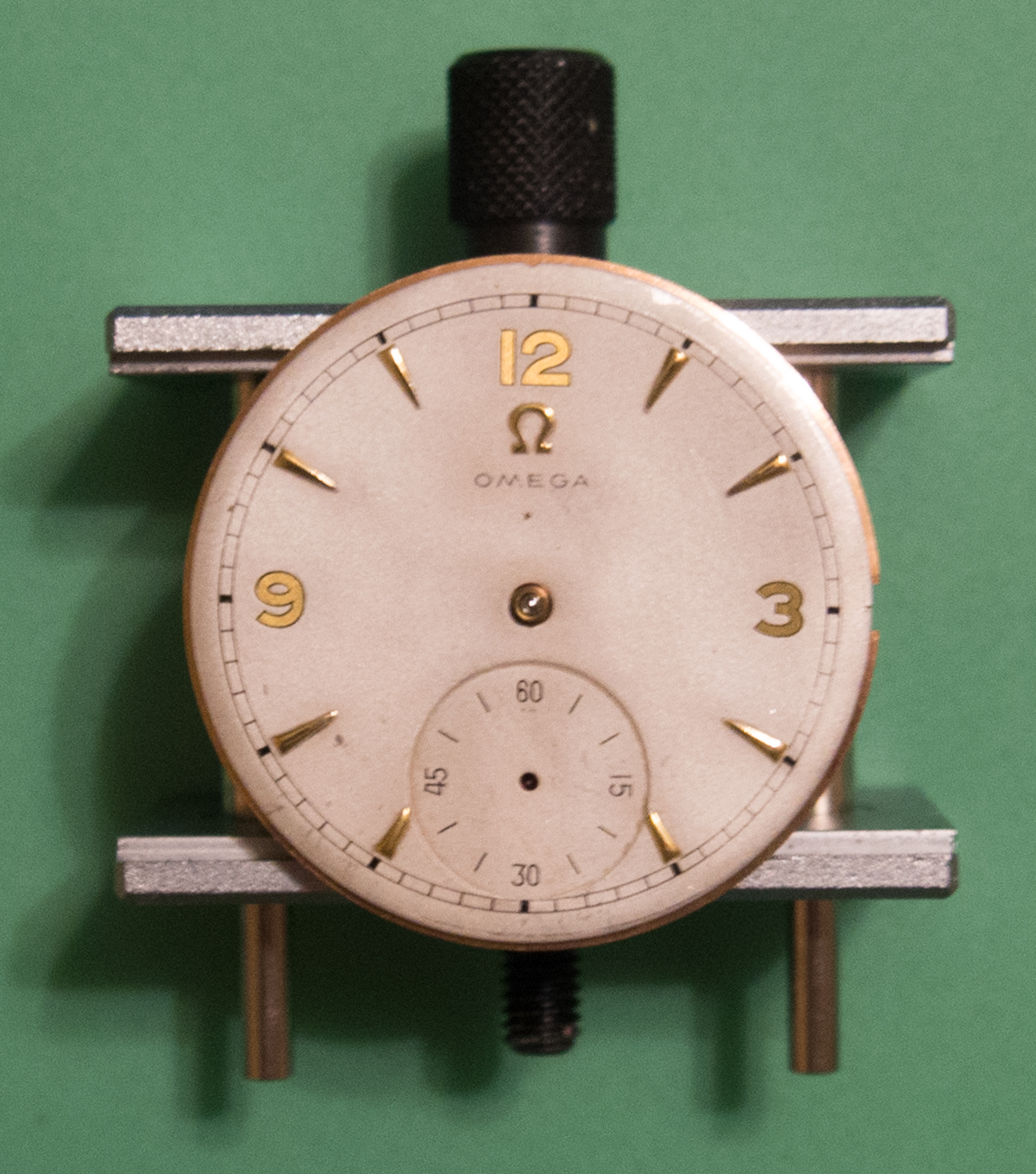

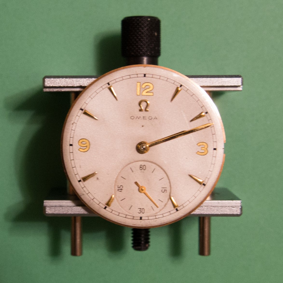

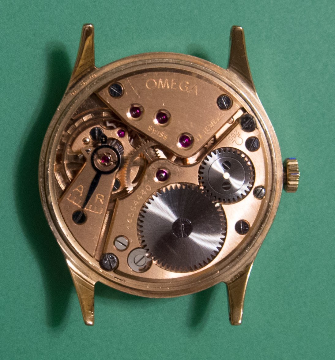

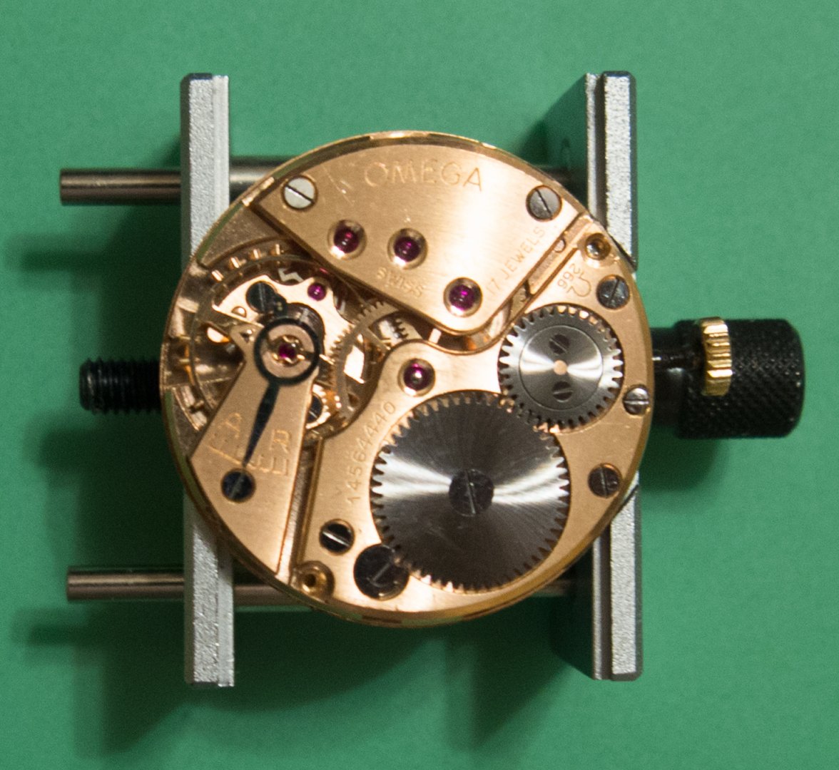

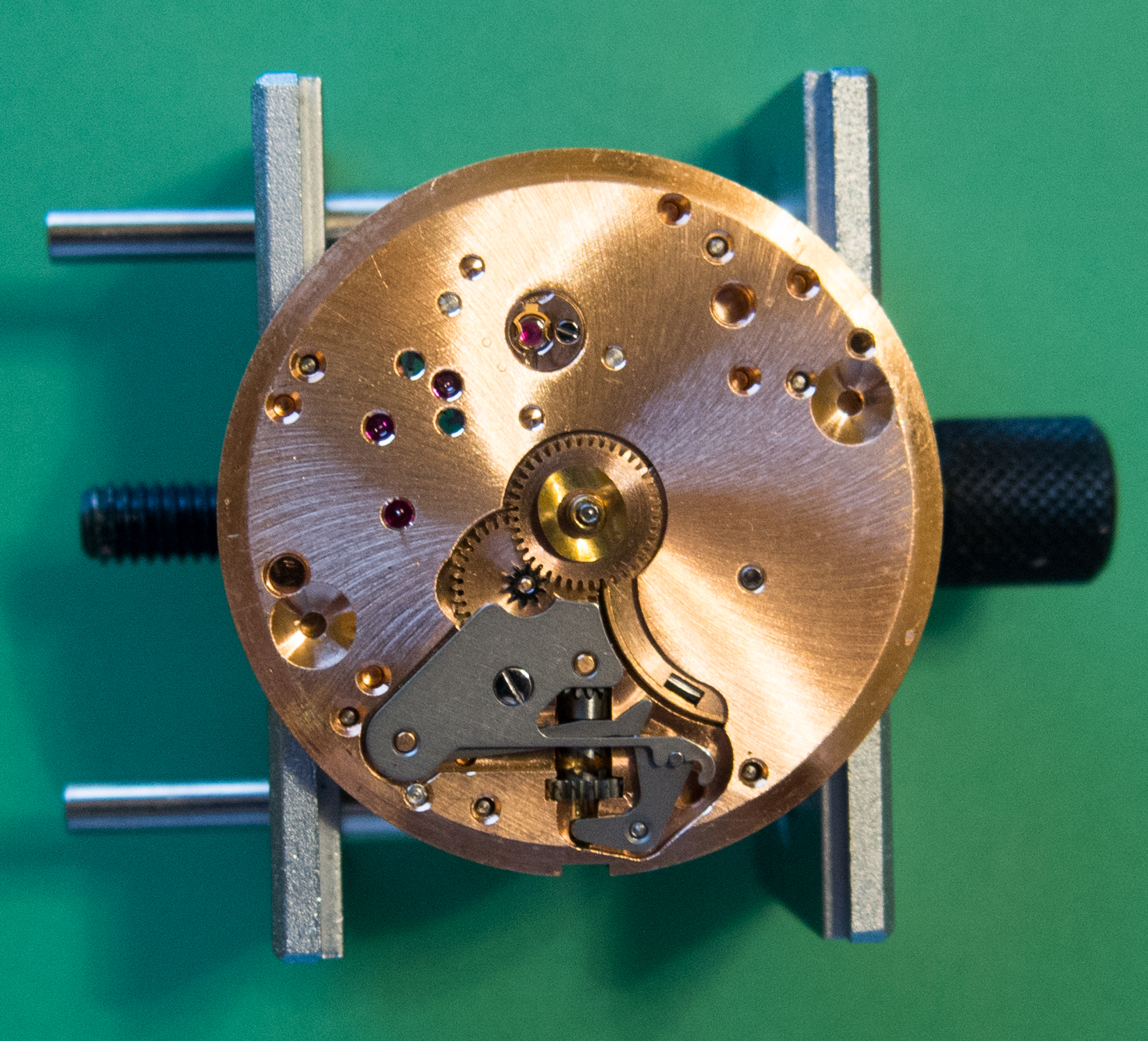

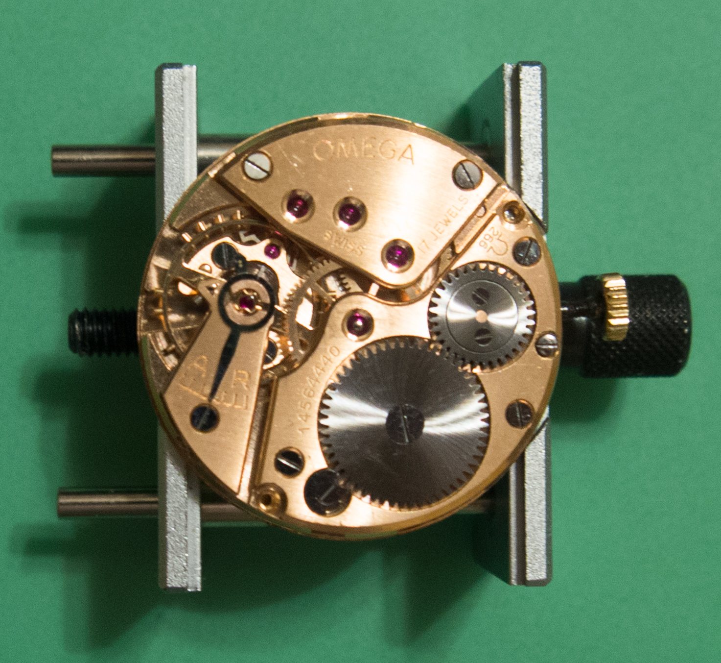

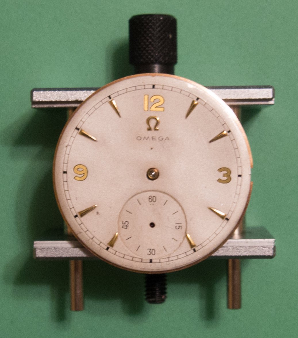

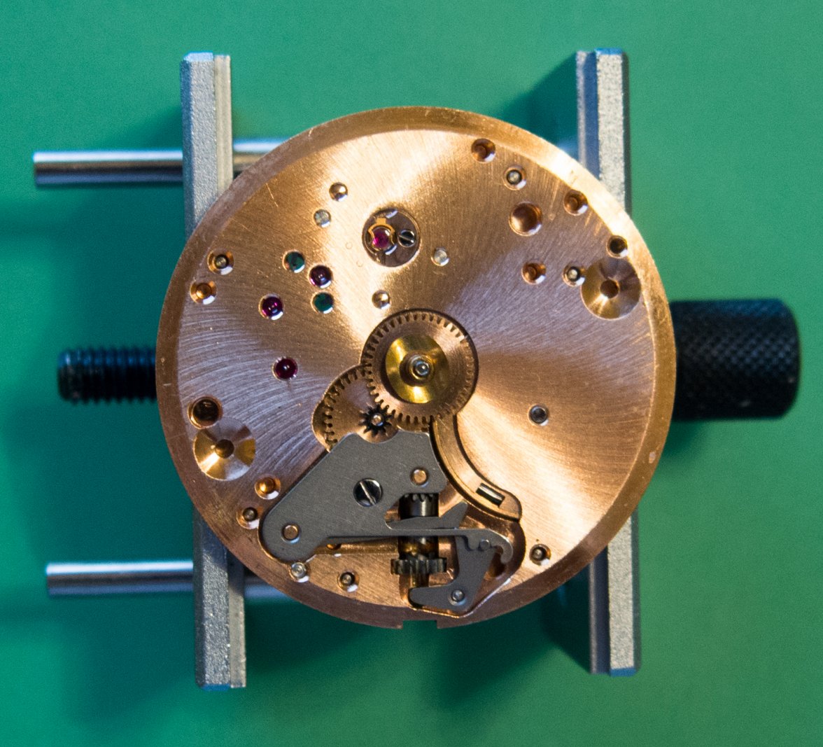

Okay, not a lot of work (or pictures) from yesterday, but here are a few to get started...
Just opened up...
KA5ybcqzgztgbcus9
Out of the case...
vomdRN3zVaaagtQR8
Getting ready to remove the hands...
2A8baGHUjch5UQV5A

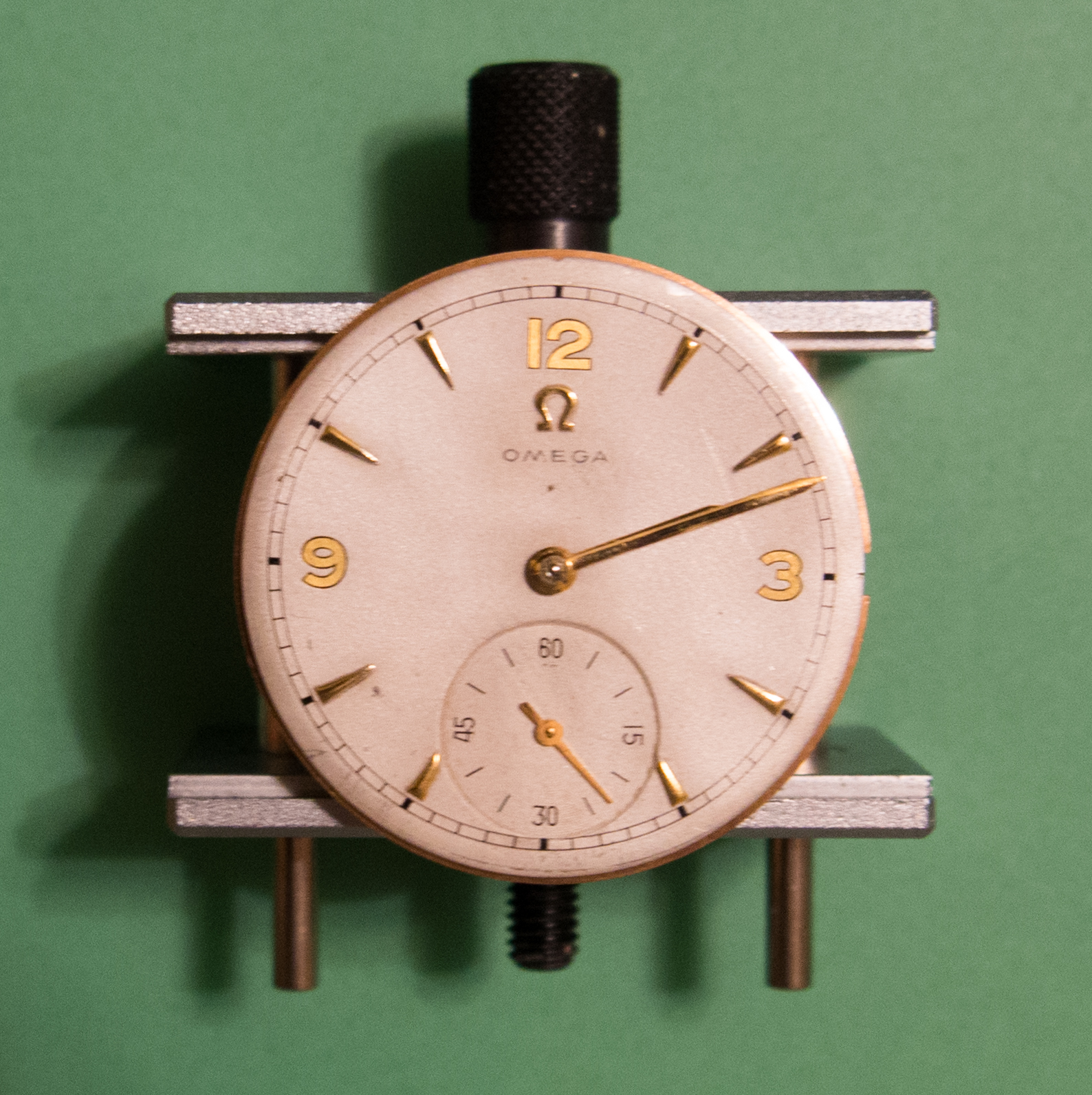

Hans off, dial still on. You can see there is a little damage to the face, but not bad. And I think the dirt will clean up. We'll see.
czFE1p6K1PCmgozD7
Dial off...
VS8UqFVeWrnB5vSR7

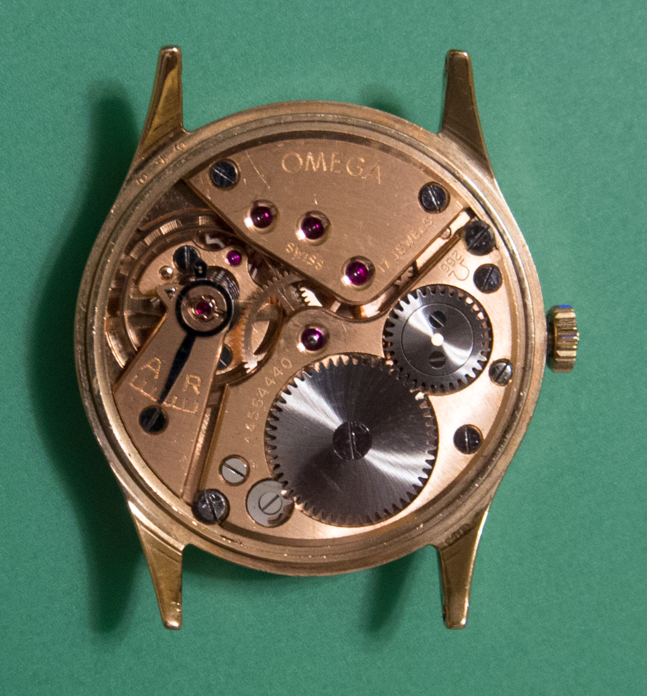

And saving the best for last. I knew that back of the movement looked pretty good. But when I saw this I was amazed...
I can't believe how clean this movement is. Very happy with purchase.
That's all for now. I have to run to work.
-Paul
yXTZ8JHPtsmgmci68
