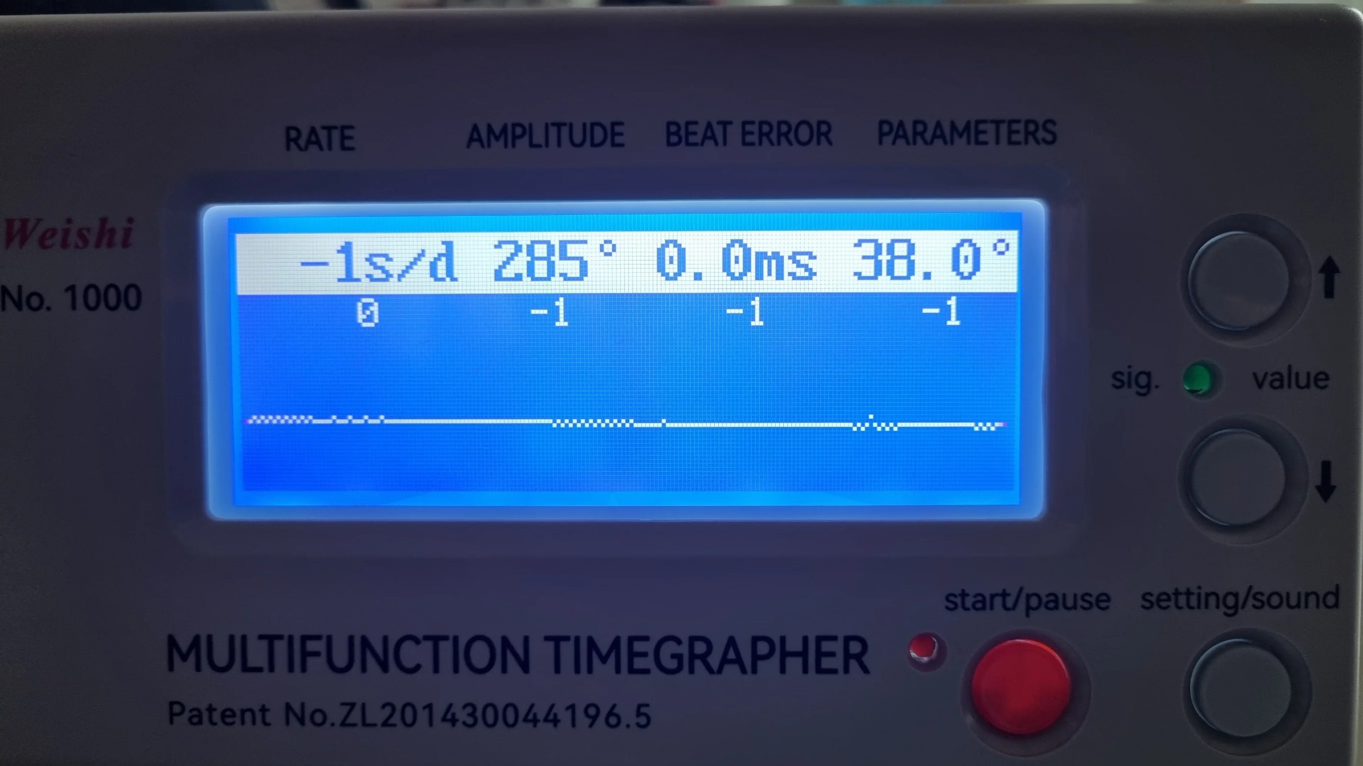

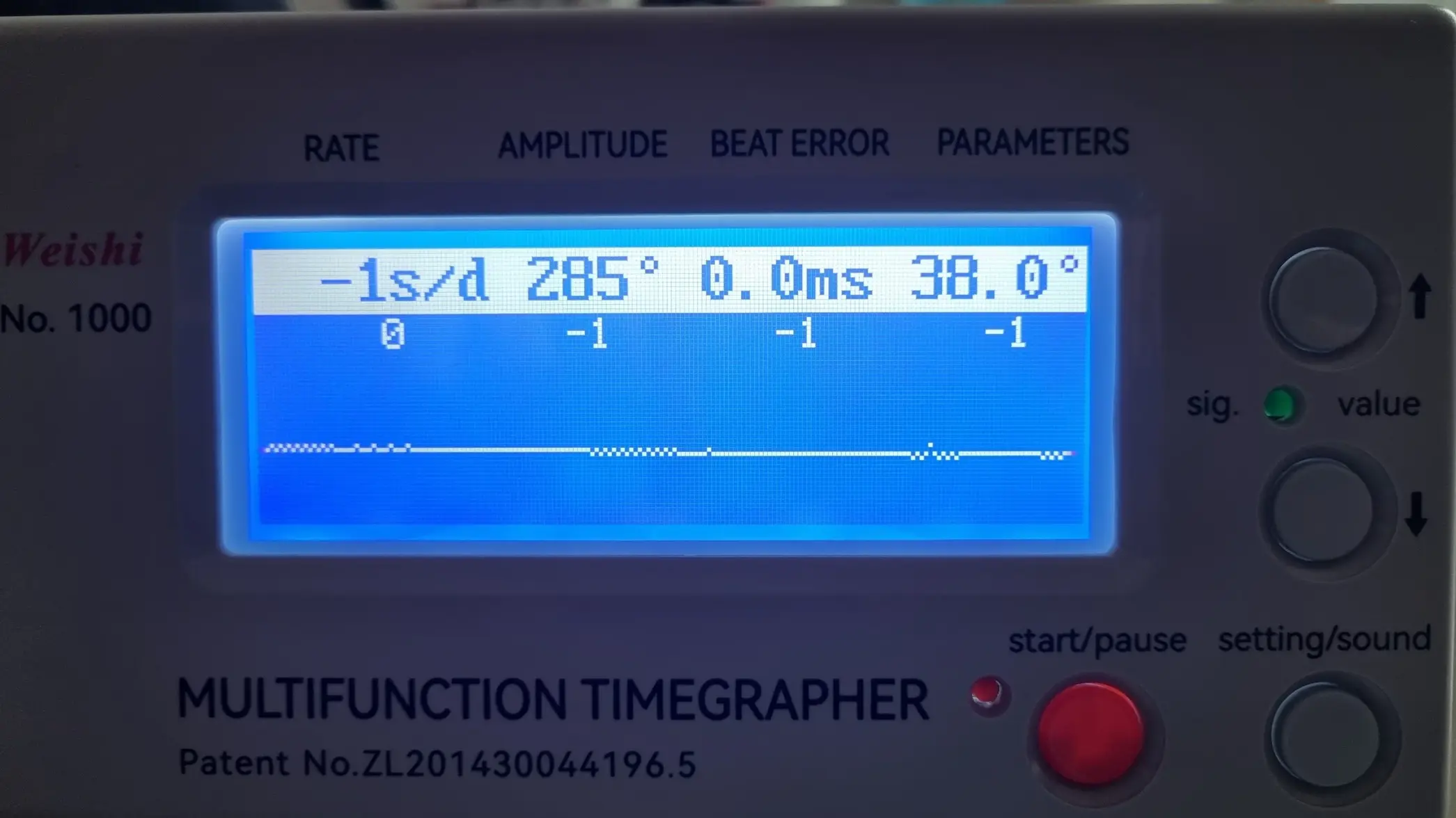

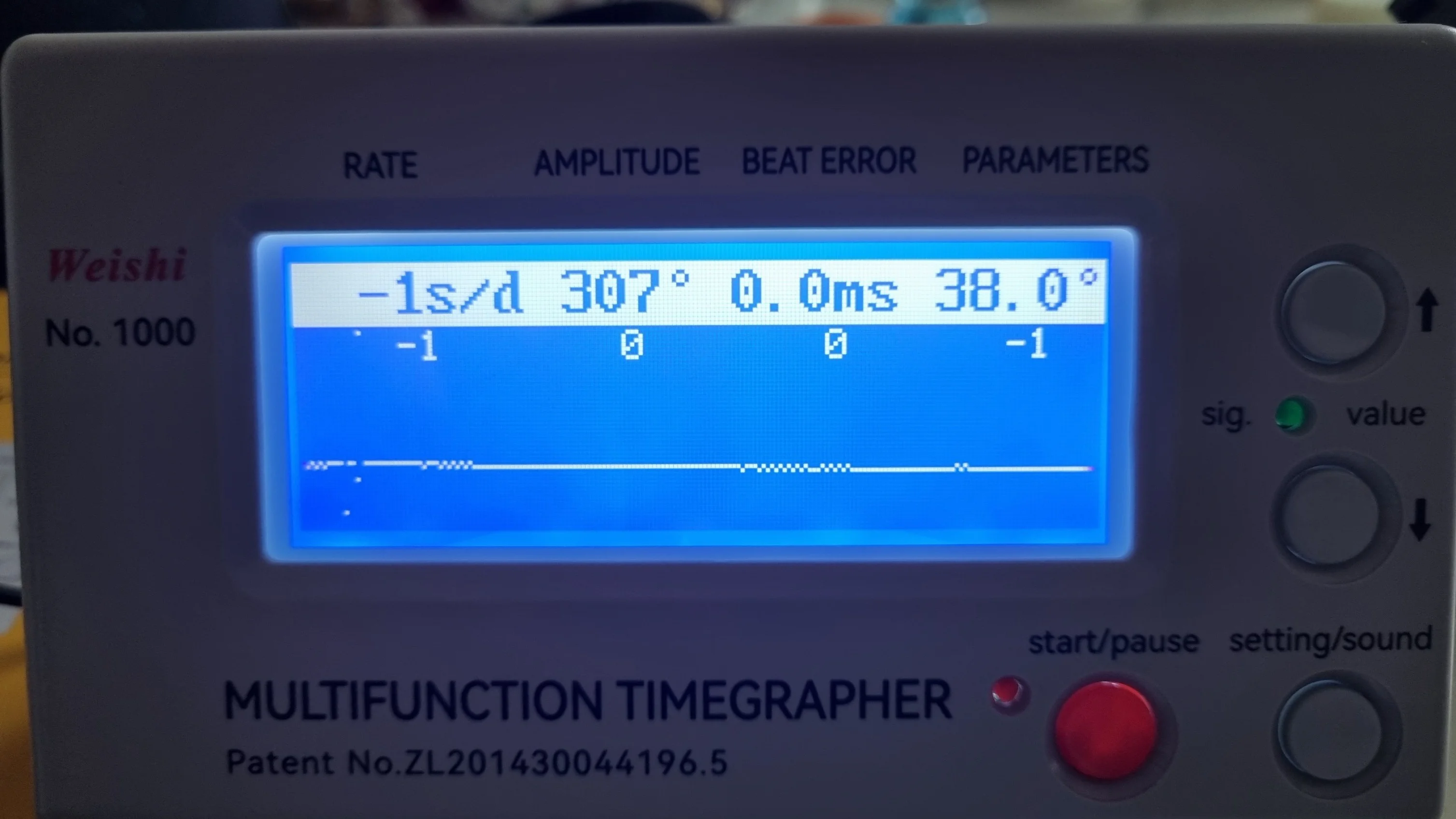

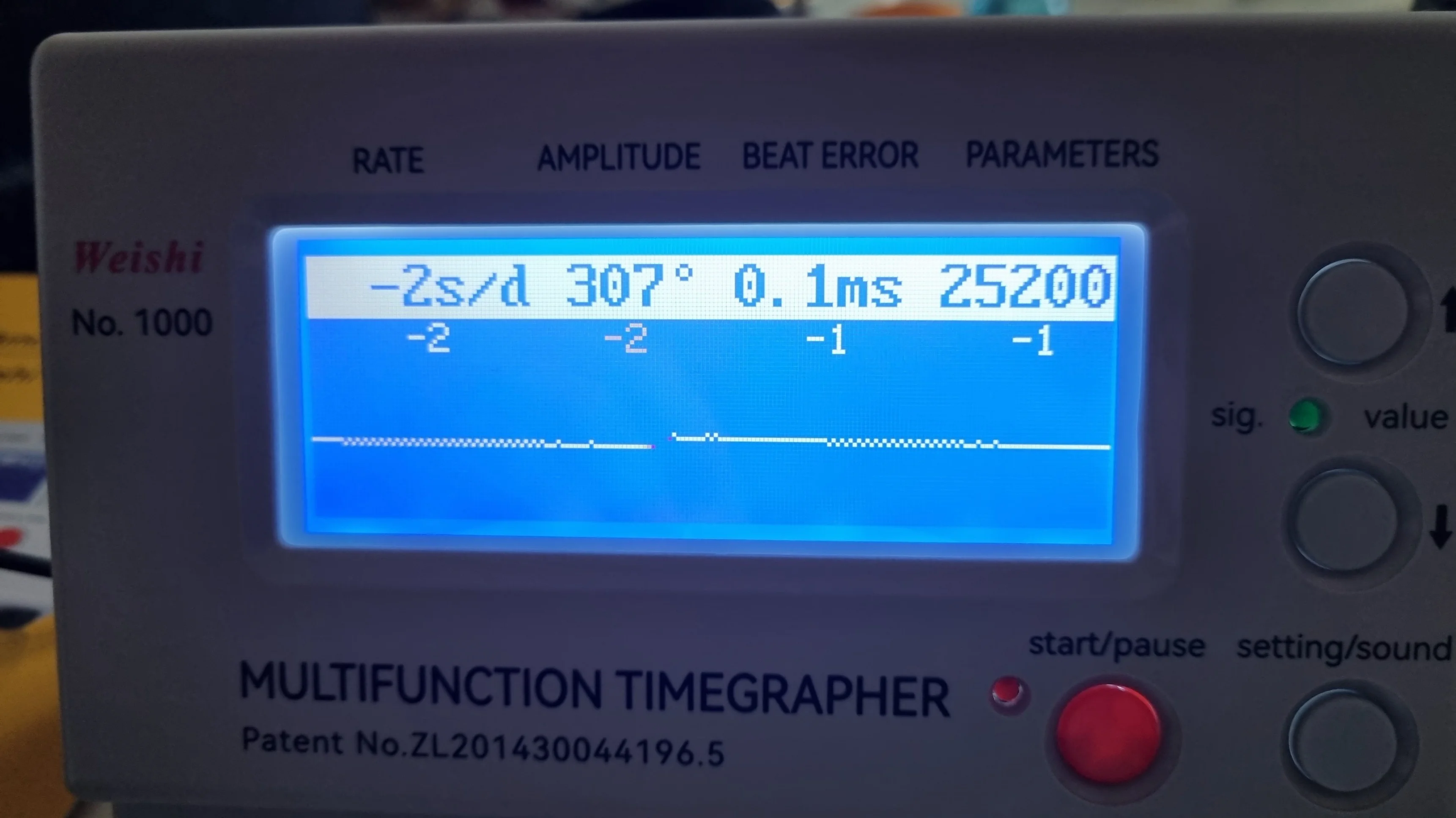

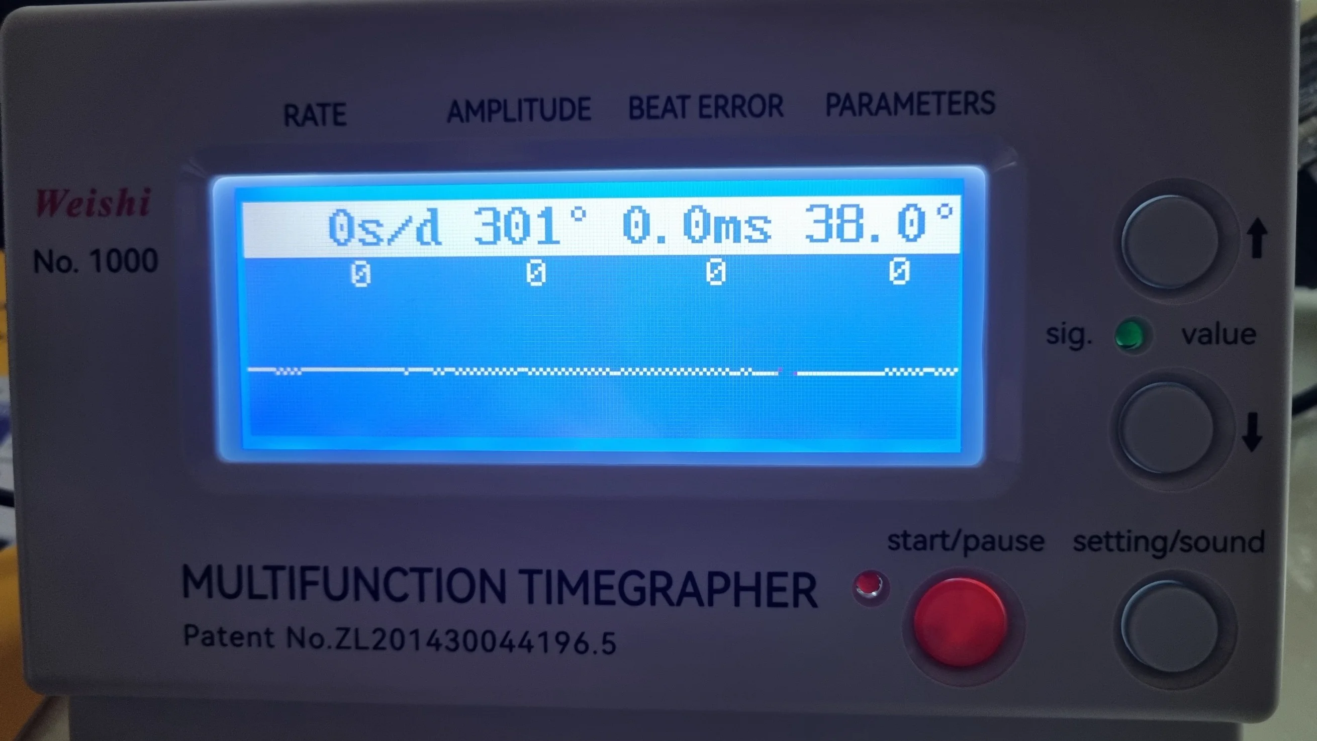

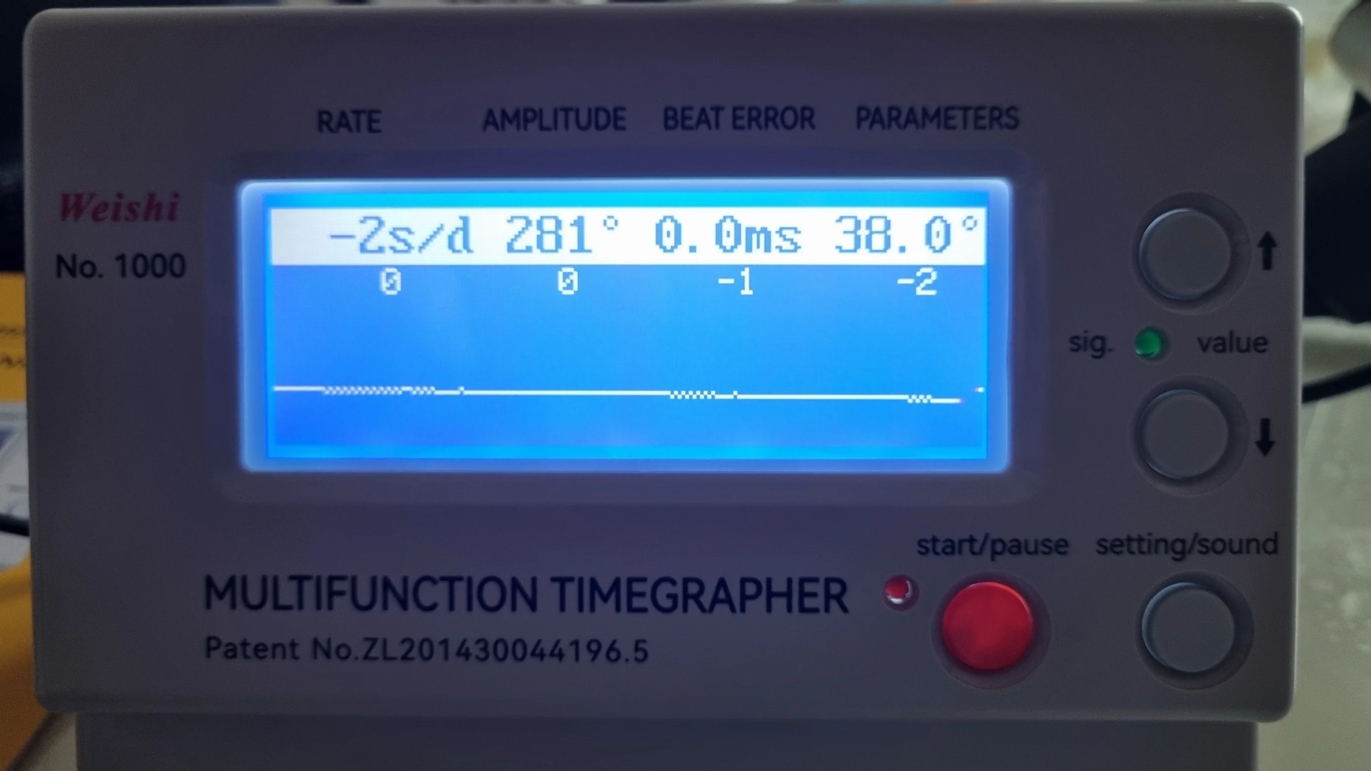

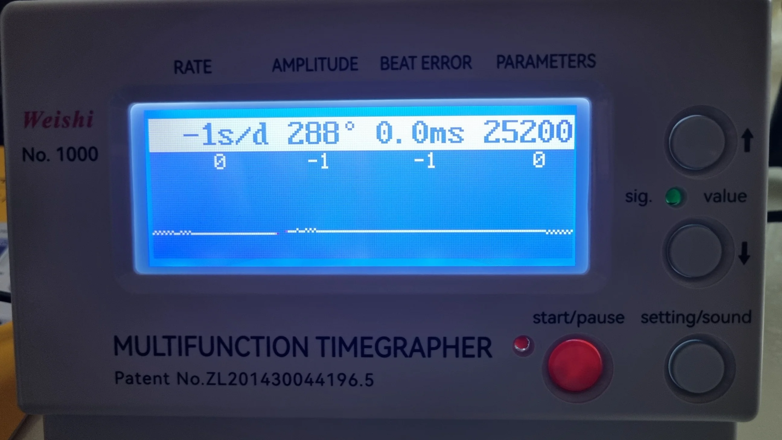

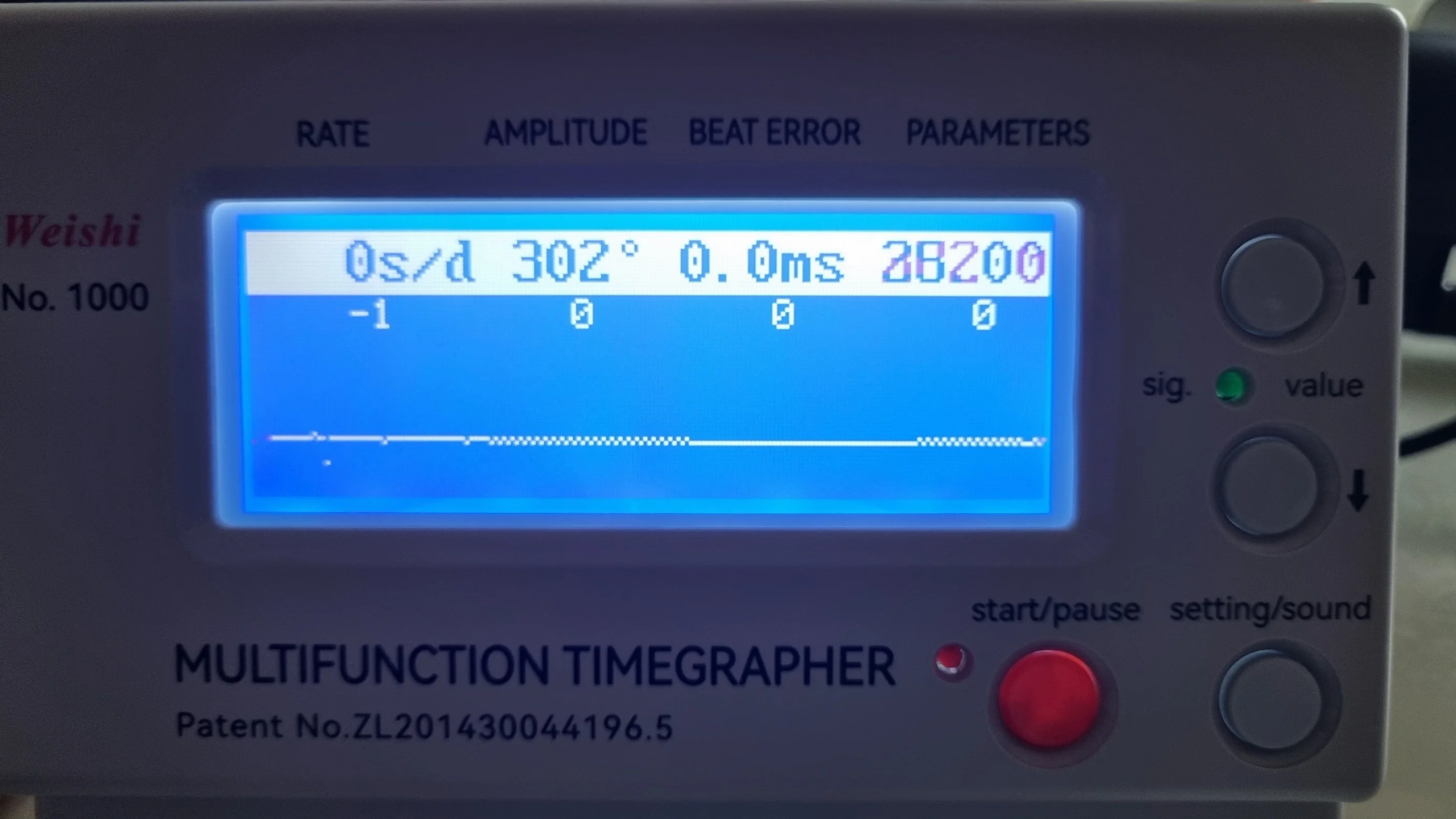

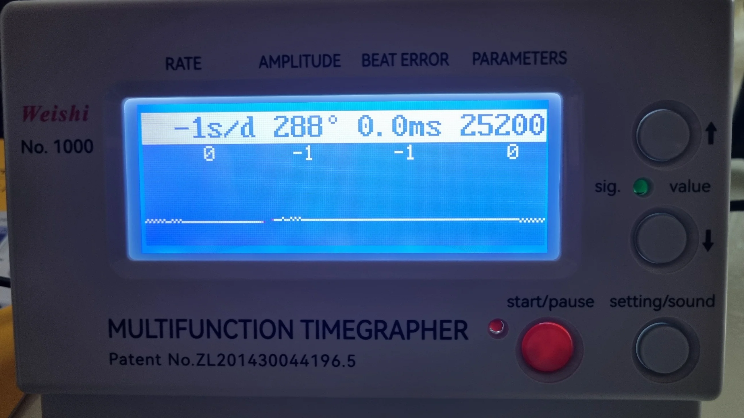

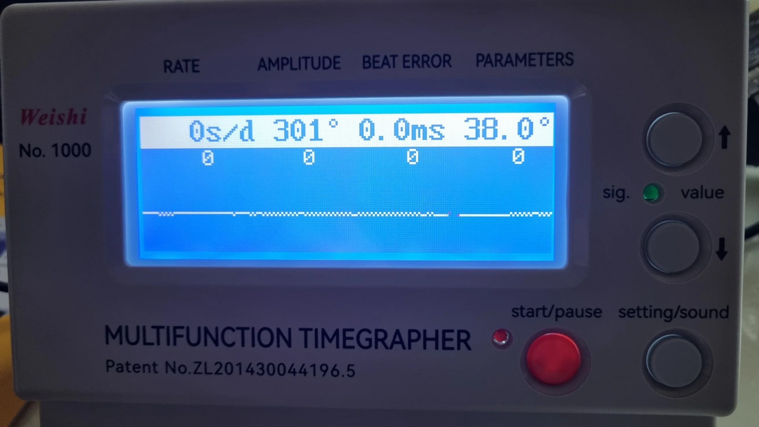

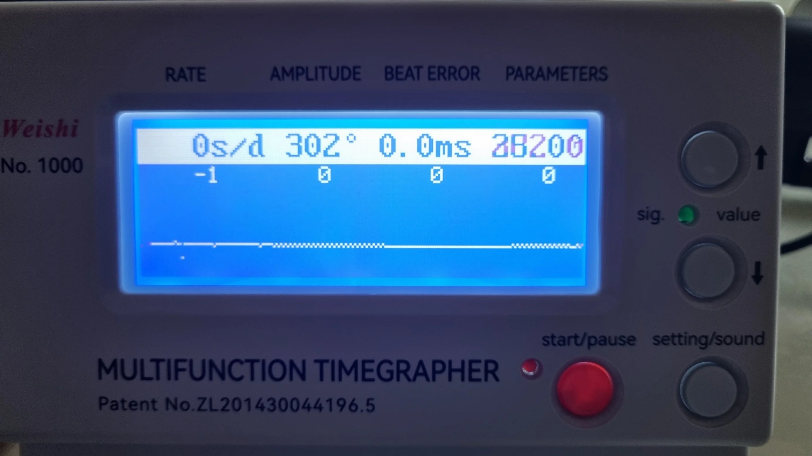

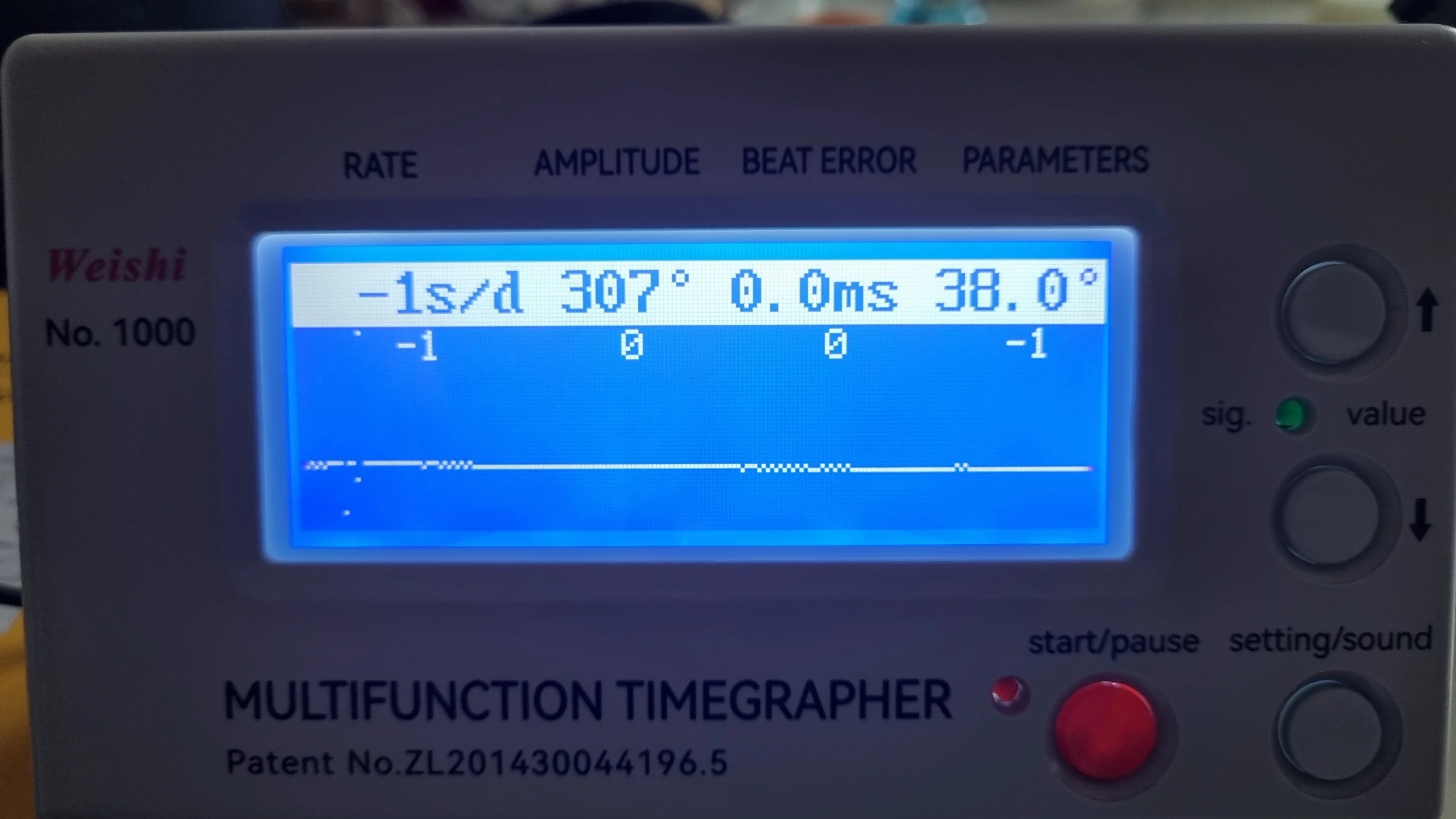

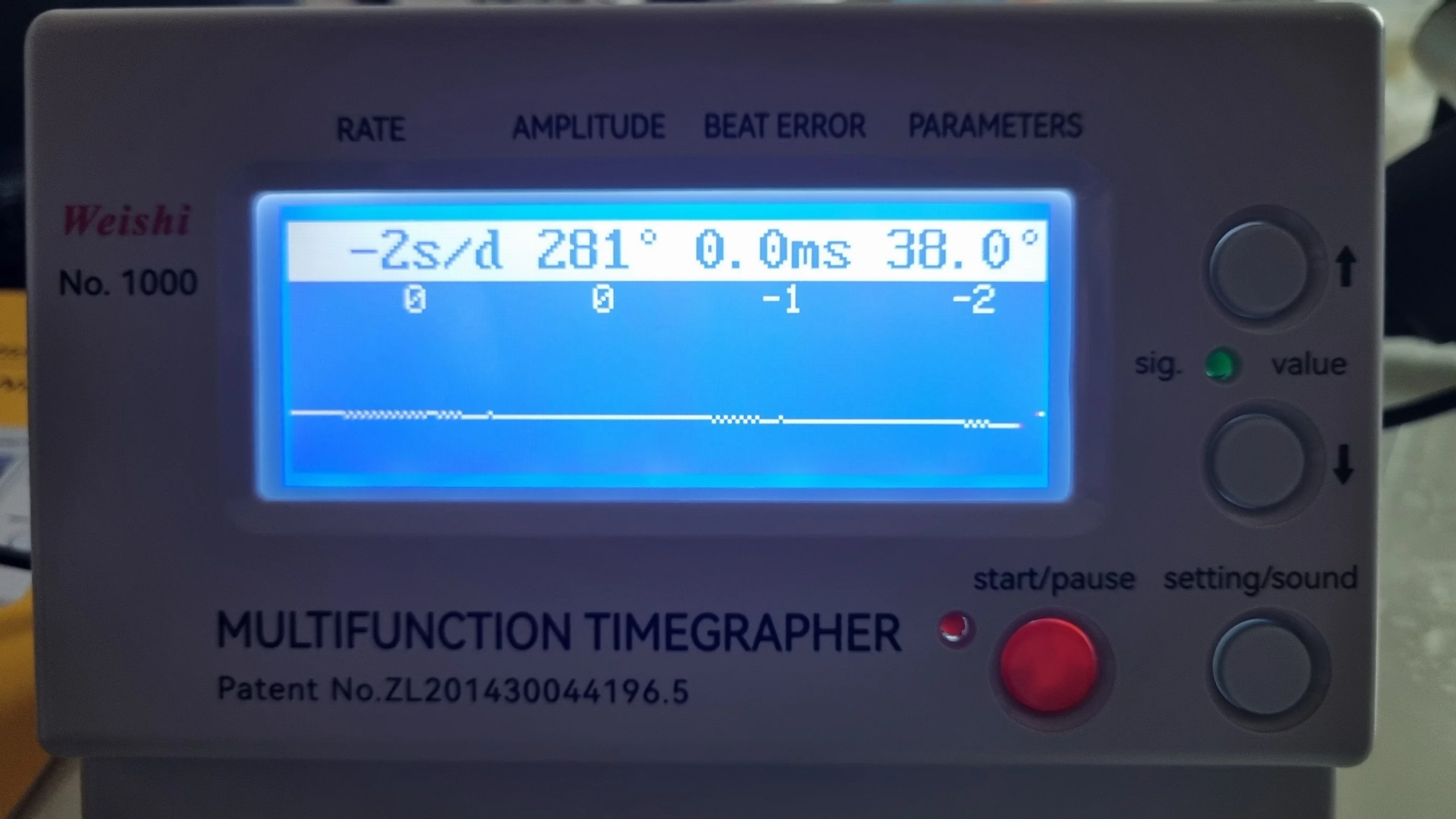

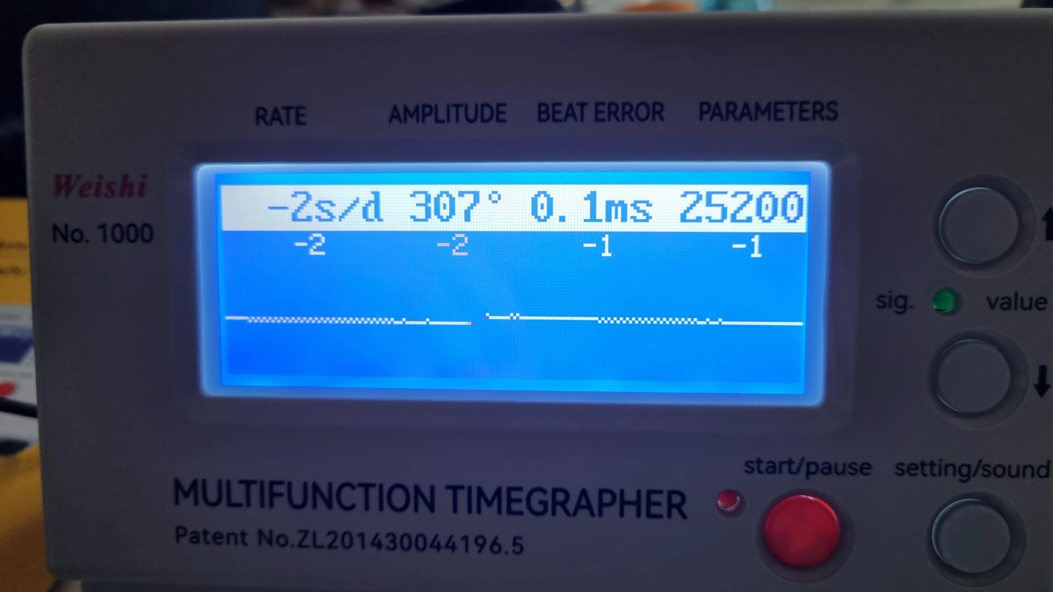

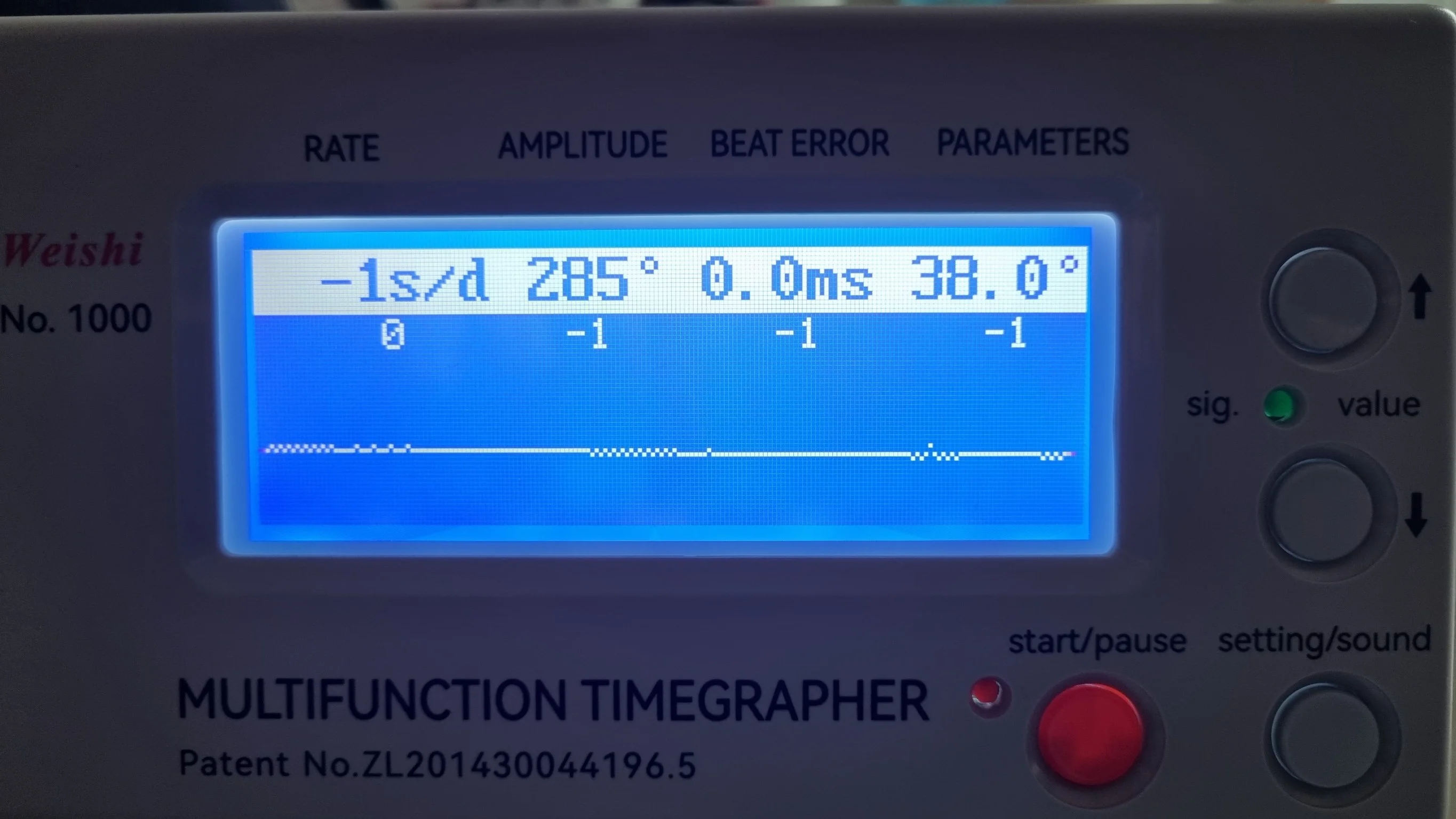

Here are timegrapher results for a brand new watch directly from online retail omega shop.
As I expected there are no positions which give me positive gain. Out of METAS promised by Omega
24
I have tested dial up, dial down, crown at 45, 135, 225 degrees, crown up and crown down
24
