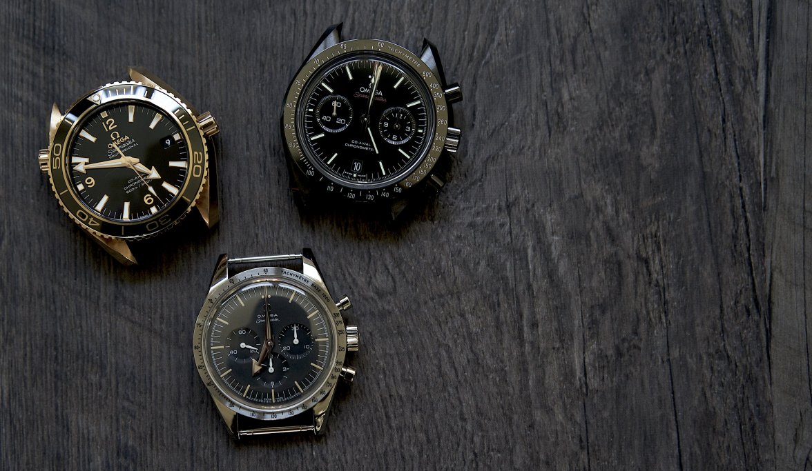

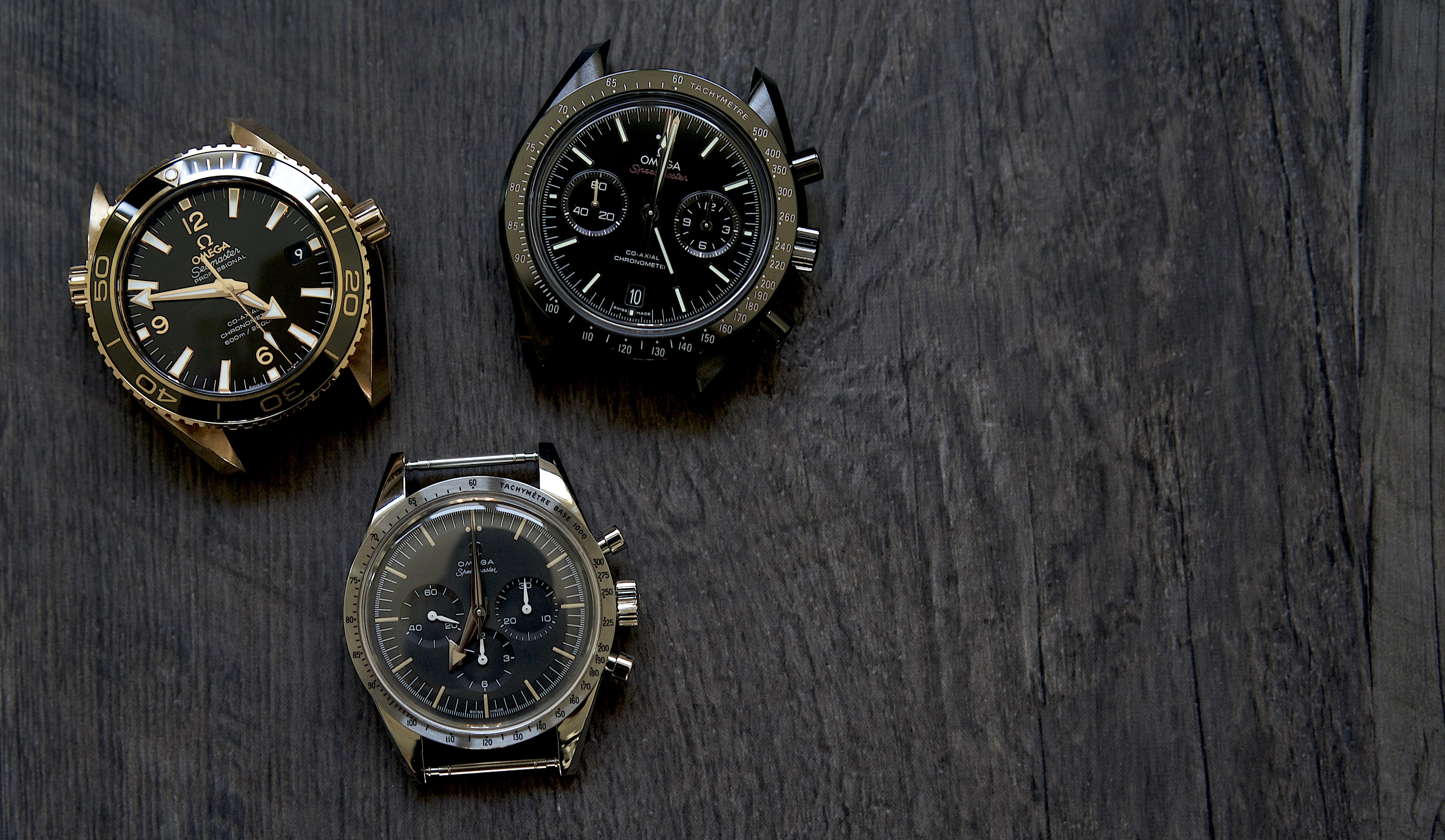

my DSOTM and friends.
33
33
Don’t worry. Keep accumulate those bad lucks. One day, you’ll find a Paul Newman Daytona in a thrift-shop. I found a minty AP at the mall, so it can happen to anyone.
Now that’s a cool watch photo
