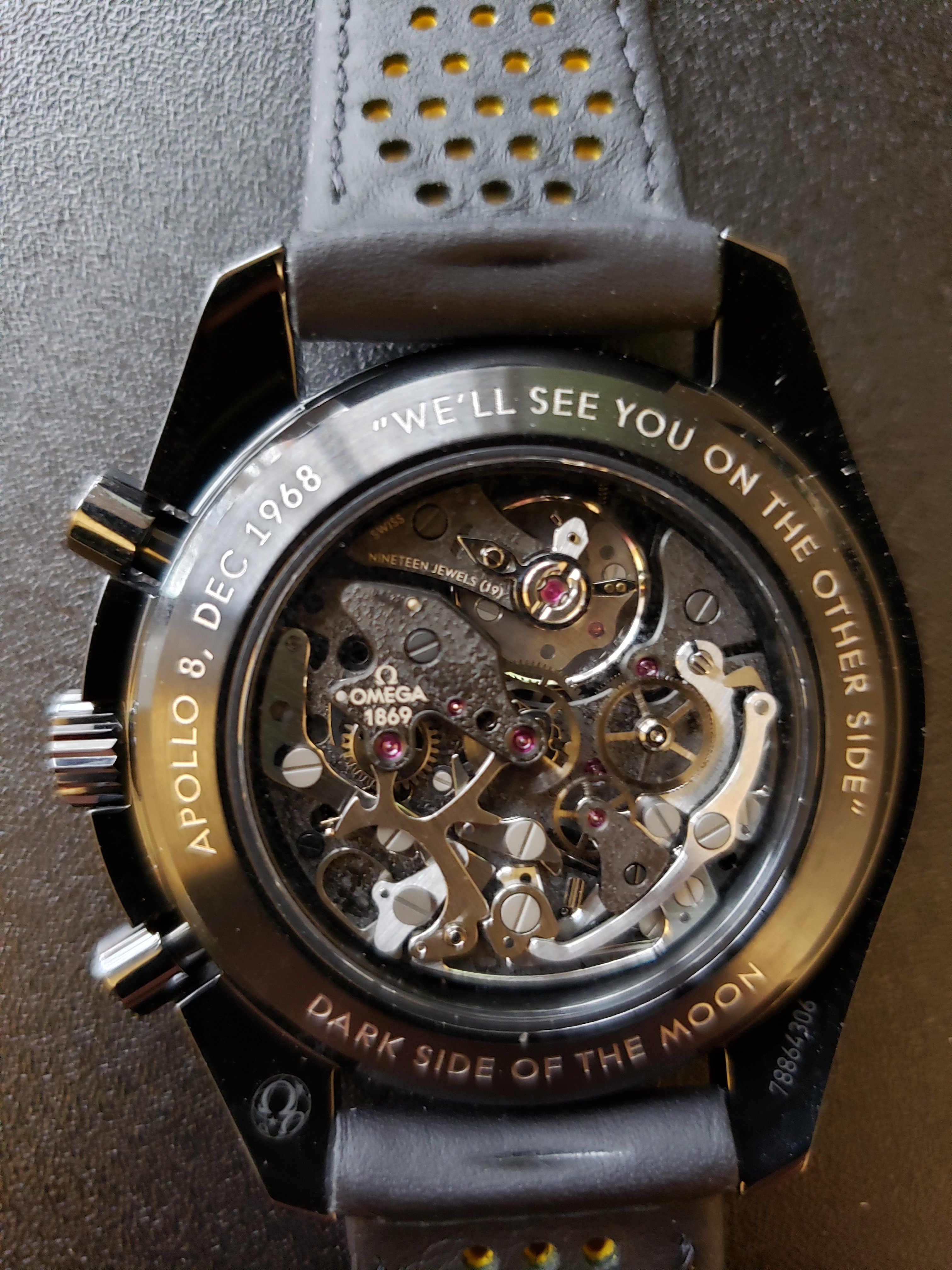

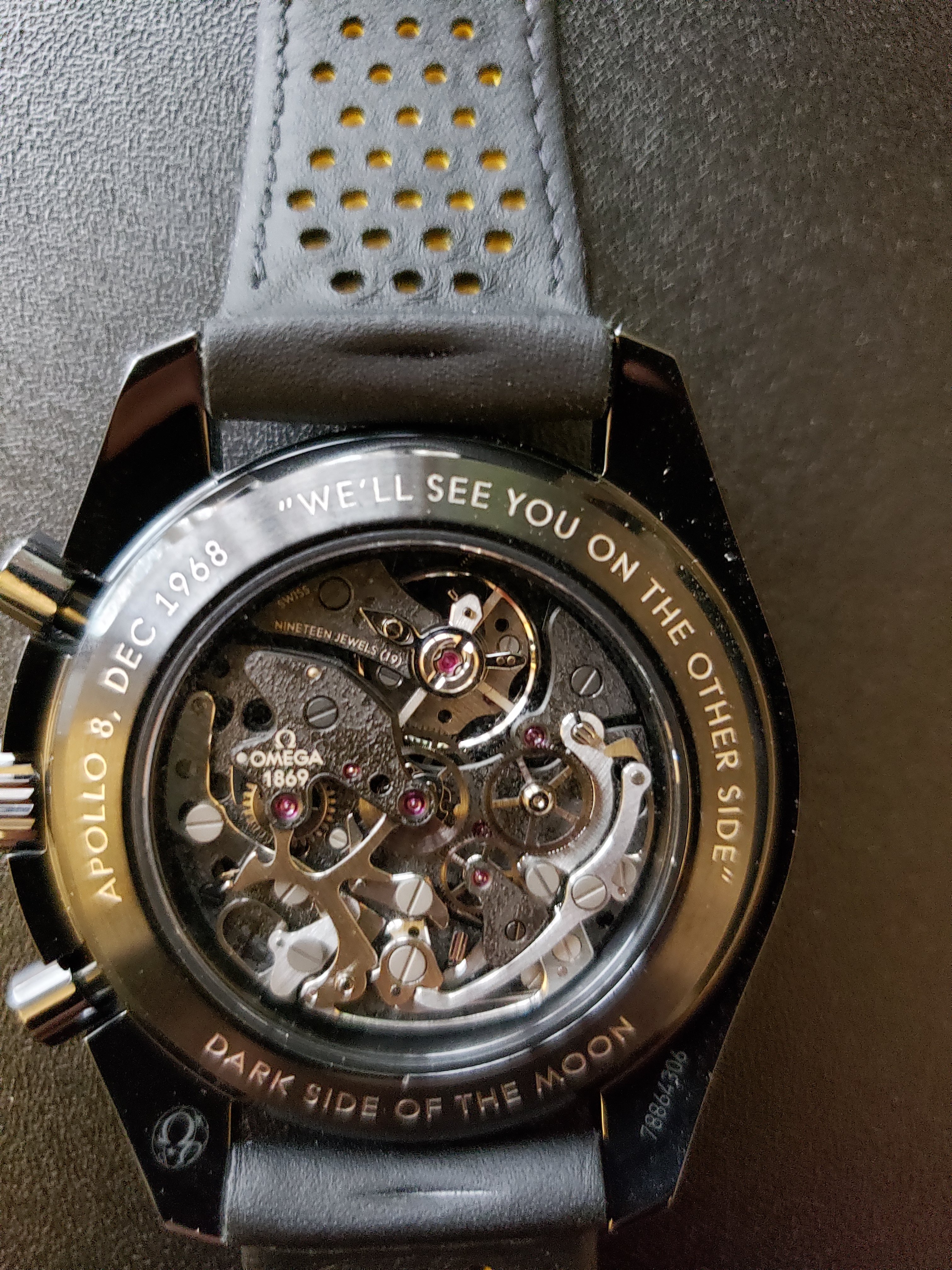

Did you fully wind it until you couldn't wind it any longer?
Is this happening with the chronograph running, or is the chronograph off and reset?
Can you show some photos through the case back?
Yes. I did try to avoid over-winding it. About 60 turns.
Off and reset.
Sure. Took them just now, the first one is while it was running, and then when I went to put it back on, it stopped. Actually, pics are backwards... stopped one first.
Off and reset.

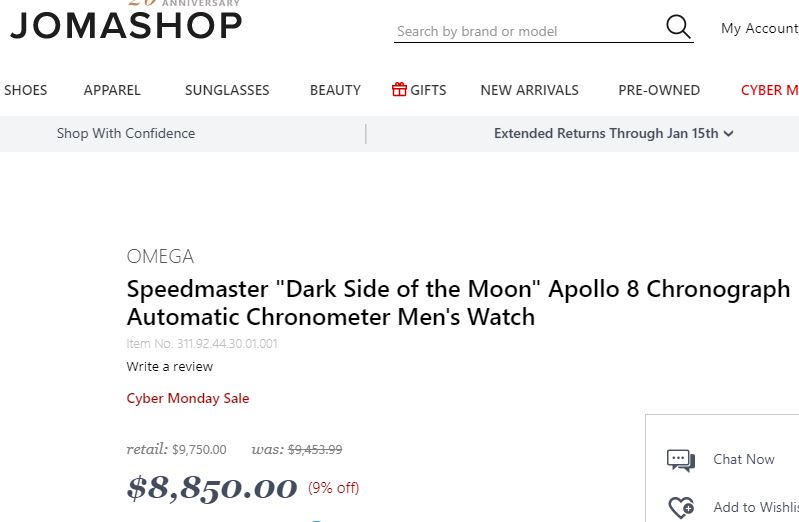

These comments above are why I do not buy from Joma. I'm sure they're fine and reputable, but I don't want my new watch serviced by them. And their savings generally isn't enough to cover a service.
While I wouldn’t have Joma - or any other grey market dealer - service any of my Omegas, it’s not accurate to say the savings from buying grey isn’t enough to cover the cost of an Omega service. Joma for example, is currently selling the DSOTM Apollo 8 for $8,850 USD, which is a discount of $950. That’s enough savings to pay for Omega’s $750 full chronograph service. Many other Omega models are much more heavily discounted, often by several thousand dollars.

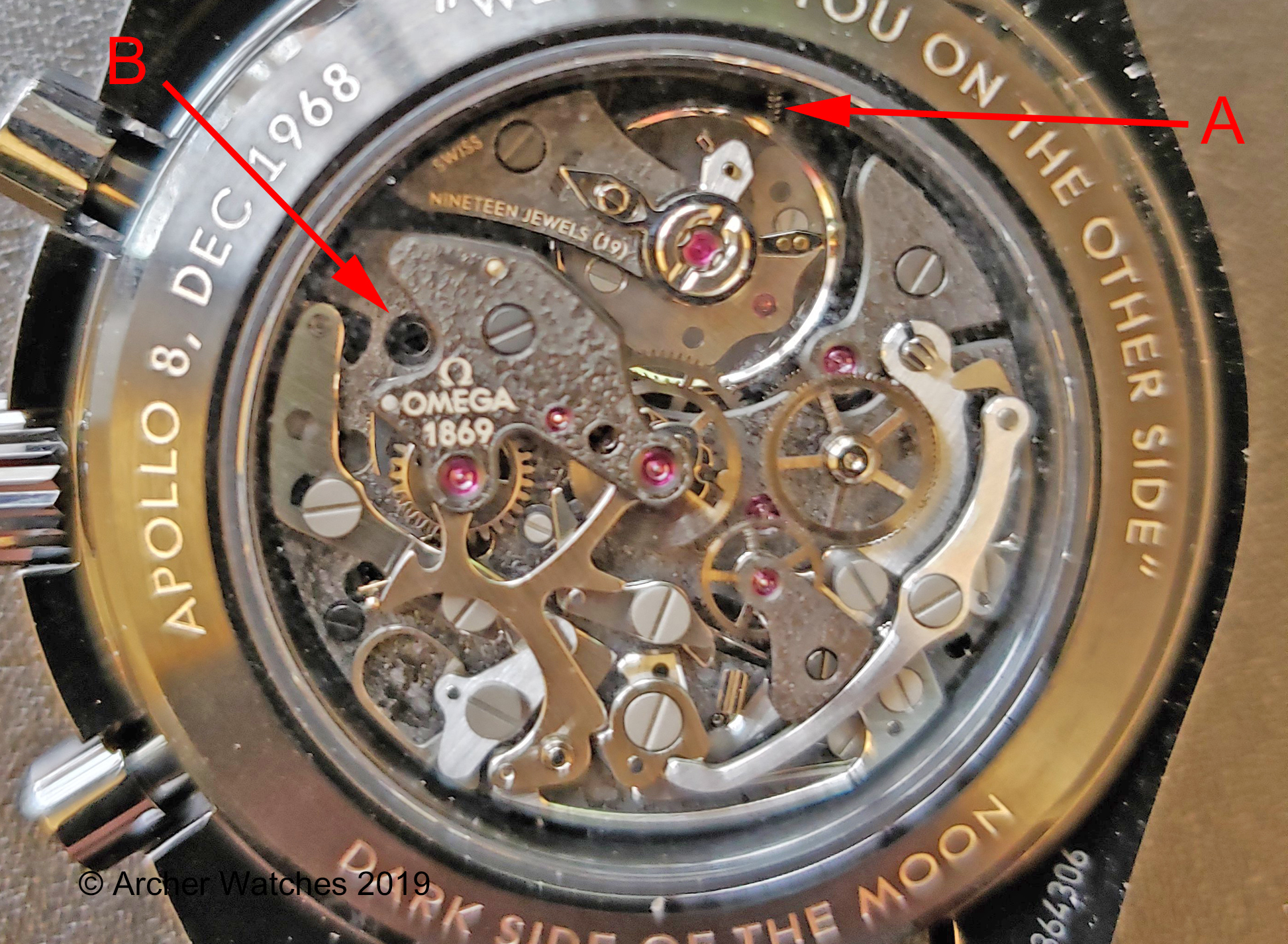

Here's the problem:
Screw floating around at A, should be in hole at B.
Easily fixed, and should be covered under warranty.

While I wouldn’t have Joma - or any other grey market dealers - service any of my Omegas, it’s not accurate to say the savings from buying grey isn’t enough to cover the cost of an Omega service. Joma for example, is currently selling the DSOTM, which retails for $12,000 USD, for $7,850. That’s enough savings to pay for Omega’s $750 full chronograph service 5 times with money left over.
I didn't say buying from [any] grey, just buying from them. You can often do better than Joma. I guess I should have been more specific - the Apollo 8 DSOTM is what I got, MSRP is $9750 USD, Joma is $900 off. So your argument does still have merit, but I guess it really depends on the model.
That said, I did much better than that price.

Here's the problem:
Cheers, Al
Holy smokes, good eye! Thanks for that, I feel better knowing what the issue is. I'll send it off.

Here's the problem:
Cheers, Al
What a great spot! That’s why this forum is one of the best IMO
Yes, with this particular watch you make a valid point and I agree.
