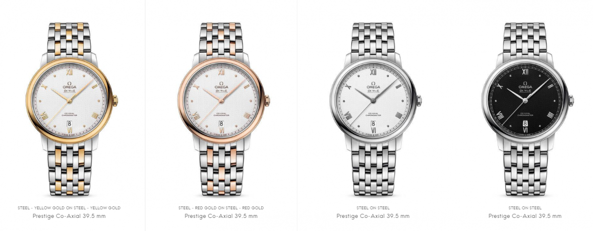

New De Ville LE

Surprised to see the 2500 again. Not that there was anything wrong with it. Its a workhorse.

Interesting that when I look this new watch up on the Omega Extranet, it doesn't show the specific movement listed - it just says 2500. This is odd, because normally they show the latest variant of the movement used, which is a 2500D...or that WAS the latest movement until I saw an updated 2500 tech guide today, where the 2500E was added...馃槻
Although not a METAS movement, the 2500E has had a silicon balance spring added, so should be far less susceptible to magnetism than the other 2500 calibers are, and will also have better accuracy I would imagine, although I have not seen specs for that just yet. So although I thought the 2500 movement was not really being updated anymore, it appears it's still being modernized...

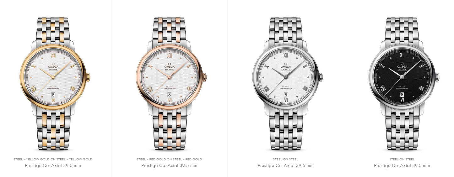

2500D or 2500E?? I purchased my Omega DeVille prestige cream dial from AD in July 2021, I thought it had a 2500D?
